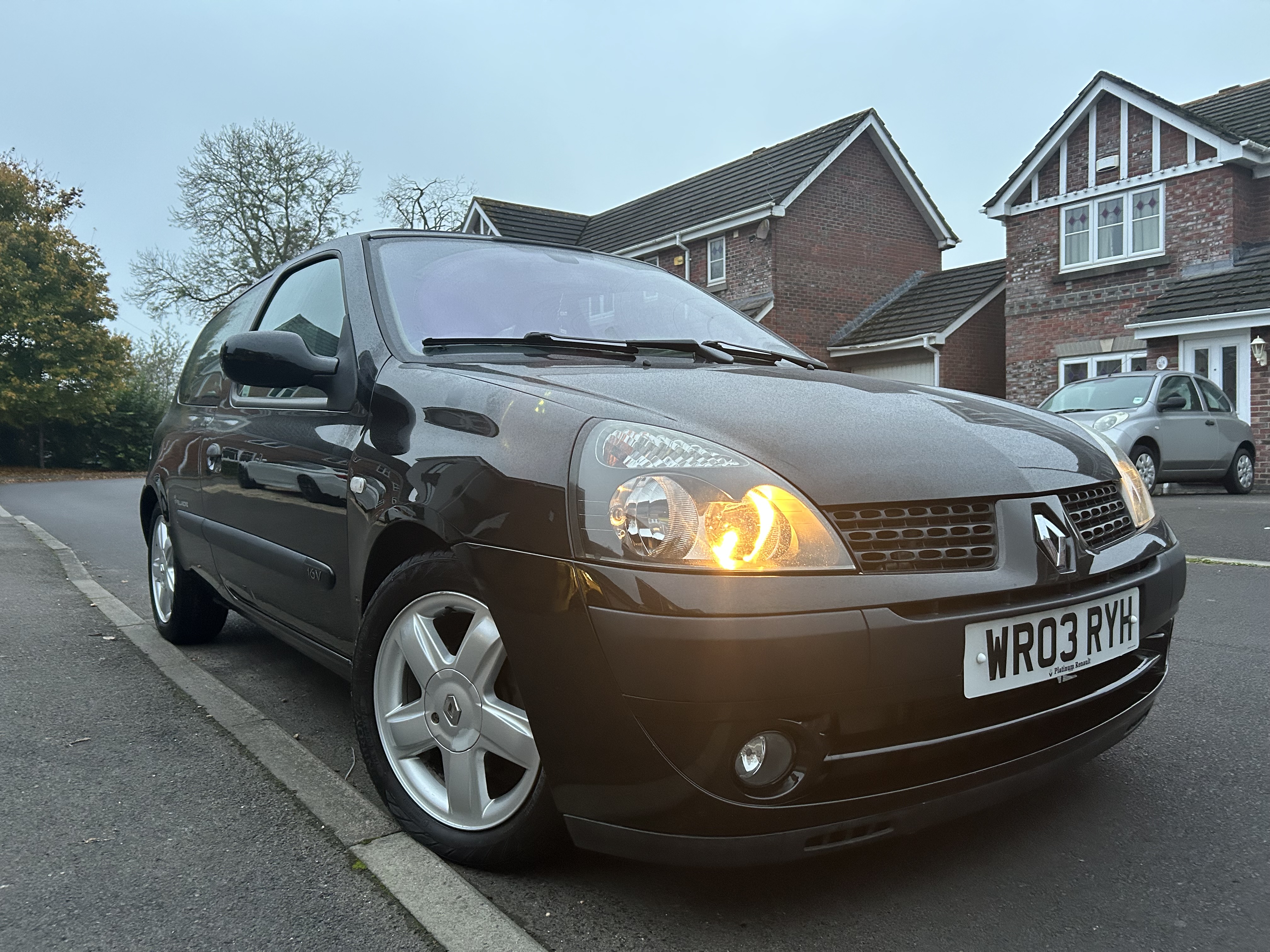

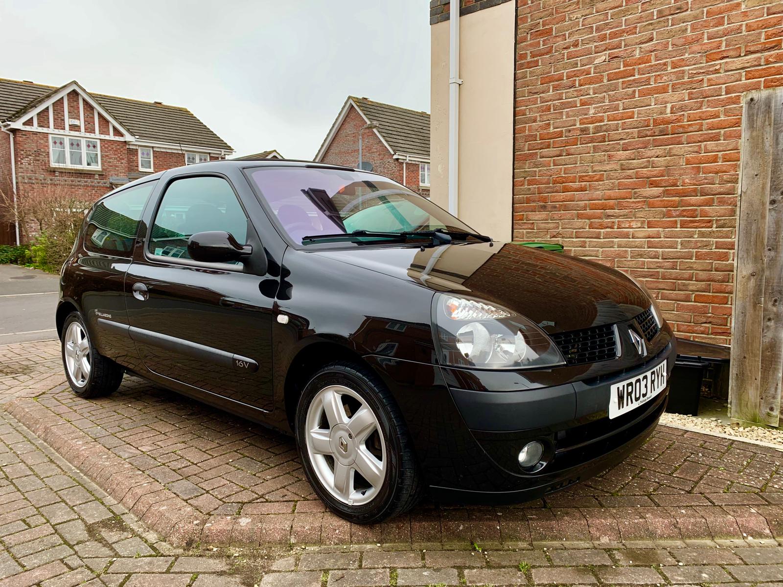

Another thread. This time its a little Clio billabong 1.2 16v thats been in the family since 2004.
Originally my mothers car which i learned to drive in way back in 2005. And then subsequently thrashed the life out of it when i passed until i got my own Clio.
My mum owned it up until 2018 until it was passed onto my sister to run to work and back in to keep the miles down on her 182. She used the car up until late 2021 and its been parked up at my grans house ever since.
With my daughter turning 17 next year i thought this would be perfect for her to learn in, just like i did all those years ago.
Last week week i decided to get the Clio back to my house for some tlc :)
Spec wise its pretty good being a billabong, has climate control and an electric sunroof which doesn’t leak.
Its currently on 74,931 miles so still pretty low.

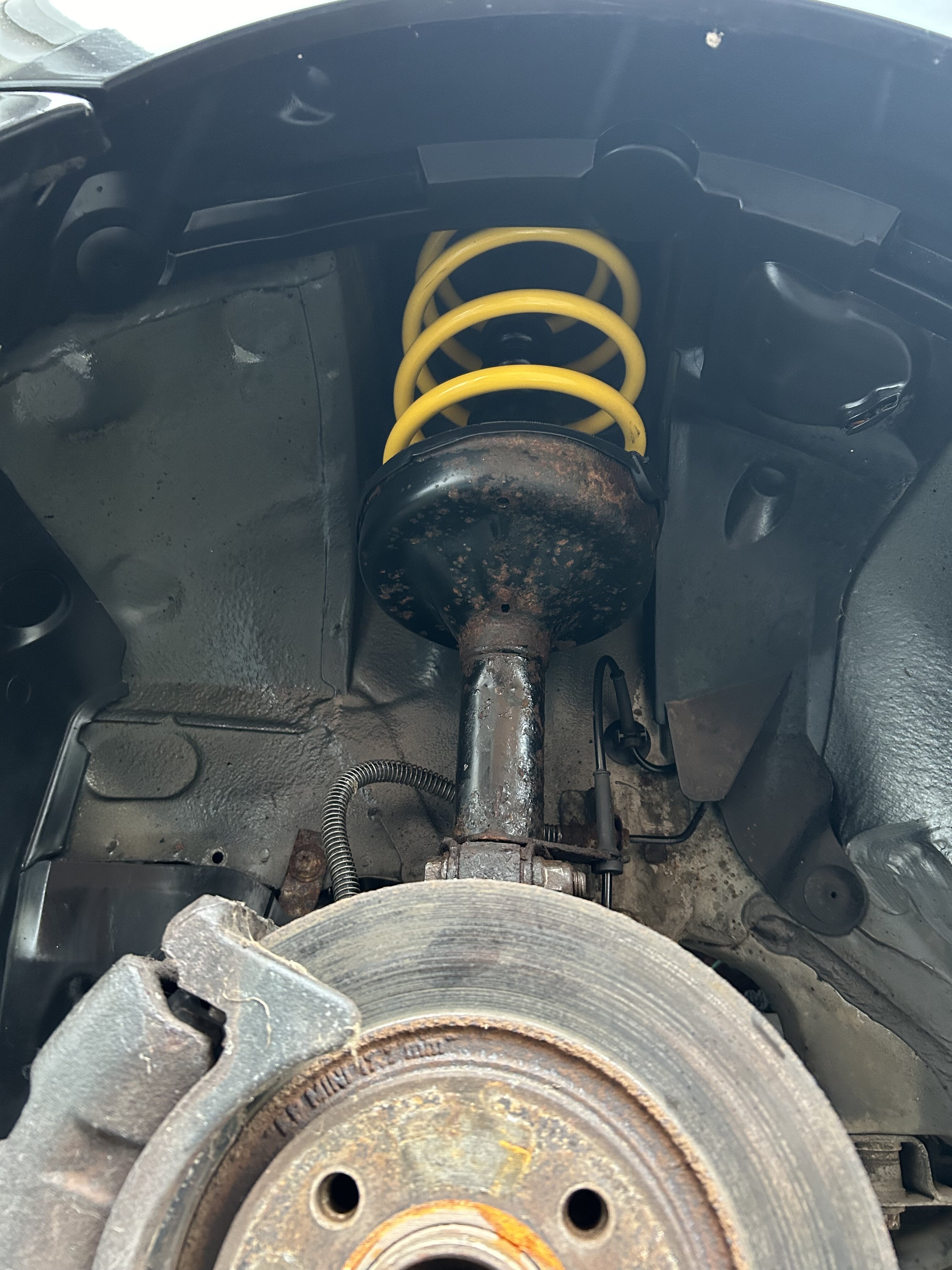

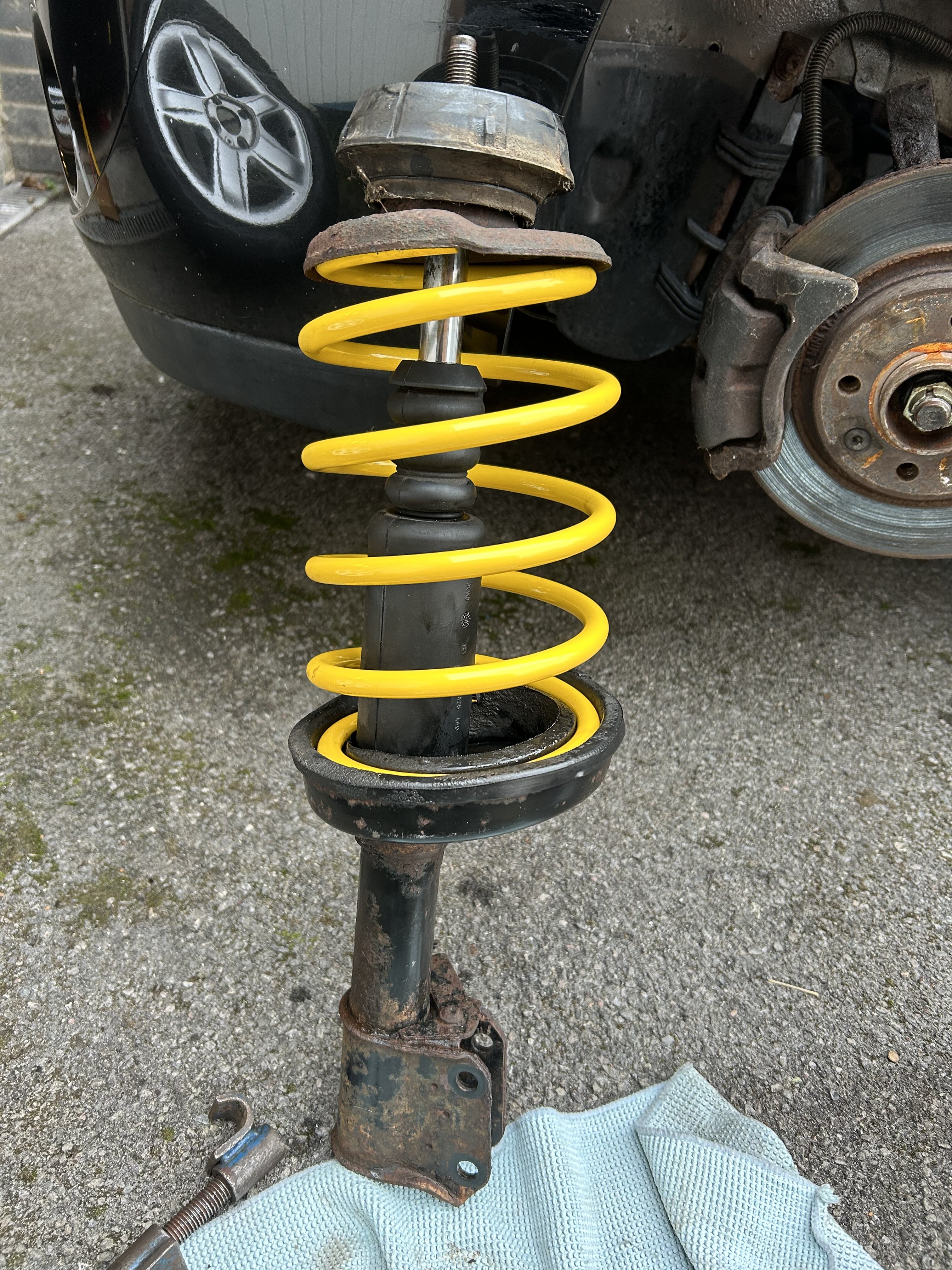

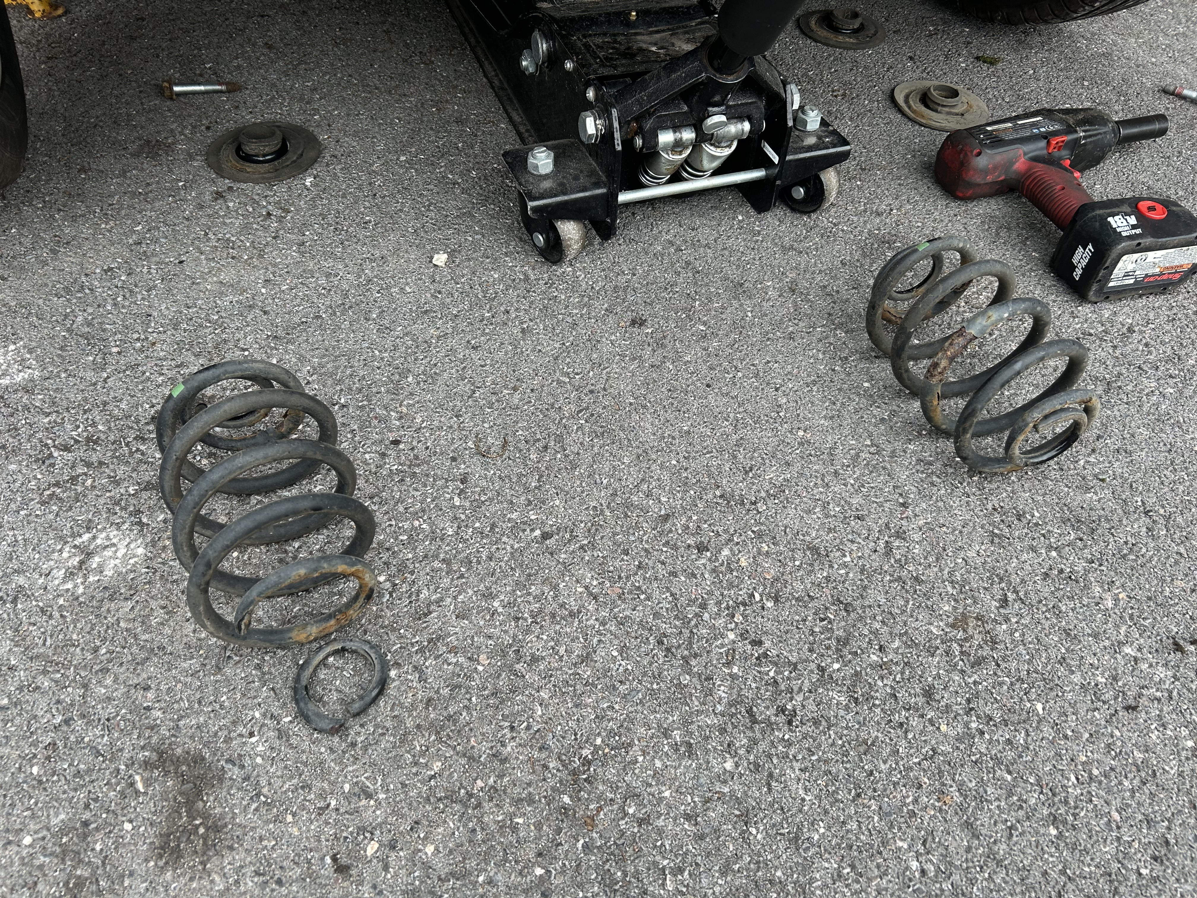

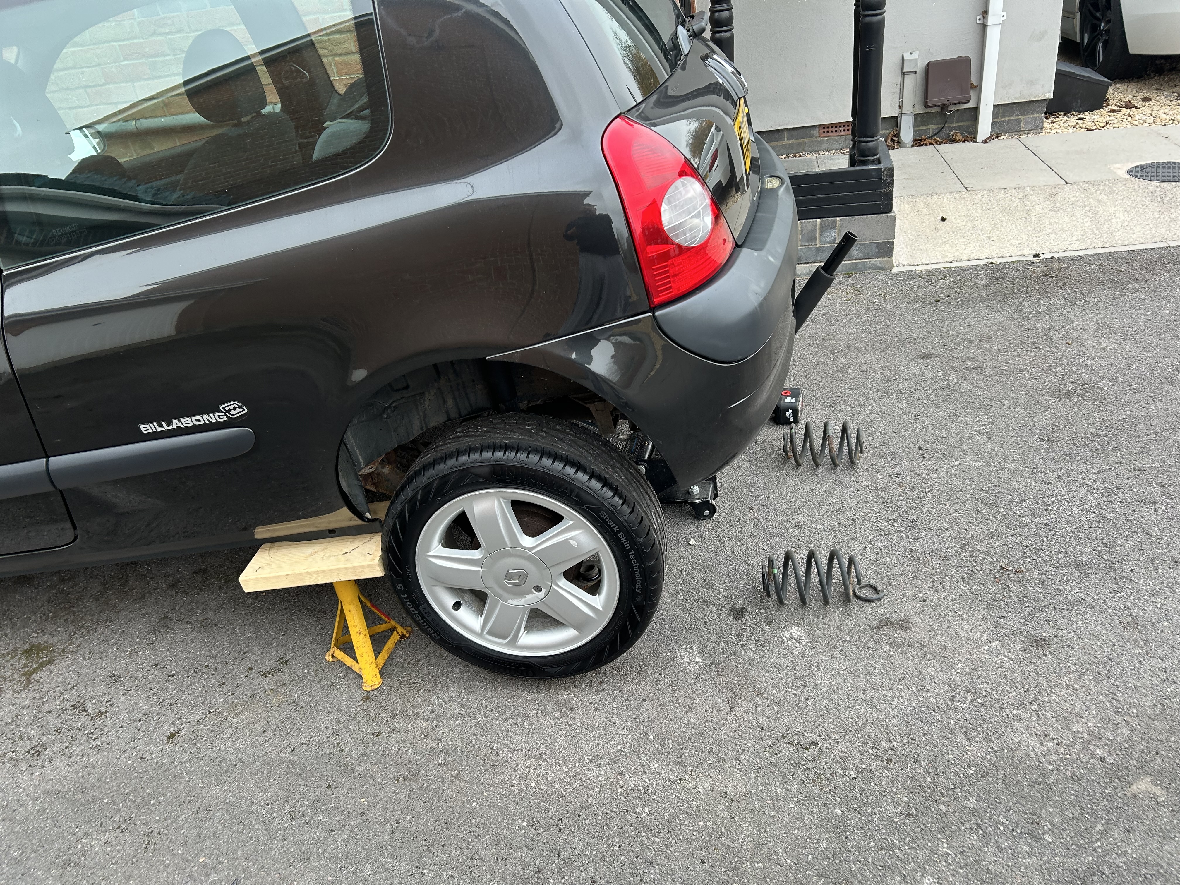

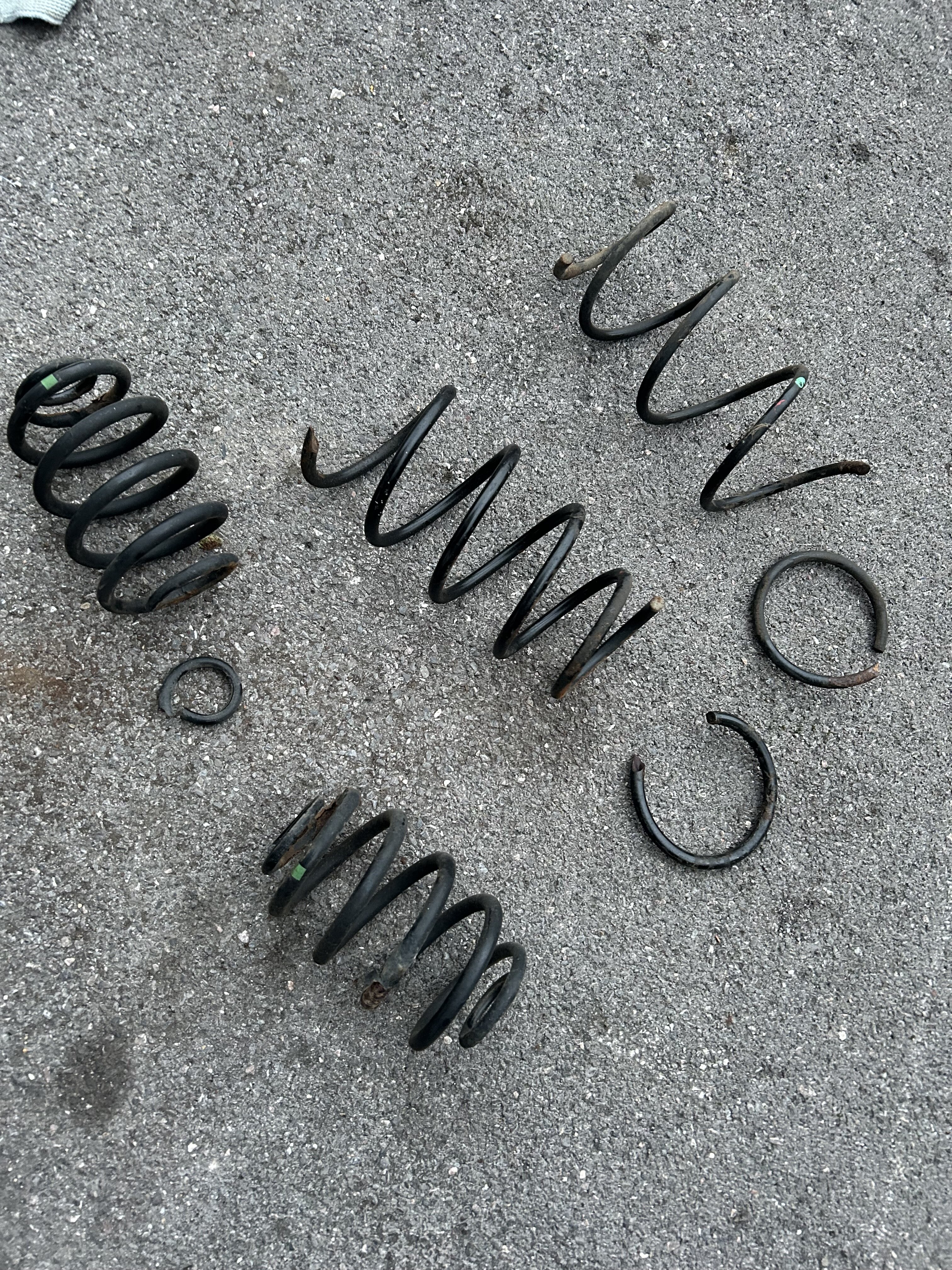

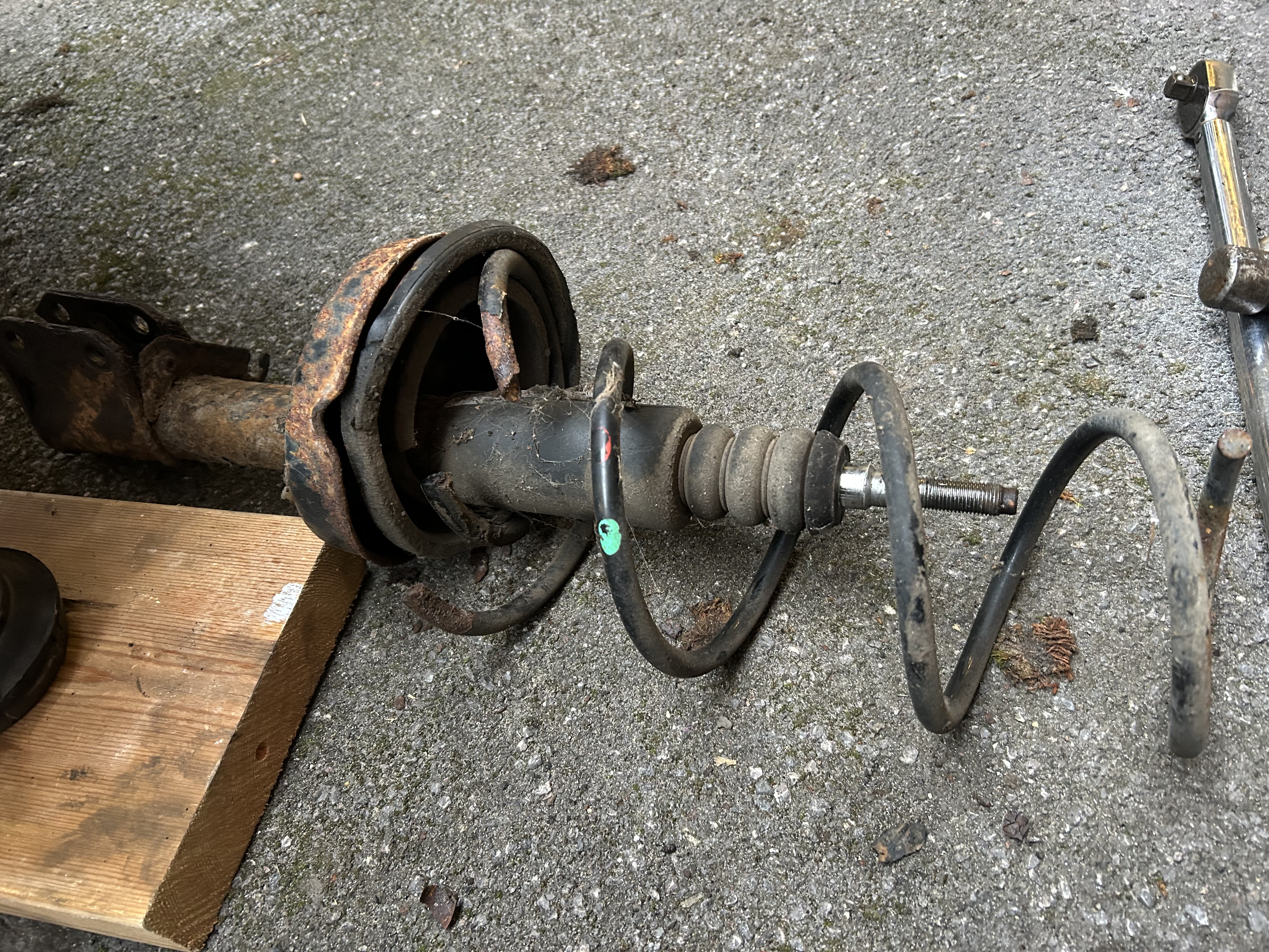

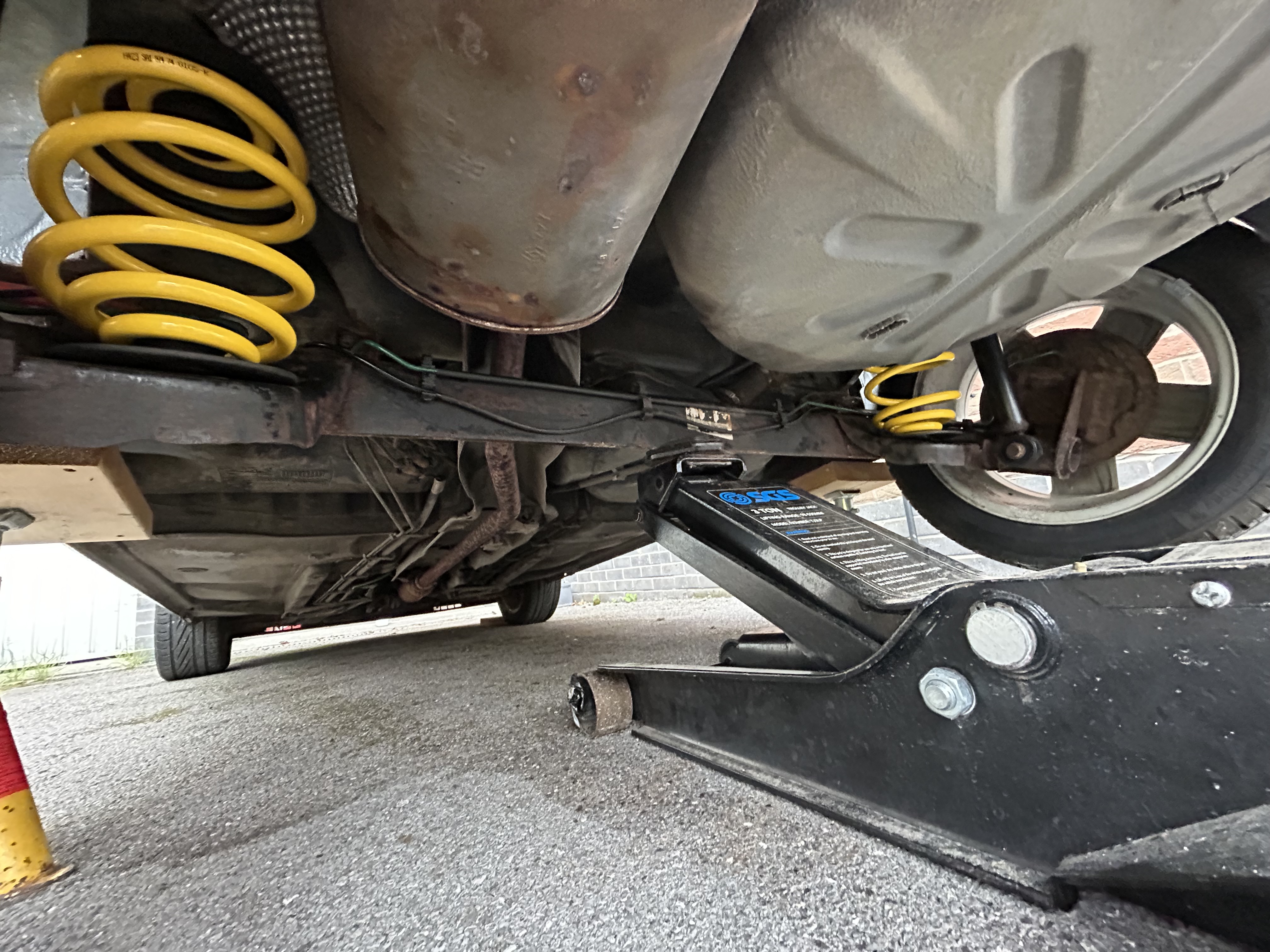

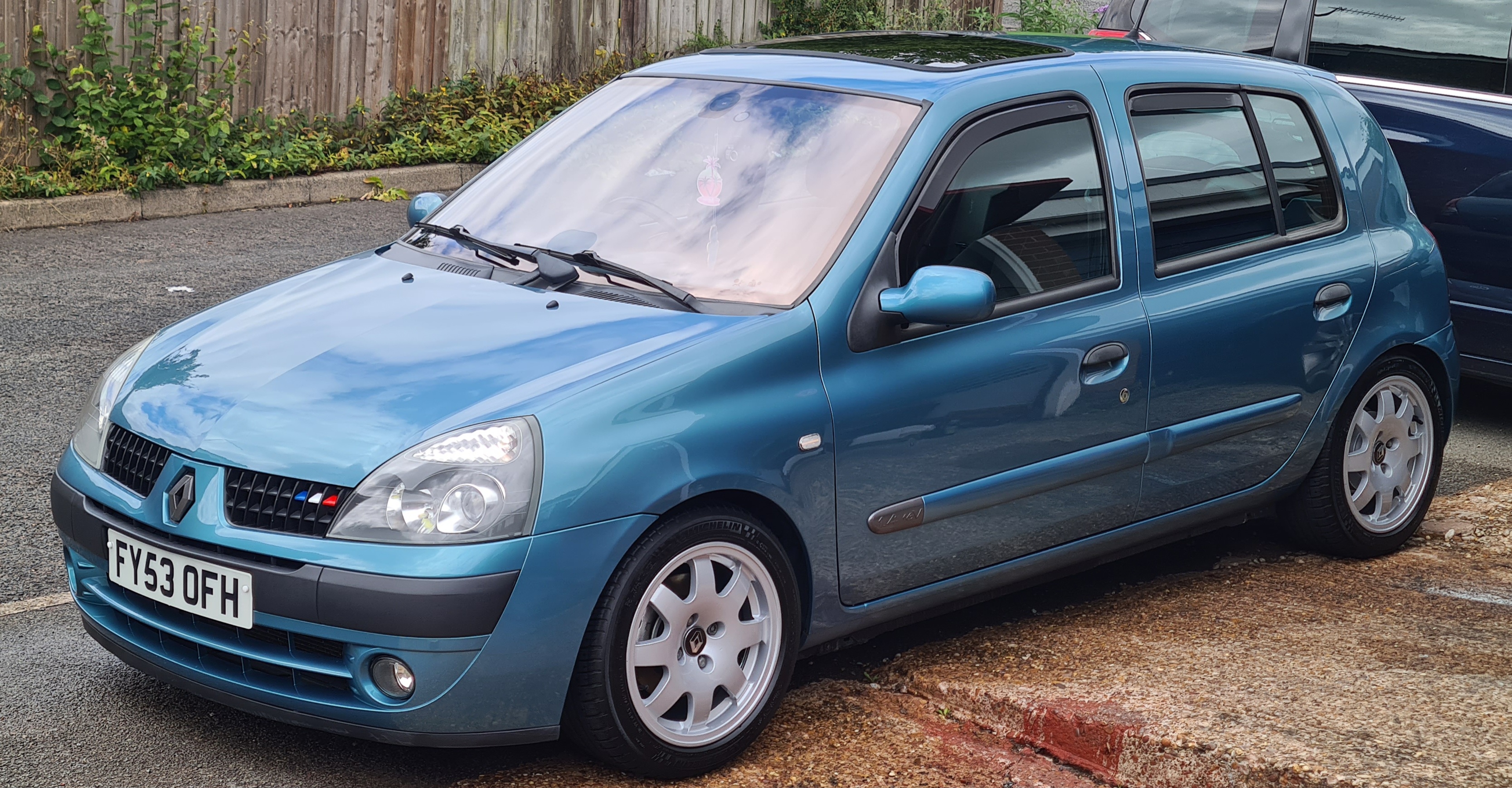

I knew it had a couple of snapped springs so i ordered a set of AMAX 35mm lowering springs which were only £69 for all for brand new on ebay.
I will be updating this thread on works that i will be doing over the coming months.

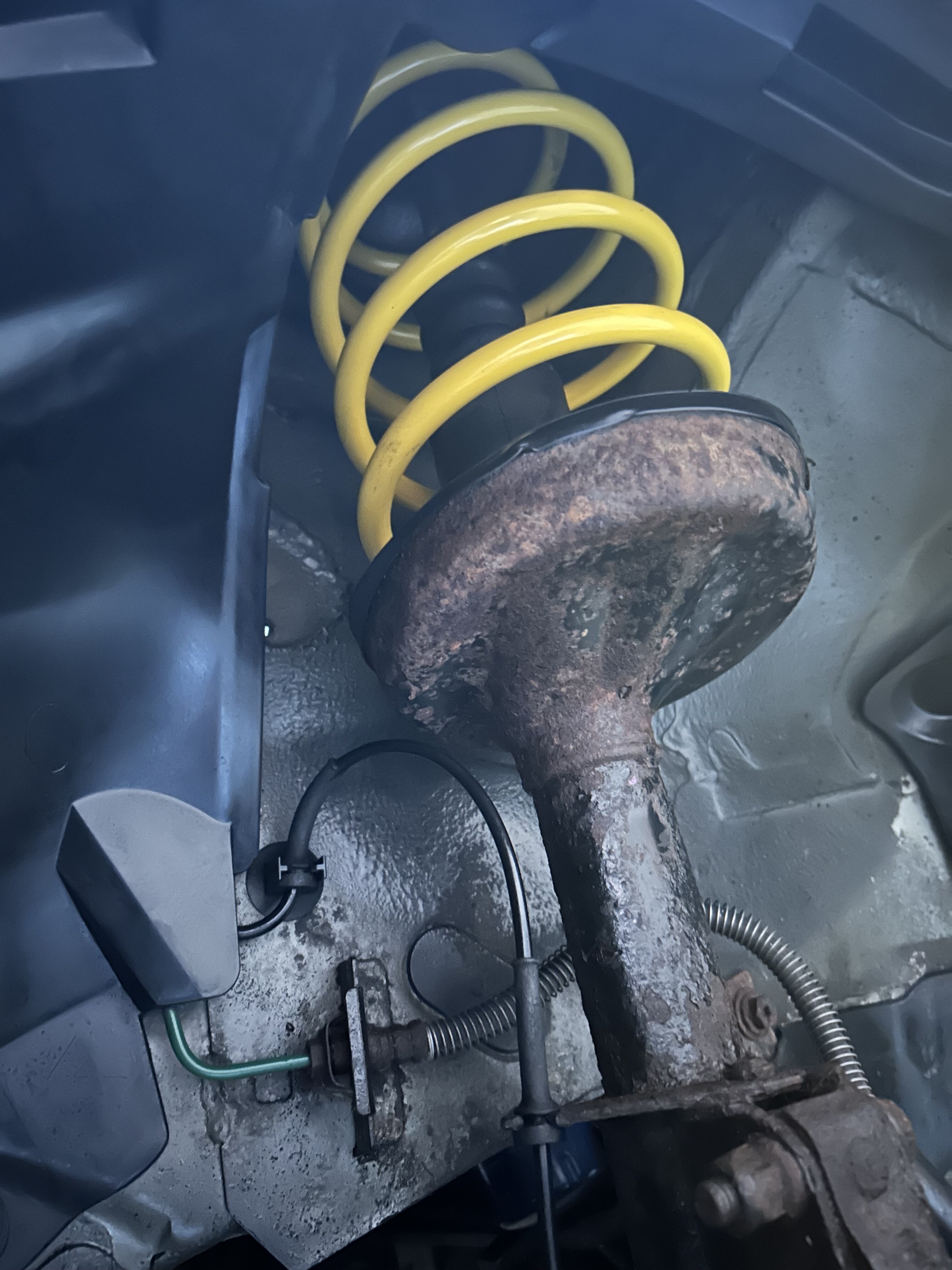

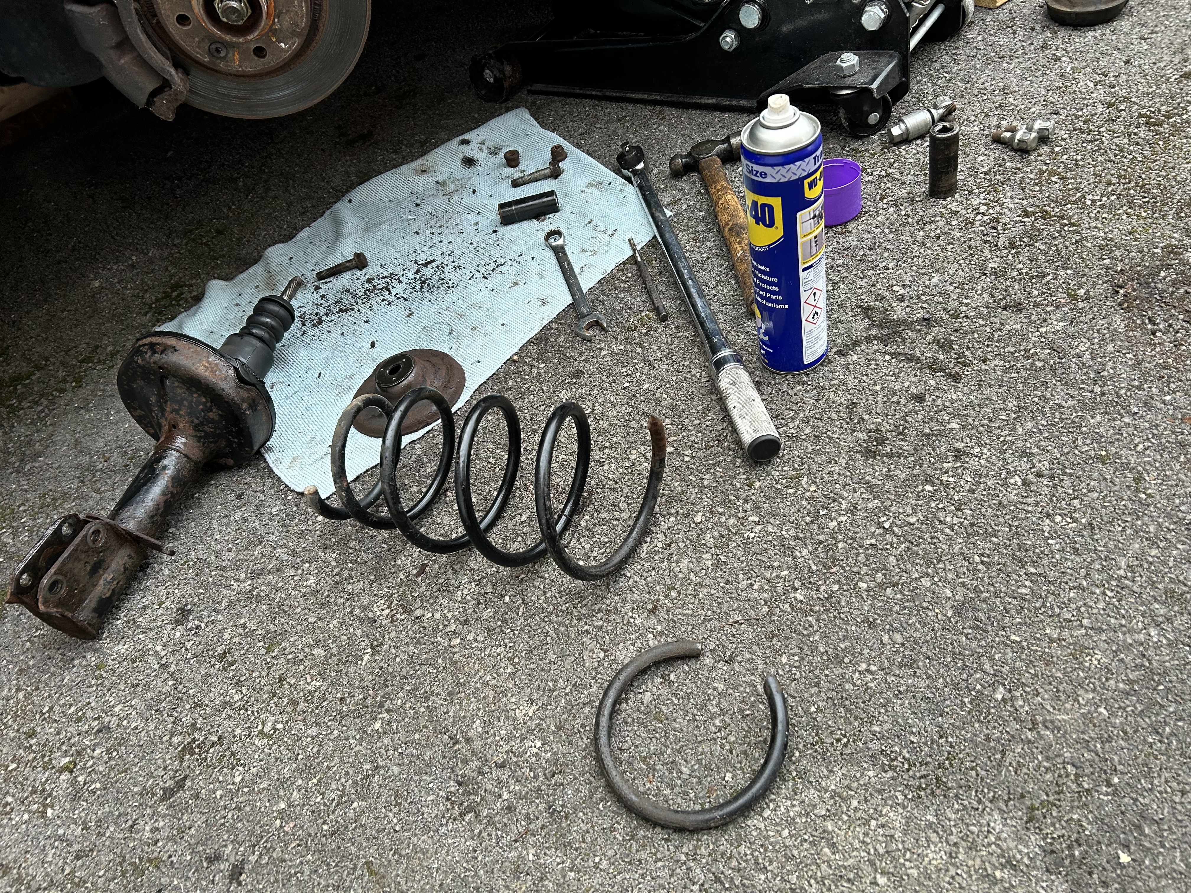

Onto replacing the springs, ended up finding 3 broken 😂
Probably should’ve replaced the shocks and top mounts but it will be fine for now, no play in the mounts and no leaks from the shocks.

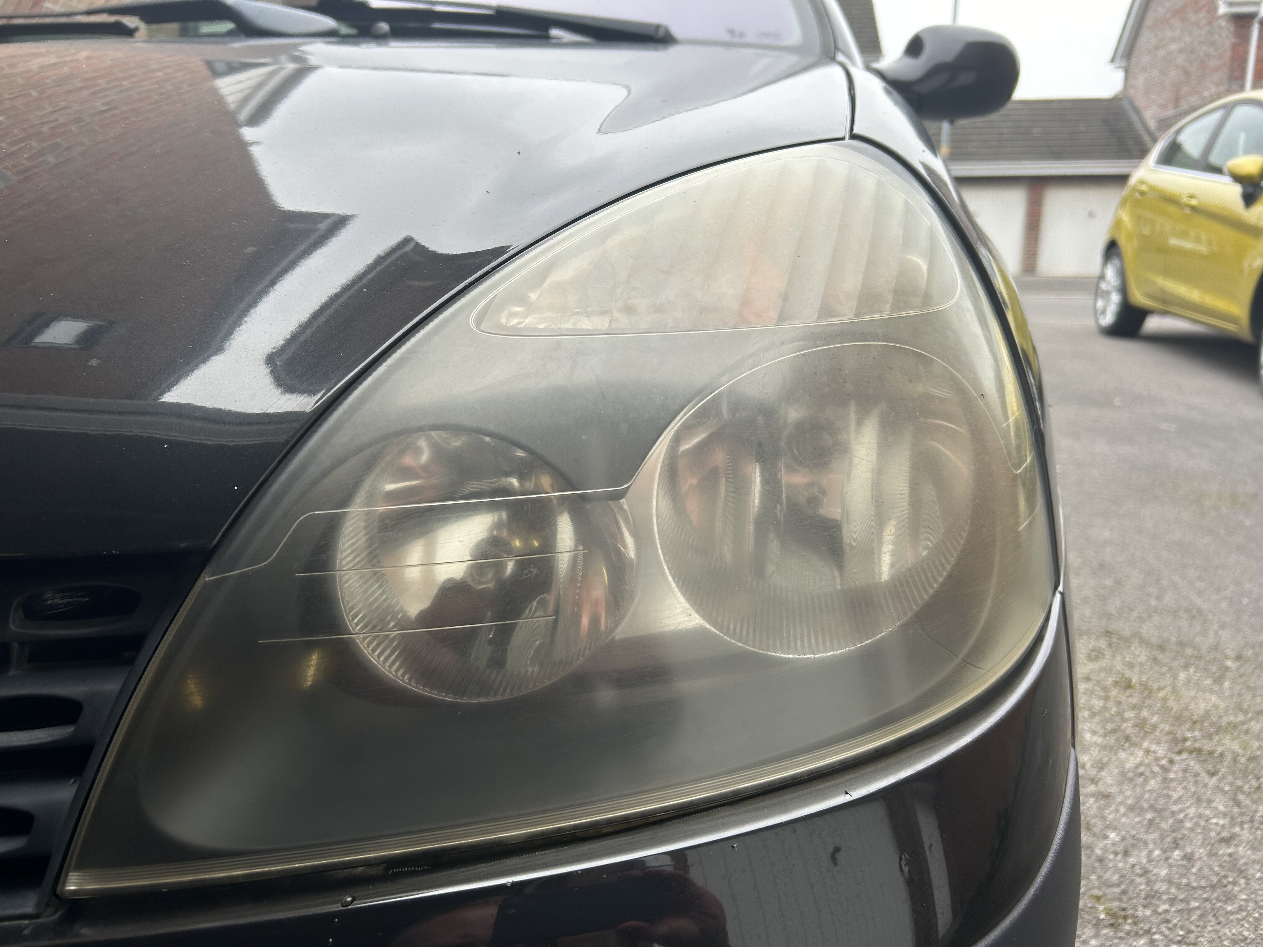

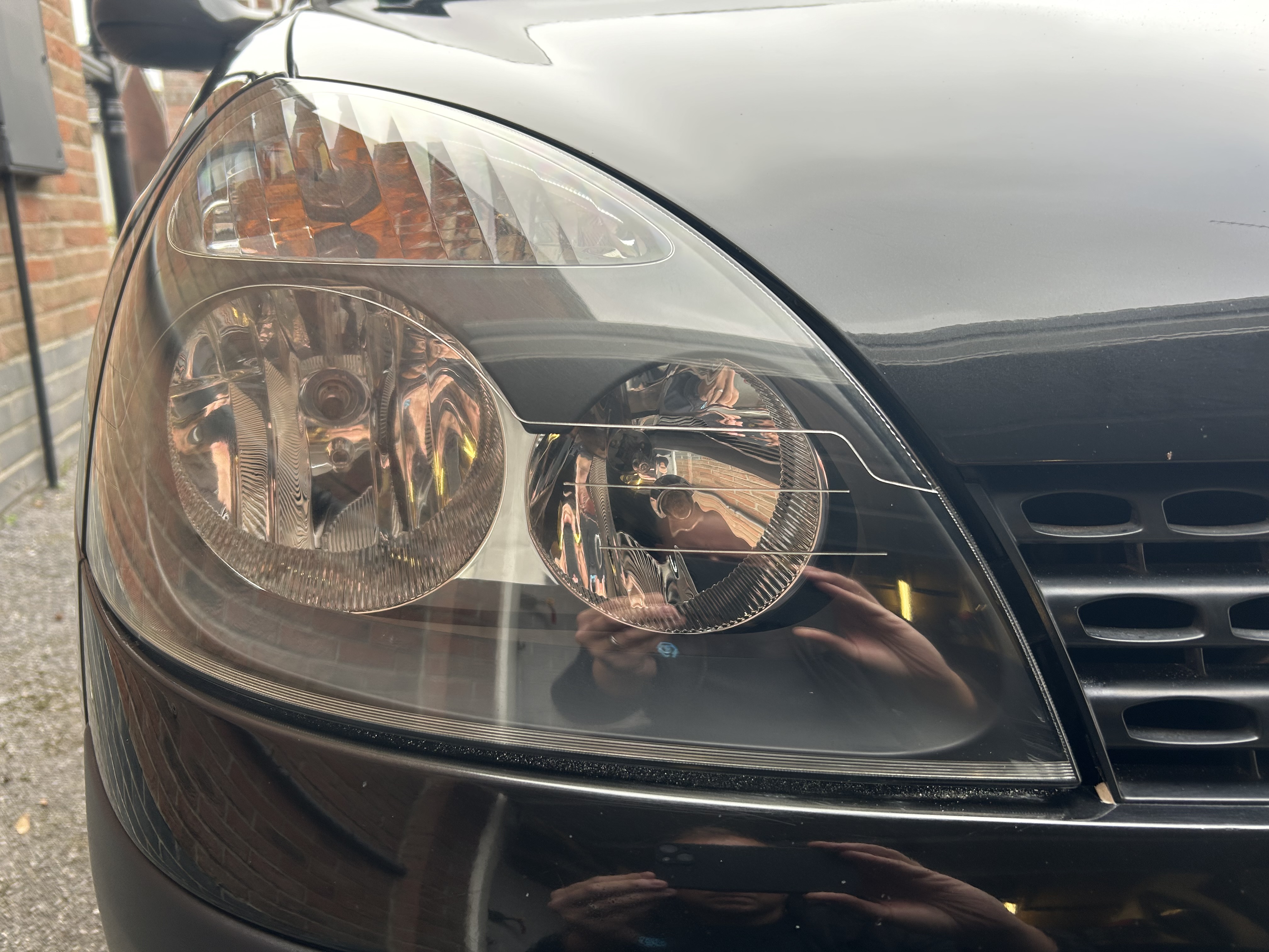

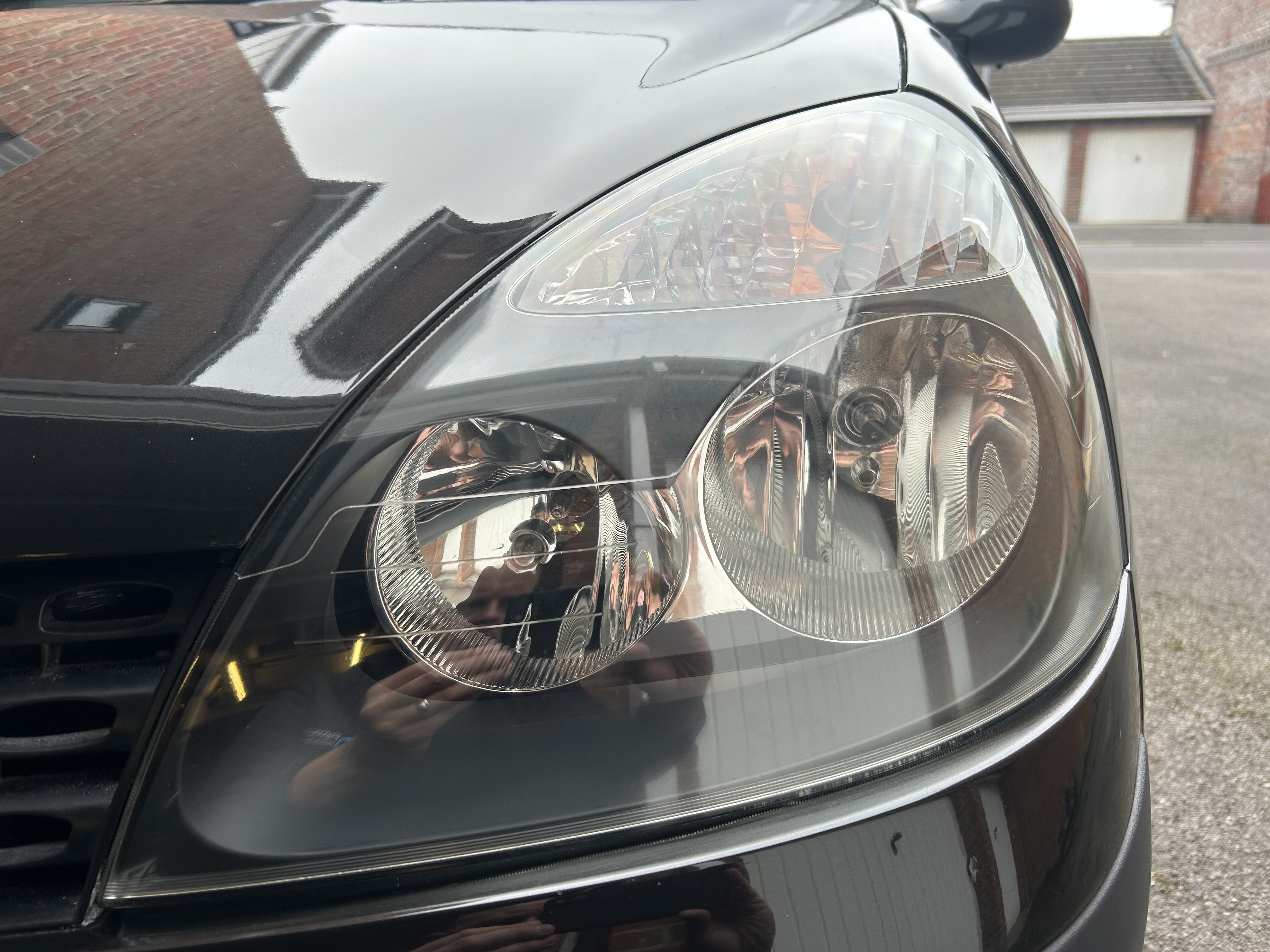

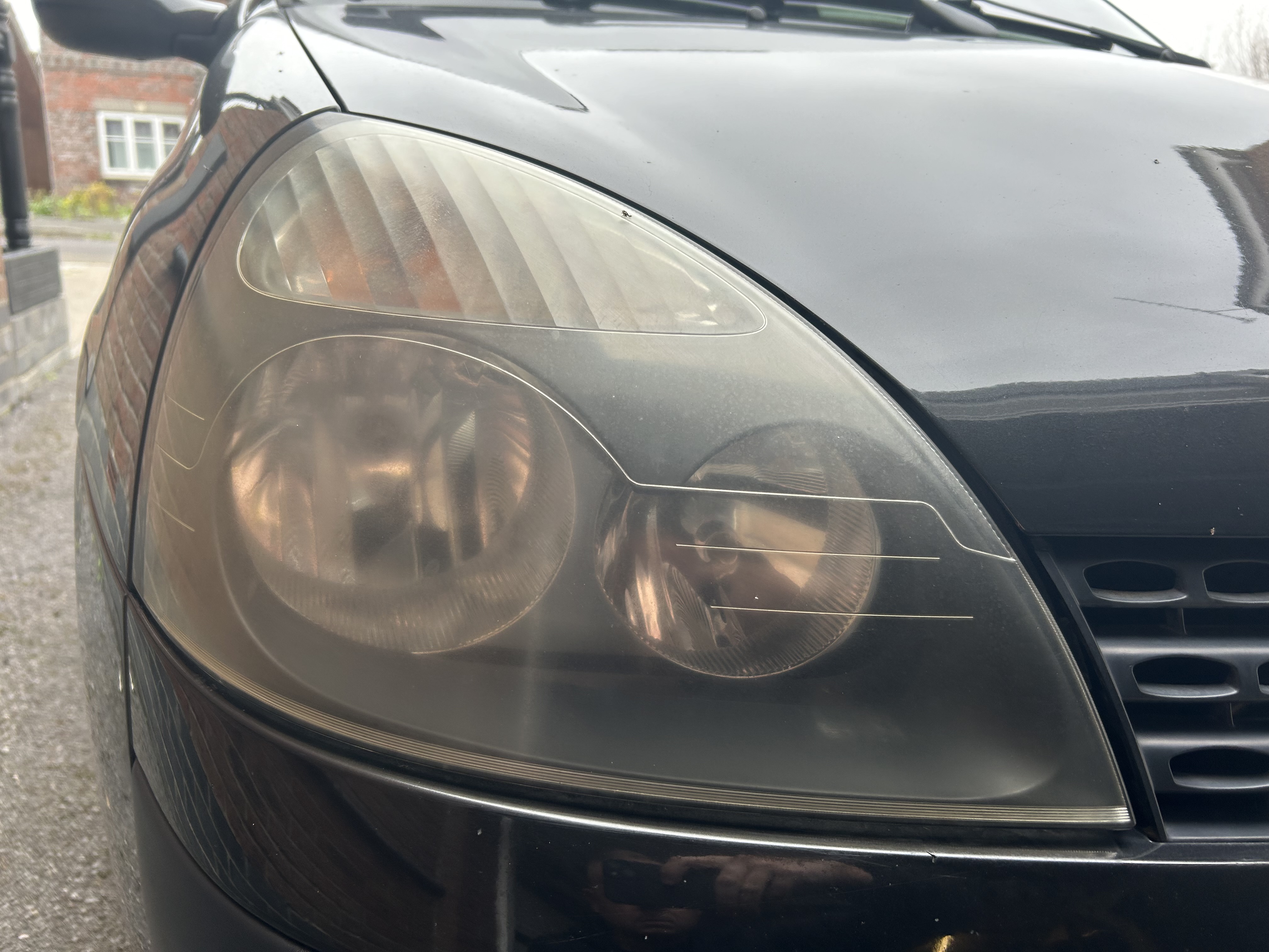

Looks clean @Alastair, headlights came out great.. mind me asking what process & steps you used to clean em up? Inspired me to do mine!

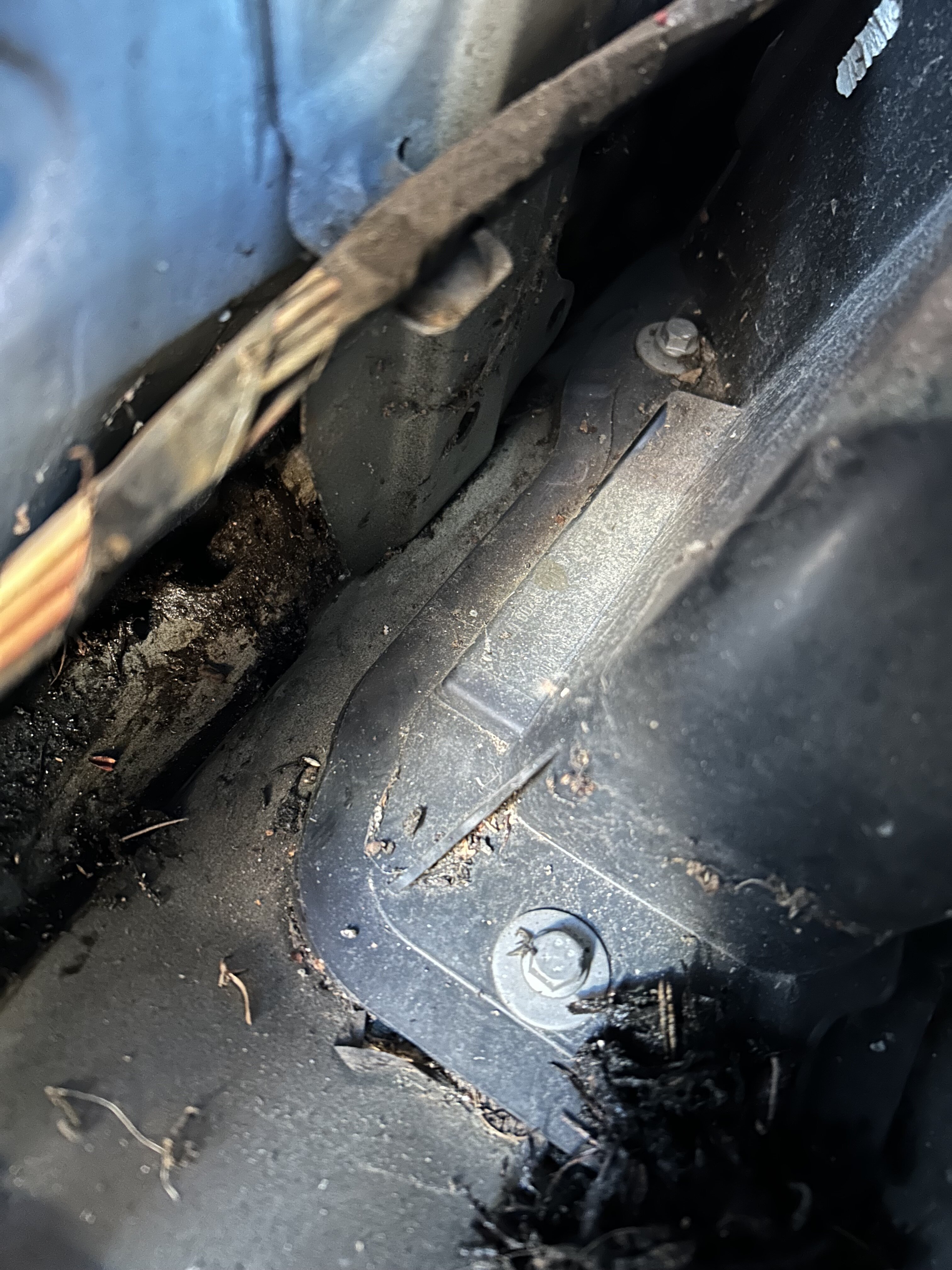

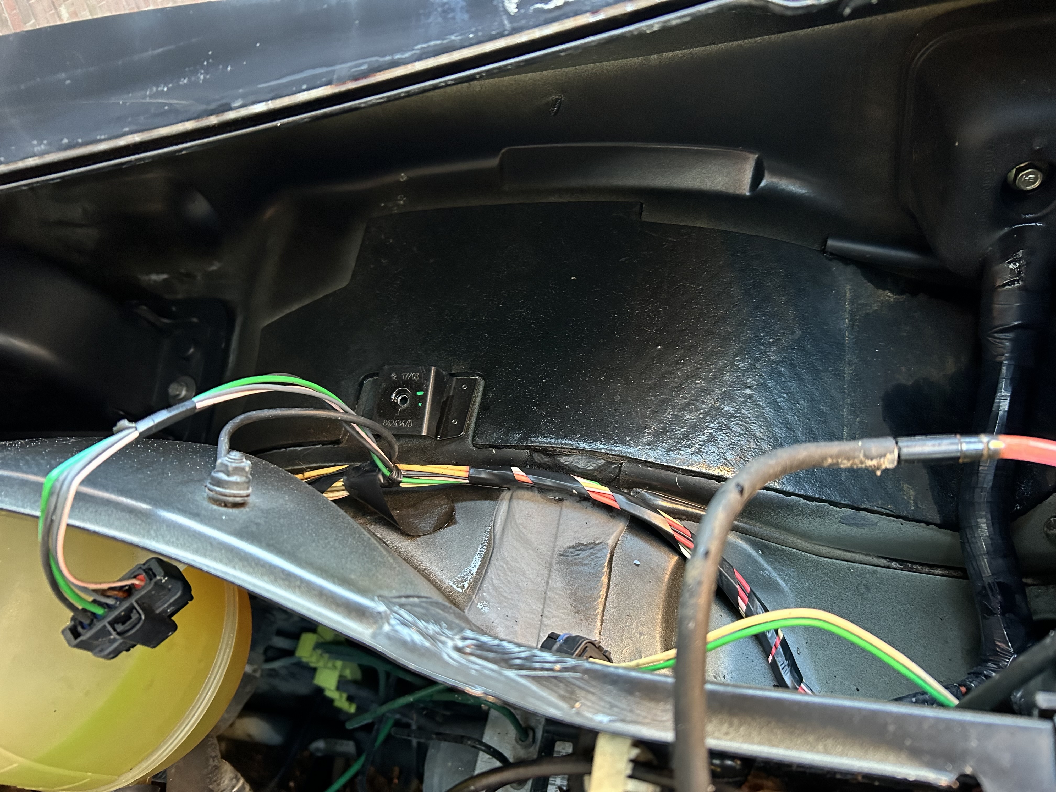

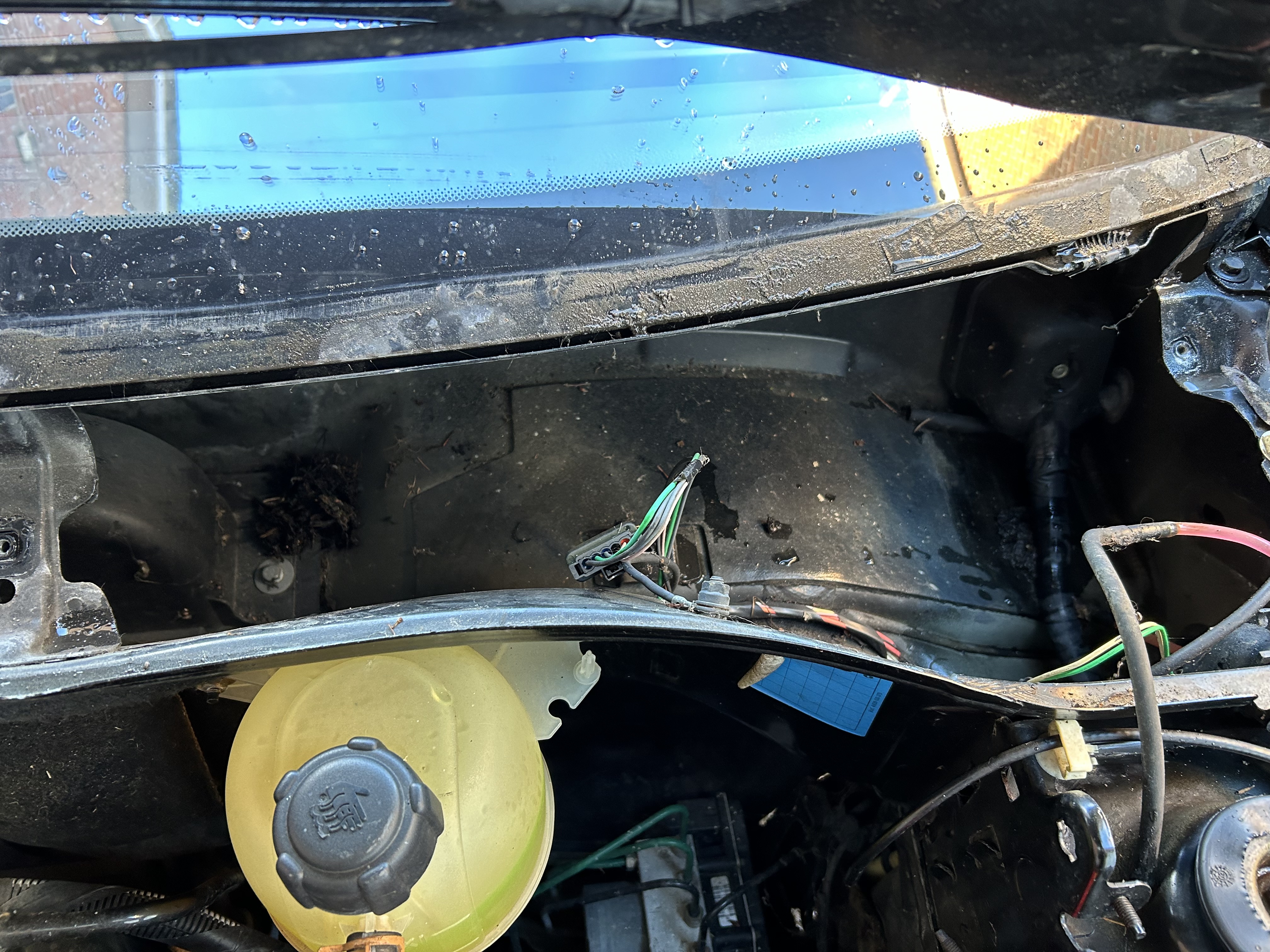

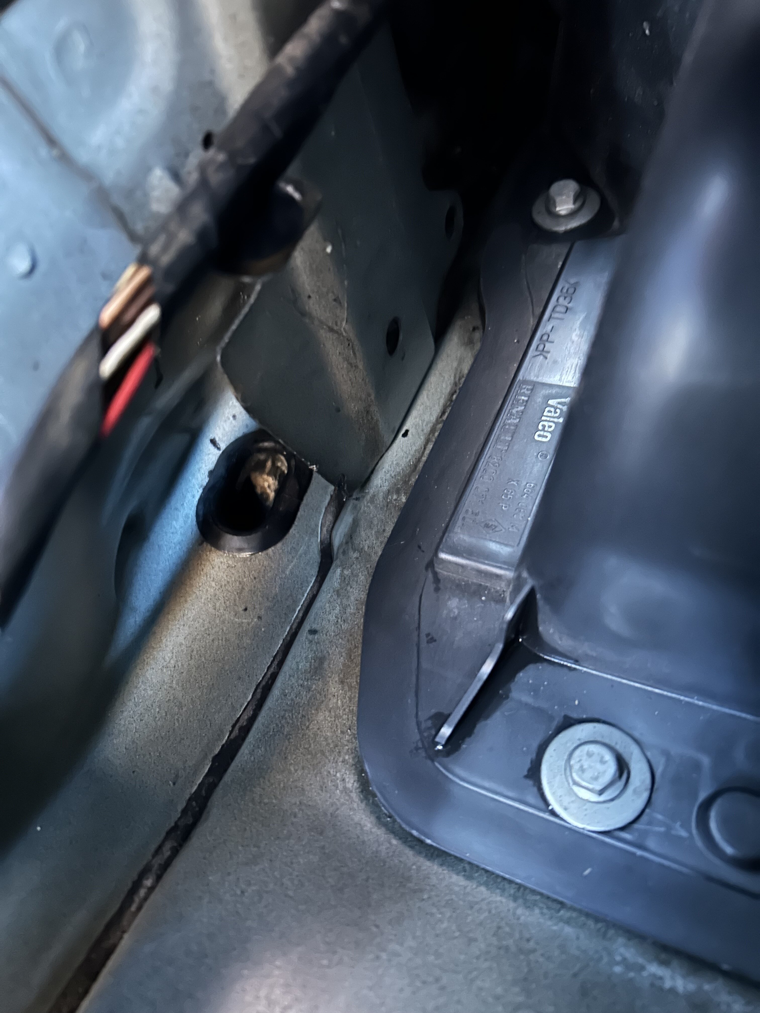

Another little job done, wanted to clear out the centre drain under the scuttle panel so got that sorted.

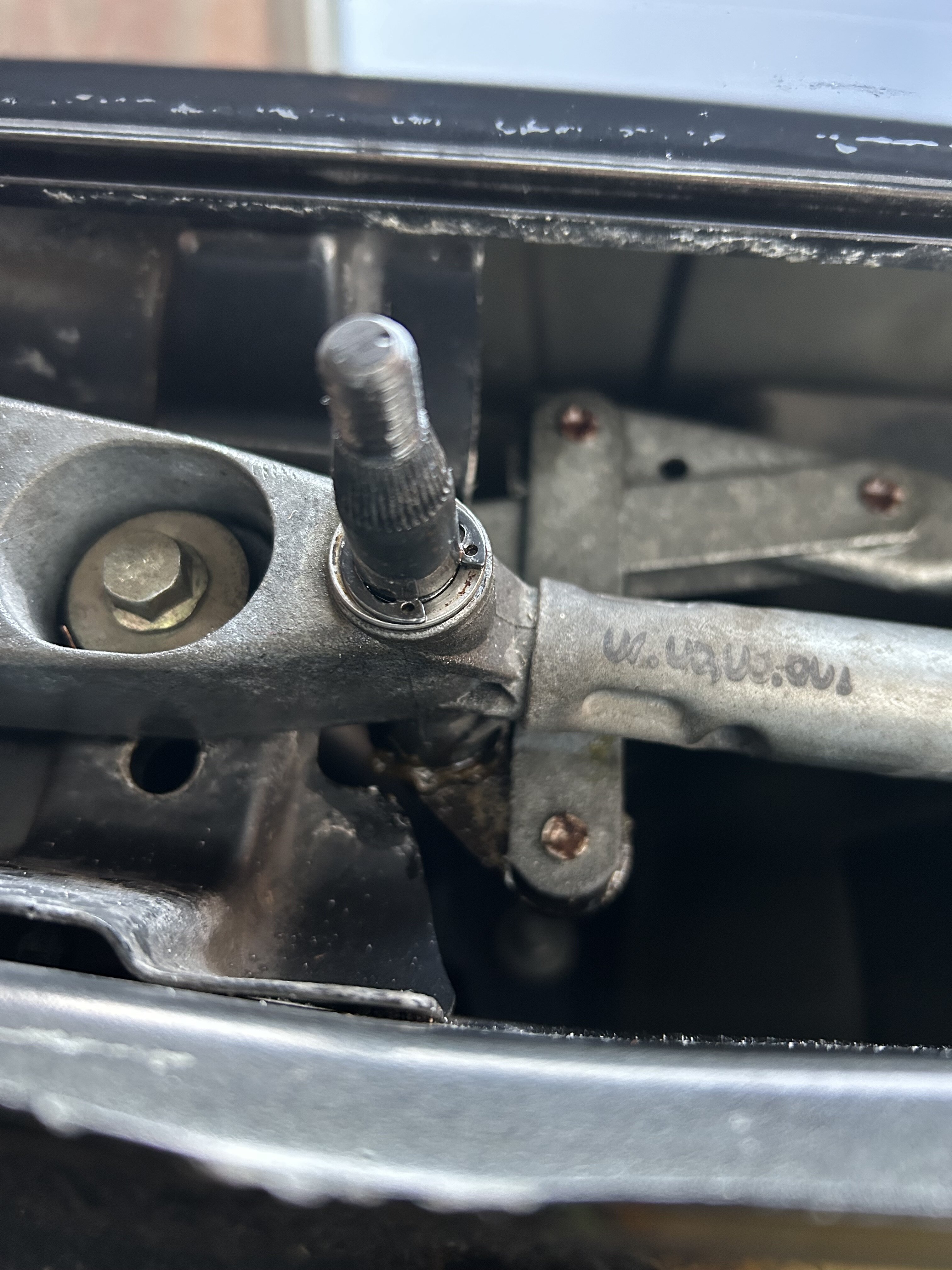

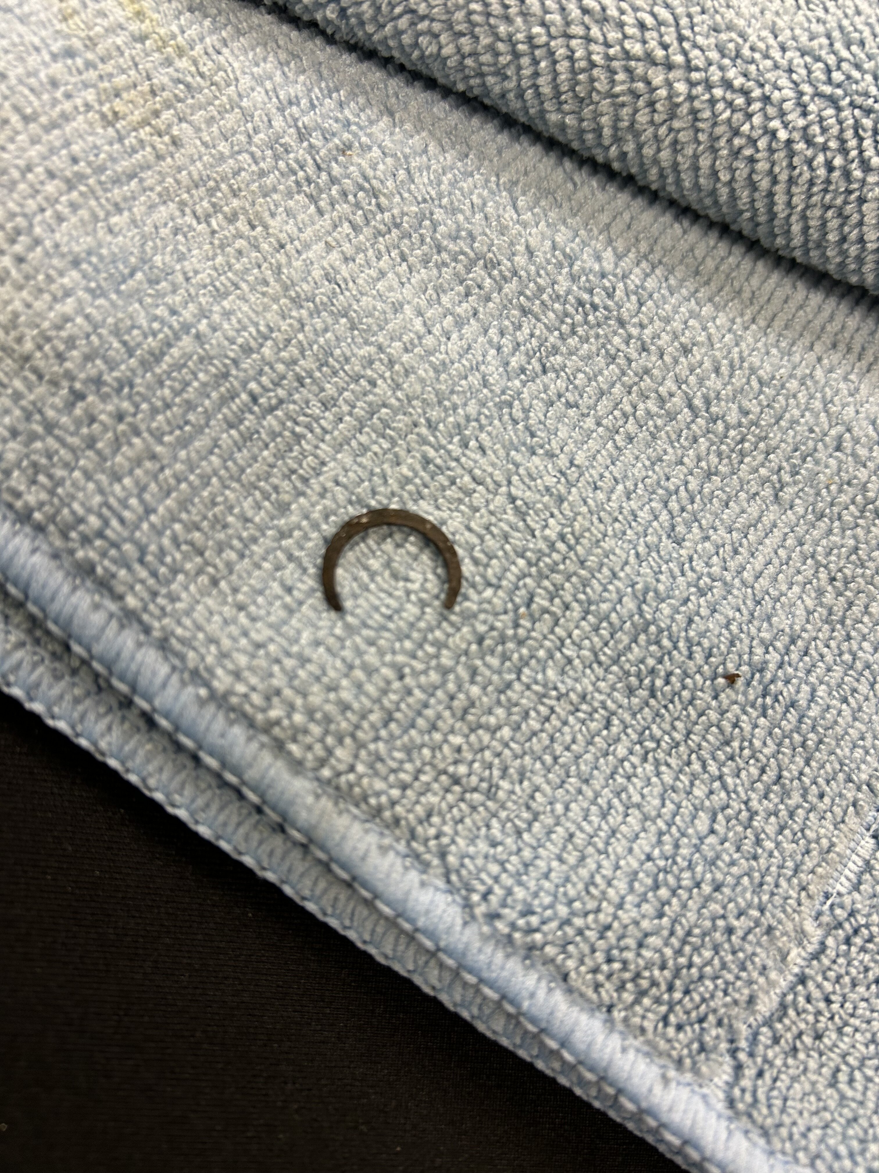

Whilst i was there i noticed the wiper linkage was all floppy, circlip holding it together had almost disintegrated so i replaced it with a new one and greased everything up.
Before, under the scuttle.
After a clean and unblocking the centre drain.
Wiper linkage circlip and then the new one fitted.

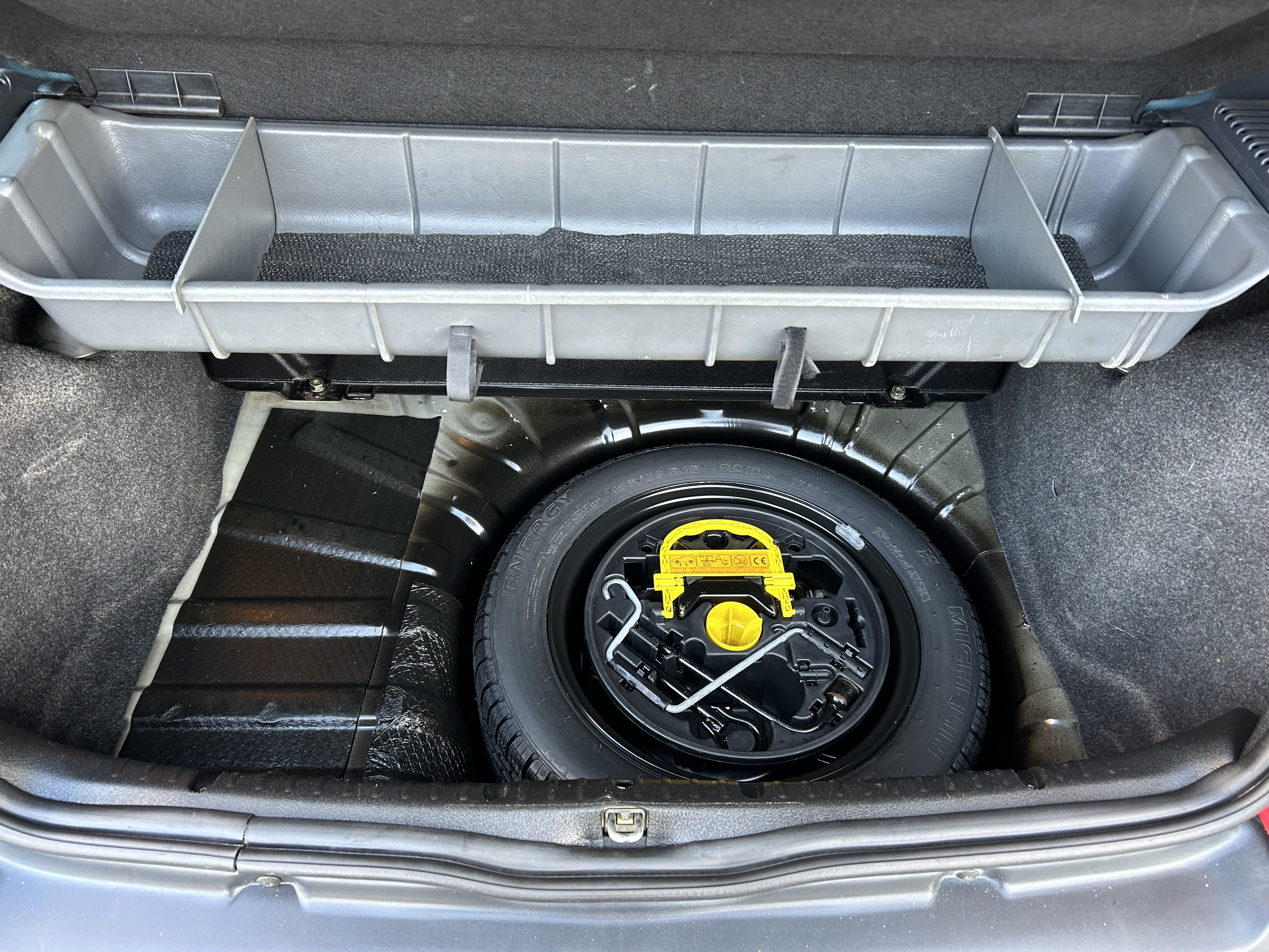

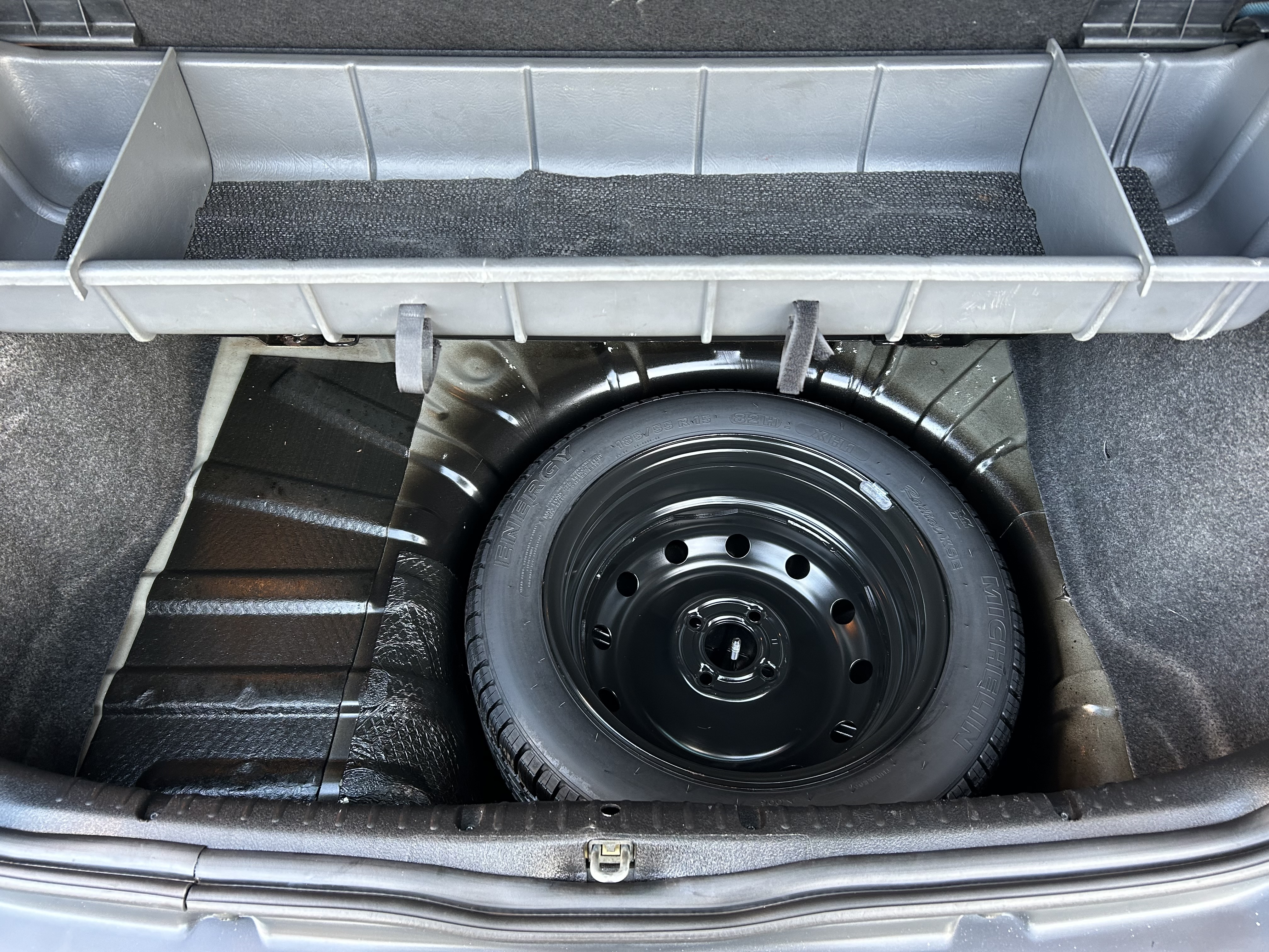

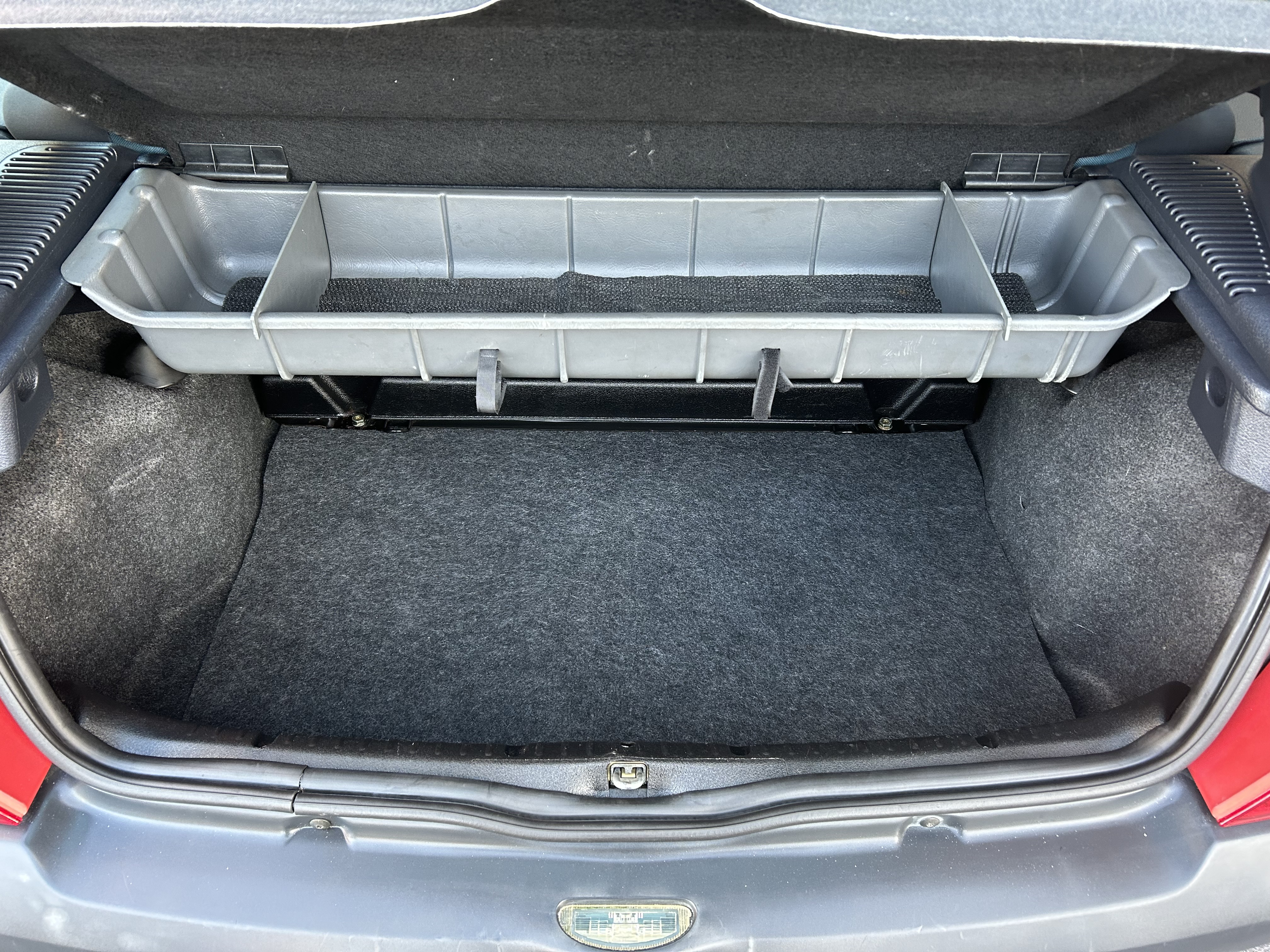

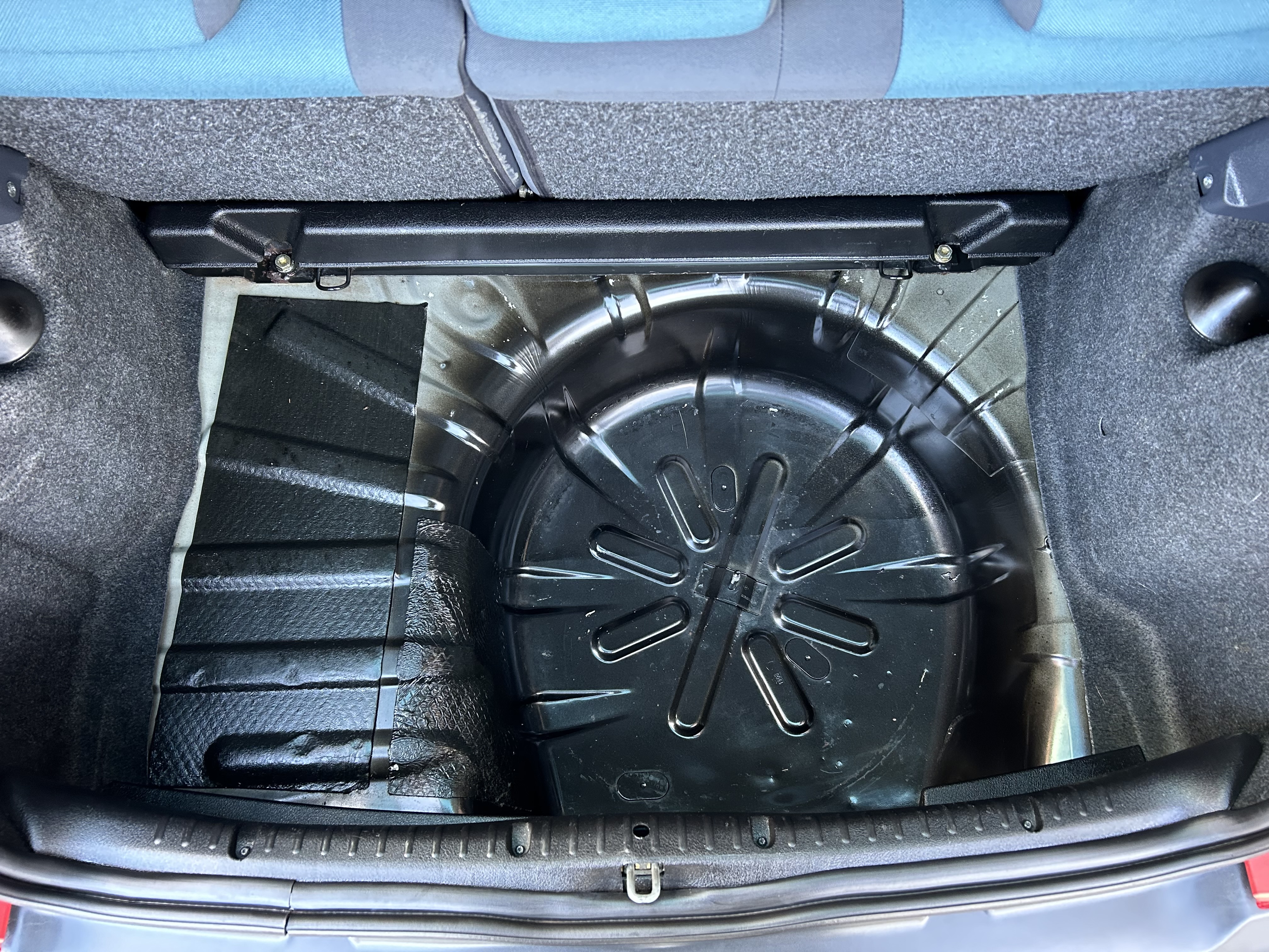

Boot cleaned out inc spare wheel etc.

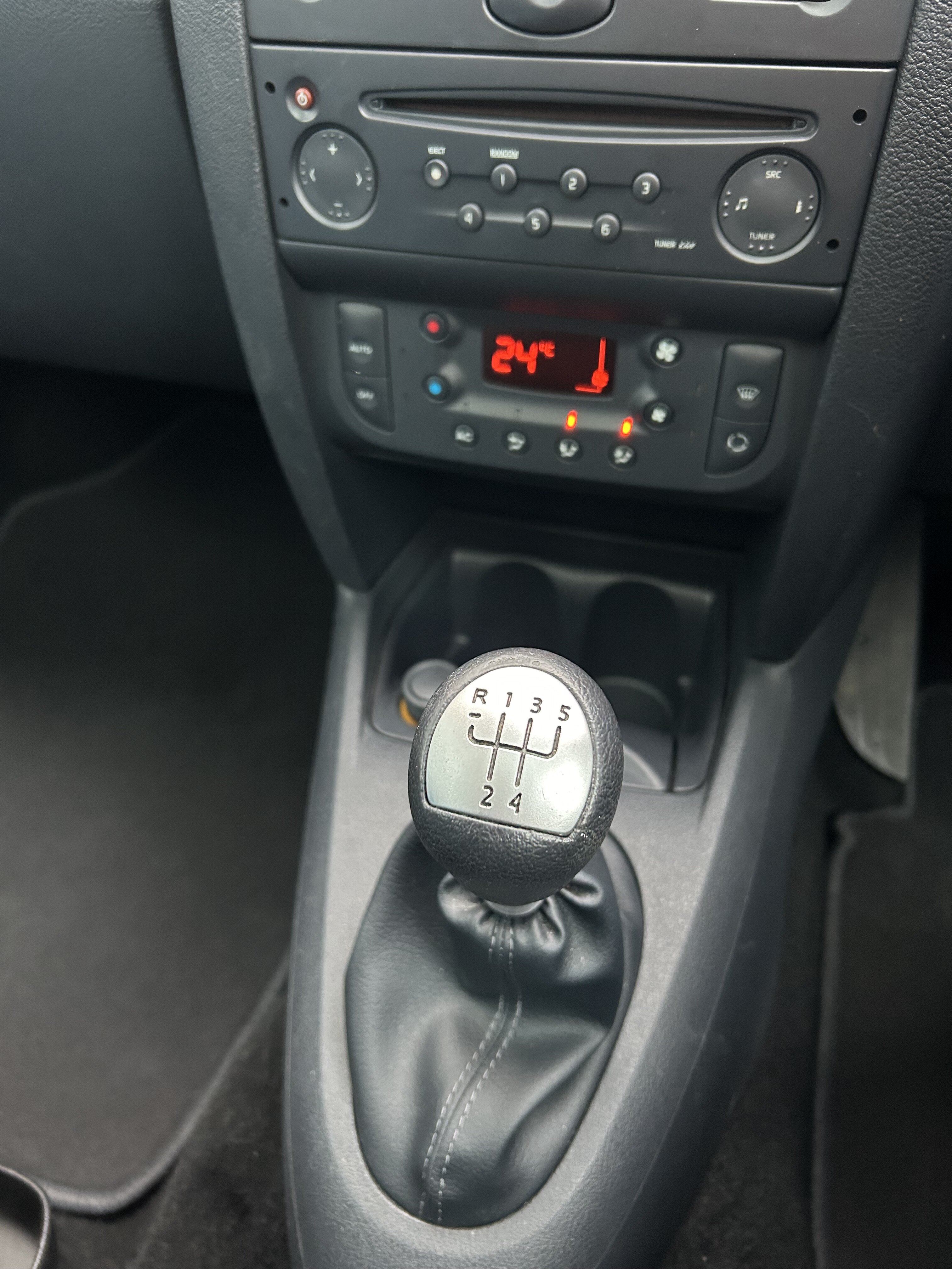

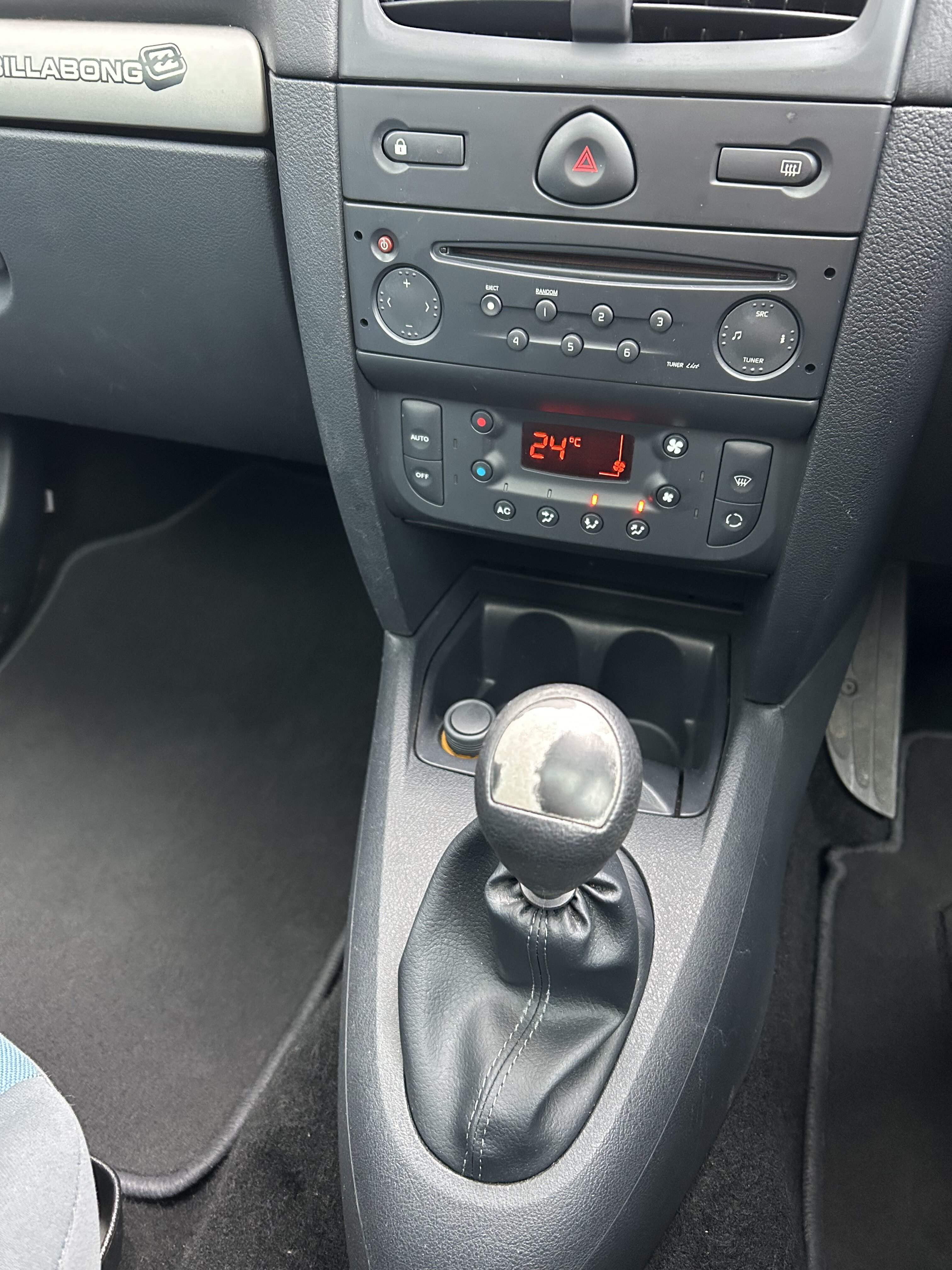

New gear knob insert.

Good work mate, ive got those springs on my RSI, surprisingly good ride quality! i think its better than standard!

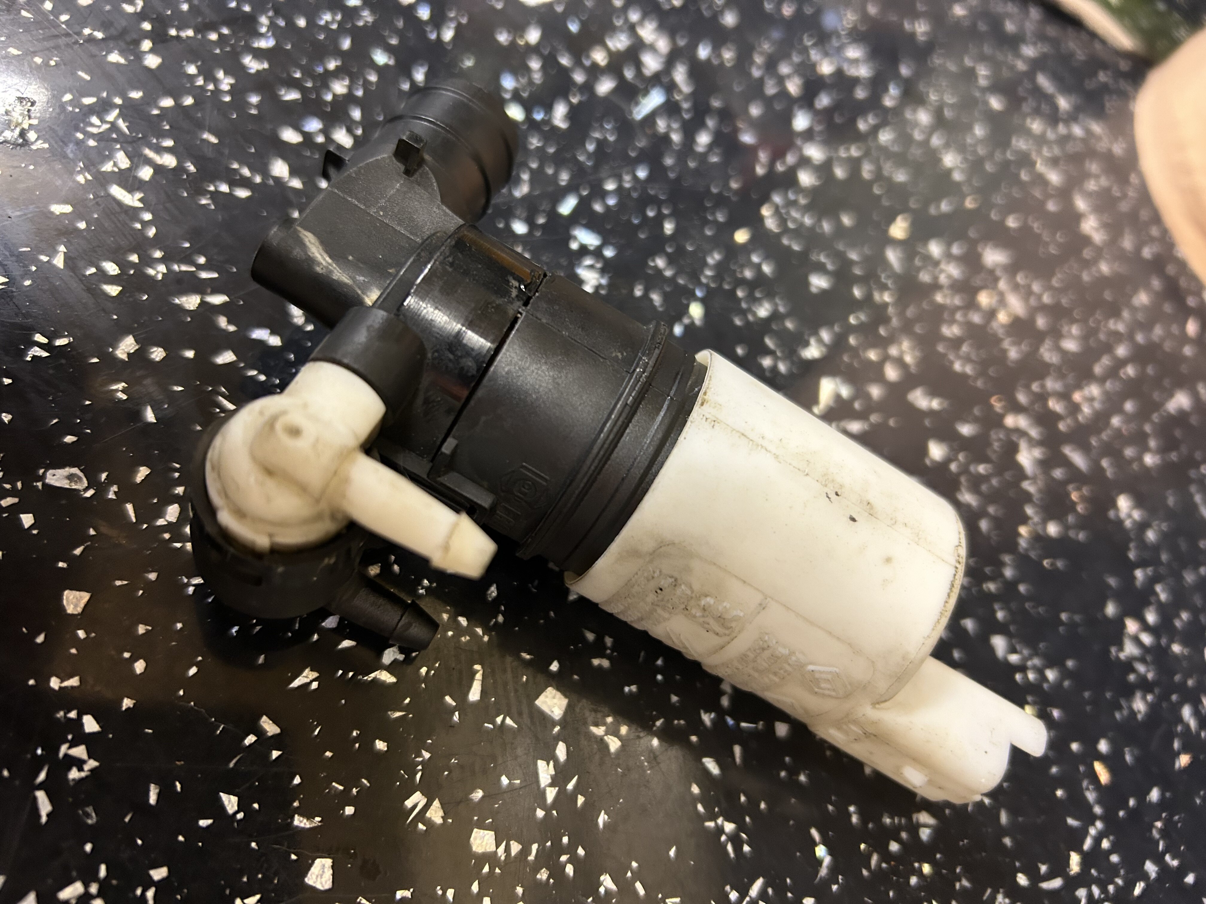

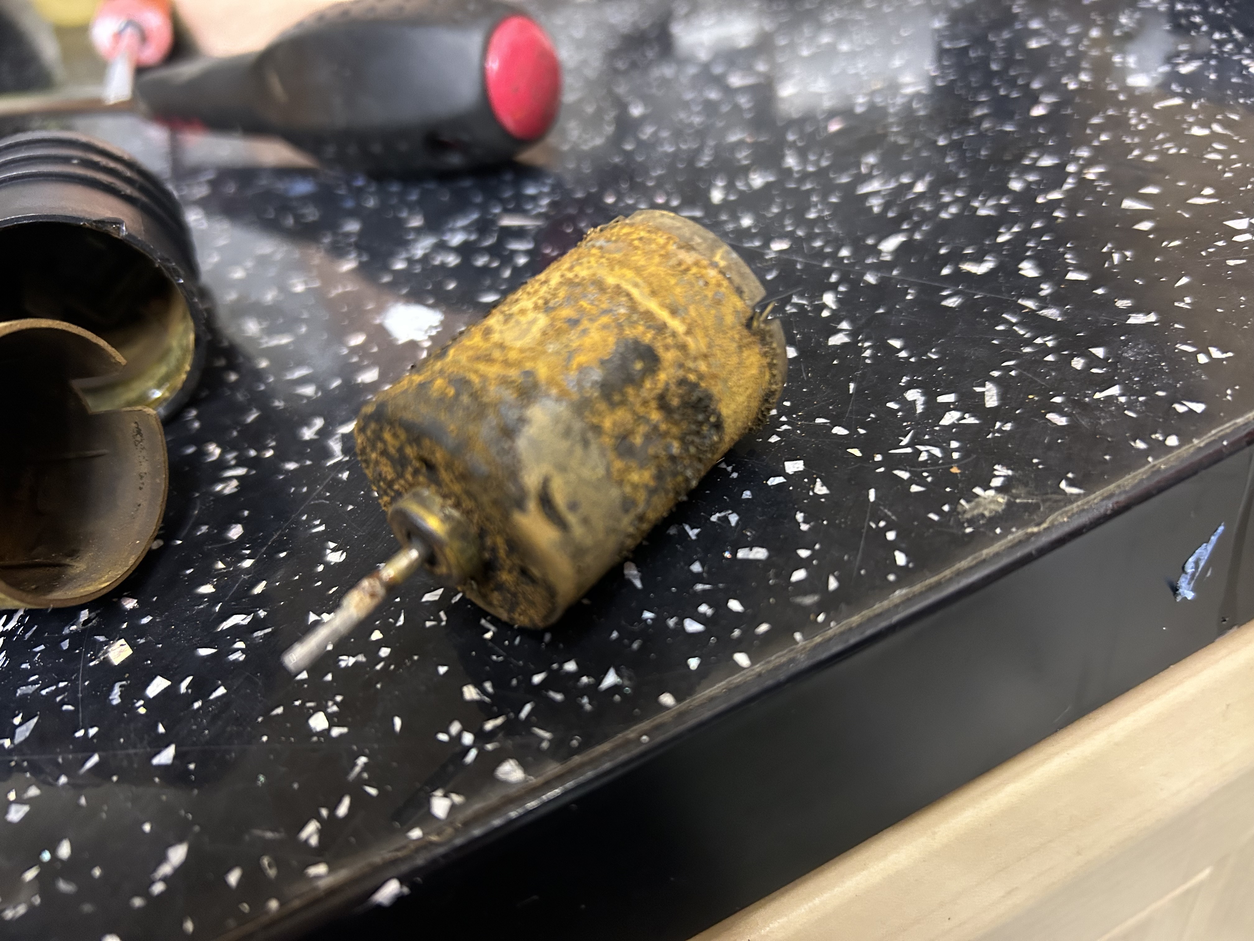

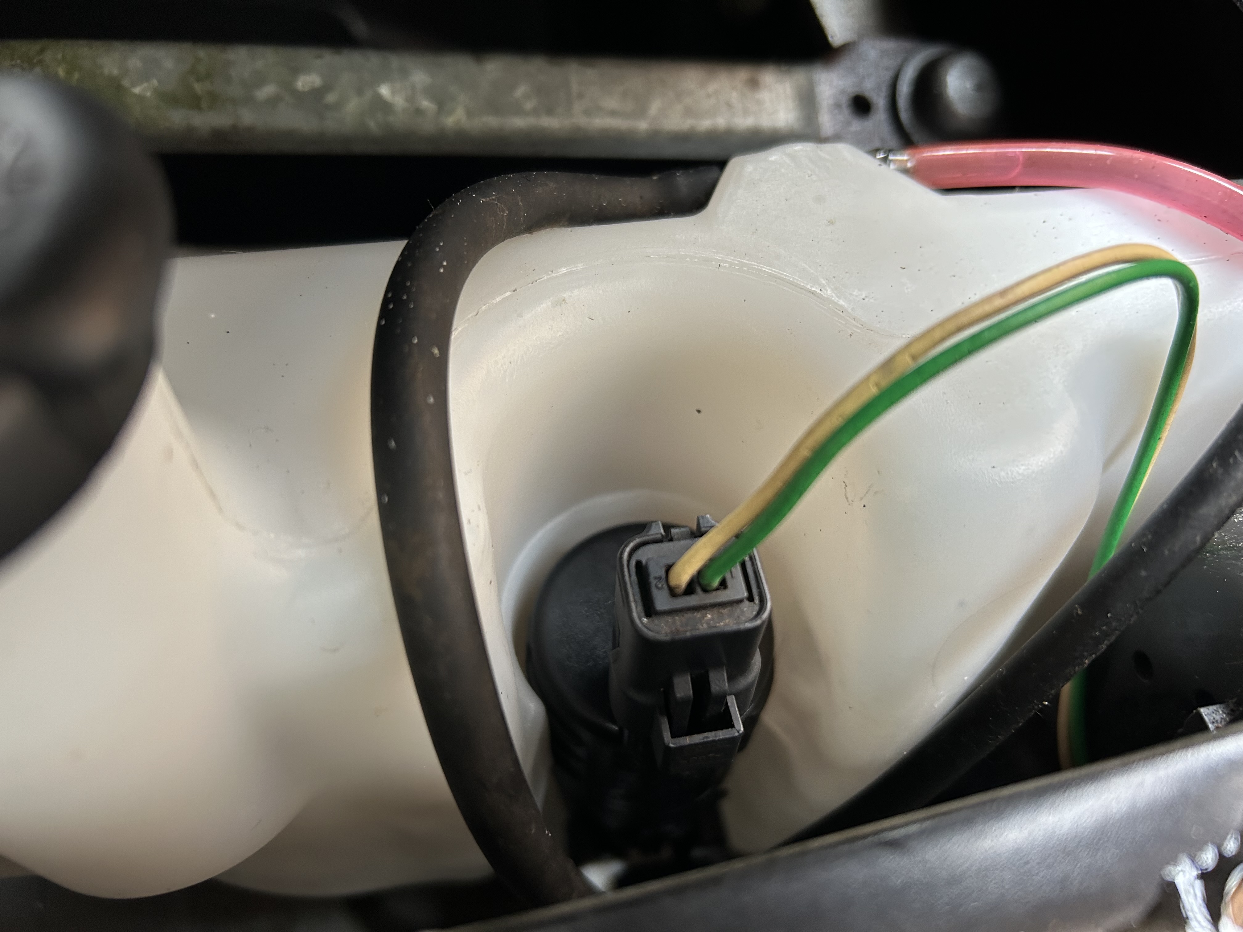

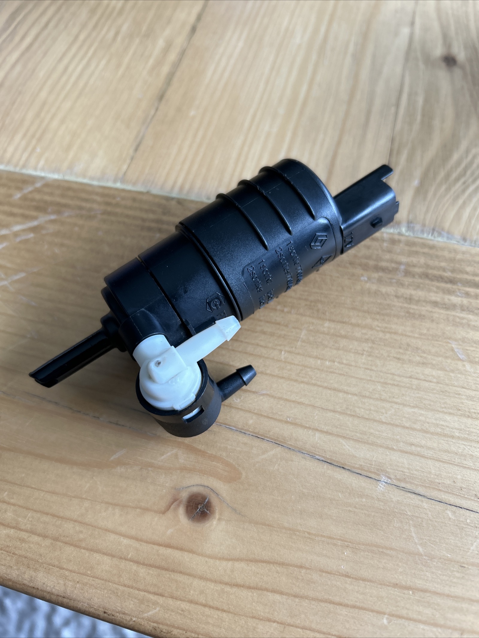

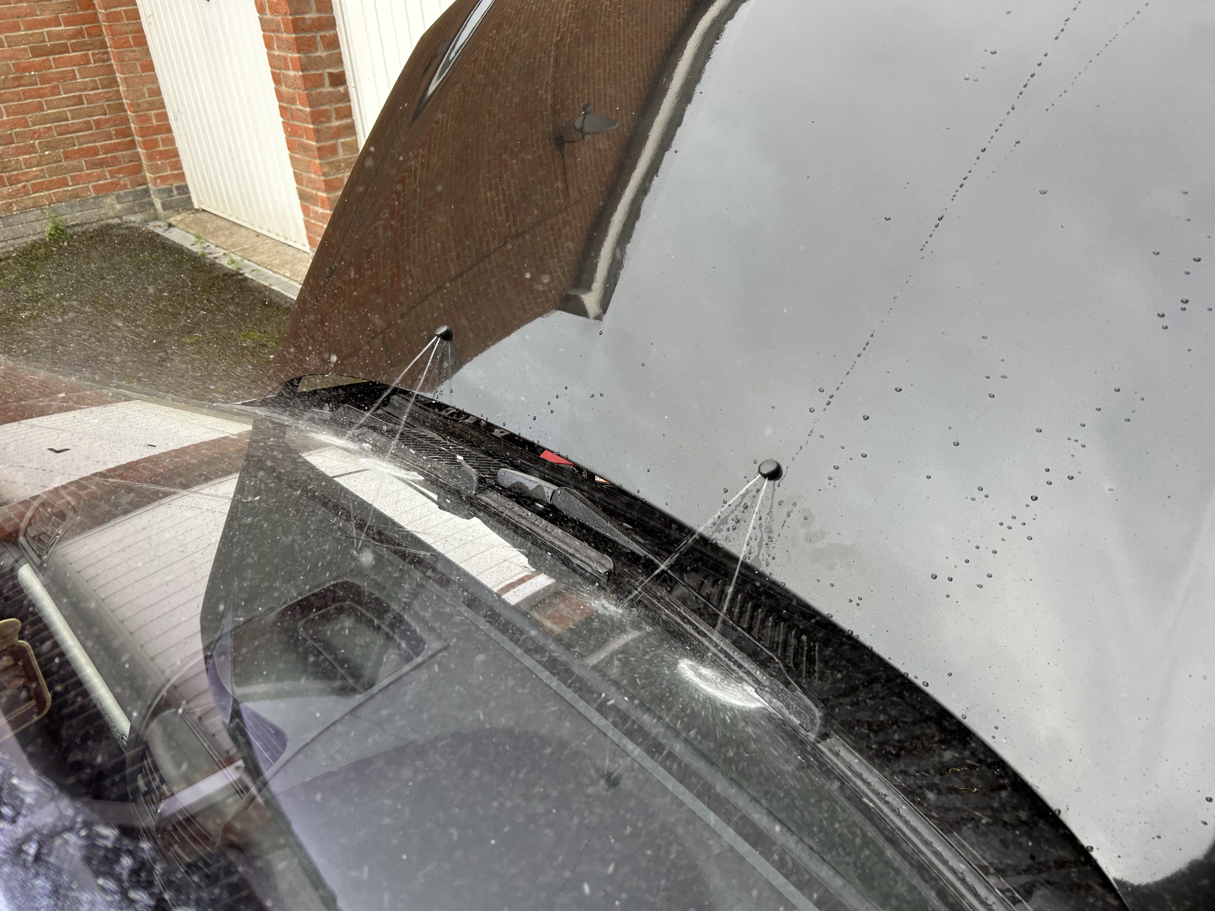

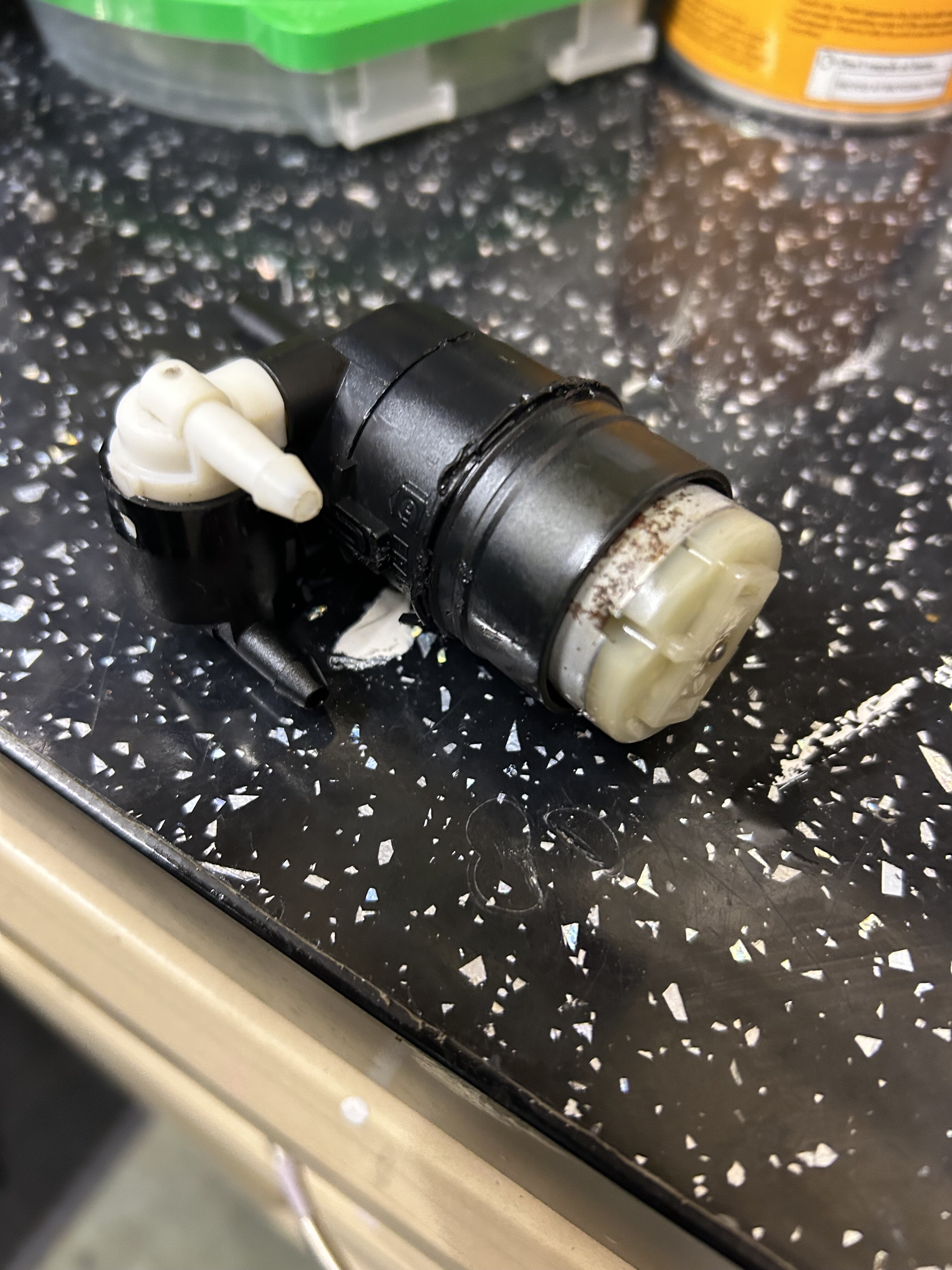

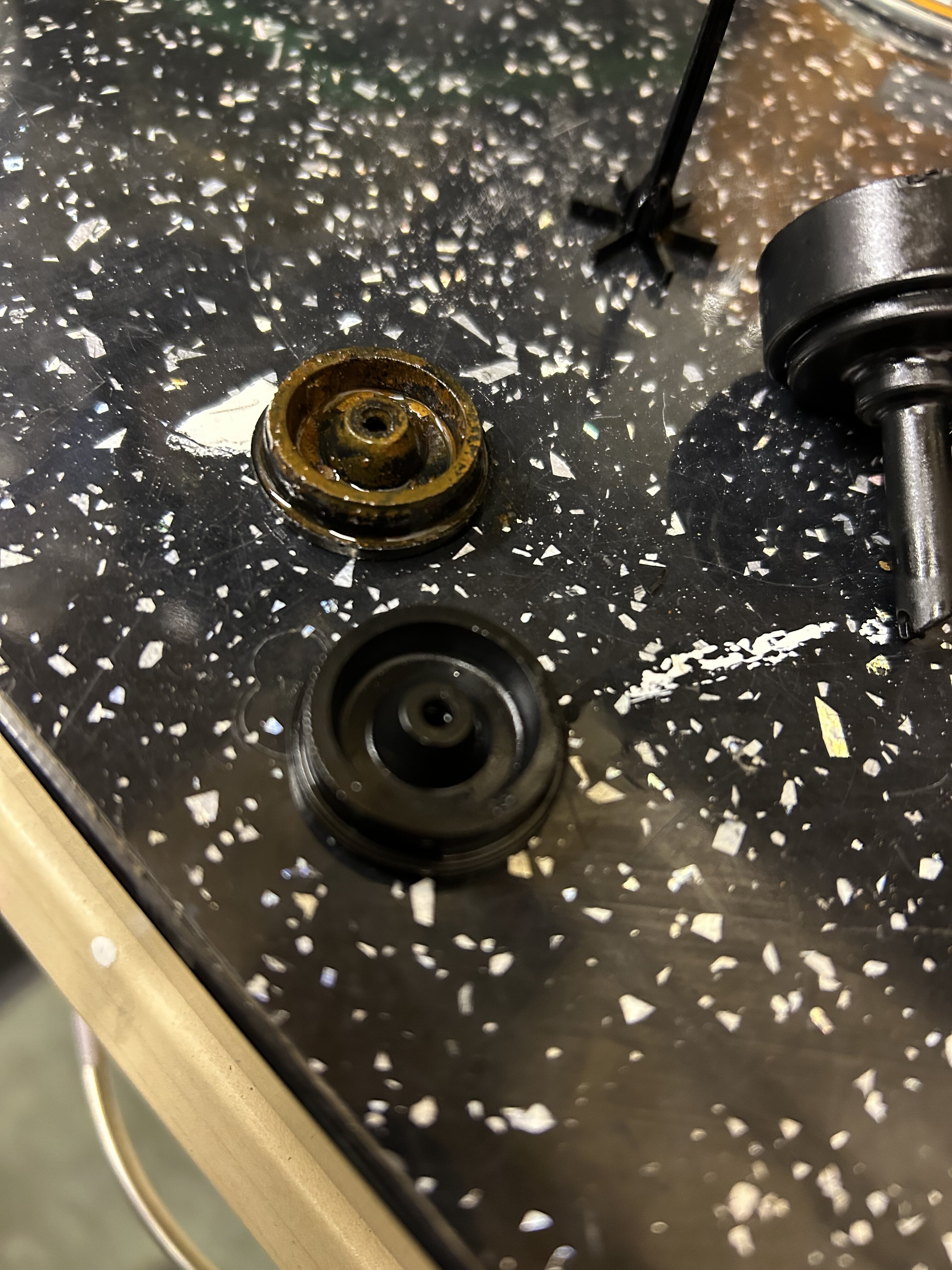

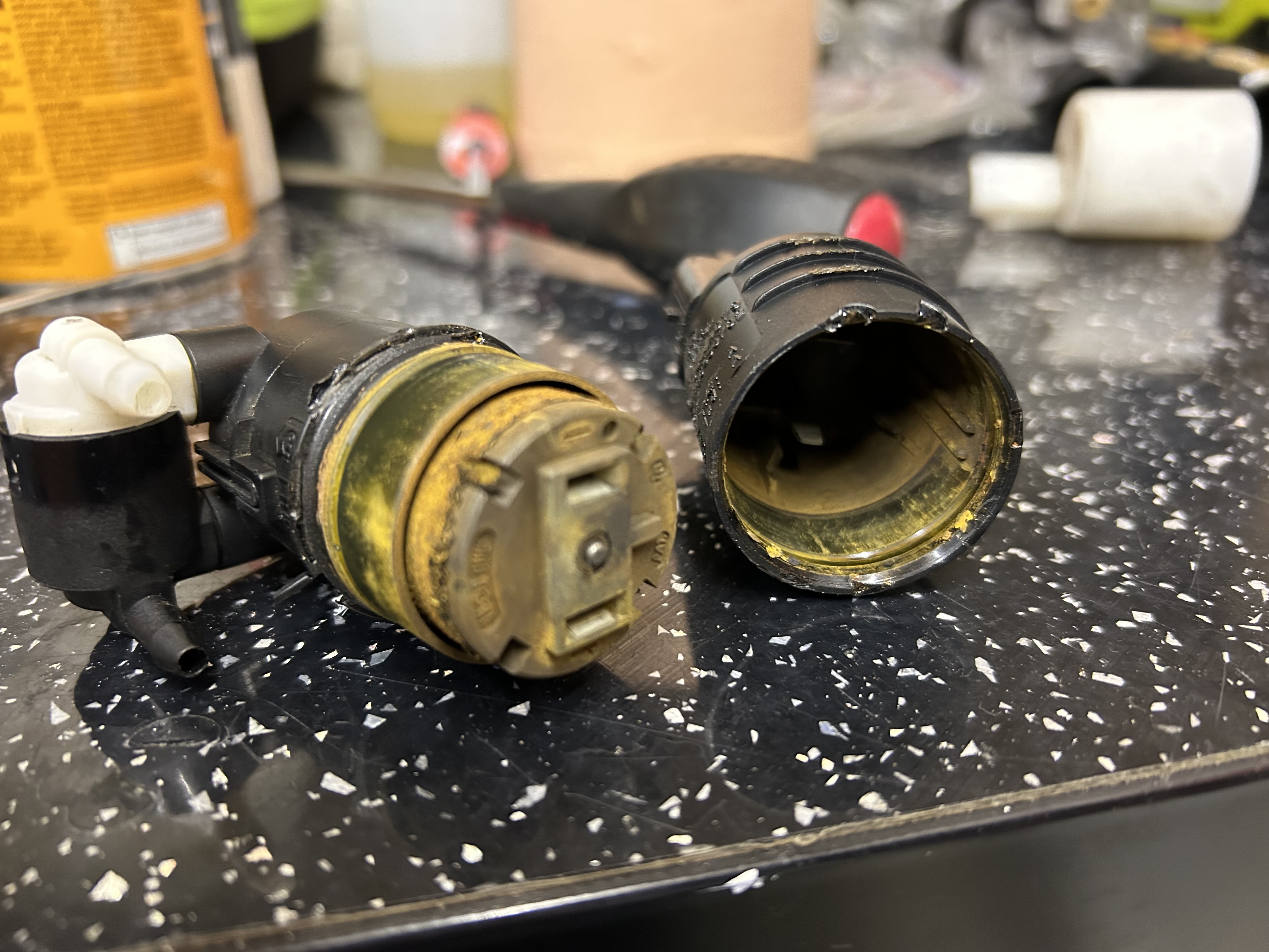

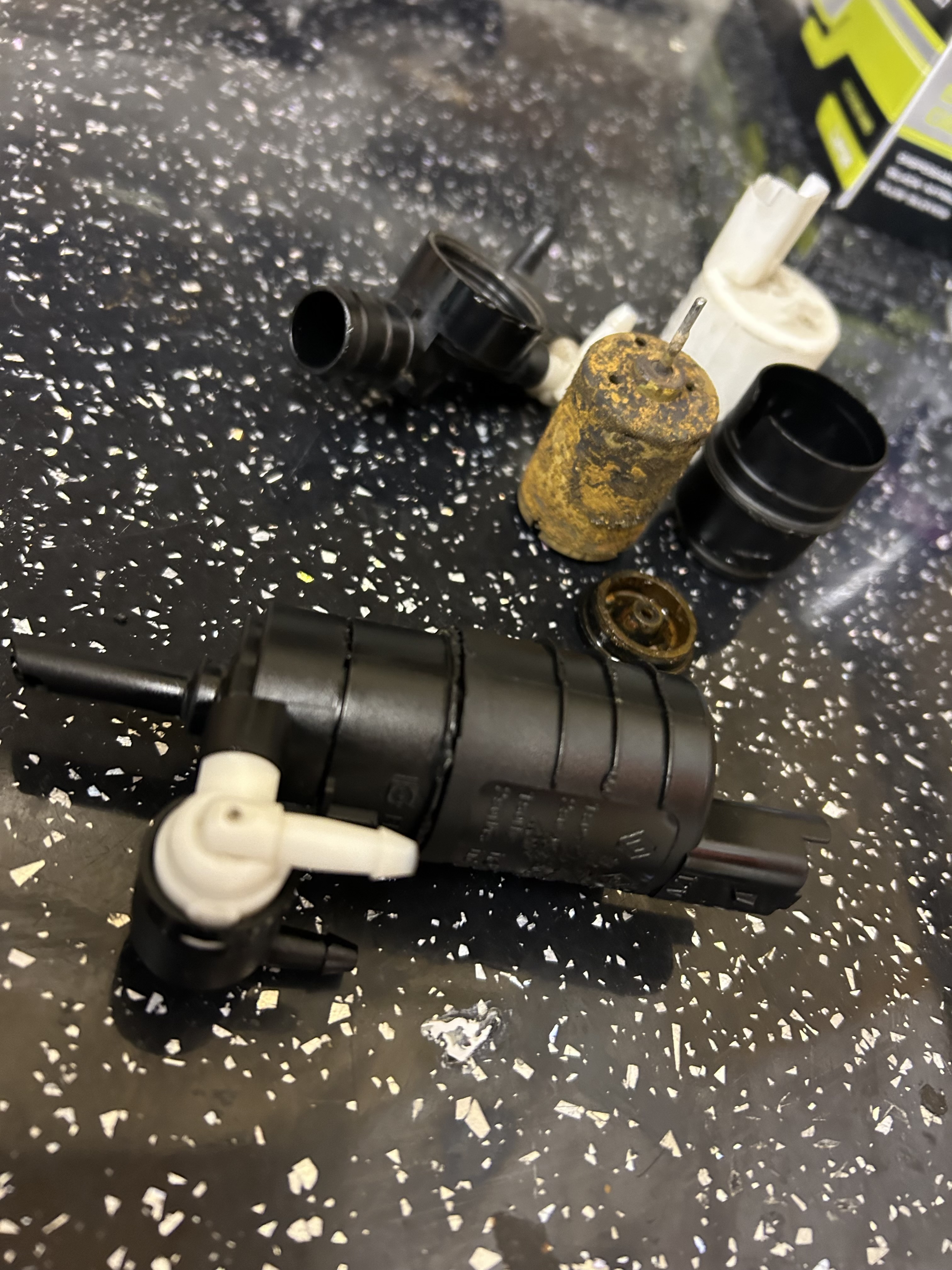

Another job sorted today, noticed the washer pump wasn’t working. Instead of buying another one which are about £70 genuine i thought i would strip it down.
Motor seized up, looks like the seal failed and let water in.

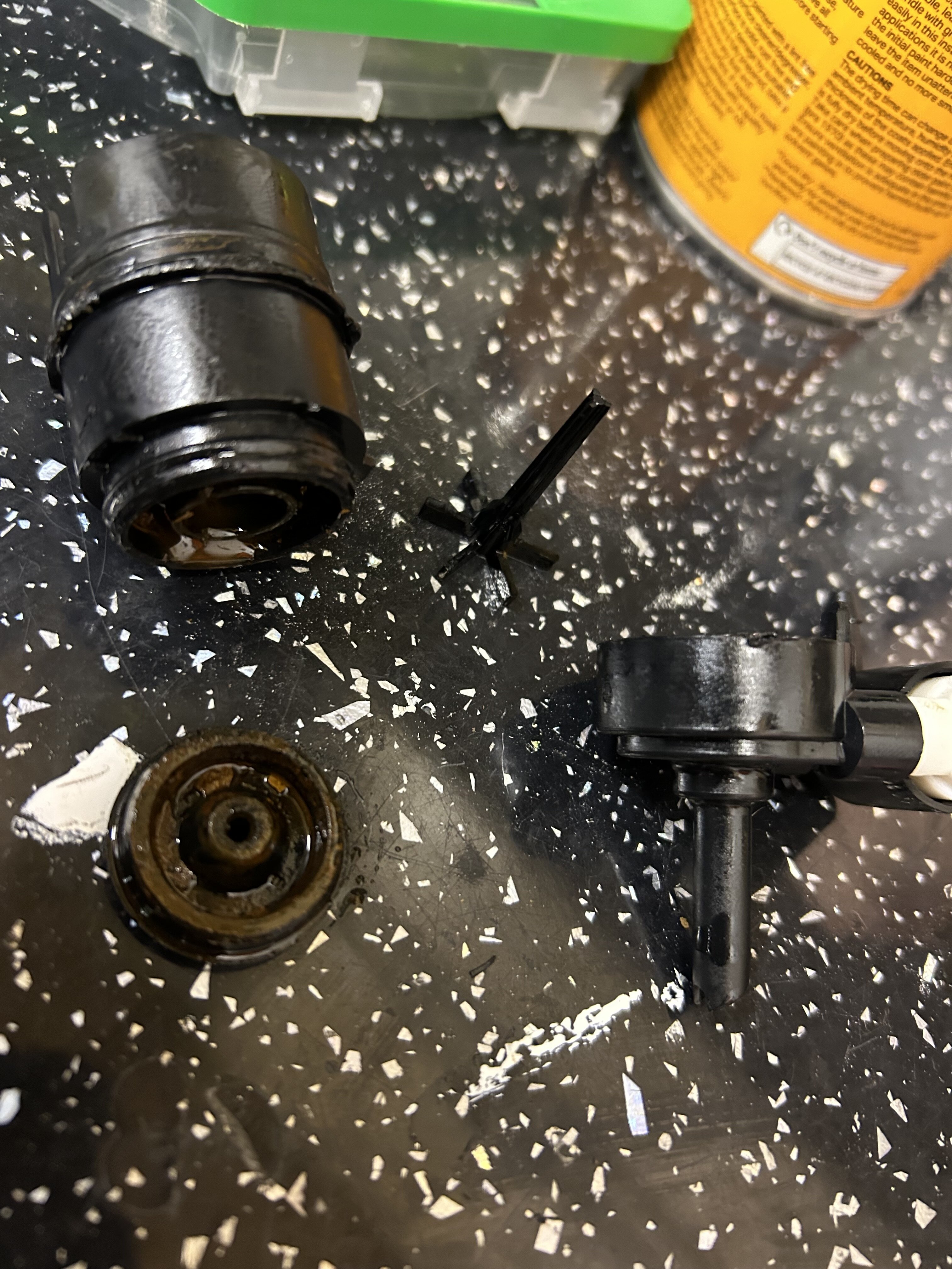

Went through my tool box and found a couple of Megane washer pumps with a different bottom outlet.
Stripped box down and transferred the motor and seal onto the Clio pump, all working again.
Nice £0 fix. I could've bought a Chinese one off eBay for £8 but from experience they usually last about a year.
Superb job, willing you be taking it to a few shows next summer ? I like the make do and mend approach on the washer pump too :)

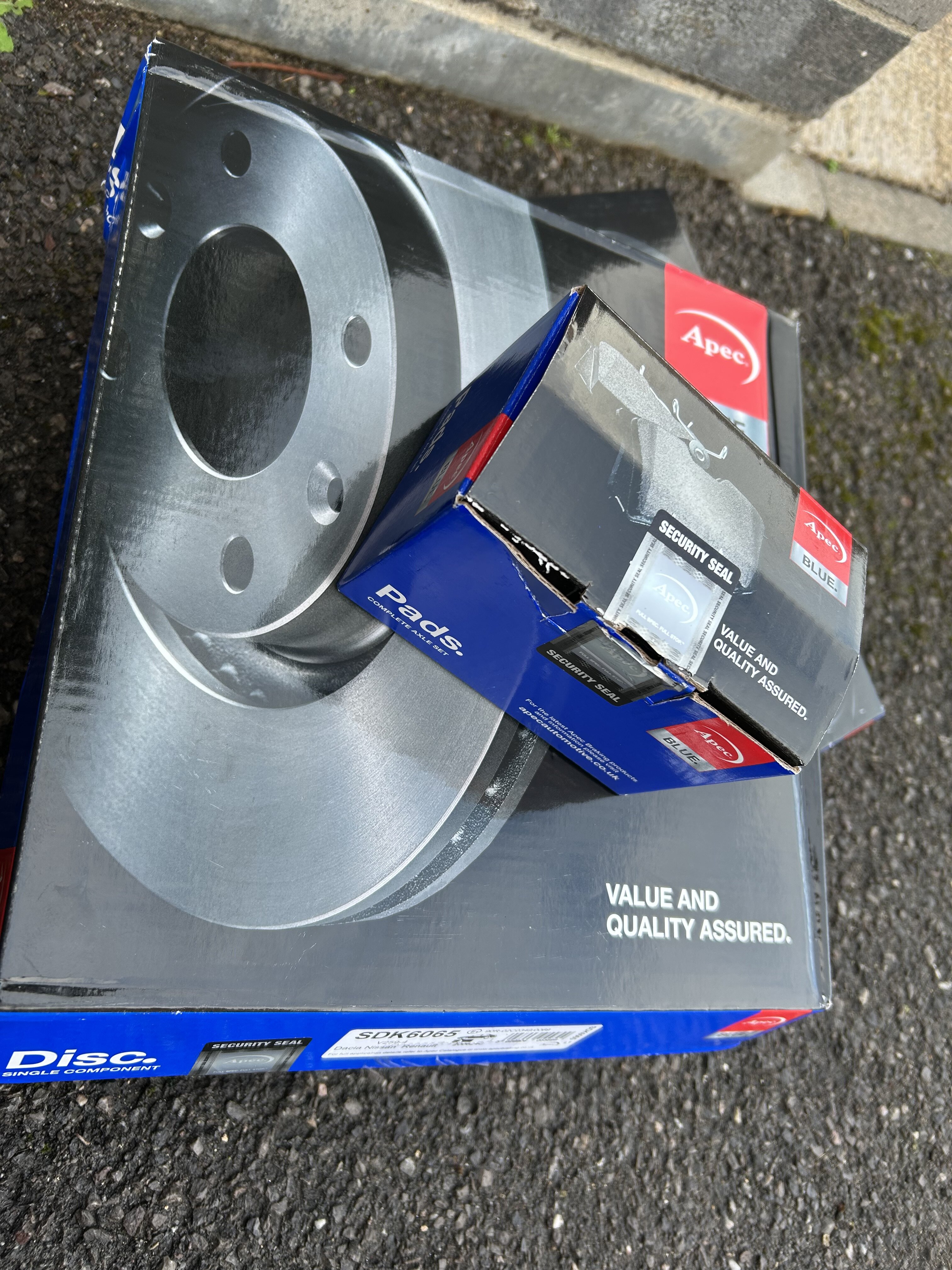

A few more bits sorted.

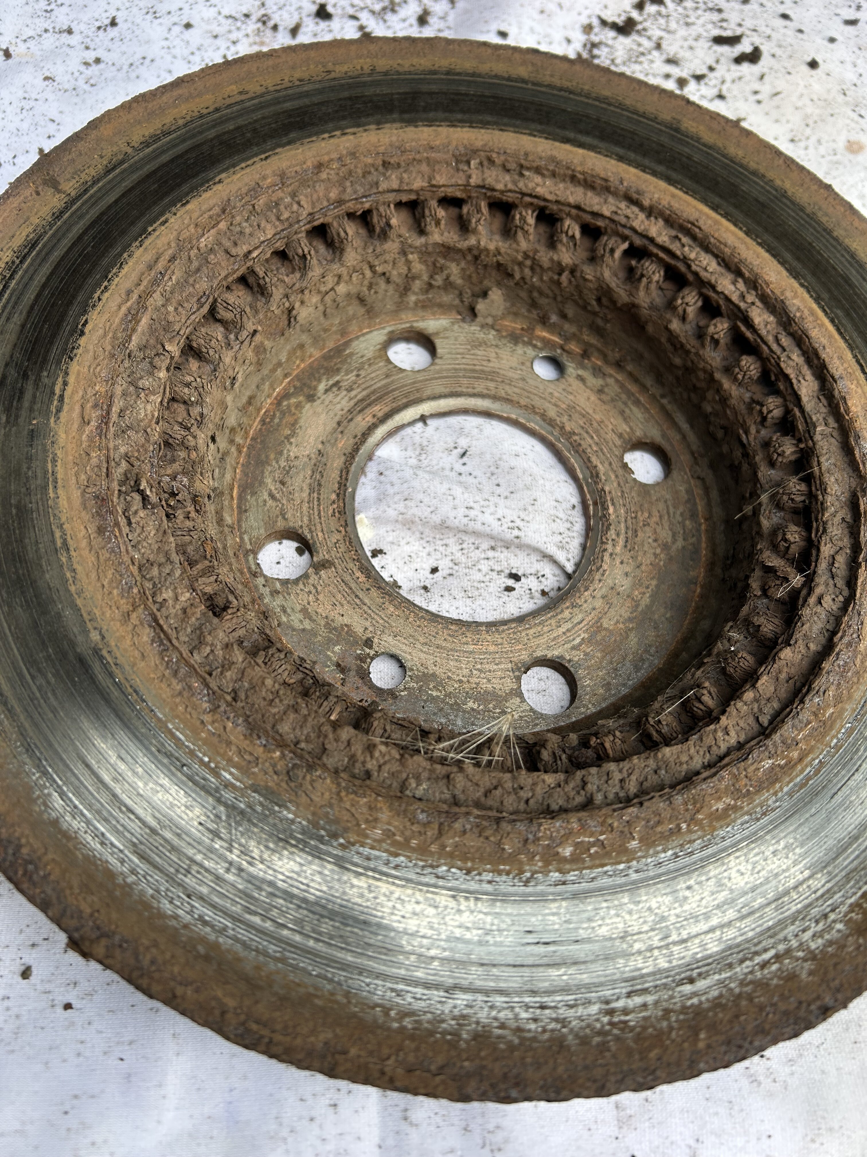

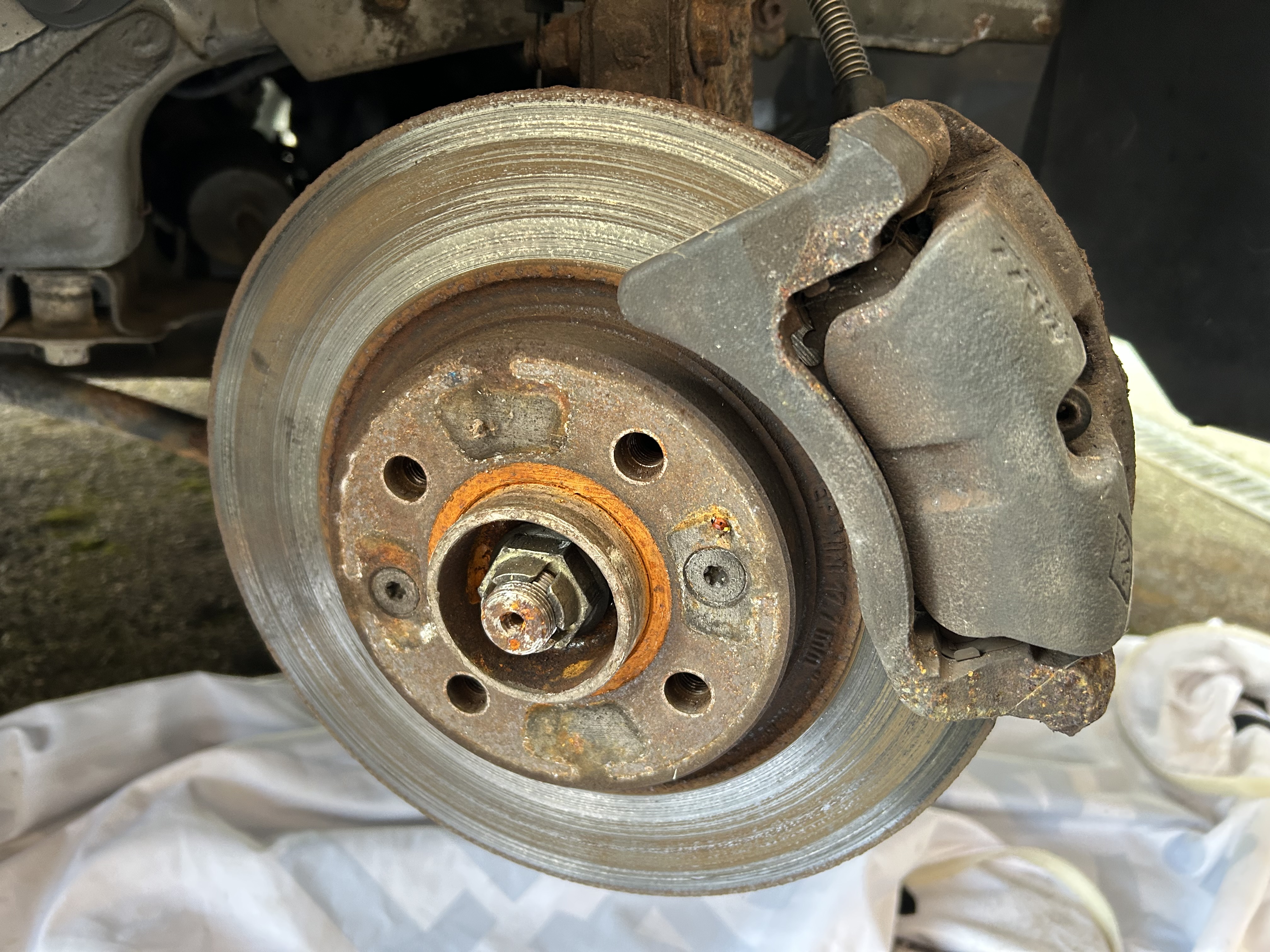

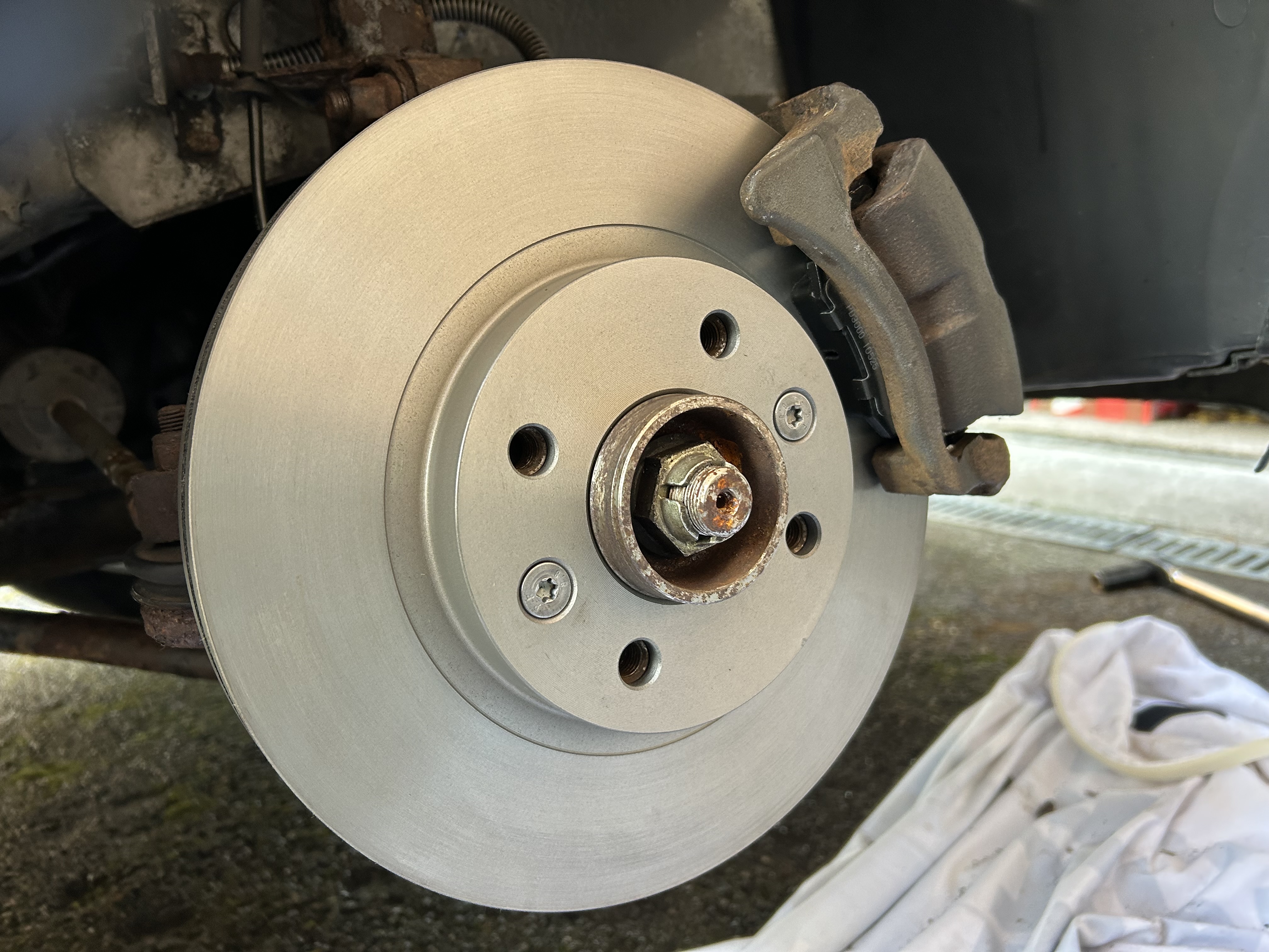

Apec discs and pads £45

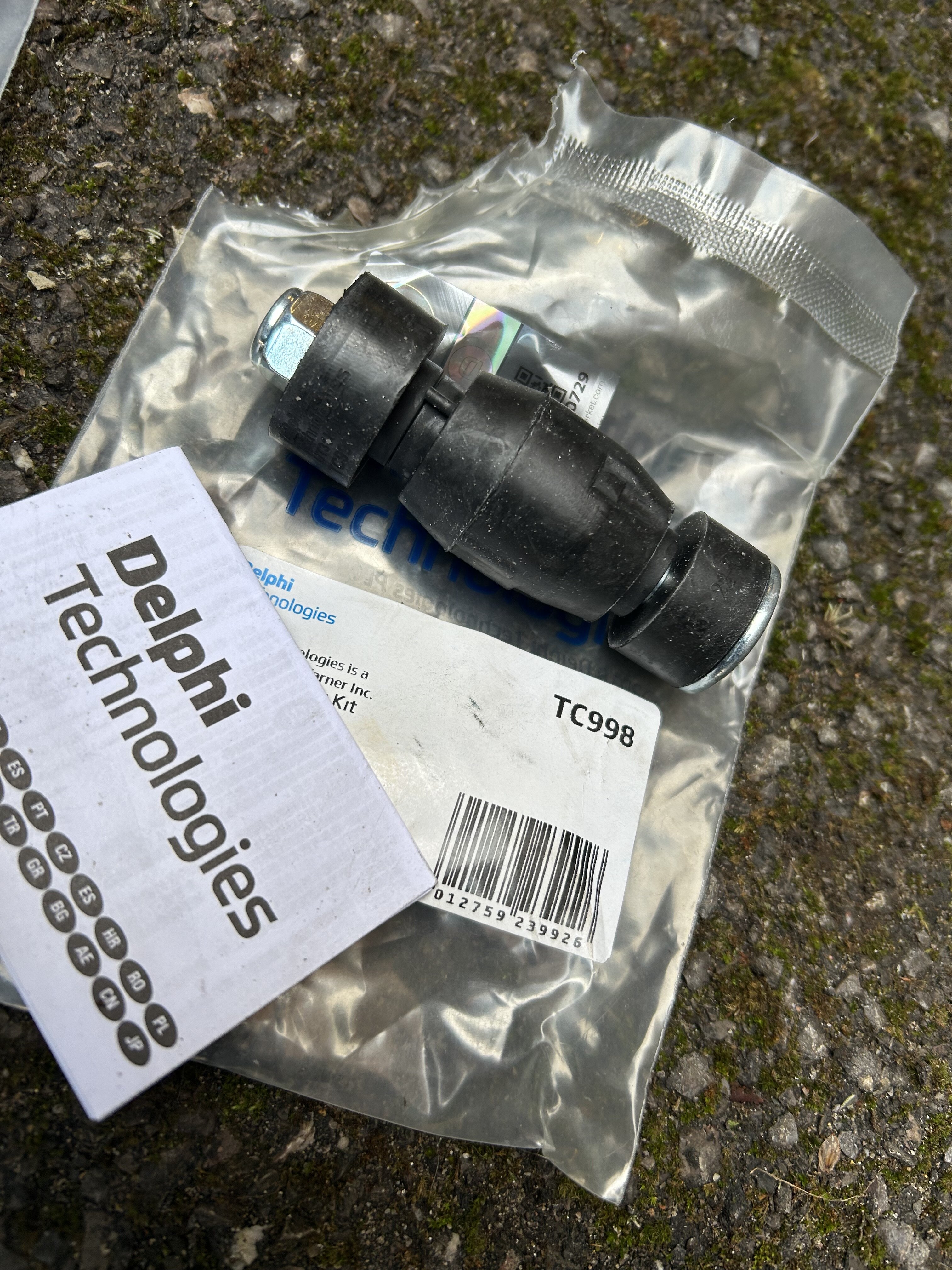

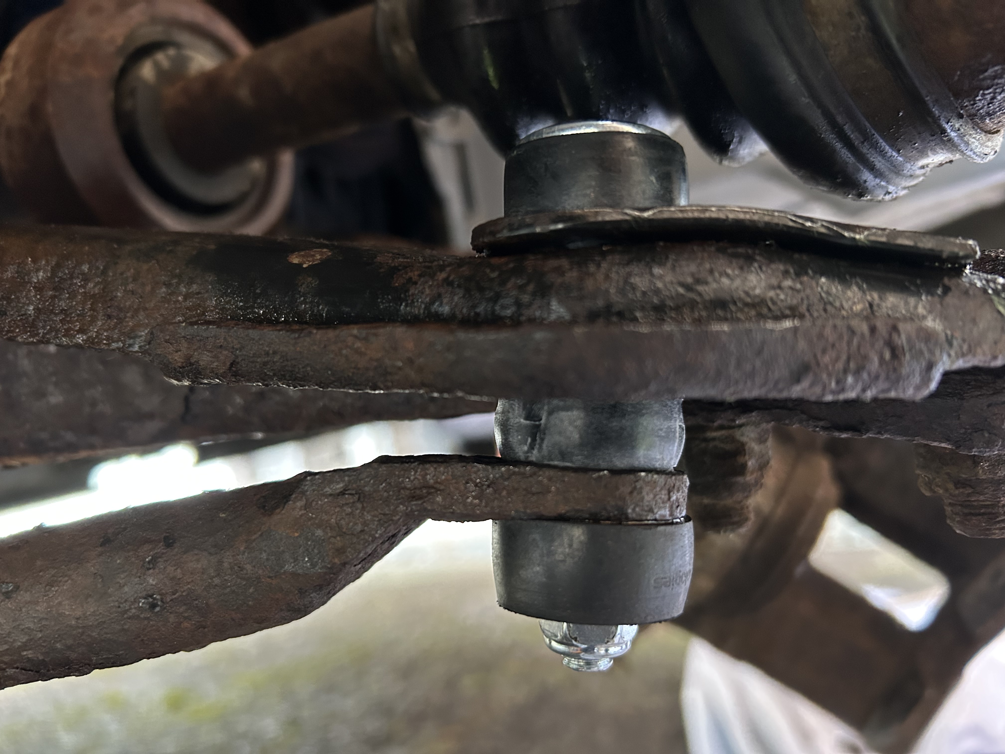

Delphi drop links, £6 for the pair

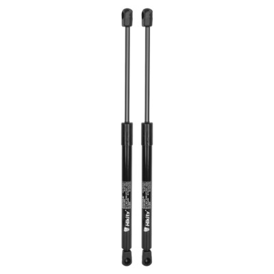

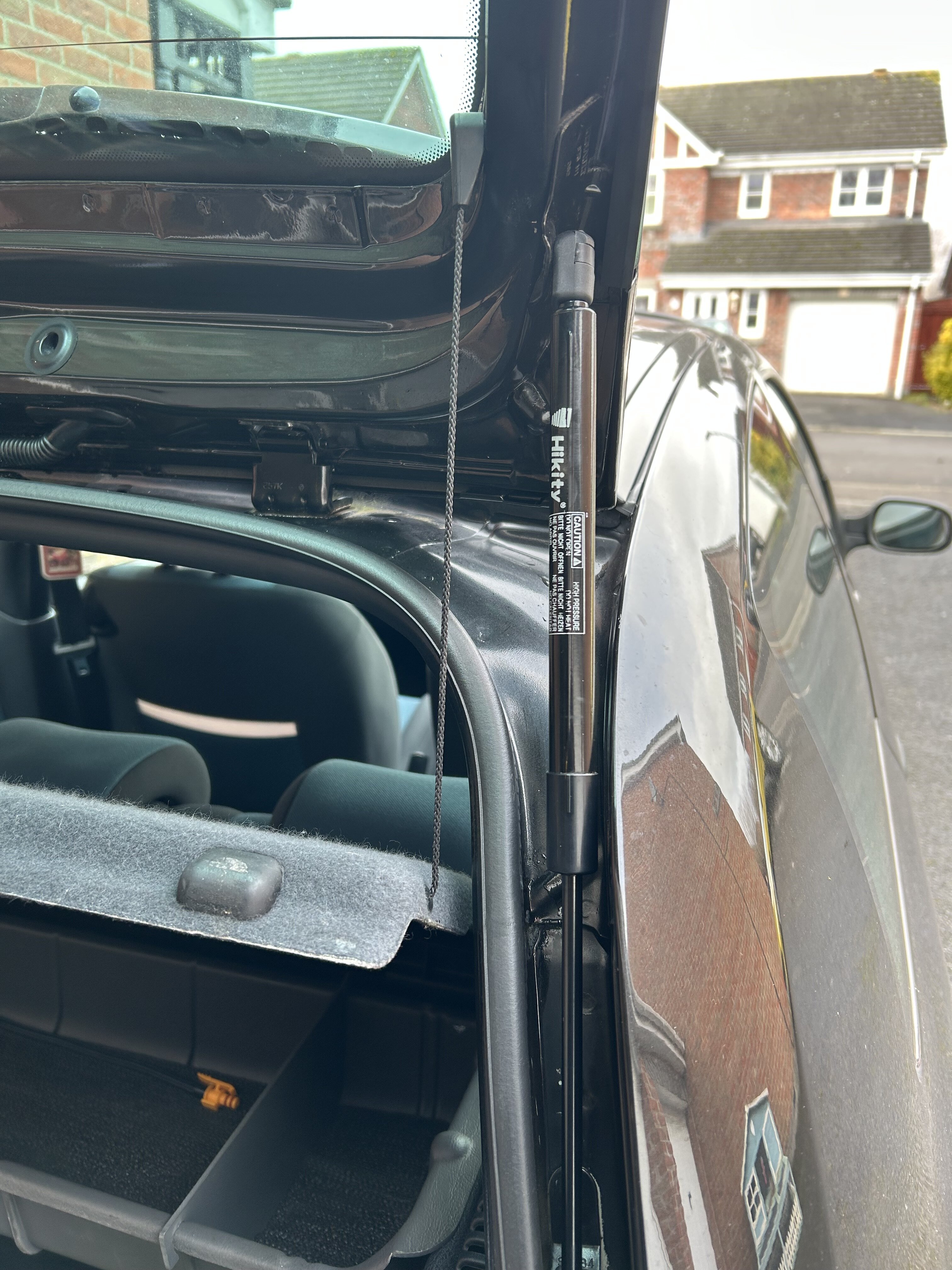

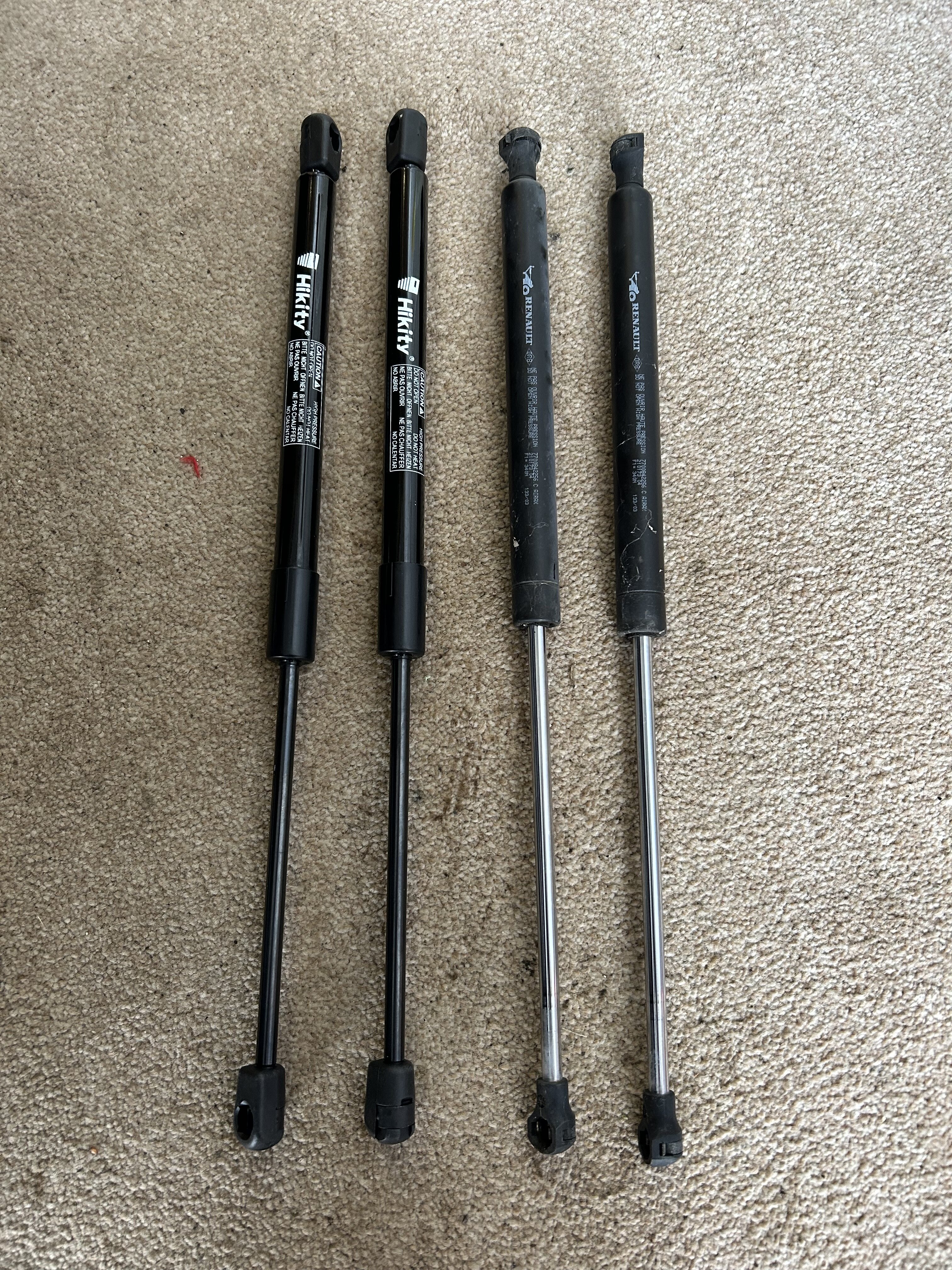

Boot struts, £10 for the pair.
Parts are bloody cheap for the old girl!

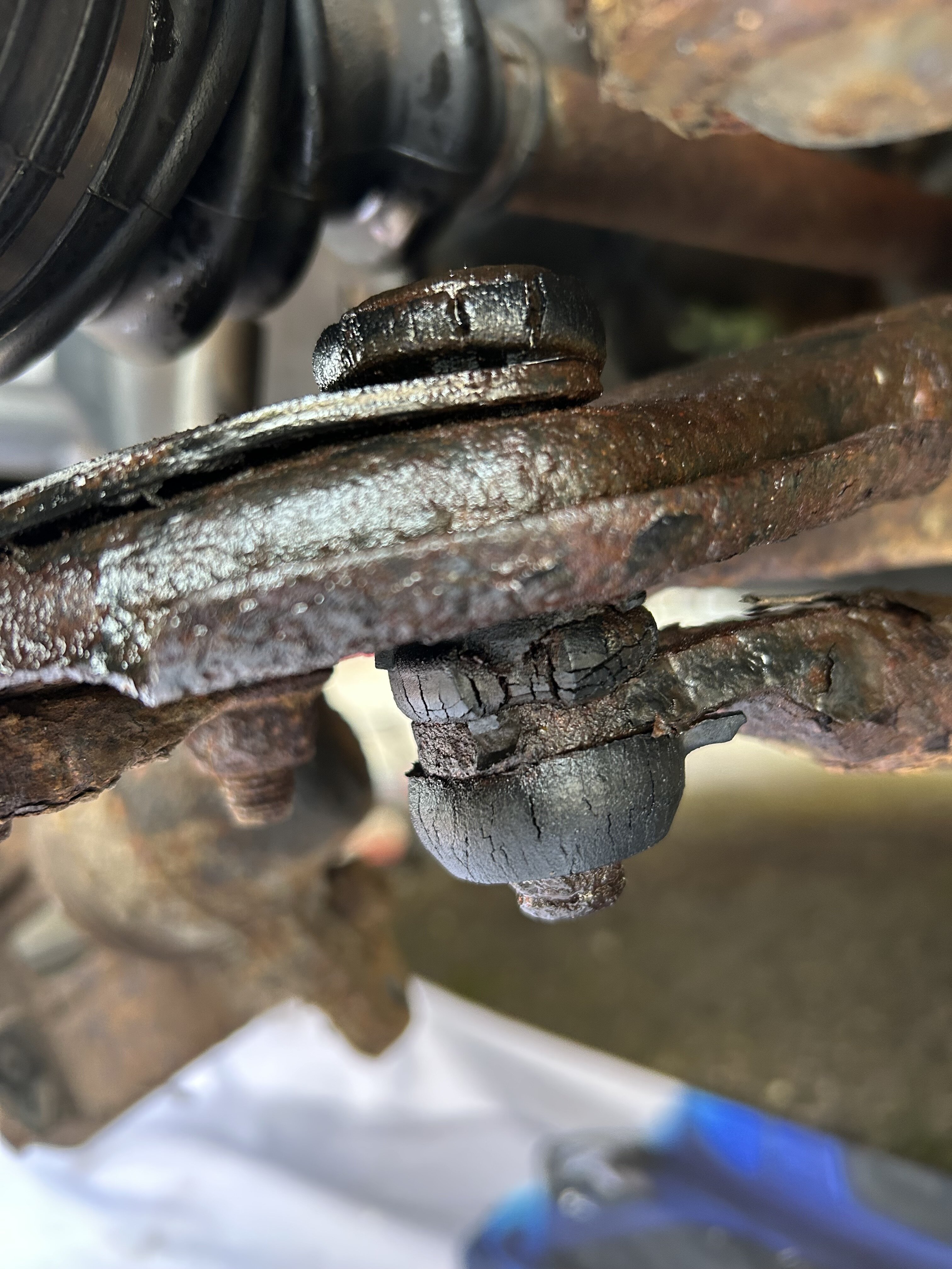

I did notice the lower arms are looking a bit crusty so i better get those done in the new year.

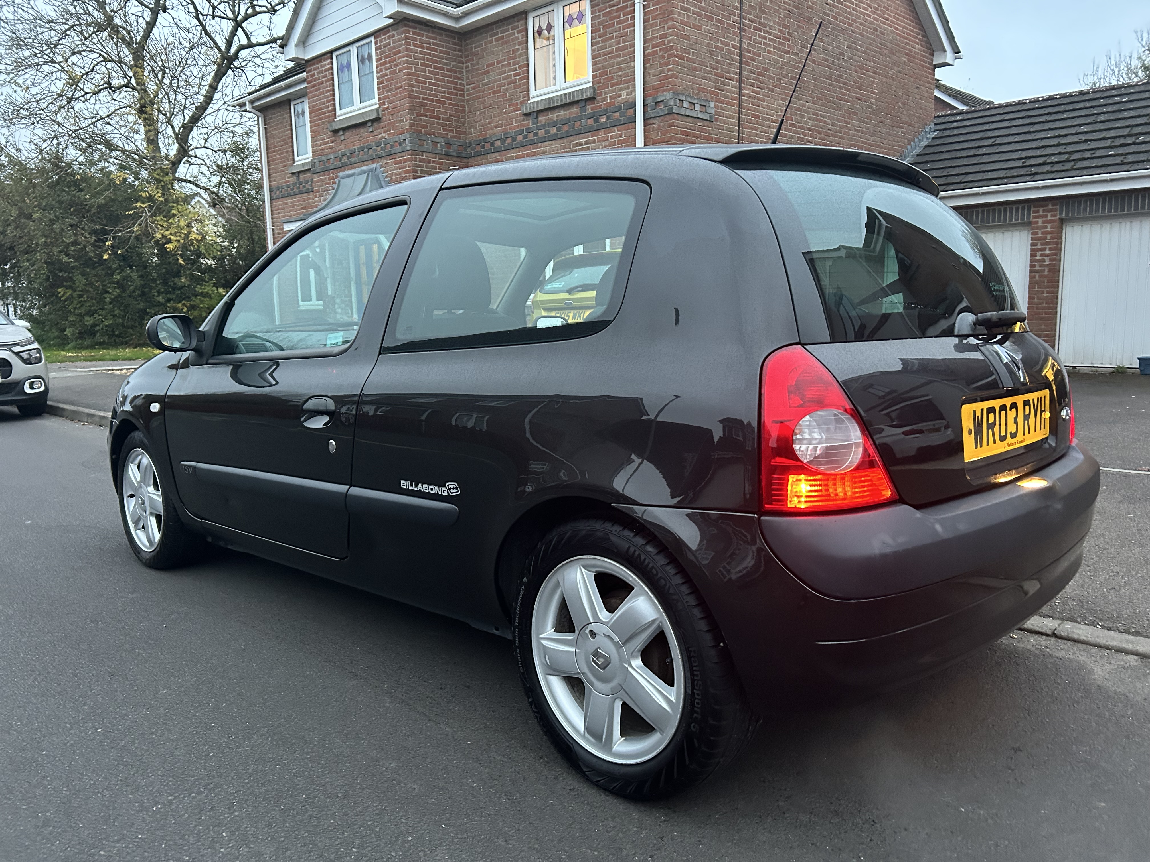

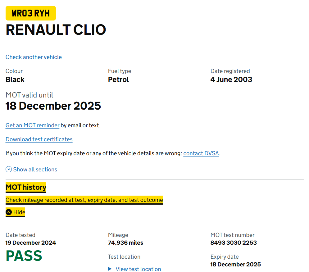

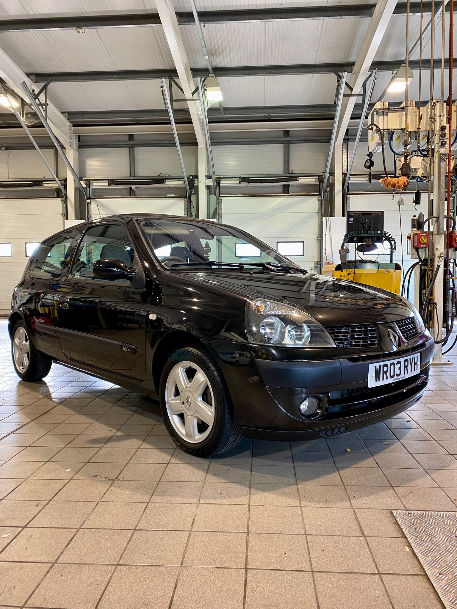

I shall hopefully get it in for MOT this week 🙏
