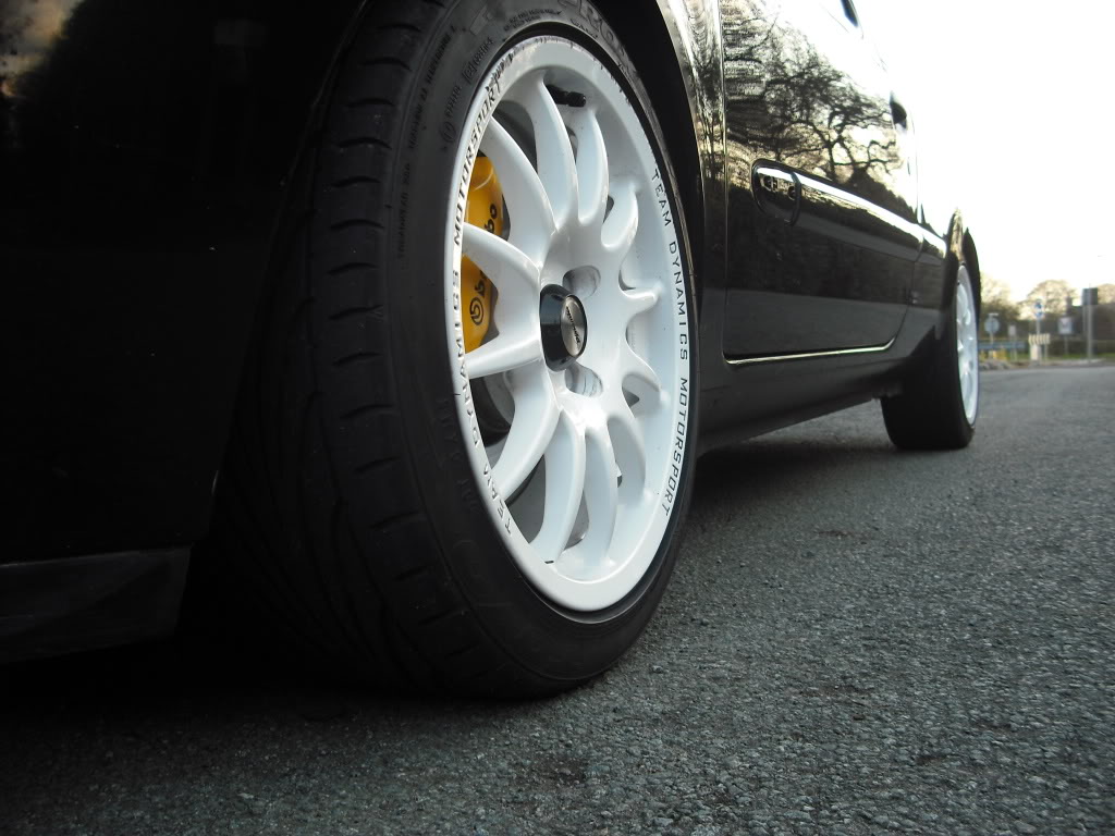

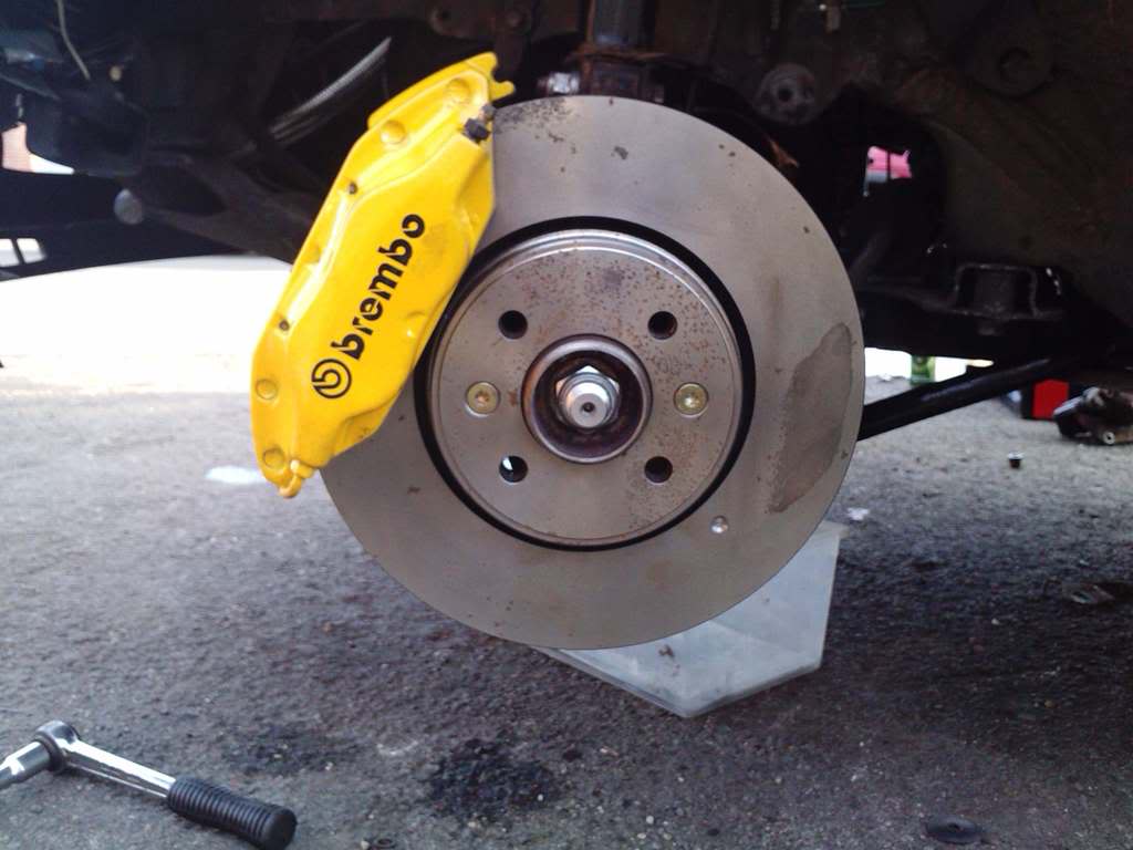

I have 406 ones which are identical. They fit non-RS hubs, wont fit RS hubs though without brackets....
Excuse the kerbing :eek:

ive got a old set of 406 ones
so defo wont fit without brackets then what brackets do they need? and where from
