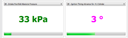

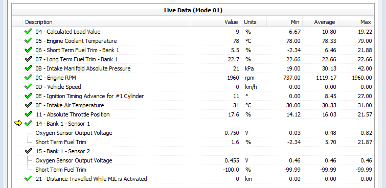

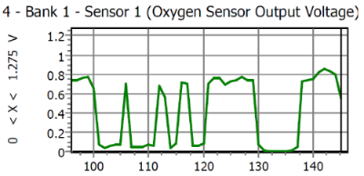

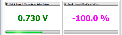

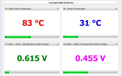

Here are a couple of pictures from the OBD2 reader. I don't actually think it will mean much but thought i would post it up anyway. No fault codes are listed at all. This was done just before the first run.
