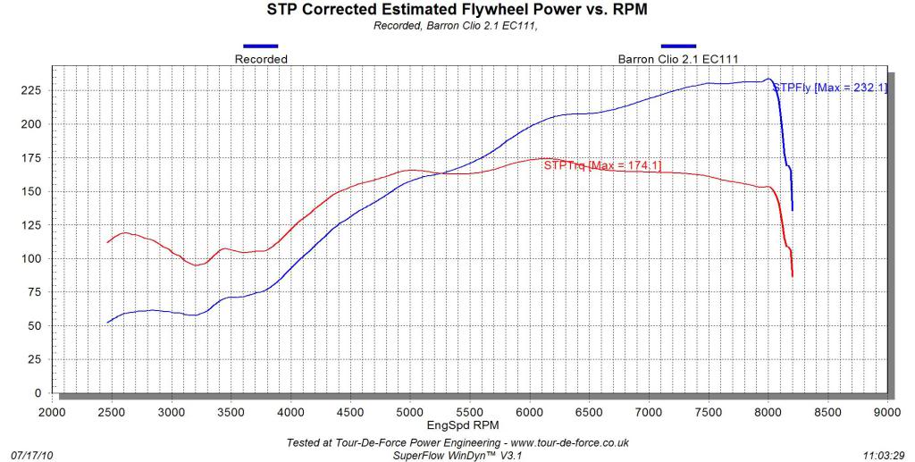

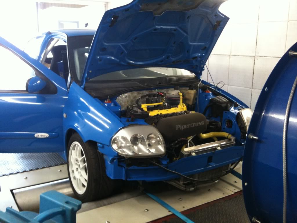

The car is mapped and sorted! not as high power as i thought but as you can see the power is still climbing lol. The car has been at Tour-De-Force for the past 2/3 weeks. The car has made 232bhp peak with 174ftlb of torque. The most impressive bit is that the car makes as much torque at 8k as a normal Cliosport makes at 4.5k. The timing has been slightly altered, matt mentioned the car would make the magic 240 with a couple of days of fine tuning of the timing and leaning the fuel out (this isn't possible as i do not have the money to replace the engine if anything fails)

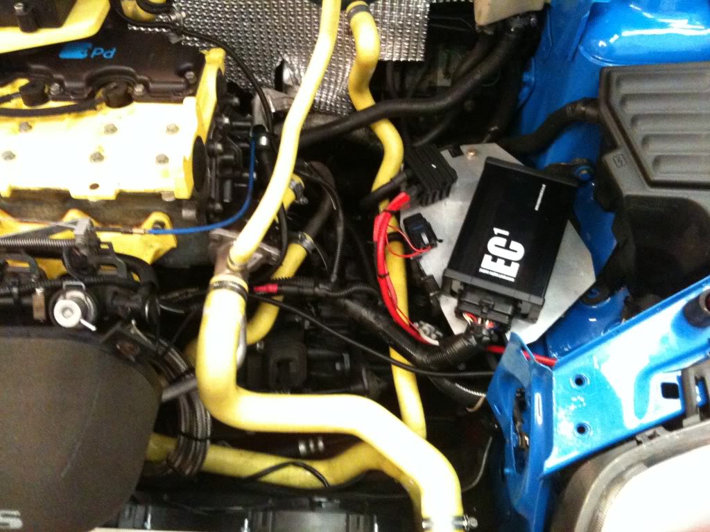

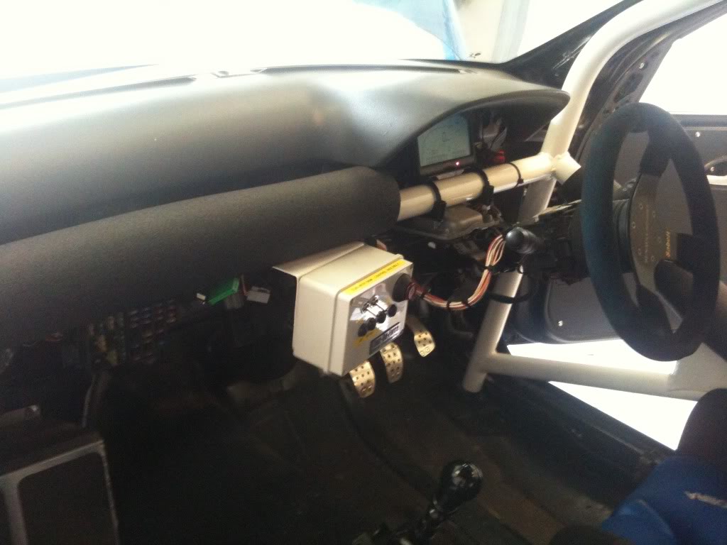

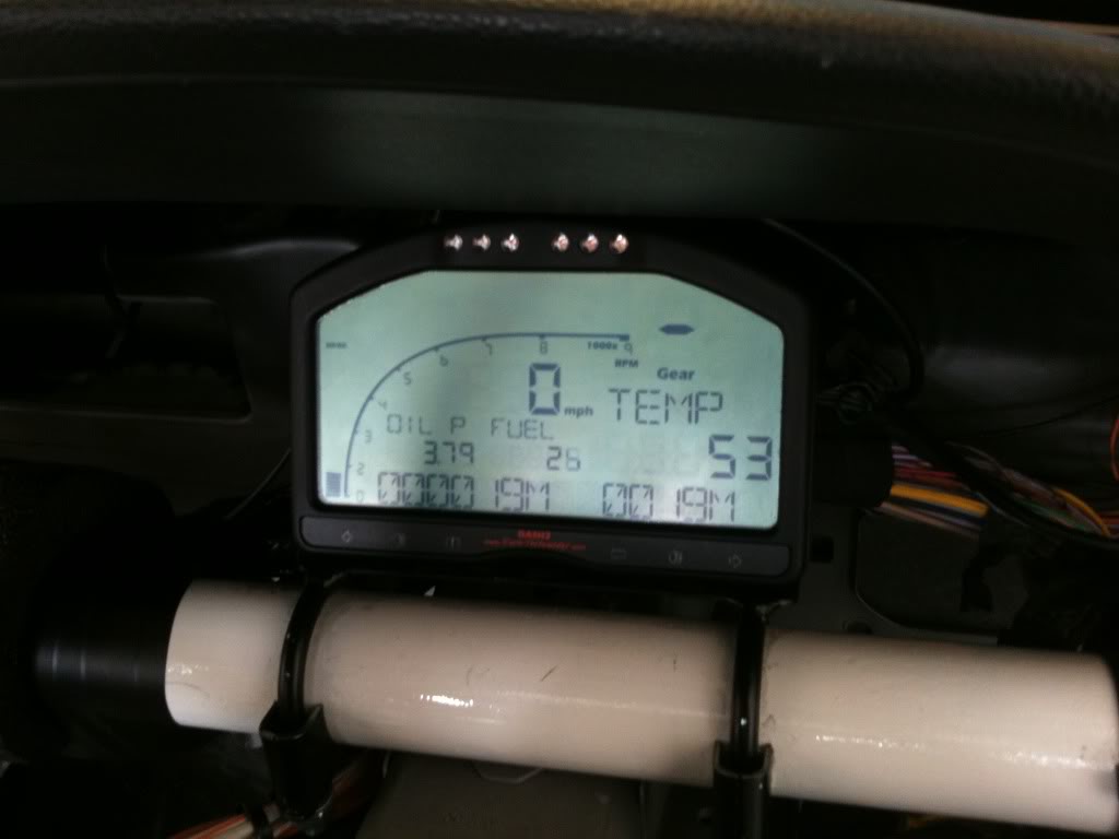

Its had a new EC1 ecu + cal, Renault ecu removed, engine bay loom separated and removed what wasn't needed, control box wired up, DASH2 fitted and calibrated, heated windscreen wired up and much much more.
Notice the 1.4k idle :lolup:

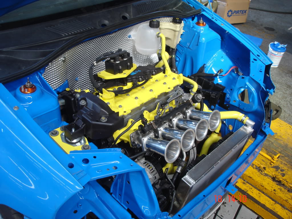

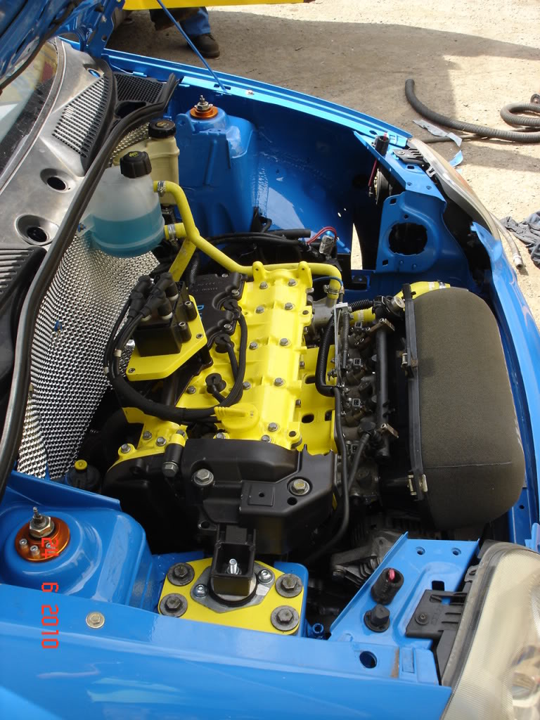

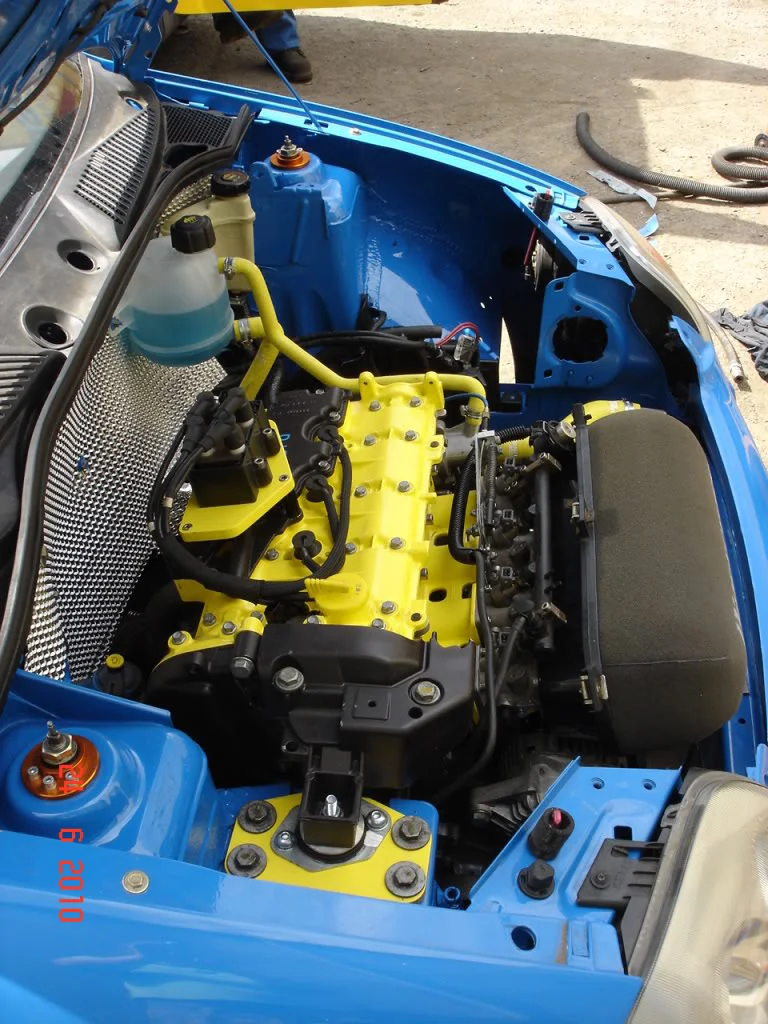

How the engine bay looked without the ecu etc:

What top engine mount is that?

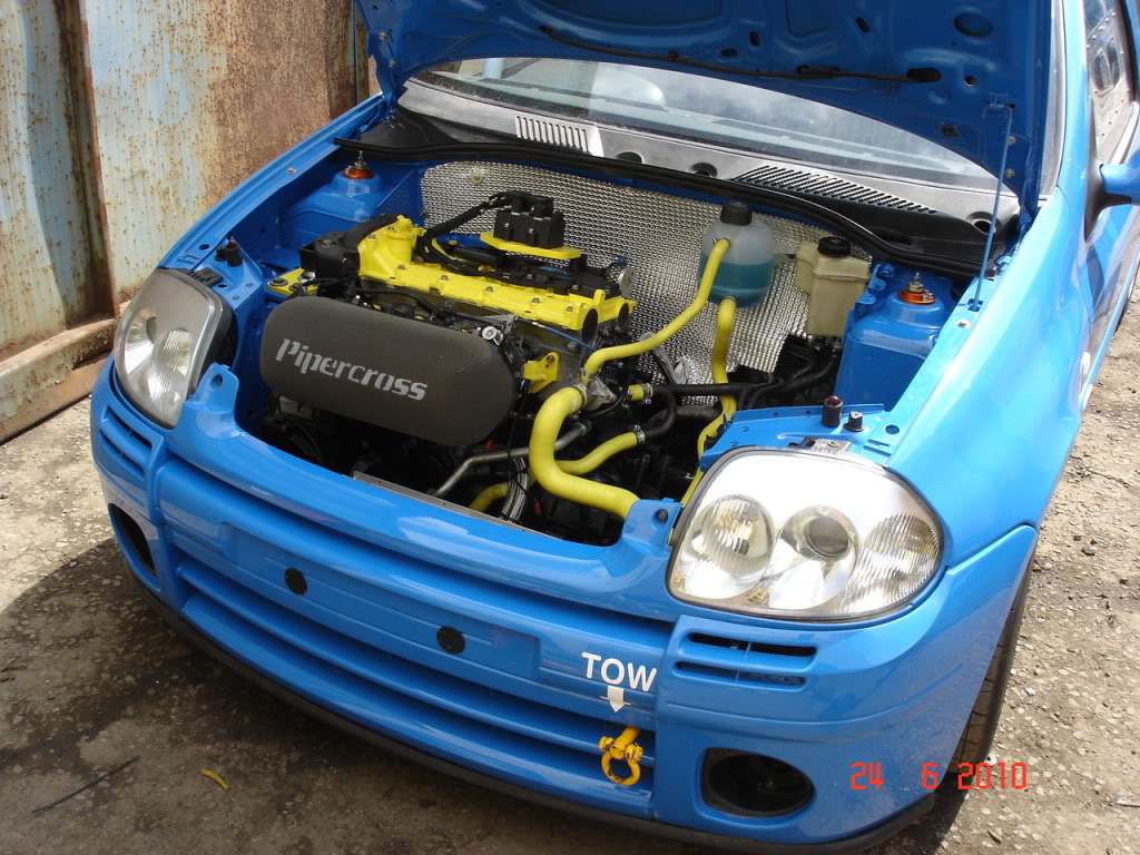

Any pics without the sausage filter?
What dash top is that?
  RS6+ & 40d MSport X5
Only thing i personally dislike is the yellow hoses, but thats being very picky!

no idea, with its low weight/high power/LSD i think it would be around 5.5-6

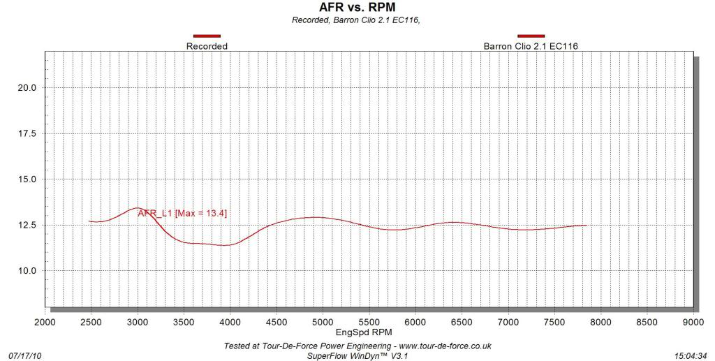

Mind me asking the reason for 11AFR at 3500rpm? Is this due to the aggressive cam profiles used and/or valve overlap dialed in?
yeah was speaking to matt about this, when he altered the fueling to anything else the car didnt like it at all so had to stick to that.
