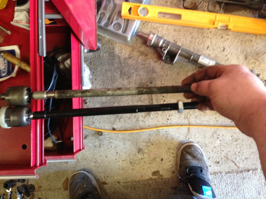

I bought inner track rods from GSF - they came very next day
I know the genuine renault stuff is supposedly better quality but instead of £90 + vat - they were £28 + vat and came next day

The GSF stuff is firstline which wouldn't be my first choice - but next to each other they look identical
And for the price difference I could replace the firstline ones after every track season without any impact on the bank :D

Does yours have cup suspension?
If so I'm pretty sure you need the firstline ones - the lemforder are too short
Firstline FTR5277 are the ones in my picture
