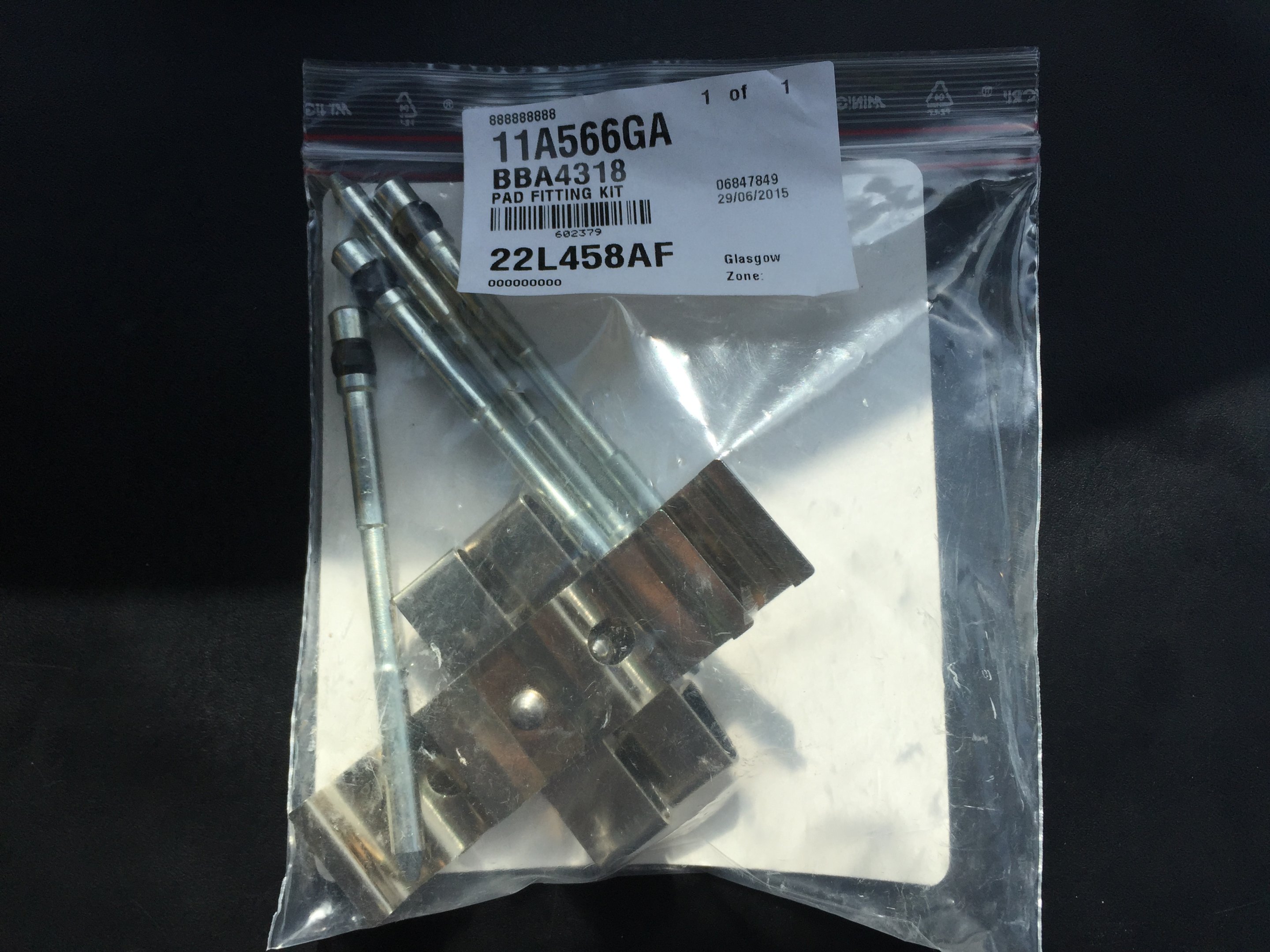

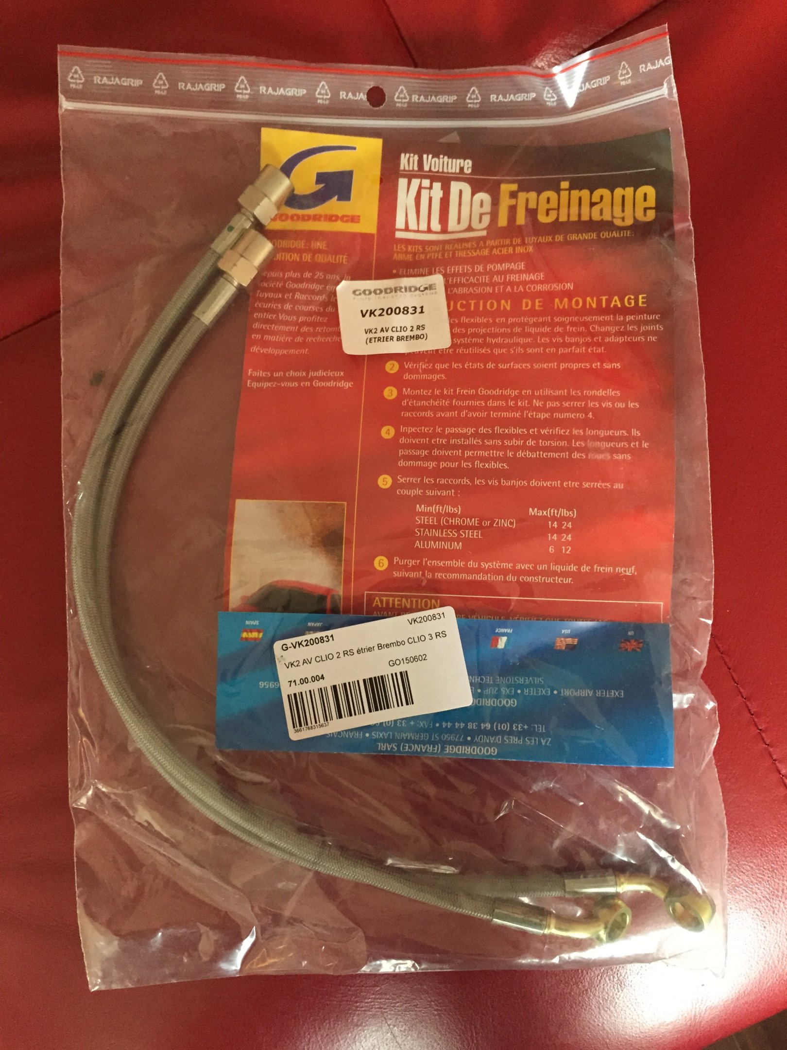

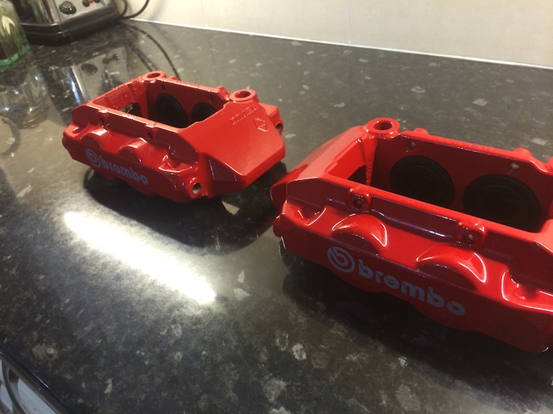

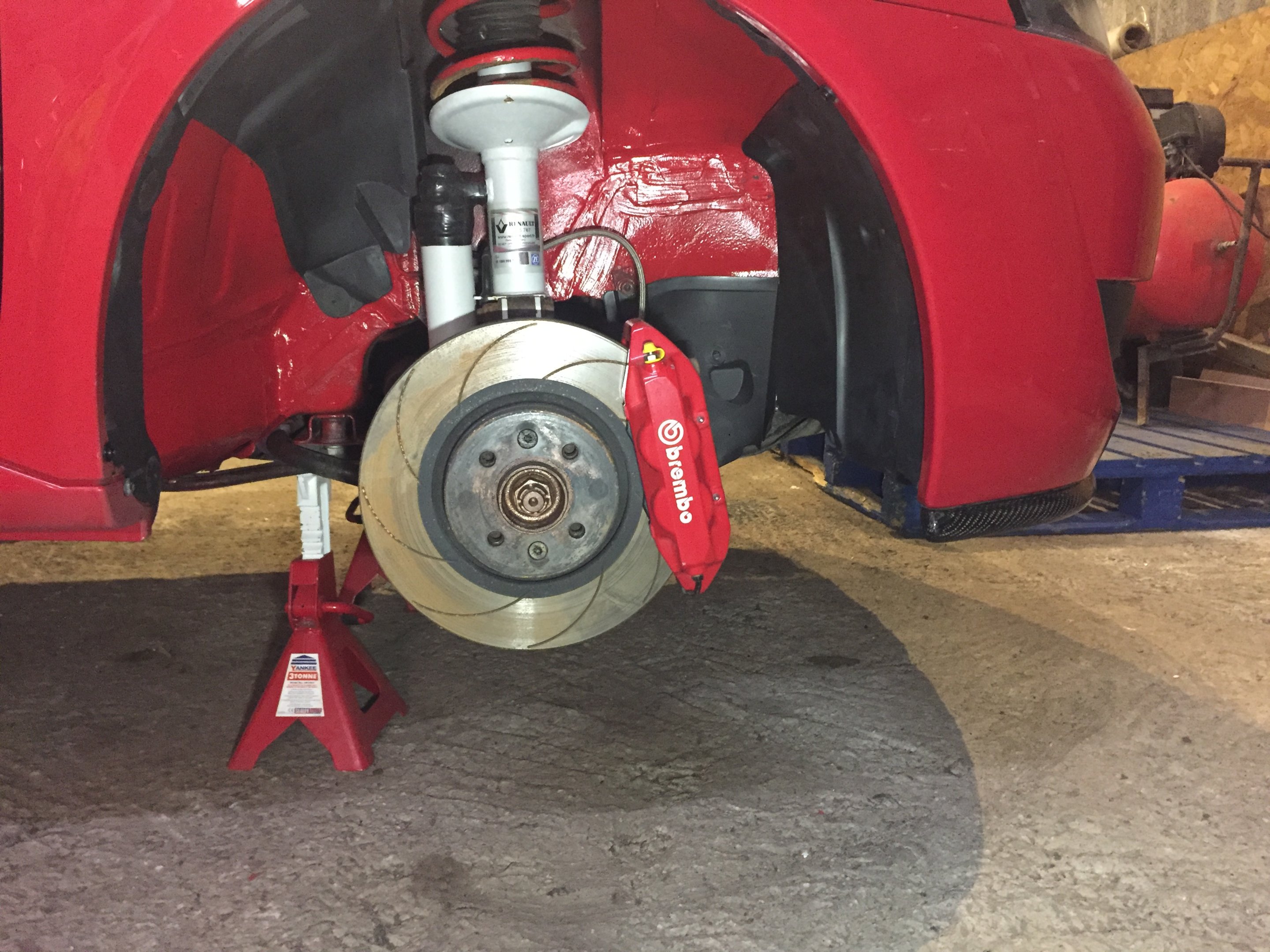

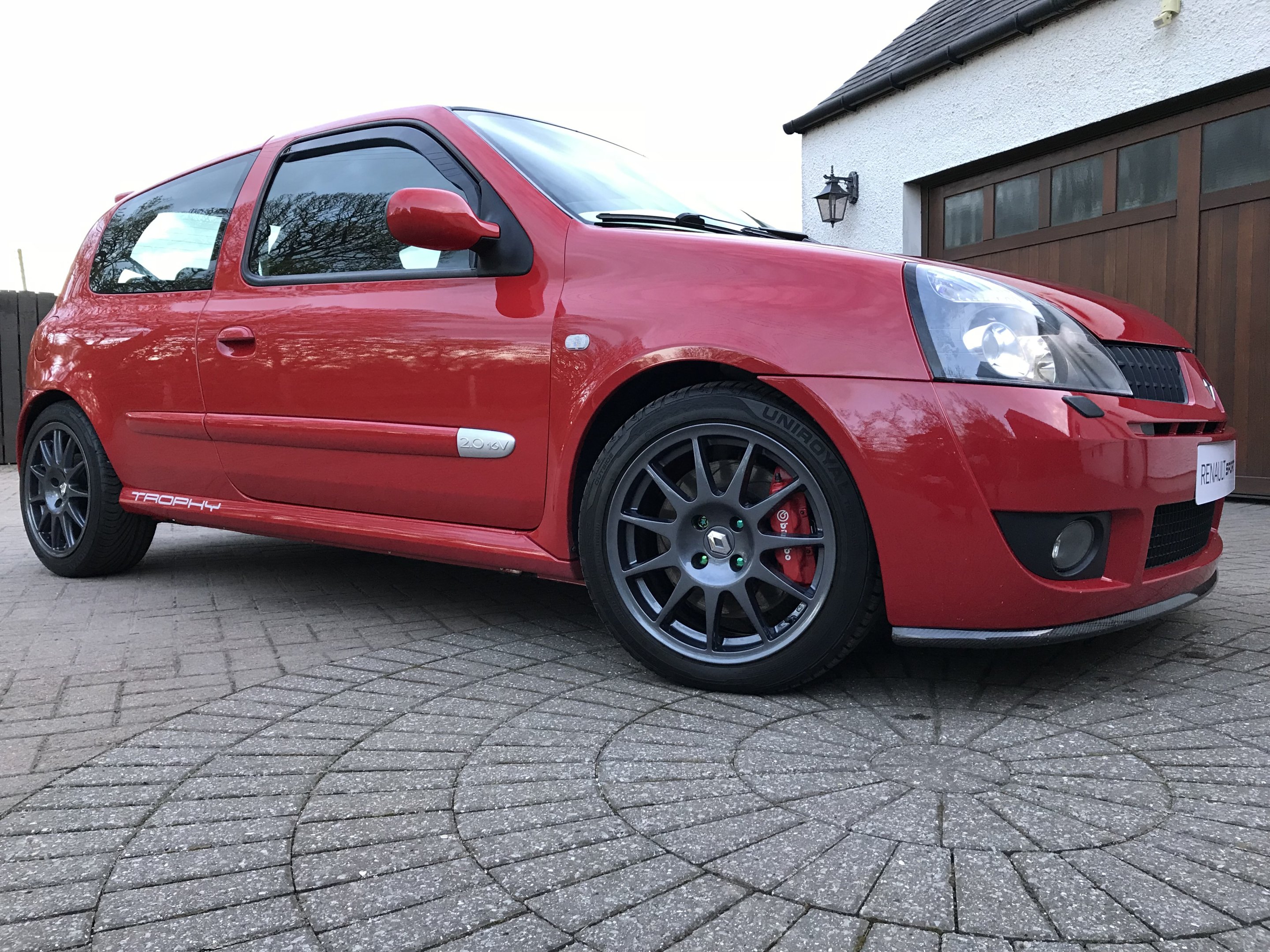

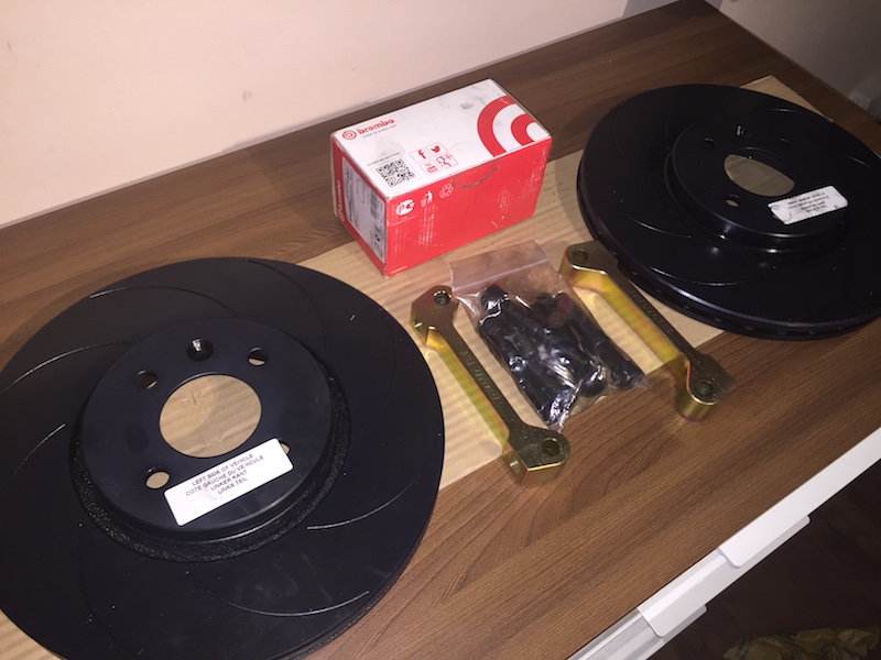

@pat-t2phy if you want to fit 300mm brakes under standard Trophy alloys you also need 20mm spacers due to the offset of the alloys, You can fit Clio 172 Cup alloys and get the wheel weights moved to the back of the alloy as there is only about 1mm or 2mm clearance if that.
You need the following parts
300mm Renault Scenic discs (4 Stud)
197/200/225 Brembo Calipers
197/200/225 Front Pads
197/200/225 Pad Fitting Kit
197/200/225 Braided Brake Lines
Pure Motorsport Brackets
20mm Spacers (If Running Trophy Turini's)
No Spacers (If Running Cup Turini's)
