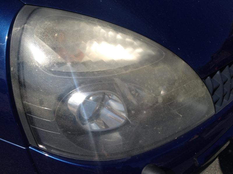

Well I have had the 172 for a month now - Ive fitted an alloy foot rest, KN panel filter, clear repeaters and my old JVC headunit, but today I tackled one of the things that was bugging me the most!
The headlights! they were crap.....really spoiled the front of the car.
So after looking at various options decided to have a go myself with the 3M headlight correction kit (£19 ebay!)

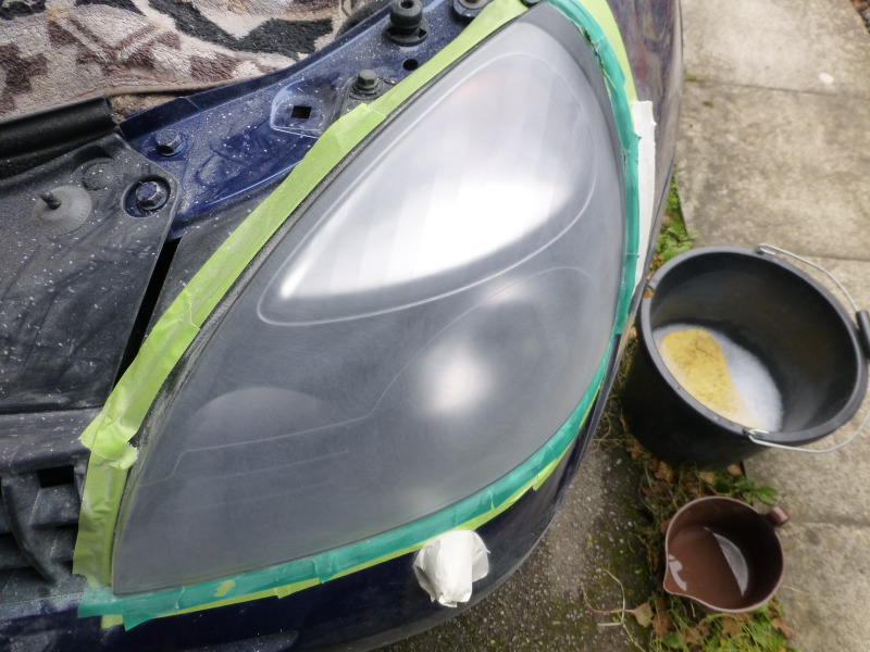

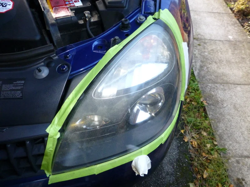

So masked them up.

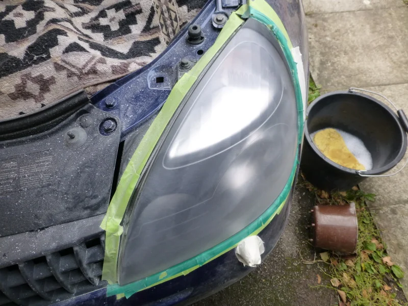

500 grit....
800 grit....

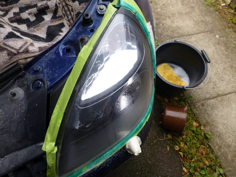

P3000 Trizact....
Polished....

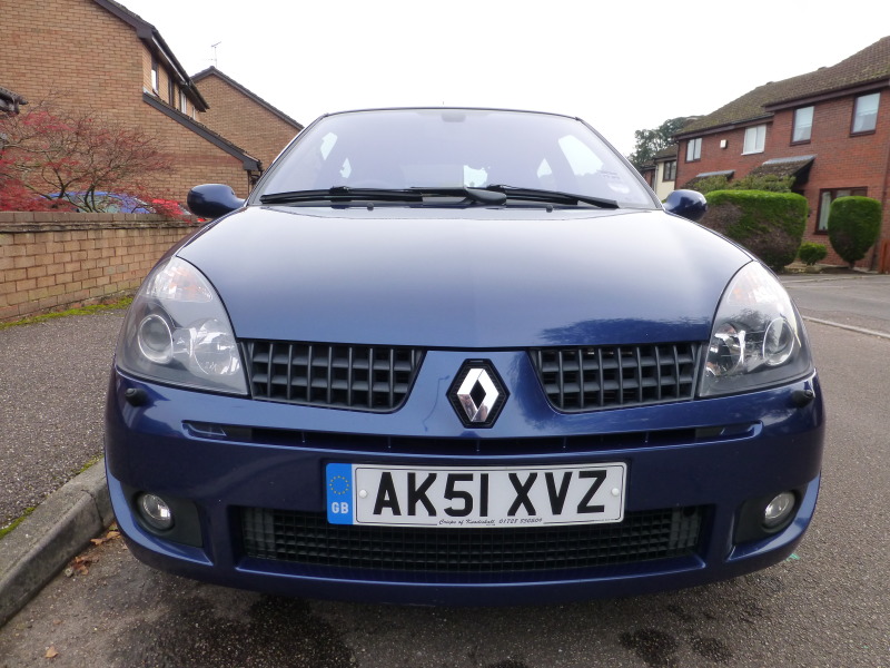

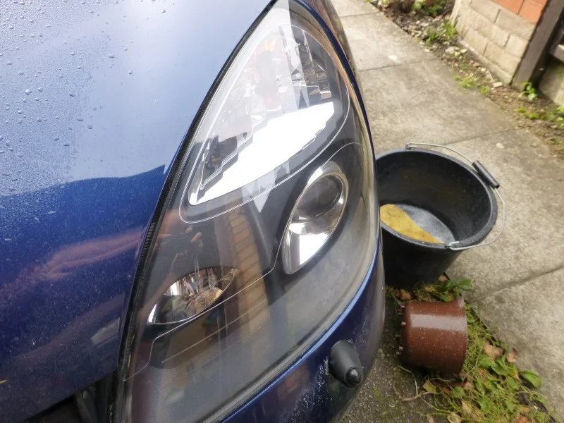

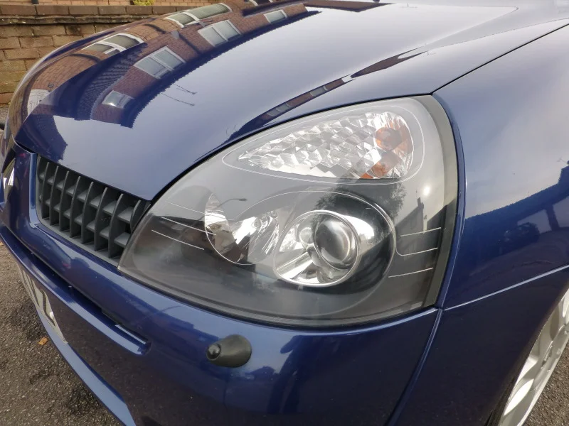

Finished and car cleaned....
Overall very pleased with the results - headlights look really good now.
Few tips:-
1 Double mask around the edges,
2 Cover up everything you can when doing it as s**t goes everywhere!
3 Take your time, dont push to hard! I probably spent more time sanding than you really need to but the results were definitely worth it.
Overall the best £19 ive spent in a long while and tbh it was a a simple process to obtain amazing results:cool:
