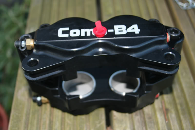

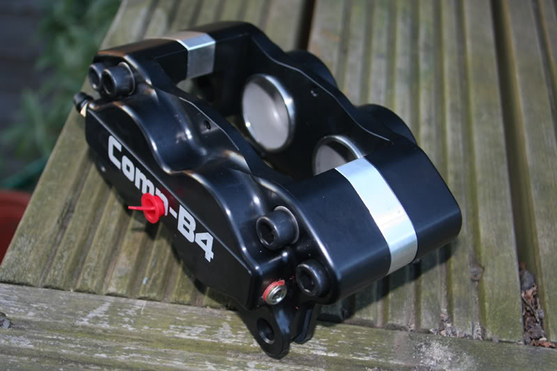

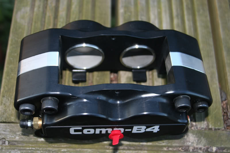

Bleed nipple wouldn't be much good at the bottom!!!
Look great but lack of dust seals would concern me due to my massive mileage.
In the supplied documentation it says -
DIRT SEALS DUST SEAL MUCK SEALS MYTH
The correct term is corrosion seals
Calipers are hard anodised aluminum with stainless steel pistons therefore there is nothing to corrode.
But at the end it says-
However we recommend regular inspection and servicing by trained technicians. :D

I was speaking to a guy from AP a few weeks ago and he basically said that they only run the dust/dirt seals as a precaution on the road calipers and that most of the race calipers only loose the seals becasue of a risk of them melting and causing other issues during a race/rally. He said that they don't believe there would be any issues with using the race calipers on road, as long as they are inspected for any issues every now and then. Thats only a 5min job anyway!!
I agree nothing wrong with none dust sealed realy just need to maintain them more check them for rust and maybe rebuild them ever one to two years but the parts are cheap.
I'd personaly always buy dust sealed as I'm lazy
