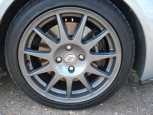

They don't look the same....
The one I have, the discs are fitted back to front for more bite, the calipers look grey where as yours are black?? and my discs have around 80% more grooves.....
(I got the car like it, can't comment on the exact spec tbh...)
  lift number 1 @ btm
the kit came from ben p, but that is all i know about it apart from the discs and bells have been frozen in liquid nitrogeon.
  lift number 1 @ btm
drhowser, i got my B4's from a group buy organised my ben p.
they are will be the same i'd imagine, i had them treated at a place called frozen solid.
i've not actually tried them yet.. but i'll trust daniels opinion :approve:
  172 cup
hi spec 300mm 4 pots i love them tbh but i could imagine there pritty much the same as most four pot kits i have the complete soild disc not the one with the rotors ;) due to the solid one piece discs are 24mm thick so they can take more heat ;) and last longer where as the rotors are only 22mm thick
