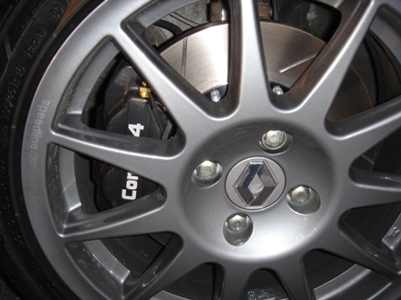

I have the compbrake B4 kit on my 172, great power once up to temp.

They cost me £650 through a group buy, normal retail is iirc £800. This includes cailpers, bells, discs, pads and now goodridge braided lines.
If your feeling really flush then AP make a 4 pot kit for 172/82's iirc they cost 1.5k.
