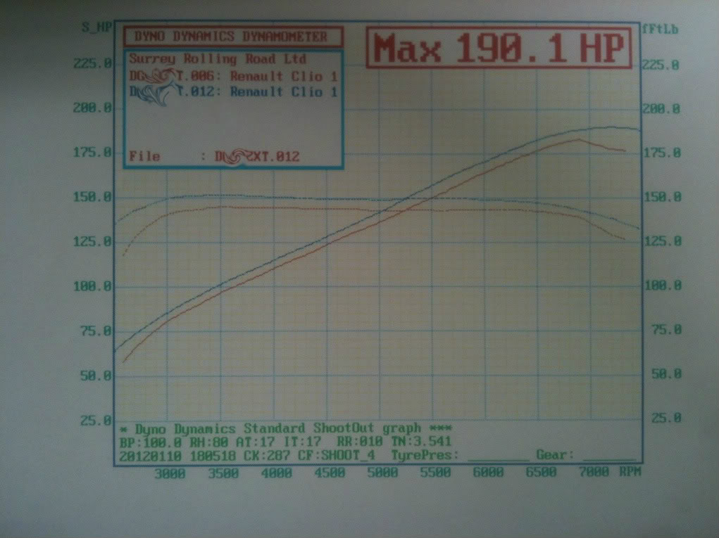

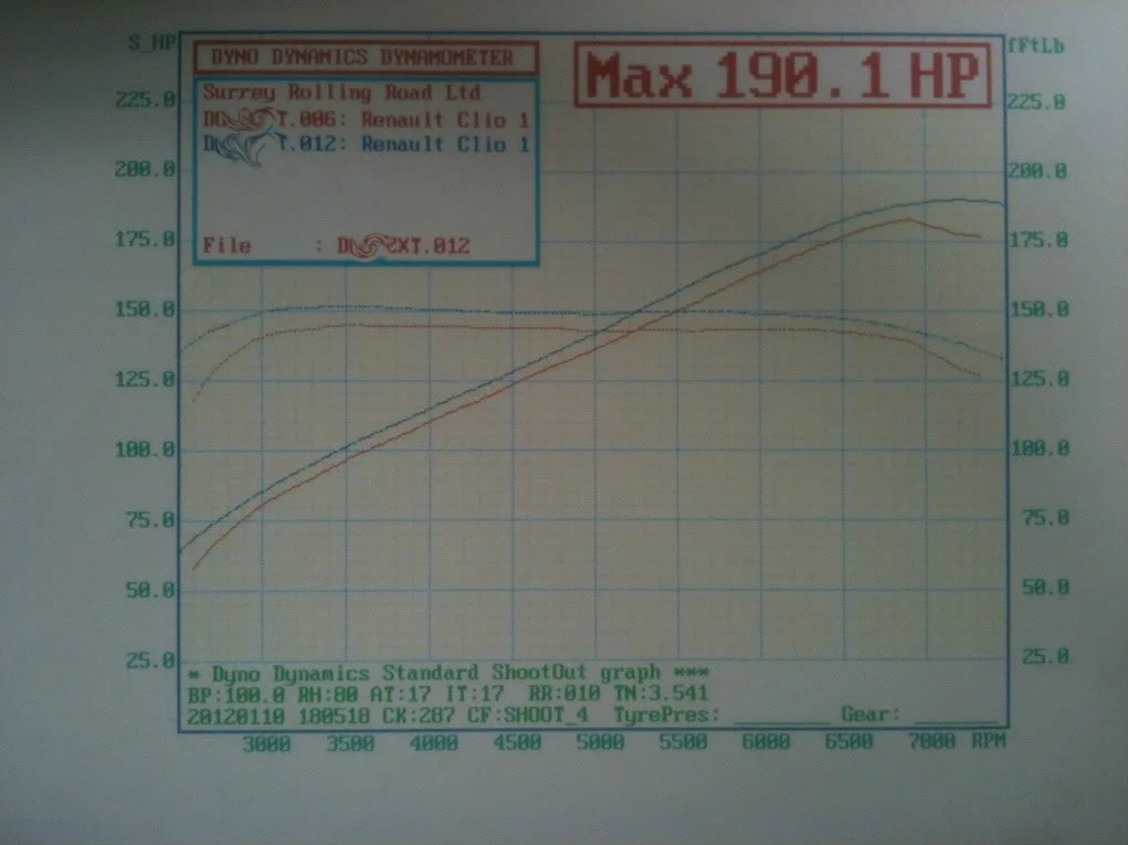

Im looking forward to the day i see an RS2 that manages to break 150ft lbs on a stock engine. I think i'll be dead by the time that happens though.
Here you go mate:
Holy s**t 151ft lb.
I had an incling you'd post that graph (i do remember it for being the flattest torque cover ive seen a while back). That was a "healthy" one. Not seen another one get close to that.
Holy s**t 151ft lb.
Or the other way of looking at it is 3500rpm during which it never goes below 148.
Personally I would much sooner have a good spread of torque than a slightly higher peak figure for only a small portion of the rev range
IIRC you said on here that you got rid of your 438s because they were too peaky and you didnt like the fact you couldnt easily keep it on the boil? So I would have thought you of all people would appreciate the effectiveness of an RS2, especially on track?

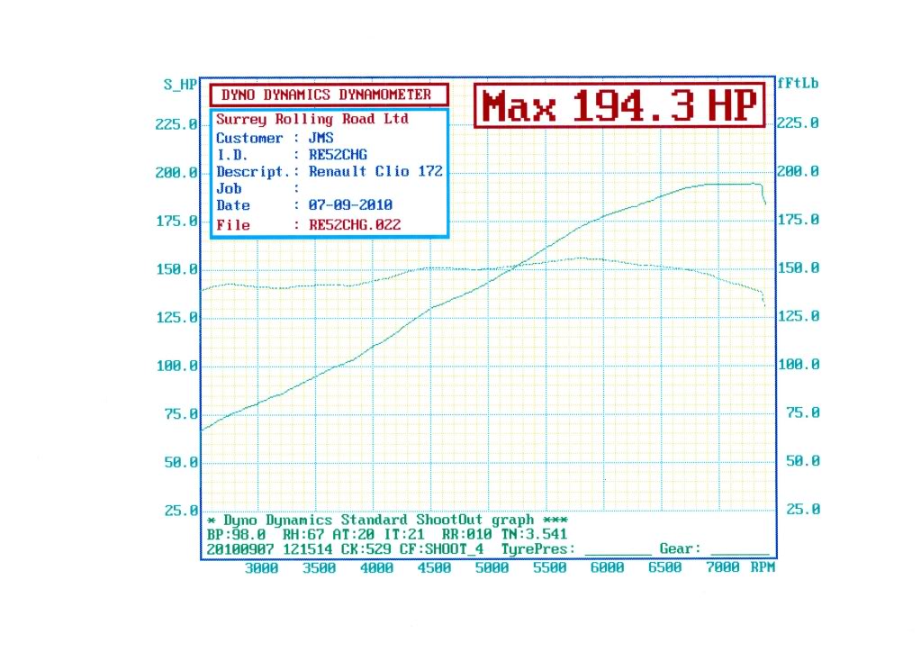

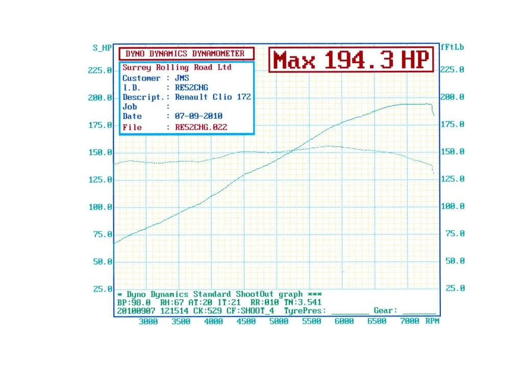

Here is me in our RS2 car for example, still with the leather and aircon, I absolutely love how massively tractable the engine is:
http://www.cliosport.net/forum/showthread.php?660036-Video-of-our-RS2-clio-172-at-combe-today
Disclaimer, that car does have 197 cams as well, but thats only increased the top end power slightly, hasnt done anything to improve the spread of torque, thats all down to the RS2

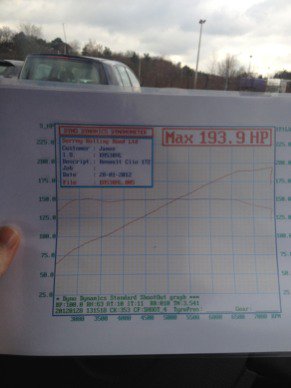

Here is -J- with his RS2 (164bhp as a standard car, so not a freaky powerful one to begin with or anything) mods are just exhaust mods and mapping and RS2:
TBH from talking to Mike @ MWM, it is pretty much normal for him to get these results, obviously the F4R is famous for varying, but in his experience (which is more than anyone else has I would imagine) they make those sort of numbers more often than they dont, I think that a lot of people (including yourself) probably are thinking of the figures that people were getting before James teamed up with Mike from MWM to do the mapping, so IMHO a lot of the previous lower figures were because they simply werent mapped as well as Mike does, so it wasnt a problem with the product, just with the people mapping it not knowing what they were doing well enough (or possibly knowing but just couldnt be bothered as it wasnt their product?)
