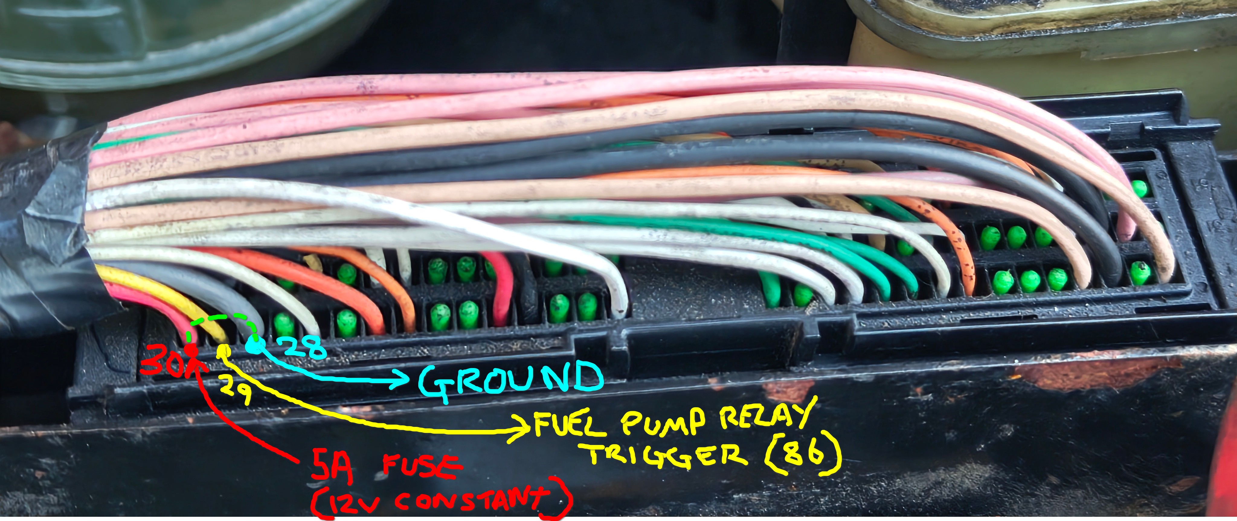

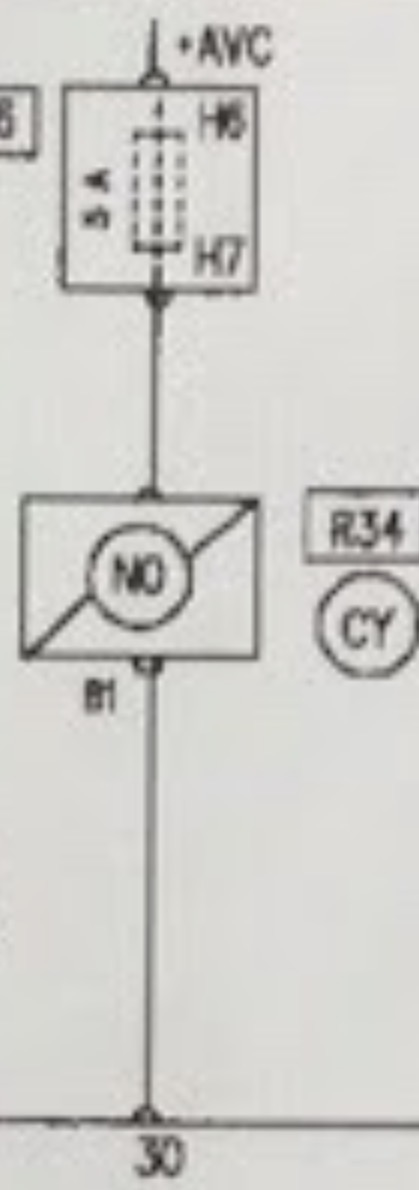

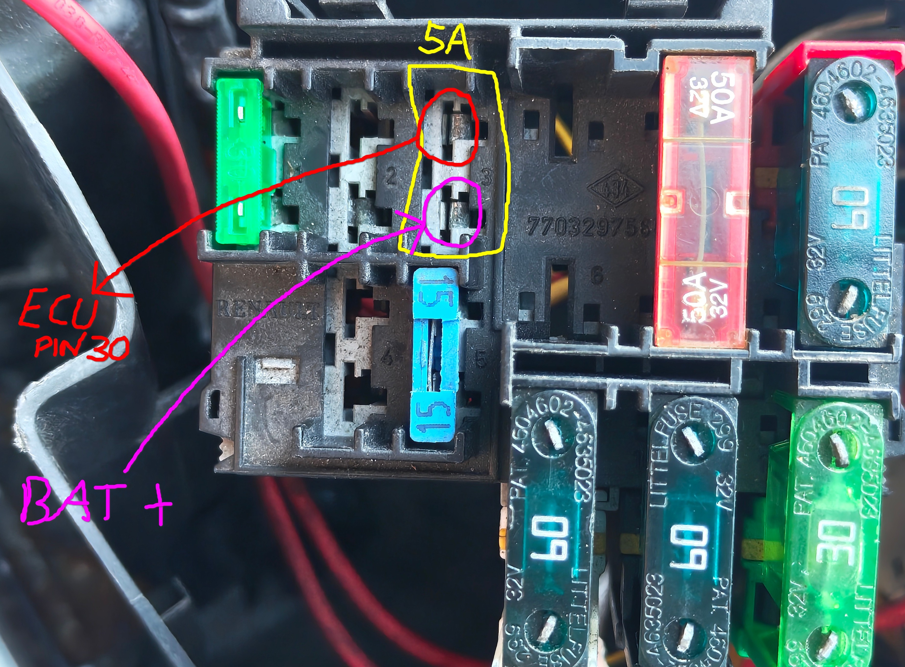

Lots of electrical testing later has revealed that the 5A fuse in the engine bay fuse board blows as soon as the negative battery terminal is connected (ignition fully off). This fuse appears to sit in-line between the Battery Positive and Pin 30 on the ECU harness. To eliminate any other parts of the circuit shorting to ground, while testing this the fuel pump is disconnected. Inertia cutoff is disconnected. Relays are all pulled out.
Multimeter on the 5A fuse holder shows a nice clean 12.38V to the battery + on one side, and a direct to ground continuity on the other side (red wire going to ECU). If I disconnect the ECU harness, that continuity to ground goes away. So question 1, is that expected for it to reach ground through the ECU when the harness is connected?

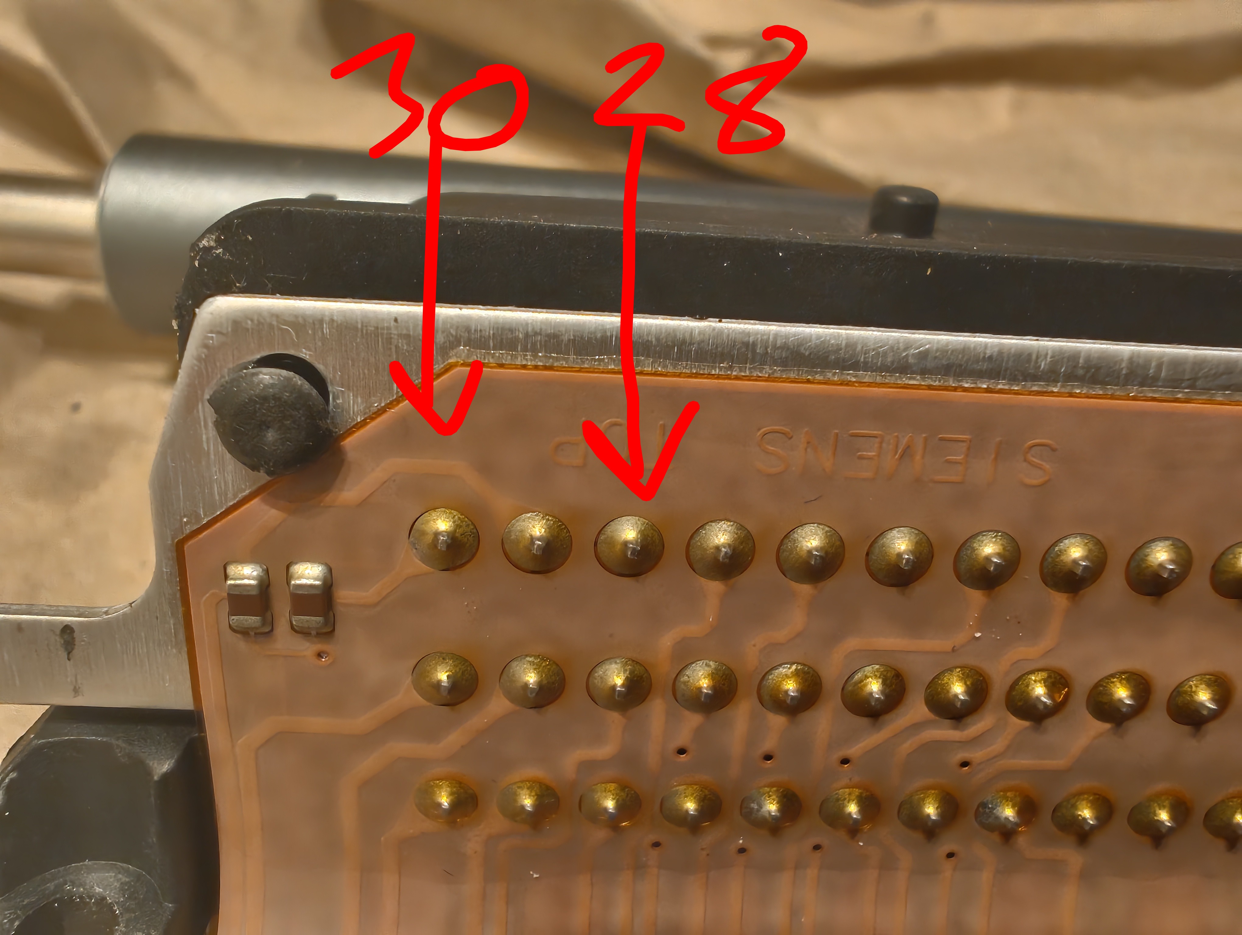

A second observation is that there is continuity through the ECU between pin 30 (our 5A fuse) and pin 28 (ground wire). Which explains why the fuse goes to ground when the harness is connected, the ECU is bridging pin 30 to ground. So question 2....is this also expected?

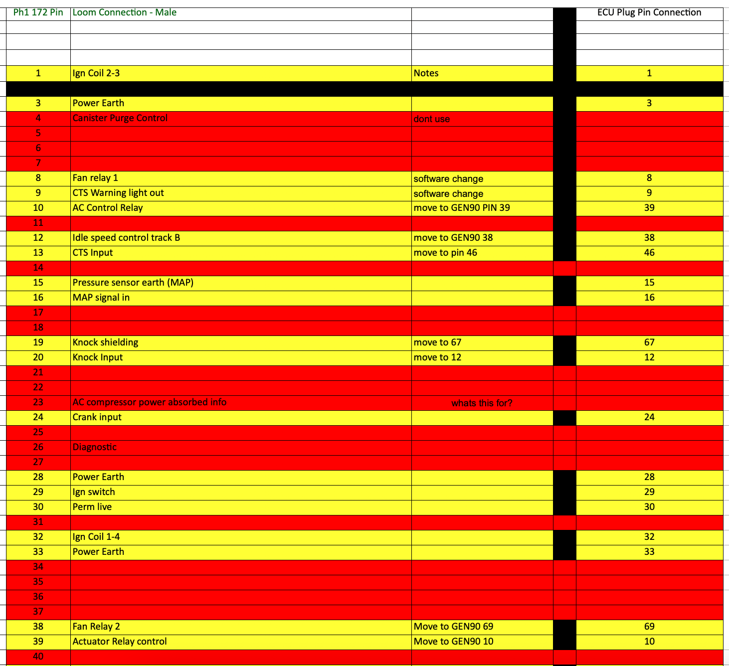

Note sure how useful this is but Kitson's GEN90 thread documented the pins on the ph1 ECU (different to the phase 2 because obviously!). It confirms your pin labelling. But surely if the ECU ever bridges pin 28 to 30 the fuse will blow? Which would point me towards an ECU issue?

There's a thread from kitson about gen90 and fuel pump if you want the other half of that list as that only goes half way.

Taking it apart nothing looks obviously horrendous, though the ground pin doesn't appear to have any traces going to it...maybe it just grounds to the metal backplate?

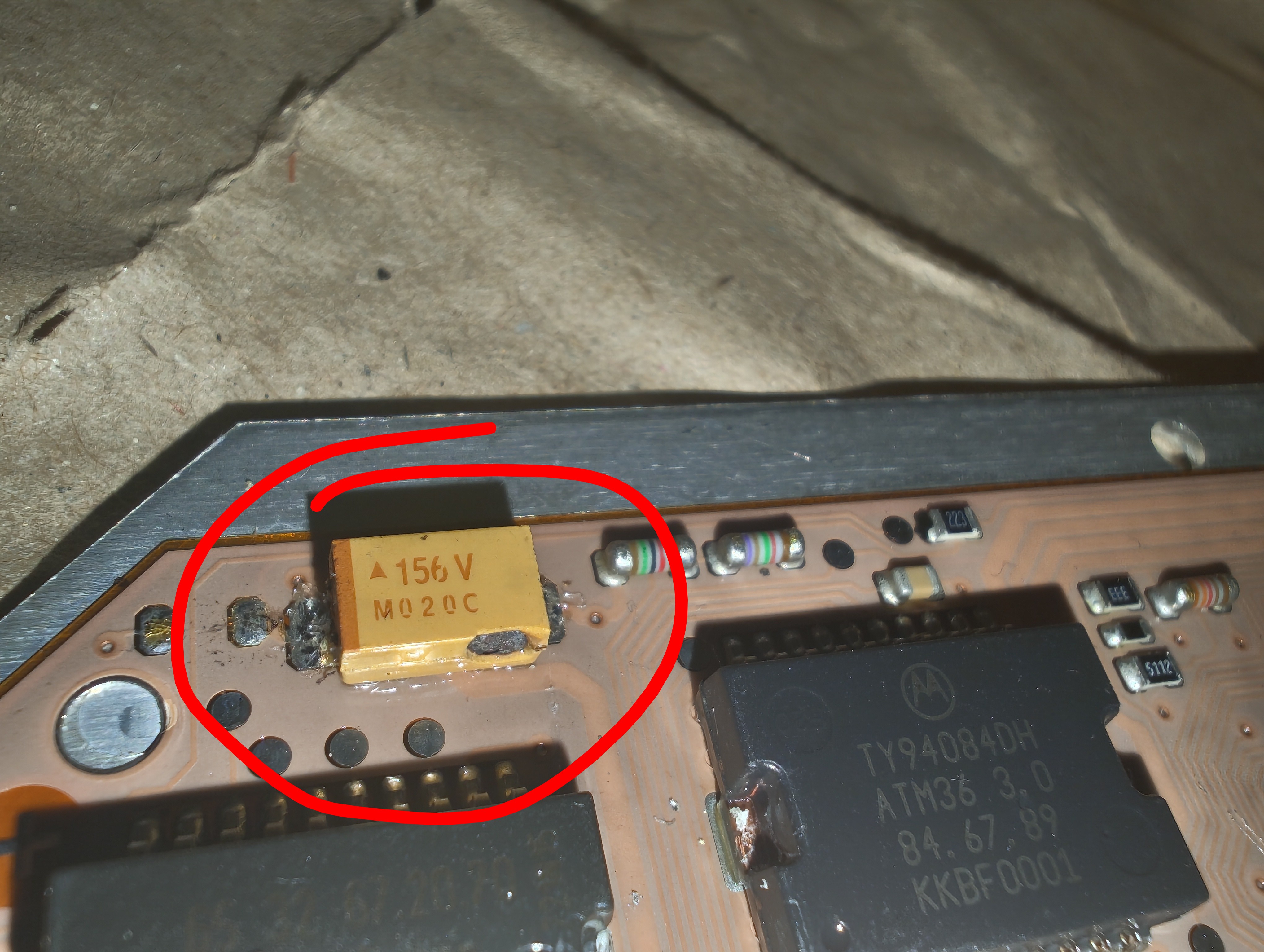

Thought I'd update you guys since you've all been so helpful in pointing me down the right paths, and I think I finally found the smoking gun.
After testing a diode that looked like it had clamped, turns out it hadn't and in fact it was something sitting in parallel to the circuit. That's when I found this capacitor with a nice little hole blown out the side of it.
Took it off and tested between it's contacts, dead short, no resistance. Once removed, I only now get continuity to ground on that circuit with the probes one way round between the pins and not the other way round, which is the expected behaviour.
New ones on order, let's hope that's all it needs!
For anyone coming across this in the future, it's a 15uF, 20V Tantalum SMD capacitor, Case Size C and 1.7ohm ESR.
