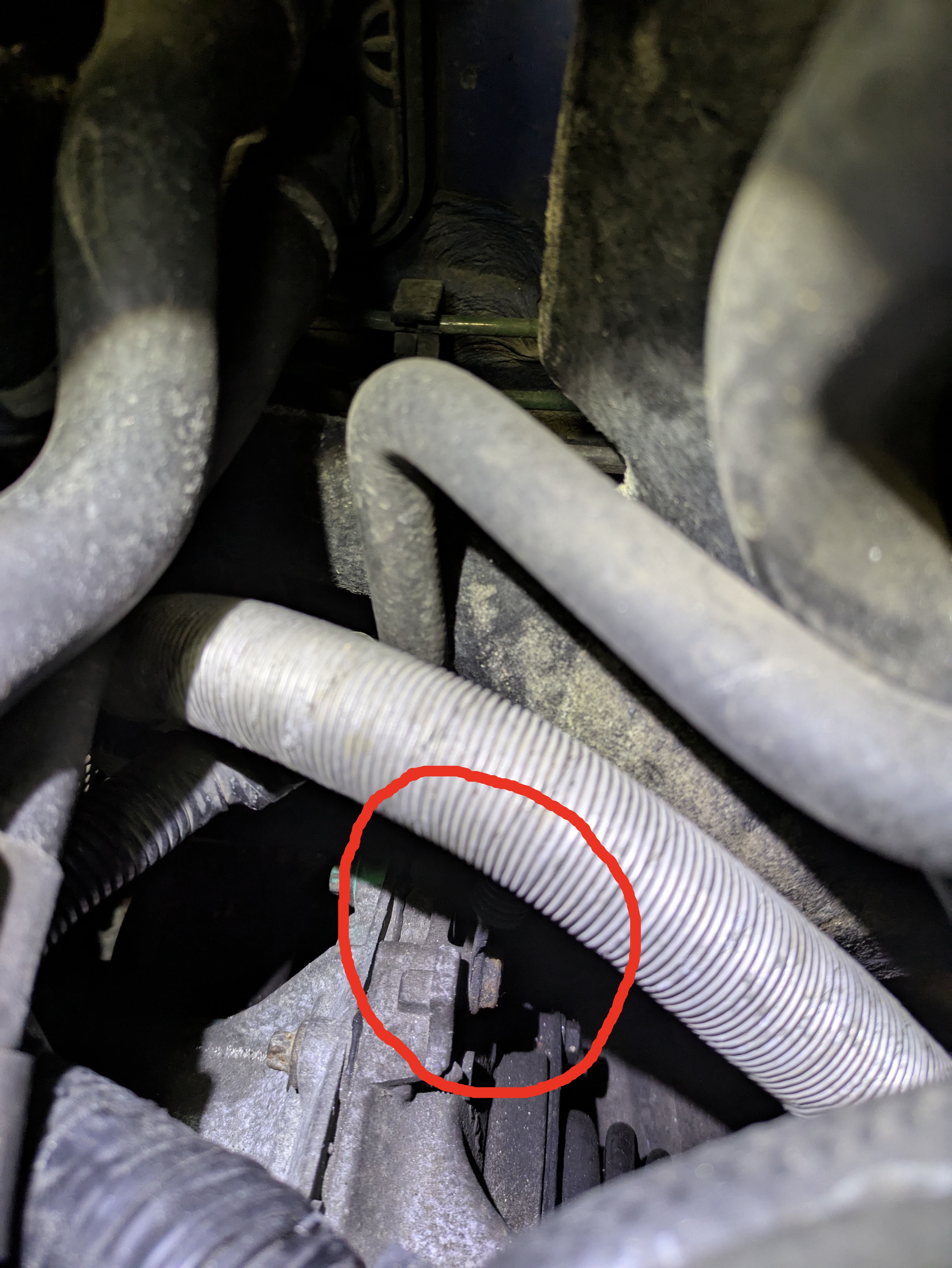

Check the earth on top of the gearbox, it’s pretty much directly under the throttle body area. I’ve had that break before with similar symptoms.
Ah right, thanks for the tip! Was looking for it but forgot where it was since changing the gearbox a few years back and could for the life of me not spot it.
Not sure if it was the right one, found one on the gearbox bellhousing towards the firewall, above the drive shaft. Did not try that one specifically as it , gonna give it a new shot tomorrow.

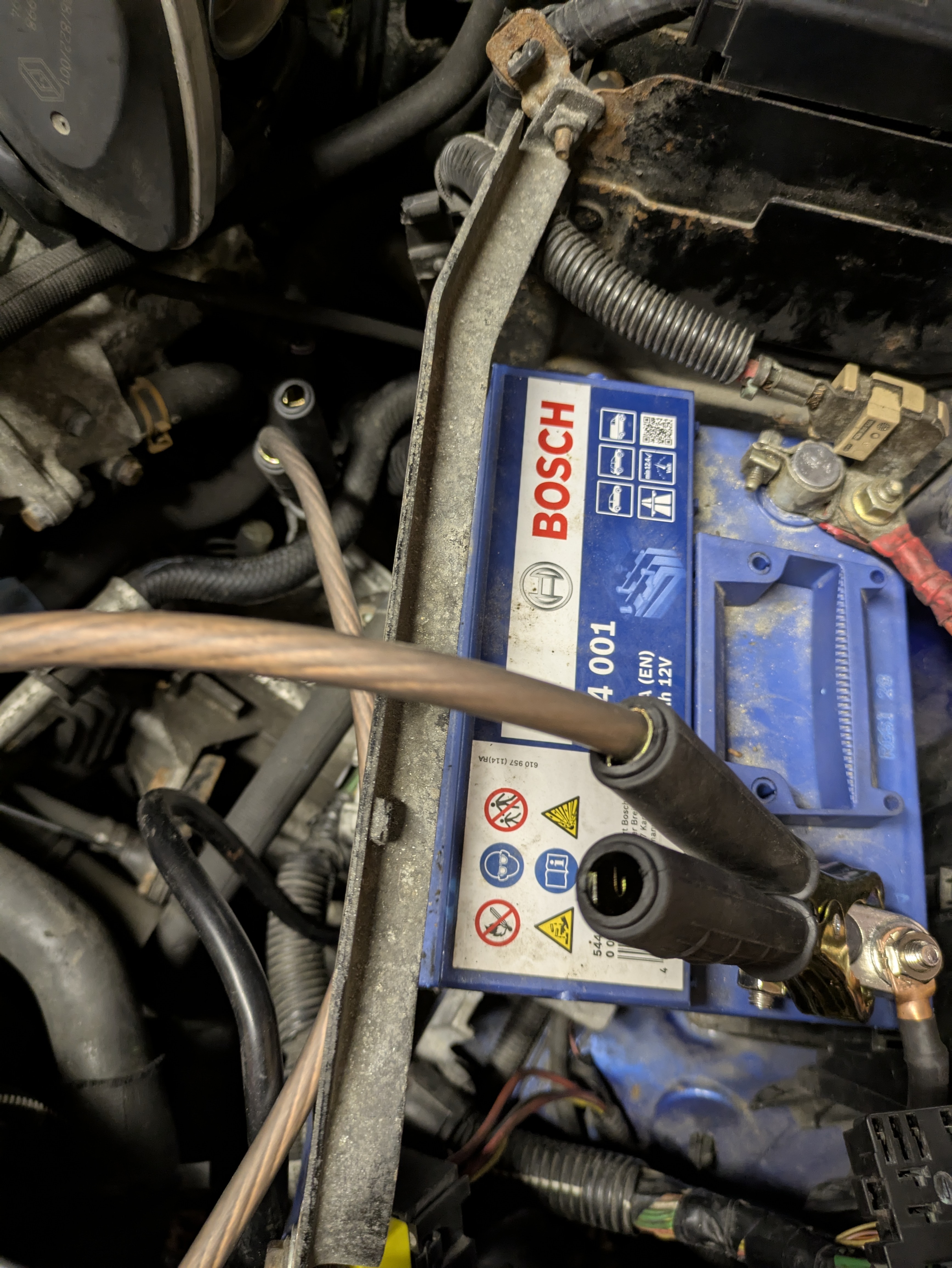

Made a makeshift jumpercable (softer copper and sheath) and tried in a few locations including on the ECU to no avail.
