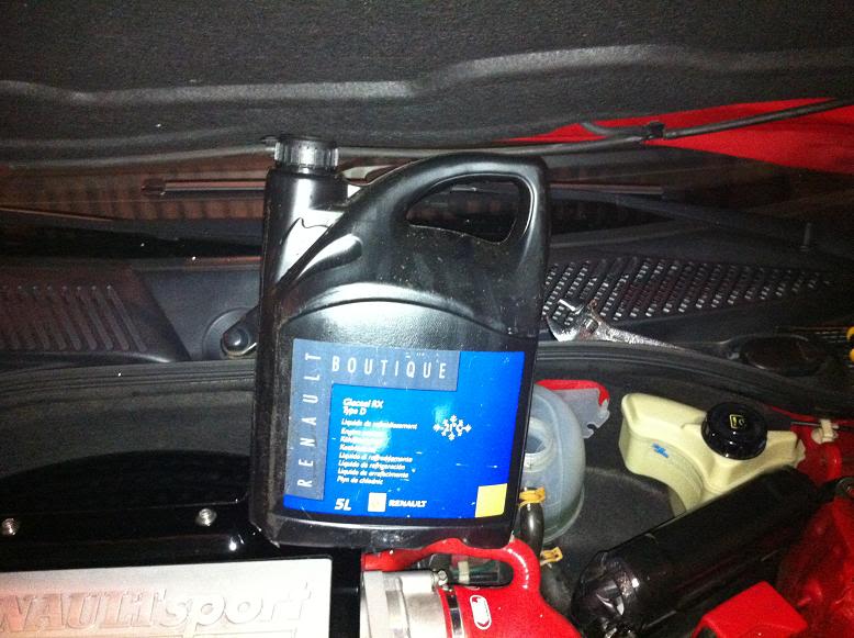

If you have not bought coolant i can drop you off a bottle, I have 7 5L bottles of Type D sitting here doing nothing and i want to move some of them

Type d coolant is the green stuff right ?
I just changed mine and put red oat in have I fucked up ?

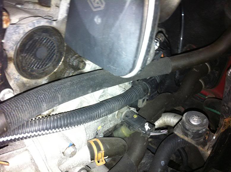

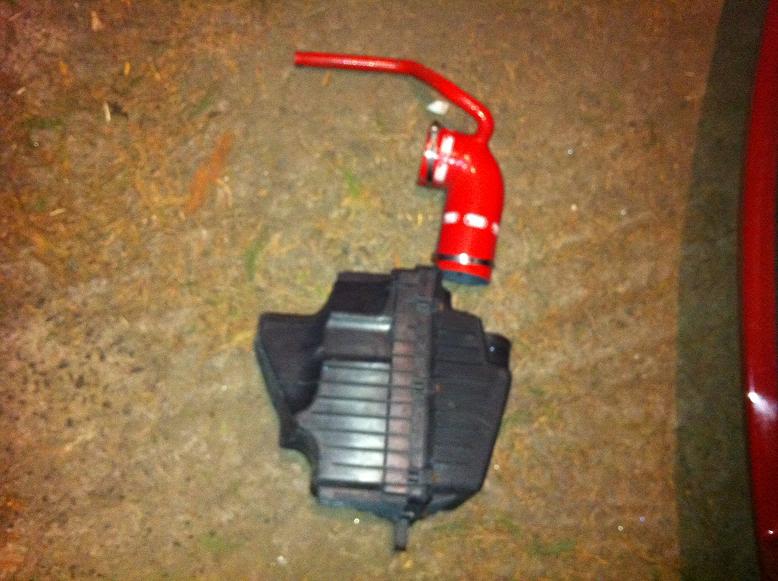

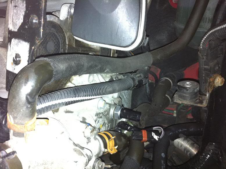

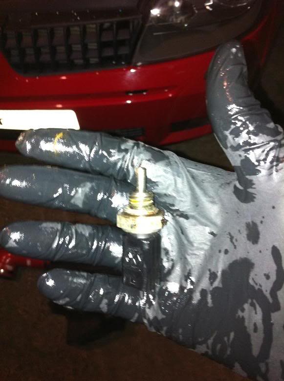

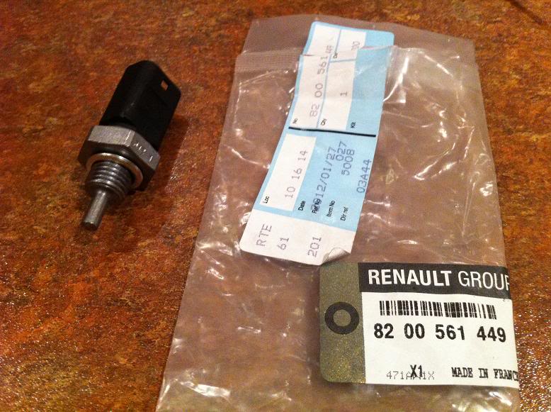

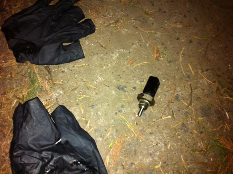

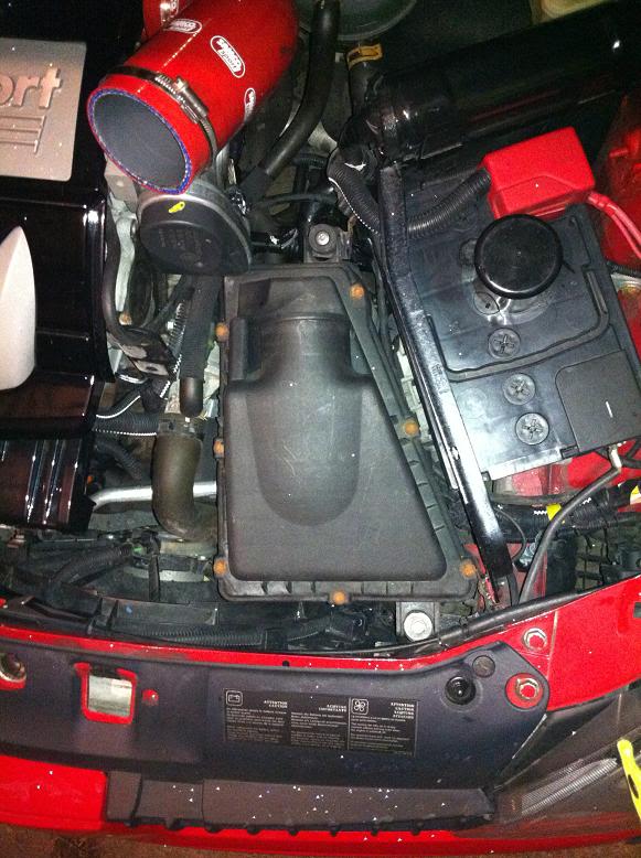

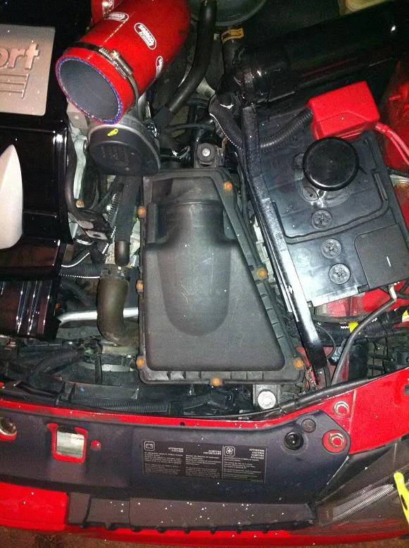

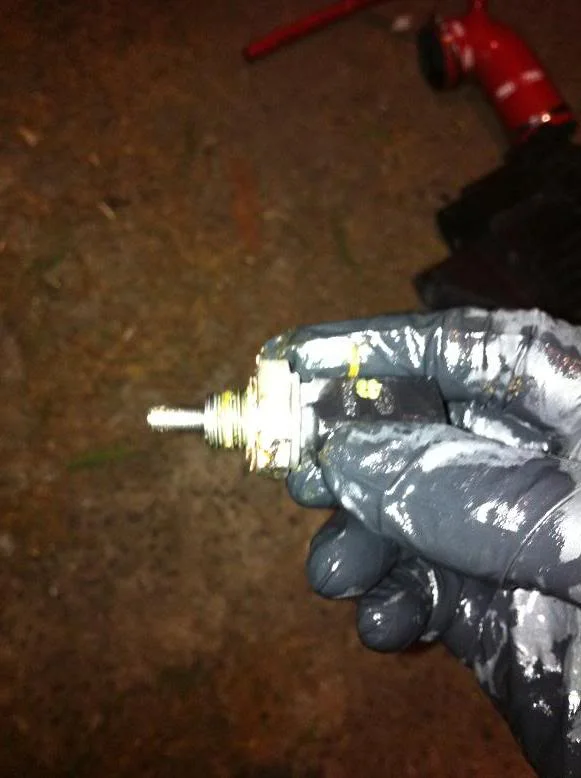

Fitted thermostat and CTS.

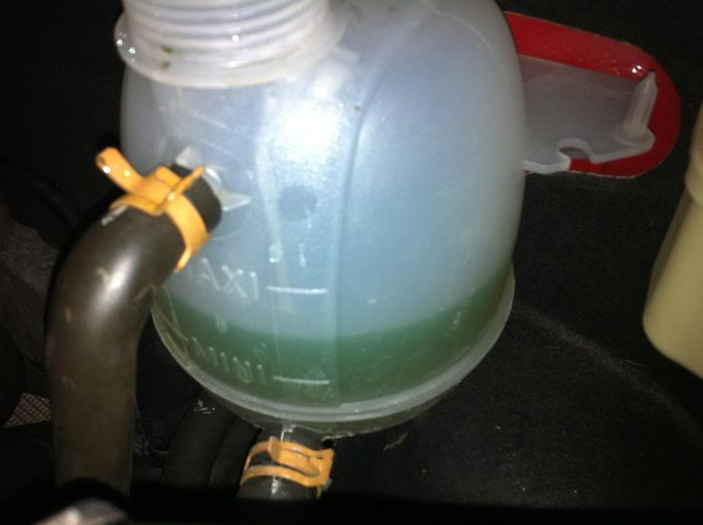

I was a bit unsure of the process regarding bleeding the Coolant but I warmed it up with the cap off the reservoir, popped the cap on and opened the bleed valve till stream of bloody hot coolant!
Rinse and repeat a couple of times then took it for a drive. Everything seems to be working ok, 7100-200 rpm limiter.
Will check when cold and top up tomorrow.

Sounds like the CTS has sorted it. RE: the bleeding procedure, I topped my reservoir tank up, opened the top bolt on the thermostat housing until it ran without bubbling. Topped up again and ran the car until the fan and thermostat opened etc, once car was cold again topped up, and been spot on since.

I had a similar problem, I replaced the coolant sensor and it kept happening. It was actually a duff thermostat, it was stuck open so the engine was too effective at cooling! A replacement thermostat is super cheap and is just literally next to the sensor (the triangle shaped bolt pattern just in front is the housing) so the method is the same.
