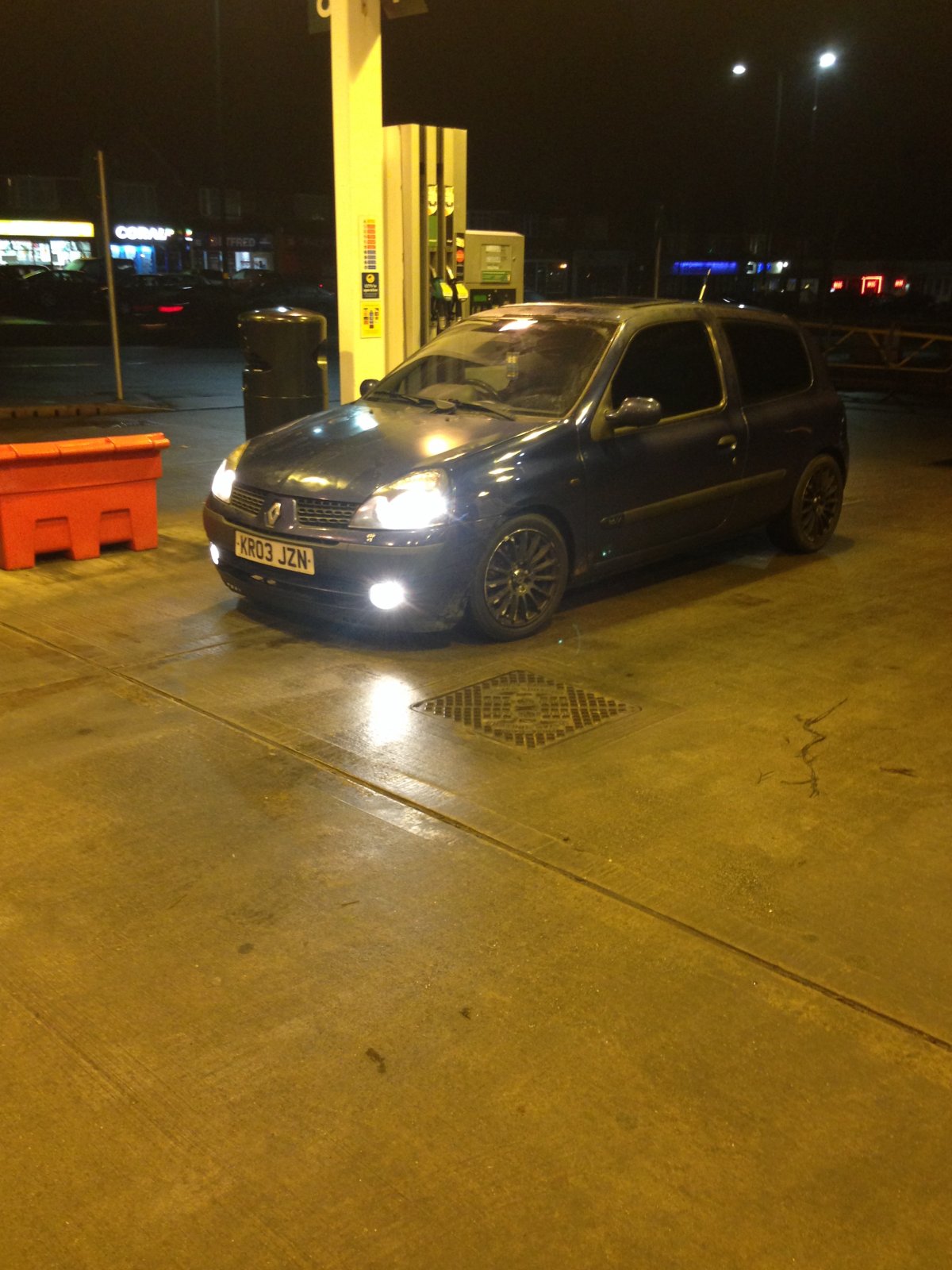

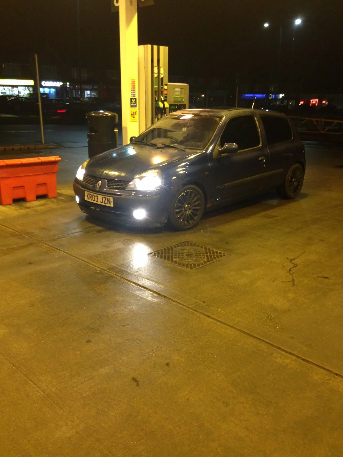

My clio mk2 is lowered on standard shocks and theres at rattling coming from them at speed any idea what this could be?
