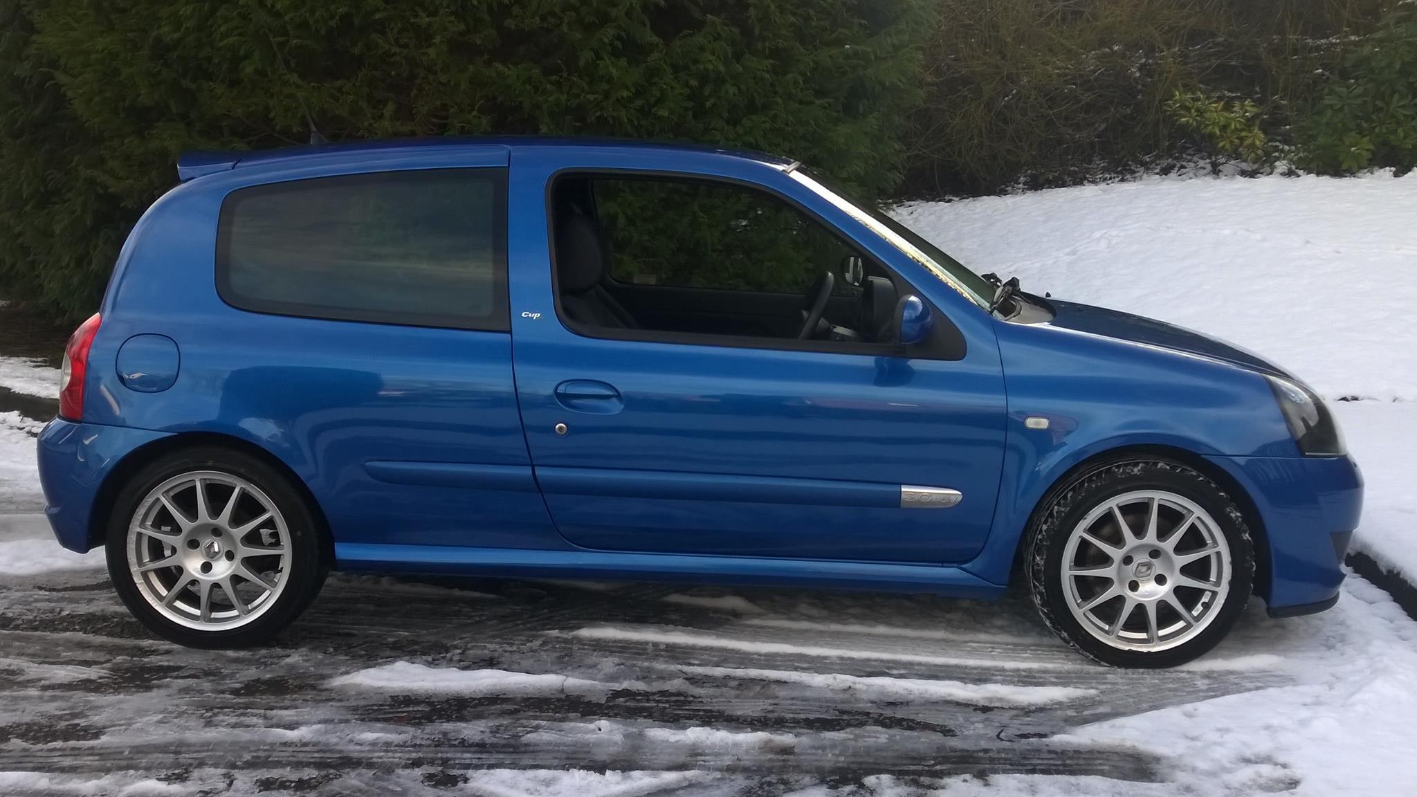

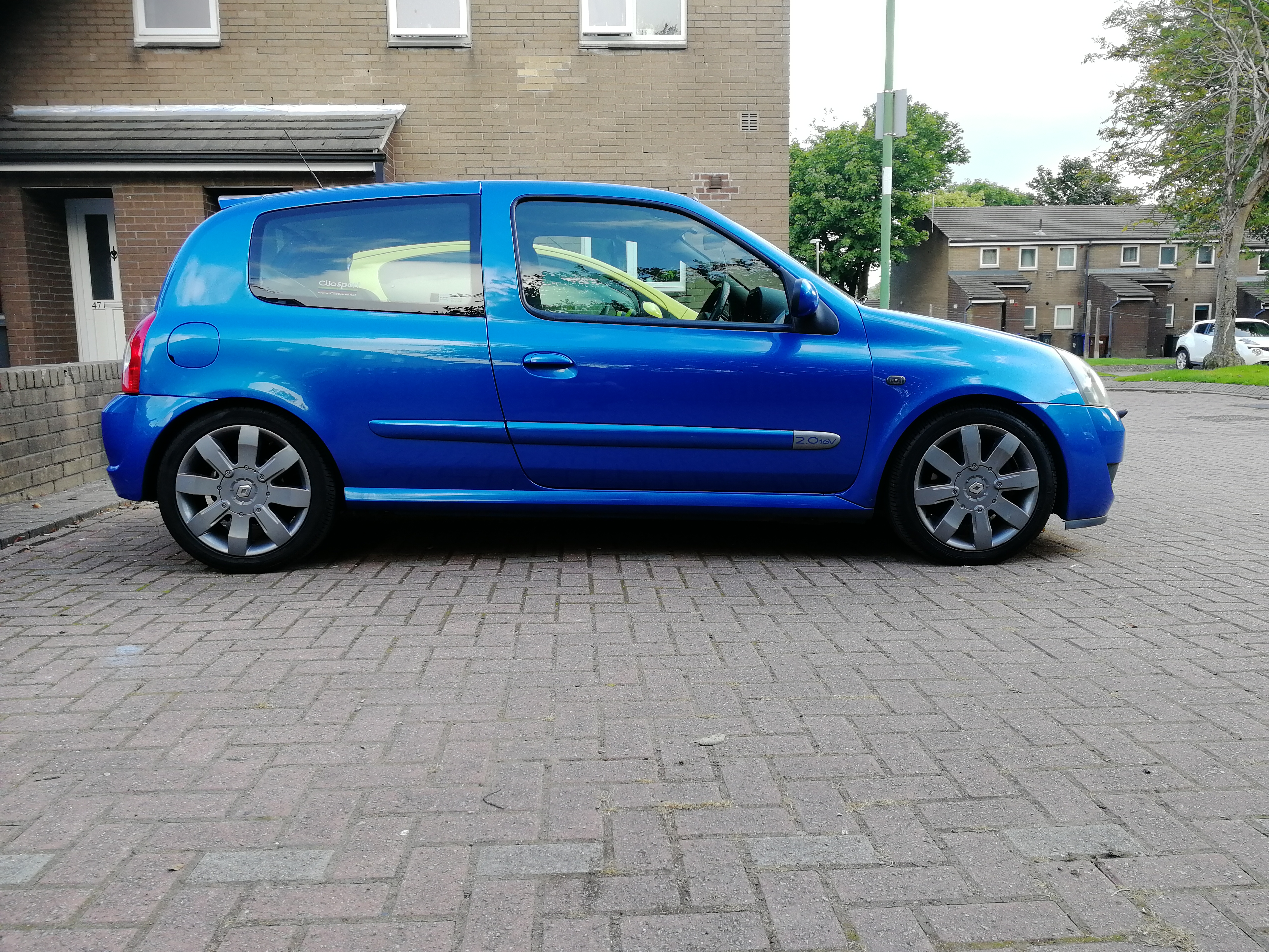

do you have any pics? I feel like i have seen some and they look really low? I have done just 300 miles over the last year it only moves every week or so to keep everything running right.
I think it looks spot on now. Like I said. The drop is only very subtle, about 20mm at most and it's handles so much better.
I ordered on Monday afternoon and they came Tuesday morning. I can't recommend them and Kam racing highly enough 😊

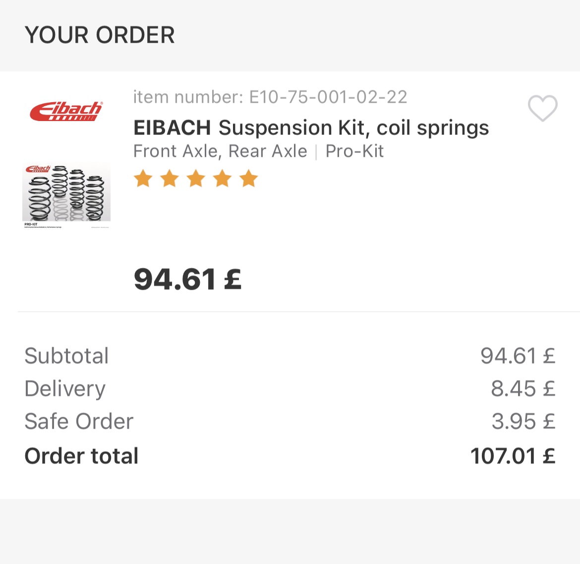

I paid £120 five years ago for front and back set, those came direct from Germany - best price at the time.
You wont go wrong with the Eibach Proline springs, better quality than Renault, ride will be as good or better and will settle after time and look just right, I'm glad I changed over from OEM springs which in my case kept breaking.
will be putting new dampers on too so should feel brilliant as current ones are the 16 year old originals! £107 seems a bargain then if that was 5 years ago.

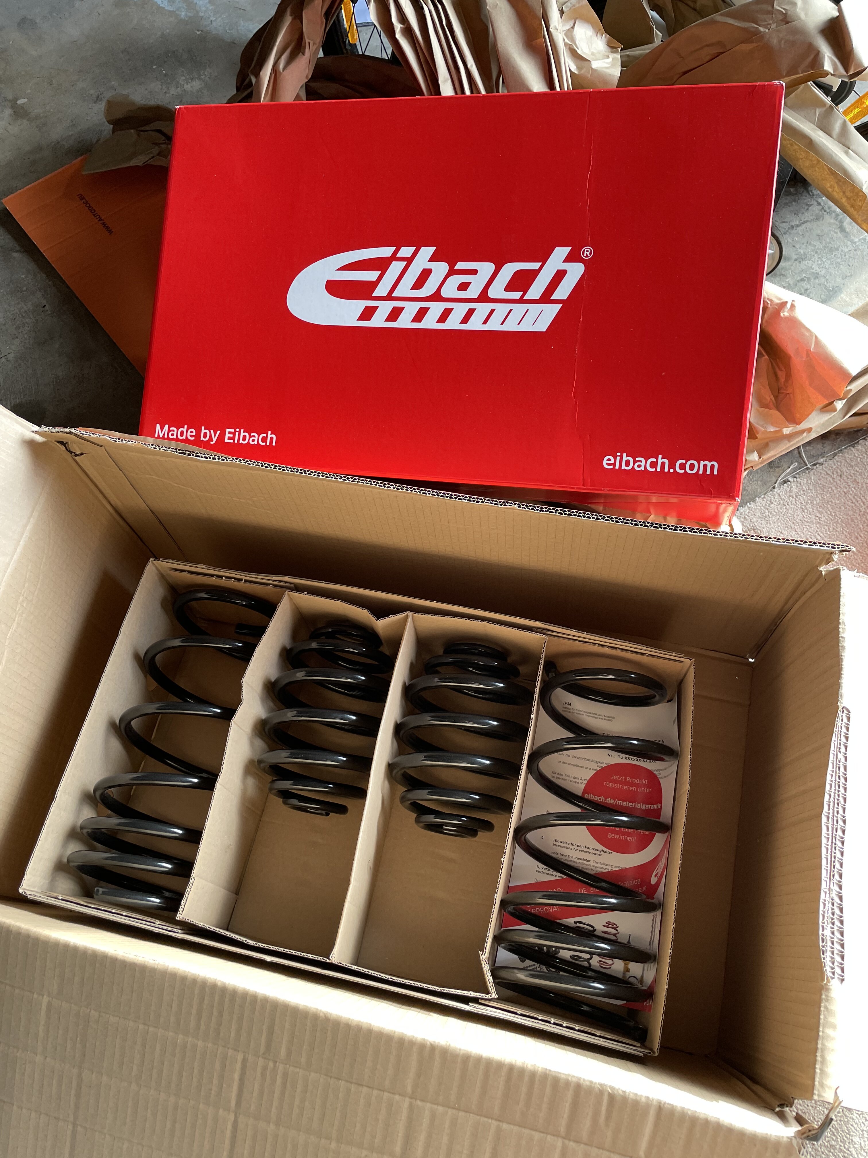

I've ordered the prolines too, being delivered tomorrow....going to get the cup shocks also....what top mounts you going for?
Im going to get febi as everything i read seems to indicate they are the best fit, like the originals before they changed the design. I will be putting it all together with new cup shocks too.

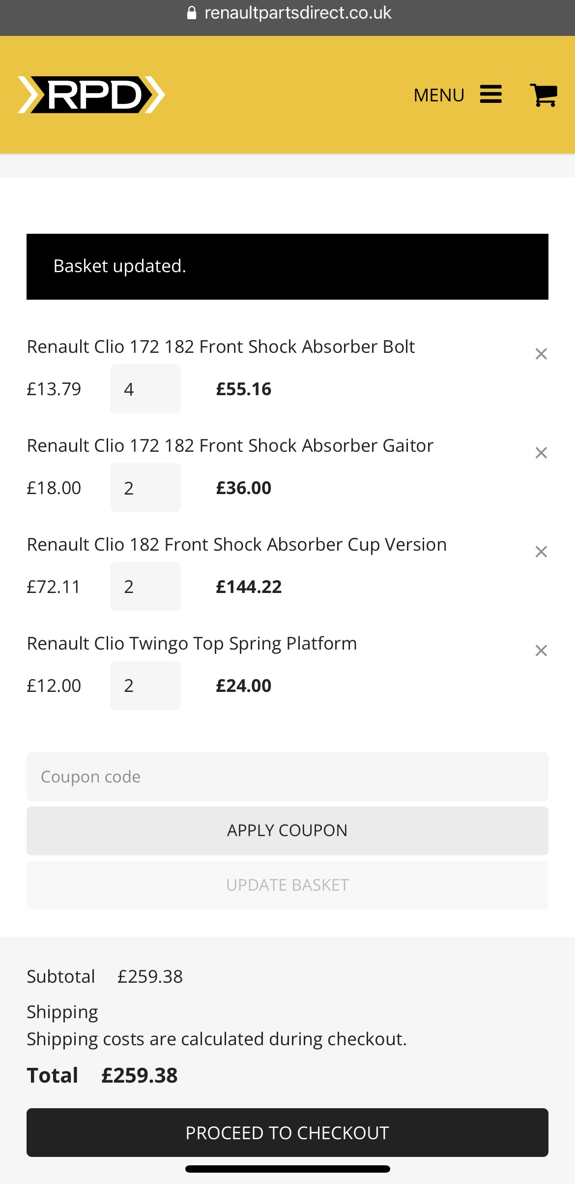

Anyone knownof any cheaper alternatives to renault prices for the bolts and gaitors
£55 for 4 bolts is a disgrace!?!? And £36 for 2 gaitors?!?!

Thanks for this mate, although i have just ended up ordering it all from RPD. I just cant get over the fact a full damper is £70 and 4 bolts are £55 lol.

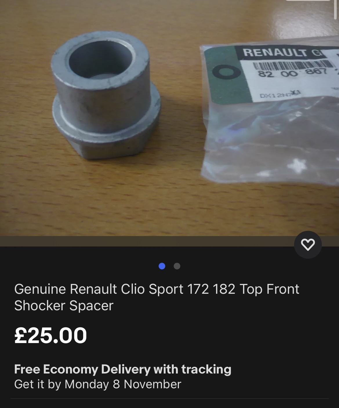

Anyone know what these are for and if they are needed ? I don't remember these on the standard suspension before.
This thread is pretty comprehensive in explaining how these spacers fit with the updated Renault top mounts.
I’ve read on here (and there’s a bit in the above thread) that quite a few people have had issues with these updated/revised top mounts & spacers, so go for the febi version of the original style top mounts - I went for the febi ones when I replaced my top mounts a few years ago and had no issues whatsoever. The febi part number is 37597 If you’re needing replacement items.
edit:- just seen above that you’re looking to use the febi top mounts, so you won’t need those new spacers.
