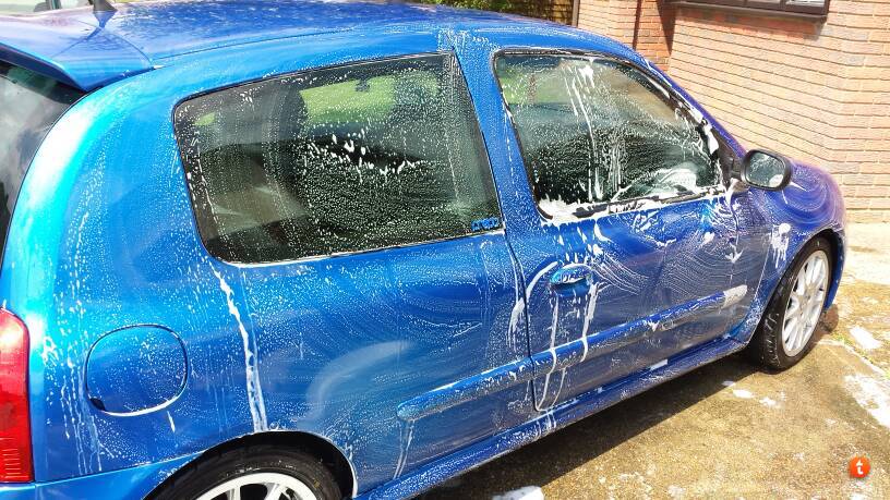

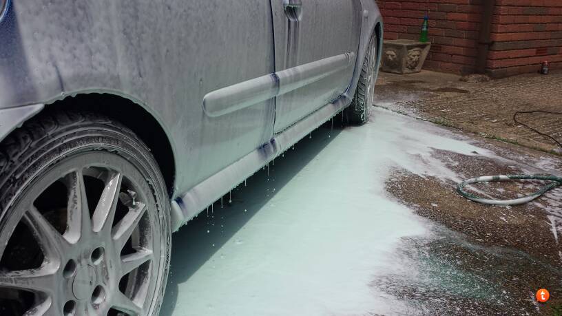

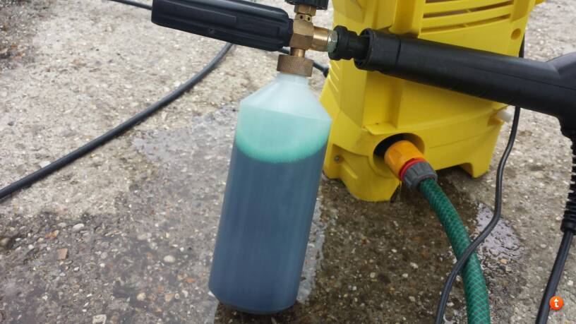

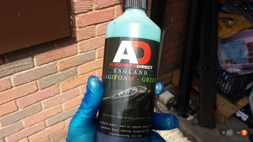

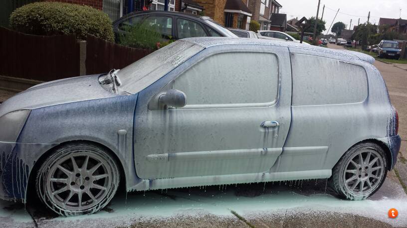

After giving it a quick blast with the pressure washer I used Autobrite magifoam green
Then after 15 minutes I rinsed the snowfoam off then got down to shampooing in which I used Autobrite Purple Velvet (Amazing Smell) :)

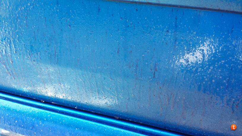

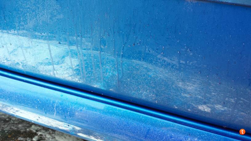

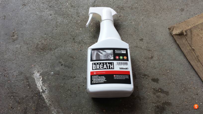

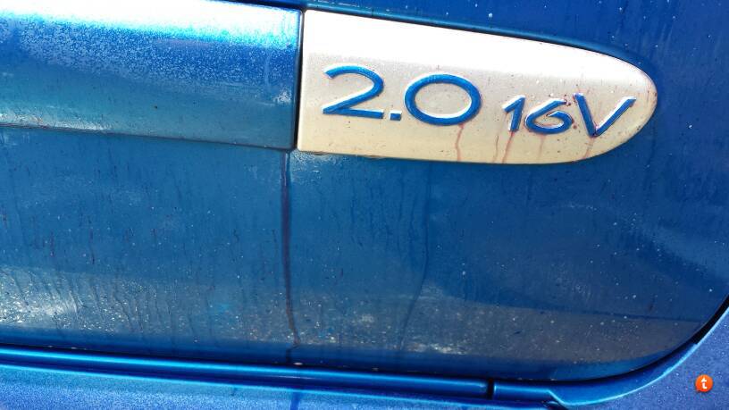

I then whipped out the iron x and for this I used valet pro dragons breath. Got plenty of fallout of her which I knew I would of as paris has never waxed it since hes owned it
I then gave it a 2nd shampoo with purple velvet & used my meguiars lambswool mitt and done the wheels aswell & then dried her off with a fluffy drying towel & then gave it a quick QD with Autobrite berryblast

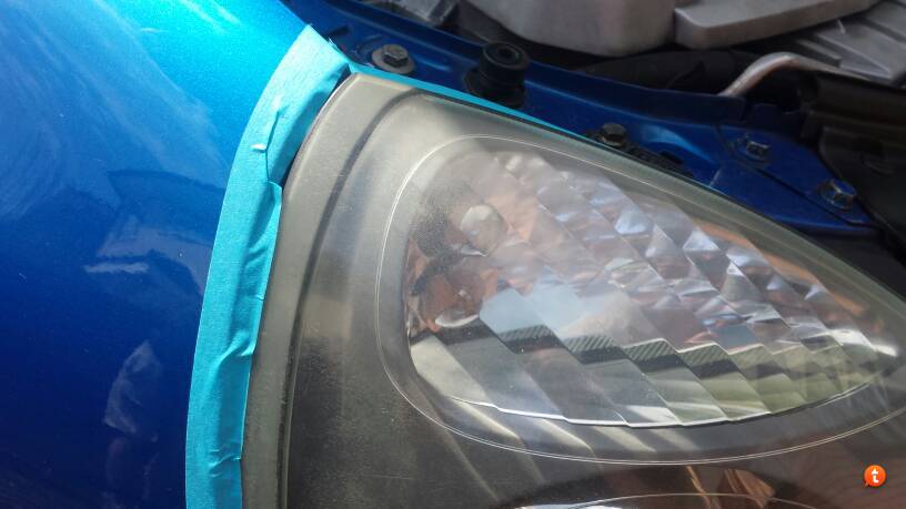

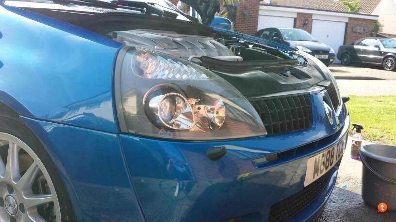

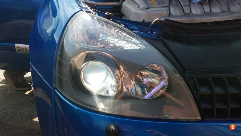

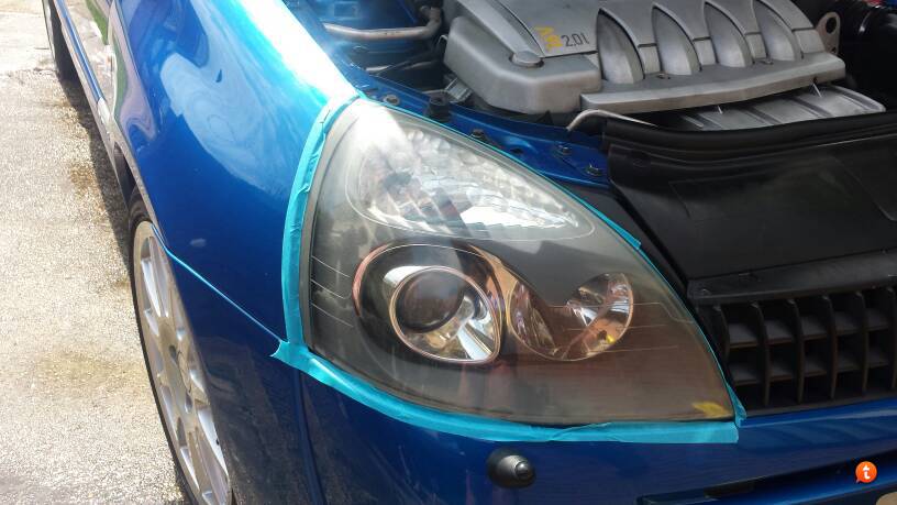

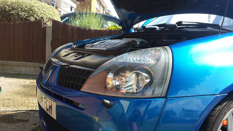

So then to the headlights. I masked them off with 3m tape so all the water & compound never got in the gaps
As you can see from the pics above the headlights are quite hazy so I used wet & dry sandpaper starting off with 1500 grit then going through the grades with 2000 2500 and then 3000 grit then finishing off with G4 compound

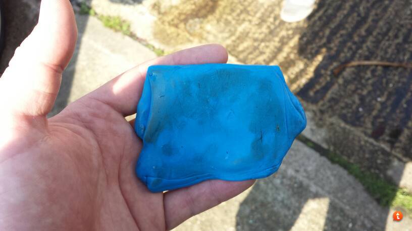

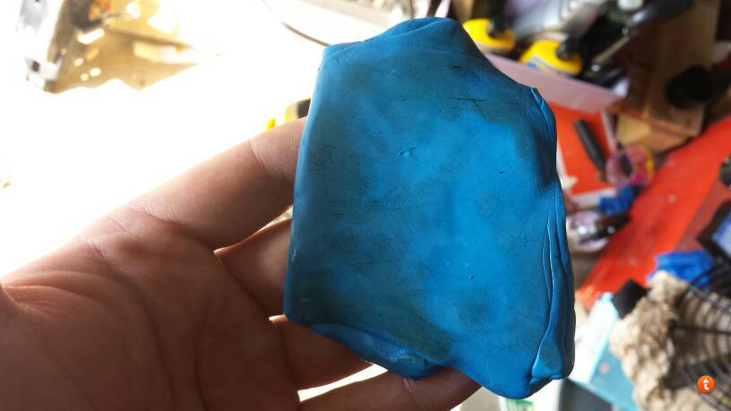

So the headlights come out ok, much better then what they were anyway so I then got back onto the cleaning and got the Claybar out and pulled plenty of contamination out of the paint

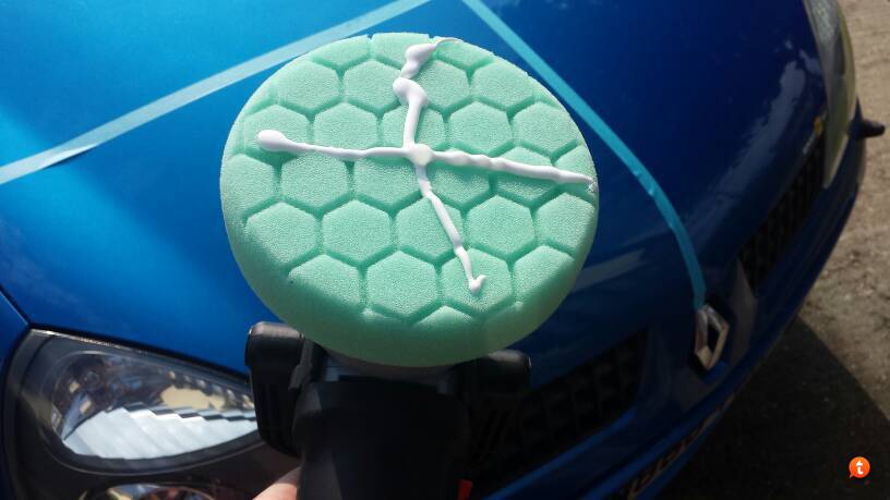

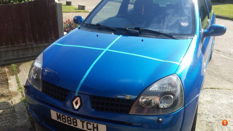

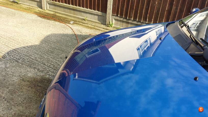

So then the DAS6 come out so I masked the bonnet of in 4 sections and used a green hex pad & the product used was menzerna IP 2400 and then finished off with poorboys blackhole

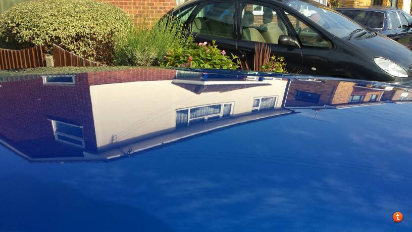

And heres a shot of the bonnet once I done it

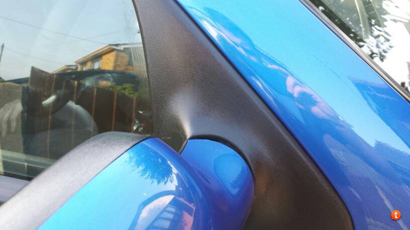

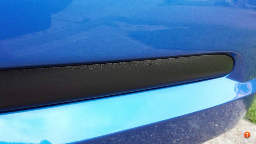

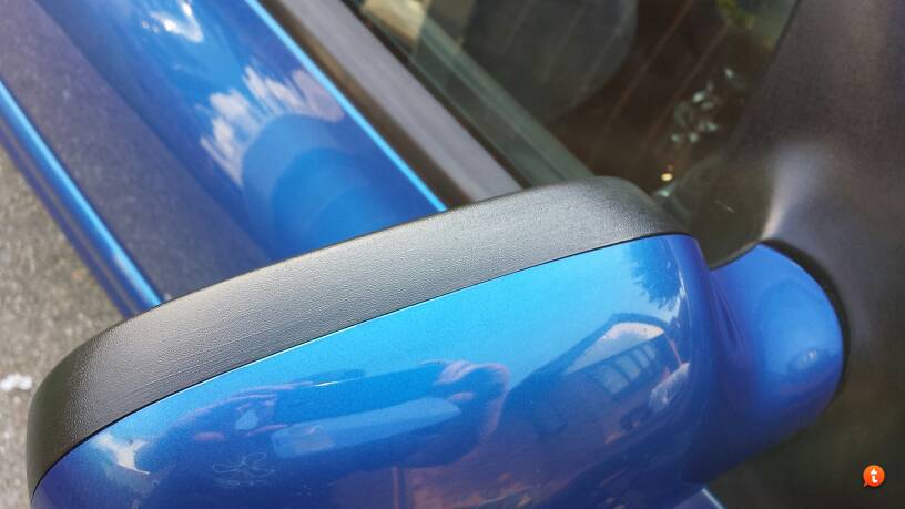

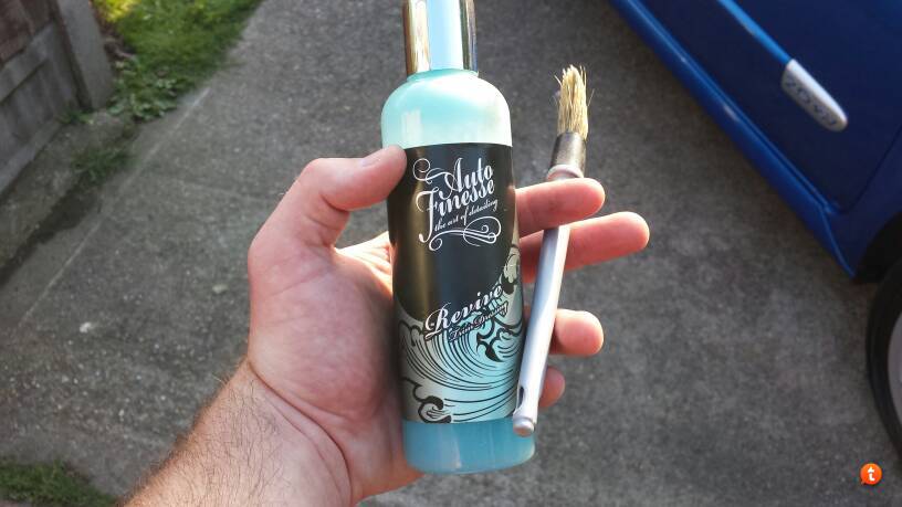

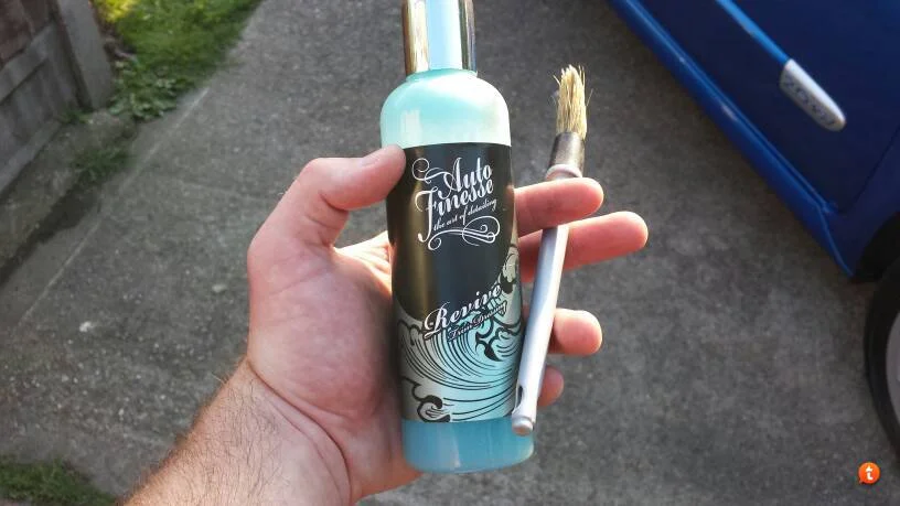

And after waxing I then did the final touch ups which was trim restorer which I used auto finesse revive with a brush and polished up the exhaust with auto glym metal polish

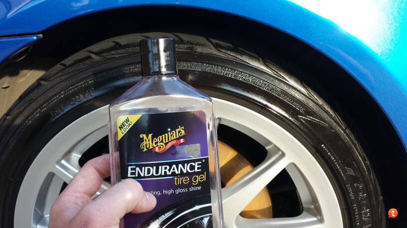

Then I got the meguiars endurance tyre shine out

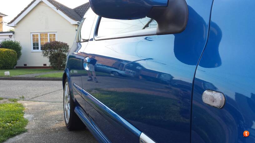

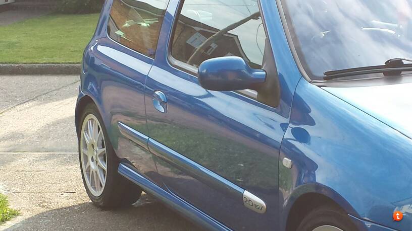

And thats it. 7 hours later we have one very clean artic 182 which paris is hugely happy with. Its now very clean indeed and im also very happy how it came out
Heres the end result

- a couple of the marks on the clay look like Tar marks, so worth adding a tar remover in to your decontam routine to prevent this
- Revive looks like it needs buffing off, but great idea on application as long as you're not over applying. Won't do any damage, just wastes product :)
- 1500 grit W&D paper is possibly a tad overkill, but thank god someone has finally followed up through the grades correctly. I've been saying it and seeing it for years! Yeah, just buffed it after 500 grade... :dead:
Headlights have come up really well chap. Very pleasing results.

Cheers JD. It actually wernt to bad for tar. Ive just ran out of oblitarate :(
I only used a tad on the brush. It spread quite nicely which was good next time ill buff it which will be shortly as im in the middle of washing mine for FCS lol
I was going to start on 2000 but paris had a line in the headlights so I thought I would attack it with 1500 lol

Nice work Kyle, I would also say too much product on the pad, will sling and waste a fair amount.
I usually start with 1500 too, work up through the grades but being very thorough then hitting it with machine, usually menz 2500 followed by 4000.

If you don't buff revive properly it will streak/run etc mate that's all.

Also look at Junkman's videos for priming panels aswell as the pad. 4 pea sided blobs, spread at speed 1 then stop, just enough to cover the area. Then another 2/3 pea sized blobs worked at a higher speed. No zenith technique. Just works so so well and so quick.
Cheers ant & yeah I should use less lol. I will have to come up the unit soon and learn from ya lol

Oh will it ill remember not to do that next time ill buff it after ive used it. Ill check that out cheers gally much appreciated :)

Yeah 1500 on the headlights is no biggie, I used it on my old mans car when I did his, got them looking like new.
