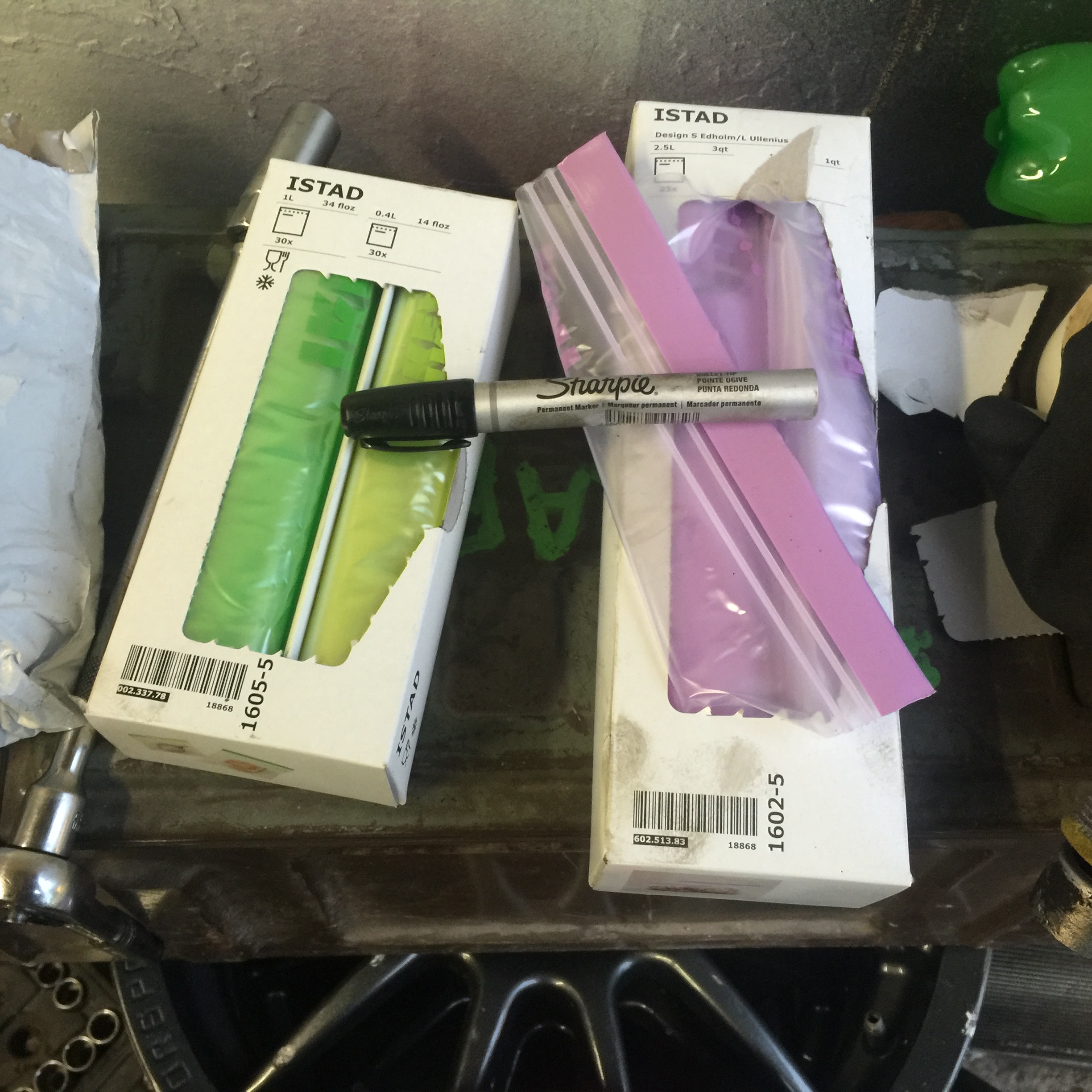

Quick tip, Ikea food storage bags are excellent for storing parts in, good and sturdy and cheap as chips.

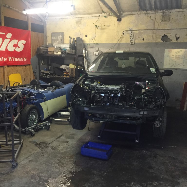

Bad news is that the torrential rain yesterday resulted in this mess:
Dave did get the front suspension partially stripped yesterday so as long as i can get this loot cleared up i might just be able to pull the engine and box today.

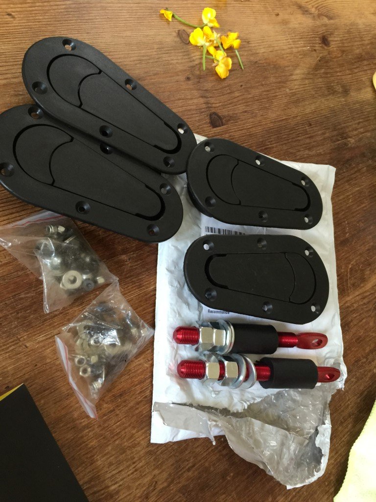

A word of warning - there have been instances of the cheap Aerocatch replicas failing. Considering failure is likely to result in a repair spend, proportionally higher than the difference between the copies and genuine - I'd give it some thought before you fit them.
Is that workshop susceptible to flooding? Anything ruined or were you lucky?
I have original Aero Catches here to compare them with mate and there seems to be very little difference. The material seems to be comparable, i think its a glass reinforced plastic on both. I can see no difference at all between the posts. I know what your saying but we will probably leave the original bonnet latch in place for a bit just for some insurance. the rears im not worried about as the failure mode would result in nothing more than a lot of noise!
Workshop has flooded before but normally just the 2 foot in front of the door, yesterday was the first time its been that bad and we have been here for 5 years now. Luckily my mate Dave was up here so spent most of the afternoon clearing stuff up off the floor so nothing seems to have been damaged.

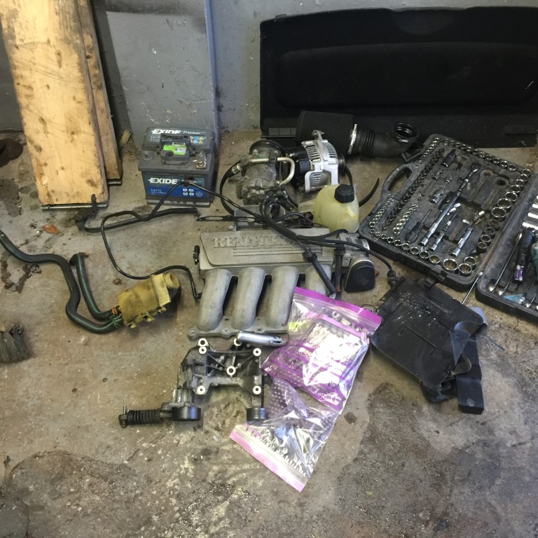

Got the sound deadening removed from the engine bay as well as the closing panel for the heater.
Removed the heater completely from the engine side of the bulkhead.
