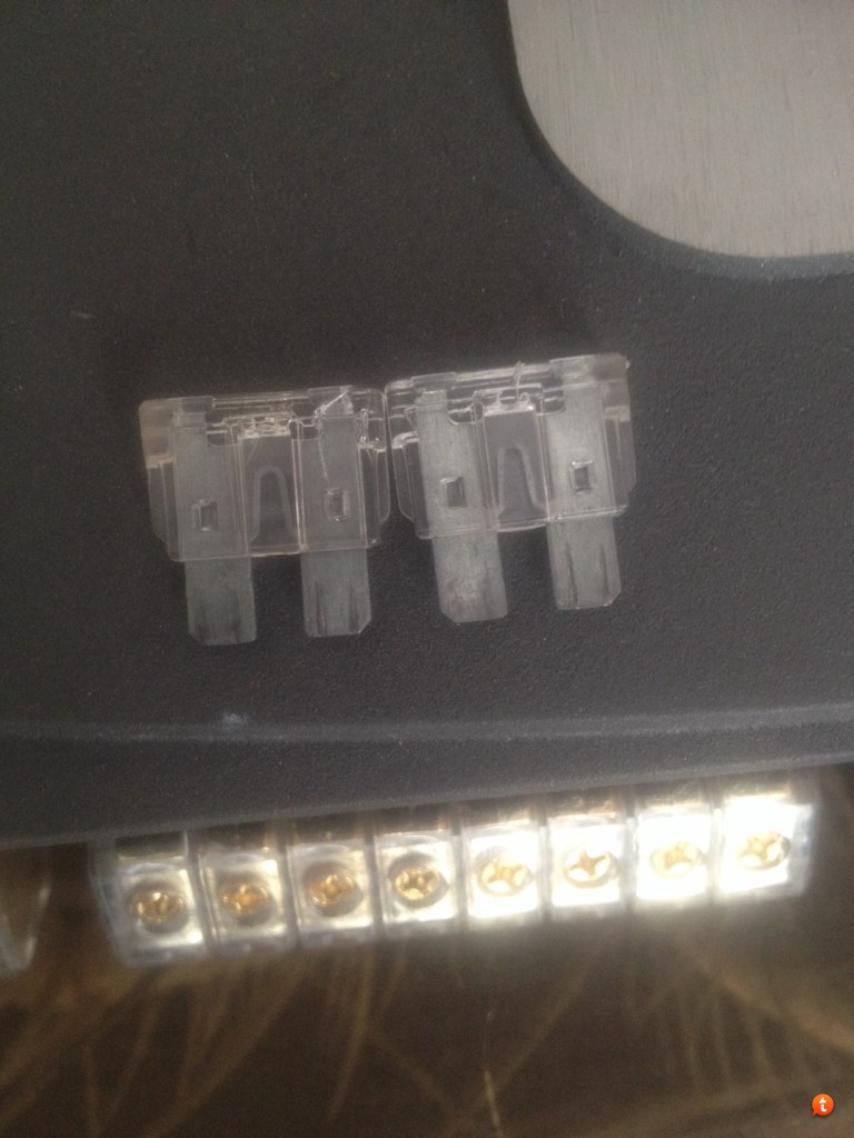

I would change it it have you also checked the fuse on side of amp and also the earth as well

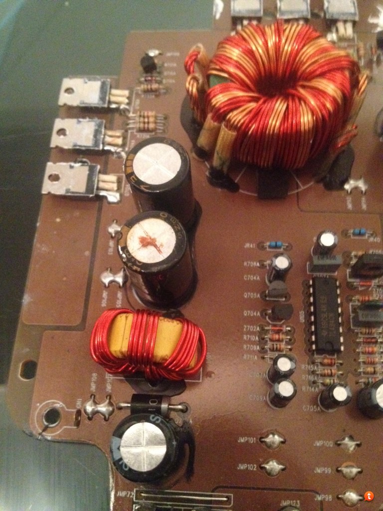

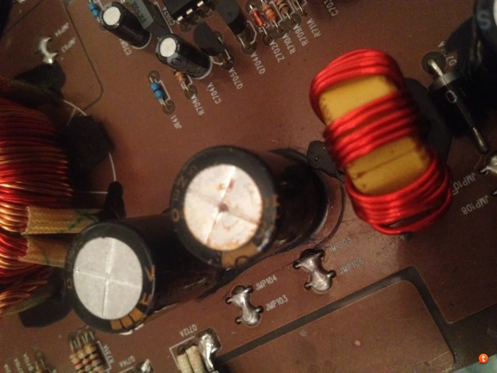

what does it smell like? (serious question)
the cap on the left above the inductor has something on it (residue?)
  Mk3 1.4 clio
I gave it a good sniff and it don't smell oh anything really. It does look like it has a small hole in the top.
  Polo + Micra
that does look like electrolyte tbh
so i'd say that is your offending article get the numbers off the side (something like 35v 3300uF) and get a replacement and replace it
you'd know if it was smelling lol
  Mk3 1.4 clio
Cheers mate I will get product number down and get me some order. :)
  Polo + Micra
you don't need a product number just one that matches the spec of the original (i.e 35v 3300uf) and if you get an option go for 105degreeC ones with high ripple current
