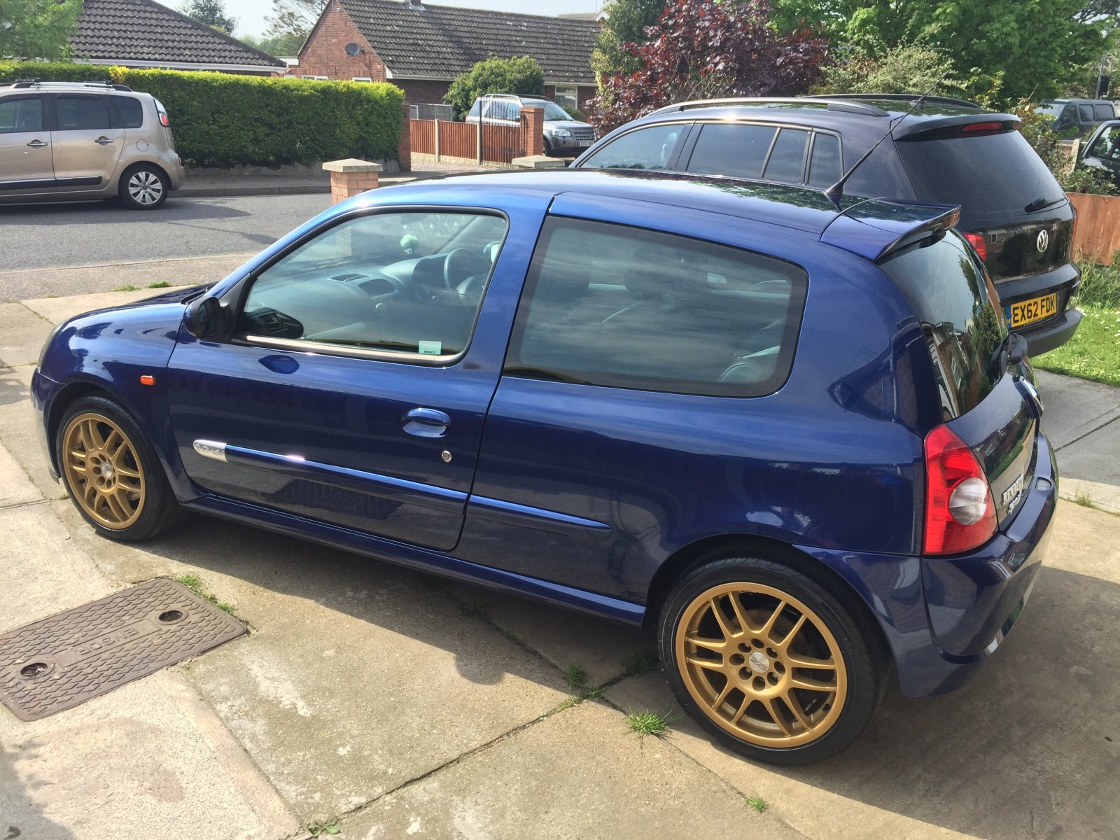

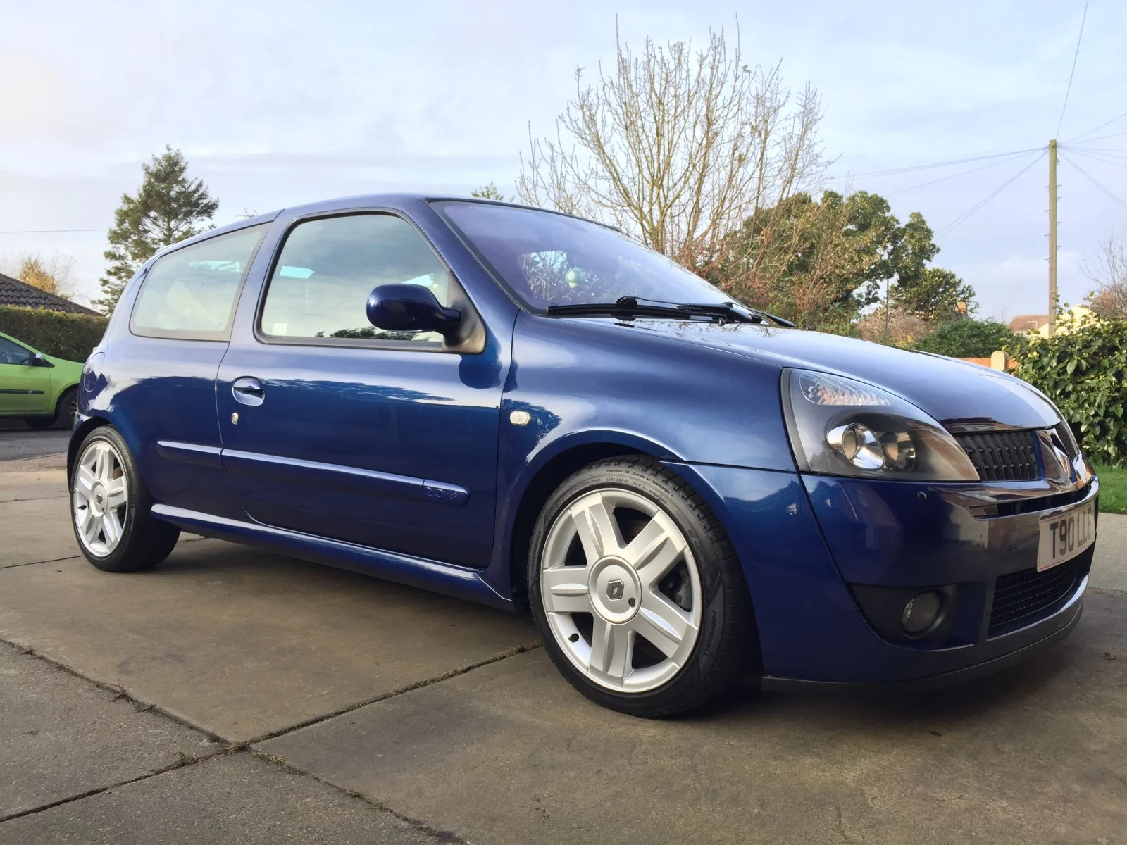

As the title suggests this is the story of my Monaco thus far, it is my 2nd Renault Sport Clio the 1st also having been a Monaco 172 which i had for 5yrs, sold for a 2.5 ST Focus and instantly regretted for 6 months until this little beaut came along.
2 owner 73k full dealer history, I had been looking all over for a decent low miler 182 and this came up locally so had to have it. Even though I said I would never have a 172 in Monaco again.

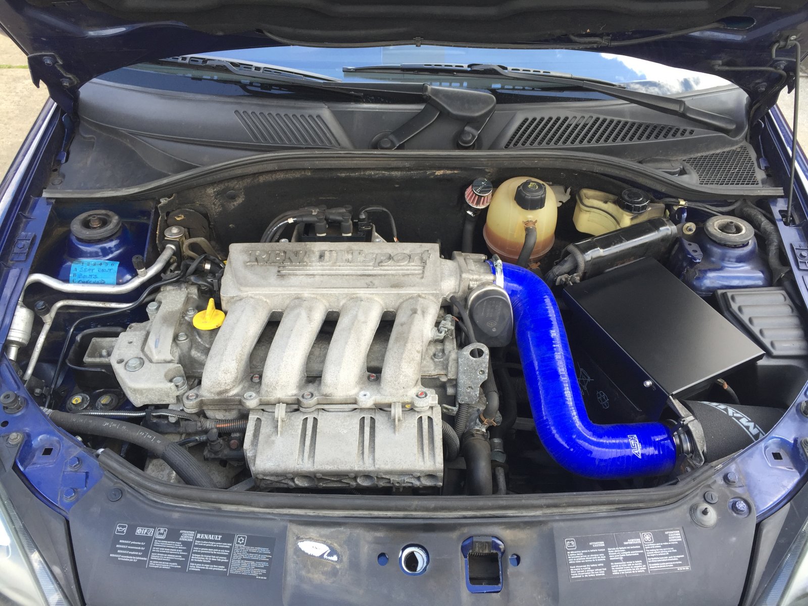

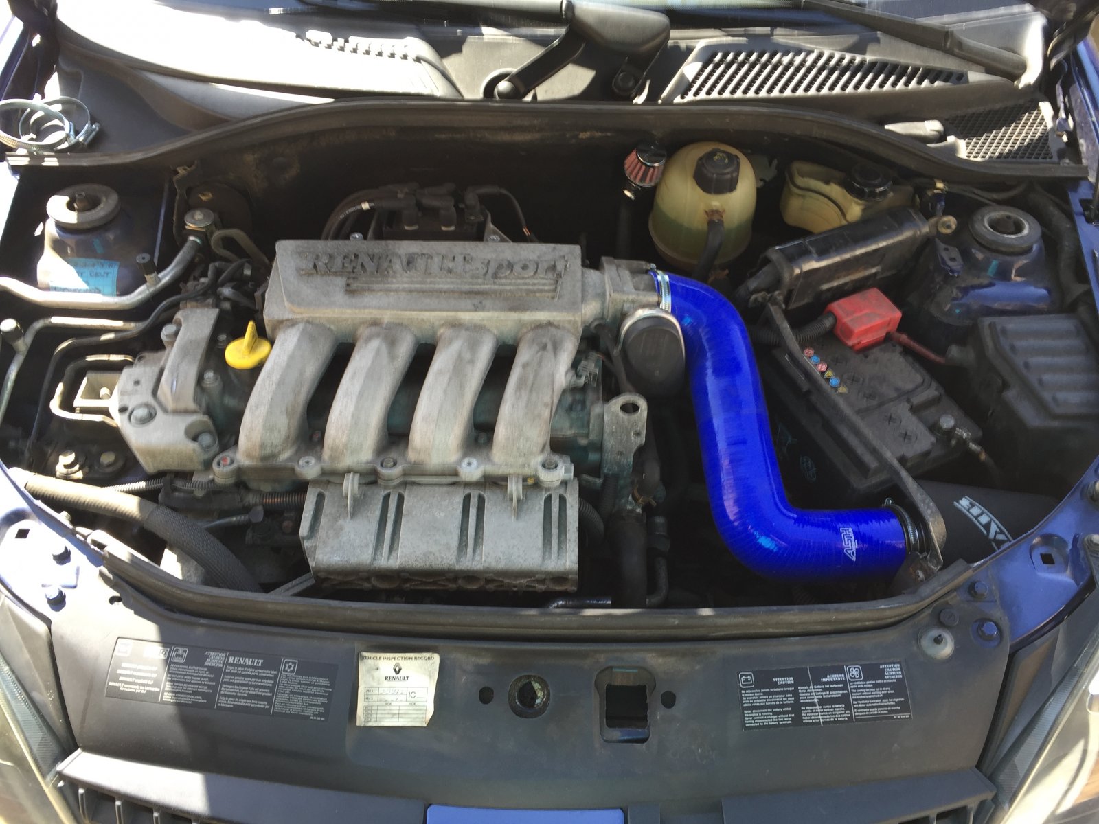

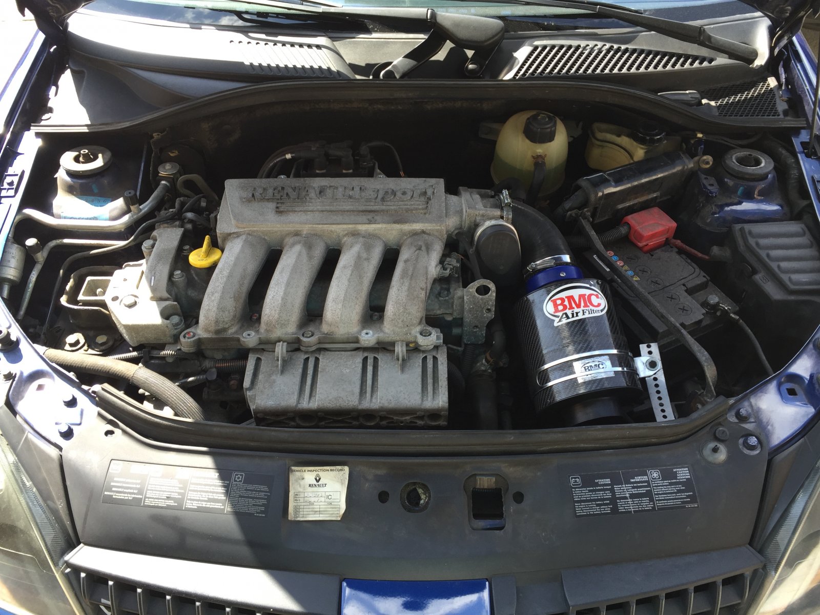

The noise from the BMC CDA was loud but I wanted louder!! I took the original Fatty intake setup an changed it to my own "k-Tec" design/style for half the price!!

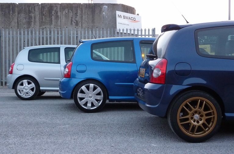

What to do when your car sounds like its on bodies?? meet up with mates who also own Sports...

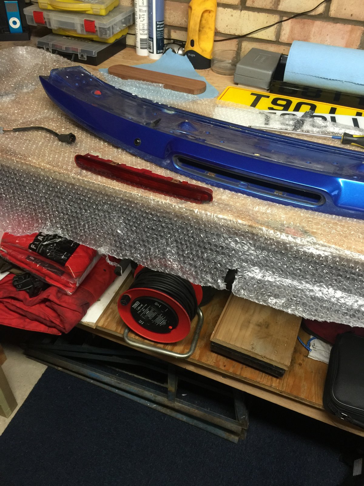

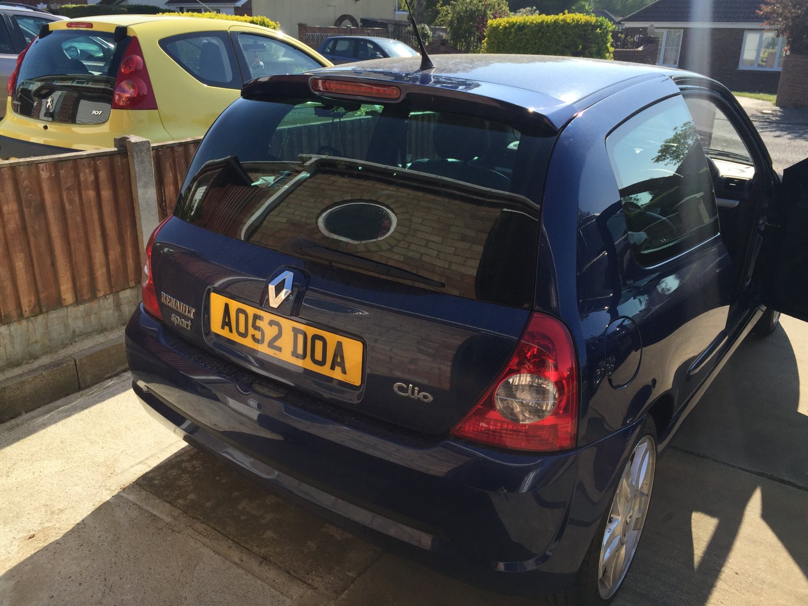

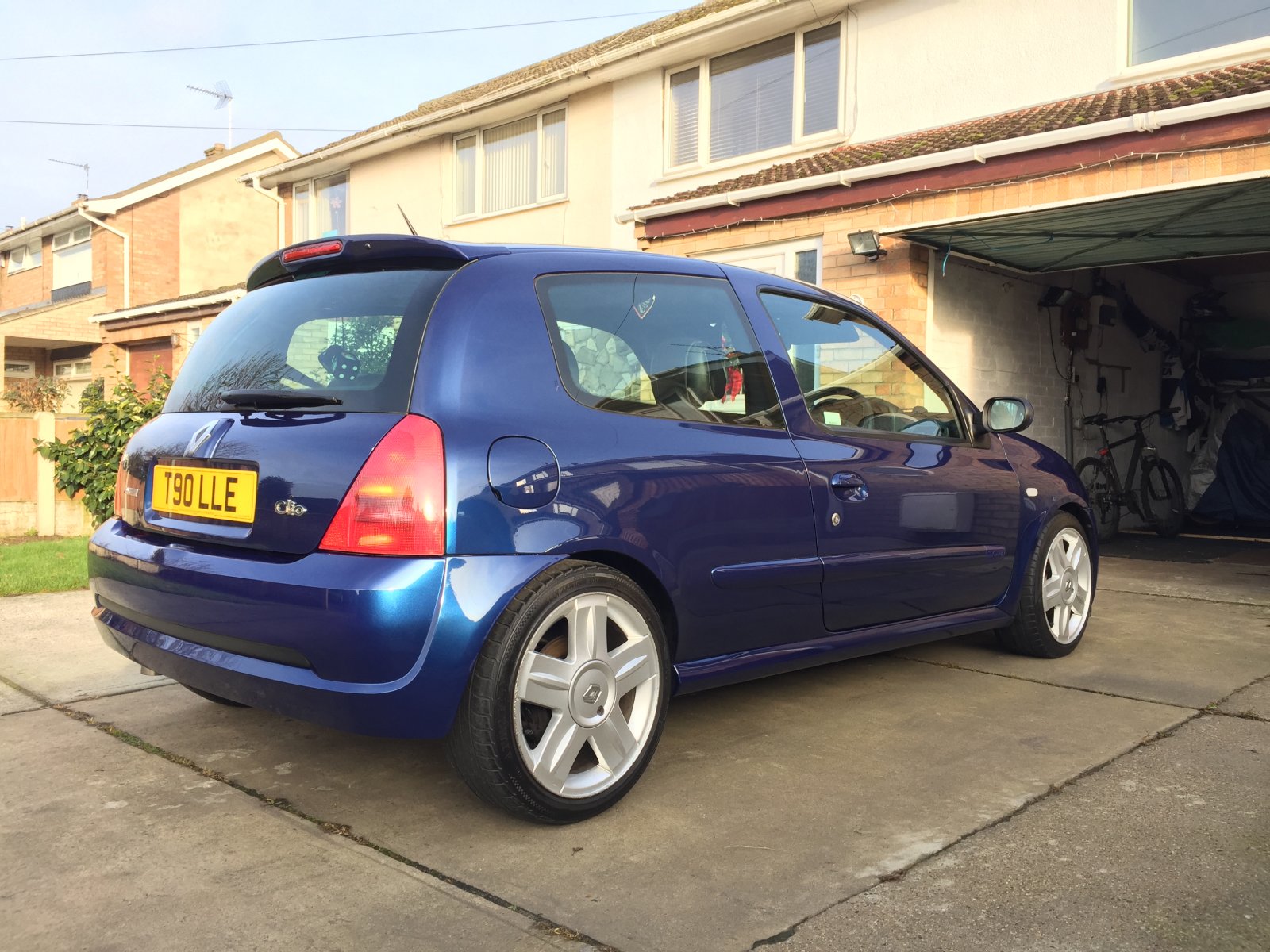

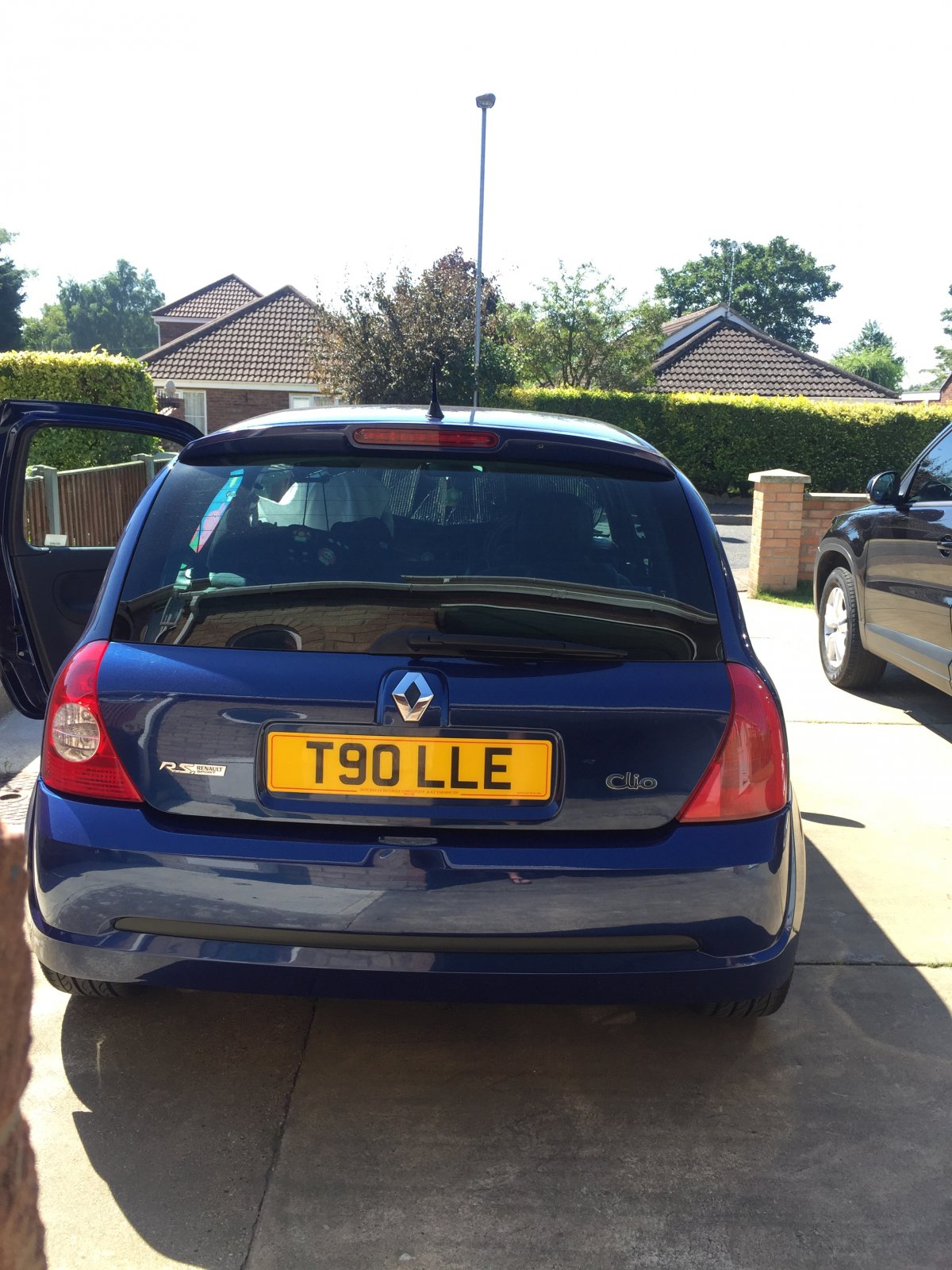

Next to come along was a Cup spoiler for the massive price of £60, it was the wrong shade of blue and the light had the tiniest chip in it, so of to the paint shop and local dealership to order a new light.
Fitted...
Its suprising how just a little spoiler can change the arse end...

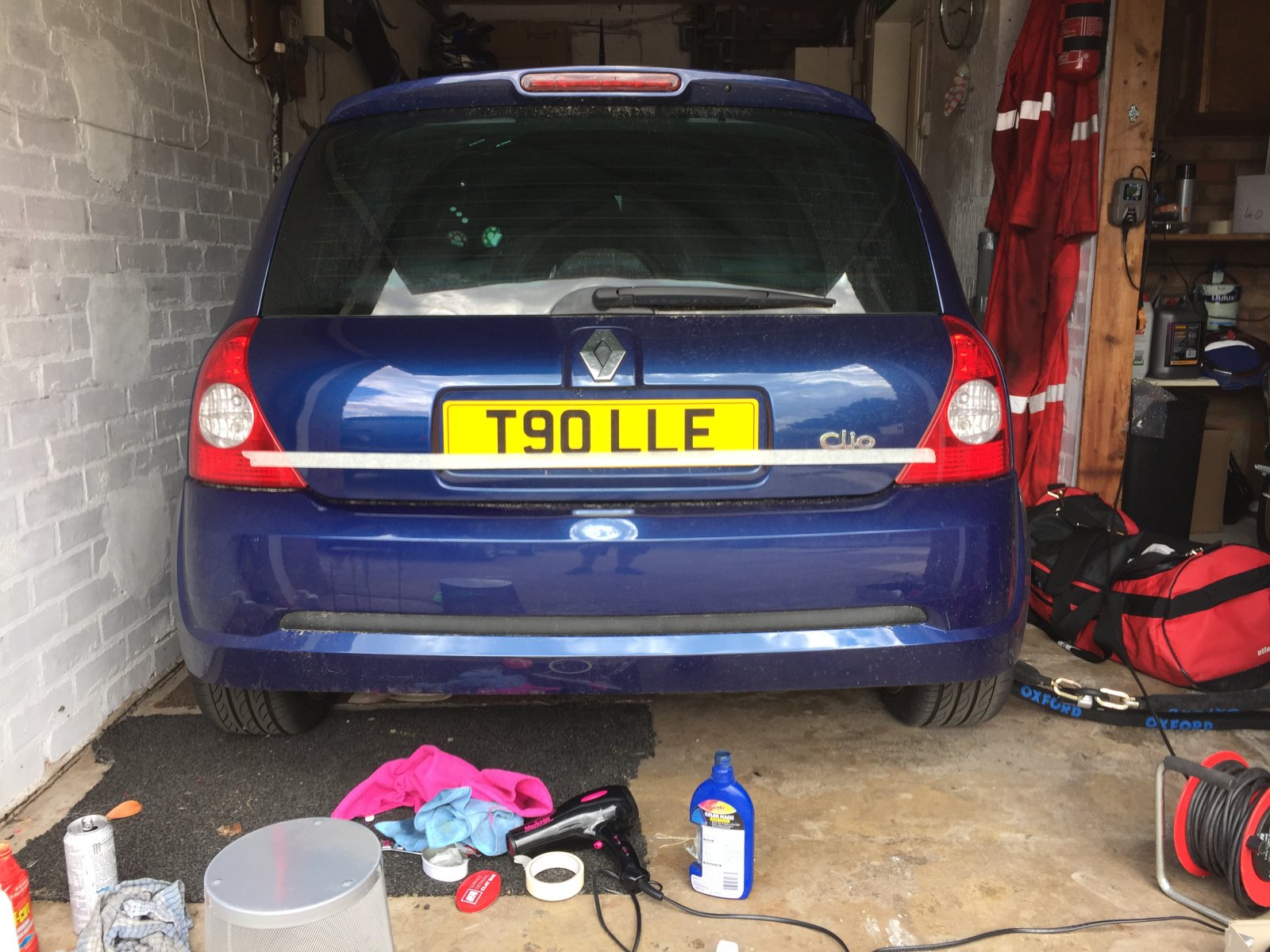

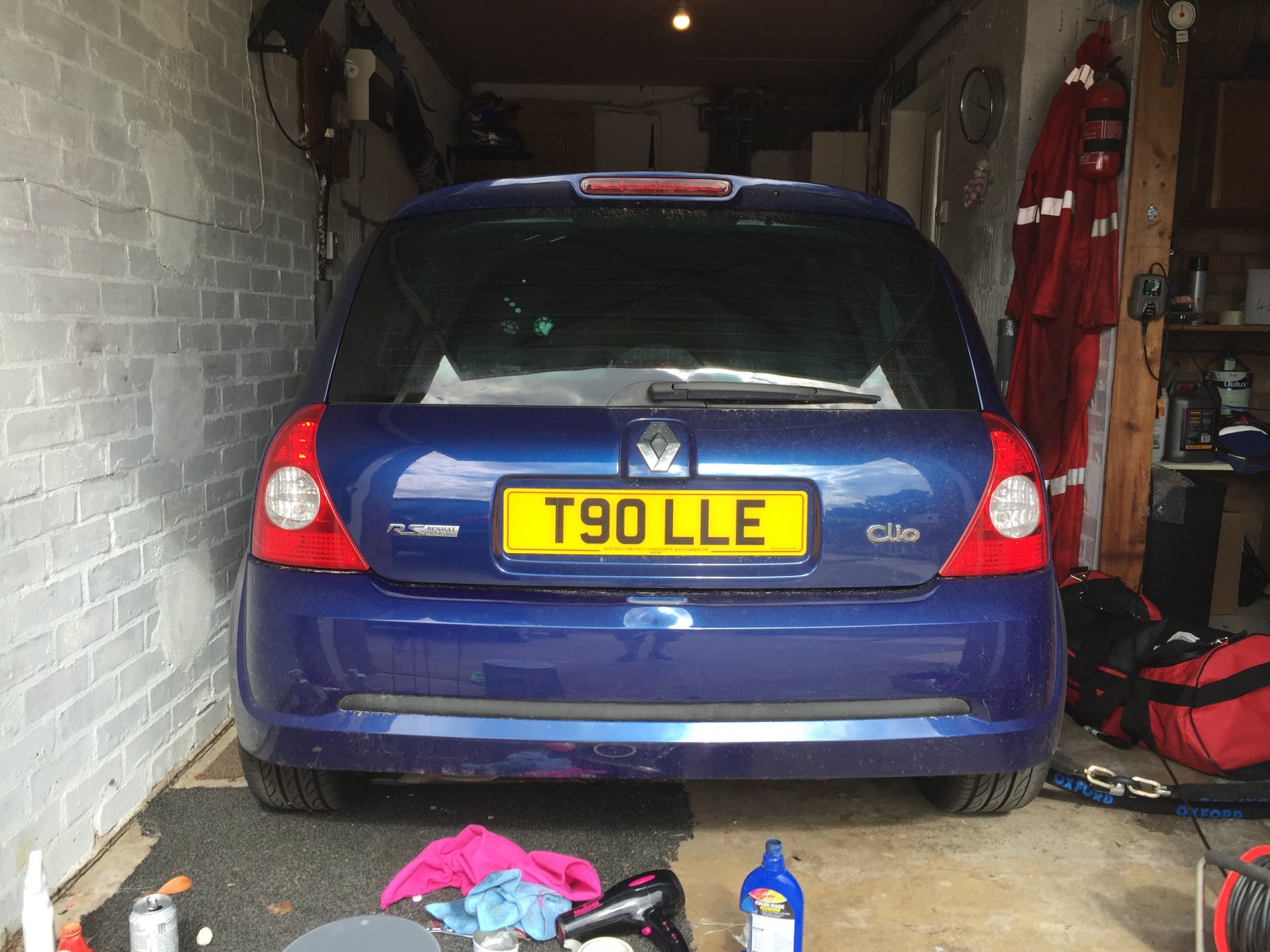

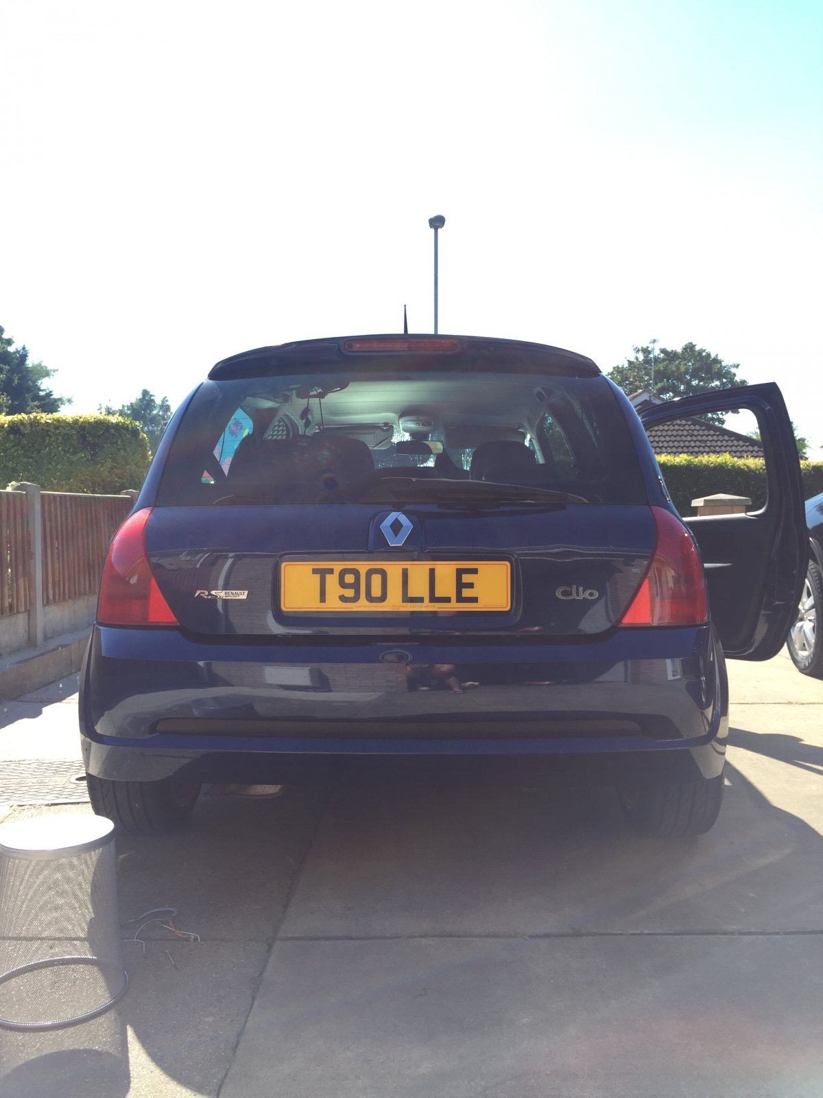

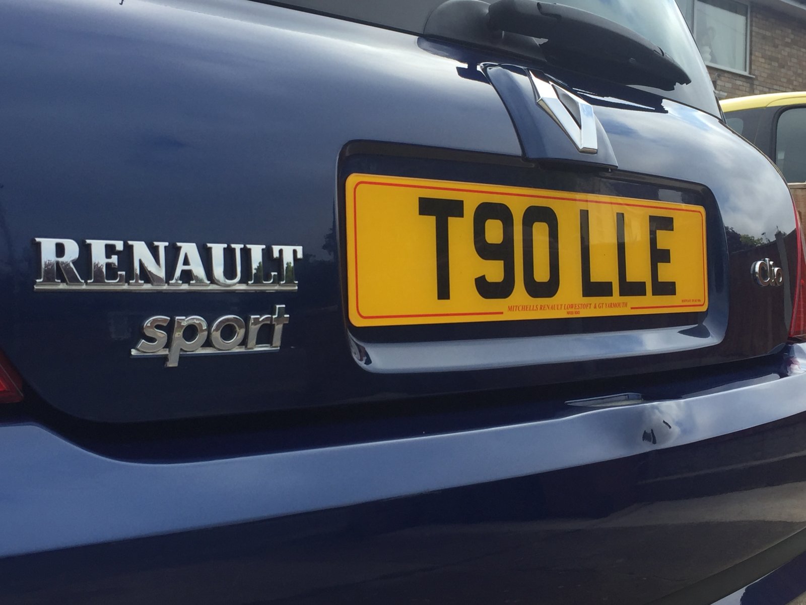

Next on was the private reg on local Renault dealer plates and a battery cover, nothing major but all the little details count haha
I was after an enclosed on but was unable to source one at the time... Still tidies the bay though

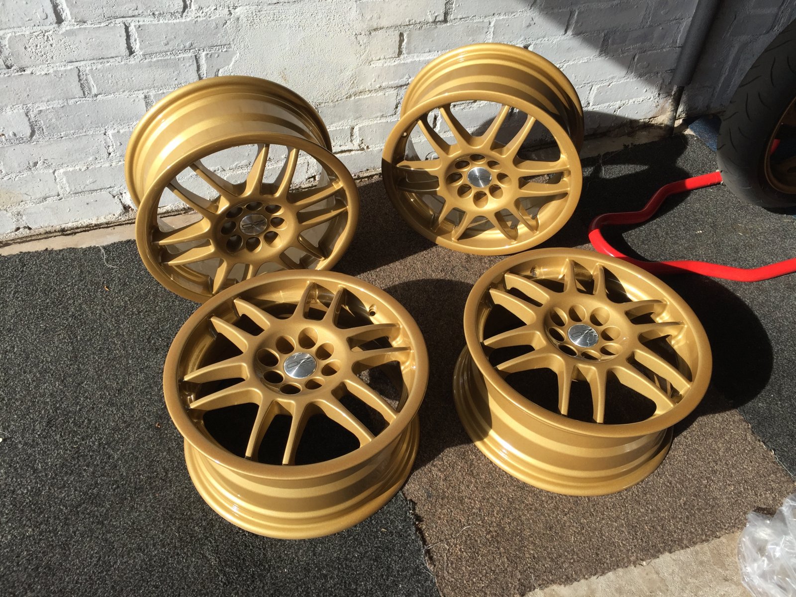

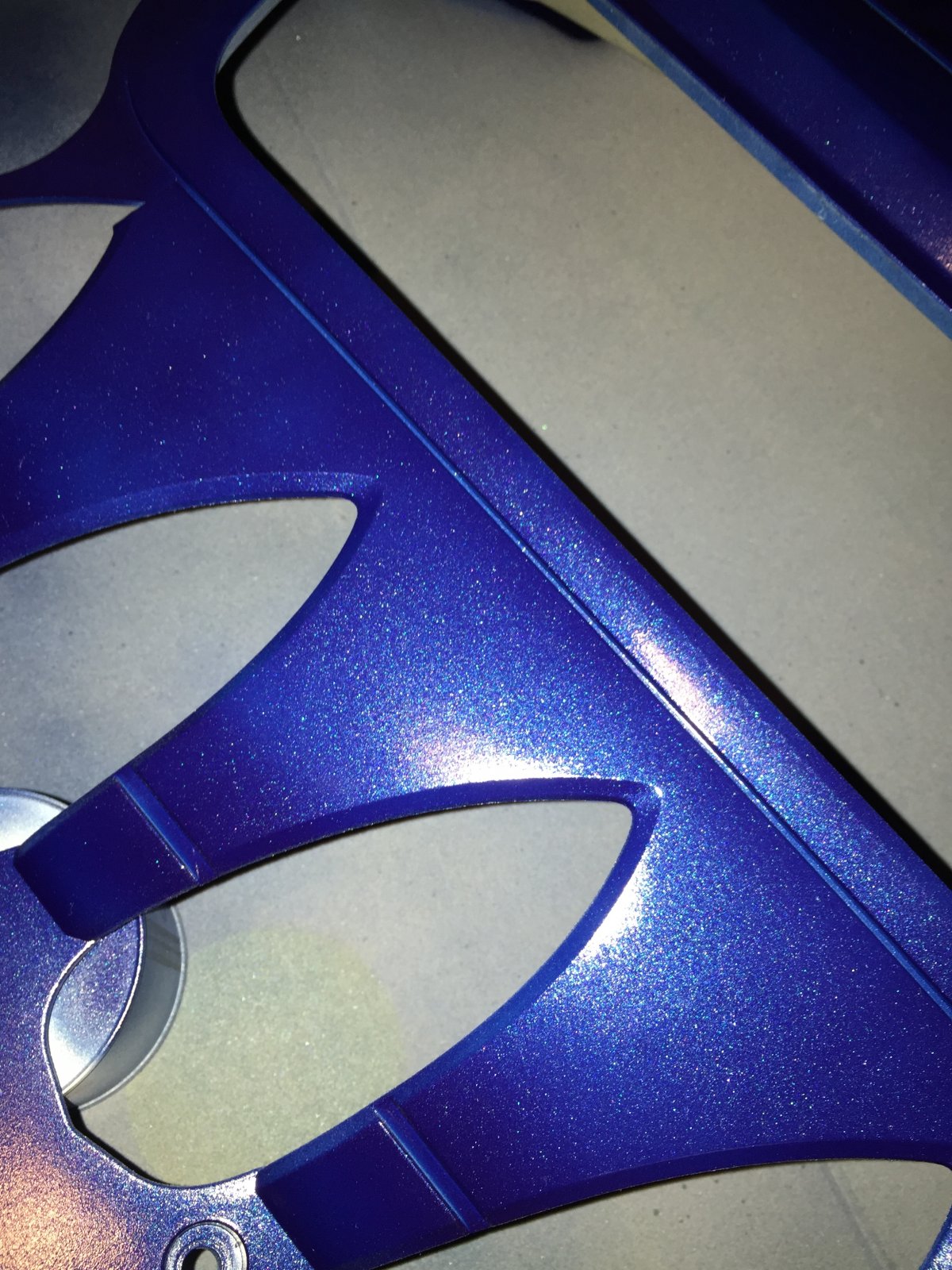

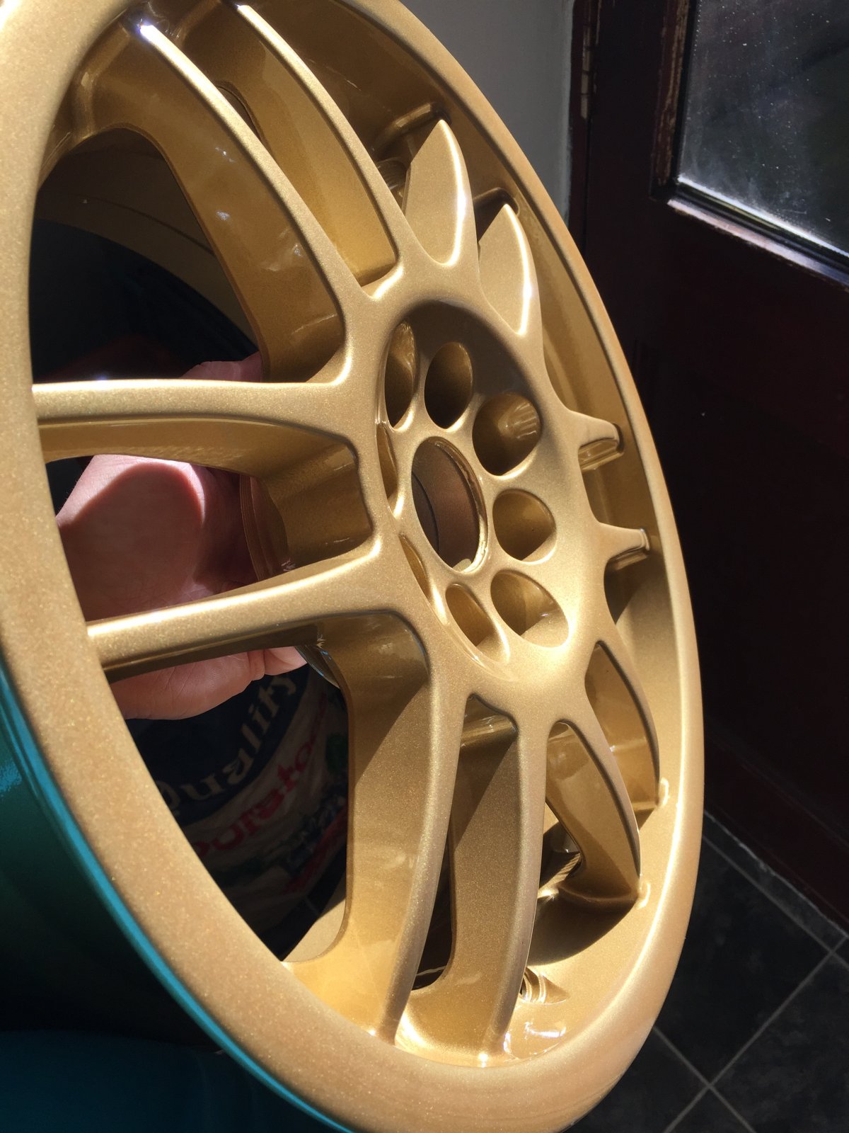

Next up was a full brake re-fresh, Brembo HC discs, Mintex 1144 pads, OEM rear Brembo discs and pads. At the same time I managed to source
some 16" OZ F1's for £180.
These were promptley set off to the local powder coaters...
And who couldnt resist a test fit again... before being wrapped in new Pirelli P-Zero's

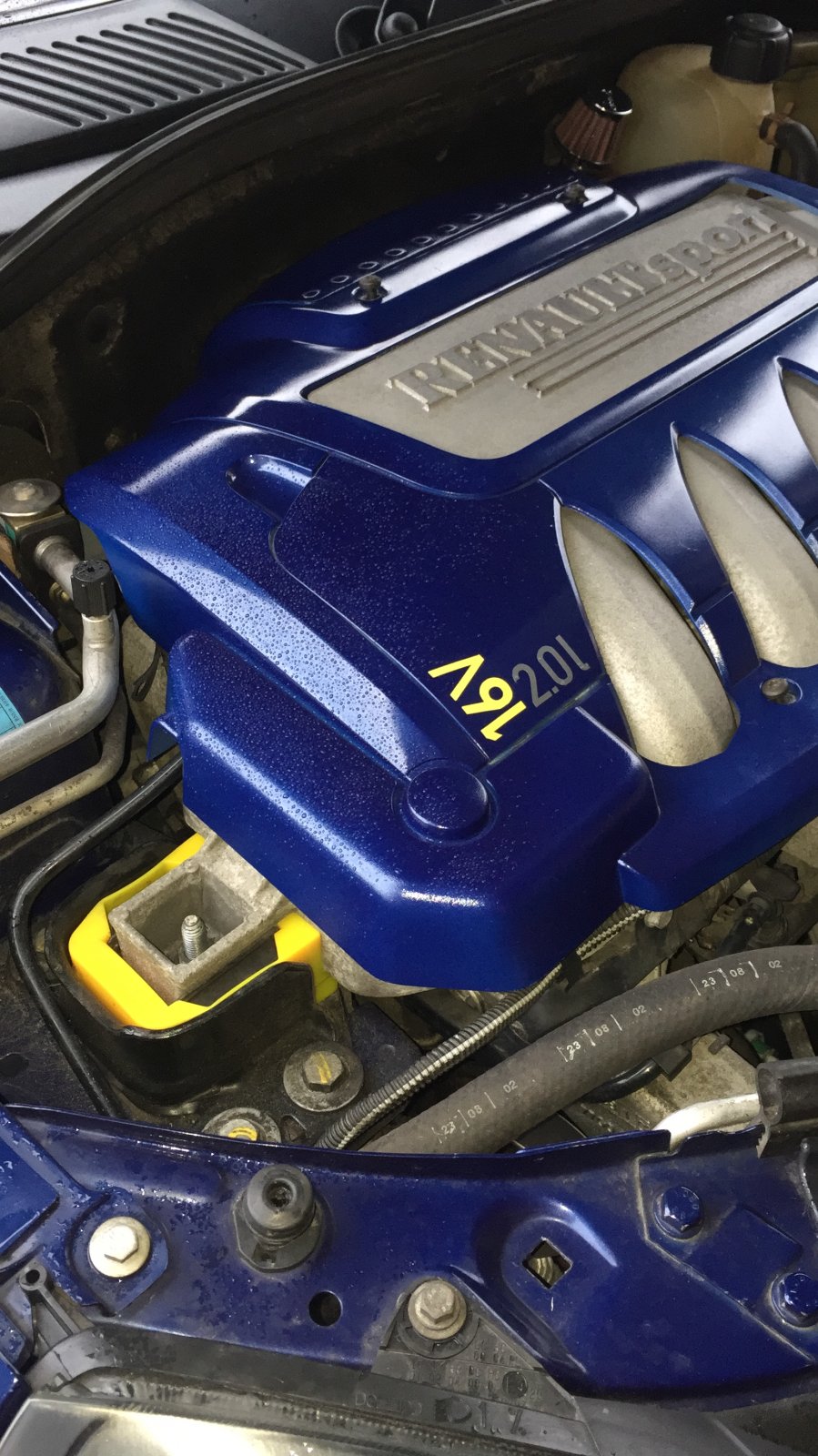

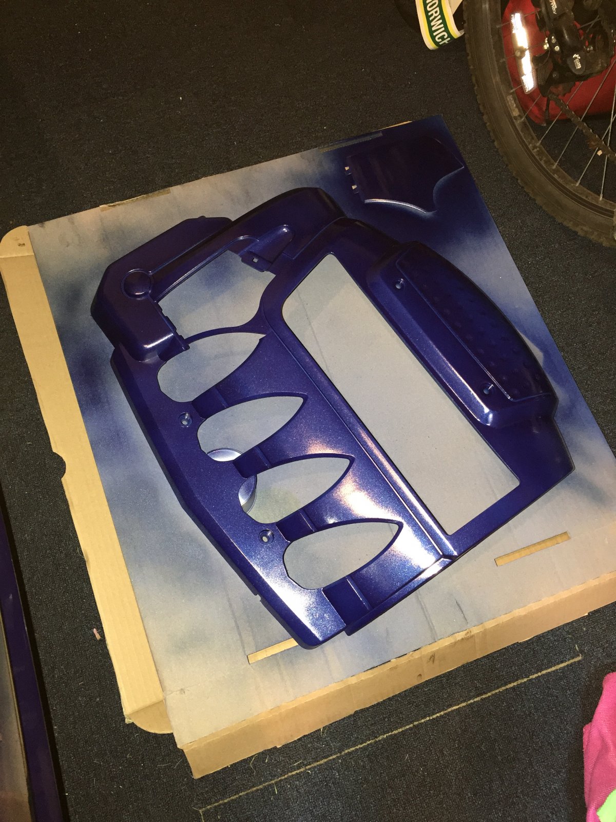

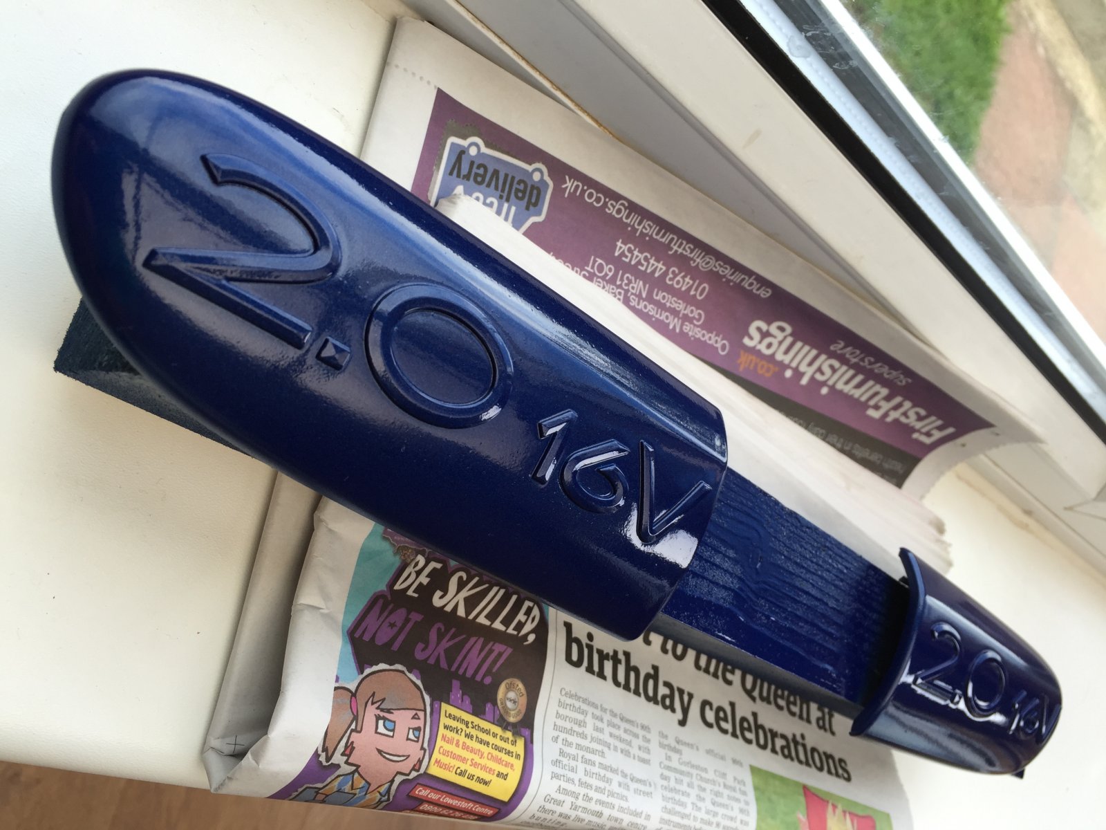

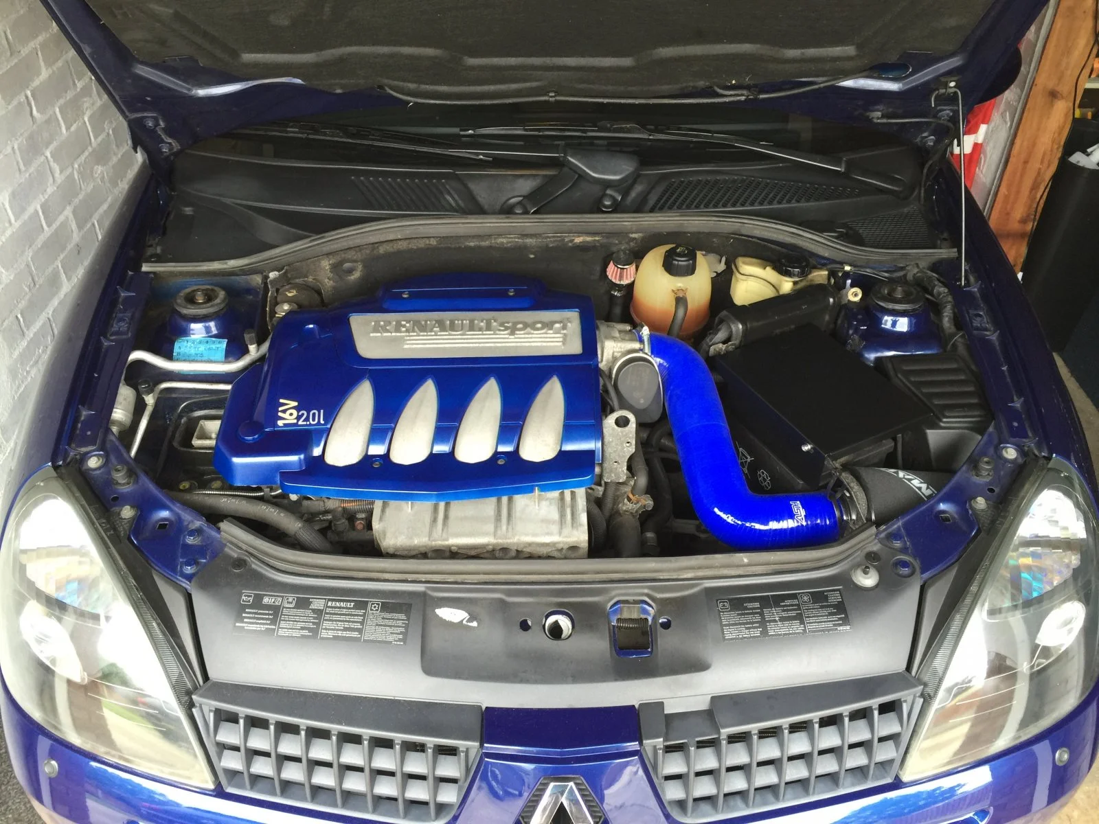

What was lacking in the engine bay was the cover... sourced from fleaby for £20 and rattle can painted 432 Monaco complete with new 2.0L 16V sticker

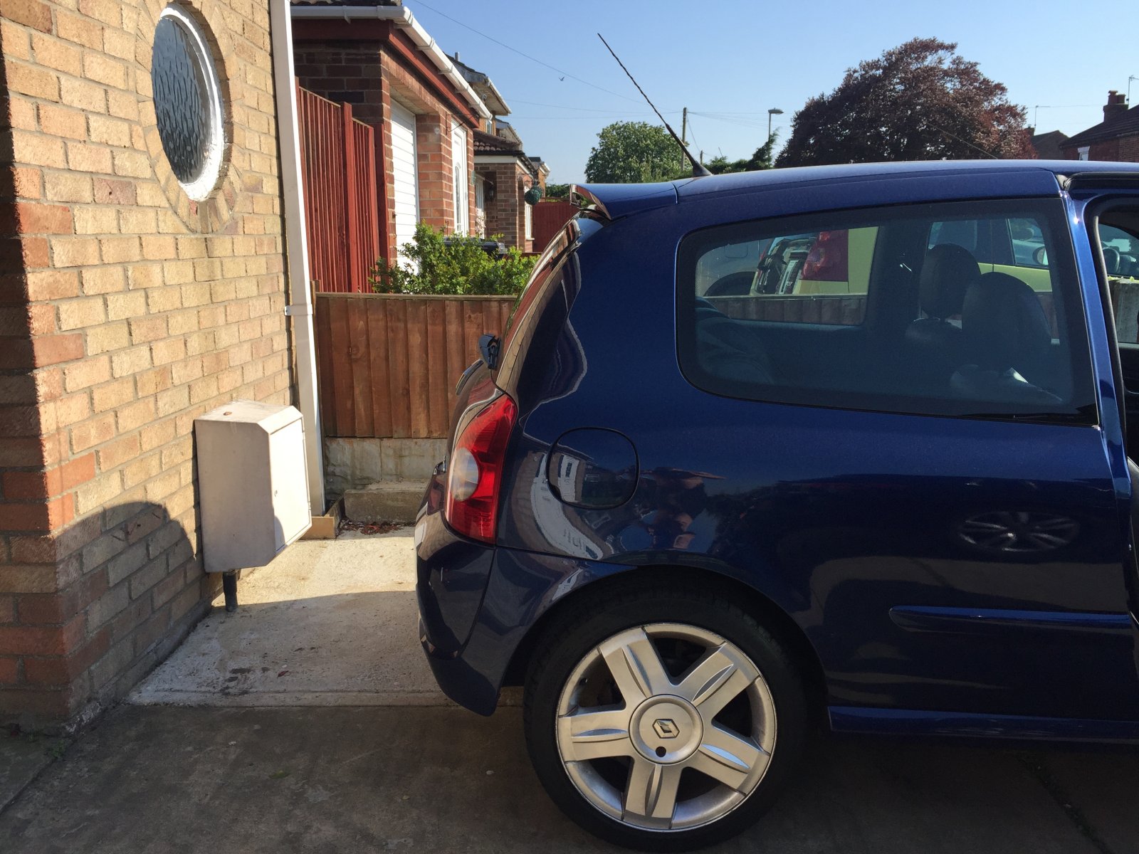

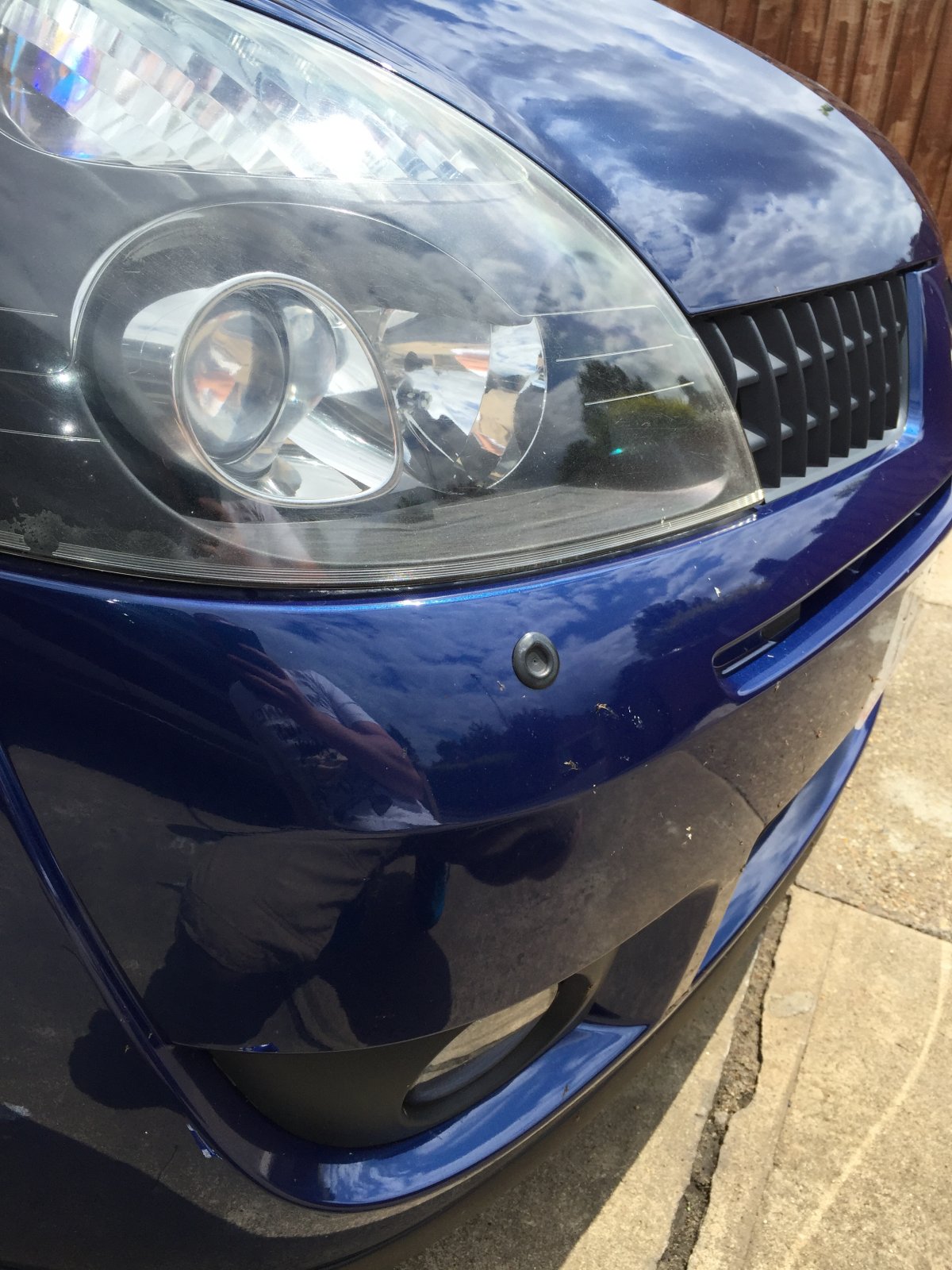

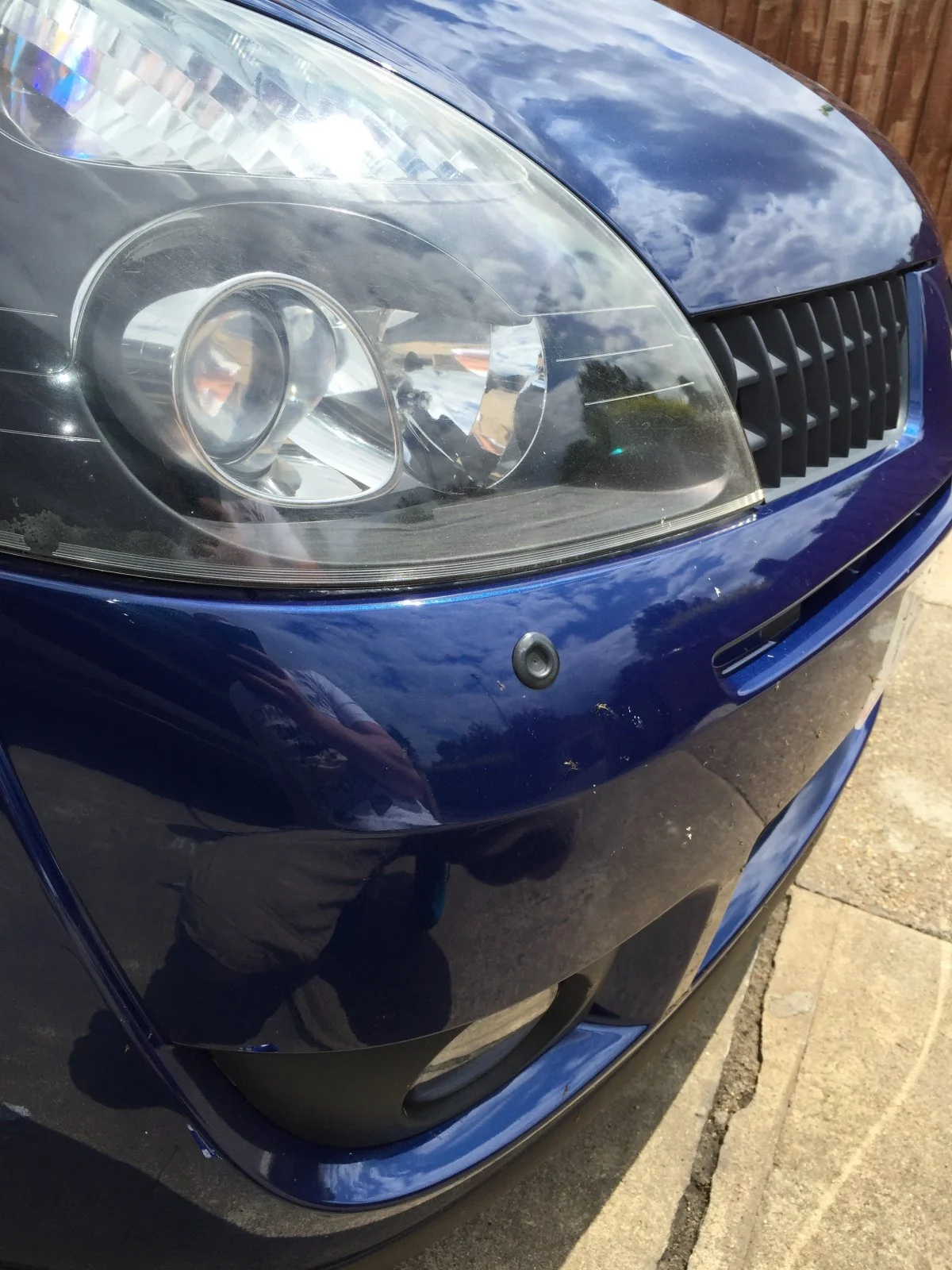

Whilst saving for a suspension refresh other little mods were done... Bee sting ariel, washer blanks and bullets
Someone for an unknown reason removed the bumper jets... Ignore the bug splats haha
Changed to regular gromets as im not a fan of the washer blanks...
My own attempt at colour coding the bullets, not the best finish in the world but I'm happy with them.
At the same time as painting the bullets I got some clear side repeators from a local scrap yard for £2 and fitted them. Who wants to pay £18 for one from Renault!!??

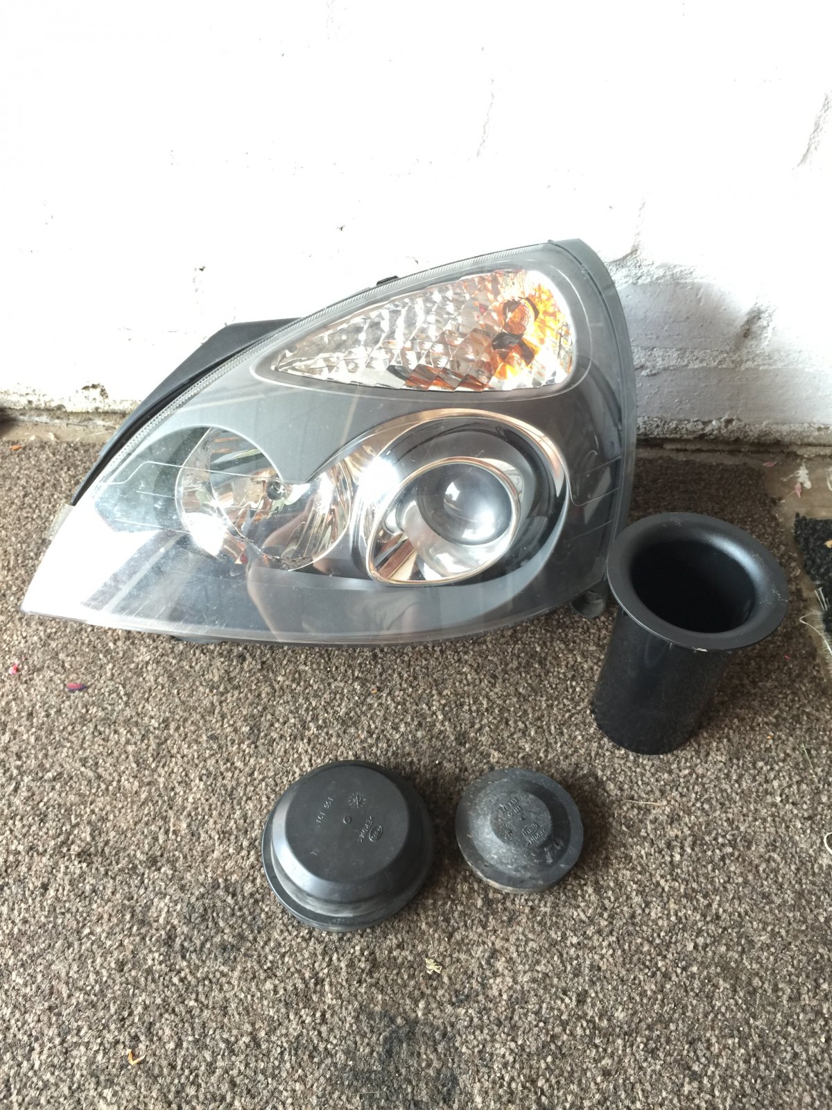

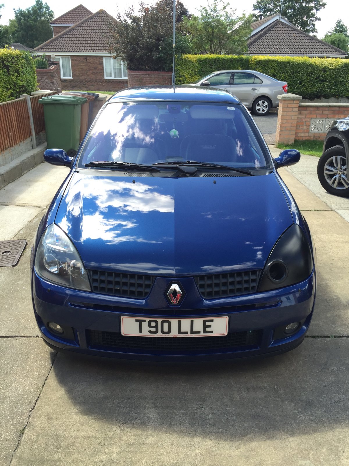

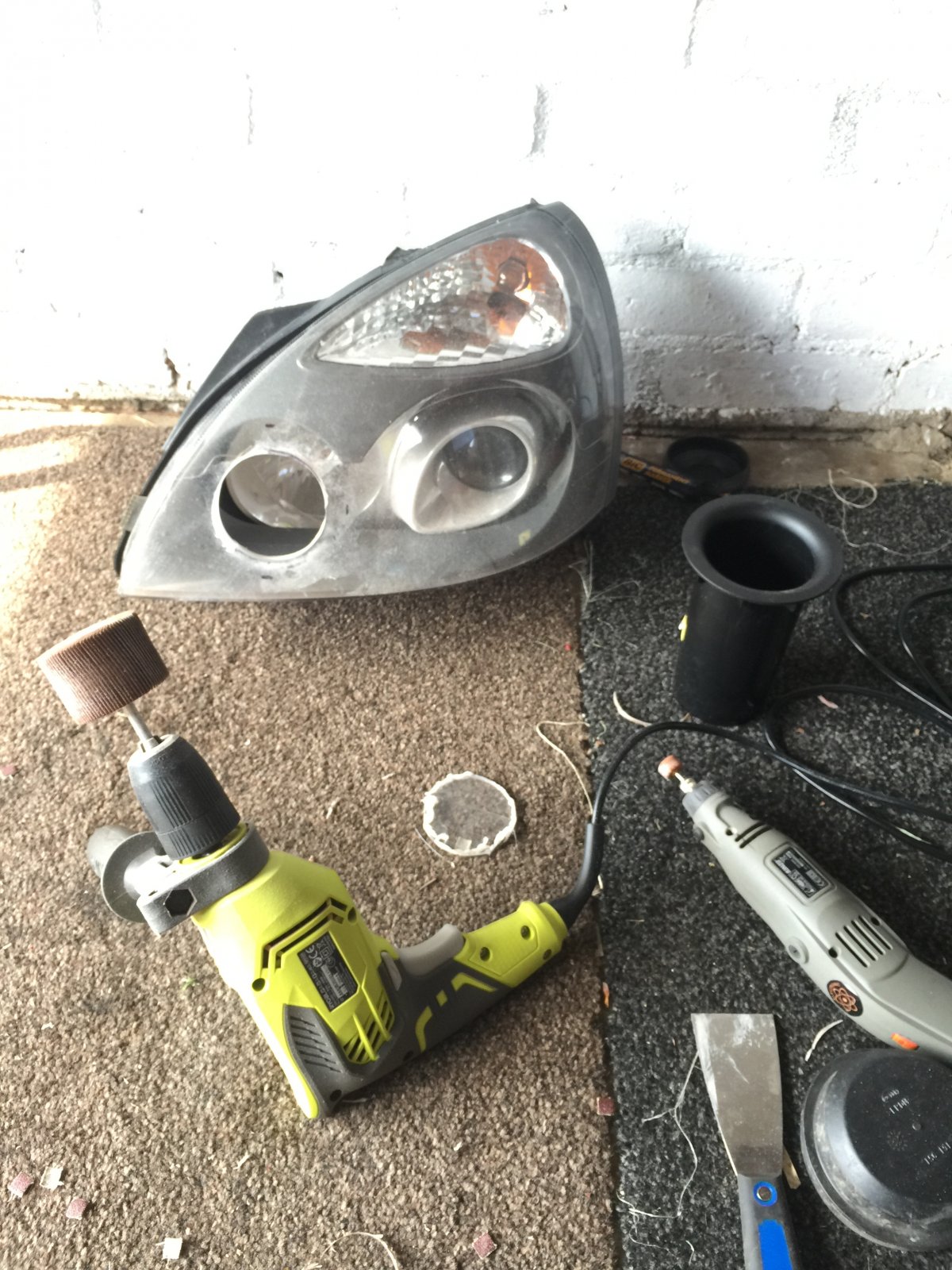

This next one is not going to be to eveyones taste but I had to do it!! Cup racer style headlight... as for the legality of this mod... errrrrr I never got stopped for it :tongueclosed: It was however promptly taken out as the winter nights started to draw in and I needed to see at night when driving lol

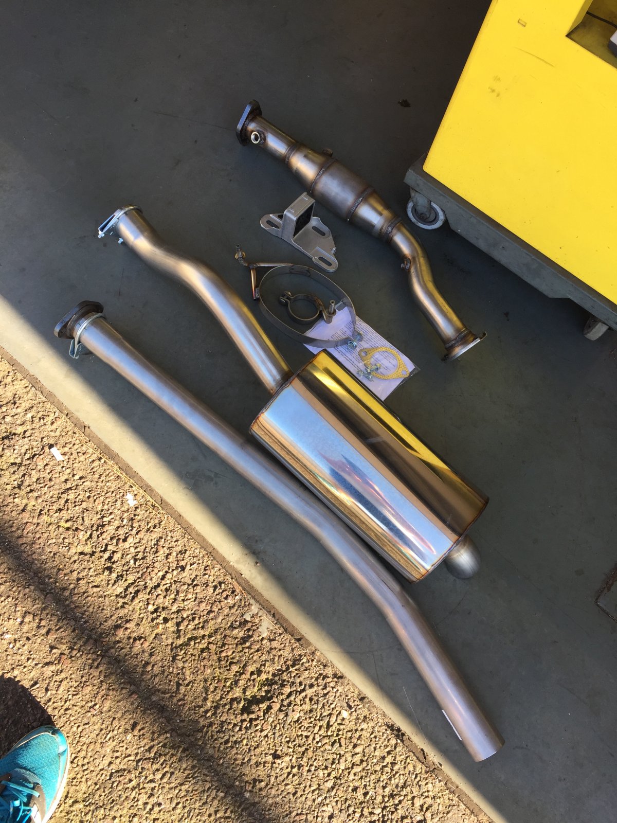

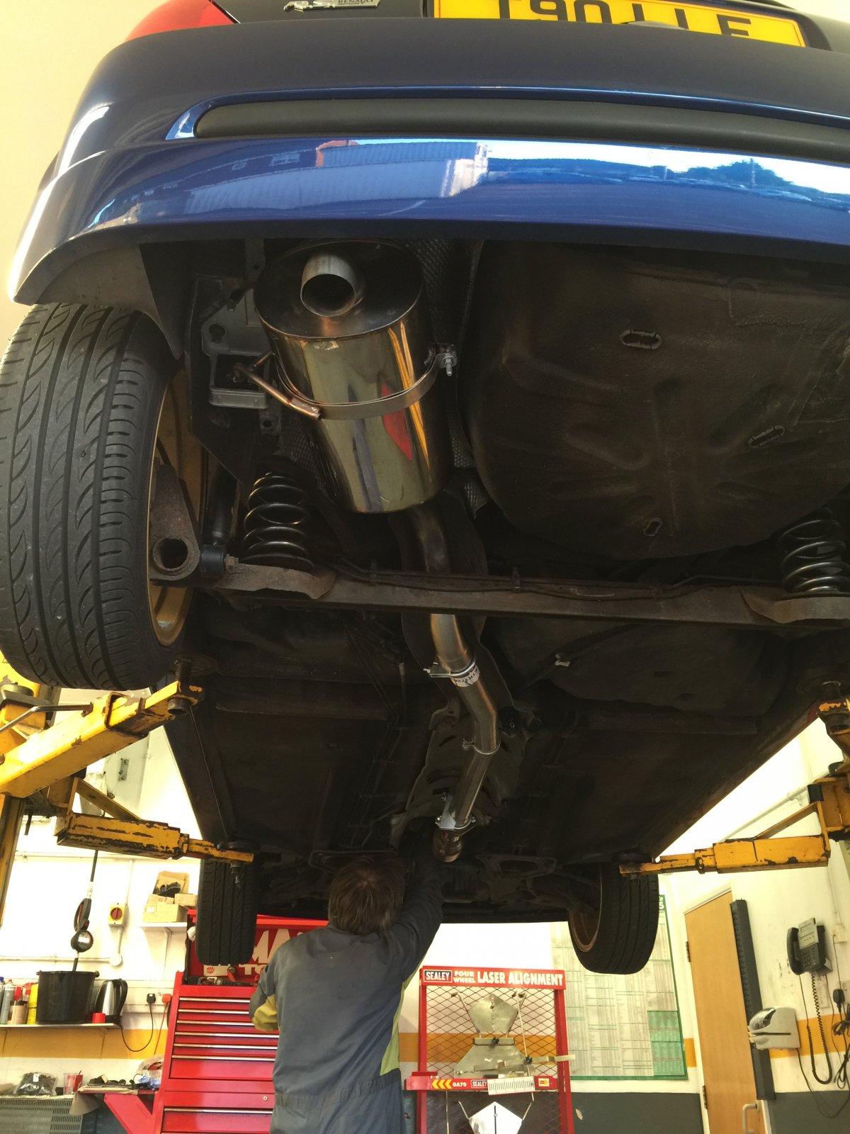

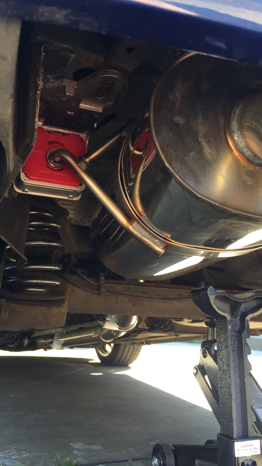

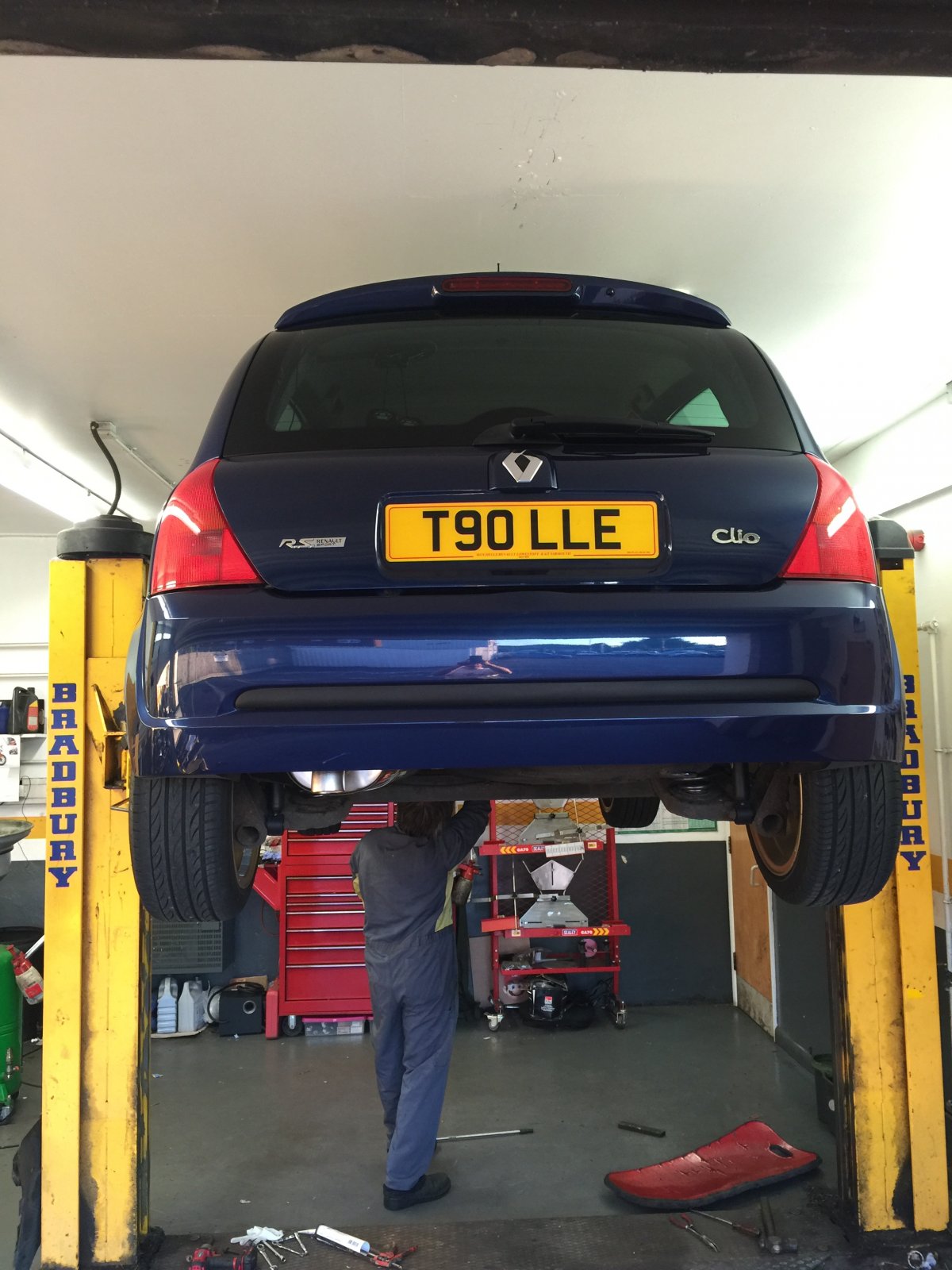

During the summer I noticed that my exhaust system was blowing at the rear box, upon getting under the car it was dicovered that the whole system was knacked. The cat had split, it was blowing at the centre join and the rear box had more holes in it than material was hold it together. The issue is there are not many choices for the 172 systems so a call was placed to K-Tec for a full 2.5" SuperSports Stealth System including a sports cat.

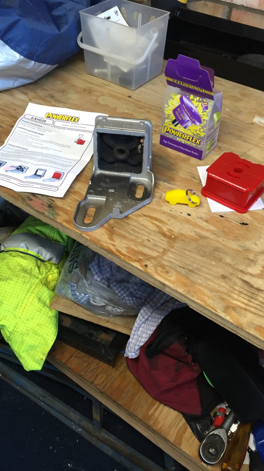

Shortly after fitting the common mount issue showed itself as the new OEM I had failed after 2 weeks, on to ebay and order a PowerFlex bush.
What chew to put in!!!
Much better postioning...

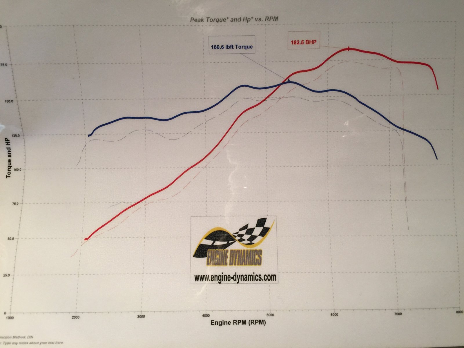

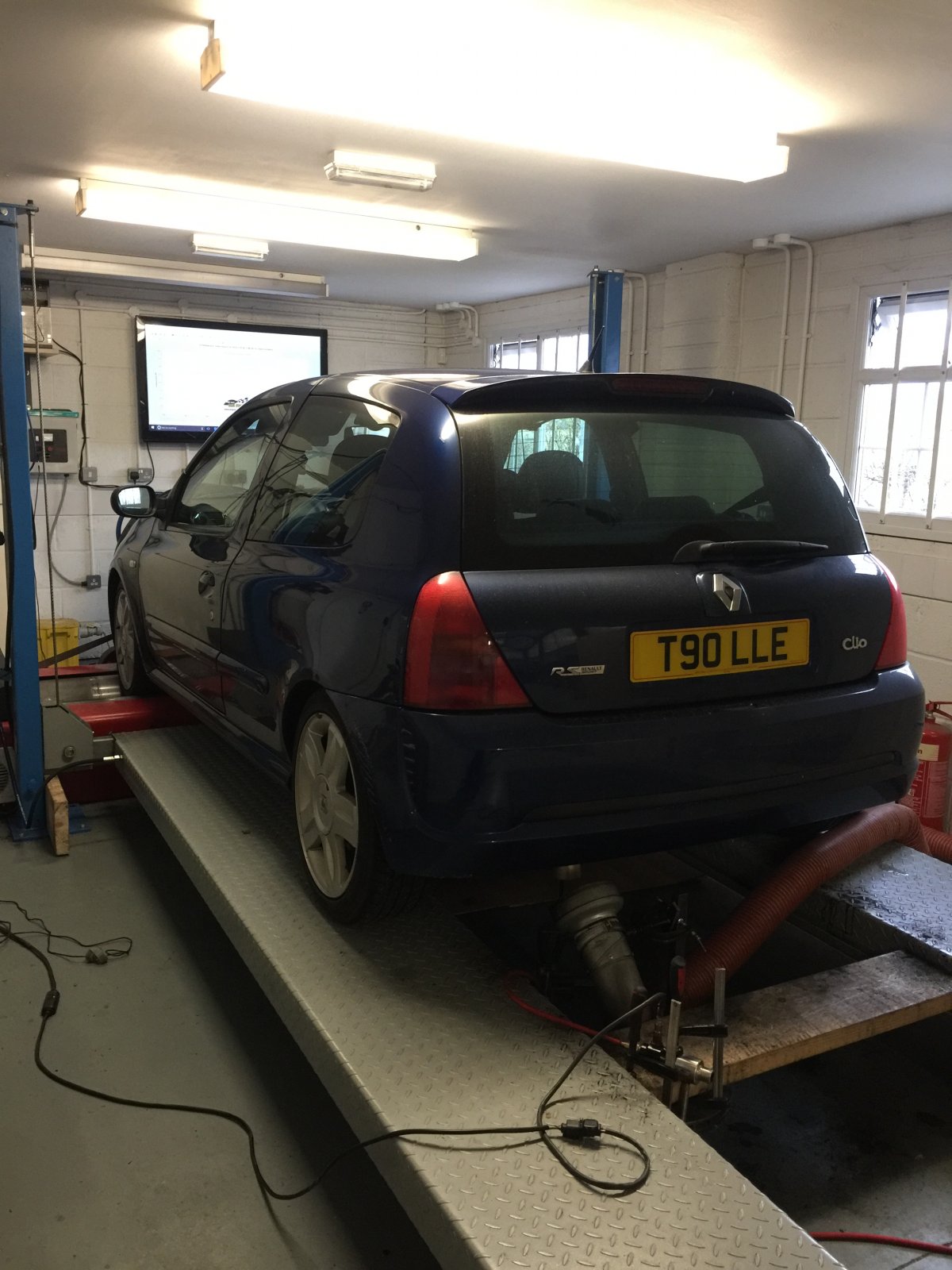

With the Monaco breathing right and exhausting well the next option was to see what damage I had actually done to the engine with my "mods", a trip down to Essex to see Andy at Engine Dynamics would reveal all.
She pulled 150.1lbs ft and 170.3bhp Peak on her 1st base run... 2 and a half hours later Andy had smoothed my power drop off and gained me 10.5lbs ft and 12.5bhp peak whilst raising my engine limit from 7200rpm to 7550rpm. Not big numbers by any means but it has transformed the car and quote from Andy "one of the strongest stockish engine he's seen in a while" I was made up :grin:

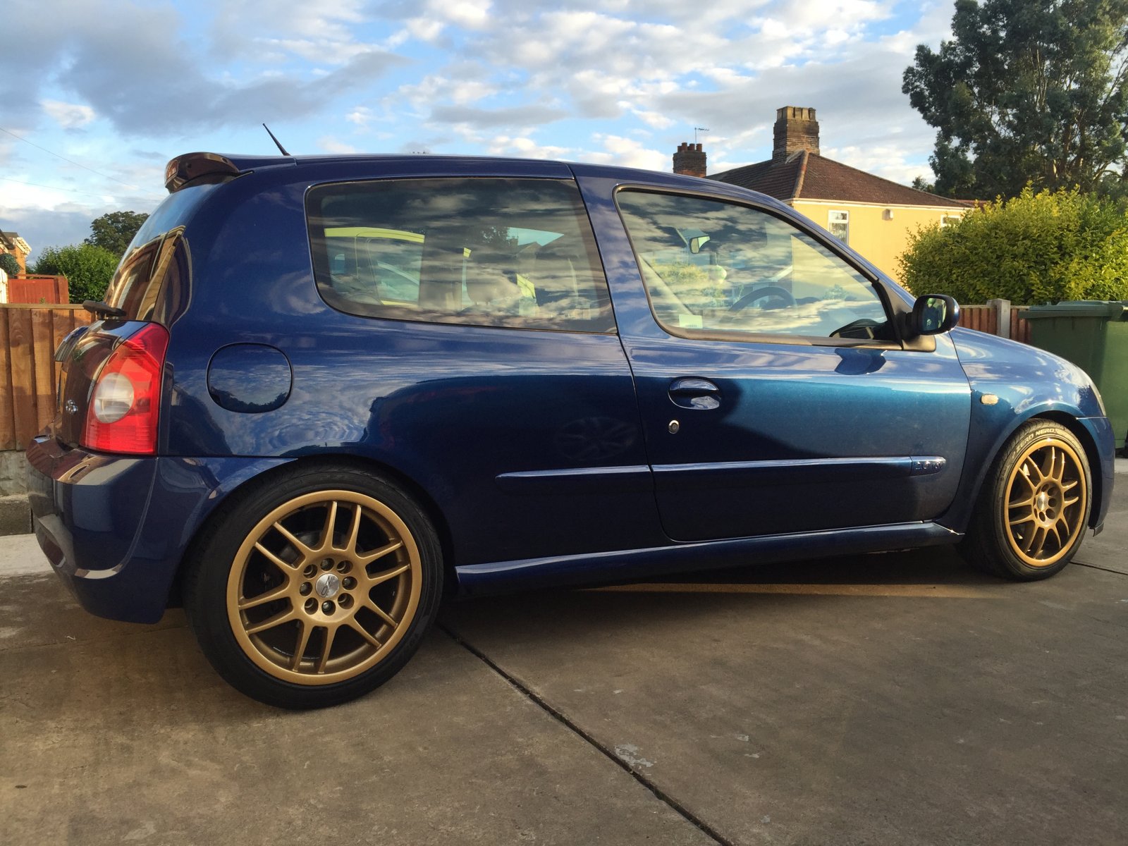

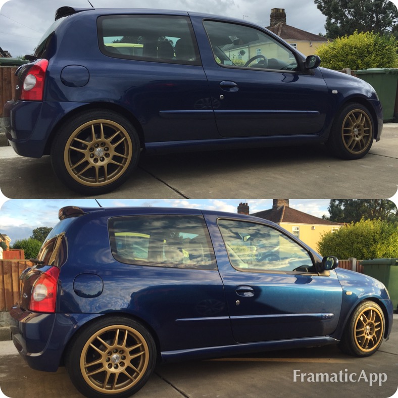

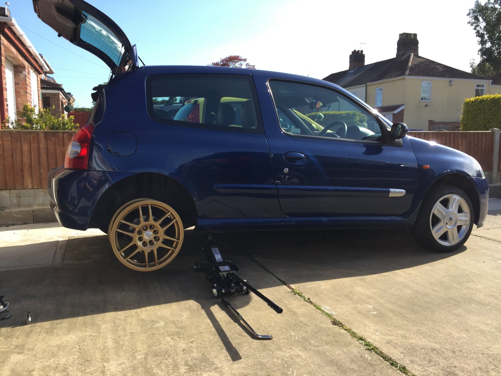

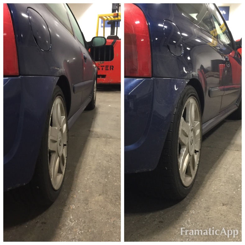

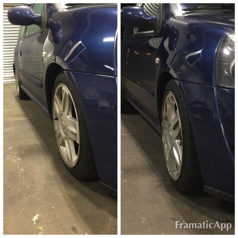

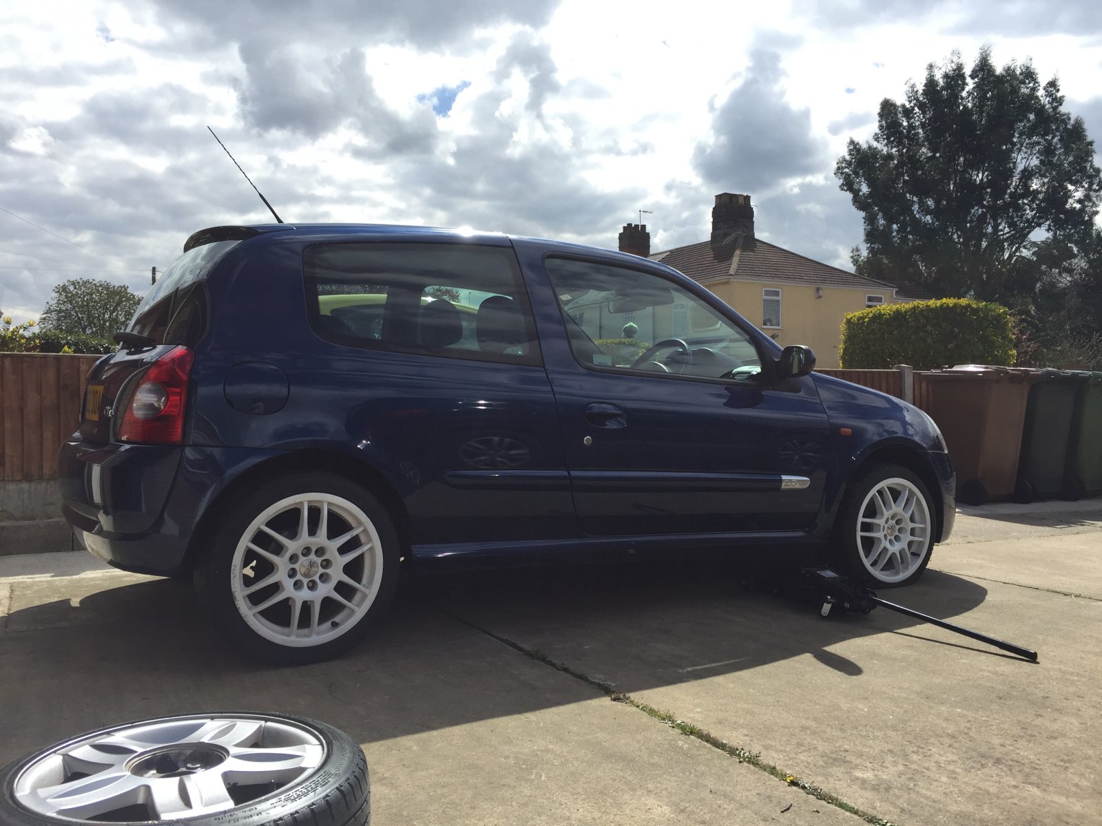

With winter impending the stock 172 wheels where put back on but looked hidden in the arches, a deal was done with @182_steve for his 16mm hubcentric spacers after he had got his hands on some Turini's and the combo wasn't working for him.
Before an afters... not sure if i'll keep them on when the Oz go back on in the summer due to the difference in ET's

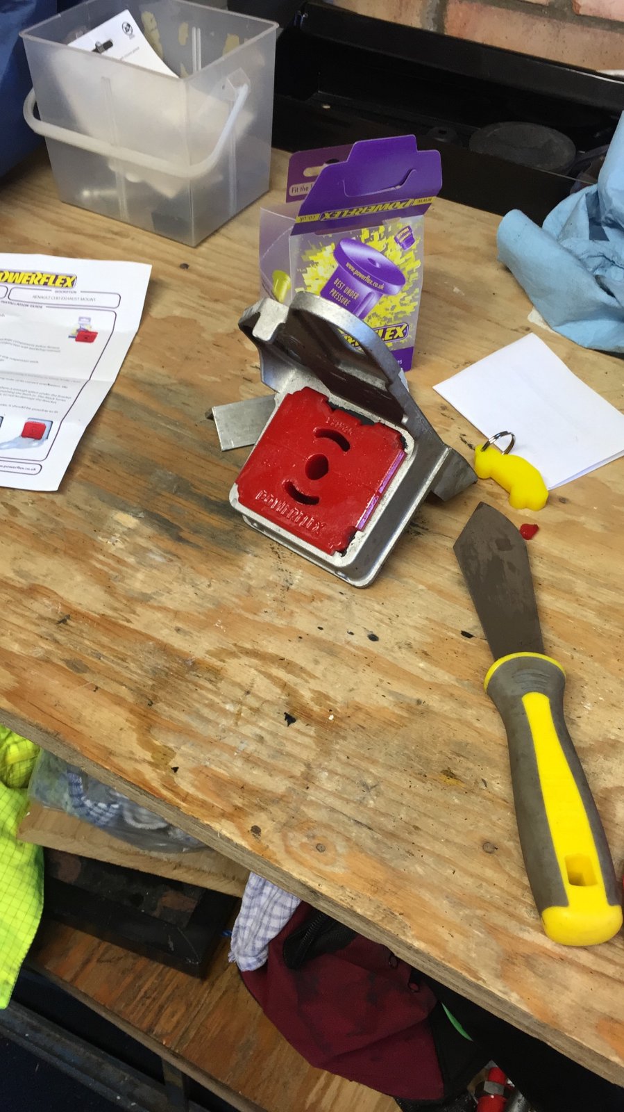

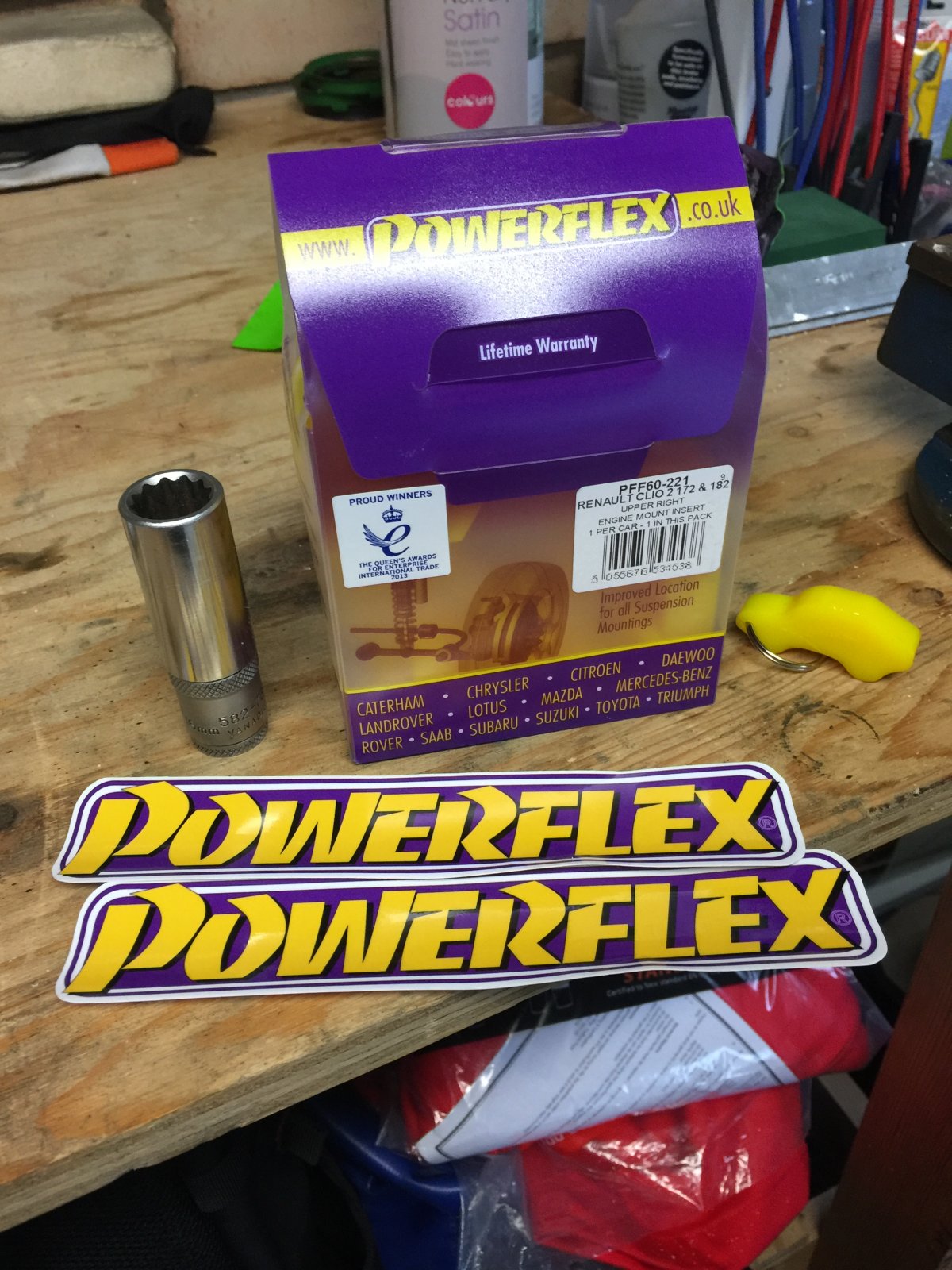

Lastly and the most recent upgrade was to the engine, a PowerFlex upper mount was fitted in 10mins on the drive last week. I like the way its made the engine feel under acceleration but idle :pensive:
I am unsure if i should do the Dog bone mount as yet as I hear this can cause even more vibration??

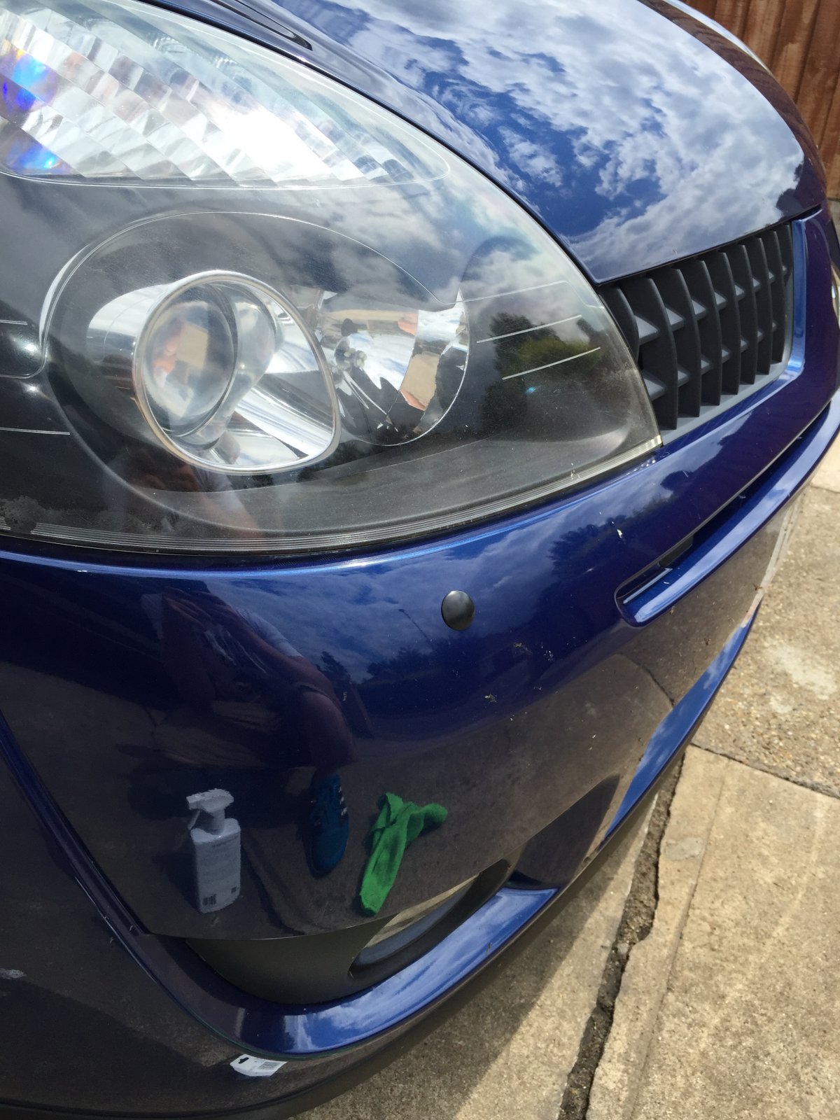

Just before christmas I treated her to a good bath as it hadn't been washed since the remap in November...
De-contaminated with Muc-Off Spray, washed with Juicy shampoo, dried with an Auto Finesse Aqua Deluxe Towel, Meguiars Clay barred, rinised and dried again, trims and grills blacked, Glass inside an out, 2 coats of Auto Glym Ultra Deep shine polish for dark cars, 2 coats of G3 Supergloss wax then buffed to within an inch of its life!! No more baths till spring!!
