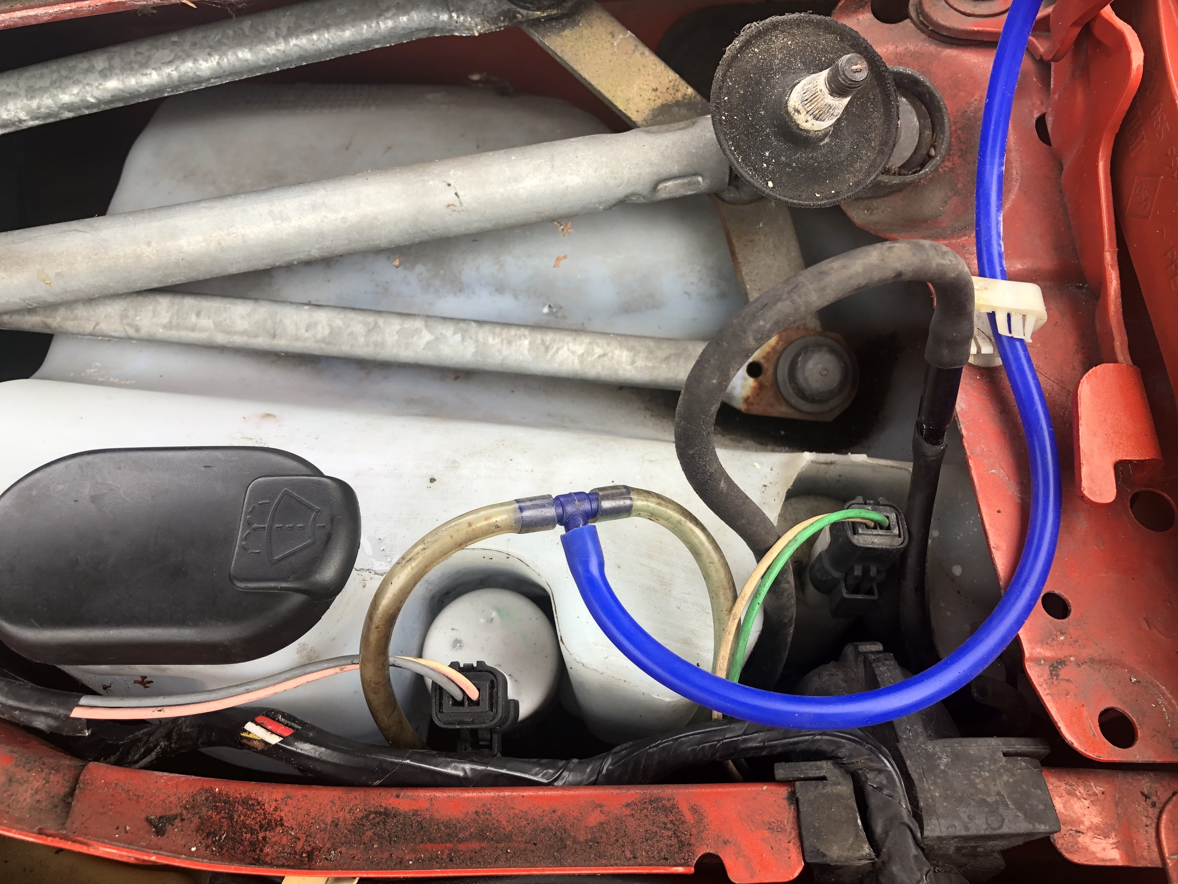

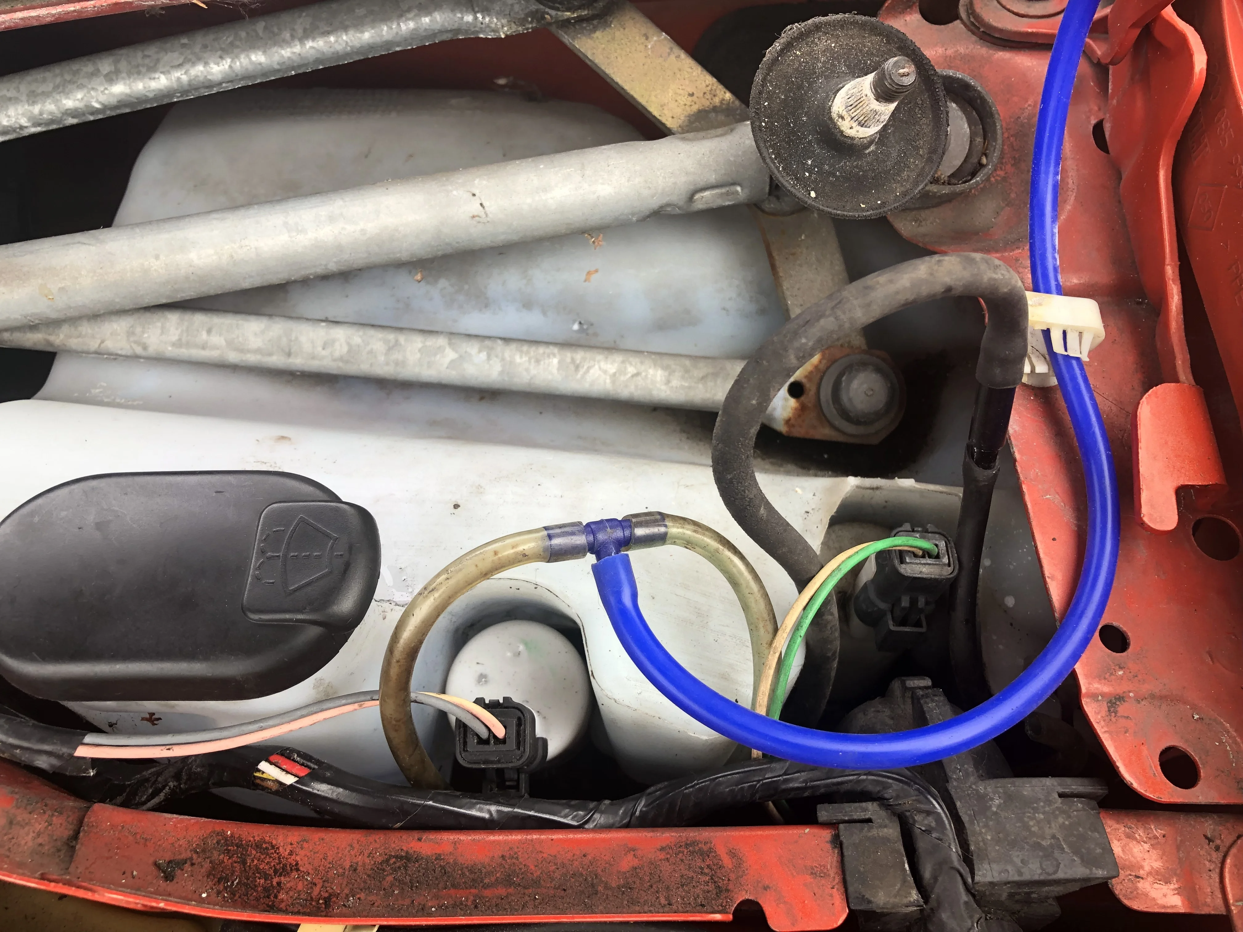

Spent a bit of time out on the Clio yesterday.
The 2 jobs I had to do was strip the 3rd brake light, This was done with much ease and packaged up to be sent to @Touring_Rob to work some magic on it!
The 2nd job was a bit more of a chew as it was changing the washer pumps out of the tank. 1st issue encountered was the fact the bottle was full and I didn’t fancy losing all the fluid.
The problem was solved by using a kids cheap draw back and push water pistol with a bit of tube to draw out the whole 3.5ltr of washer fluid 100ml at a time.
Thought I was winning! Pulled one of the pumps, changed the seal, popped it back in to test and nothing! And yes I topped up the fluid just enough to clear the intake.
Had another looked traced the pipes back from the bonnet and I’d changed the wrong pump! But the new pump wasn’t spinning up but the old one was. I sorted it by switching over the wiring plug but the pump wasn’t to the bonnet. In comes some cheap pipe I had laying around with a fishtank tee piece.
The only slight issue I have now is that when I do the rear washer the front sprays but the rear wiper goes! 🤦🏻‍♂️
I will sort it properly but with winter pending I’m just glad to have jets that work however I am on the look out for some misting jets rather than spray jets. I believe Citroen/Peugeot are the ones to get?
OssPoop
Squirt out the front and wipe the back eh 🤔😂😂😂. I do believe it's the C1 etc mist jets you want, massive difference when wiping the wrong screen🤣.

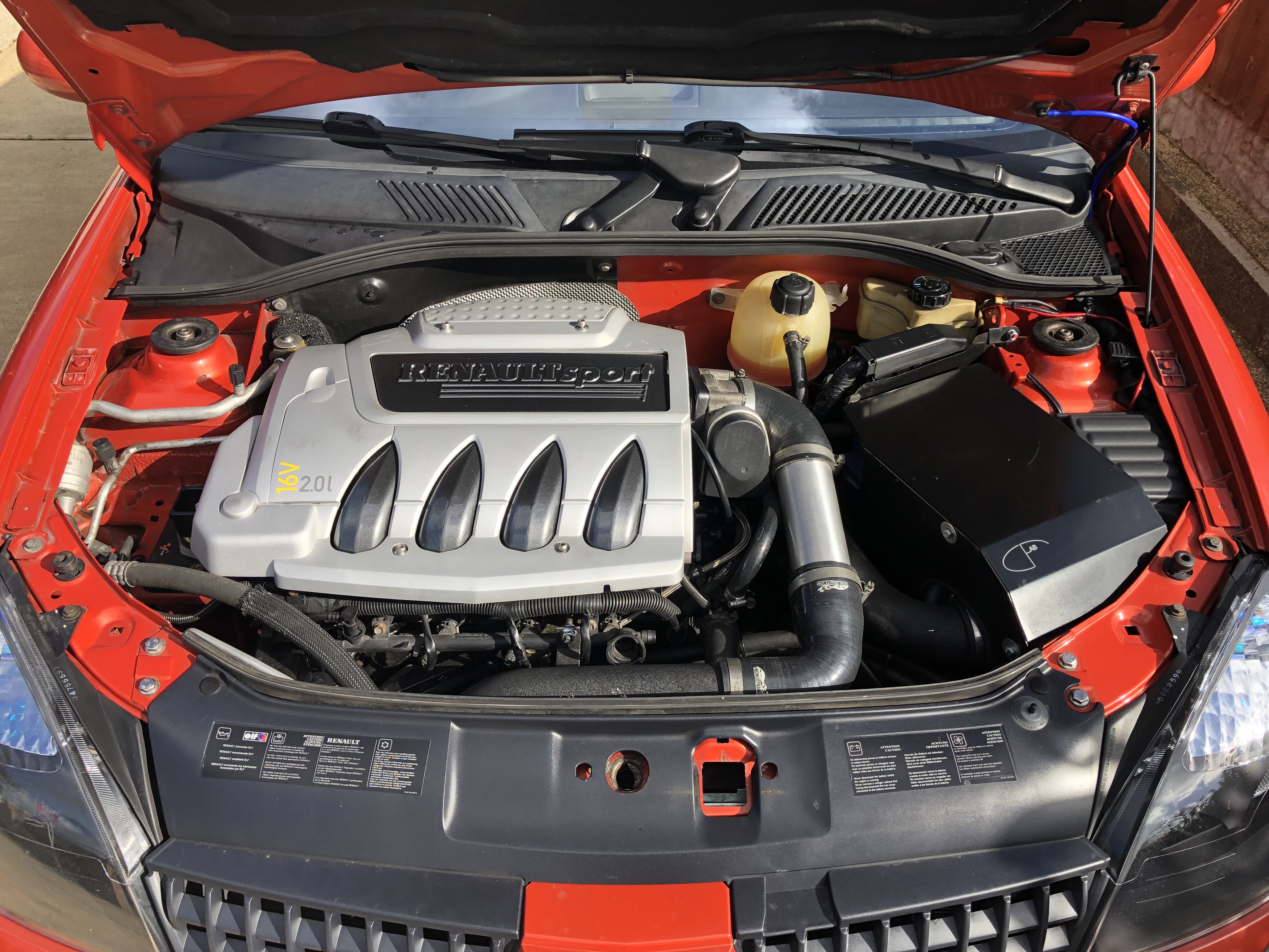

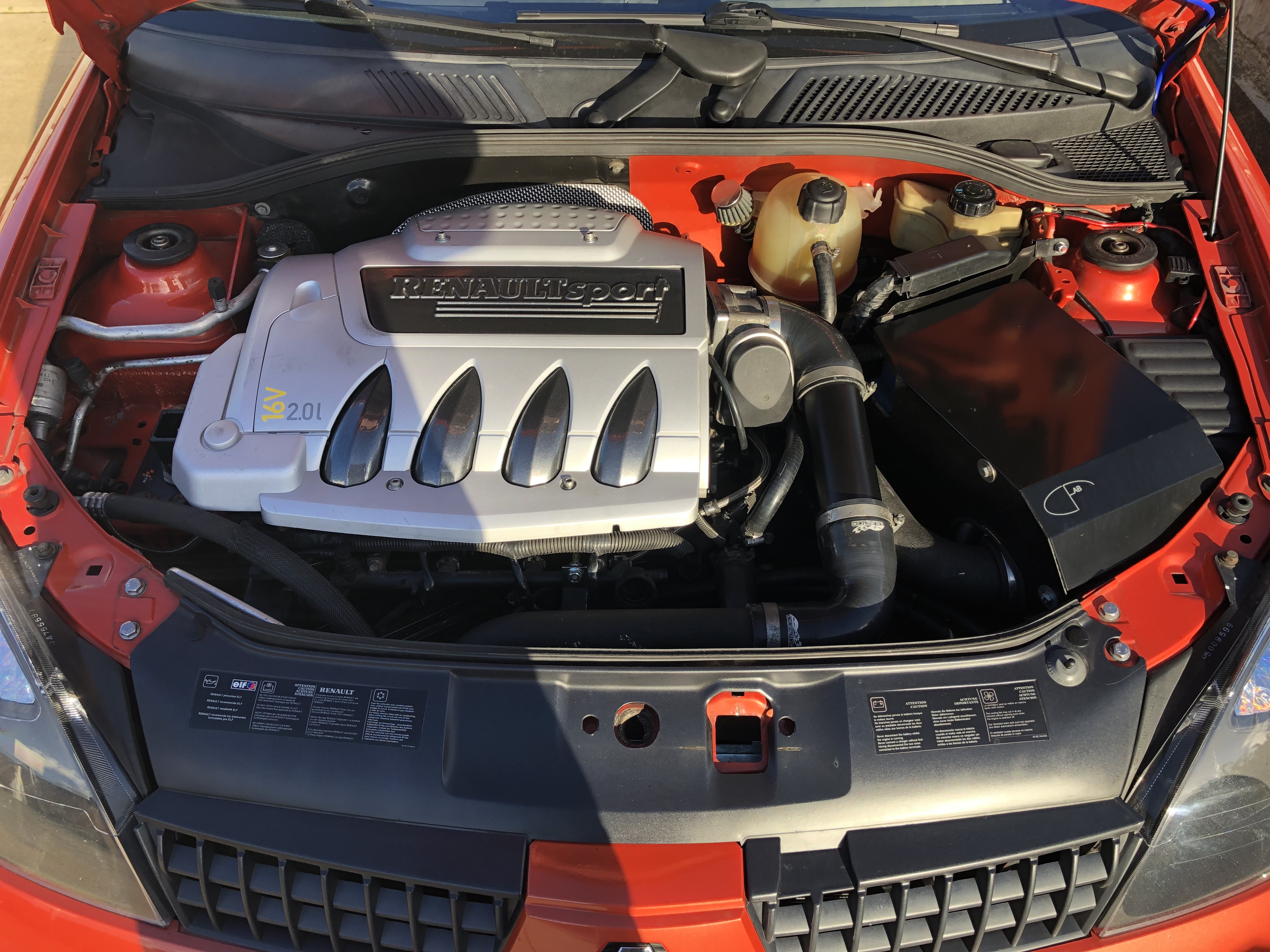

Before…
After…
I didn’t use crackle effect paint for the boost pipe in the end just some satin black I had in the garage. Still undecided if the keep cover OEM grey or go Inferno orange with it.

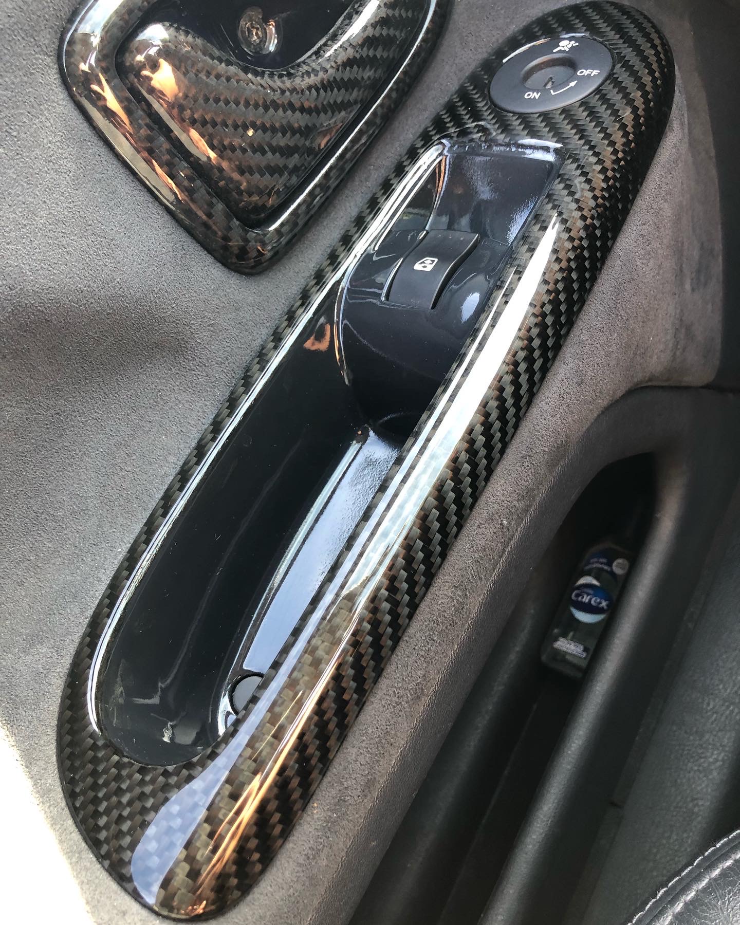

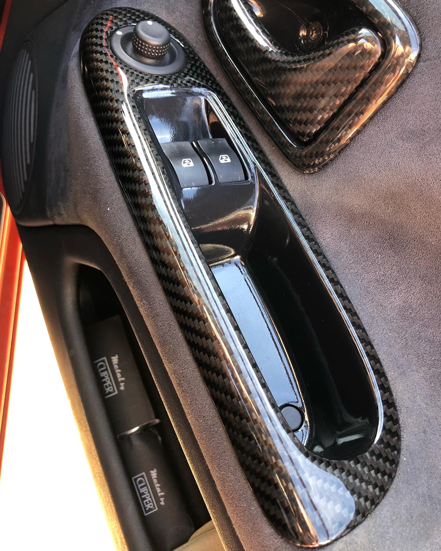

Carbon fibre update…
View attachment 1598463View attachment 1598464
Thanks to @Clio_fool for getting these door grabs out to me, they finish off the carbon in the cabin very nicely without being ott!
As it stands carbon fibre fitted…
Clock surround
Door grabs
Door pulls
Dash trims
Steering wheel centre
Washer blanks
Rear bumper trim
Still to fit after getting clear coated…
Fog surrounds
Exhaust surrounds
Rear washer cover
And I’m on the look out for or may buy new carbon splitter!
@Clio_fool can you still get these ?
