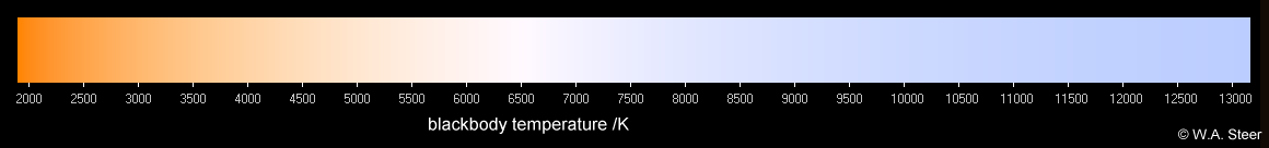

8500k is blue thats why you wouldnt want them 6k ish is what you want
Halogen is a naturally yellow light, these bulbs simply use a blue coating, if you mix yellow and blue you get green!
Sounds daft but its true, the blue coating blocks out a lot of the yellow light and what it does let through it turns more green than blue. They are not worth a penny, you would get more light output by sticking candles in your headlights. The only time 6000K + bulbs actually work is if they are a genuine xenon conversion. I know all about this as i sell xenons and tried selling the high colour temp bulbs too but they were all cack.
