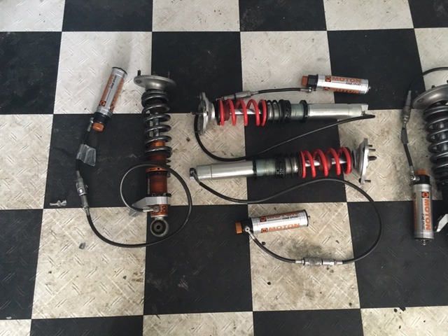

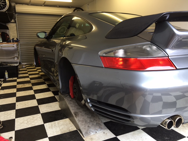

Suspension is away to be rebuilt and dynod , may change spring rates a little and also have the option of upgrading to the newer internal valving.
Hover car ...
neil a

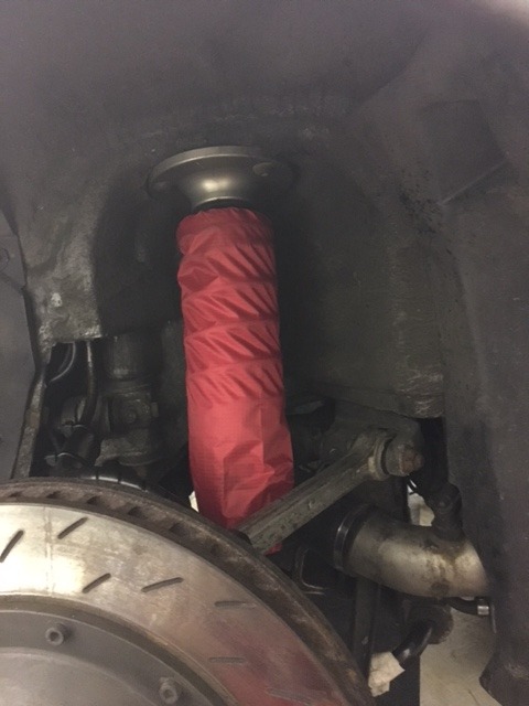

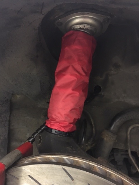

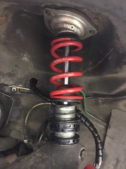

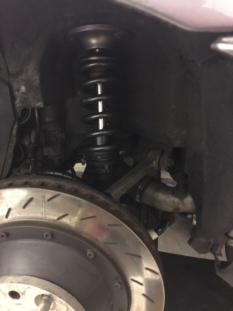

Got my suspension back today after full rebuild
Full strip down
Front bodies blasted and re coated
New seals
1 new piston rod
Oil change
Nitrogen canisters re charged
New springs
New spring seat adjuster

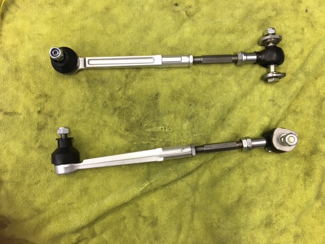

All re fitted and ride height re set with a little more rake than before , will be going in for corner weighting and next week once I have the rest of the parts for adjustable rear toe arms.
Initial impressions are the car is a lot more road compliant and less crash than before, still have to try a few compression/rebound settings as just went for mid point justnow.

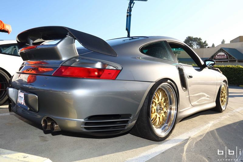

Keeping with tradition its time for a colour change on the LM's , was tempted by gold but they will be going back to standard silver .

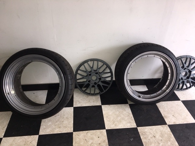

neil a

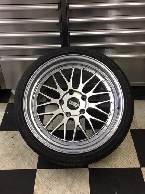

Got the centres back and first wheel built , unsure if I'm going to fit my Cup tyres to these or leave the Contis on. The cups are brilliant but would really make there summer/dry weather wheels.
