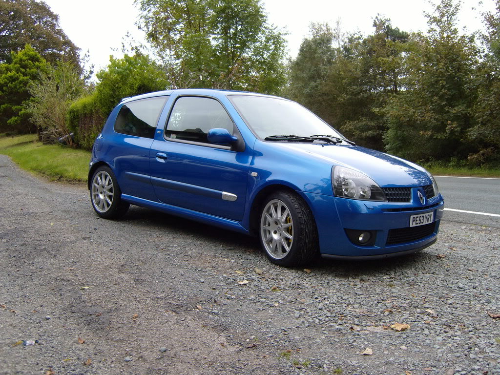

Well i have owned the clio now for around 17months, It belonged to a good mate of mine, here are some pics of how it looked back then and how i looks today......oh and has slightly more bhp too :shock: enjoy!
when i got it
At this stage it had a K&N induction kit, the noise sounded fantastic but it was loosing power due to sucking in hot air! also it had on the 6x4 magnex full system, i wasn't too keen on the exhaust due to the size and weight :D I ran around in it like this for a few months, untill i became a member on Cliosport.net! and then things started to change!

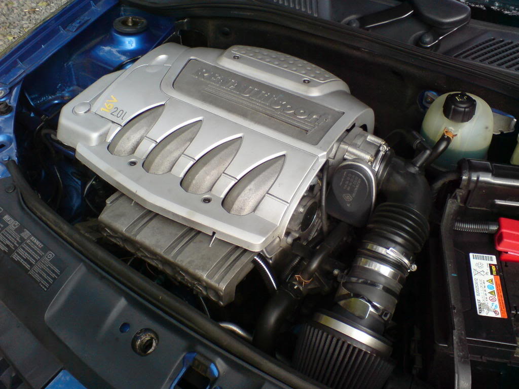

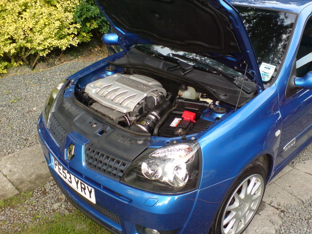

anyway I changed the k&n back to the standard air box and while i was doing this changed the filter inside to a ITG. On here there was alot of talk about fitting the clio 182 exhaust manifold to the 172. being a 4-2-1 it ment better gas flow......so i found one, bought it (which wasn't cheap lol) and now had the job of fitting it! :shock: for this there was only two ways, remove the engine or remove subframe along with steering rack, gear linkage and various other things.... so i opted for the subframe, thanks to John and shaun we got the job done, and while is was all in bits he made me a custom de-cat :).

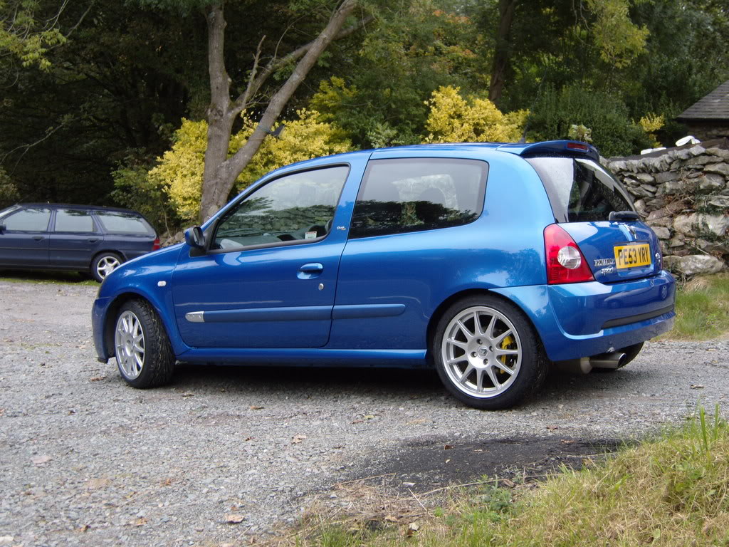

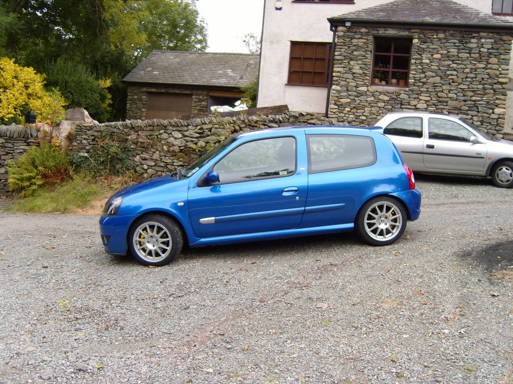

Now it was time for the suspension, after meeting a mate and seeing how low his clio was i wanted something the same
so I sorted out some Eibach sportlines :)

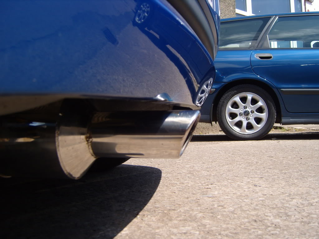

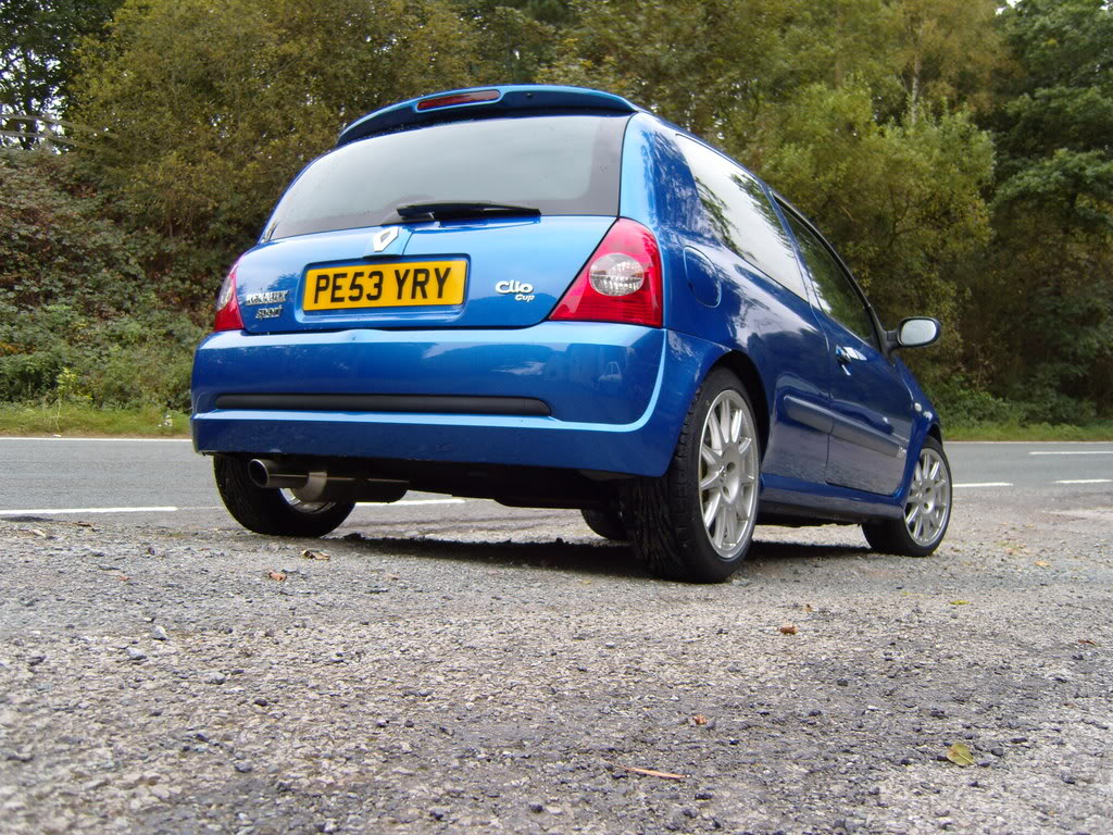

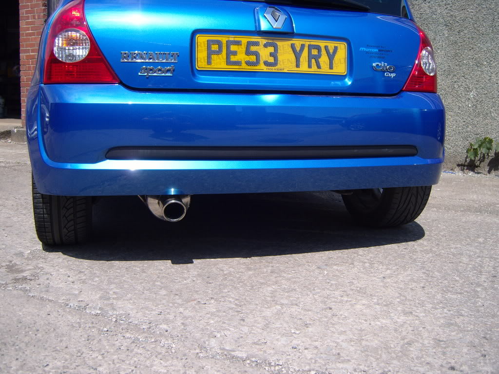

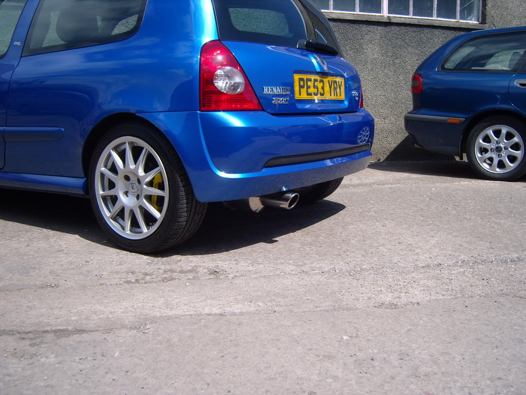

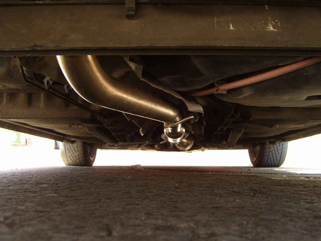

now it was time to change the exhaust! was looking around for good one which people rated.....just by luck a friend (cheers Ben) was selling one, he bought the car with it already on and didn't want it.The Ragnotti system made by Yozzasport. :)

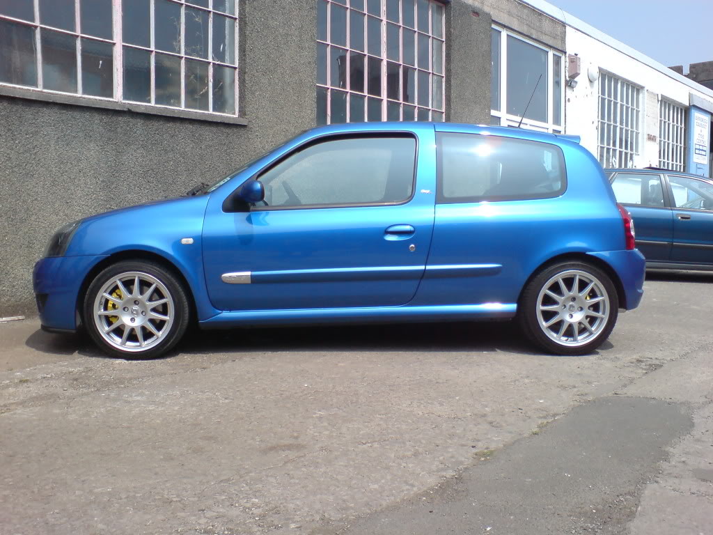

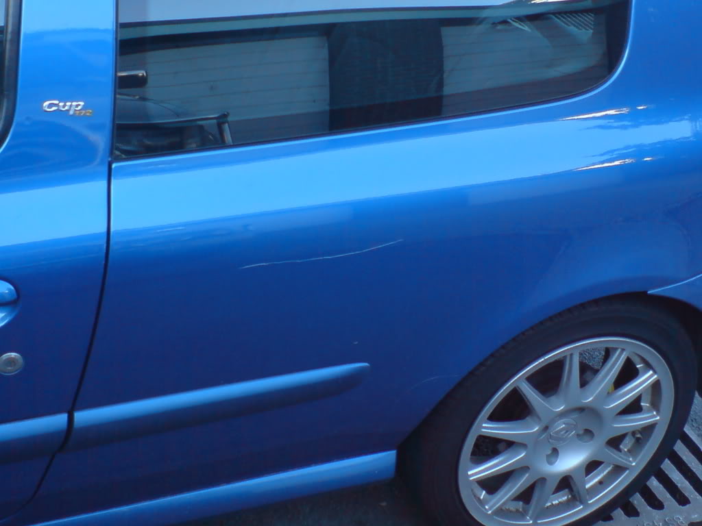

i drove the clio around like that for a few months, but in the mean time some decided to scratch it at the Trafford Center.
so had to get it re-sprayed :( but it was looking better!

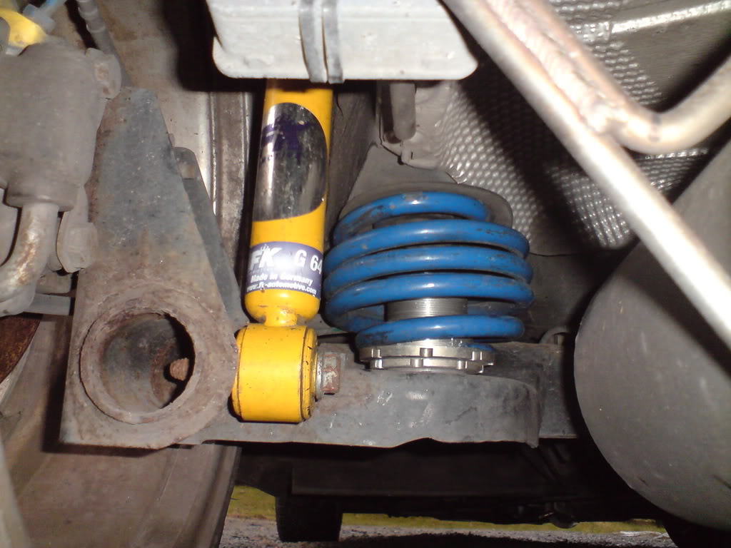

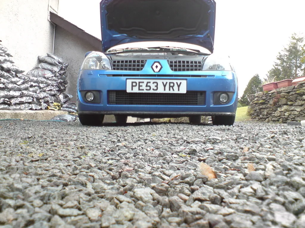

I wanted to go lower with the suspension and wanted a new air flow system :D
so just recently i bought a set of coilovers - FK highsports

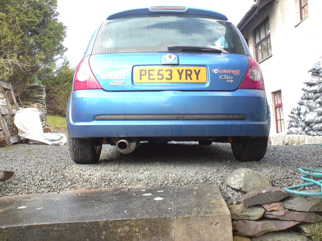

this is how its sitting today

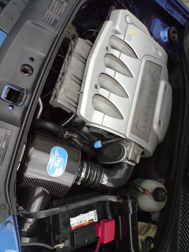

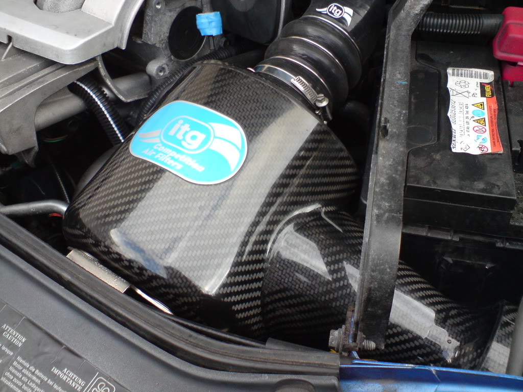

and the new air filter! ITG Maxogen kit :D :D
since the last rolling road where it made 197.6hp 174.8 ft/lb i have changed the exhaust, air filter and had the 'live' re-map i can say it pulls far greater and is soooo much quicker than before! just need a spare day now to get it back on the rollers!

  Coiley'd Clio PH2
Get those coilovers lower at the front!
Take the arch liners out if you have to...

Love it, how much did it cost you to get resprayed after the scratch mate?
cost me £300 to get it done, but what a pain it was!! had to go back 3 times!!!! :mad: I picked the garage due to people rating them and seein some of there work. 1st off they hadn't cleaned the polish/wax off so it went all 'orange peel' effect down the side of the door when they put the lacquor on....2nd time under certain light you could see a slight colour change and a square shape...found out they hadn't put enough paint on!! and it was the primer underneath showing....3rd time they had trapped moisture under the lacquor! so it showed up cloudy took it back and they ended up polishing it out.
As i said i only went to they due to people rating them.

How's about that enginecover ? I thought the Cup did not have this ?

What would you say was the best thing to do ? (probably inlets) Was the Maxogen worth it ? Like your Ragnotti Exhaust !! It's decatted is'nt it ? loud as f**k ?

The engine cover was on when I bought it off my mate, left it it on. The best thing to do.......thats a hard one! I got 12bhp out of it for doing the inlets, but I got the car already with head work, when The guy was doing my inlets he had a look at what LAD had done to the head and he said they had done a very good job! all smoothed out and enlarged as much as it could go. :)
The torque the car has got is unreal even when on the rollers the guy at JDM was saying how impressed he was with the power curve. And now with the maxogen it seems to pull even harder....need a RR test done again :D
AS for the yozzasport, yes its de-cated..its not very loud - on motorway driving it can get annoying but I don't drive on the motorway much. Very good system though :cool:
