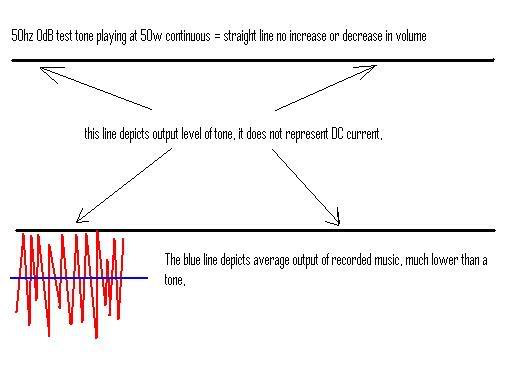

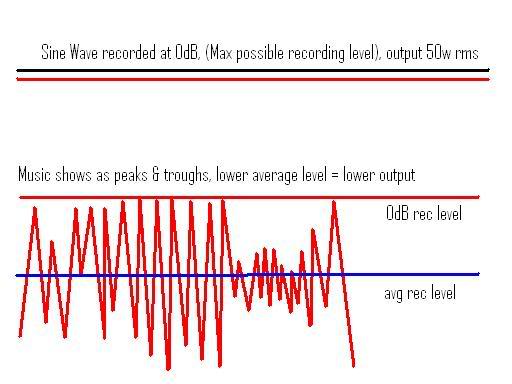

8, the art of speaker & amplifier matching
firstly i should point out that when selecting speakers or amplifiers you should ignore max output figures, they are misleading and rarely accurate. you should however take note of the rated figures,(commonly noted as RMS figures).
the RMS figures refer to the output that the unit can output continuously.
secondly, i should point out that recording levels vary from source to source, so for example a 50hz test tone recorded at 0db,(the highest possible level), will play extremely loud, where as the same test tone recorded at -3db will play at around half the volume. this sliding scale can become extremely confusing so i'm not going to go there lol.
so in effect a 50watt rms amp will deliver 50watts rms when playing a test tone recorded at 0db, but will deliver much less if playing a test tone recorded at -3db.
if you were to represent a test tone on paper it would be a straight horizontal line.
if you were to represent music in the same manner it would be a series of peaks and dips, now because the maximum recording level is 0db, the peaks would be recorded at 0db, everything else would be recorded at a lower level, giving a much lower average output. so because of this when selecting equipment you should bear in mind what you will be playing.
so i always take note of the speakers rms figures, then select an amp that is rated at least 25% higher, so if i was selecting a mono amp to drive a sub, i would check the subs rms figure, say its 300watts rms, i would then look for an amp capable of delivering at least 375watts rms into the correct impedence, the same applies to all amps and speakers. this is referred to as,"headroom".

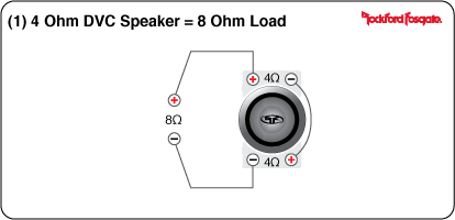

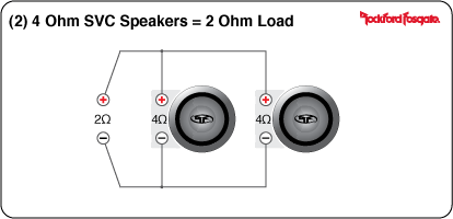

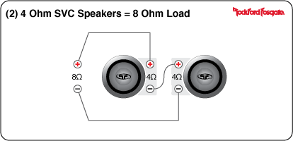

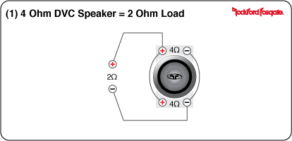

a few basic facts regarding OHM'S LAW
the ohm is a measure of impedence, this can become confusing so i will keep it basic.
if an amp is producing 50watts rms into 4ohm's, it will produce 100watts rms into 2ohm's, so if you halve the impedence,(ohm's), the output doubles.
the same amp at 4ohm's is drawing say 25amps current, at 2ohm's its draw will also double to 50amps, so if you halve the impedence, the draw,(power needed), will double as does the output.
if wiring either a dual voice coil sub or two or more subs in series you would add the ohm's value off each coil together, for example;
if wiring the same subs in parallel, you would halve the ohm's value
any question's----lol.

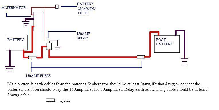

ok, over the last few weeks i have seen a number of cars that have split charged boot batteries. the vast majority,(in fact all but one), have been wired correctly but with woefully inadequate cabling/fusing.
apparently, the main culprit seems to be the,"over the counter split charge kit".
thought i had best offer some advice in the hope it saves anyone else being caught out!!
in these kits you get a 180amp split charge relay, so by definition the suppliers are expecting,(quite correctly), large current surges/draws. but for some reason these same suppliers include either 10awg or 8awg power cable
with 30amp fusing
in the interests of safety i always follow the basic rule that all power cable should be capable of handling the max possible current draw, (which includes the battery connecting cable), and fused accordingly.
had a young lad last week who purchased one of these kits from a reputable local I.C.E. outlet along with a JL AUDIO 12W7 and JL AUDIO 1000/1 amp, he had fitted it correctly and duly visited the local haunts of the young boomers. he played his system for around 25 mins at moderate volume with no issues. when it came to driving home he simply started the car and drove away....his system shut down halfway home because of a flat boot battery. the poor kid thought he had toasted his system because everytime he replaced the 30amp fuse in the split charge circuit, it blew as soon as he tried to start the car...
the problem is, on initial start up of the car, not only does the alternator try to charge the rear battery, so does the fully charged starter battery,(i have seen 200amp breakers trip on startup before
), so a puny 30amp fuse coupled with cable rated at 30amps over 5mtrs doesn't stand a chance
so, if theres a slight possibility of your system being used when the car is not running, use at least 4awg power cable fused at 80amps,(you can stretch this to 100amps if needed), if you will definitely be using your system with the car not running, then 0awg is really your only option,(but do not exceed the relays ampage with power cable fusing)....
EDIT; forgot to mention, the split charge relay should be mounted inside the car to protect it from the elements...
heres a quick sketch which should help you avoid this issue...

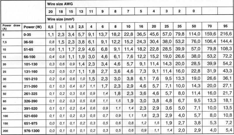

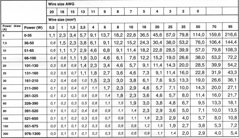

BASIC POWER SUPPLY INFO
There are two basic parameters used when working out which size cable you require;
1, The SAFETY angle, (bare minimum)...
2, The PERFORMANCE angle, (limits voltage drop)...
I would always recommend you follow the PERFORMANCE angle, this covers SAFETY and limits voltage drop....
A FEW POINTERS;
1, Always ADD an extra Battery to Chassis Earth to match your new power cable, (You can't take out what you can't put back in)....
2, Keep power & earth cables as short as possible, (power cable should follow shortest route from battery to amps)....
3, Car Chassis are good for earthing approx 350amps, (if total max boot draw is in excess of 300amps then I recommend earthing back to battery via multiple cable runs)....
Heres a cable chart based on Performance
To work out your amps power requirements the easiest way is to simply add all on board fuses together, so an amp carrying 3 X 40amp fuses would have a max draw of 120amps, if working out a main batt to boot power cable simply add all on board fusing from each amp to give an overall max draw, then simply fit the correct guage cable for that given length.....
You can, with experience, modify power cables in accordance with actual source material being played, there are so many variables you can take into account that it can get confusing.....
ummm something wrong there but thats DC.
What is it with you & DC????
If you don't grasp the analogy then say so.....
Just for you;
As in constant output with no fluctuation, no increase or decrease in output volume, a straight horizontal imaginary line.....
So, bass hits, output increases to a peak, no bass, output dips, no background music output decreases causing a dip...
Thats ^ pretty much self explanatory.....But, just to clarify,
A basic sketch, Hope you understand now;

im sure that when working out current for the power cable you dont just add up the fuse rating on the amp. i read this somewhere recently too. just off the top of my head.
as i said to you before, 0awg power cable for a twin amp setup (fairly low current like 80A for a mono and 40A for 2channel) doesnt require 0 awg.
seroius amount of overkill
1, how do i know what size power cable to run?
the answer in basic terms is;
add up the on board fuses on each amp you are going to use, say your mono amp (for the sub/subs), is fused with 2x 40amp fuses,(80amps in total), and your second amp,(for the fronts or fronts & rears), is fused with 2x 30amps,(60amps in total), then you can work on the assumption your maximum current draw is going to be 80+60=140amps, so with this setup you would require 0awg power & earth cable.
This BASIC formula was to cover all the bases, if you wish to be exact in your working out then lets play....
By using the quoted method your avoiding issues like impedance, source material rec levels, and such, your simply fitting a cable which will supply enough current over a given length with minimal voltage drop.....No matter what your running off the amp.....
The average distance between a car bettery and its boot is say 3mtrs, (that fair???), 4awg at 3 mtrs carrying upto 120amps will lose voltage, lost voltage is lost output...
I always fit cable with performance in mind, if you cover the performance then you've certainly covered safety....

what I'm saying is that you can't just say a 50Hz sine wave is a flat line then say music isn't flat even if it just an ANALOGY
  vaux cavalier
The flat line represents the percieved volume level of a sine wave, as in it maintains output or a given voltage across the amps output terminals....
If you play a 0dB 50hz sine wave at full volume through an amp and take a voltage reading off the output terminals the voltage will remain constant, (this is how JL AUDIO recommend you set the gain controls on their amplifiers), this is because output is constant, it doesn't rise or fall, so theoretically this can be shown as a horizontal straight line......
Now play a music track at the same volume setting and watch the voltage reading, it will rise and fall in accordance with the music, this reading can't be represented by a straight line, you can however gain an average reading which again can be represented as a straight line.......
So, in pic;
Flat black horizontal lines represent output level, volume level, output voltage of a sine wave, no change in voltage = no fluctuation in output so no peaks or dips in line.....THIS IS NOT A PIC OF A SINE WAVE.....
Jagged red line represents output level, volume level, output voltage of recorded music, frequent changes in voltage = lots of changes in output, so plenty of peaks and dips in line.....THIS IS NOT A PIC OF A SINE WAVE.....
Flat blue line represents average output level, volume level, output voltage of recorded music, lower average output voltage = amplifier will never reach rated output.....So to gain full potential from speakers opt for a larger amp....
Please note, I'm not being cocky, I'm not being arrogant.....
I don't consider Mr Dink to be slow, less knowledgeable or thick, his mind is simply full of techno babble which won't let him grasp just how basic or simple this ANALOGY is.....The fact he's willing to disagree shows he at least read the thread.....
1hz = 1 cycle per minute
50hz = 50 cycles per minute
each cycle is 360 degrees if 360degrees were to be represented by a speakers cone it would be from;
rest or ref--to--full outward excursion--to--full inward excursion--to--rest or ref....
You should also understand that a speaker receives power through both connections, +ve voltage pushes the cone outward, -ve voltage pulls the cone inwards....
In basic terms when watching a SINE WAVE on an oscilloscope each upward peak represents the speaker cone being at full outward excursion, each downward peak represents the speaker cone being at full inward excursion, no power to speaker would result in a flat trace depicting speaker cone at rest or at its ref point.....
When using an oscilloscope to set amplifier gains, too little gain results in a shallower wave form, (as in less cone movement), too much gain results in a squared off, (or clipped), wave form, (as in the speaker cone is reaching full excursion and actually sitting there for an extended period).....This extended period at full excursion actually increases the rms power of the signal and causes excessive heat build up leading to premature coil failure....
Clipping can be heard as distortion, but be advised, detecting clip through a sub is very difficult.....
If you now translate the pic of the SINE WAVE kindly supplied by Mr Dink to an amplifier, you can take the upper limit to represent the +ve voltage rail and the lower limit to represent the -ve voltage rail, lets say at full volume each rail runs at 100V with the amp receiving 14.4V.....If you lower the input voltage, then the +ve rail & -ve rail both lose voltage also, this in effect will narrow the distance between the upper & lower limits, as these limits narrow the chance of clip greatly increase.....
Hopefully you can now see why stock head unit amplifiers distort at moderate volumes when suffering internal voltage issues caused by flashy graphic displays etc etc....
Just to add all the above is just an opinion;)

Tell you what, draw me a horizontal line depicting output rms voltage from your JL 1000/1 at full volume playing a sine wave...
Lets say 1" in length = 10seconds.....
Now draw me another horizontal line depicting output rms voltage from your JL 1000/1 at full volume playing music...
Again, 1" in length = 10seconds.....
Assume you play each for 1 minute, so each line should be 6" long.....
Awaiting your pic......
  Polo + Micra
well being as they are both RMS
(meaning the square root of the mean squared)
they would both be horizontal lines the music one being lower than the other
  vaux cavalier
Thankyou....I do believe we are both now on the same page.....
