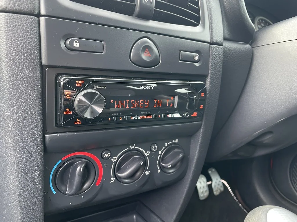

Then, one of the first things I wanted to improve was the audio to make the car a bit more usable every day - both in terms of sound quality and things like Bluetooth.

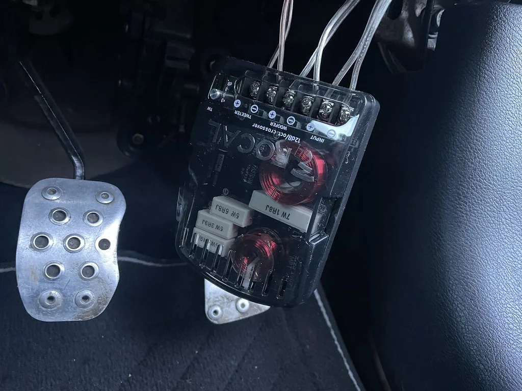

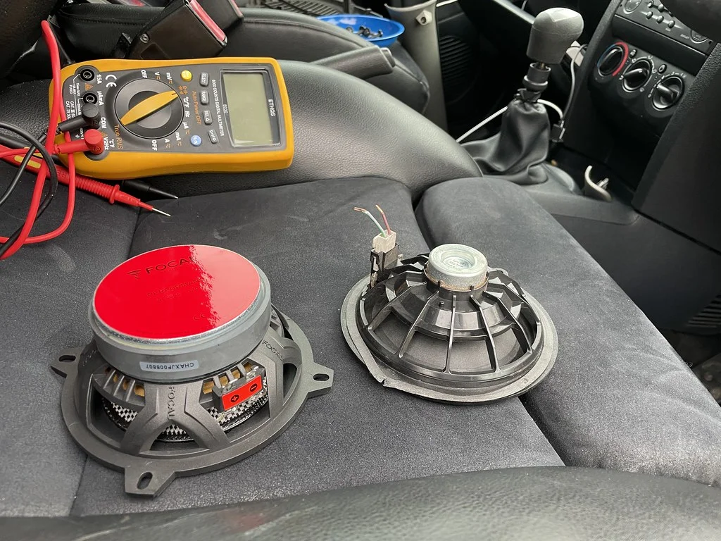

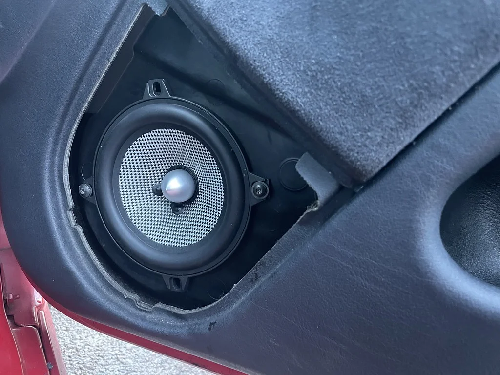

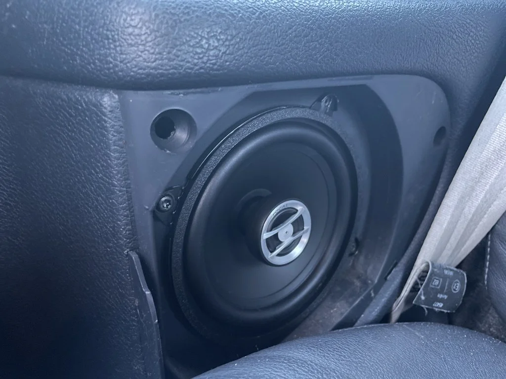

I decided on some Focal AS130 component speakers for the front, Focal RCX-130 co-axial speakers for the rear and a Sony DSX-GS80 to power them. The special thing about the DSX-GS80 headunit is that is has the power to drive the speakers without the need for an extra amp (4x100w max / 45w RMS).
New vs. Old - A big difference in size!

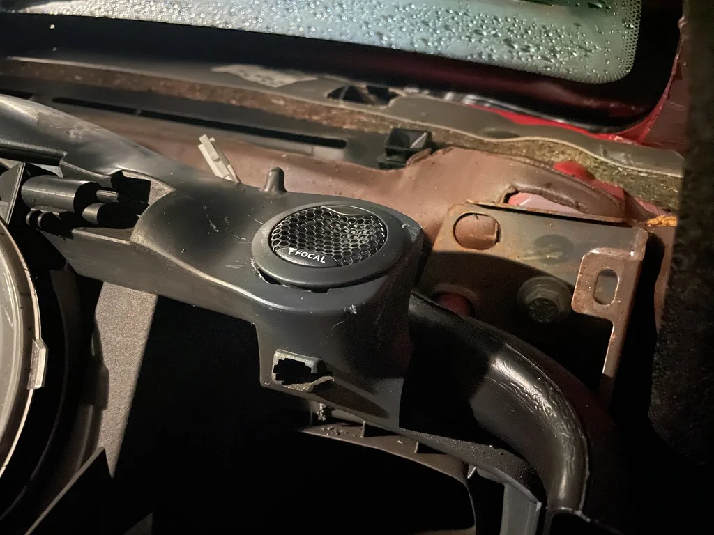

Fronts fitted re-using existing wiring and tweeters in stock location :)
Rear was super easy:
And the headunit in - I'm just waiting for a new steering wheel adapter lead to arrive. It turns out a normal Clio 182 lead is no good, and I actually need a canbus one from later models.
The improvement in sound is incredible. I'm on the fence on whether I need to add a sub. It would definitely benefit from it sound wise, but it sounds great as it is and it's not really following the Trophy ethos.

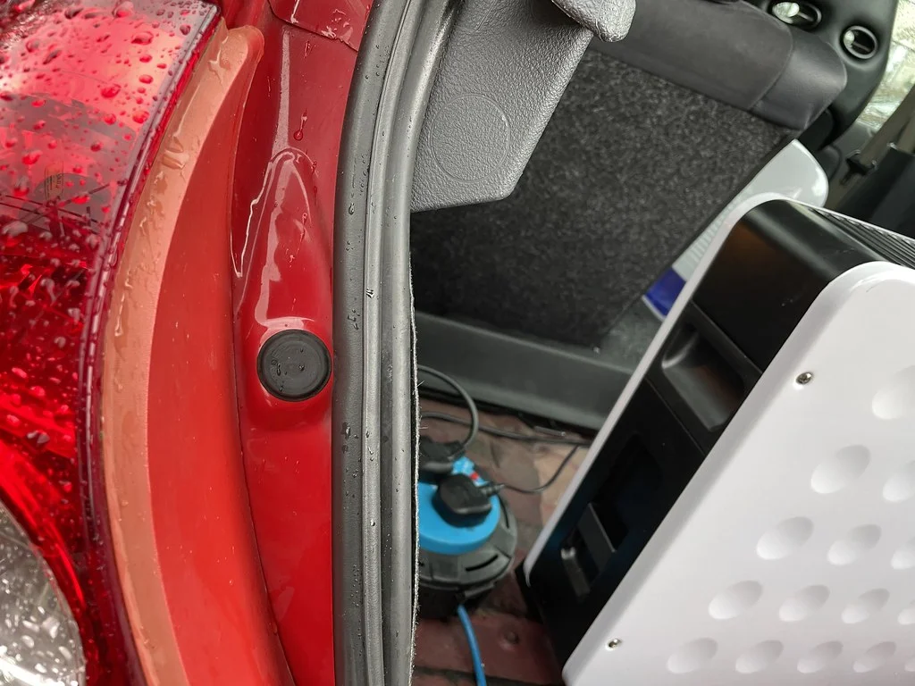

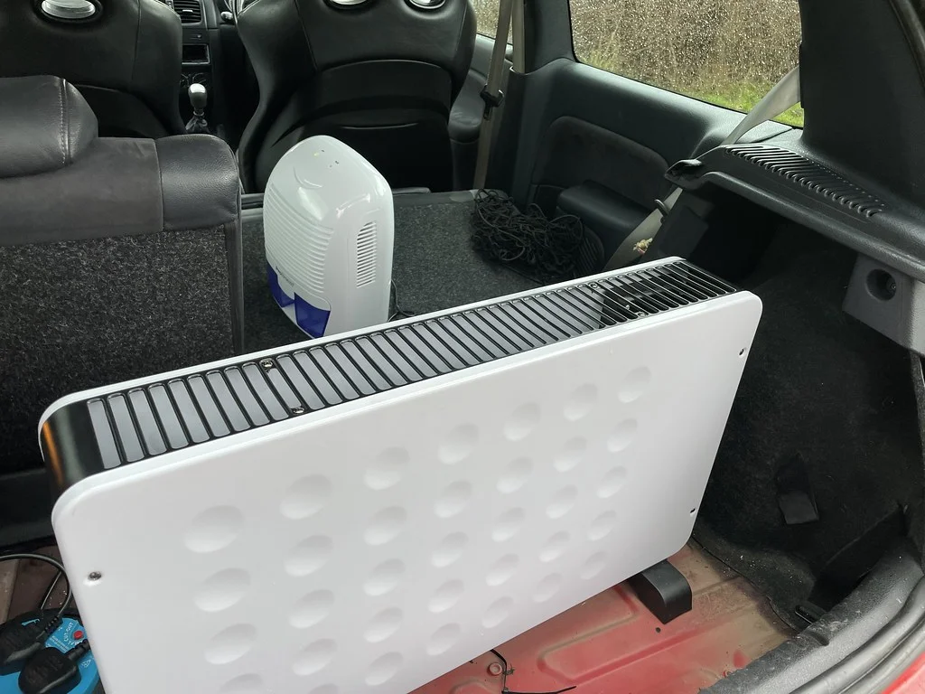

While fitting all this, I discovered a leak - a fair bit of water under the rear seats.
I tracked it down to this silly little grommet.
Hopefully that's the only place that water is coming in.
Now just need to try it out with the help of a heater and dehumidifier.

Did you replace the boot Grommets with new ones ?

I just siliconed the old ones.

I just replaced the Boot grommets on my car with new items from Renault. I think they were a couple of quid each.
The new ones are a much tighter fit and have little clips on them which have more than likely perished on the ones on your car. For the price of them, I’d just get new ones.
