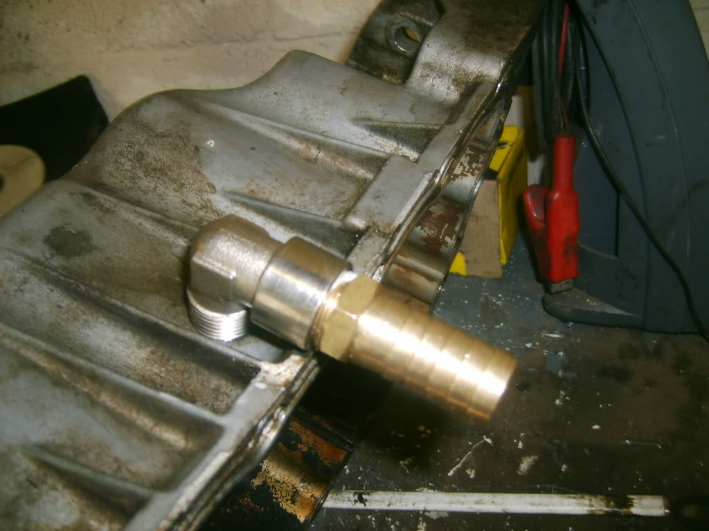

I'll check tomorrow for you as I got hose tails and stainless tees made up for the standard hoses then when I fitted the forge hoses I realised I never needed them.
The turbo connections are 13mm.
Like this.
