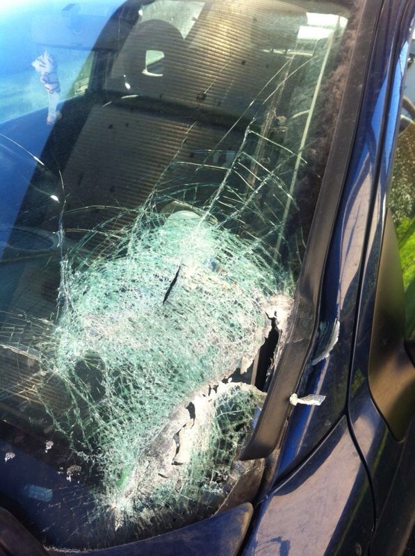

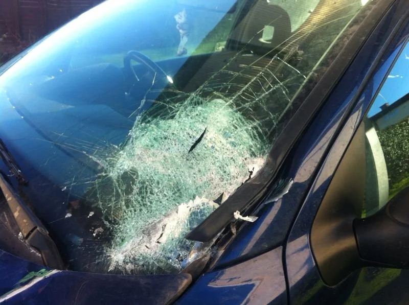

My friend did this earlier.. What are the chances if autoglass being able to fit a new screen???
She's panicking as she needs the car for work etc..

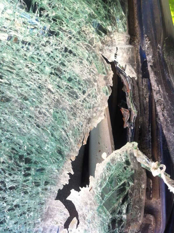

At a guess, the problem would be wether the a-pillar is damaged where the bead sits. Won't know until the screen is off probably.

Looks knackered to me but I'd rather someone's opinion who's in the know.. Clipped a parked up trailer.. As in tractor and trailer.. She has rang them but they can't come until weds and they couldn't say over the phone without looking st it.
  S4 Avant
Repairing that would involve chopping the A pillar out and welding a new section in from a donor car.
Massive costs.

Autoglass won't fit a screen to that, the part where it meets the windscreen would have to be straight first. The dent on the outside is f**k all, it all depends what it looks like where the glass meets the pillar whether it'll be a write off or not.
  BG 182
Shitt! Assuming the trailer didn't drive into her, is she fully comp? It's a matter of the insurance deciding if the pillar is feasibly, legally and economically repairable. It will probably be brought from a write off auction and repaired by a dodgey Indian garage in high wycombe :)
