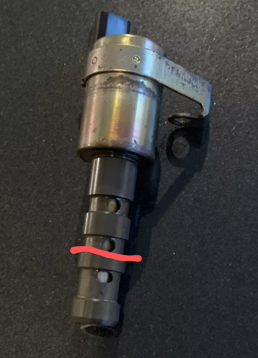

Got a pic of the solenoid? I don't understand how it's snapped? Unless they mean snapped the connector off it with the slip of a ratchet or somthing??

Photo taken from the Internet but its the metal casing thats snapped along that red line.

The dephaser, as I recall, uses oil pressure to phase the inlet cam 16 degrees over a certain set of driving parameters including MAP reading, throttle position etc etc - so the cam position naturally should be fine for idle - ie it should NOT run rough or badly even with that solenoid broken. I would be checking the timing is right, immediately. Its a fairly rudimentary setup on the 1*2 in that its not fully variable, the phasing of the cam is ON (16°) or OFF (0°). True VVT is a PWM setup that would be able to vary the cam phase from 0° to 16° and any value in between.
Additionally I dont believe you need to remove the solenoid to do the belt or change the dephaser pulley so why were they messing with it?
Ask them to explain the process they used to set the cam timing, write down what they say and transcribe it here - theres a fair chance they havent done it right.

A new solenoid has been fitted which has greatly improved it but its quite lumpy on idle still. I'll be taking it somewhere else to get it fully checked over. They took the solenoid out to take the cam cover off as it was leaking.
