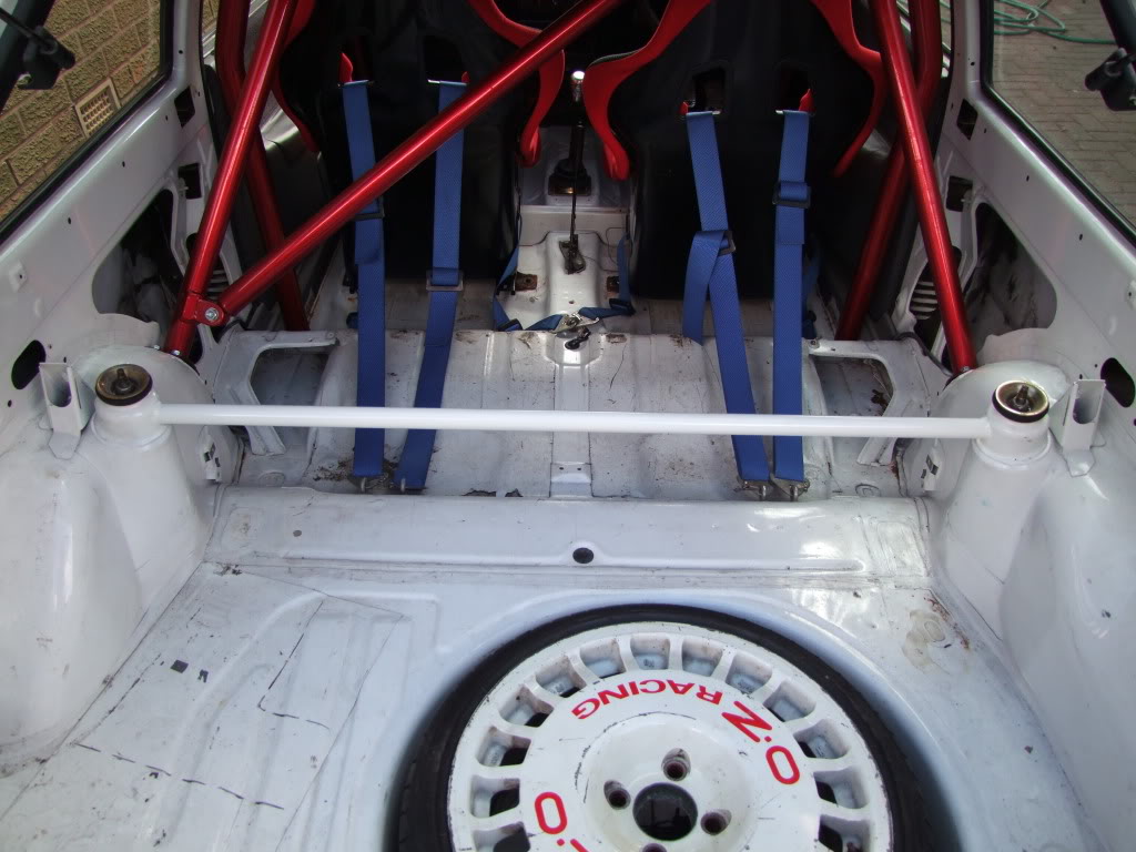

This one would work, as it is mounted/welded to the actual shell of the car and would obviously stiffen the back end up.

Many chuckles, it seems each thread on CS at the moment can't help but deliver. Rear strut bracing is only effective if it is welded (like Craigus photo above) onto the actual shell, I.e the part of the car flexing under increased stress.
