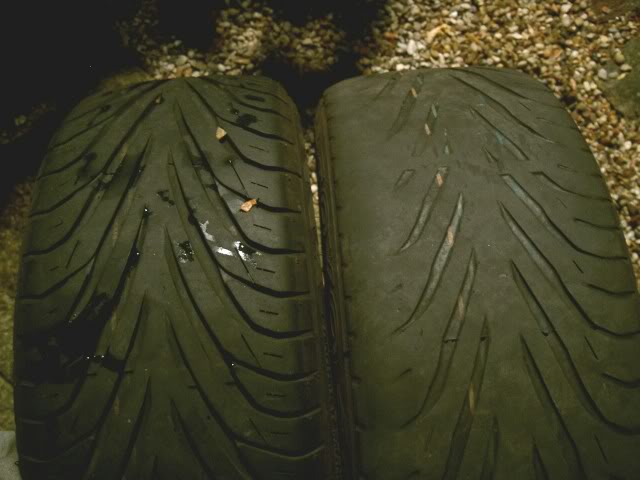

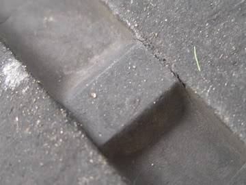

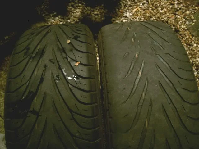

but sometimes using the makers isnt the right thing to doo look at this tyre its not down at the wear markers but its an illegal tyre due to that bar that runs all the way across is flat
  182
Haha.. does seem a bit weird as if you had say 205 width tyres and they were on the limiter you would still get more grip than a brand new 165 tyre (correct me if i am wrong!!)
Despite this still wouldnt let mine get under 2.5!
Hypothetically speaking... ;) on that tyre in the photo, if you were to remove the bar, you could carry on using it for a little while longer, no?

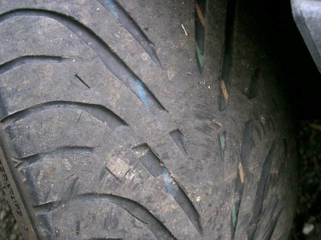

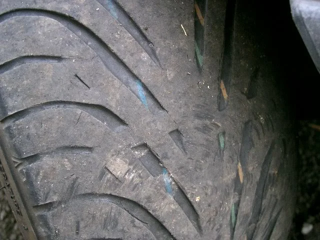

Yeah I'm not worried about using new tyres if I do a track day, the thing Im more bothered about is the handling of the car when they are very low... or what I think is low :S there isnt really any difference in the marker to the tyre now, just a slight bit so I'll change them now regardless I think... they have done 22k and 4 track days!
  Clio 182
Ambo said:
^^done well to get that out of tyres...assuming fronts of course!
Yeah fronts! I guess I mainly drive around London and on motorways hence why they've lasted?
Maybe I should take a pic of the markers :S
  182... again!
...or buy a tyre depth gauge, cheap enough and then you know for sure what they are!
  182... again!
^^think when they are actually flat/smooth from the tread across to the indicator then thats 1.6mm.
