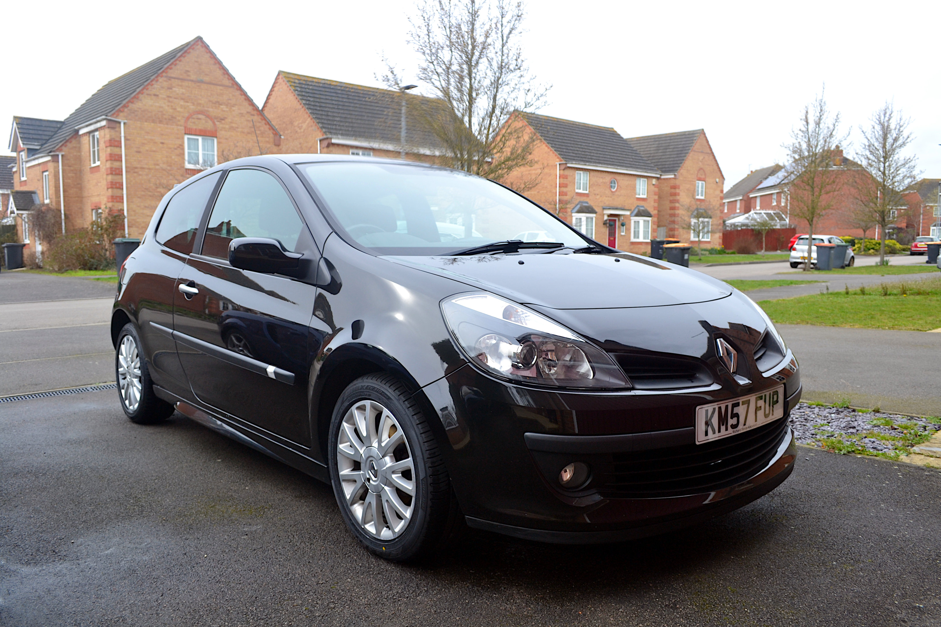

Here is my 'as delivered' photo of the car, given it a quick wash and wax - paint will need correcting but currently going through everything to get it in top shape, just got the cambelt, waterpump and all belts replaced as well as a set of new tyres.

Good choice, it's based on the later d4f engine from 2004> so the 75hp one with the large black airbox/engine cover all as one. It got an aluminium inlet manifold with different throttle body and if I remember right the only difference internally was stronger valve springs, there was a breif when the engine was new.
Set of 172/182 injectors and a good map will see 145+ hp, efi parts done one last week.
