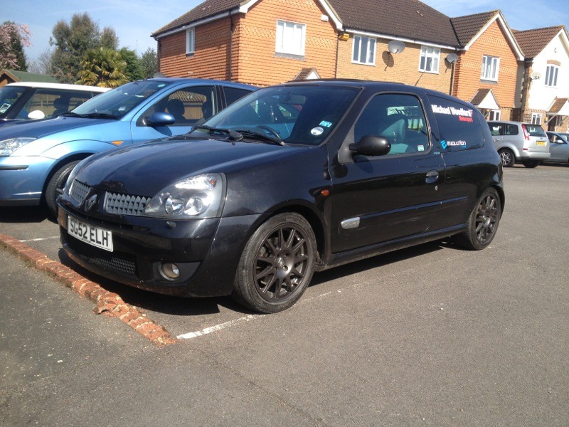

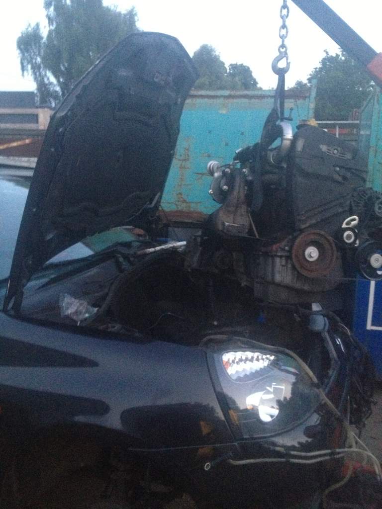

After a safe return back to the workshop, the work begun, old engine out, complete new engine in. Start it up and it sounded like an utter dog! 4 totally dead injectors! £600 in Renault later and she was alive, be it bloody slow!
When your use to a 200bhp Ph1 172 as a daily, this really doesn't excite you in anyway shape or form. How ever, 600ish miles to a tank and £30 a year to tax, who really cares. I PROMISED myself this was a cheap get around and all spare funds would be going towards my Westfield Cosworth project AND THE DCI WOULD REMAIN TOTALLY STANDARD!
How ever. Lately I've sorta slipped up, it all started with a cheeky remap, i mean what the hell, I own the kit to do it so why not. The gains were epic! It turned quite a mundane boring to drive car into a little warrior. Loads and loads of torque. It just made it feel right and when you went to overtake someone at 70mph, it just felt more safe to do so!
Next I went over the local scrapyard for a wiring loom from a mini for the westfield only to be greeted by a DCi106 that had been smashed hard up the back! It had always bothered me that my DCi didn't come with an intercooler and as there was one here with all the pipes for £40. Baaahhhhh what the hell!
As I had all the boost piles off my DCi anyway to fit the intercooler I decided to remove the EGR valve too as if I drove round town a bit, the next time I gave it a boot full, it would smoke the town out, then clear so I decided to rule it out anyway.
Removing the EGR valve and housing perfectly exposed the actuator arm for the turbo and I noticed it was adjustable from the factory! As it was now intercooled I though what the hell, a bit more boost won't hurt and wound it up by quite a margin.
THE RESULTS ARE EPIC!
Thanks to the lack of EGR and colder air the fuel consumption has got even better than it was! And the little 1.5 has been turned into a little powerhouse. The car is So So So much fun to drive now. It really takes off well from as little as 1500rpm in any gear whatso ever.
I'm really really happy with it, so happy infact, I've just agreed to buy some Turinis for it. :)

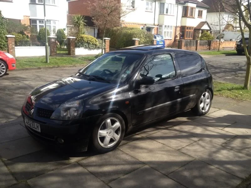

Have done a little more to the old girl today!

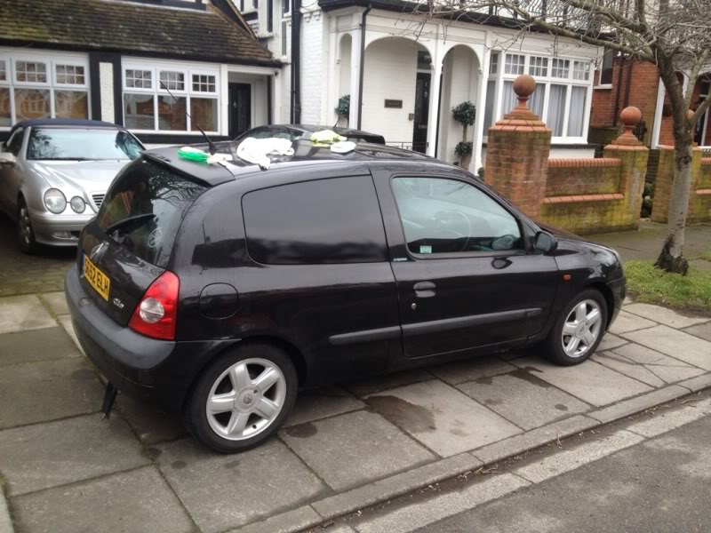

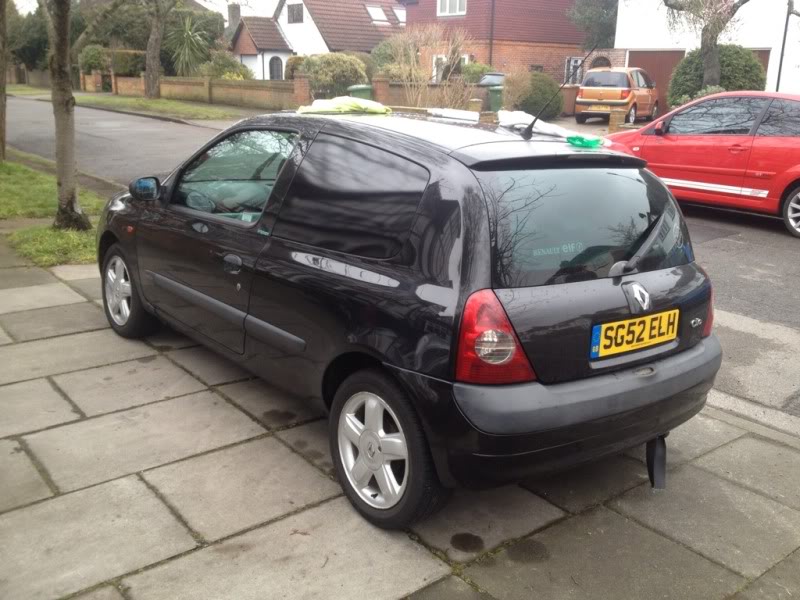

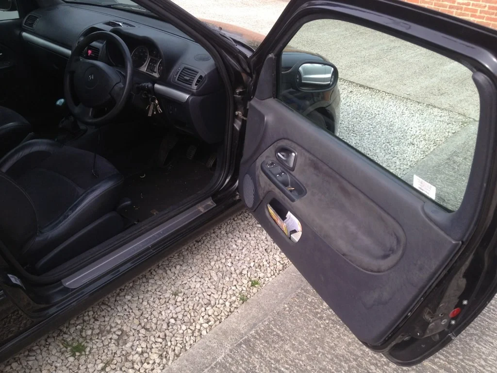

She clicked over to 164000miles so I gave her a fresh sump of oil and a new filter. I like to change the oil on my own cars every 6-8k.

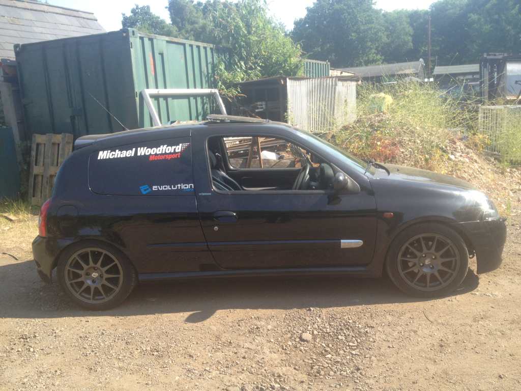

I also ordered some gloss black vinyl to fill in the rear windows to make it look like a van. More often than not, its used as a van anyway. £9 delivered off eBay and I didn't hold much hope but it actually looks really good (I think)

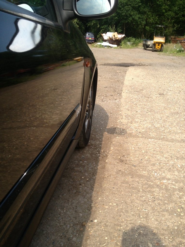

Next after changing the springs on my brothers turbo clio too coil overs, I nabbed his old apex springs off him to fit to the DCi car/van. The springs are firm but I think the ride hight is spot on.
Tomorrow I collect my new wheels from the refurb'ers. :)

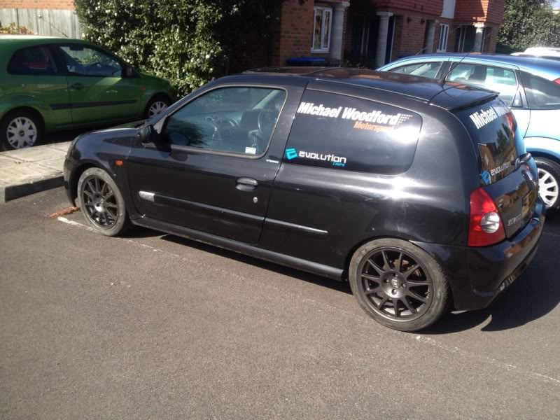

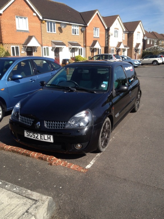

Couple of bits a bobs done to the car this week.
Gen Renault Clutch kit
Gen Renault High pressure pump
Gen Renault Cambelt, auxbelt kits coolant and water pump

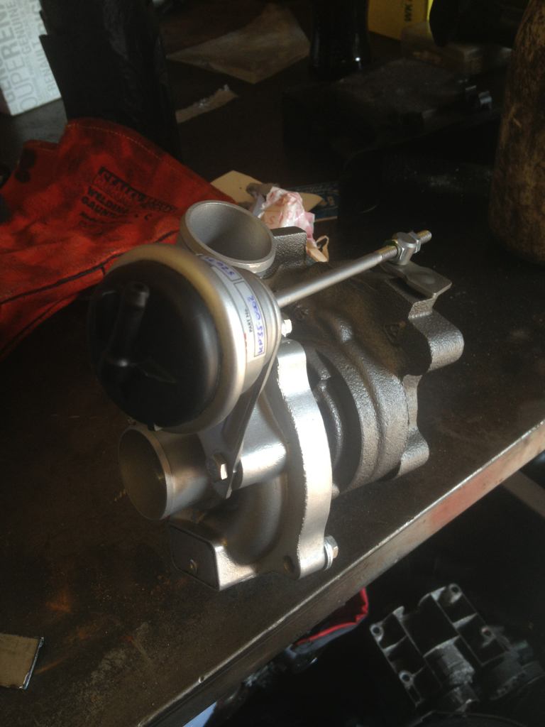

Michael Woodford Motorsport spec hybrid turbo.

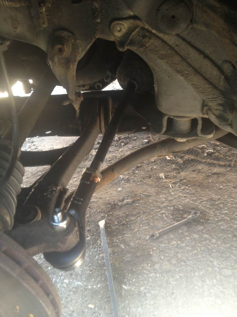

All new track rods, track rod ends and ball joints.
Home made de-cat.
  182/RS2/ Turbo/Mk1
Looking forward to having another go in this now its got the hybrid on it.

Old pump had done 167,500 miles and very occasionally under high load the engine management light would briefly come on with the code Low Rail Pressure. As I was doing the cambelt anyway I thought I might as well put a pump on, as if it did finally give up the goast, I didn't want it to swarf up my brand new Gen Renault Injectors.
Feels good to drive now. New turbo has to boost set much lower so I need to get the mapping stuff out and raise the boost again.
