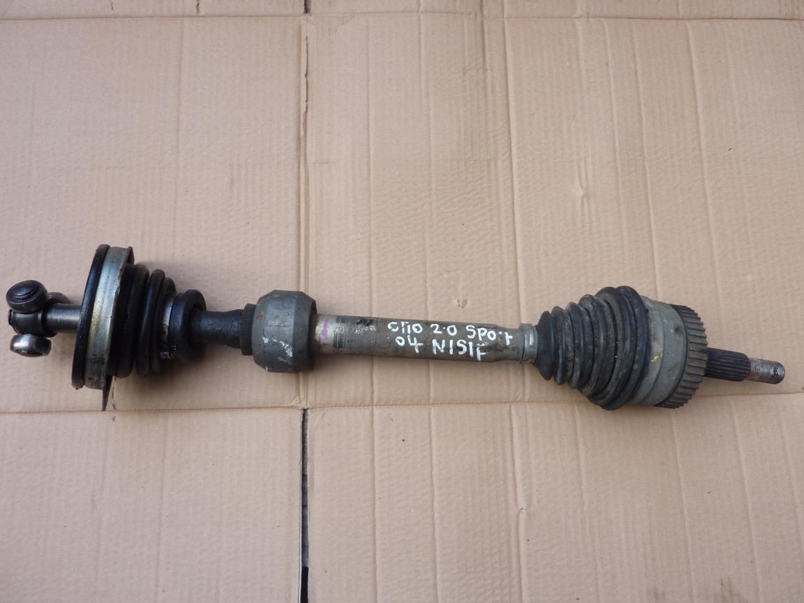

  Inferno 182 & Saxo
Check that gaiter, where it bolts to the box and the other end of the boot with the clip on it where the driveshaft goes through it

id there was a leak between the gears and the area where the clutch is...am i right in saying the clutch would be slipping?
  Inferno 182 & Saxo
No as the bell housing protects the clutch plate. Only way that can get contaminated is a crack in the gearbox casing or oil leaking through the flywheel bolts if they havent had thread lock/seal on them. It can get out that gaiter you photo'd if its torn or come away from the gearbox itself. This gearbox isnt like most others, where the drive shaft goes through a seal seated in the box itself, the clio has a joint that goes into the diff and oil sealing is performed by that gaiter.
A picture of the a shaft probably explains better than I can:
