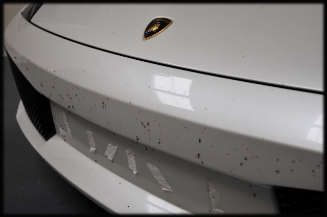

The warmer weather has brought out all the flies and various bugs up here and this was evident on the front of the car:

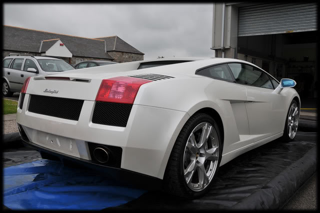

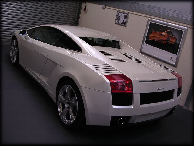

The car only had approximately 400 miles on the clock when we first viewed it back in the spring, but the owner has obviously been out enjoying it in the last few weeks as it was a bit grubbier than when we first saw it tucked away in the garage:

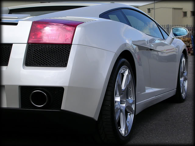

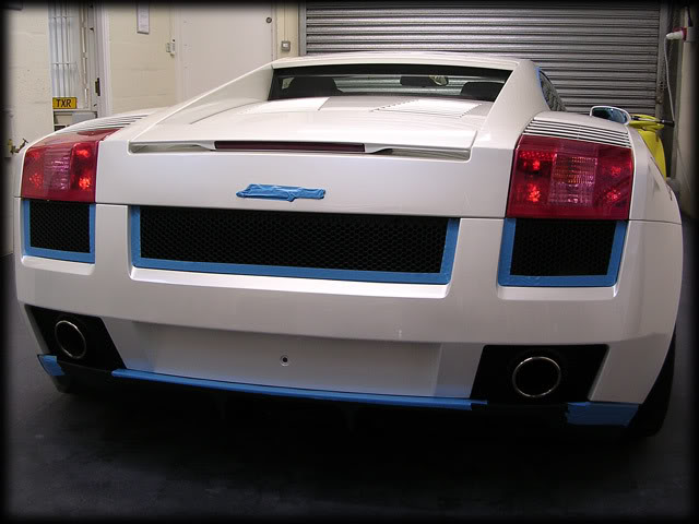

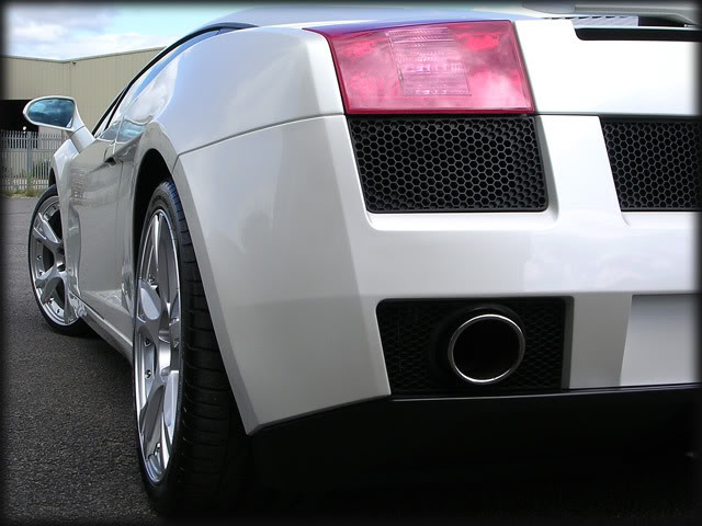

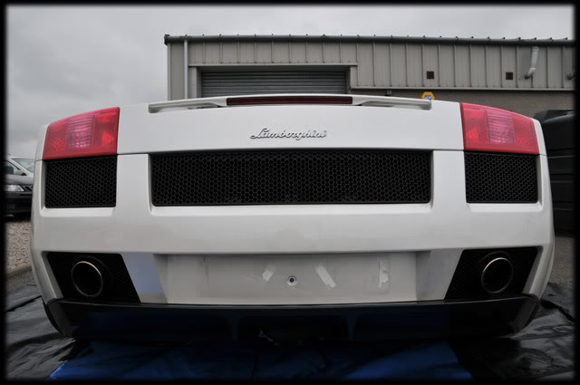

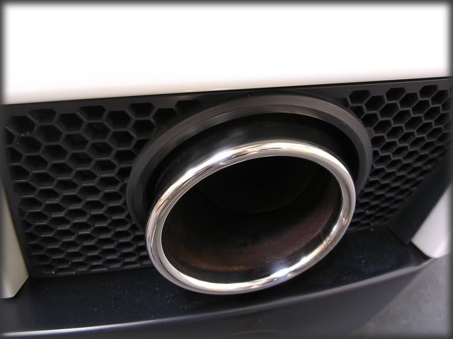

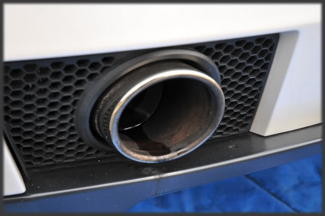

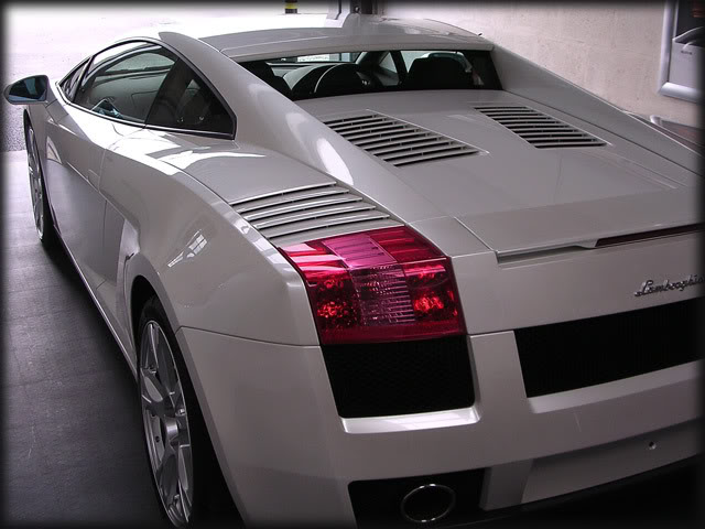

The back end was covered in soot from the exhausts:

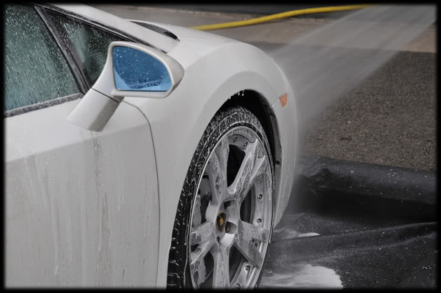

First up was the pre-foam, using Meguiars Hyperwash @ 50 degrees:
Followed by a thorough rinse at high pressure:

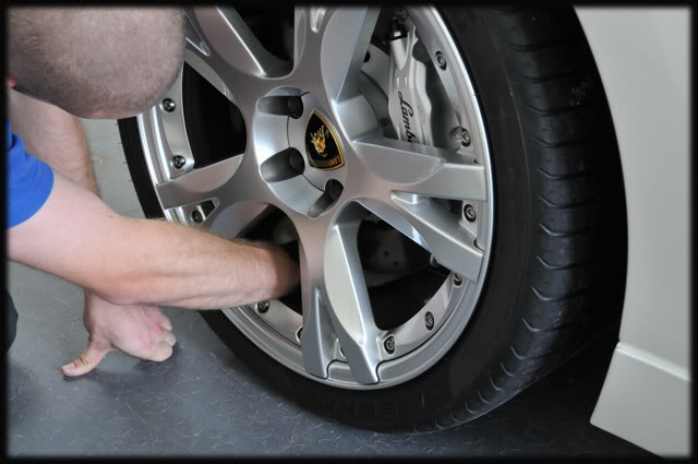

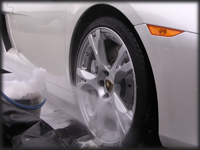

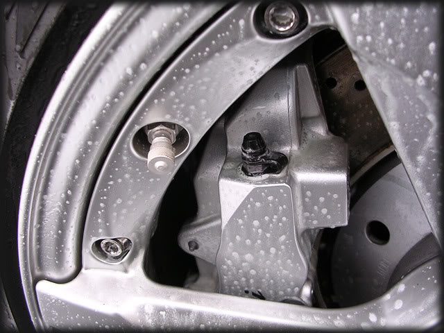

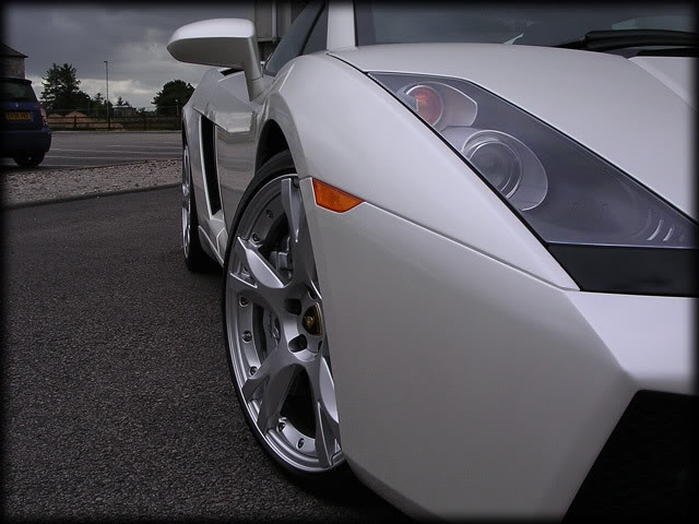

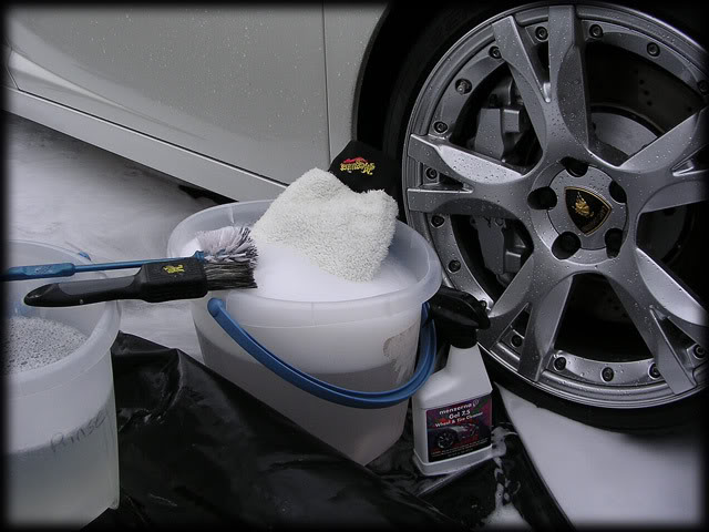

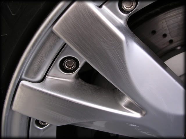

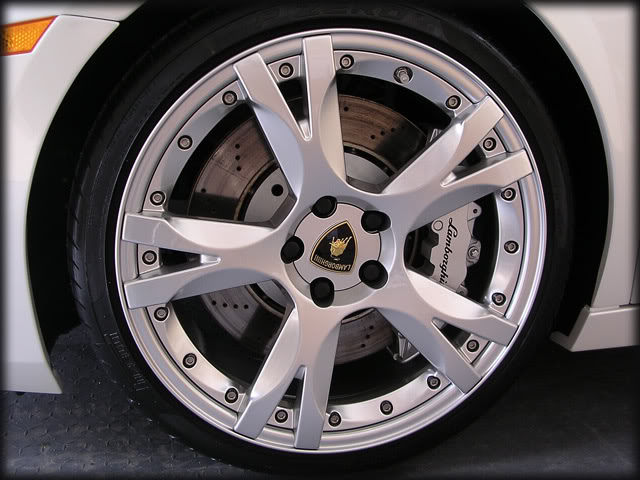

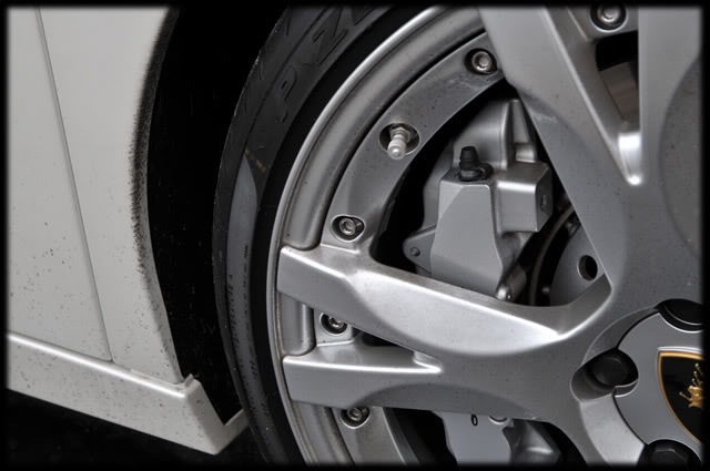

The wheels were next, using the followings bits and pieces:

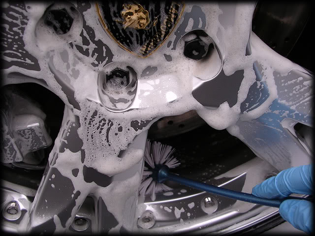

Menzerna 7.5 was sprayed onto the wheel face and inner rim and left for 30 seconds or so:

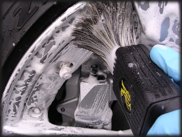

This was then agitated with a Meguiars Slide Lock Brush (as good as anything else I've used):

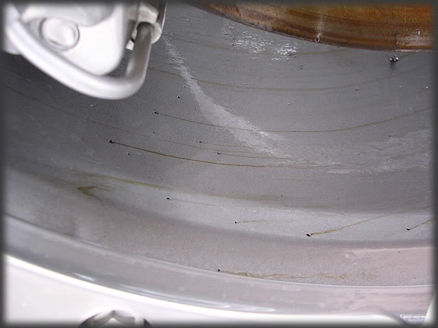

Our wheel back brush was used for the inner rim and caliper:

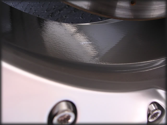

The car was then rolled back a bit to ensure I'd cleaned the entire inner rim and caliper face before rinsing off:
A few tar spots remained though so we'll come back to these in a bit

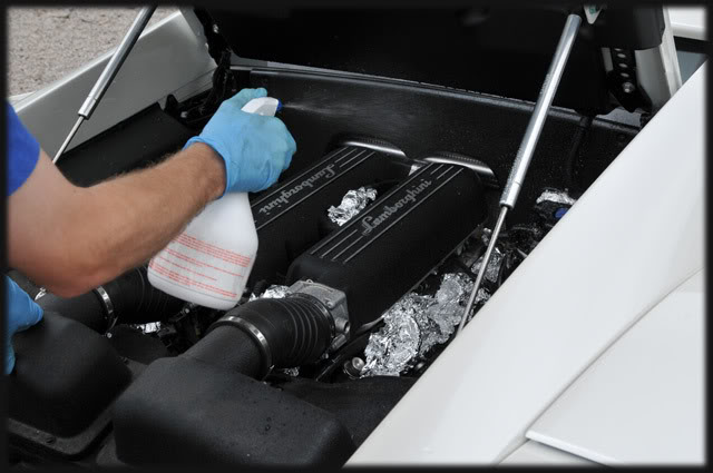

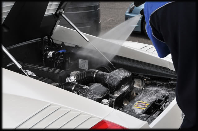

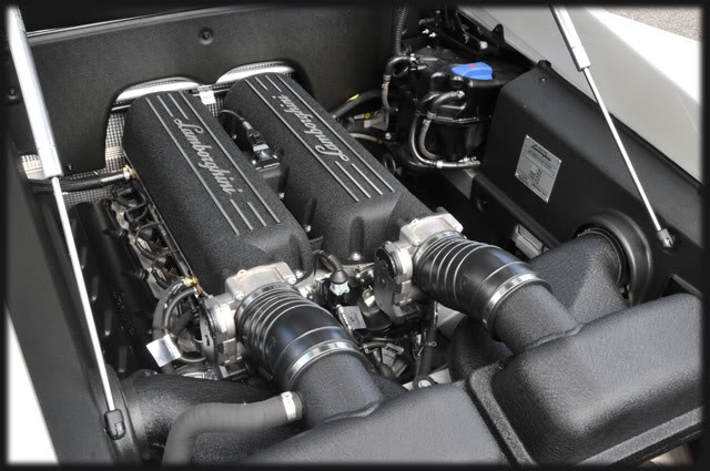

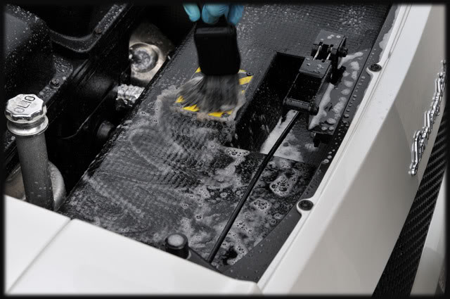

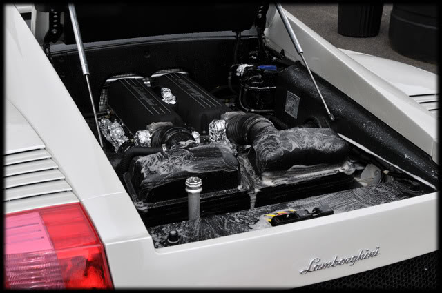

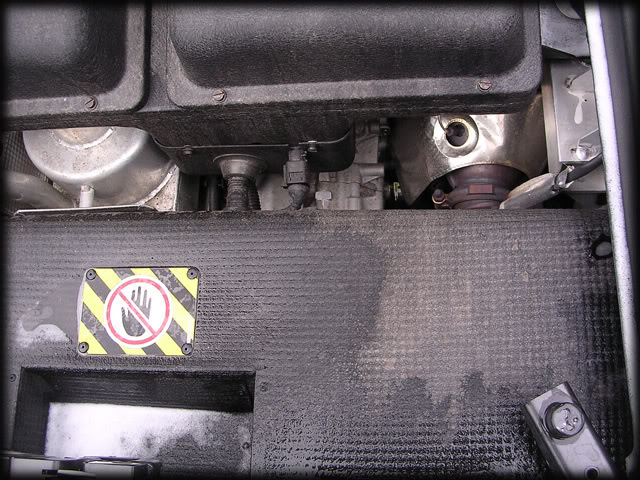

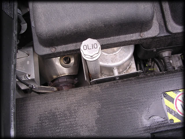

I then moved round to the engine, which was showing a fair bit of grime already:
Any exposed parts were covered up with foil (perfectly safe on modern engines with plastic plugs, etc, just don’t be daft and use it across battery terminals, etc!) and P21S Total Auto Wash was applied to the entire engine and bay:
The worst bits were given a bit of agitation with the brush:

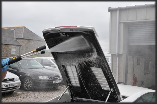

Then using the pressure washer on medium setting, I rinsed the engine off:
All bits of foil were then removed and I let the car sit and idle for 5 minutes to help the majority of the water dry off quicker.

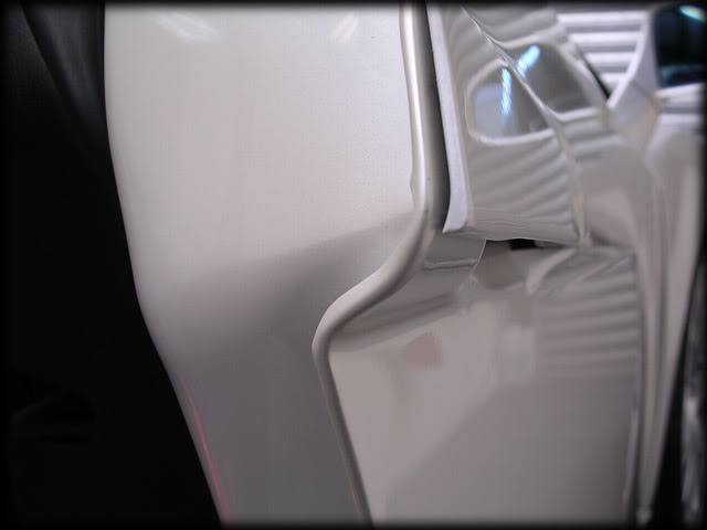

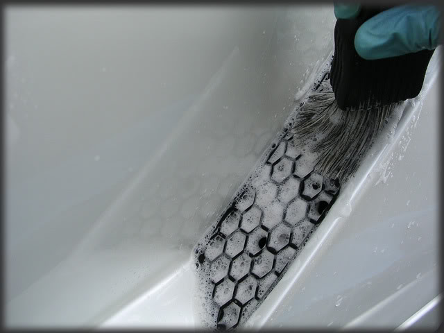

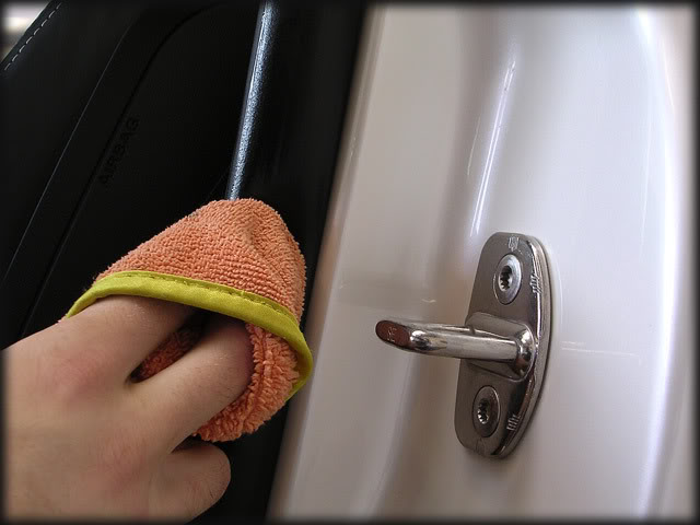

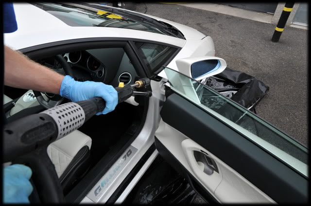

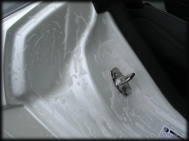

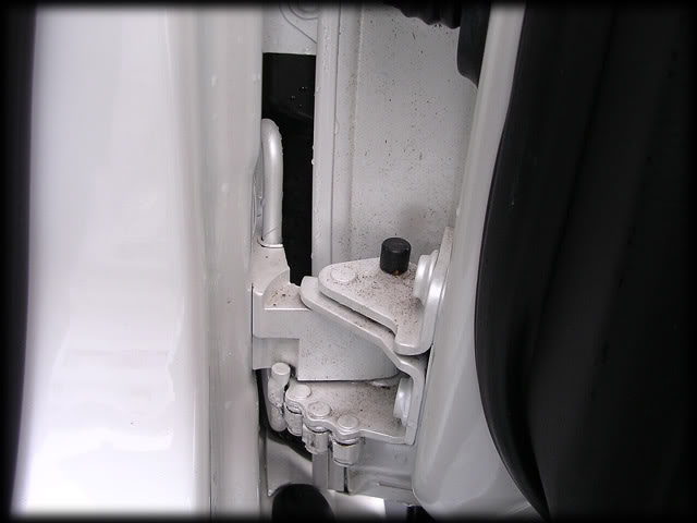

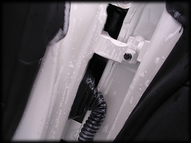

The door shuts were attended to next, just showing a light covering of dust more than anything:
P21S Total Auto Wash and the brush were used again to agitate the worst of the grime:
A trick learned from my valeting days still comes in handy for this bit, using the pressure washer on medium setting I rinsed the shuts thoroughly without getting a drop of water in the car:
The best way to do it is to start the lance away from the shuts and then aim it where you want it - this way you won’t get any splash back.

After rinsing there were still some stubborn bug splatters on the front end so instead of trying to scrub them off with the mitt I got out a product I'm using more and more of now the warmer weather is here:
This was sprayed on and left for a minute or two:
A pic after rinsing off at high pressure - bugs all gone:

The final job before claying was to tackle the tar spots clinging to the paint and wheels. As usual - Autosmart Tardis was used:
(note the contaminants still stuck to the rear end from the exhaust even after washing).

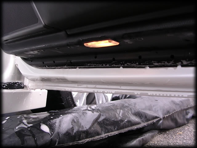

I then moved the car inside ready for claying but firstly removed the remaining sticky fixers from the bumpers with the heat gun:

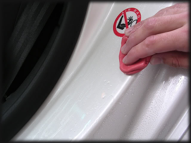

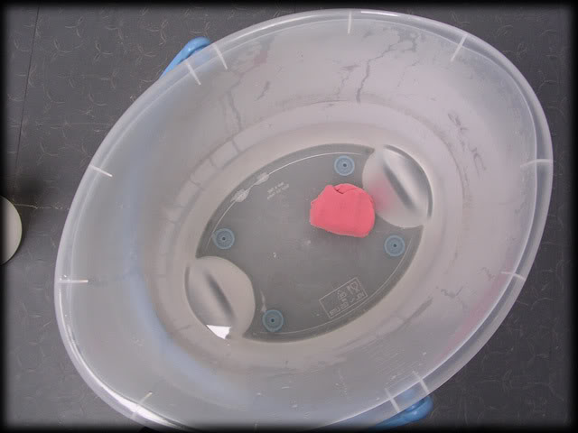

I went straight to Meguiars Aggressive Detailing Clay for this detail...
...reason being that the car was covered in small metal filings:
They were everywhere, even under the fuel cap:
The clay did its job well though:
It was a bit tedious at times but I slowly worked my way around the car - ensuring each panel was 100% clean:

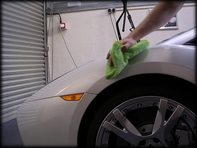

The car was then moved back outside, foamed and rinsed one last time and then dried off with the leaf blower:

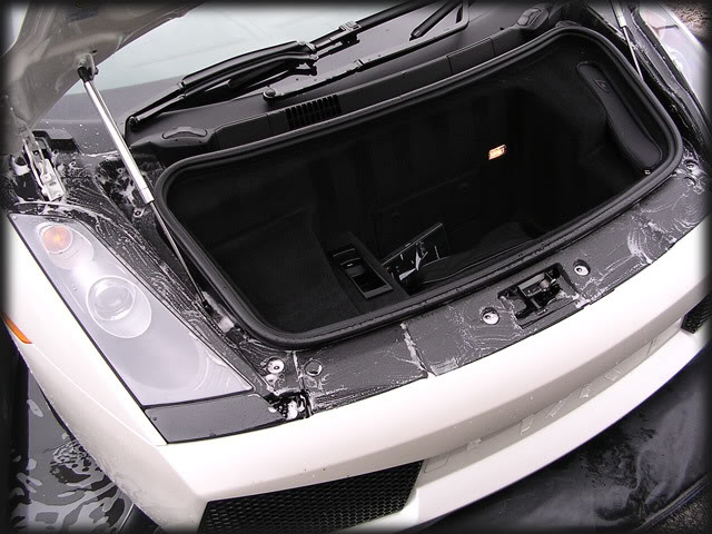

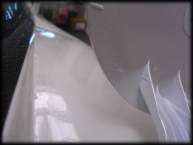

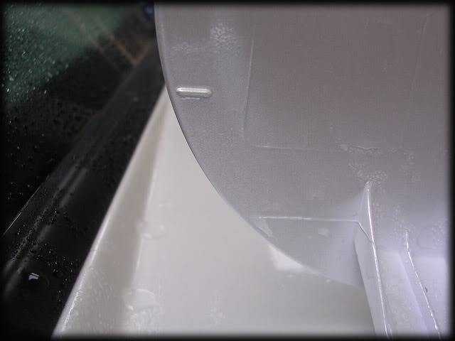

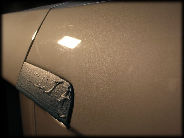

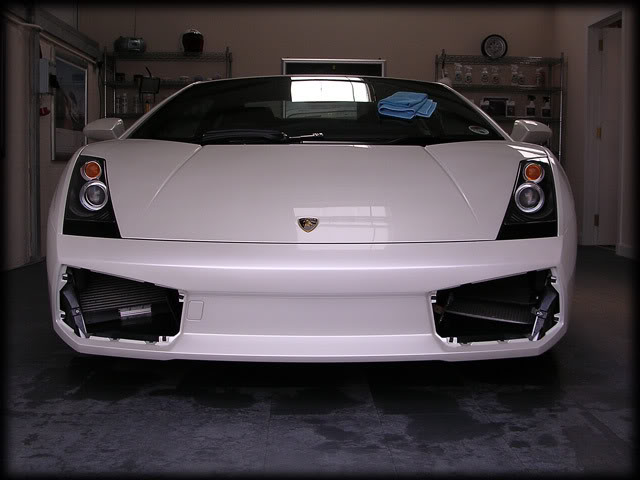

Now parked up inside, I removed the front grills to gain better access to the lower parts of the front bumper when I got round to polishing them:
The car was then taped up ready for polishing:

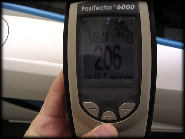

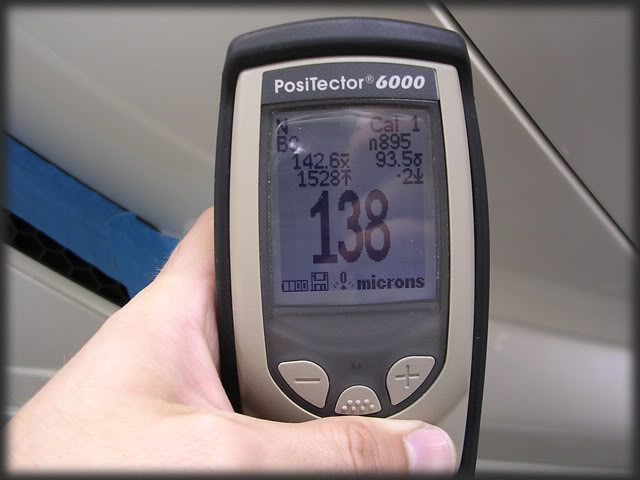

Before paint readings were taken, I checked that the gauge was reading accurately, as you can see below, it was working perfectly:
The Gallardo is hand painted (and also has white as the ground coat, followed by the clear coat with the pearl mixed in and then topped with another coat of clear) so I was expecting fairly high readings. The top panels such as the bonnet, roof and engine cover were in the 200+ territory:
The lowest readings down the sides were in the 130's:
The plastics were also showing healthy levels:
The composite's gauge can sometimes struggle to identify individual layers on a lot of modern day paints as the majority of them are painted "wet on wet", but on the Gallardo I was getting very clear and precise readings nearly every time which would suggest that they are given time to cure in between coats.
Being the colour that it was (and also having only covered around 1k miles) it was always going to be difficult to capture the true extent of the defects present in the paintwork but here are some that I managed to get which give you an idea:

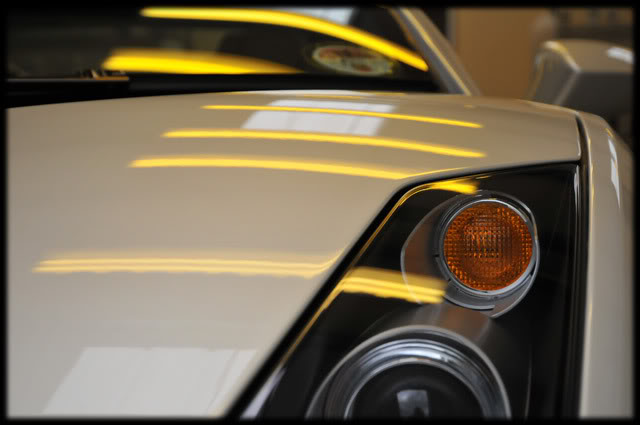

Not overly bad, but not perfect - and perfect is what we are aiming for on this one.

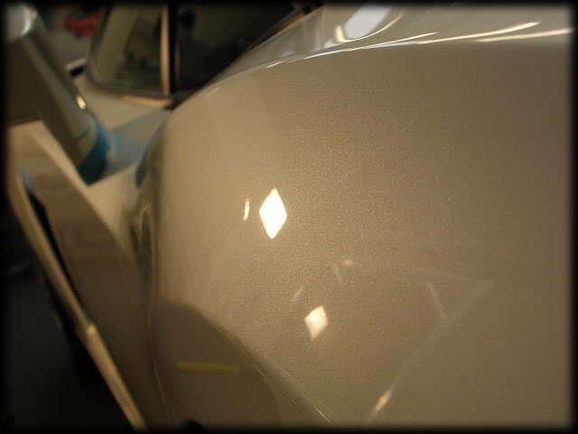

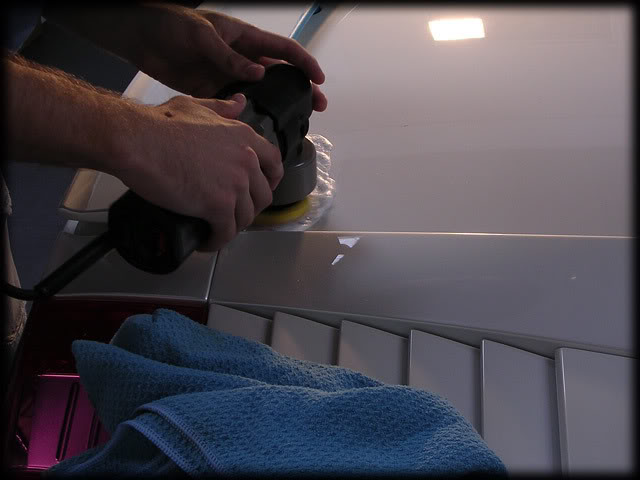

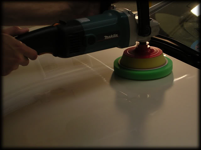

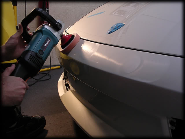

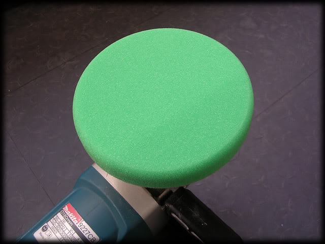

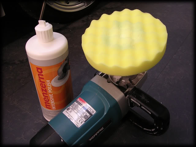

After a quick bit of playing about with polish and pad combinations I started off with one of 3M's new polishing pads and Menzerna 3.02:
Initial impressions of this pad are very good. It's very similar to the firmness and cut of a Meguiars Polishing Pad but has the added bonus of being a lot easier to centre first time!
This pad and polish combo removed between 1-2 microns.

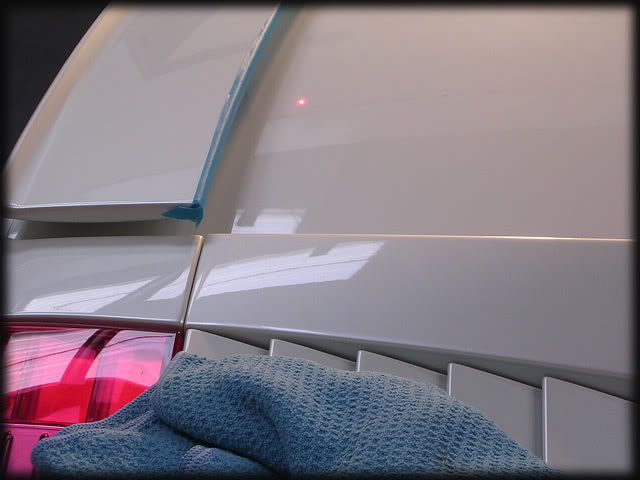

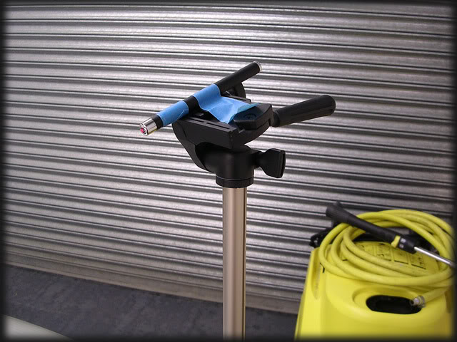

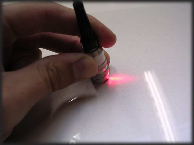

I knew this as I had blatantly stolen an idea from a fellow pro-detailer, so all the credit for this little invention must go to Matt at Off Your Marks, cheers Matt!
Simple yet effective - a laser pen taped to a camera tripod.
This enables you to accurately pin-point an area of paint you are polishing and providing you don’t move the tripod you will be able to get a very good indication of paint removal after polishing:
I should add that the readings were taken after the panel was allowed to cool down as a warm panel could potentially give false readings.

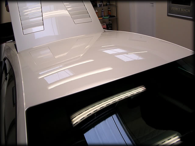

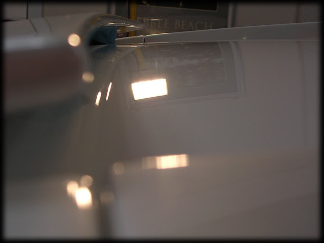

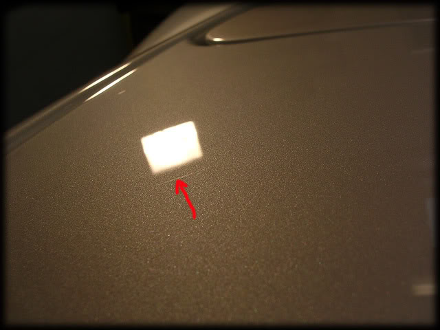

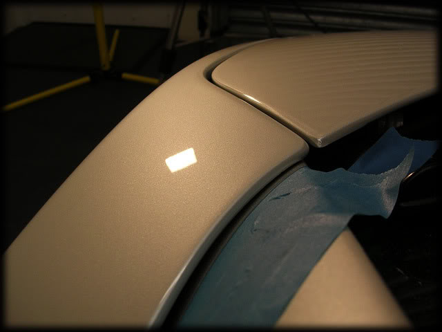

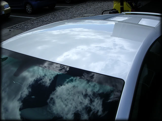

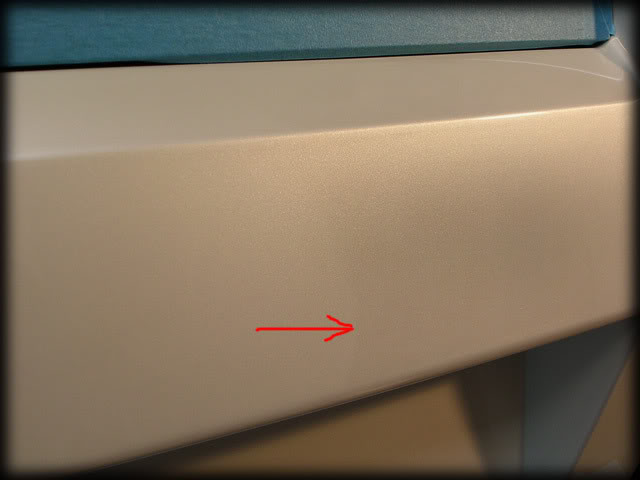

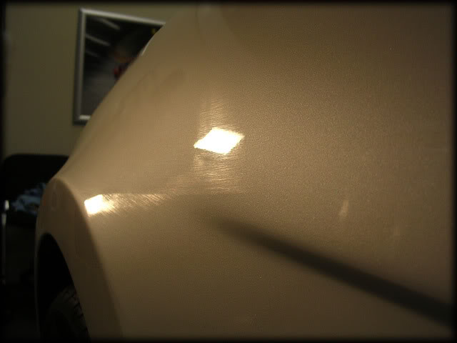

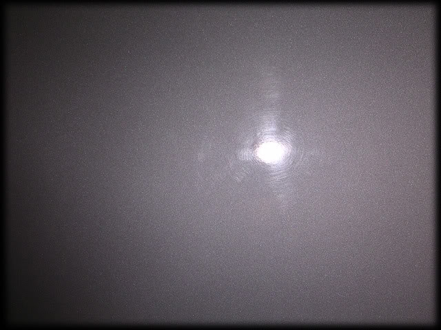

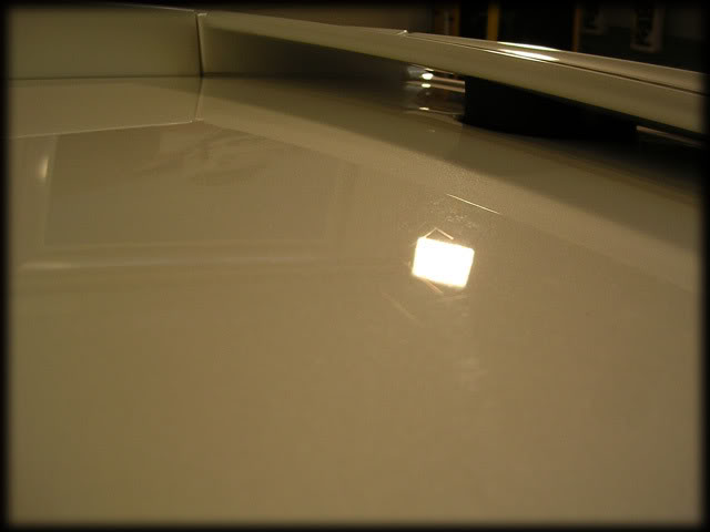

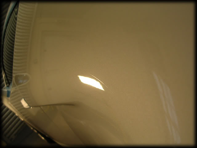

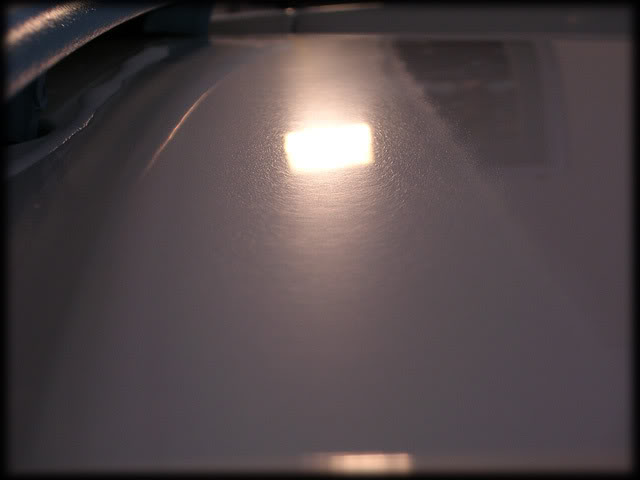

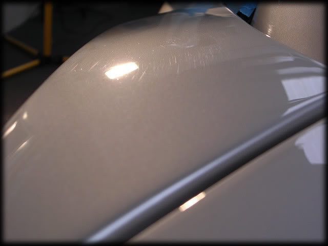

I started polishing on the roof but after a couple of passes I soon realised that a couple of deeper scratches were remaining. The paint on the Gallardo was probably one of the hardest paints I’ve polished yet - a good bit harder than normal Audi Paint, however I wasn’t complaining as I prefer hard paint to soft paint.
An example of what was left after a couple of hits on the roof:
Yes it was small but it was there so it had to come out!

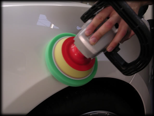

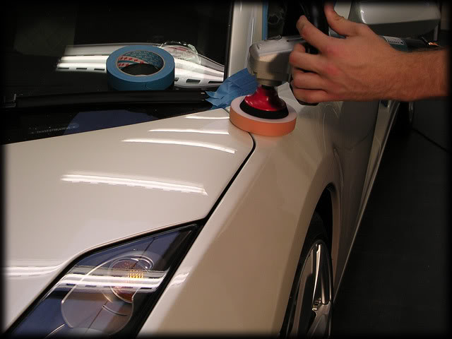

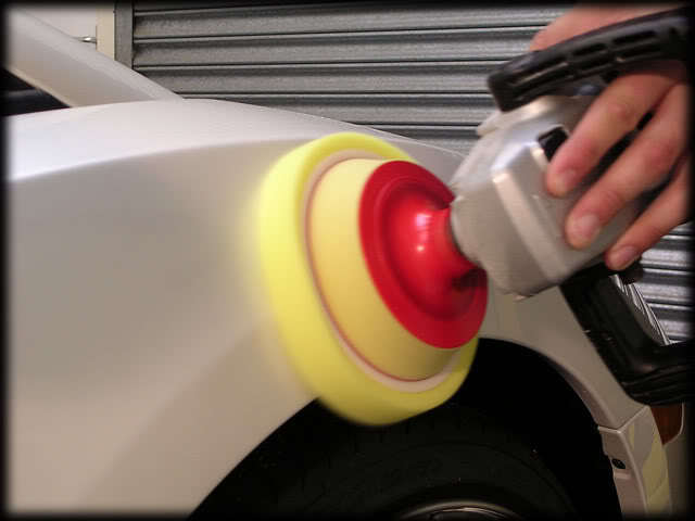

So out with another new 3M Pad, this time one designed for compounding with Fast Cut Plus (hence the green):
1800-2000rpm's were used for the majority of the correction work and this removed the few remaining defects perfectly, removing 2-3 microns at a time:

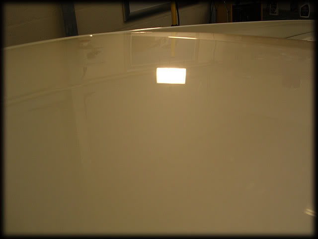

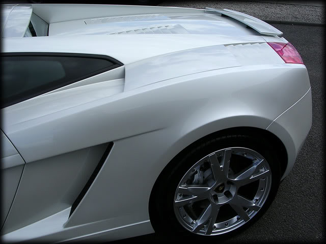

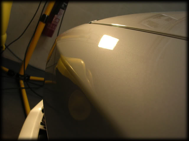

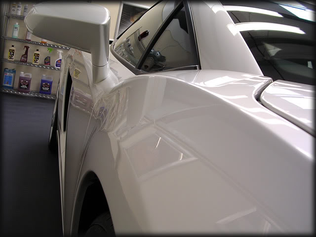

Below is a pic of the roof after stopping polishing @ 2000rpm's - no refining at all after the FCP. Even under the Sun Gun there was no evidence of buffer trails at all so this was a good indication of how hard the paint was:

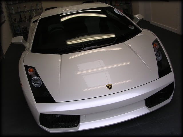

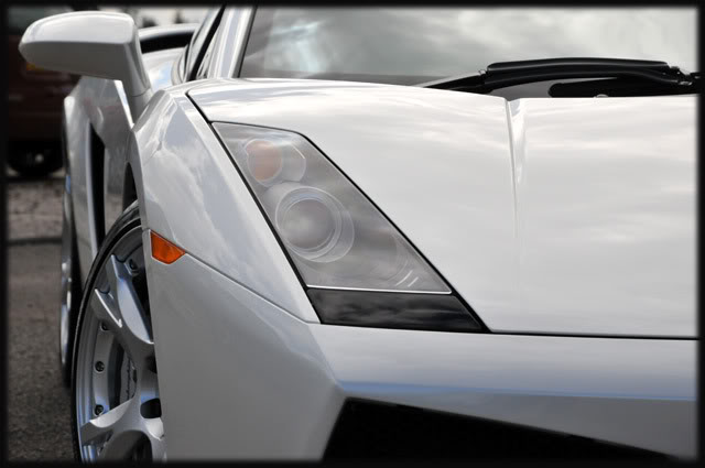

I moved down to the bonnet next and again ended up switching to FCP after the 3.02 didn’t provide quite enough cut:
Fortunately, the vast majority of the driver’s side was fully corrected using the slightly less aggressive combination of the polishing pad and 3.02:
I could have gone at the entire car with FCP but I always try to remove all defects whilst removing as little paint as possible.

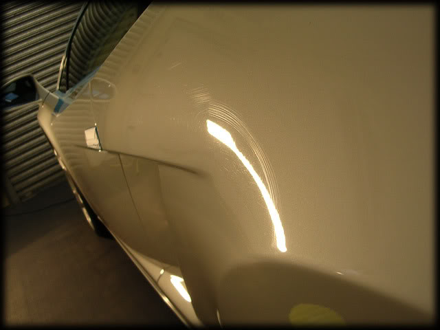

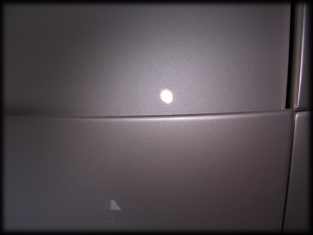

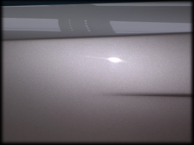

Round the other side was a bit different though. The rear 1/4 had picked up a couple of bad scratches at some point:
After 1 hit of FCP (sorry about the blurry pic, the camera didn’t focus well on the white at times):
Still there so another hit!

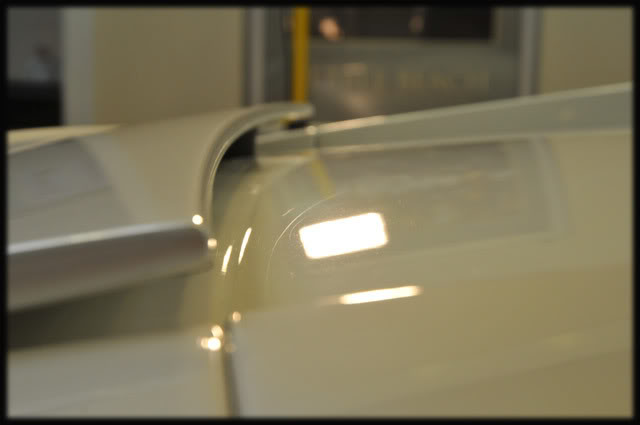

All gone except for a deeper scratch which remained:
This was too deep to polish out so I marked it with a piece of masking tape:
I planned to go back and remove any more defects like this one by wet sanding later on so that was the reason for marking them on the paint as they were hard to see at certain angles (multiple customers "examining" the car thought I was mad to go further at a scratch that they could barely see but I knew it was there and the aim of this detail was ultimate perfection).

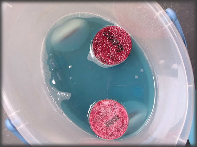

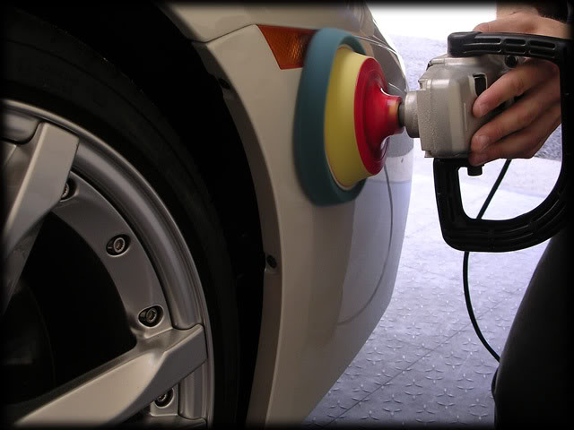

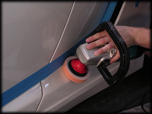

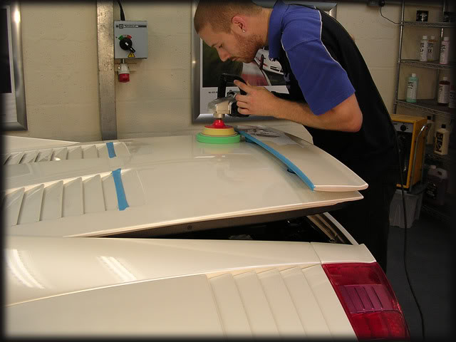

4" compounding pads were used throughout the detail for when I needed to get into the tighter areas:
Opening the doors allowed easier access to the lower sections and side skirts:

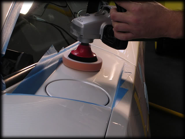

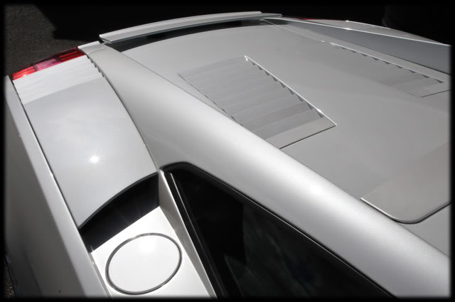

The fuel cap was in dire need of correcting:
During polishing (note the extra masking tape to prevent the edge of the pad from coming in contact with paint I didn’t want it to touch!):
After:

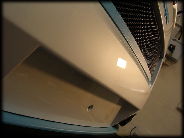

Polishing of the front bumper - plastics were polished @1500rpm's:
The rear bumper had significant swirling that was robbing the paint of its true clarity:
After FCP:

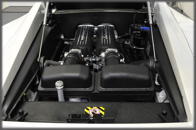

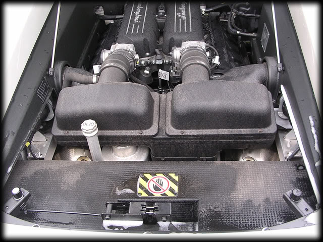

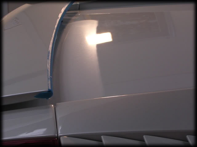

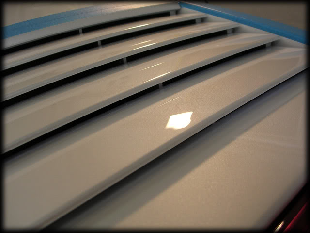

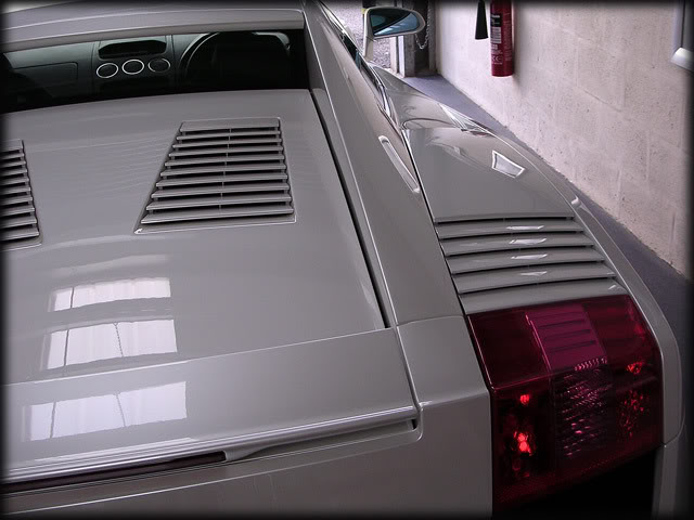

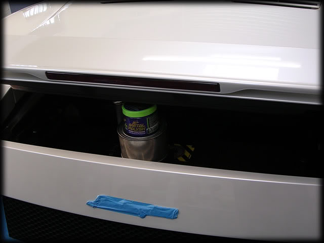

A bit of improvisation was needed to allow me to comfortably polish the engine cover
This was probably the worst area of the car in terms of RIDS so 2 or 3 hits per section with FCP was needed:
This was the last area of the car to be corrected (except for those that I knew would be corrected with the finishing polish such as headlights/wing mirrors etc) so I called it a day at 6pm - late enough for a Friday night!

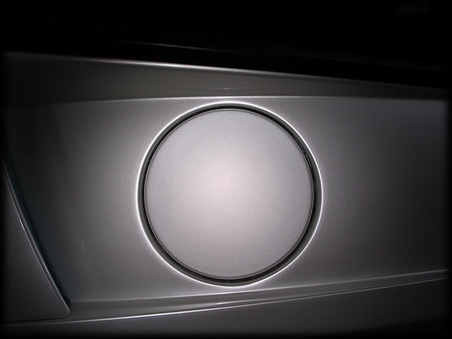

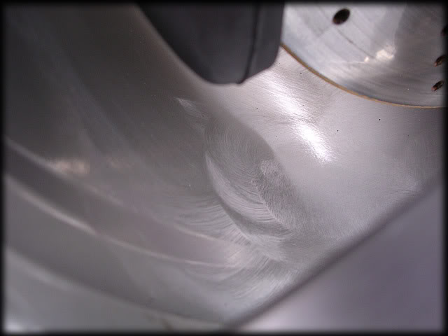

There were some odd etching marks on the fuel cap, almost like something hot (such as hot metal filings?) had been flicked up onto the side of the car (they were only a couple of mm wide so no chance my camera was picking these up). These marks had polished out completely on the rest of the car but the fuel cap still wasn’t perfect so this was sanded back too:
Polished out using the same process as the engine cover:
P21S Total Auto Wash was used again to ensure all exterior trim was perfectly clean:
A quick rinse followed.
I used a MF work towel to wipe away the tar after the Tardis has been left to do its thing for a minute:
Before:
After:
One final rinse followed to get rid of any Tarids still left on the paint:

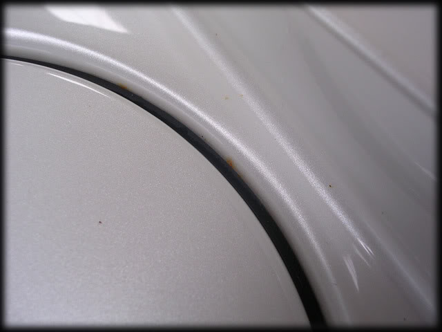

Including the shuts:
I then drove the car back and forwards a few times to clean up the discs as I didn’t want them sticking while the car was sat in the unit for the next week and rusty discs also look crap for the final pictures.

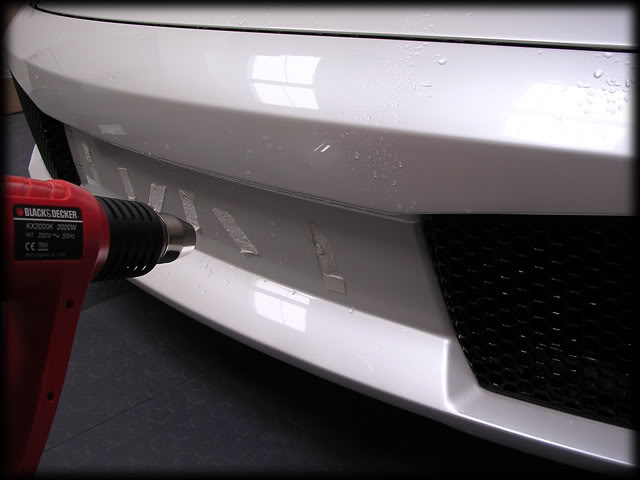

It was now 5:30pm by this point so I stopped at there for day 1.

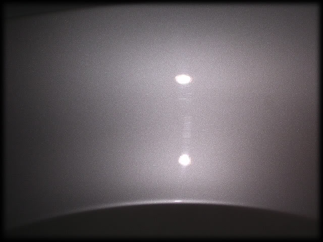

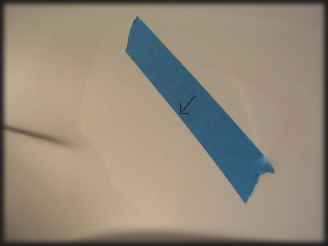

The rest of the near side corrected the same as the off side with the 3.02 and polishing pad:

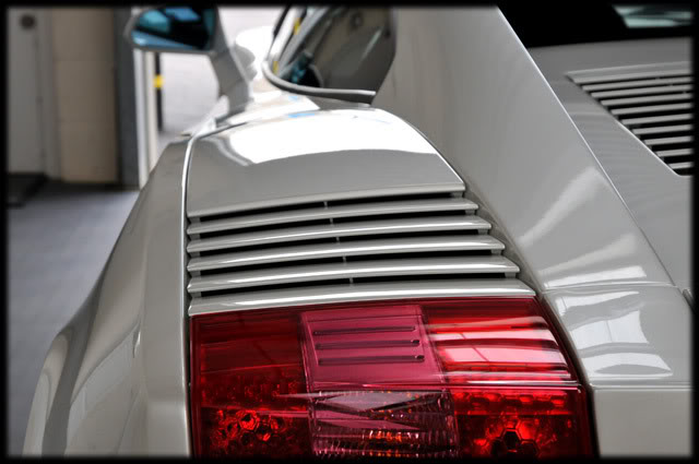

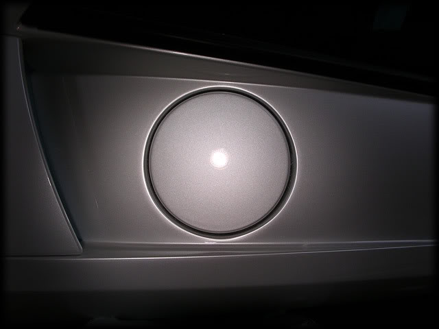

After:

Even after the thorough claying stage there was still some exhaust contamination being pulled off the paint by the polishing step, here's a poor attempt at a 50/50
Fully corrected:

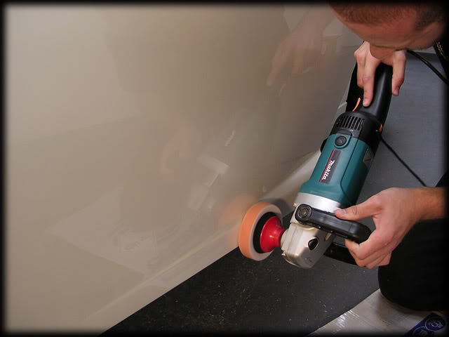

I got some good pics of the other piece of sanding I had to do though. There was a 4-5" scratch running in line with the spoiler (pic taken on Rich's camera as his is considerably better than mine!):

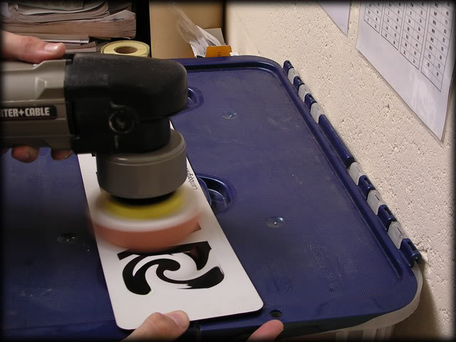

Due to the size of the scratch I decided to sand this one out by machine. I'd prepared for this on the Wednesday though as we'd spotted the scratch on the Tuesday evening so I had a couple of sanding discs soaking in a bucket of Shampoo Plus for a couple of days:
So with the laser pen put to good use again...
...I proceeded to sand the paint with the PC on speed 2, firstly using the 2000 disc:
After 4 passes and 6-8 microns of paint removed, the scratch was now no longer visible, just the sanding haze and pig tailing:
I followed up with the 4000 disc to make the marks slightly easier to polish out with the G220 and a 4" spot pad with 3.02. 2 hits were done in order to make sure all sanding marks were fully removed:
Scratch now gone:

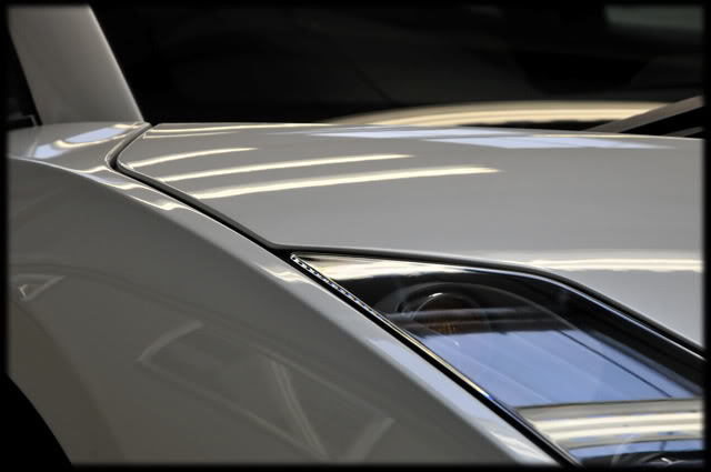

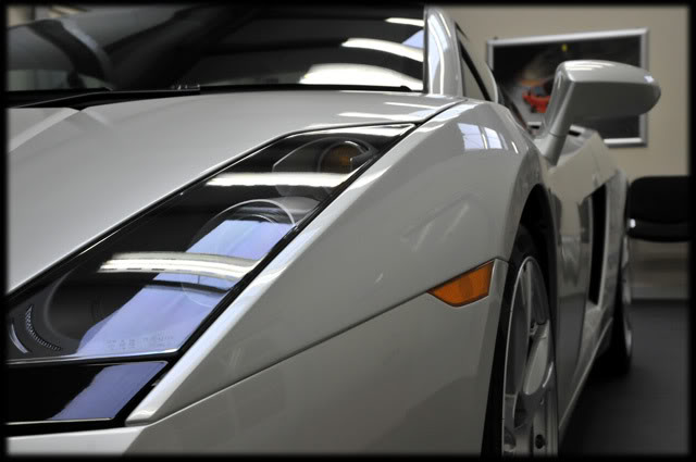

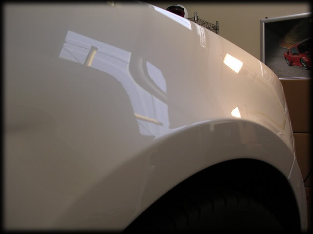

The finishing polish stage began, using a 3M Finishing Pad and Menzerna PO85RD @ 1800rpm's:
A 4" finishing pad was used for the smaller areas:
That crystal clear finish we all love to see was showing nicely now :thumb:
The very last stage of polishing was a slightly unusual one...
Blackfire's Metal Polish was used...
...to polish up the glass:
This contains a certain amount of jewellers rouge and whilst it didn’t do much in the way of correction (I didn’t expect it to) it definitely helped to give a great crystal clear look to the glass.
It finishes down just like any other polish too:

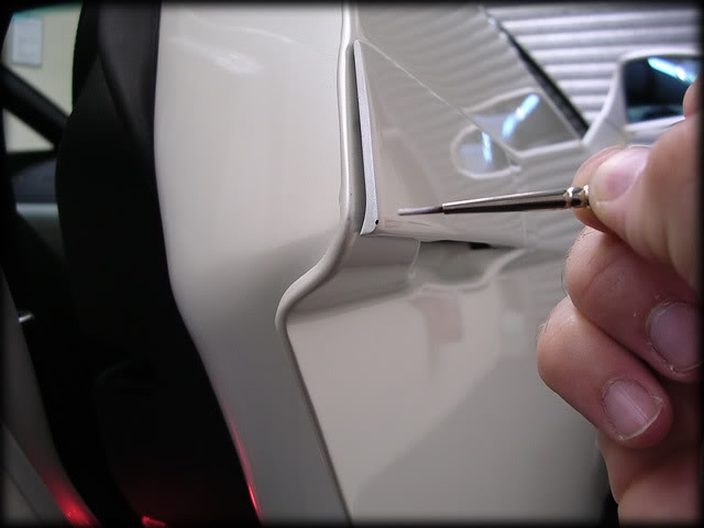

There was a tiny chip on the corner of the drivers side door handle so we ordered in some clear coat and had the local Porsche Approved Body shop mix up the correct paint for the car:
Using a fine artist’s brush I firstly applied the white ground coat:
This was then allowed to dry and then topped with the pearl layer:
The last clear coat layer was then added once the pearl had fully dried:

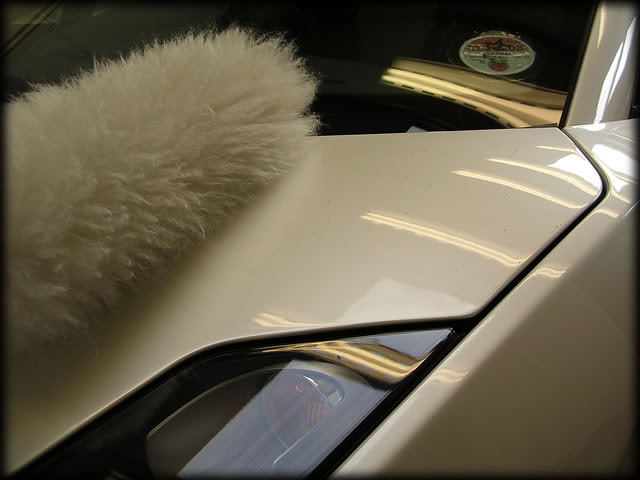

Out came the duster to remove any polishing dust:
I then gave the car a wipe down with Menzerna Top Inspection to remove any last remaining traces of polishing oils:
1st application of Vintage followed (the customer has purchased his own pot of Vintage):
I buffed the wax off with a PB Ultimate Mega Towel...
...then called it a night bang on 9pm.

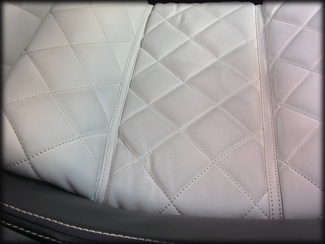

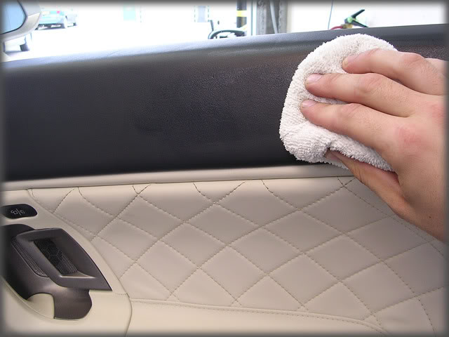

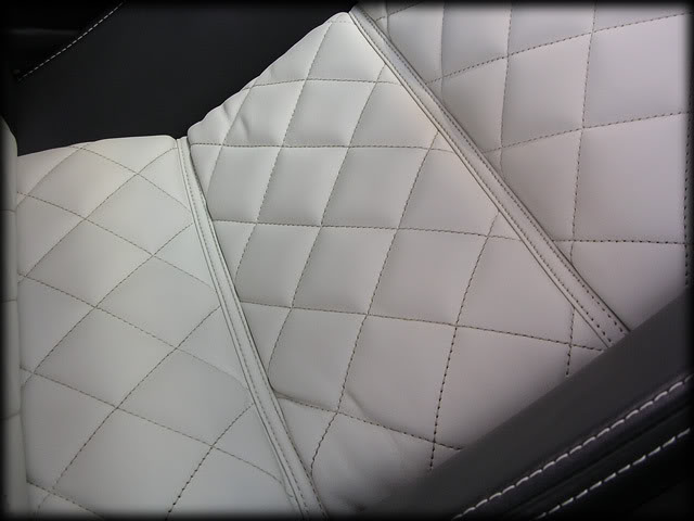

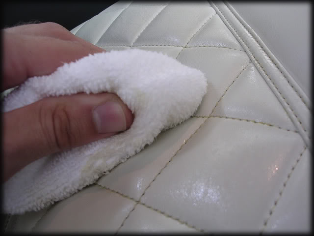

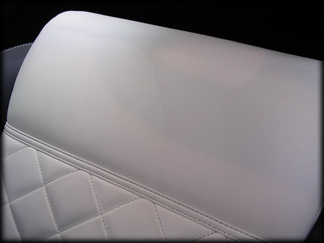

The leather was suffering from a bit of colour transfer from the customer’s jeans:
This was fixed with the help of Raceglaze Leather Cleaner and a MF applicator:
I worked the cleaner into the leather:
Dirt lifted:
Good as new:

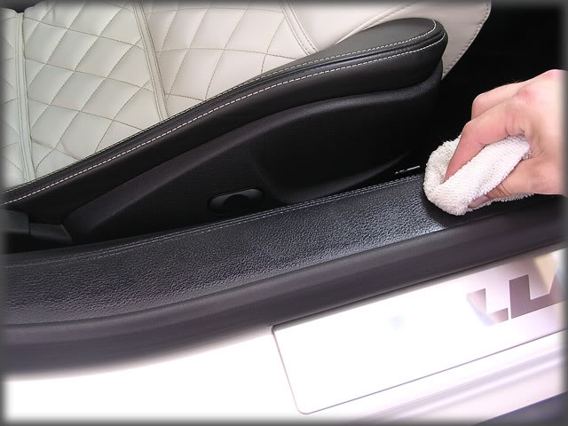

Having cleansed all the leather, I then fed it with Raceglaze Leather Balm. Every single customer so far has absolutely loved the smell and look of this stuff so it gets the big thumbs up from us:
I gave the leather a wipe down a few hours later to remove any slight smears that remained (all smears disappear over 24 hours in my experience but I didn’t want any for when the customer collected the car):
The door shuts were waxed with Vintage:

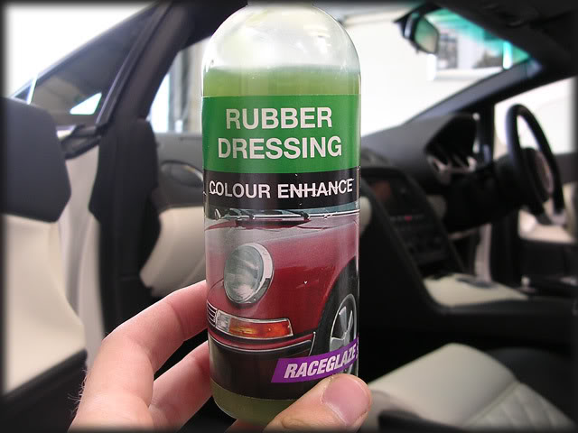

The seals were fed with another product from Raceglaze:

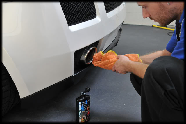

The tailpipes were polished up with Raceglaze Metal Polish and a CCS Light Cut Pad…
Before:
After:
I then sealed them with one of Blackfire's latest Polycharged products:
Onto the wheels, these were sealed with PB Wheel Sealant:
Including the inner rims:

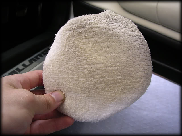

We'd been sent several types of wash mitts to try out and whilst this one was no use for paintwork I had decided it had a good use...
...for removing the sealant from the inner rims

The engine bay was dusted down and then dressed with 303 Aerospace Protectant:

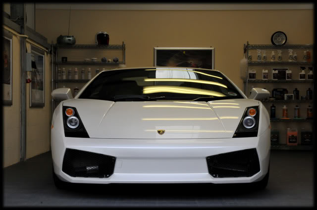

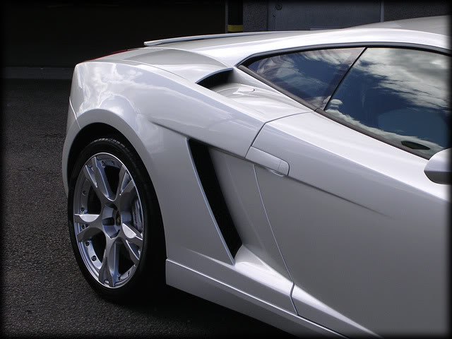

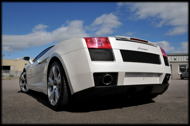

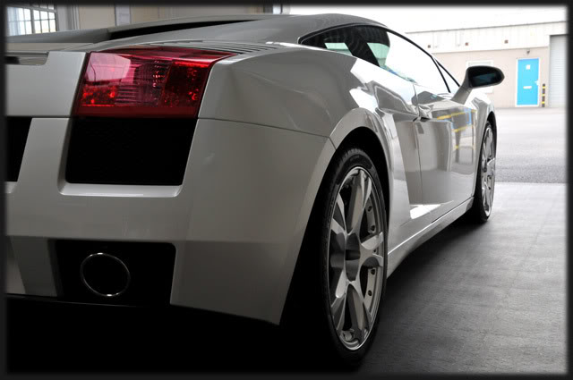

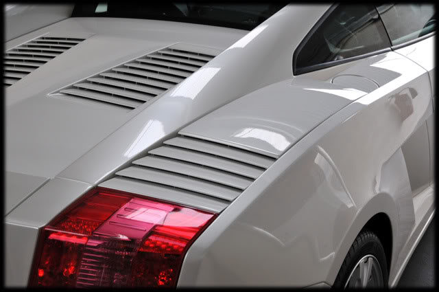

I guess there's not much else to say other than here's the results of 32 hours machine polishing and over 55 hours of work in total – enjoy!
So there you have it, our first Ne Plus Ultra (TM) detail. I just hope the next one is equally enjoyable as this one was. I also hope you enjoyed the write up as it has taken bloody ages to put together!
