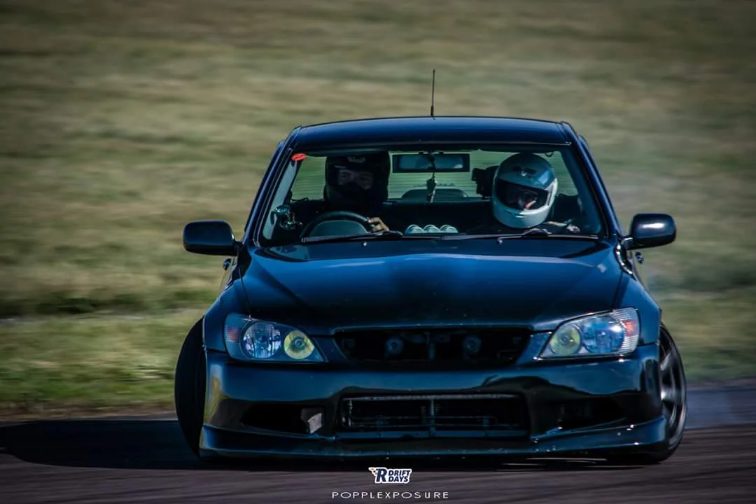

First of all, I'm relatively new to all this grip type stuff. I've always primarily been into RWD, and have owned a selection of drift cars over the years. Currently I have an is200, and whilst it's not the fastest it definitely has a decent chassis, and is so rewarding to drift as it takes a lot of effort, being so underpowered.

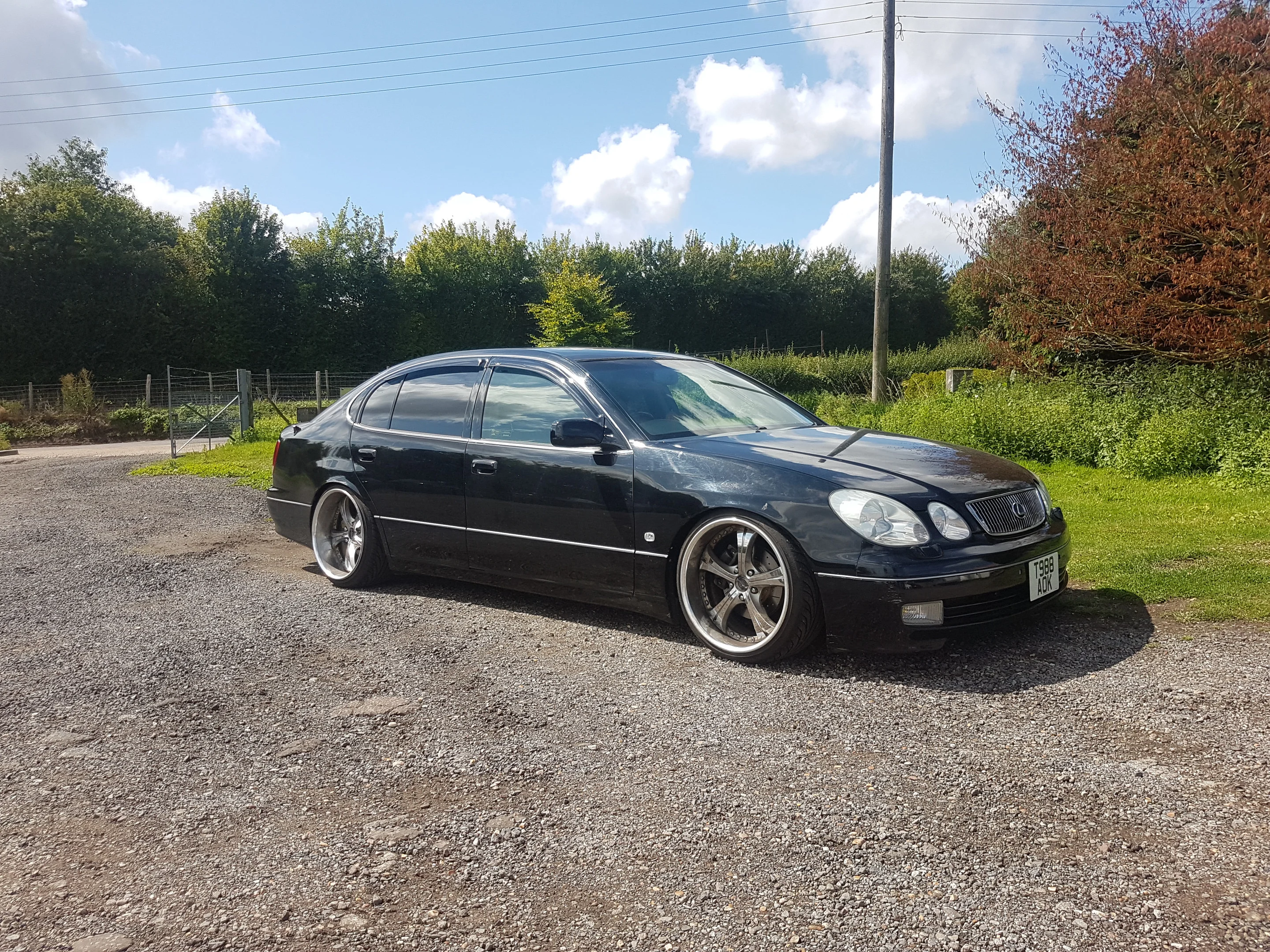

Having had a couple of less than sensible daily drivers, namely a GS300 and an LS400 (you may see a pattern start to appear with regards to my preferred car brands), I decided to get something a little smaller and more fun to drive, rather than big and boaty and sub 20mpg like the last few.
I sold my beloved GS300

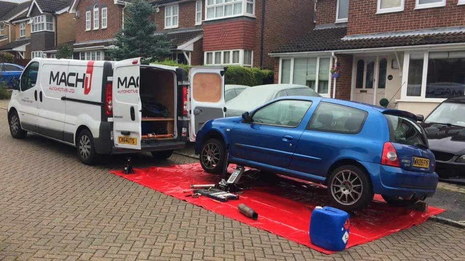

After checking the brakes out, we noticed the rear pads were toast. The one thing we didn't check the day before.
One trip to the renault dealership in Dunkirk and some broken Franglais later, and my pockets are €53 lighter. We changed the pads in a services carpark, and continued on our way.

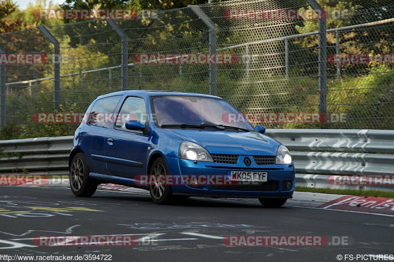

The first few laps around the nordschliefe were pretty tentative as if only owned the car for a few days, but once I'd settled in I had an awesome time. These cars are so capable!

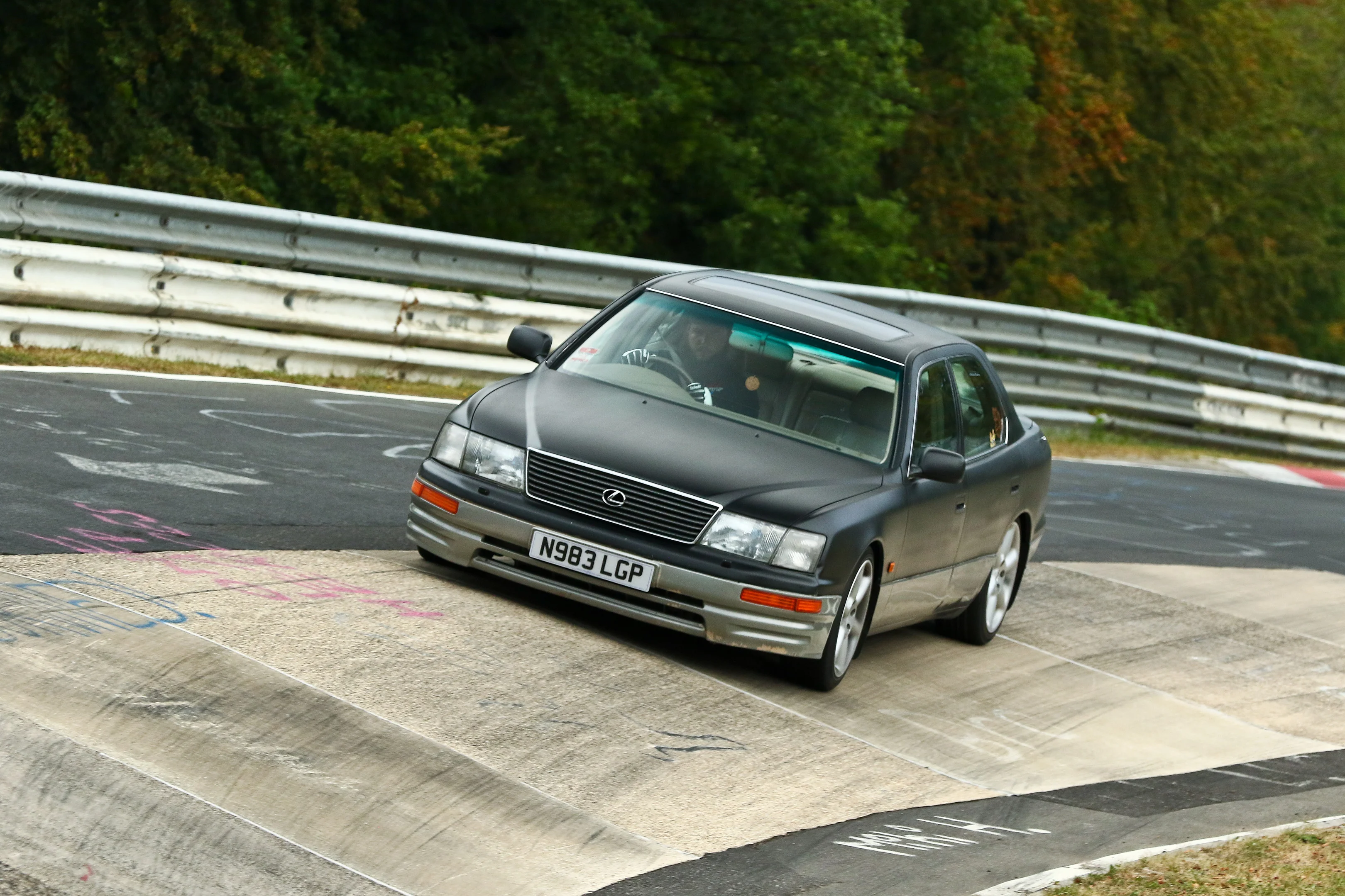

Last year in the LS400

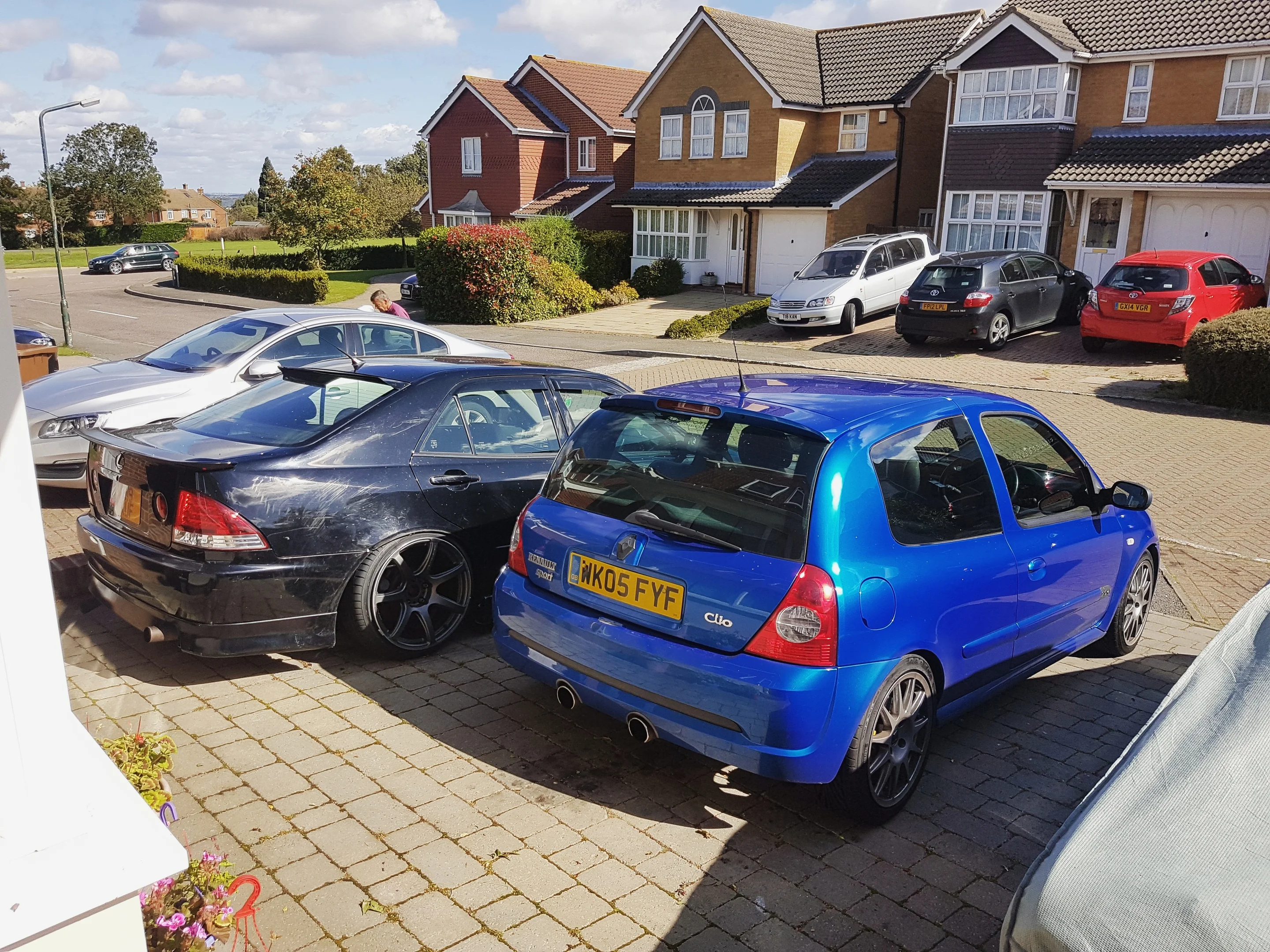

Crazy, what are the odds haha! My pal bought it off Hudson and we drove down in my is200 to collect it, and then I ended up buying it off him about 6 months later.

As for the LS400 as a track bus, AWESOME!
