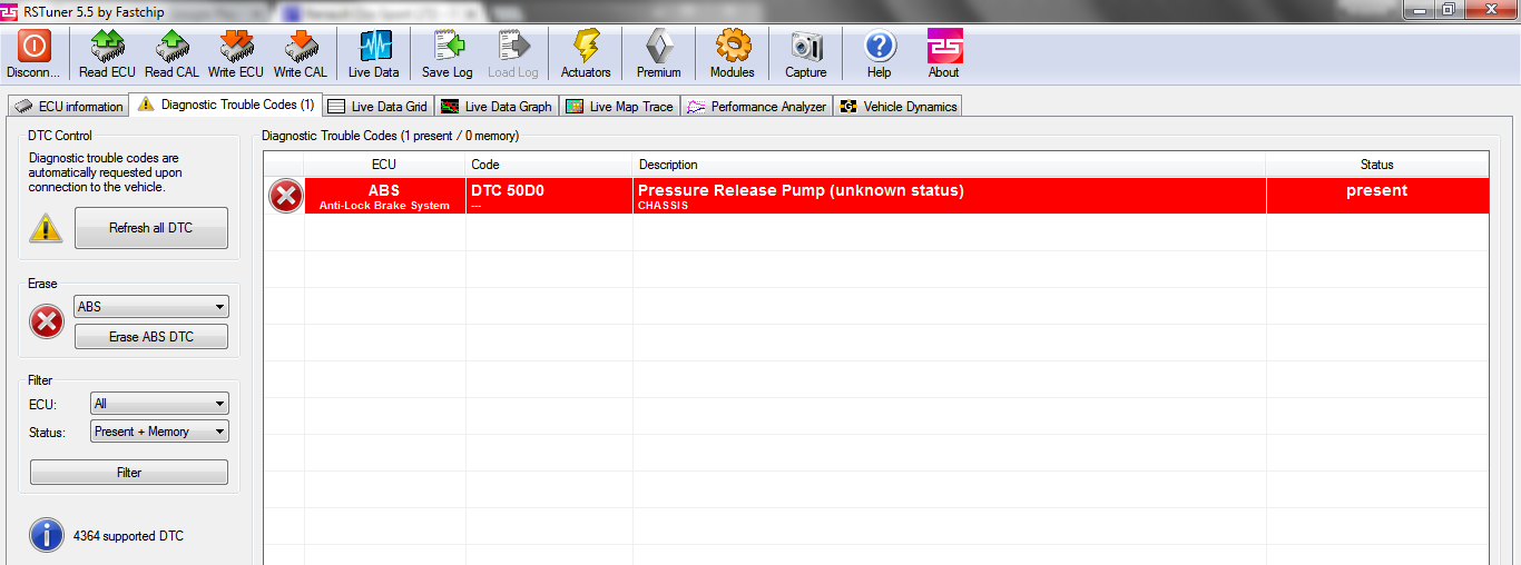

Right guys.....need more help.
Just replaced the ABS pump with a 2nd hand part.
And I am seeing exactly the same problem.
Also, because of it, I am struggling to bleed the system with RSTuner......I hear no pump activity at all when i fire the motor from RSTuner.

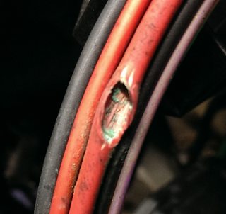

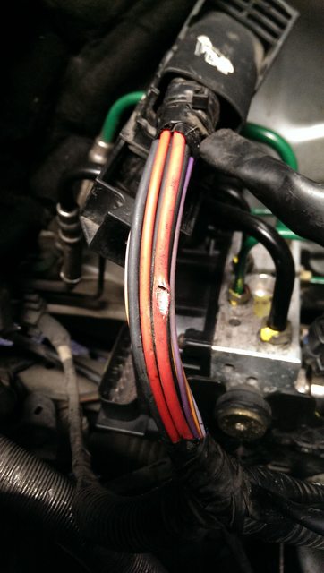

So, after a few hours of checking and double checking for stupid things (yes, me - very possible) I started inspecting all of the wiring. This took a long time, obviously. But I did note a small green stain on the loom near to the crazy ABS connector.
Gung ho....I started ripping off the insulating tape.......and.......I found this.
Cable had obviously been damaged somehow and damp/water had completely corroded the cable inside away. Nothing left. Just a hole.
So I cut out all of the bad/corroded cable.....and spliced in a chunk of 30 Amp cable, hope that's rated high enough. Anyway......that was that.....ABS spun into life and I was able to spend A VERY LONG TIME bleeding the whole circuit replacing the fluid with Type 200 (there was already blue in there)

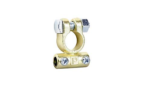

Have a slight and very intermittent misfire......say, 3rd gear WOT it holds back for a bit then goes. I did replace the end terminal for the earth strap to the battery as the end of mine was clinging on by about 5 strands so that is going to be my first port of call. This was replaced with a generic Halfords jobbie like this.....could that be a problem? Are they picky?
