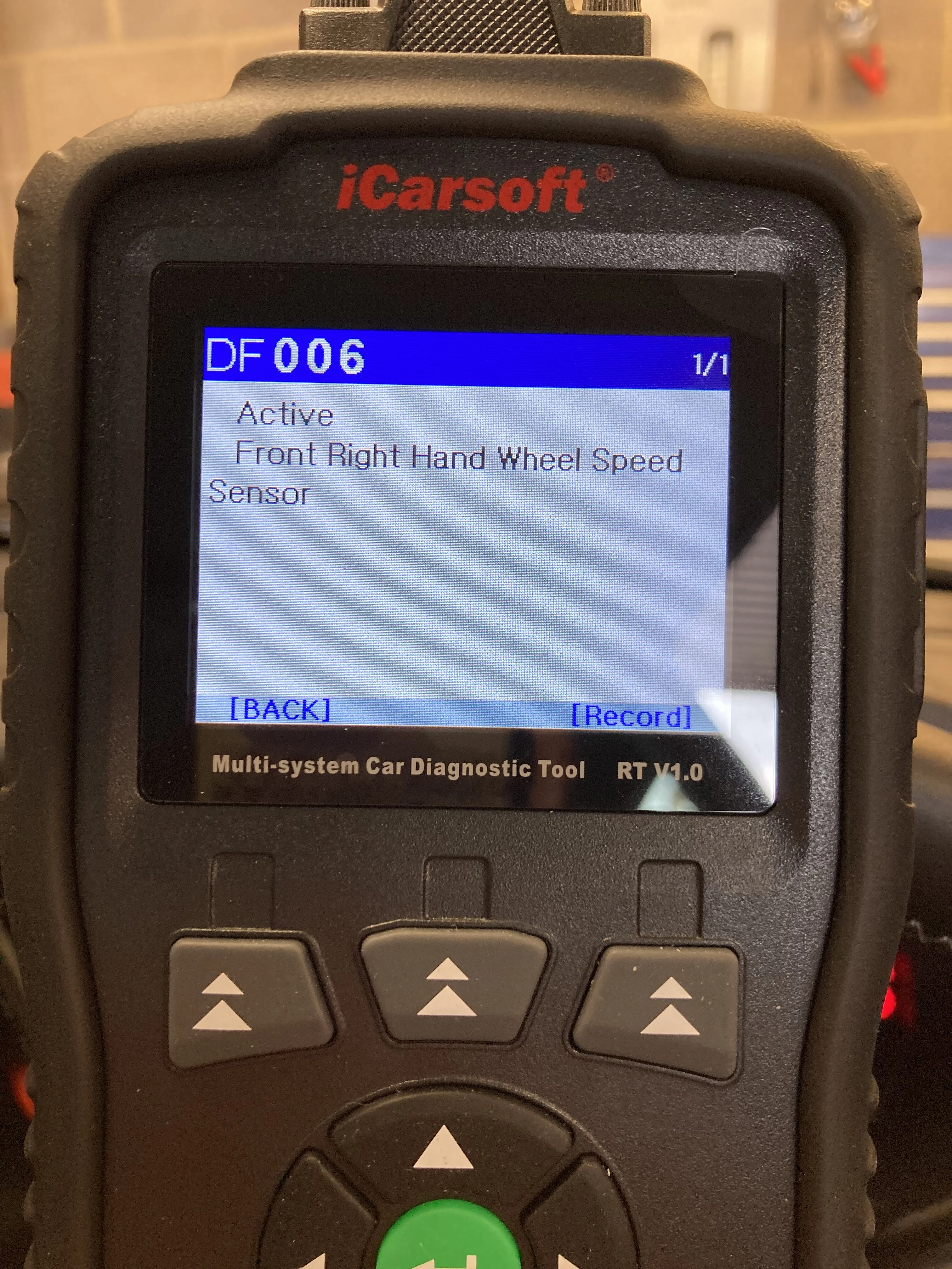

The above lights came on and my code reader gave me DF 006 FR wheel speed sensor.
Fitted new sensor, cleaned ring and checked all connectors but the lights won’t go out even after deleting the code.

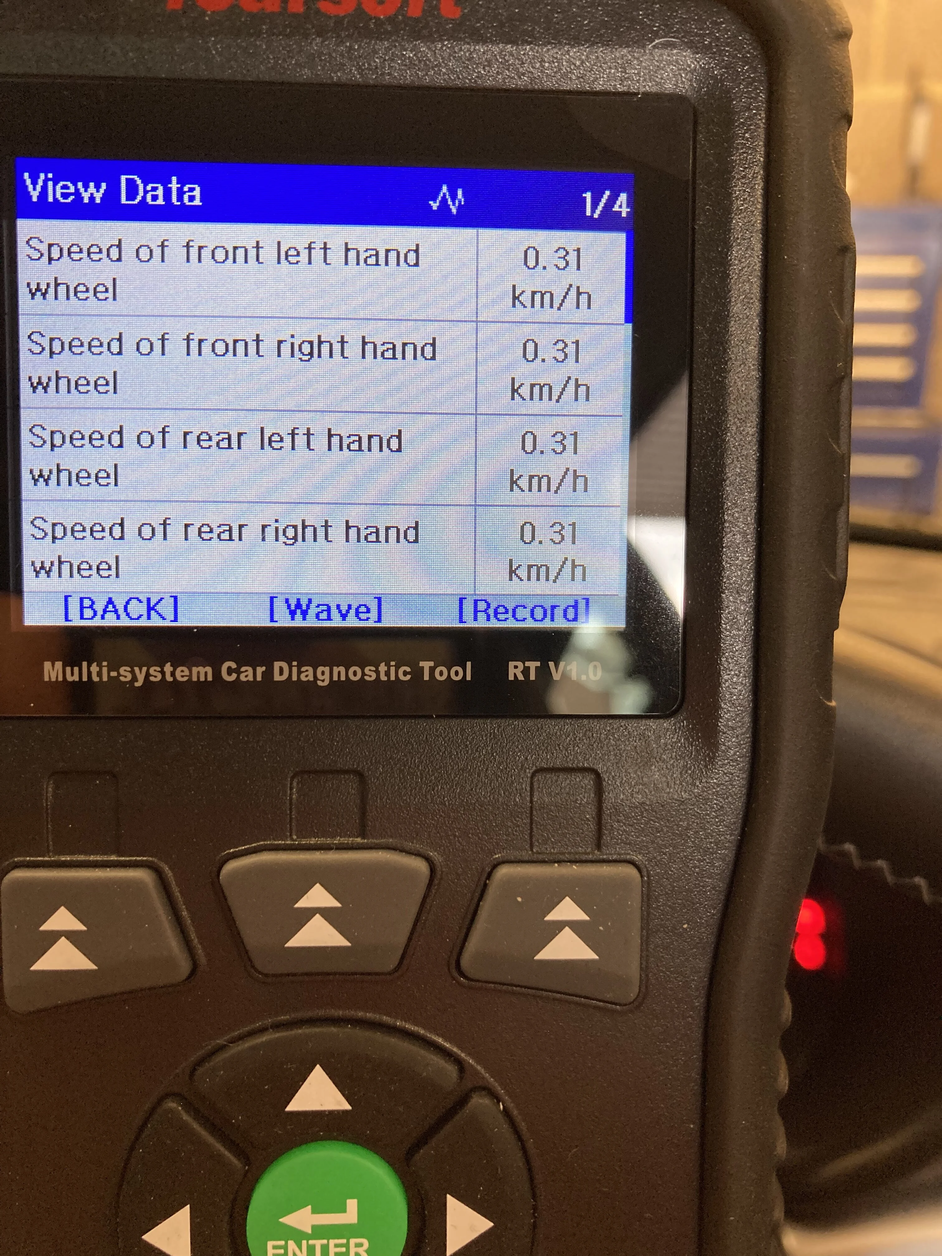

Also the data shows a reading for all 4 sensors so I’m at a loss what to try next. Any ideas would be greatly appreciated. Cheers Andy.
