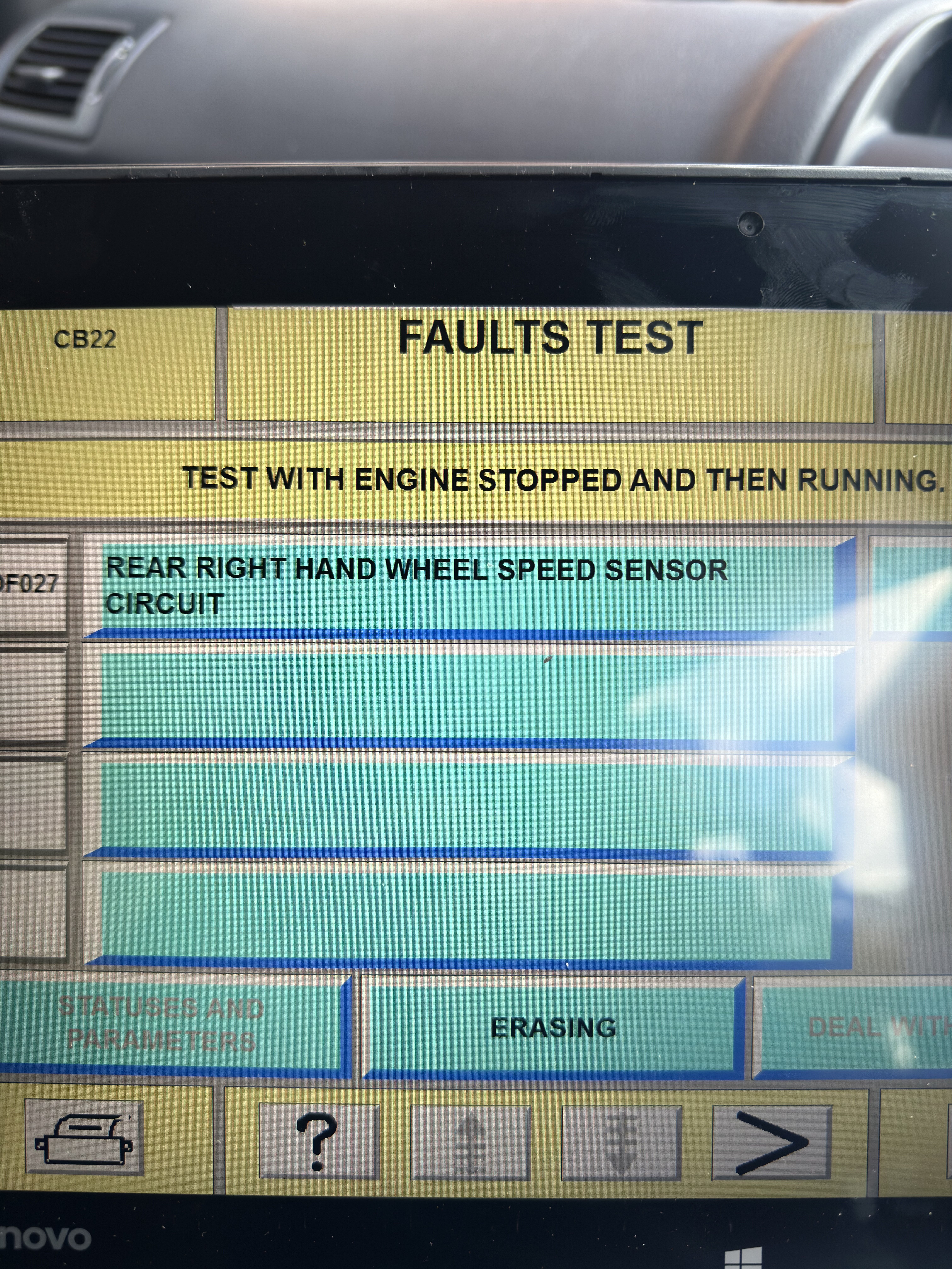

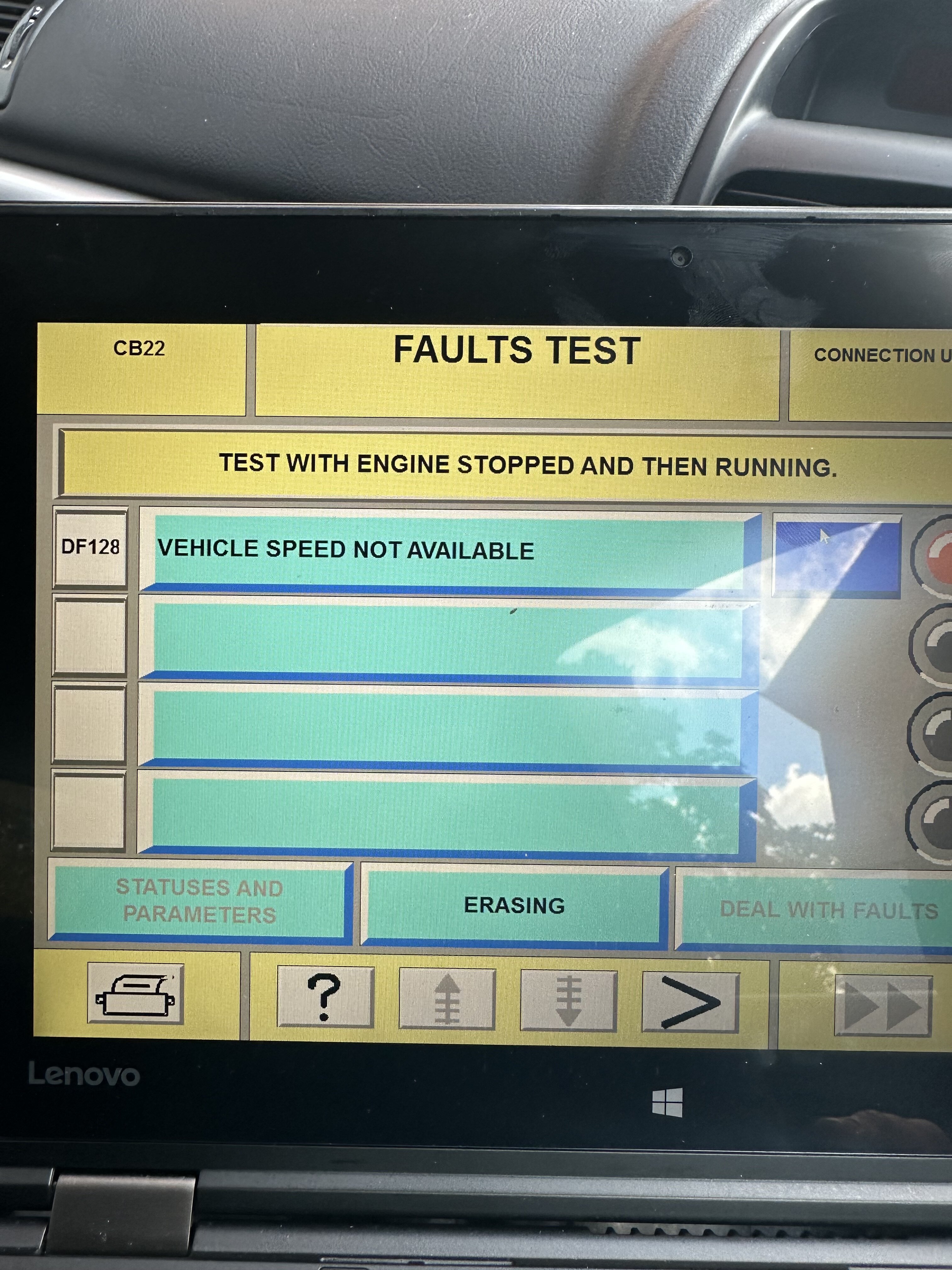

My 182 Cup has had intermittent ABS / ESP / Serv coming on for ages. More recently permanently on. Did not worry too much as I only potter about locally ! but now it is MOT time I need to sort it.
Stuck it on Clip and got the attached. Assuming ABS sensor as when you clear the codes it comes back instantly even without driving.
Am I right in thinking if it was a bad ring you wouldn't get errors until you started driving again?
Anyone who has seen this code before or who has experience here I would appreciate a bit of advice.
Many thanks.

Vehicle speed not available seems to flag up quite often but no warning light.
Id say its a safe bet its sensor or wiring issue if the other one wont clear.

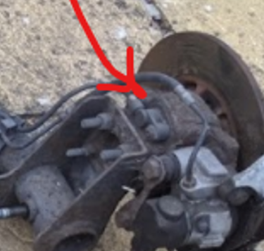

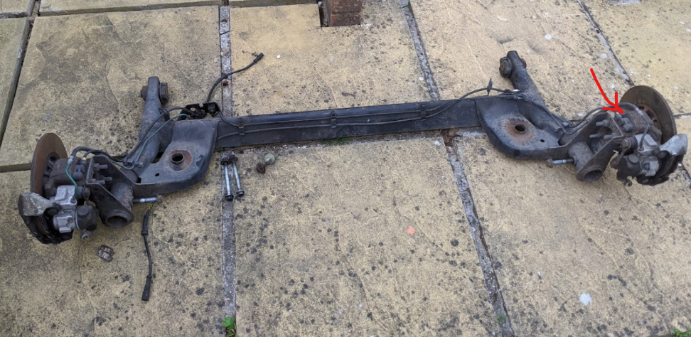

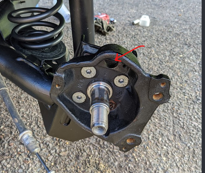

Goes here:
I seem to remember fitting my ABS sensors after the hub was back on the car. So just whip disk off, undo sensor bolt (from the back) and knock the sensor through.
