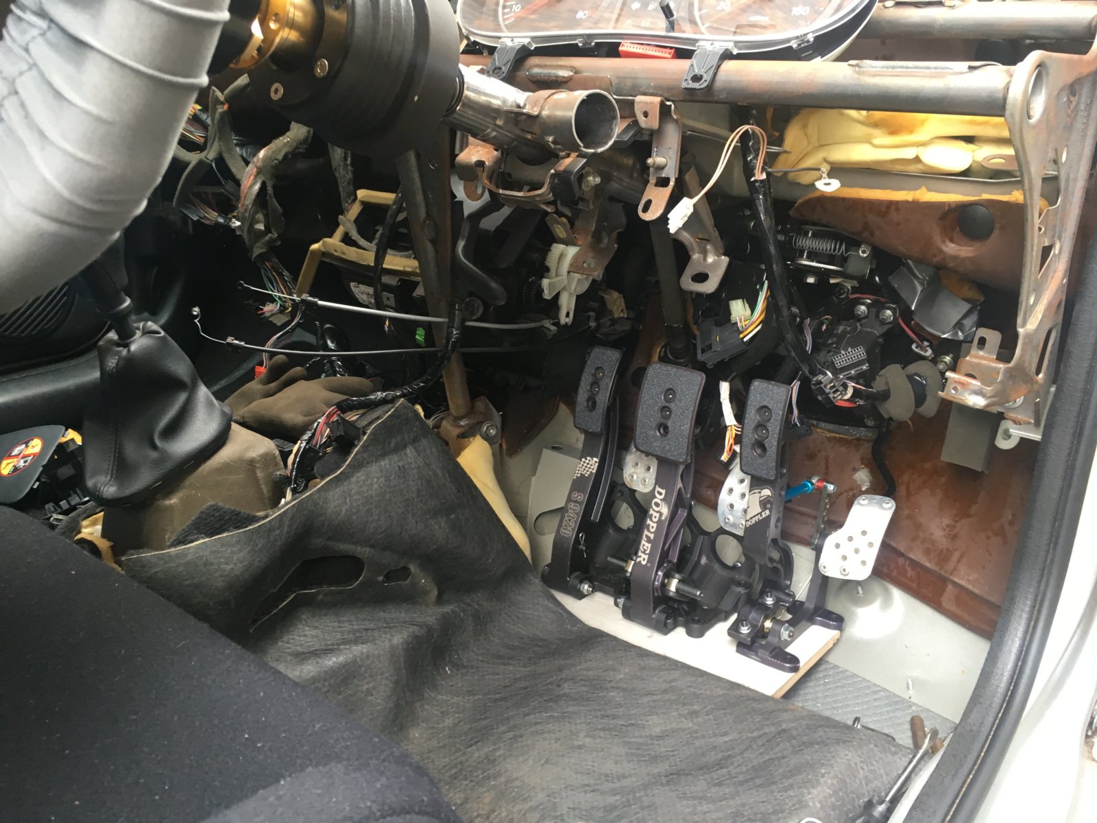

The servo has a deadzone yes, pump brakes with car off and you can feel how much travel there is before. Im fitting a pedal box right now for the same reasons as you. I couldnt say on the compbrake kit though I think a couple of people on here have used it. Im fitting those same ap racing cylinders and they arnt cheap so should be heaps better than standard setup.

I got this off ebay un used, an argentinian company 'Doppler'. Quality wise its perfectly fine, not as well made as a tilton but for the price It was an good choice.
Bare in mind youl need a master cylinder for the clutch as well a slave cylinder. Im still collecting parts for this setup but you are looking at over 1k, Ive managed to source 2 ap racing cylinders for 70 quid so far, the third bought new for 125 :oops:

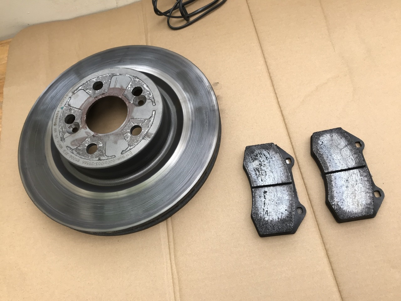

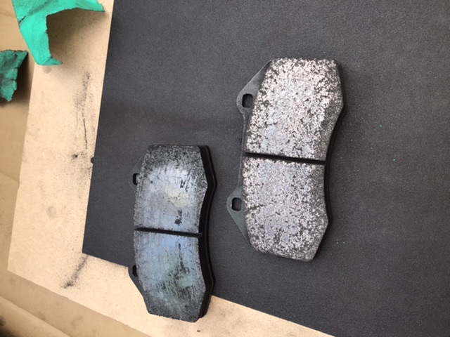

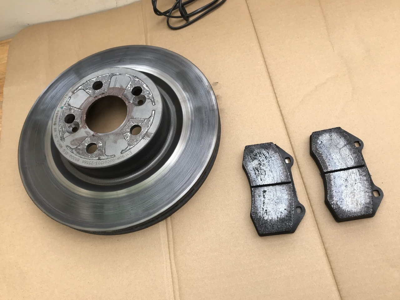

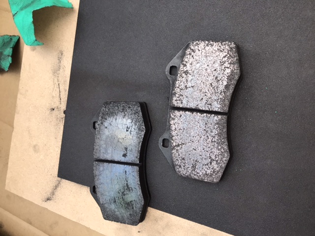

I had the same issue with the same setup but Clio 200, I thought I had bedded them in correctly but then had a track day with lots of juddering once warm it seems I underestimated how hot you need to get them during the bedding. I inspected the pads and they where glazed with lots of pad debris on the disc...
Quick rough sand on the pads and fine (1000 grit) on the disc to try and remove the worst of it.
I then went on a 6am bedding in session where I slowly brought the pads up to ‘race temperature’ starting with 70-40 before moving up to 70+-15. I found them to very slowly improve as they warmed and got no juddering. I have then left them to cure for 24hrs, the discs look a lot better and feel smoother hopefully a successful track day this Friday..
