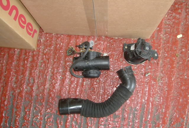

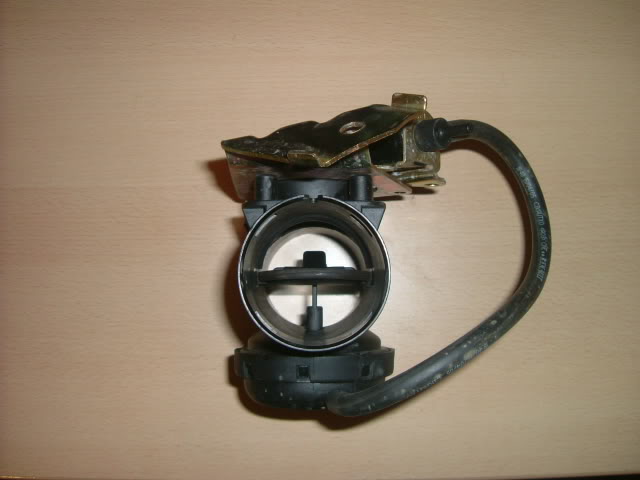

lol - take a look at the overhead view of the valve and tell me it's not restrictive, it results in a sub 50mm hole being reduced further by the valve even when fully open, if it doesnt affect airflow why dont we all put one in our zorst
  182 Full Fat
Its suffocating the poor car!! Out of interest does anyone know if this piece of kit (or similar) has been fitted to the 197??
I believe, the latest ferraris and lambos actually do have these in the exhaust to meet relavant noise regulations.
The airbox has two feeds though, the other with no valve in.
The result it the filter can easily flow enough air.

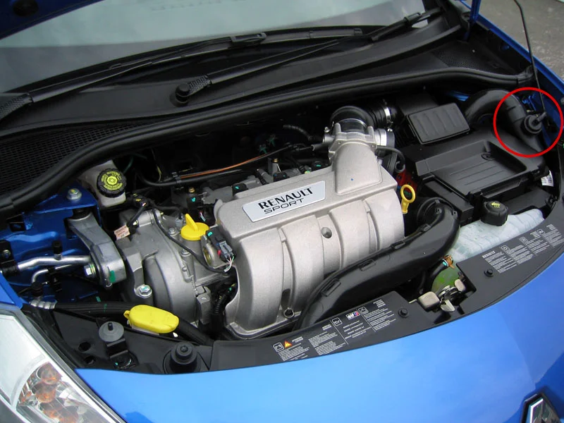

Yep, i believe so:
  Clio 172 mk2
Ah yes..I see the good old acoustic valve there:D
I wonder how many people are going to rip it out of their brand new 197 to be replaced by some washer drier hose lol
