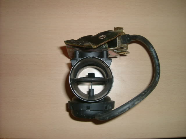

ok to clear this up we are talking about the lil black box in the middle of the air feed pipe?

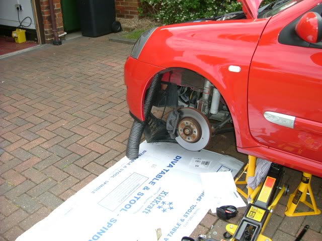

guys how do you actually remove the valve as my gen 2 kit is coming today and i thought i would remove it at the same time cheers many thanks ps sorry for asking i have no mechanical knowledge what so ever lol

1) Jack up car
2) Remove front passenger wheel
3) Remove inner arch liner to gain access
4) Un-bolt and remove, remember to block the end of the small rubber pipe.
More pics here; http://s23.photobucket.com/albums/b387/7MAT/TROPHY/CAI/

Arch liner is held on by a few plastic plugs which cost about 10p each to replace if you do chew then up whilst pulling them :approve:
7MAt above helped me with my acoustic valve removal, only took about 30mins!

Ben's point that it can not help torque is absolutely fundamental as it is on the wrong side of the air filter to create any useful resonant pulses to improve cylinder filling - the air filter will act as a damper. The only thing that has not been checked out is when it works - in addition to the vacuum pipe there is a solenoid with an electric feed. If anyone has the time, they could put an warning light type bulb or meter into the circuit to see when and if it is activated.
My best guess is that it is to do with drive by noise, particularly for Switzerland

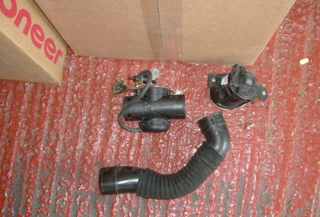

clidge, if you plan to run a proper caf by removing the foglight you have to take the acoustic out, as it is in the way. if you are not doing this then leave it alone imo

haitch thanks for that mate i am getting my gen 2 kit fitted tonight and will eventually put a bigger feed in so shall i remove it?
  Clio 172 mk2
You have to remove it to get the feed down through the gap and to the fog.
