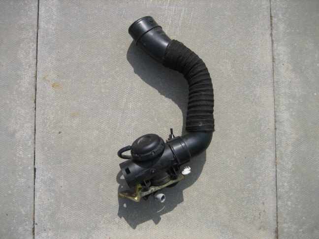

tried to search but couldn't make head or tail of it, just wondering how i would go about removing the acoustic valve, where it is located etc. plus will i have to blank anything to keep prevent juddery idle?
thanks ad:approve:
Did mine on saturday and noted good results.
Take the passenger wheel arch off then to the front you'll see it attached to the same bracket as the horns. Take this bracket off the car then take the valve off the bracket and reattach bracket to car to hold horns in place.
follow the thin tubing upto the inlet and unattach, cut a little off the end and put a screen in (something to block it) then put the little bit you cut off back on inlet else your car will idle just over 1000rpm.
Hope this helps
Can you clarify the bit in bold as this confuses powey?

Remove the lot, when you do this you'll find a 6mm rubber tube which i blocked with a screw to stop the suction (valve is activated by this) and disconnect the leads (plug). Tape up the end of the leads (plug) to prevent moist etc coming in and you're done..
When already doing this mod, it's best (and very easy) to get some 65 mm cafs to replace the shitty ones left when removing the acoustic valve

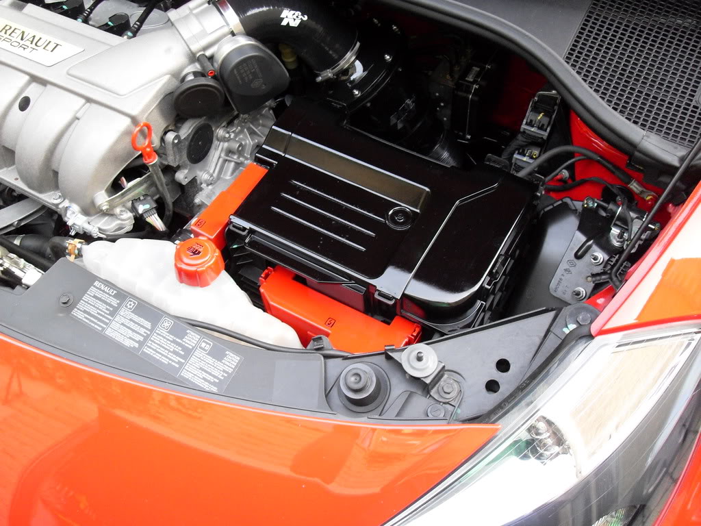

on this picture the black circular thingy.....is that just a breather for oil vapor?
inbetween the plenenum chamber and dipstick.
