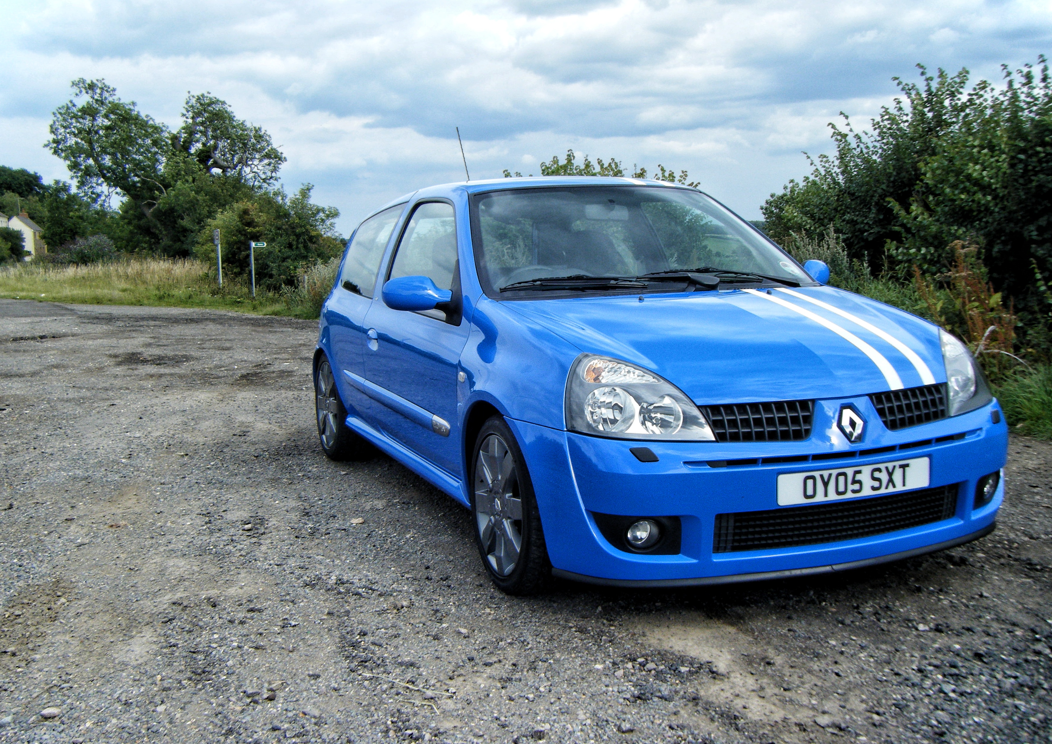

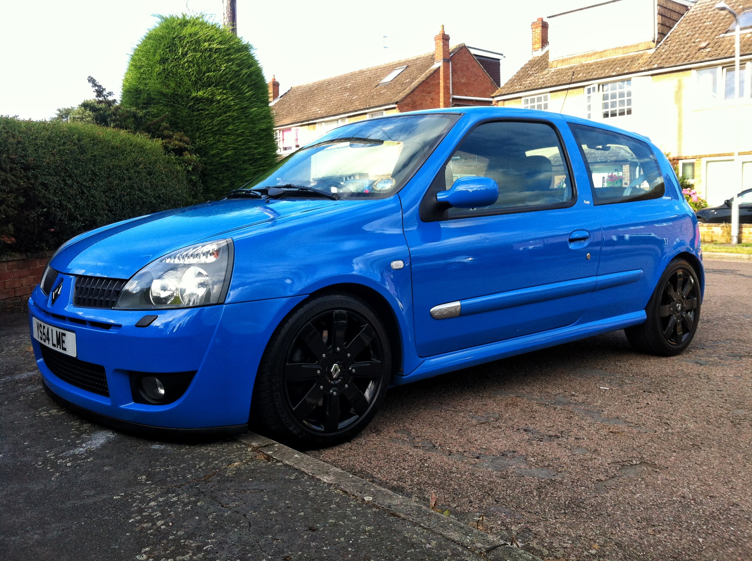

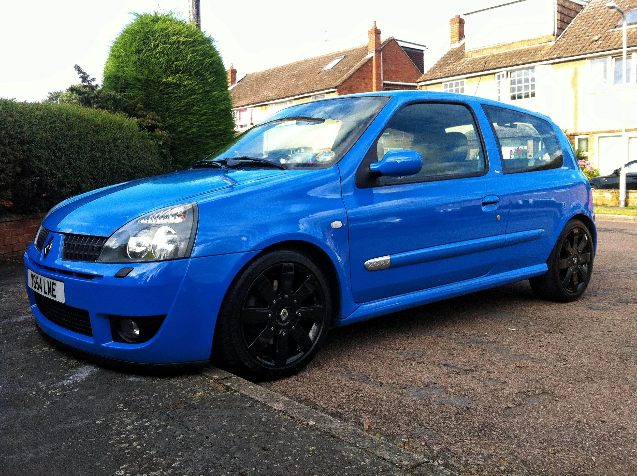

First purchased in 2011 is my RB 182 Cup (funnily enough only £100 separates the price I paid for this and my new one).

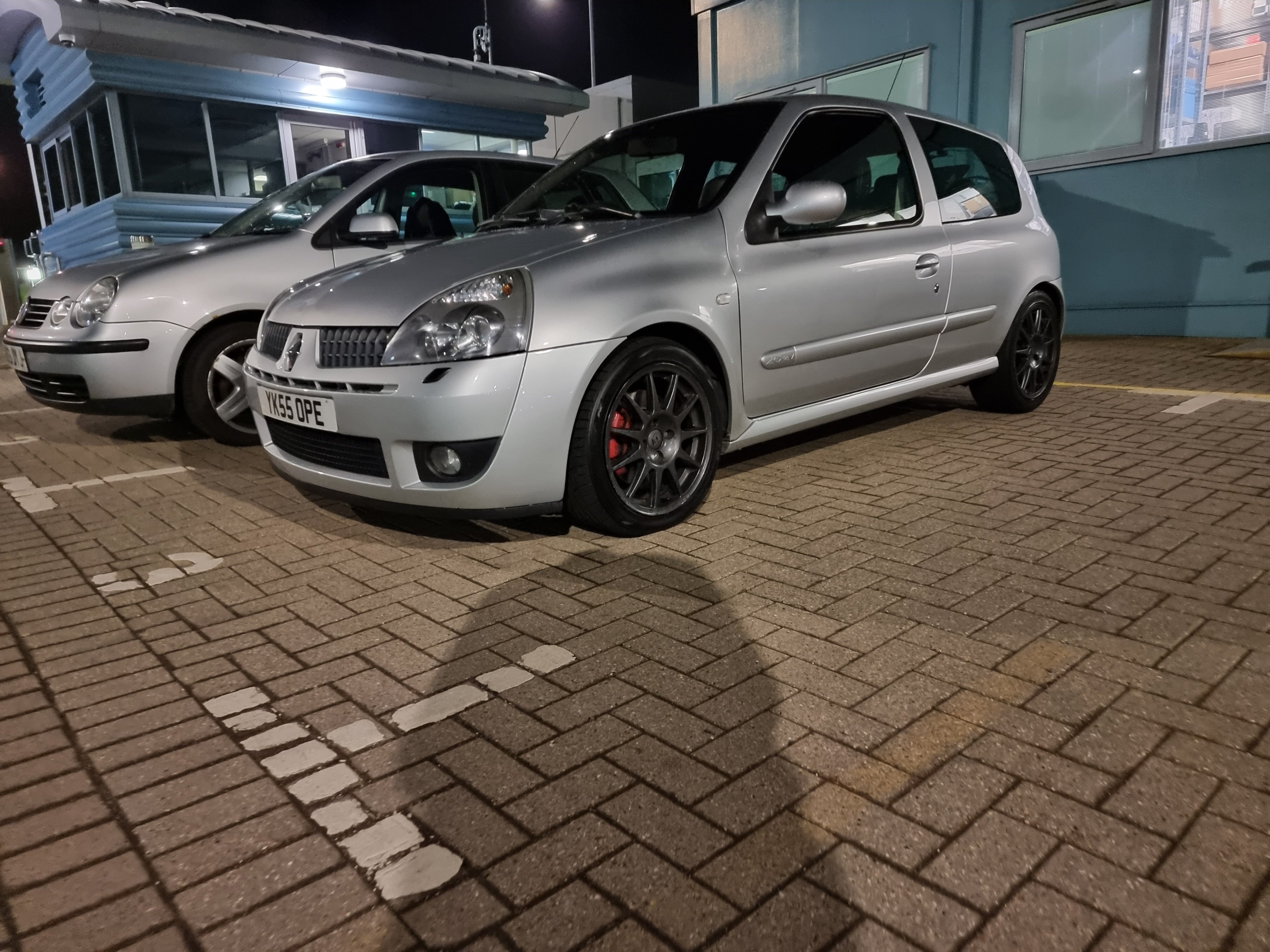

Then I got my Iceberg Ph1 172 which was probably my favourite Clio to date.

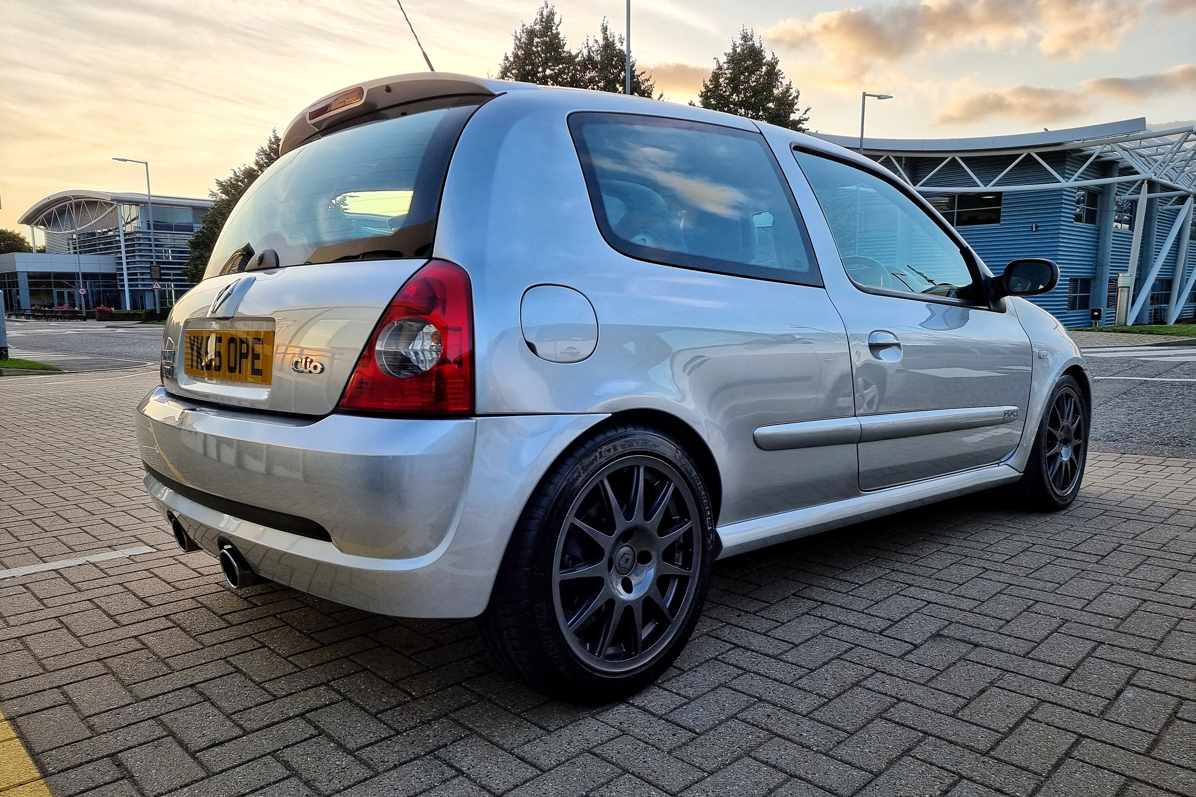

Then back in an RB 182 Cup I should add if it wasn't obvious RB is my favourite colour for the Clio.
Adamm.

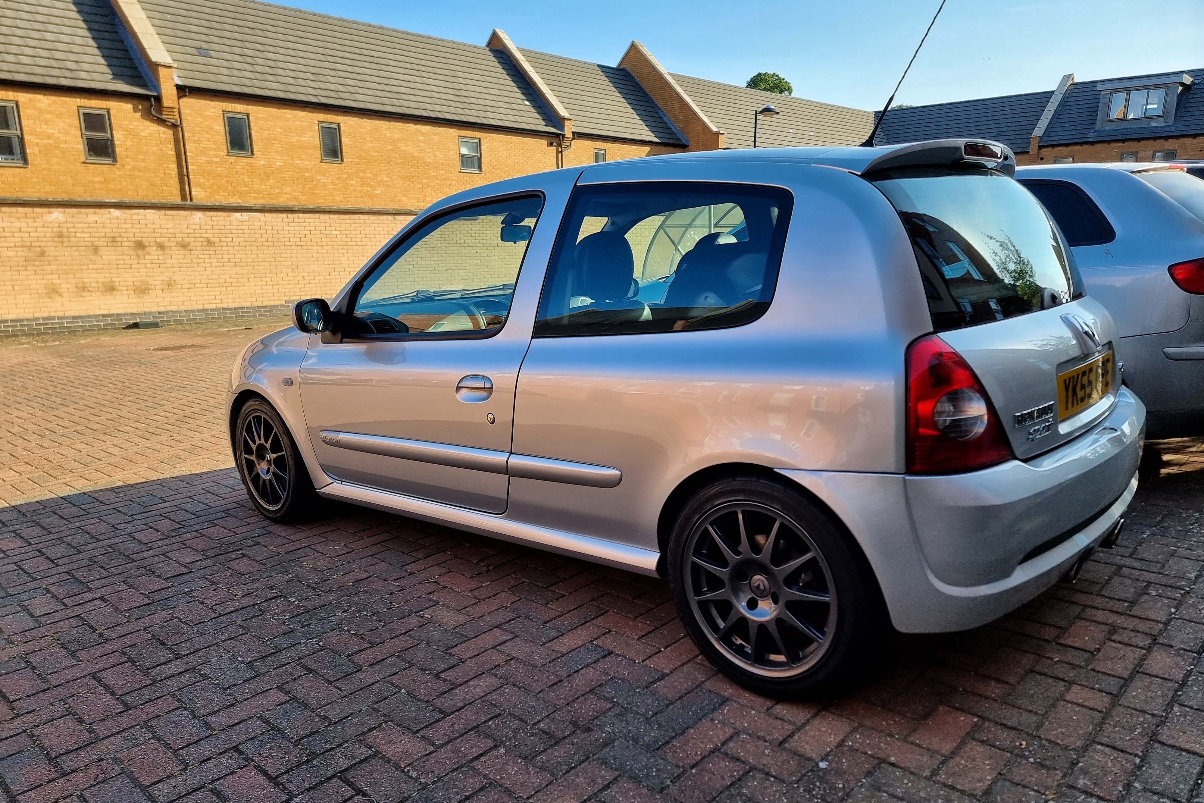

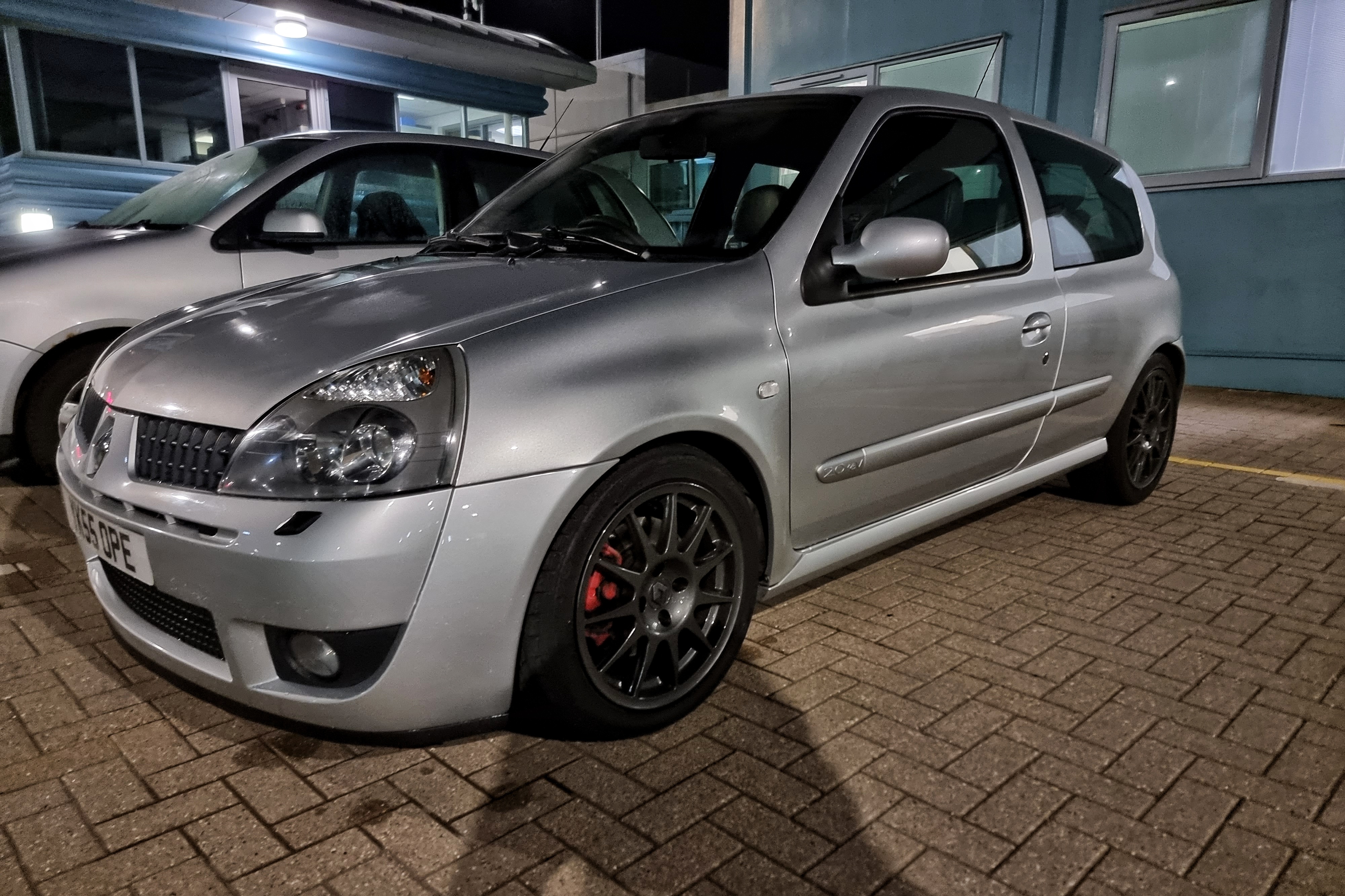

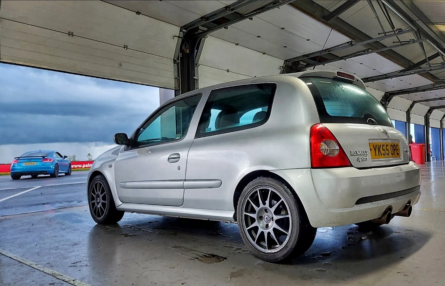

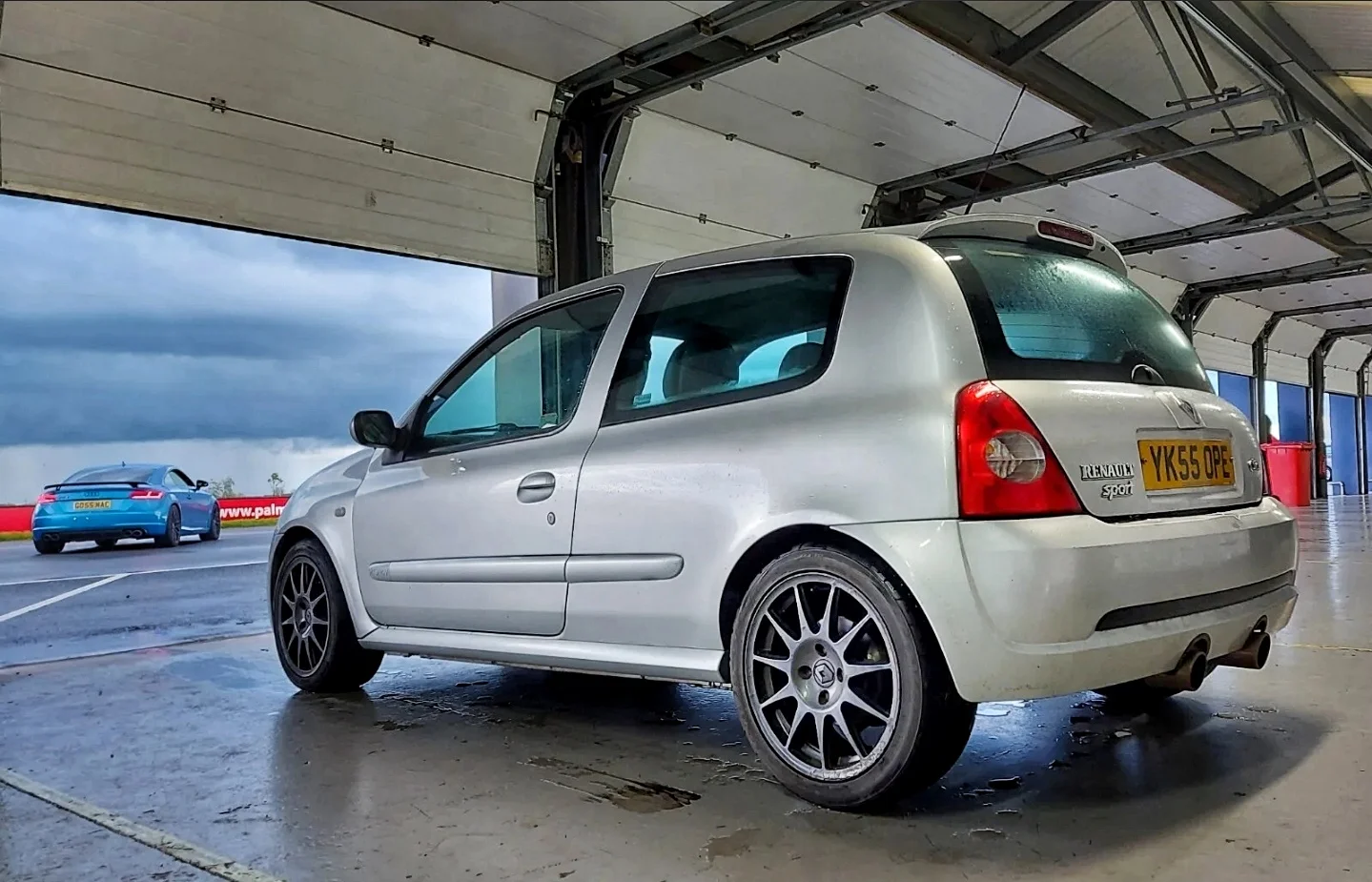

And now my current Titanium 182 FF.
List of mods on this currently..
Eibach pro (changing to grams)
Scorpion exhaust
172 Turinis
White line rear anti roll bar
Poly bushed front anti roll bars
Ported and matched inlet
ITG panel air filter
DS2500 pads
Goodrich brake hoses.
Hopefully I didn't bore you too much by rambling on but I think I'll leave that there for now and keep updating with anything I do in the future. I'm a lazy fucker so expect progress to be slow and boring 😅

Nice mate. I’ve got grams spring on my titanium 182 and they work brilliantly with the standard dampers.

Nice mate I've heard good things so I'm looking forward to get them on. The Eibach pro are great too don't get me wrong just not quite low enough for my liking especially if I'm considering 15" wheels.

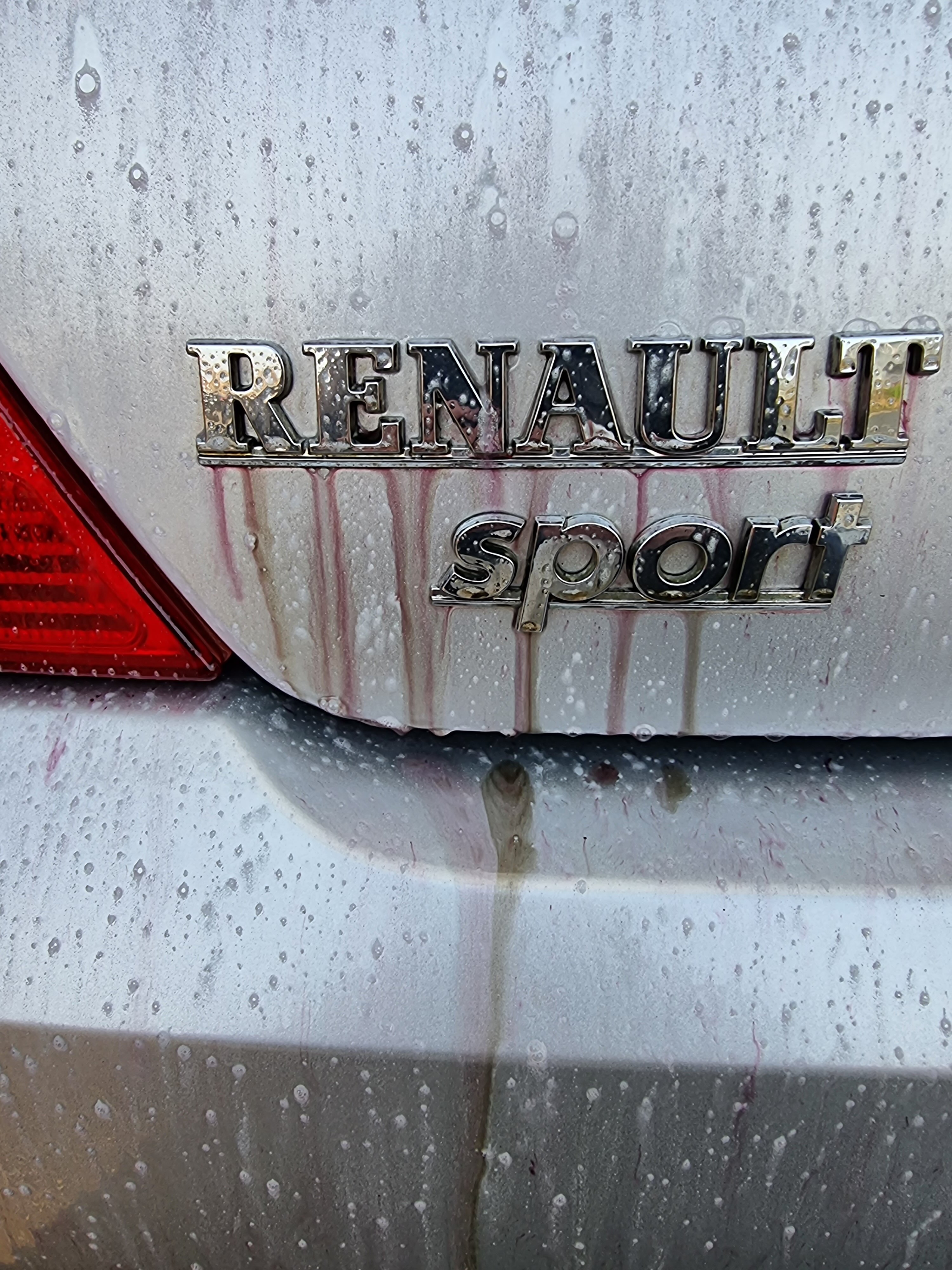

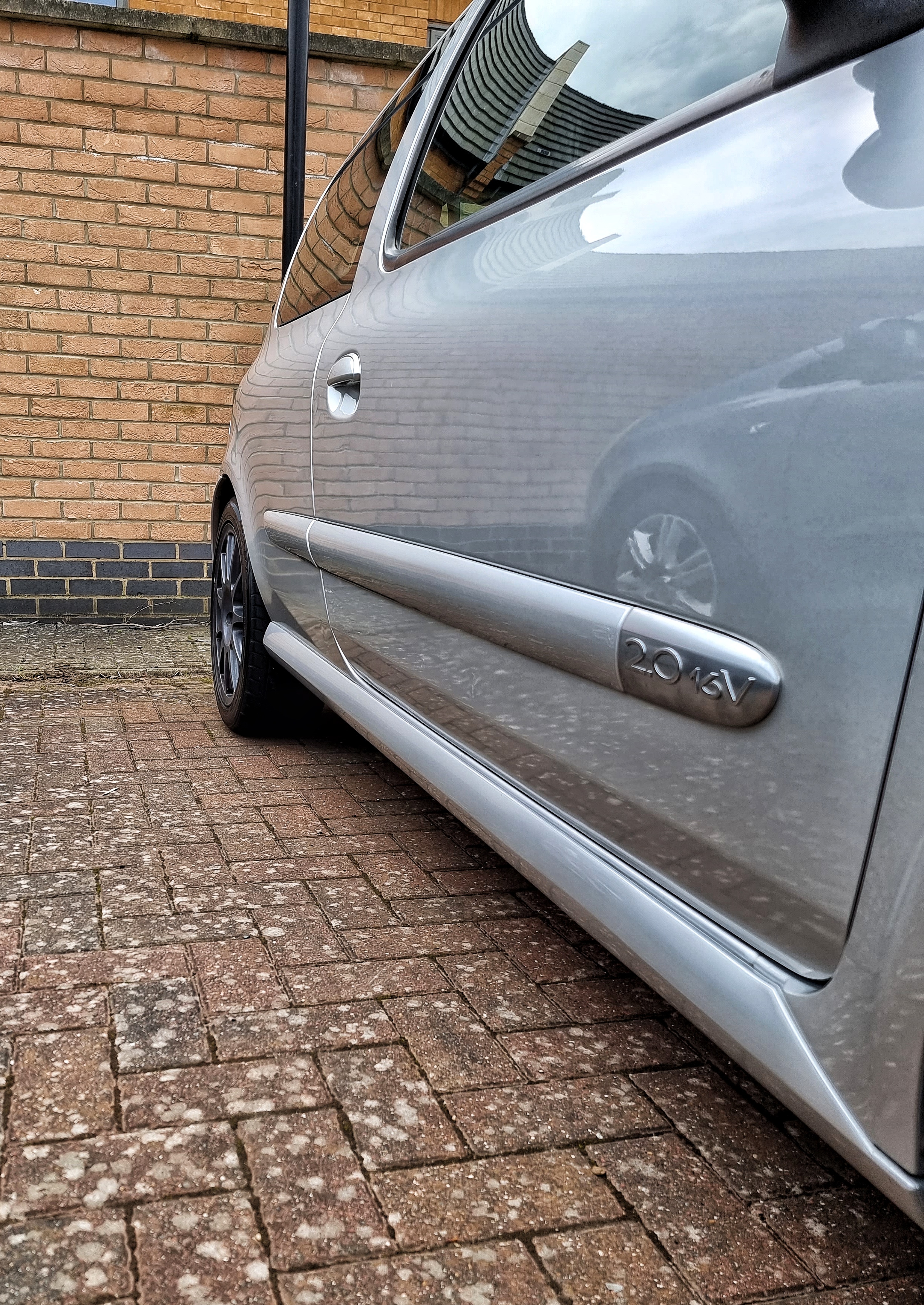

Gave the car a bit decontamination wash at the weekend steps included a quick rinse with Bilt hamber Surfex, followed by a bit of a bath in Bilt Hamber Korrosol washed off and then another bath with Valetpro tar and glue remover with a final wash with Carpro reset. I forgot the clay bar but after all that the paint feels really smooth. I never do a good enough job at getting before pictures but the difference is night and day just from that. It's really brought out some of the defects in the paintwork now but the polisher will come out another day for most of those.

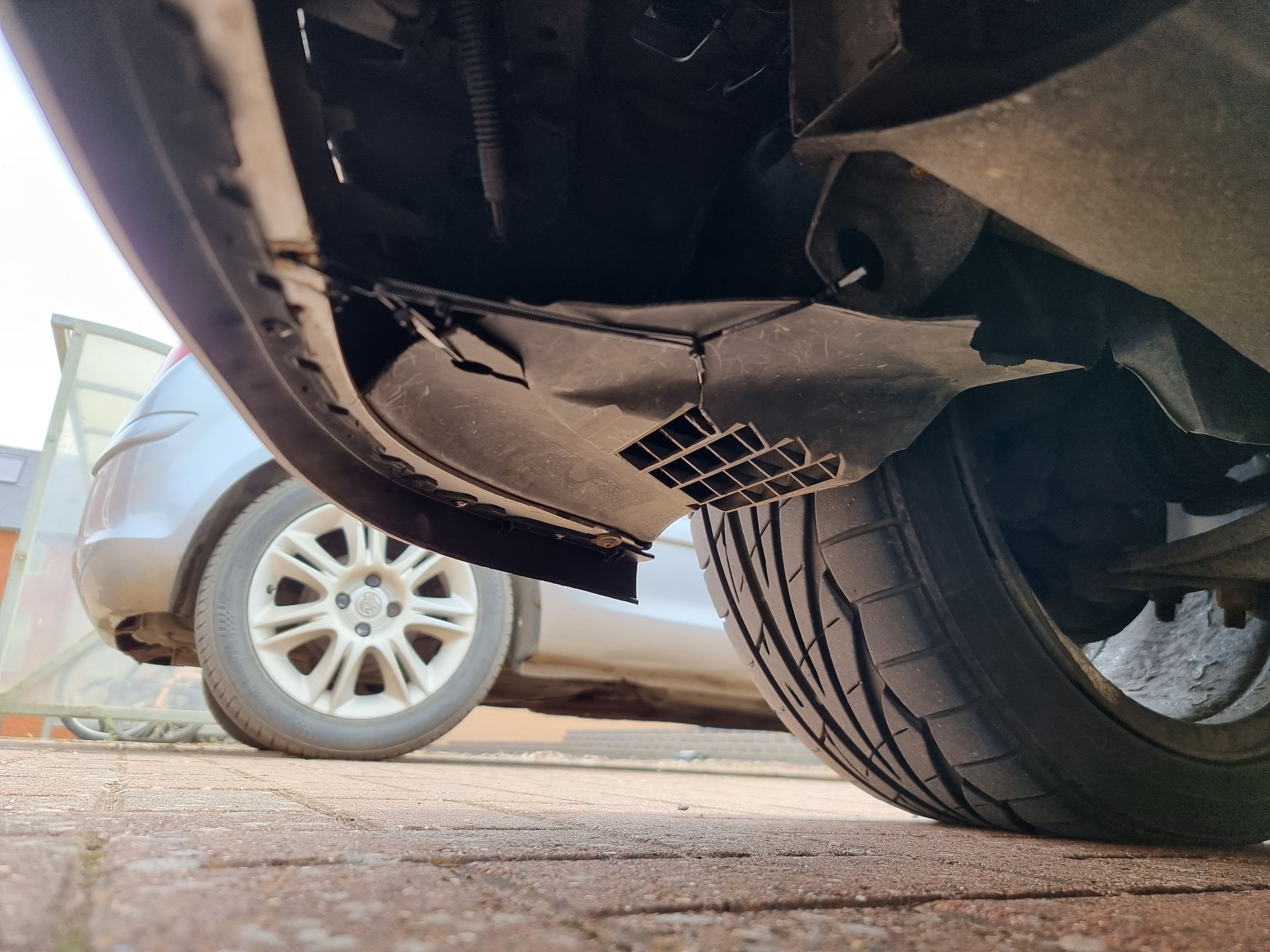

Had a flappy front section of arch liner so put up a bodge job for now. It's pretty solid so temporary to permanent fix not yet decided 🙈
There's still some left where it meets the front bumper so I'll pop a screw in there once they arrive in the post as I need more for the splitter anyway.
I then swapped the front numberplate over for a new smaller one and fitted a fabia front splitter. These make a great difference to the front end just need to be careful not to piss off the police now 👀
The state of the wheels is absolutely minging I'm not even going to bother cleaning them again. Hoping to get them refurbed in a few weeks but the wash really opened my eyes to how bad they are.
Some bits I'll get on soon is the windows have slight water staining going on so going to give it a go with some normal polish and pads but failing that I'll get some ceriglass ordered before putting a coat of G1 on them. Headlights will be getting a polish too as they're not too bad right now so best to get on it before it's too late. Bullets need to be looked at see if I can clean them up a bit better hopefully they'll clean up well with a bit more attention. Seatbelts need a clean the drivers one especially is filthy. Hopefully get all that done before any more updates.

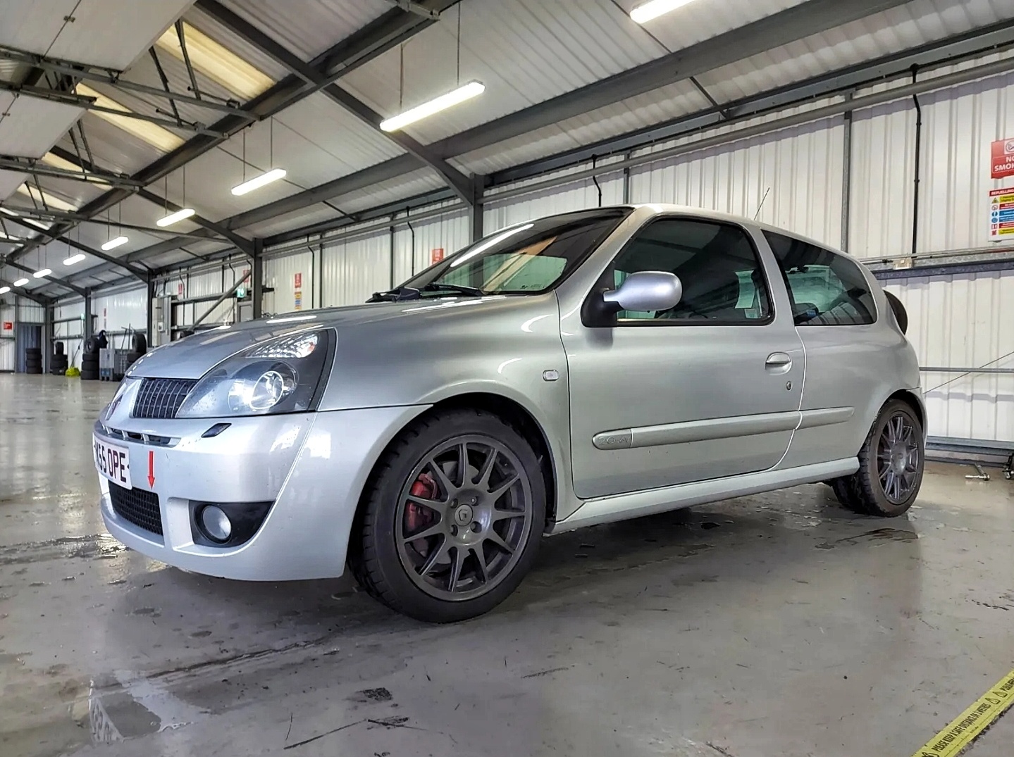

Bit of an update seen as I've clocked over 2k miles since buying now.. More than what it did for the past few years so at least the old Clio is getting some use again.
Had a few issues occur 1 being a misfire on cylinder 1 which I suspected to be injector seen as spark plugs were done in December. Decided I'd try the coilpack and leads first as they are cheaper and could probably do with a refresh anyway and it seems to have fixed it. I noticed a slight crack in the old coilpack housing too wether that was the cause I've no idea.
Also had a leak into the passenger footwells and under driver's seat. Luckily I spotted it before it got absolutely soaking but it turned out to be the pipe from the scuttle into the engine bay which was clogged with dirt. After giving it a good fingering it all gushed out so I'm thinking that was the likely cause. Now I've got the task of drying it out but for now I've dabbed it all with drying towels which soaked up the worst of it.

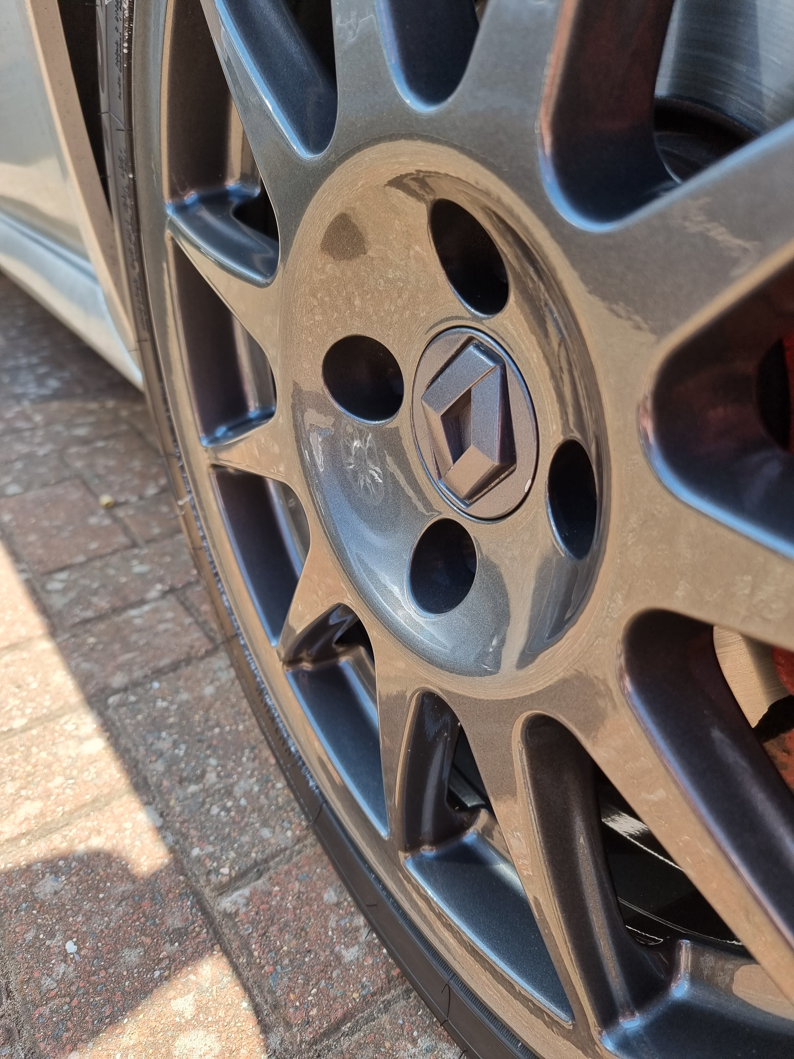

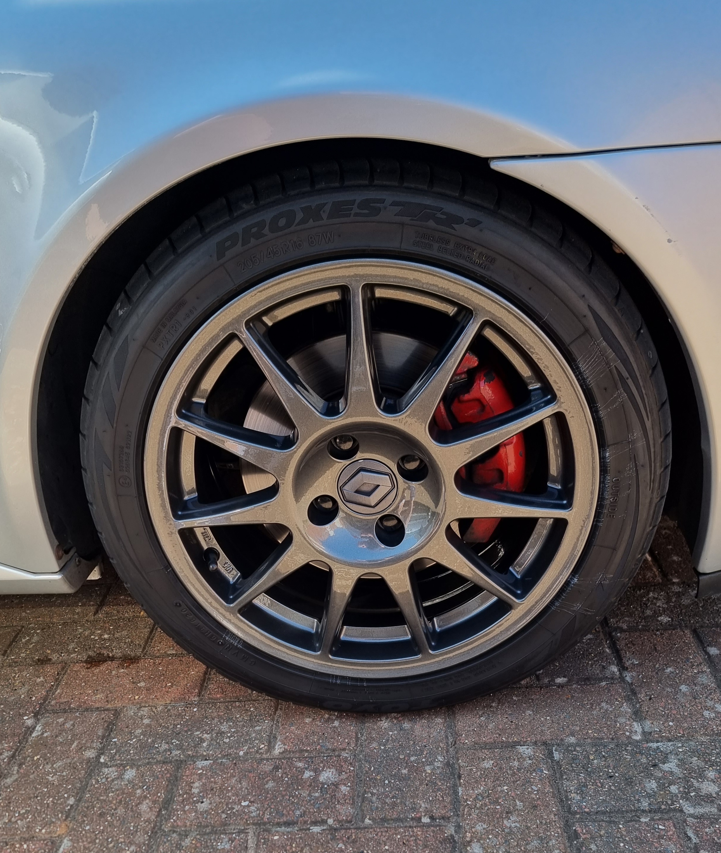

Wheels were refurbed a while back in a colour called sparkle anthracite tbh it's essentially just anthracite but I think it has a bit more of a flake to it. They were the biggest let down to the car though so glad that's sorted now. And I've also had it put onto grams springs as the prolines were just a little too high for my liking. Really happy with how the car sits now.

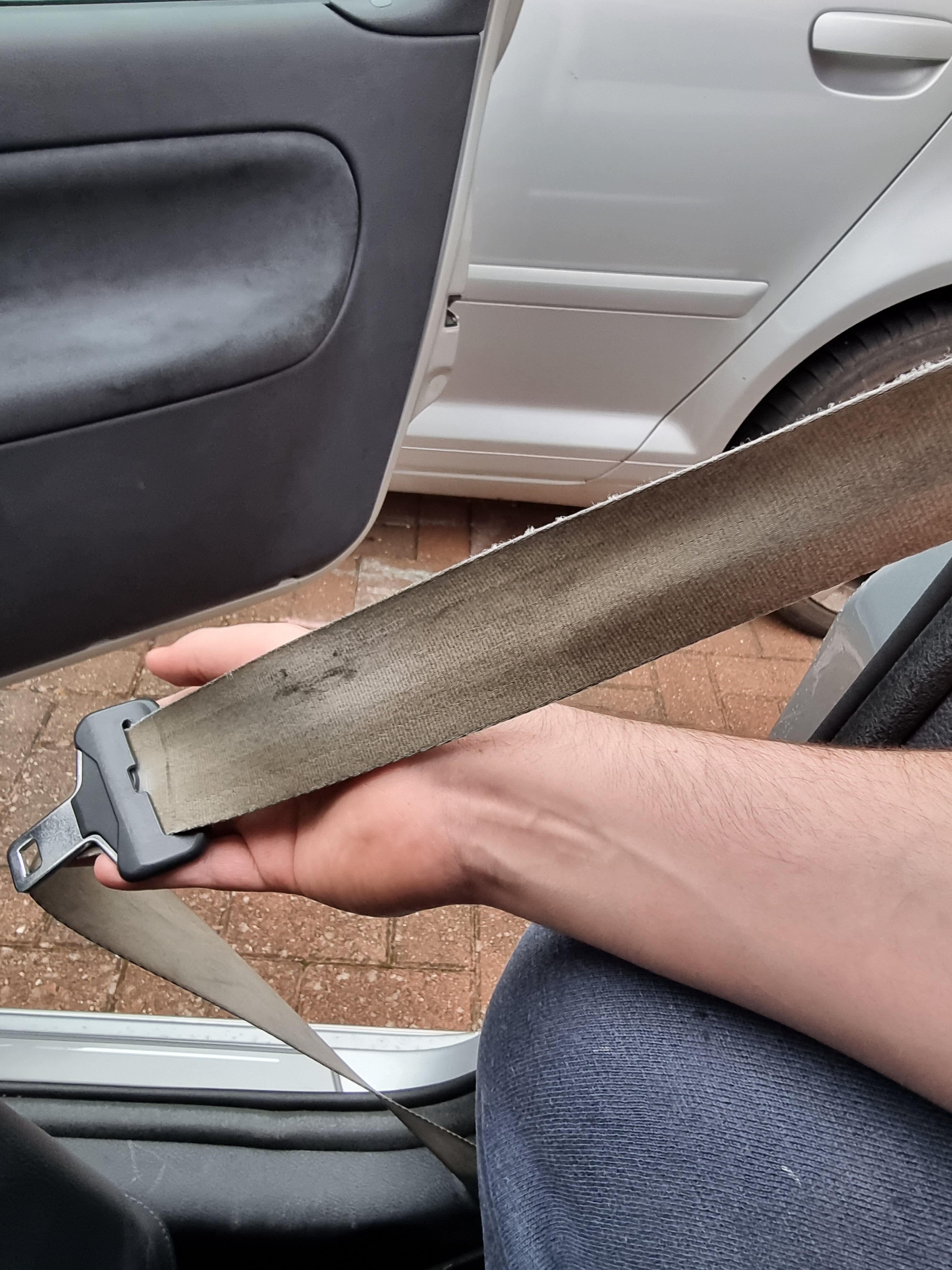

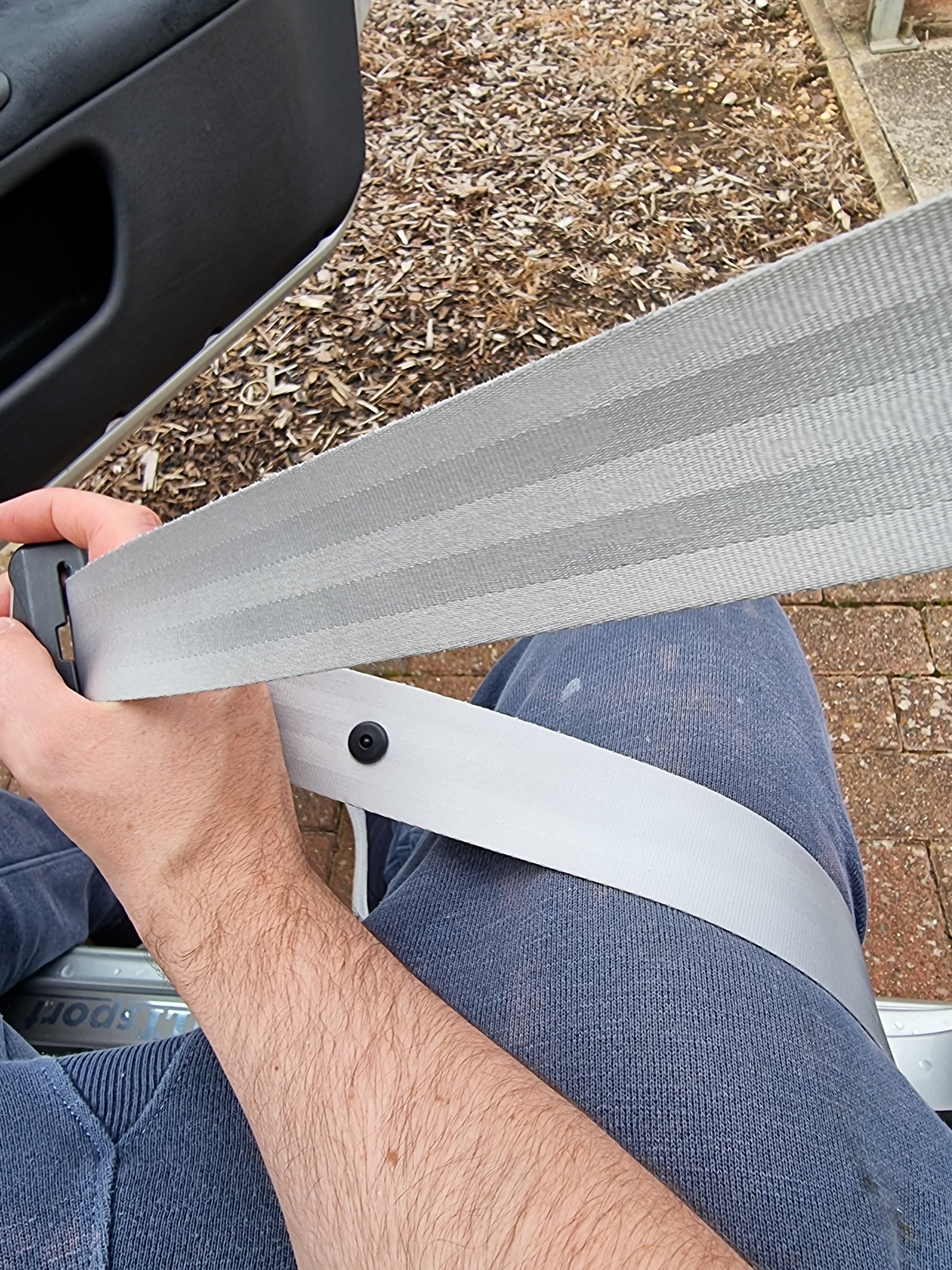

List of things to sort still is getting a dent man on a few small dents and cleaning up the seatbelts.
NickReilly063
  182 Trophy Rs265
Love your attention to detail cleaning your seat belts - they really do make a big difference when they come up nice 👌
I did mine as was really pleased too.

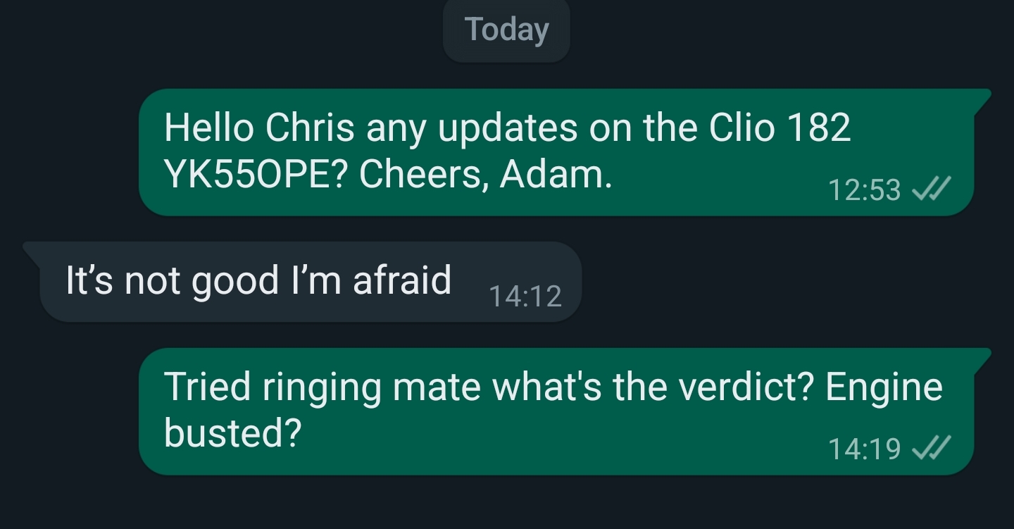

What’s happened??

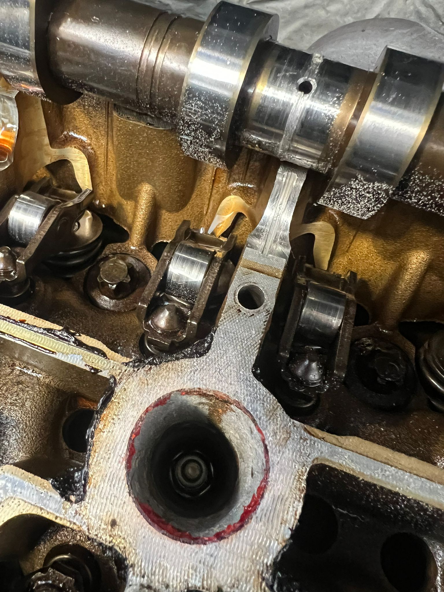

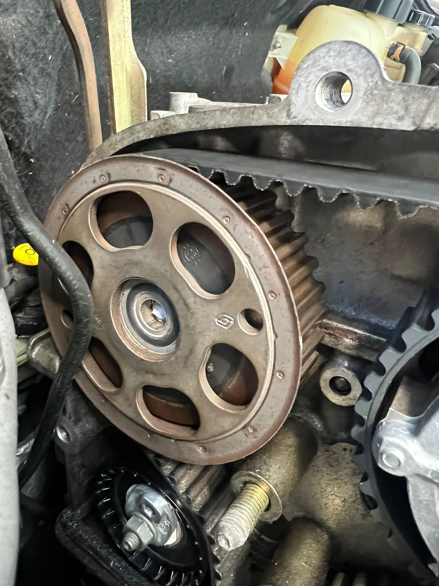

Hoping to get the full run down tomorrow of what and how it happened but it's seeming like something in the engine has failed. Car cut out idling and wouldn't start again. Was hoping crank sensor but the garage have said it's not looking good so that pretty much ruled that out.
Shite way to start the new year car has seemed solid too put more miles on it than what it done in the last 3-4 years before passed MOT and service just a few weeks ago and the car was praised by the garage for being a lovely example and then this.

Does it sound normal when it’s cranking over?
Or does it crank over really fast and sound a bit s**t?
At first it didn't even want to turn over almost like a dead battery but then eventually it was turning over like this. A few on here who are more clued up did suggest it didn't sound quite right. When RAC took air filter off you could hear a ting sound from throttle body when it was trying to turn over.

That’s not dead. I’ve had perfectly good/running ones sound worse than that starting up. 😂
Haha honestly mate I don't know I left it in better hands than my own because I'm useless and this is all I got earlier. Spoke on phone briefly and he said he'd ring me back after more investigation. I'm on nights so was asleep all afternoon but will ring him again in morning and hopefully get to the bottom of it but by that message I'm guessing it's fucked something 🤷‍♂️

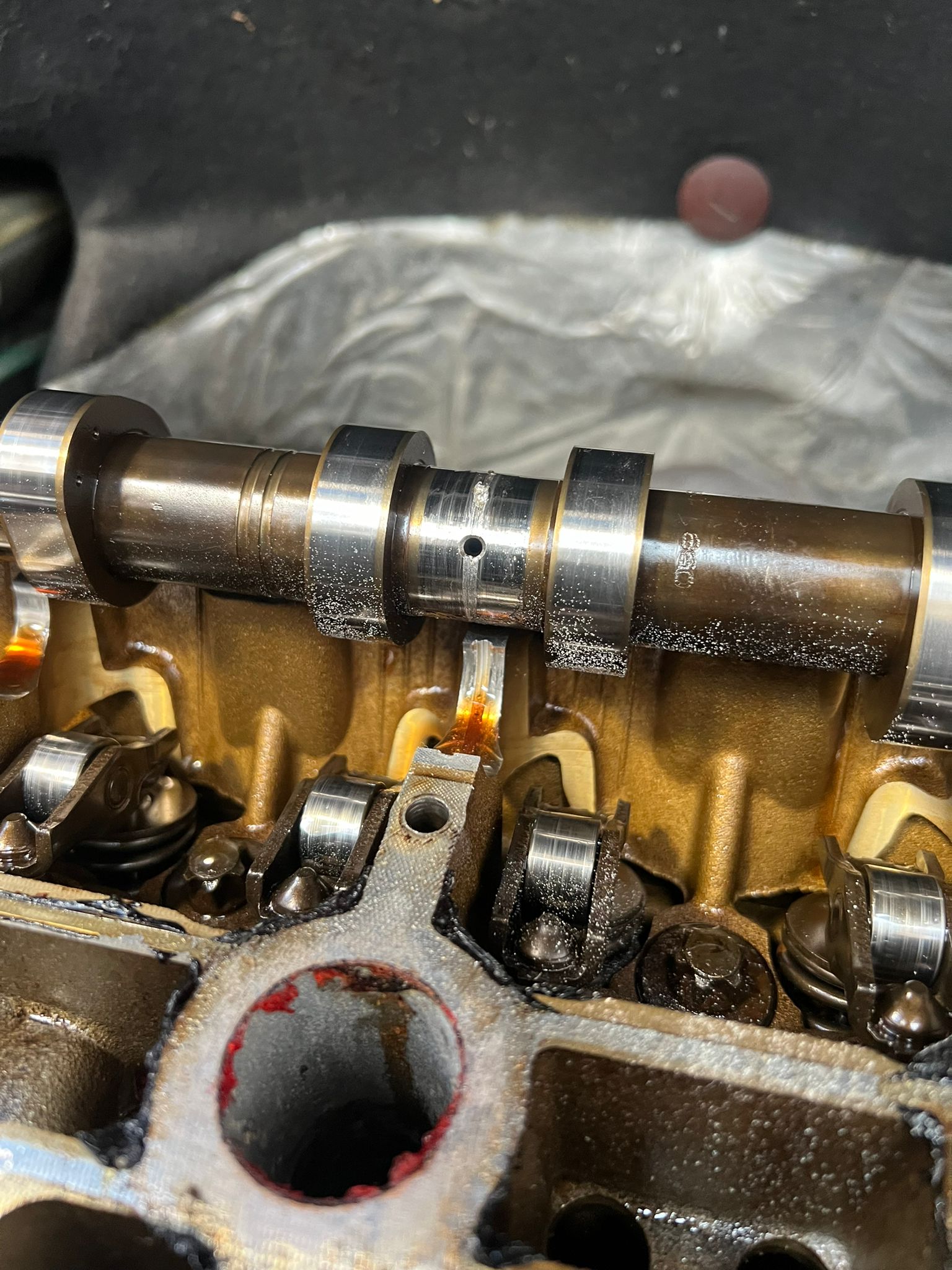

What's the diagnosis?
So I've not had the full run down yet but the diagnosis is essentially the exhaust cam is currently stuck solid and is either caused from it seizing and stripping the bolt or the bolt coming undone. When they put the timing tool on one was perpendicular to the other. Bit of an odd one tbh belts were done a year ago and it just had an oil/filter service.

So the work to get this back on the road has been agreed now and I feel a bit sick 😔😅
Just some shite luck I guess but very odd also that on only 80k the exhaust cam seized for no apparent reason.

You having another engine dropped in, or having that one repaired? May aswell drop some 197 cams in while you're there.....🤔
