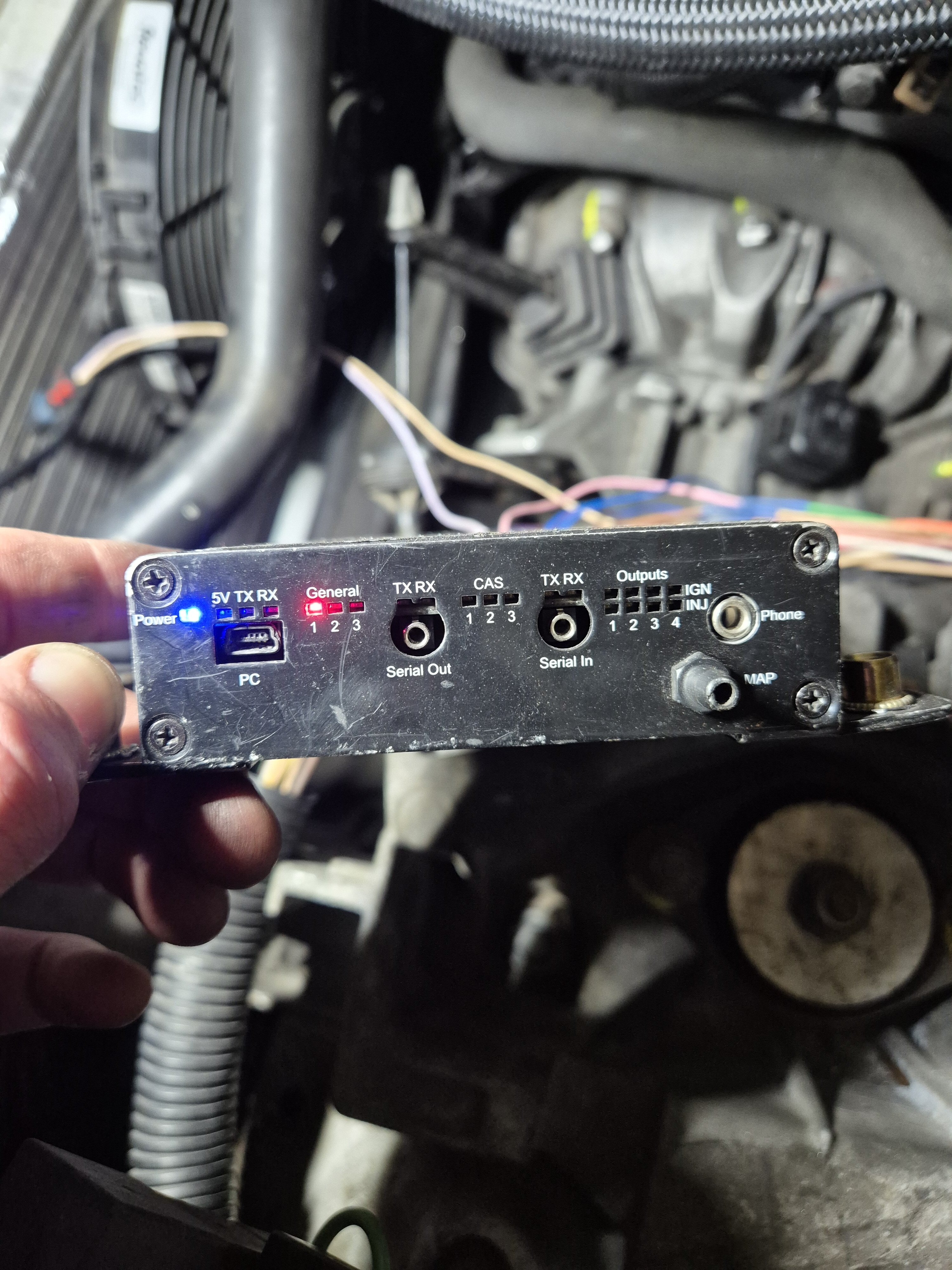

Just installed wiring loom and adaptronics ecu for running ITB's.
Car cranks but won't fire, fuel pump isn't priming on ignition or when cranking as all fuel lines are bone dry.

Immob light irrelevant now as standalone ecu has control over the engine. Forget all the common fixes for original ecu.
Does the ecu have blue lights flashing when powered up and have you been into the ecu via software to check its got a map on it?
You will need the laptop on it to see if its registering rpm etc when cranked.

Ecu powers up and fan starts and then stops.
Blue power light is on alongwith General 1 (red) and Tx flashing yellow on both serial in & out
What software is needed to read the adaptronics ecu? Haven't been into it to check anything

Cheers, I'll have to get a suitable laptop to get it loaded onto as only got a macbook atm.
It was already mapped by chris @ efi when it was in the previous car however have since added cams. Plan was just to get it running and then trailer it to a local mapper to get it setup properly. I didn't want to go messing around with too much stuff
