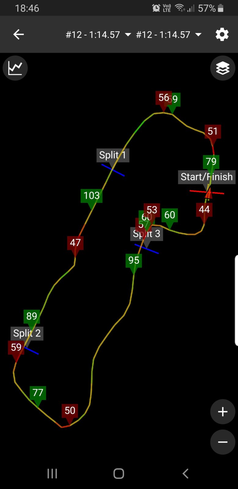

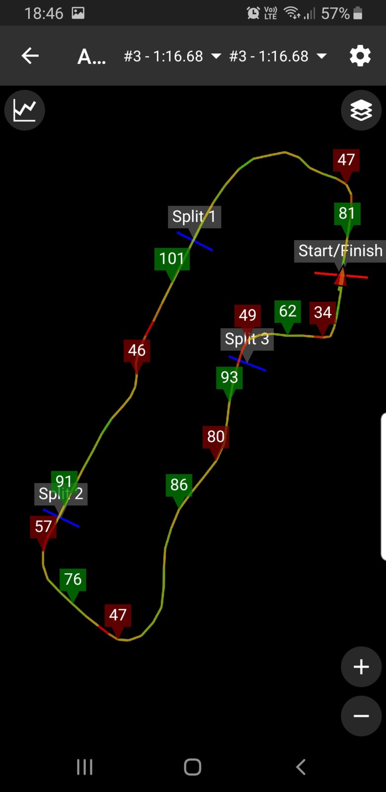

Just looking through my lap timer from Blyton a few weeks ago and I've noticed I was near 2 seconds a lap quicker on the MR2's heavy OE wheels with 195/50/15 front and 225/45/16 rear running NS2R 180's versus the 20kg less unsprung weight (total) OZ Ultraleggeras with 195/50/15 front and 225/50/15 rear on Nankang AR1's.
Conditions were damp in places on the NS2R's as well.
Can't get my head around it TBH. Watching the vids back on the AR1's I was pushing just as much and grip felt better on the day. Didn't have many consecutive clear laps on the AR1's but was still pushing when I did. I thought it would be the other way around with the AR1's being 2s a lap quicker.

Possibly just the spring rates were better matched to the NS2R or you were scrubbing more speed on the brakes with the grippier tyres

Side by side of speeds, you could be bang on scrubbing more speed.
NS2R's
AR1's

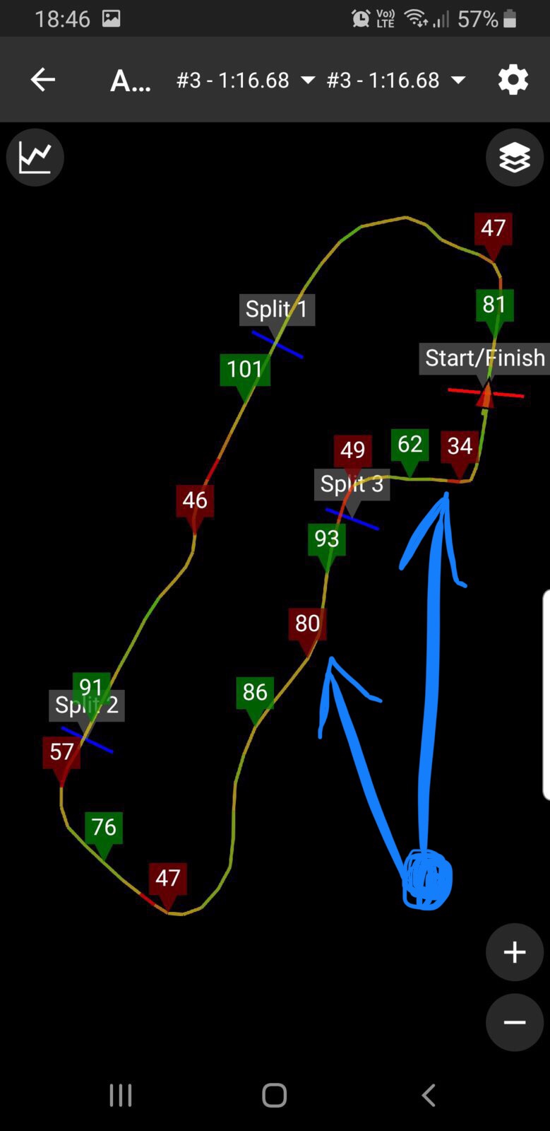

Ok, I’ll put it another way.
Given that you’re in some low power NA ‘shite’, carrying speed is very important for you. [emoji16] There’s more deep red on your slower lap, indicating you scrubbed more speed. But this isn’t racing telemetry here.
