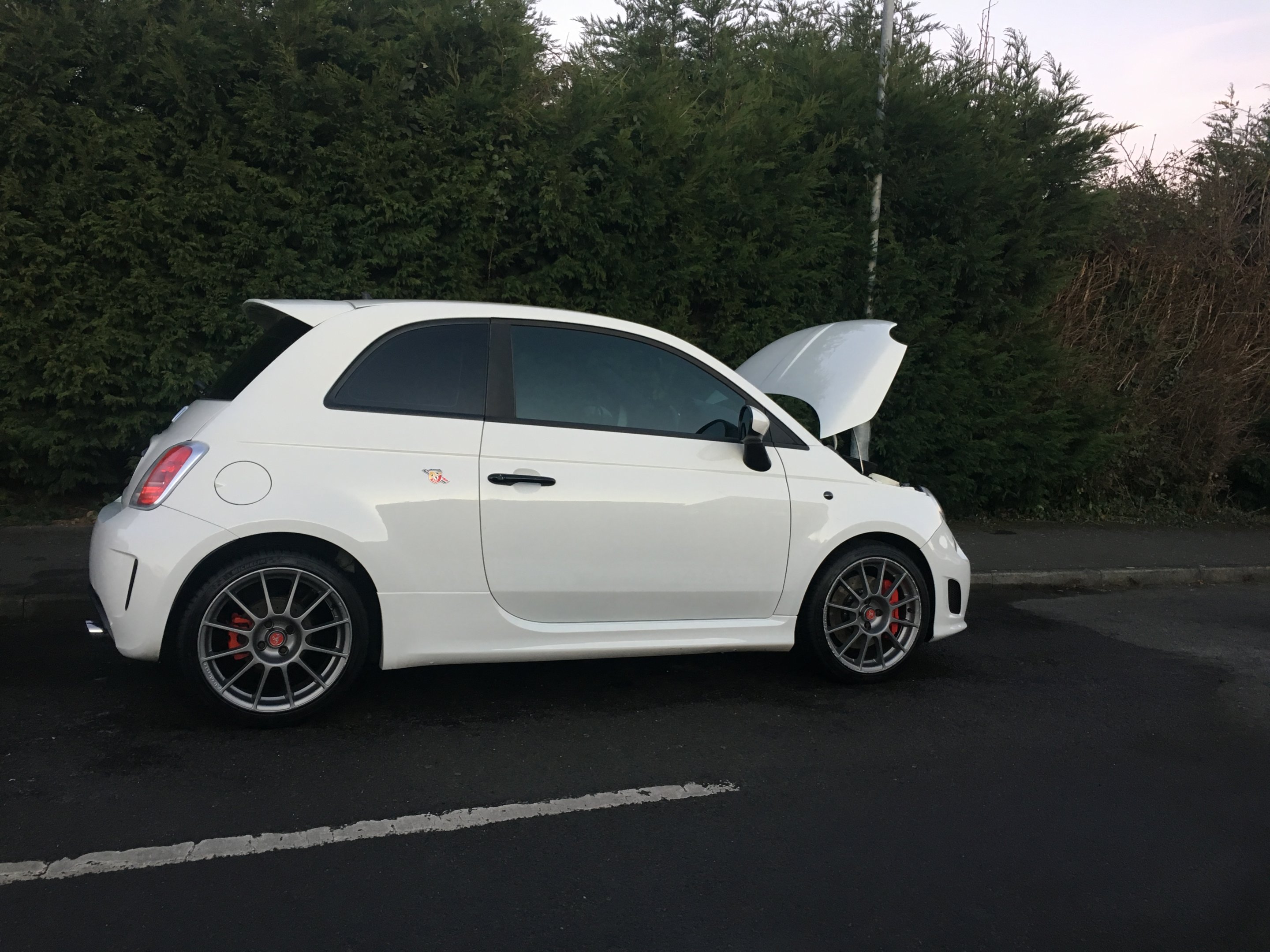

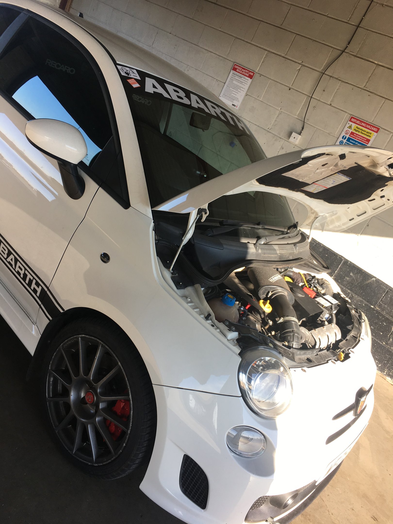

Since advertising it for sale, I haven't had as much interest as Id have liked. Decided to keep it for the time being with the aim to go RWD soon.

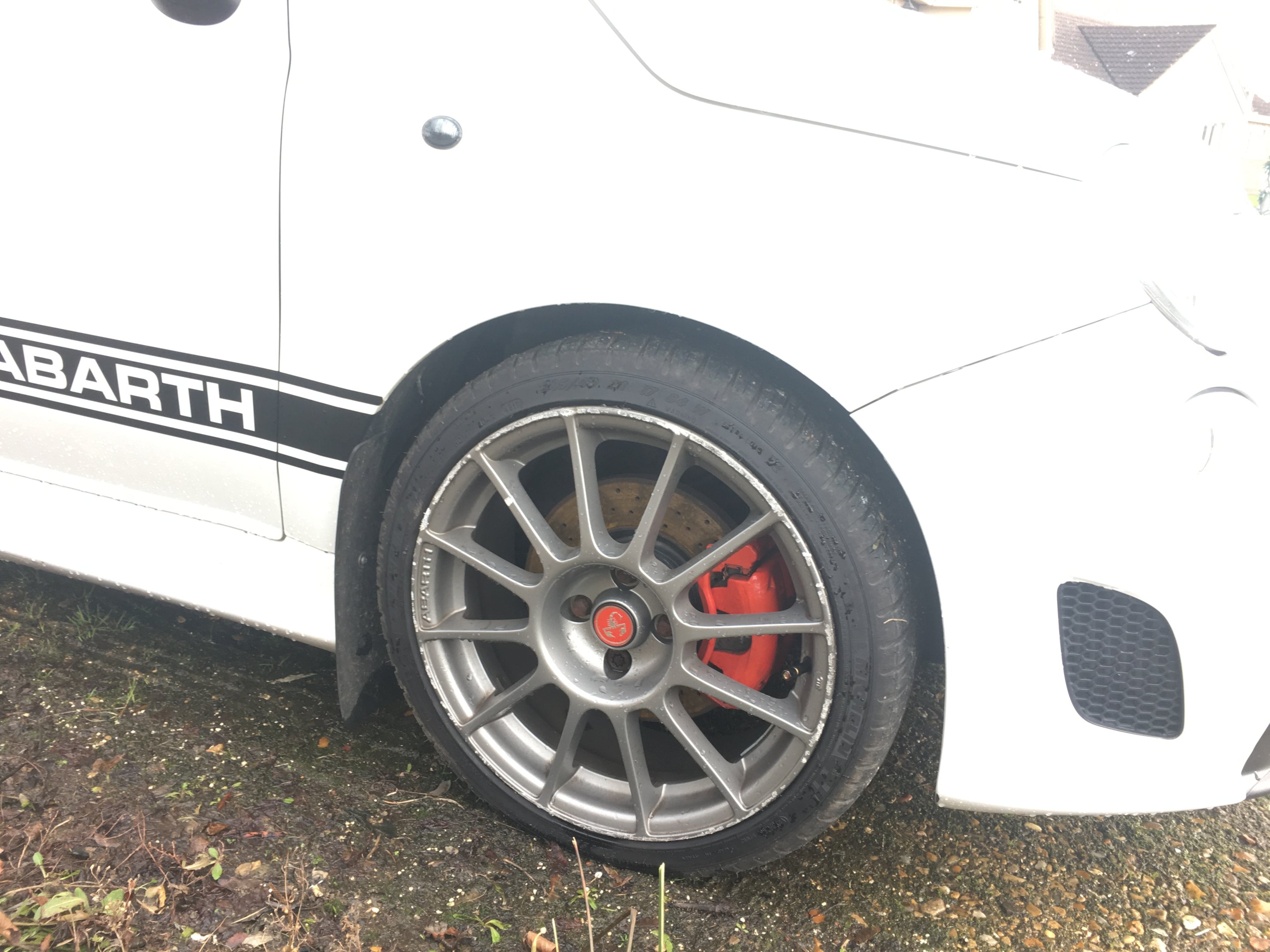

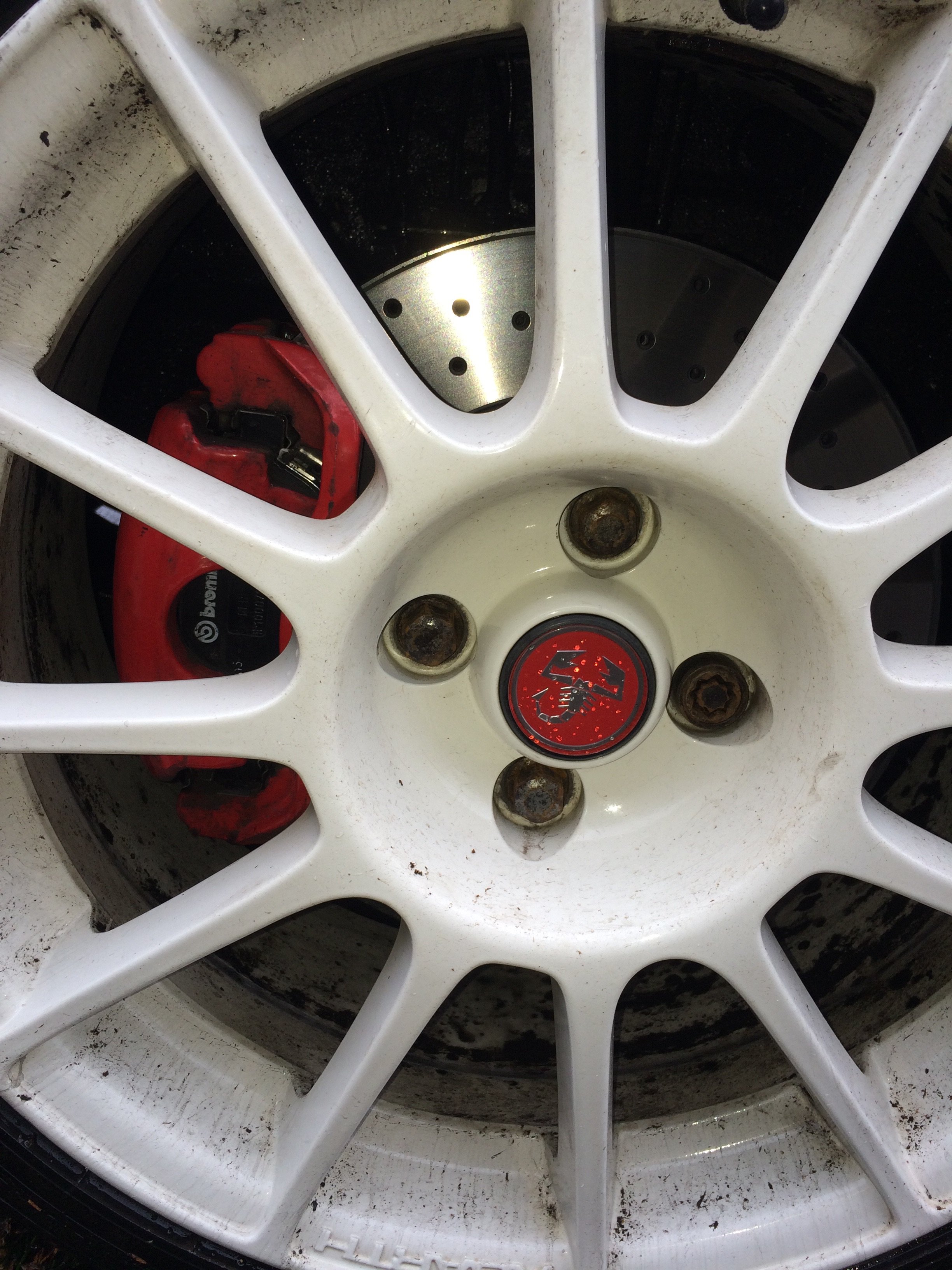

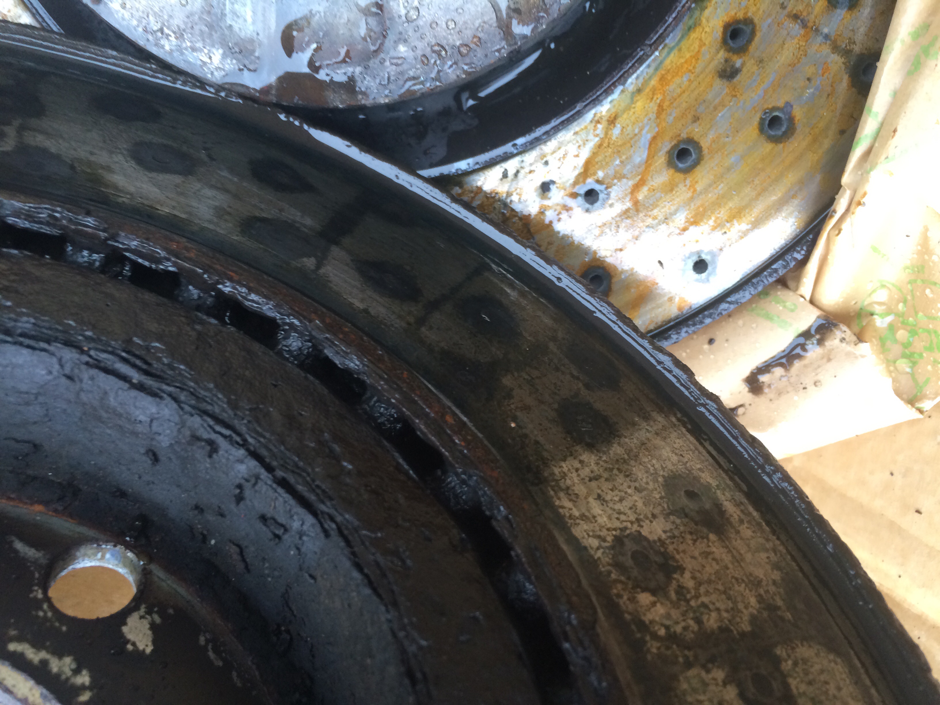

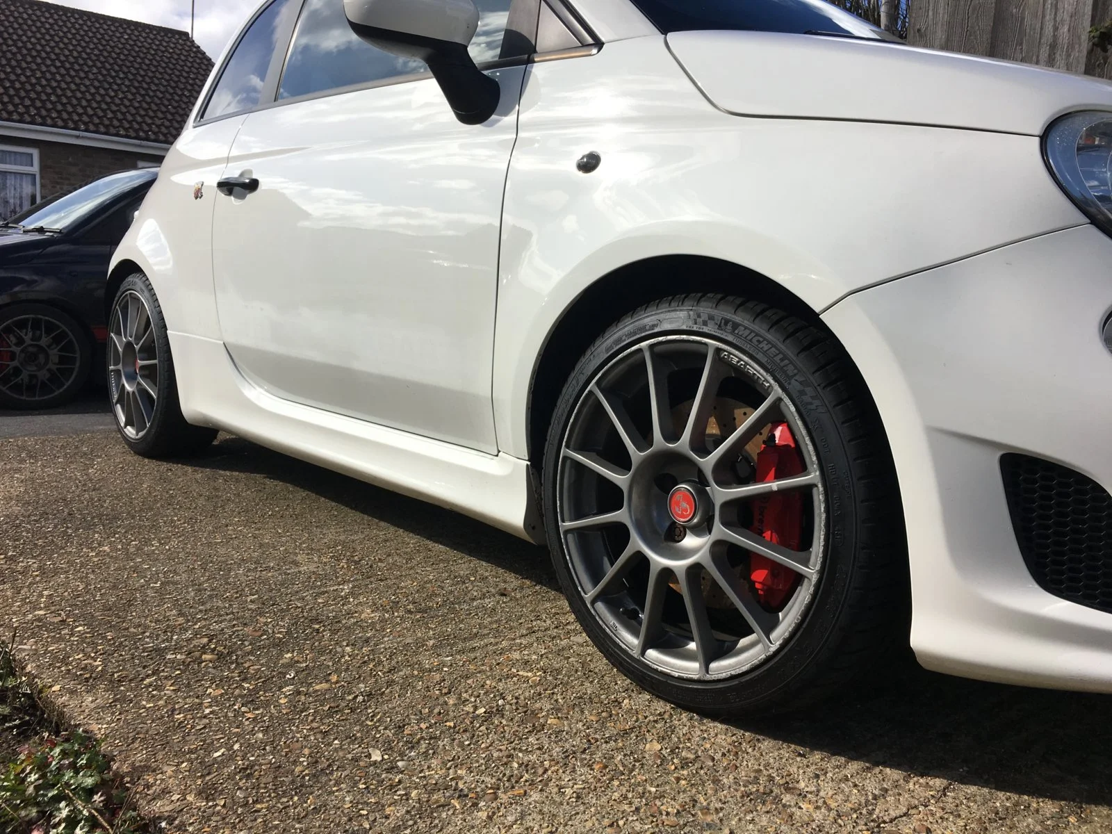

Fitted new brakes all round last week and have done 500 miles to bed them in since, much better than the old ones!
And the new brakes, fitted in the pouring rain!

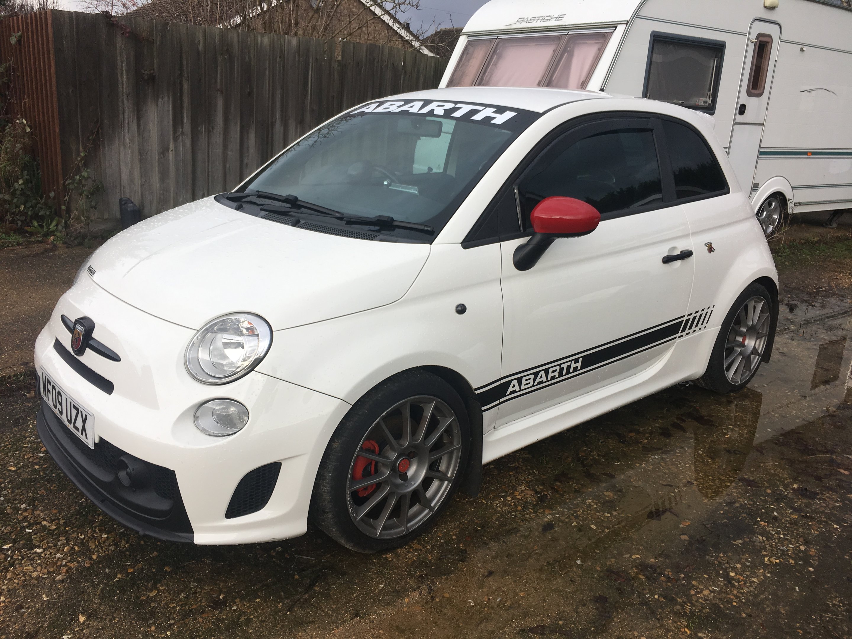

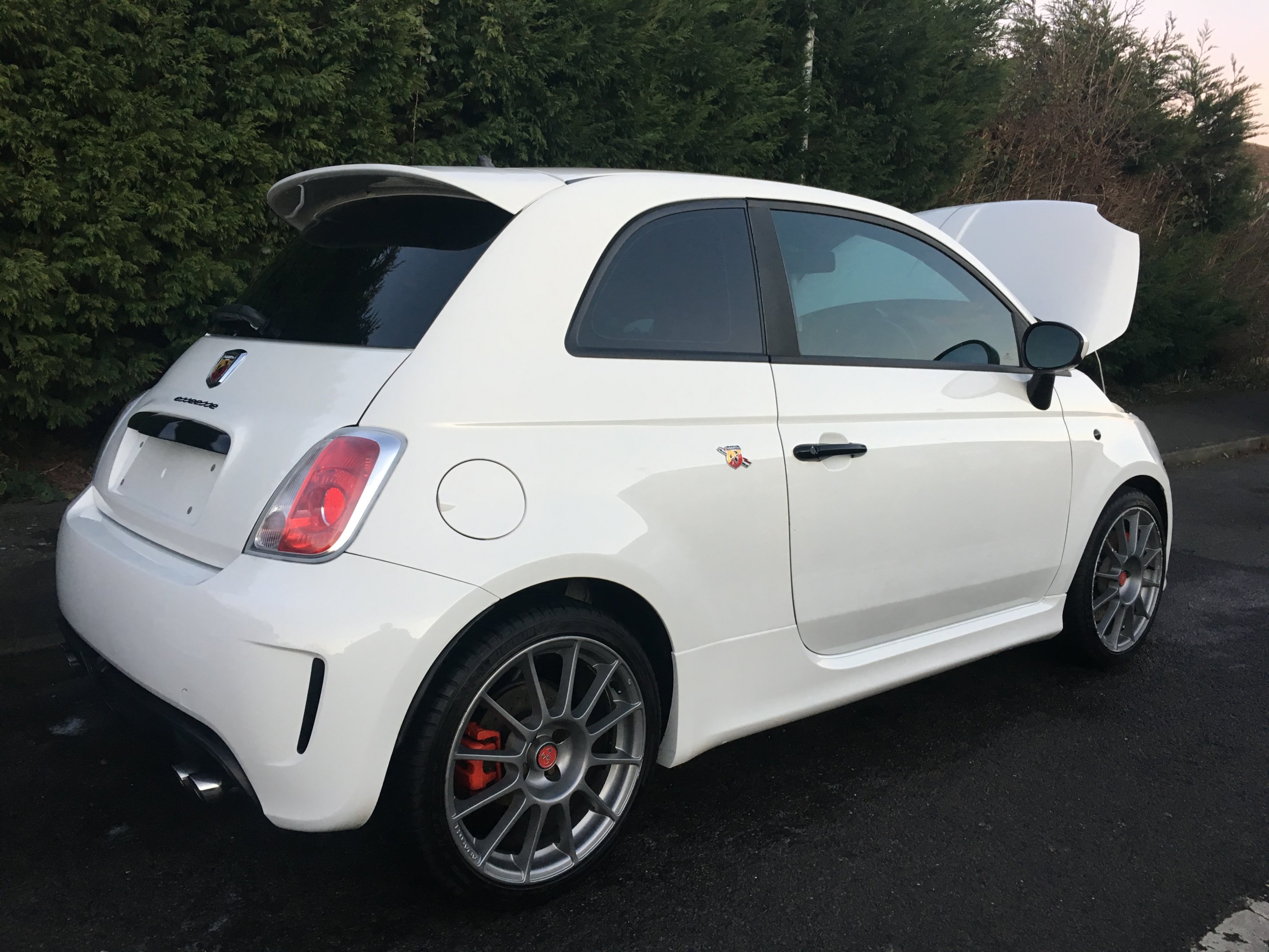

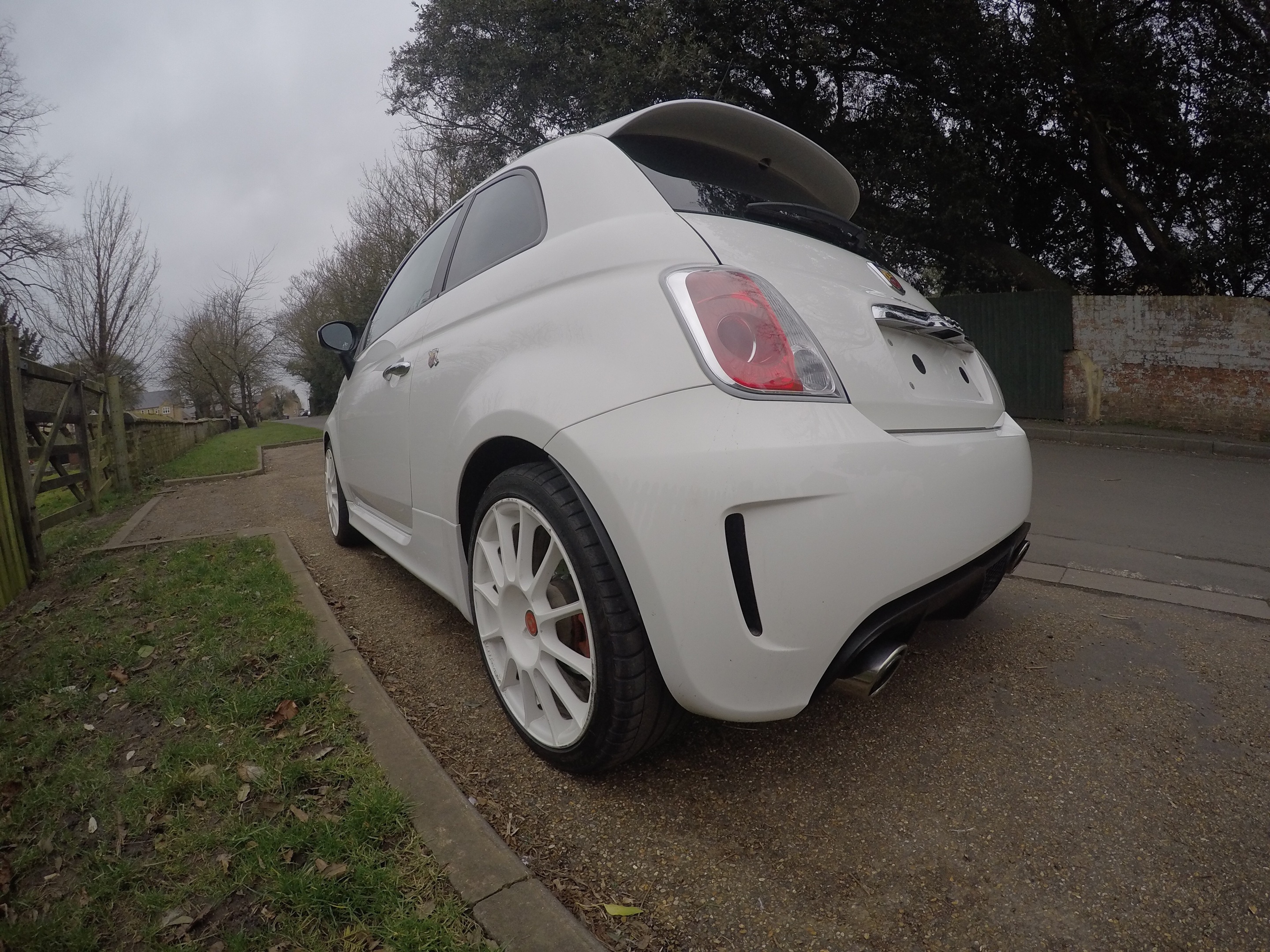

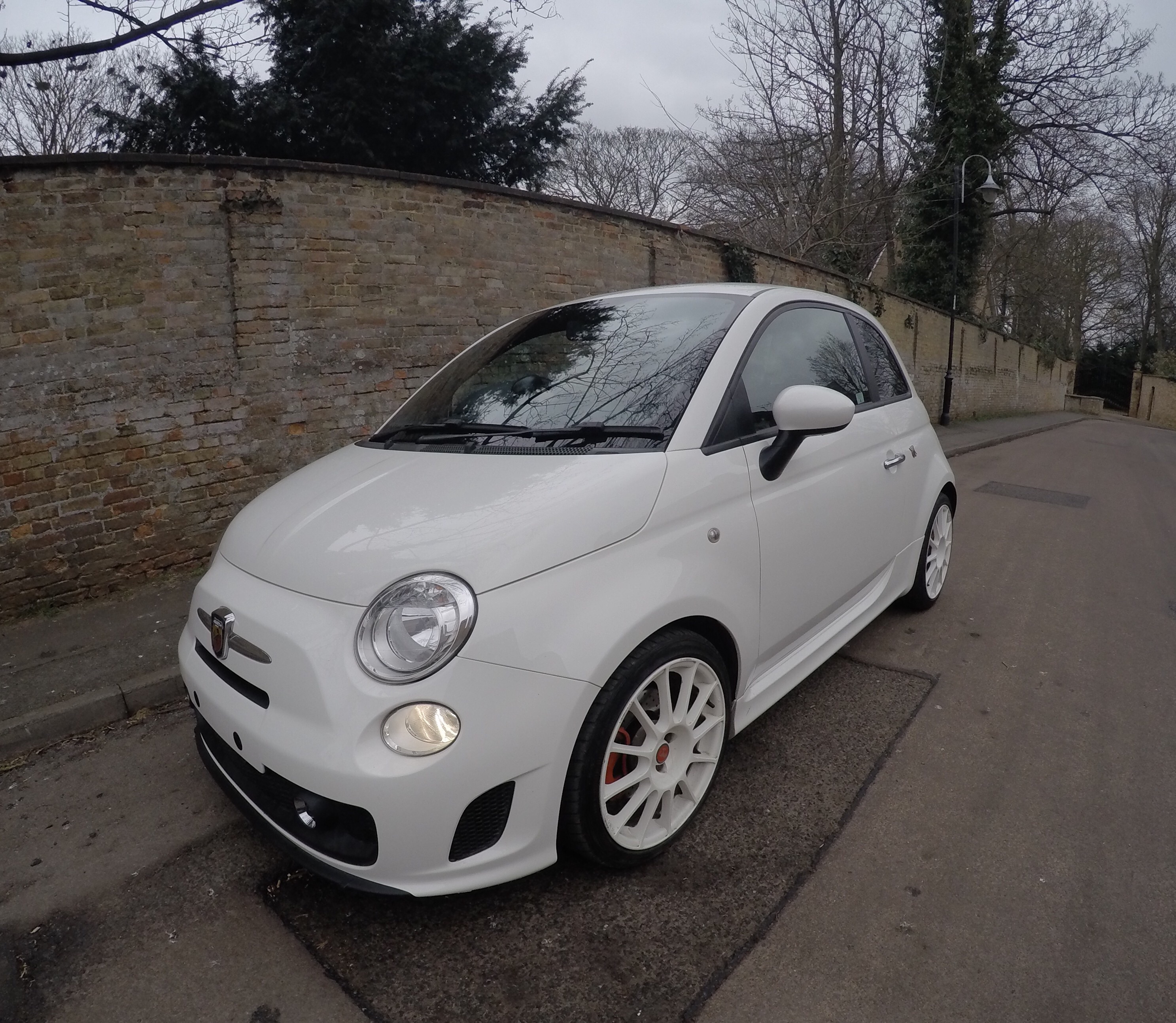

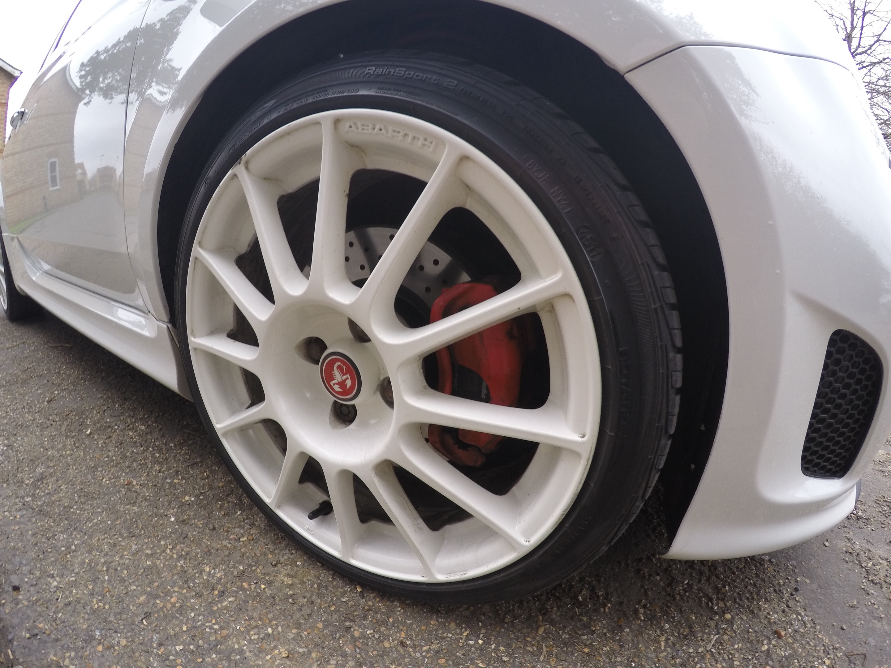

Got around to giving it a clean.
Comments welcome!
You'll never get much interest advertising it on the 6th Jan !! March - September is the time to sell cars IMO.
Anyway, looks great, can imagine keeping those alloys clean is impossible.
That's true, I didnt advertise it properly either.
Oh I'm glad winter is behind us, that's for sure. White alloys I'll never do again!

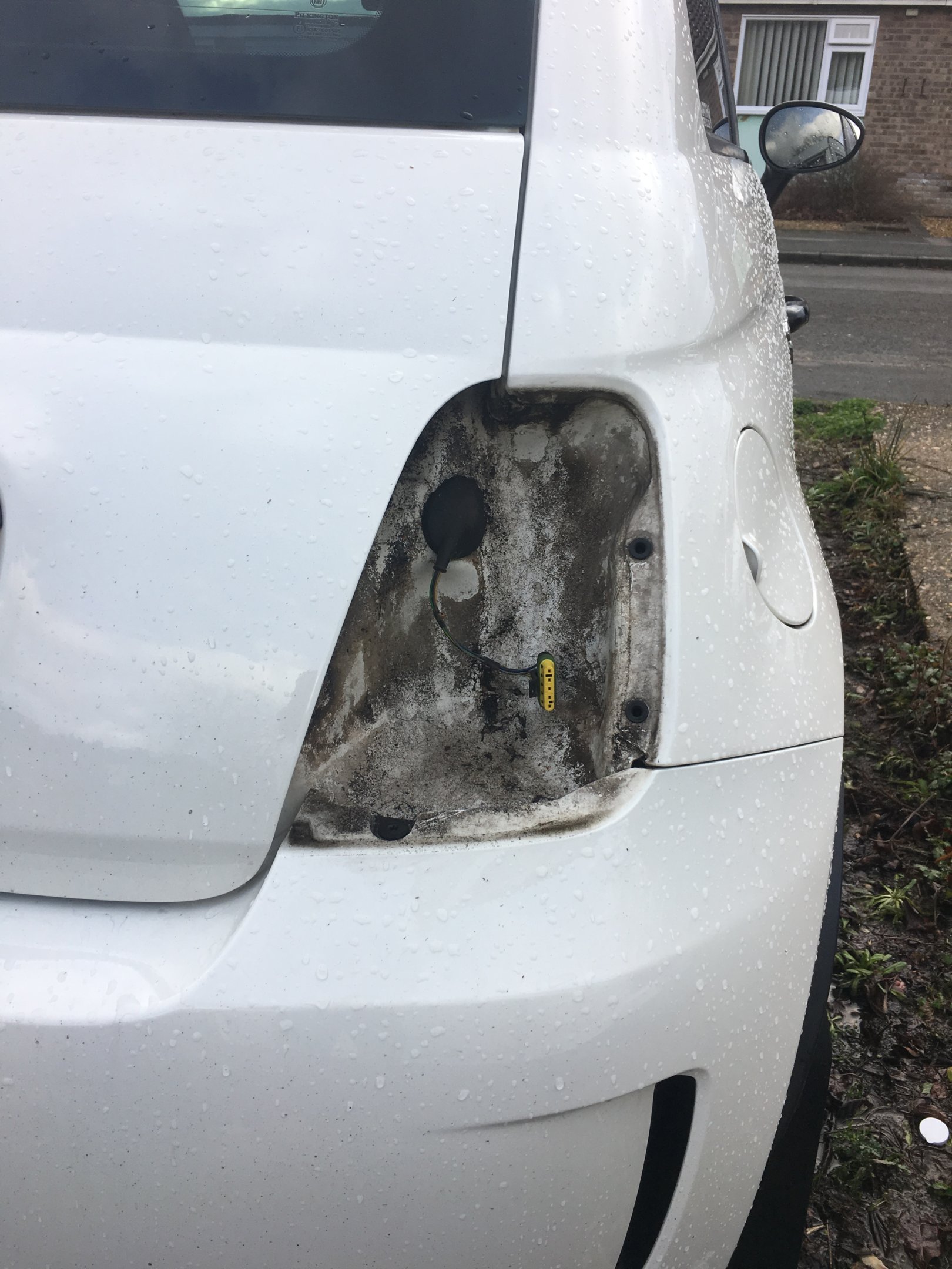

I spent hours sanding down the ruined lights, must have had 10 layers of lights tints!

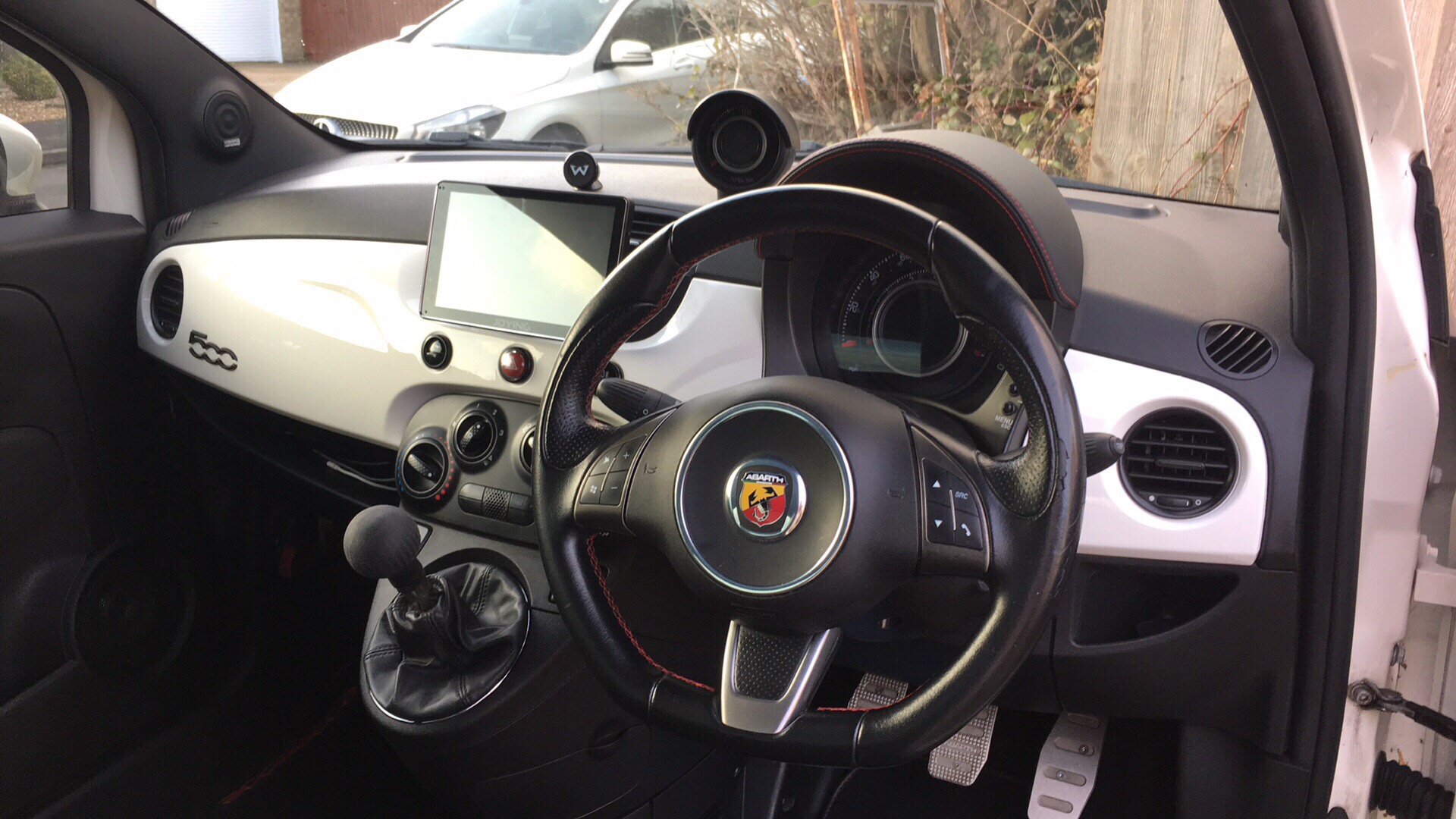

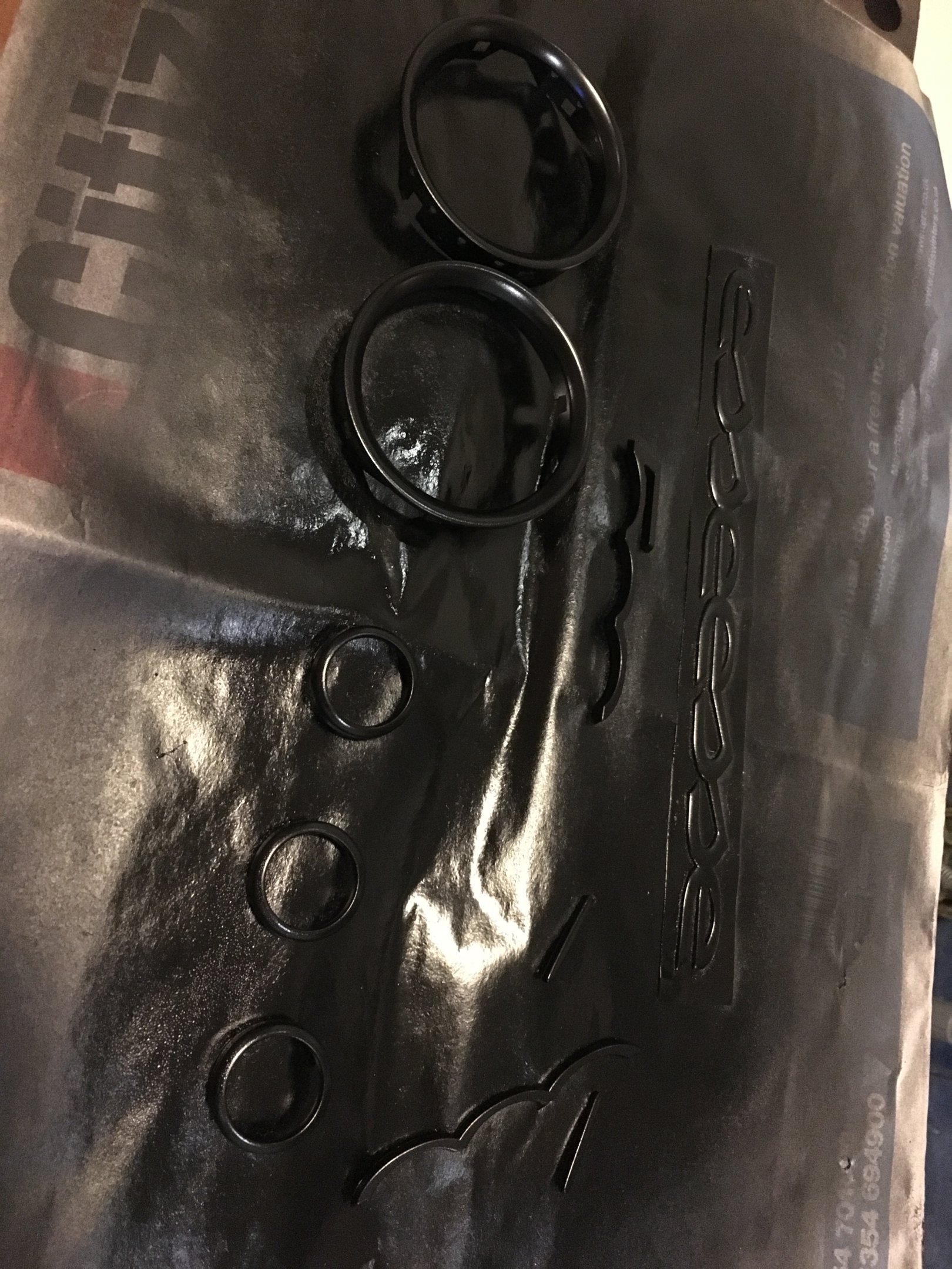

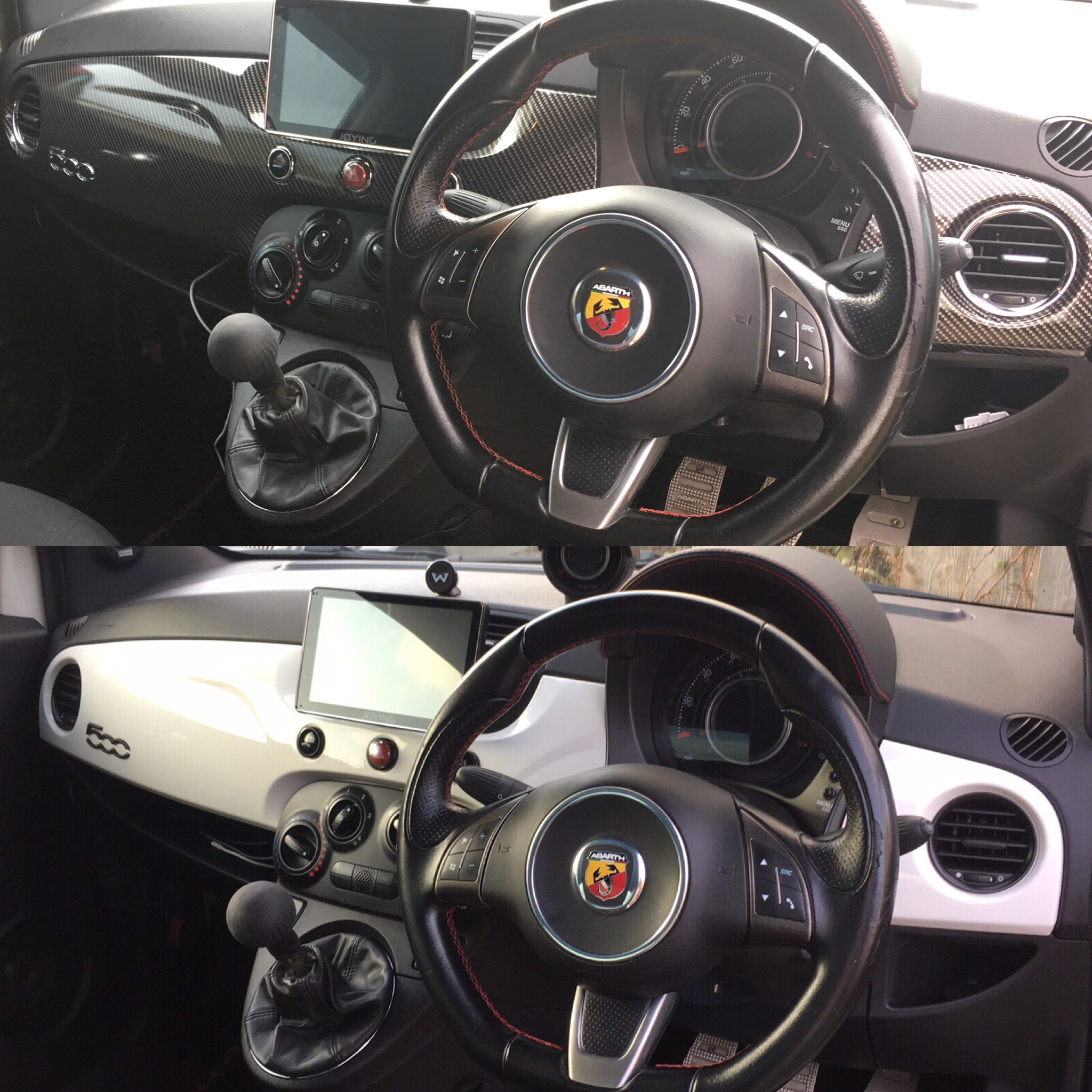

The carbon fibre dipped dash wasn't my cup of tea so that needed to go. I thought a nice touch of satin black would go well on the interior so I sprayed some surrounds up and my rear Esseesse badge
And all fitted it looks a little like this..

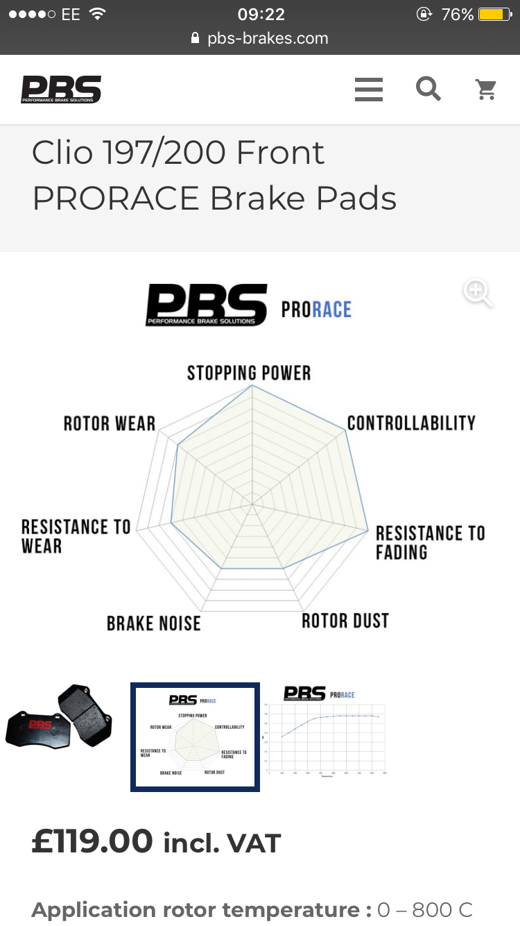

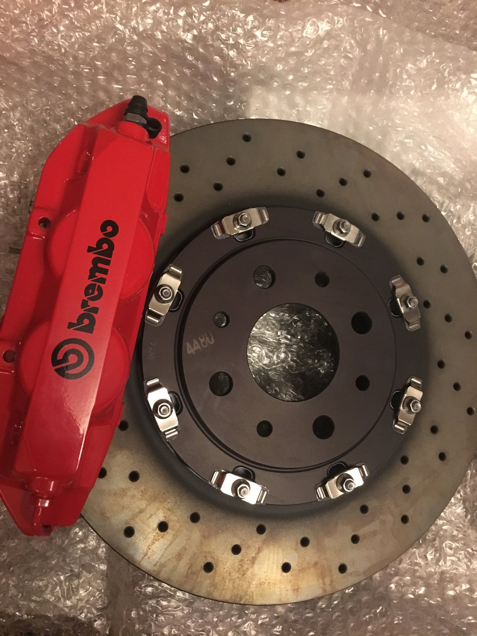

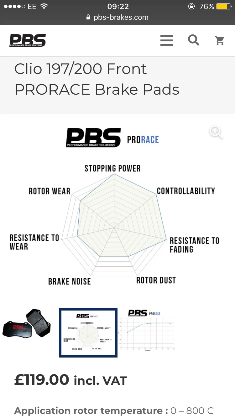

A brand new Brembo calipers and fully floating Brembo discs, with braided hoses and some PBS brake pads (heard some good things about these so thought I'd try them!)

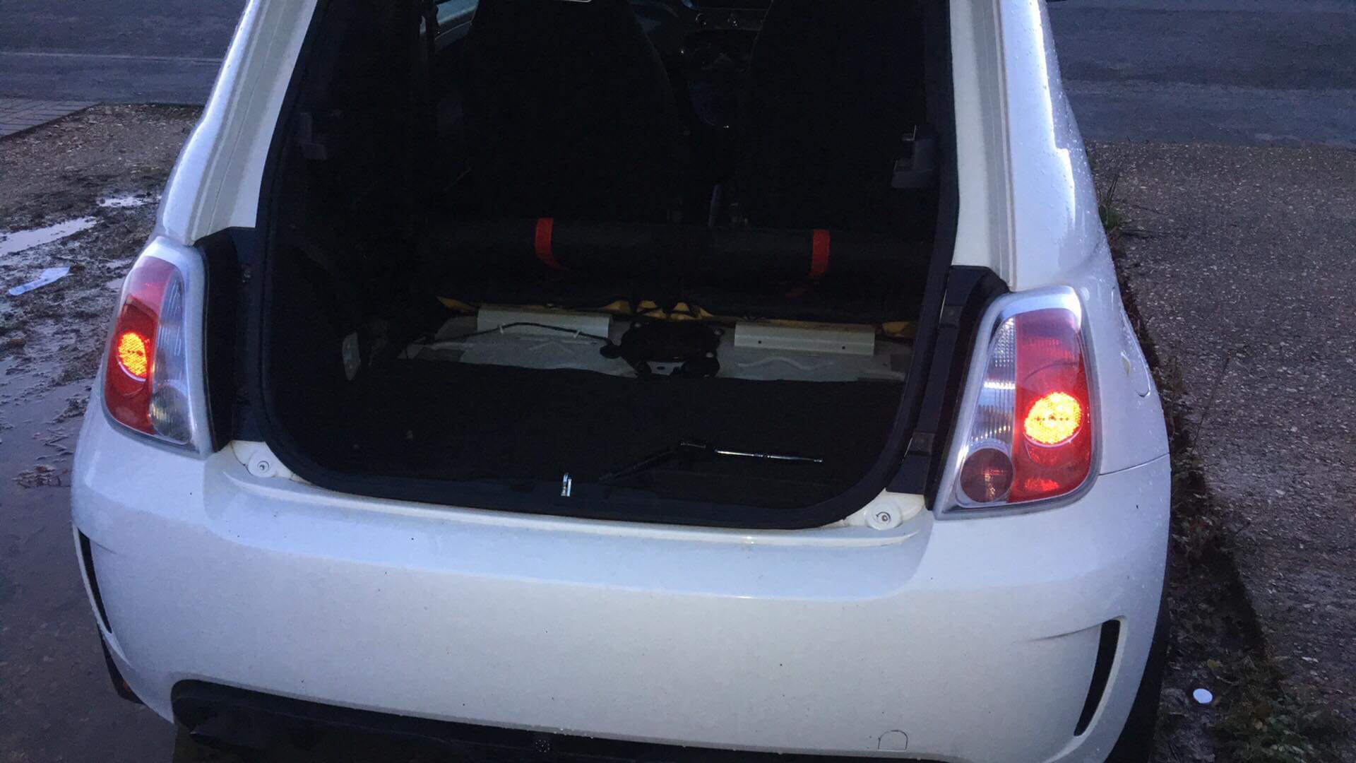

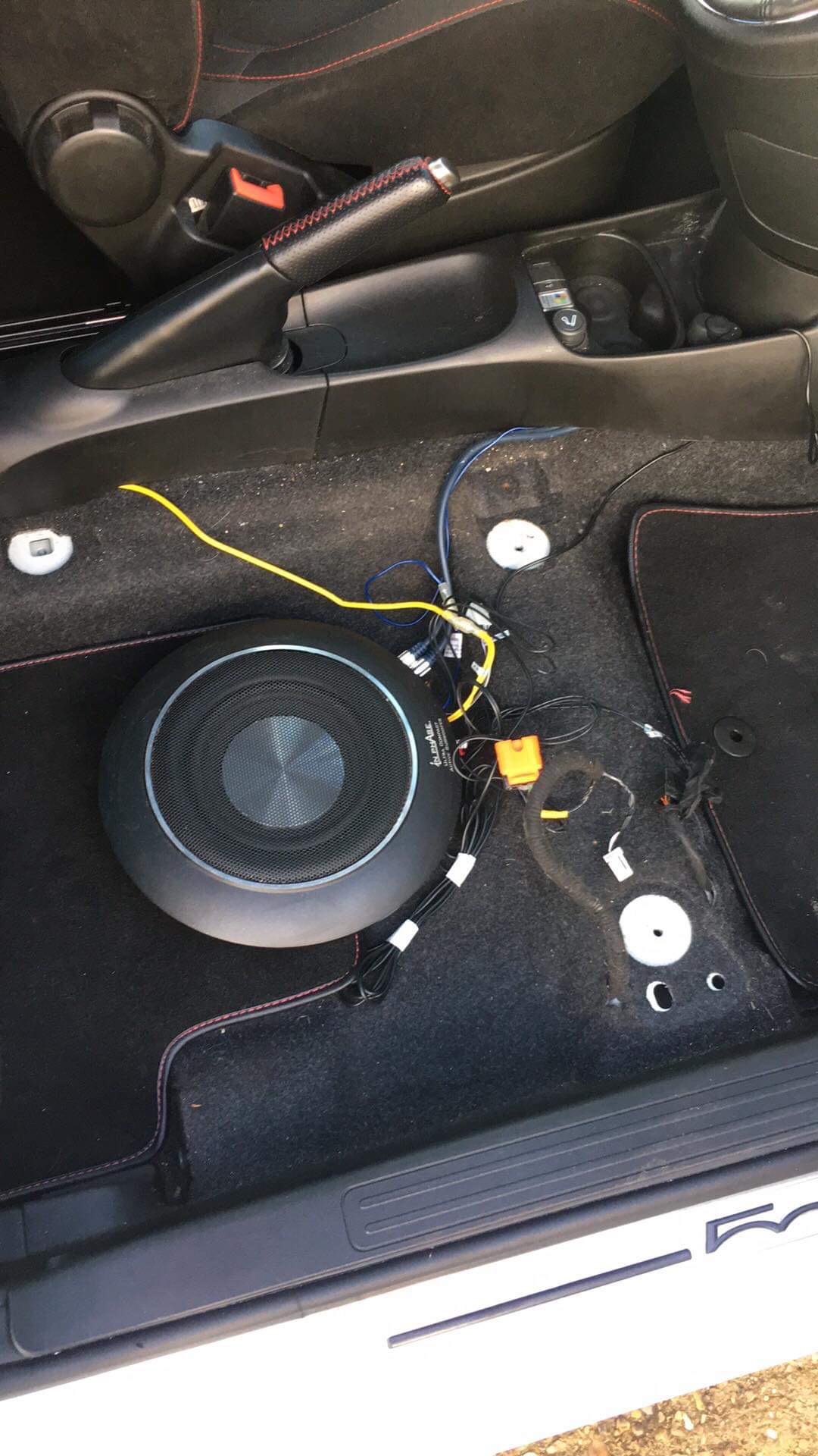

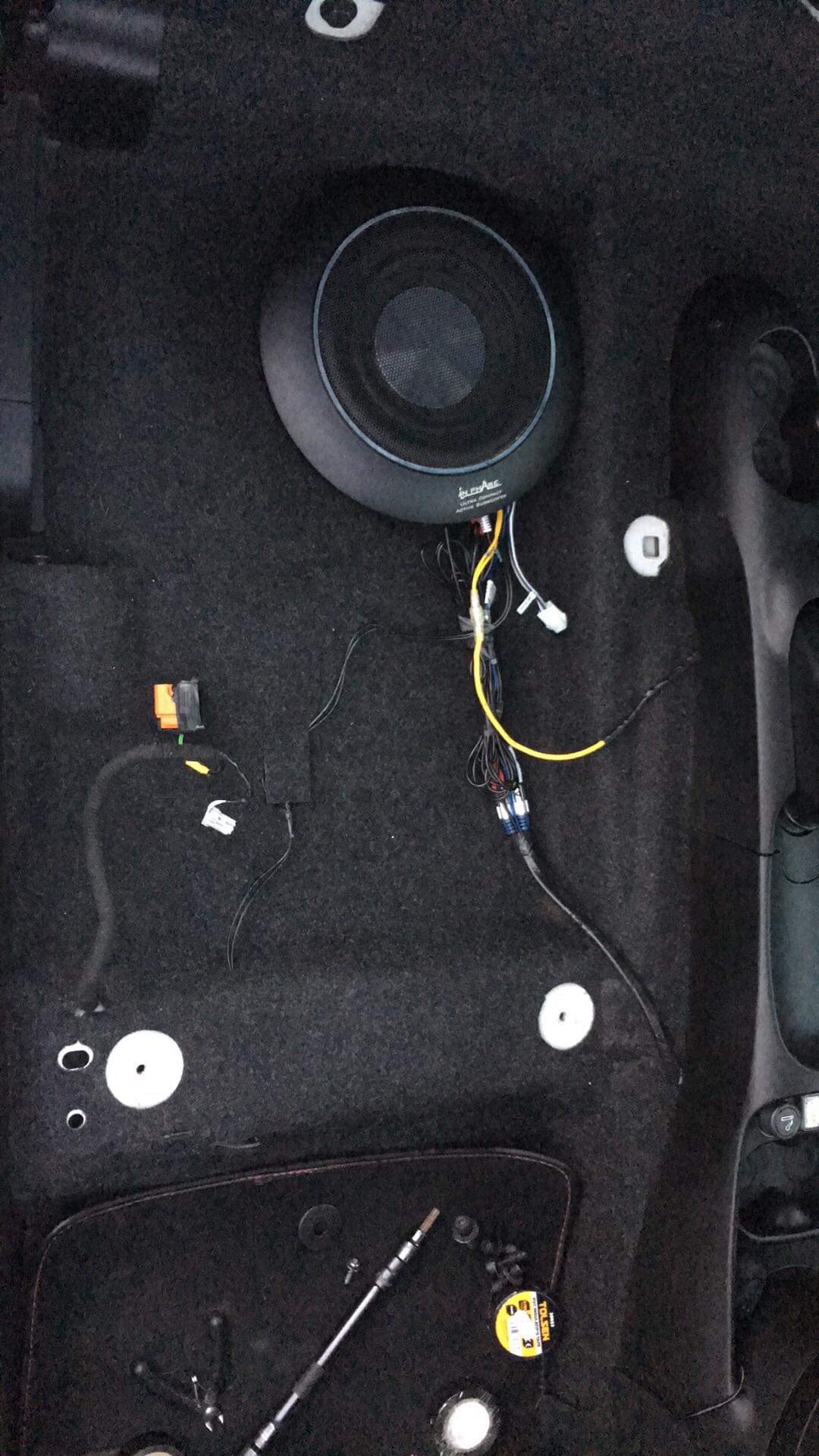

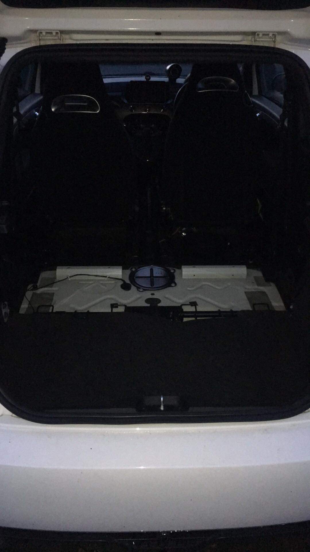

I decided to rip out the entire interior of the car and sort out some wiring for the subwoofer as it looks like a wasps nest.
Before;
After;
Thinking about which direction this car should go in, I kept the interior out

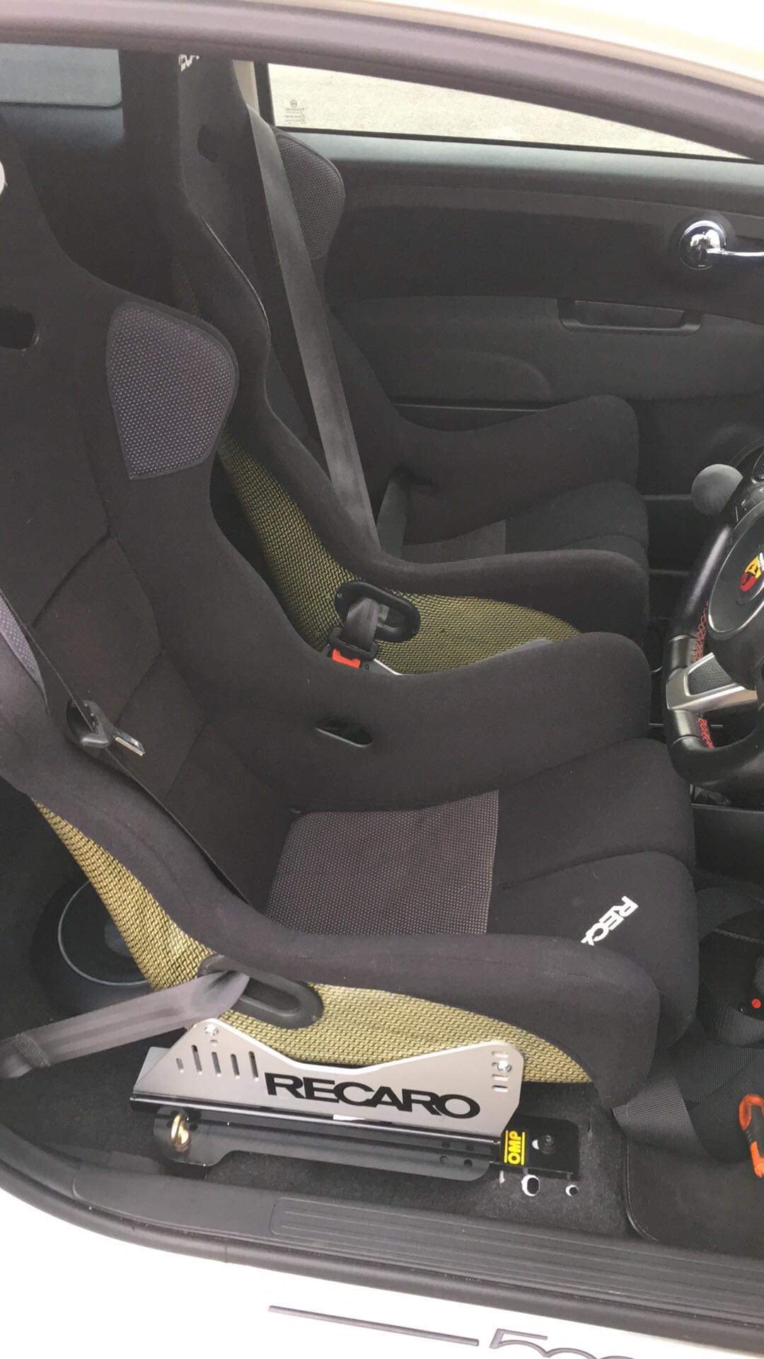

I then messed about with some OMP floor mount adaptors and fitted my seats from my M3 along with standard seatbelt receptacles, anti sub eyelets for my Schroth harnesses..
I've also changed the wing mirrors from red to white, updated all the halogen headlights to 150% Philips bulbs in the hopes that they're not candles in the dark.
The seats have absolutely transformed the poor seating position in this car, completely over kill but they still look fantastic I think.

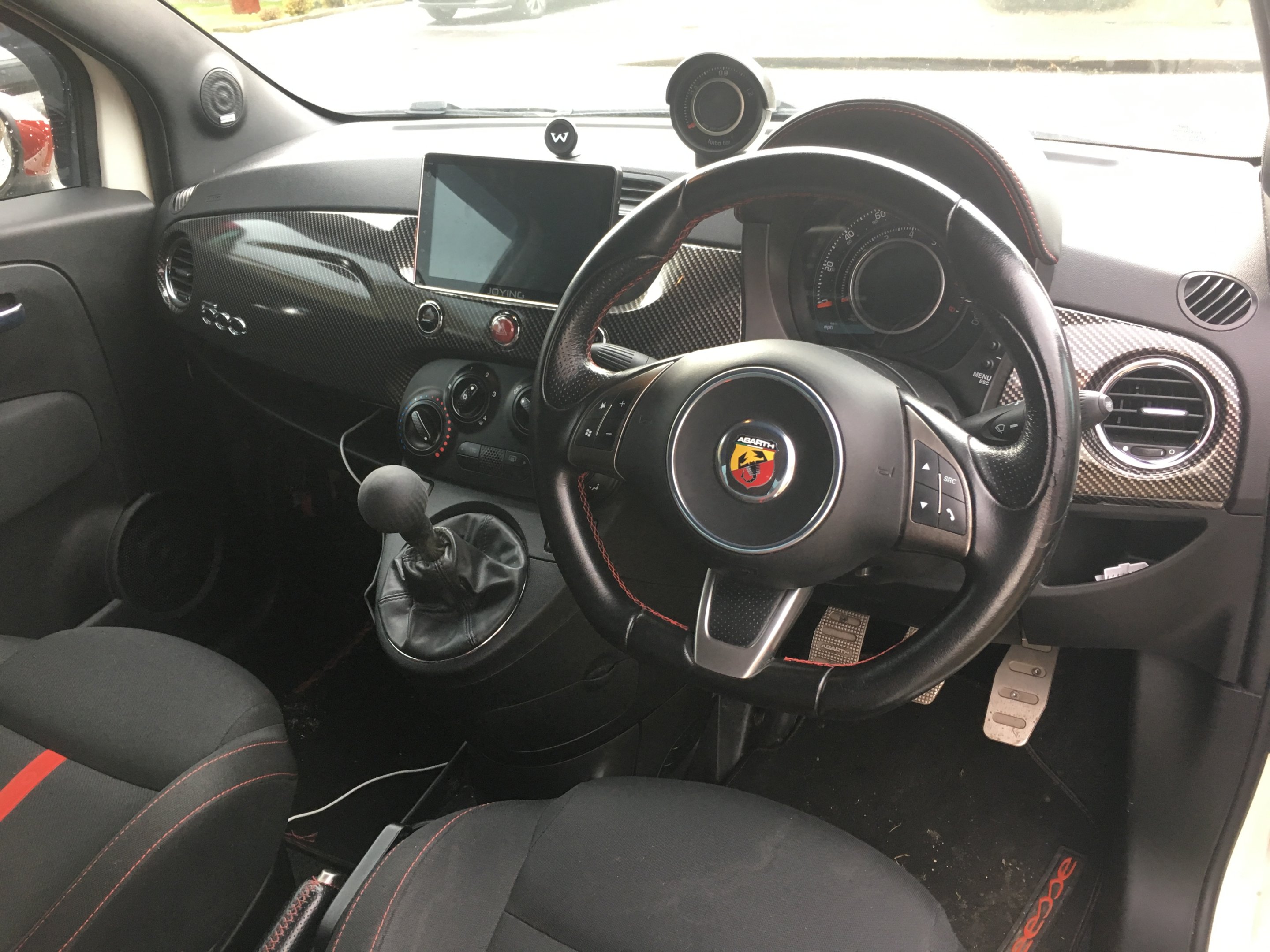

Direct comparison of dashes, before and after.. feel as though I should do something about the steering wheel.
White just looks like it's a 1.0 inside. The carbon didn't look that bad as it wasnt that matte carbon wrap shite
Sent from my SM-G965F using Tapatalk
The carbon was dipped and I couldnt hack looking at it, I have everything to do a carbon dash with proper carbon if I find time!
I'm not a fan of carbon at all and I thi k its tacky as f**k, however, that white dash just doesn't cut it for me[emoji29]

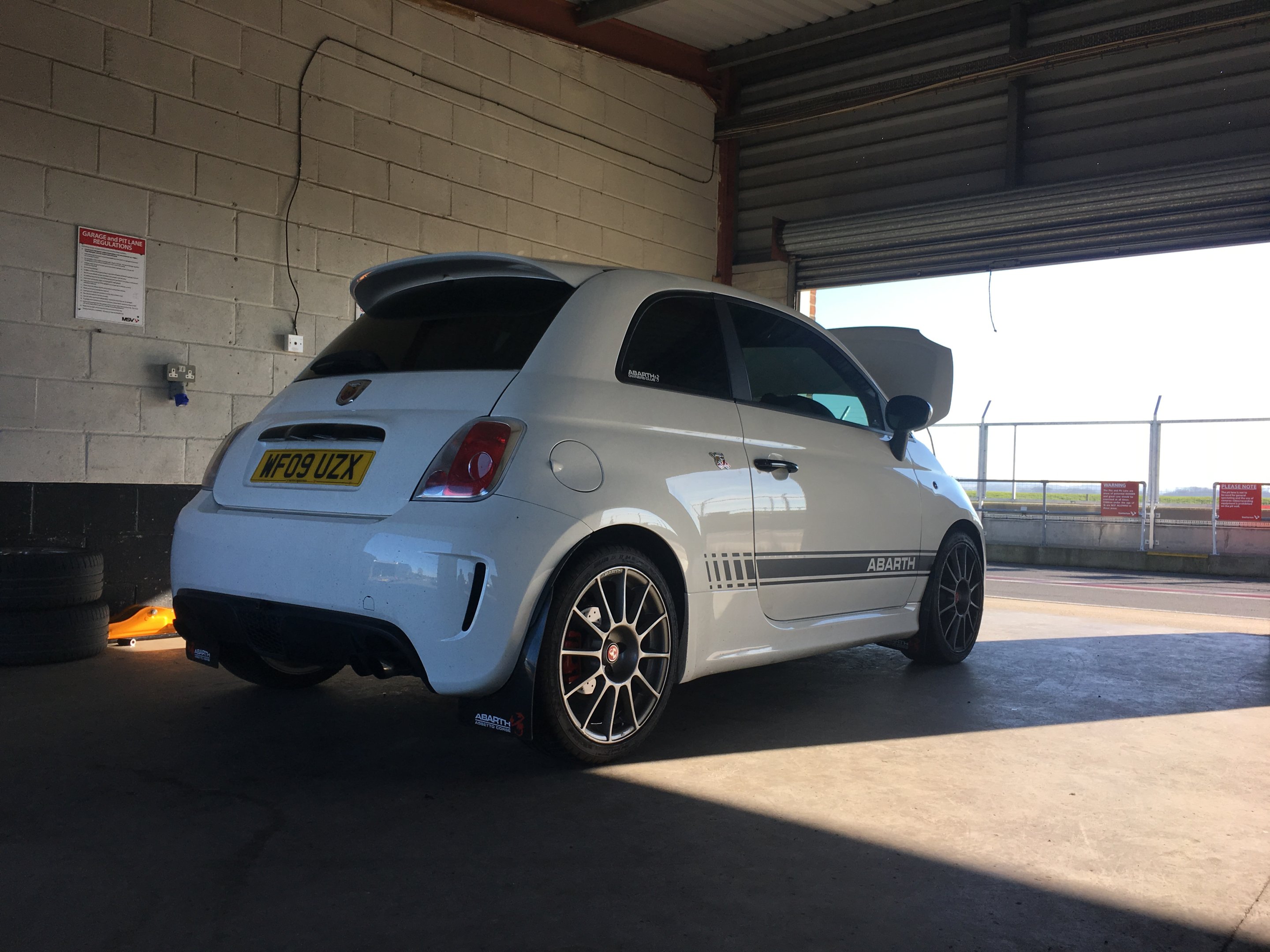

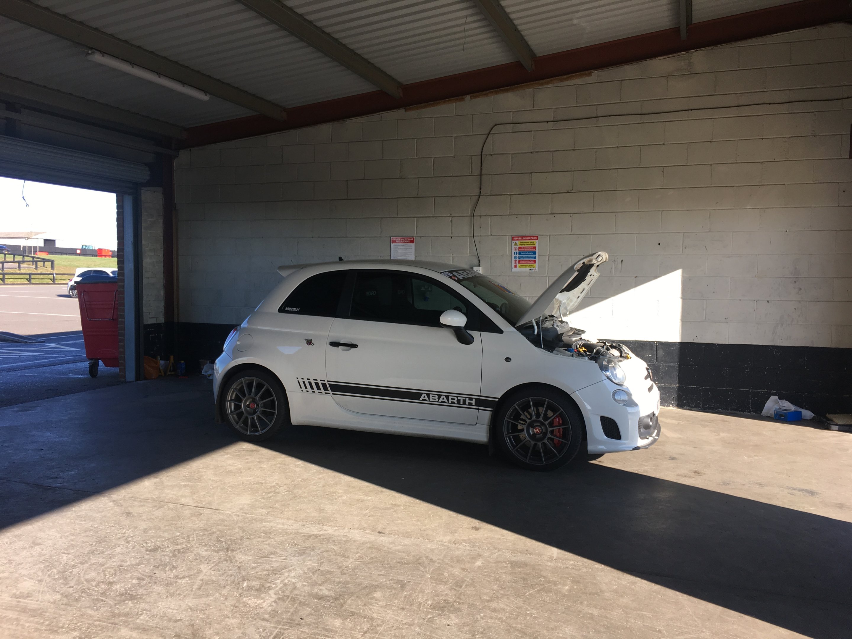

Today it filled in for the M3 on a trackday
Trackday went well, it held its own on Michelin Pilot Sport 3 tyres. I have some Direzzas Dz03G semi slicks to go on but the bushes are too perished to put that sort of load through them.
Ended up taking off the mud flaps as they kept catching..
I also chewed up a passengers side driveshaft so I'll get one of those sorted along with a list of powerflex bushes that I need!

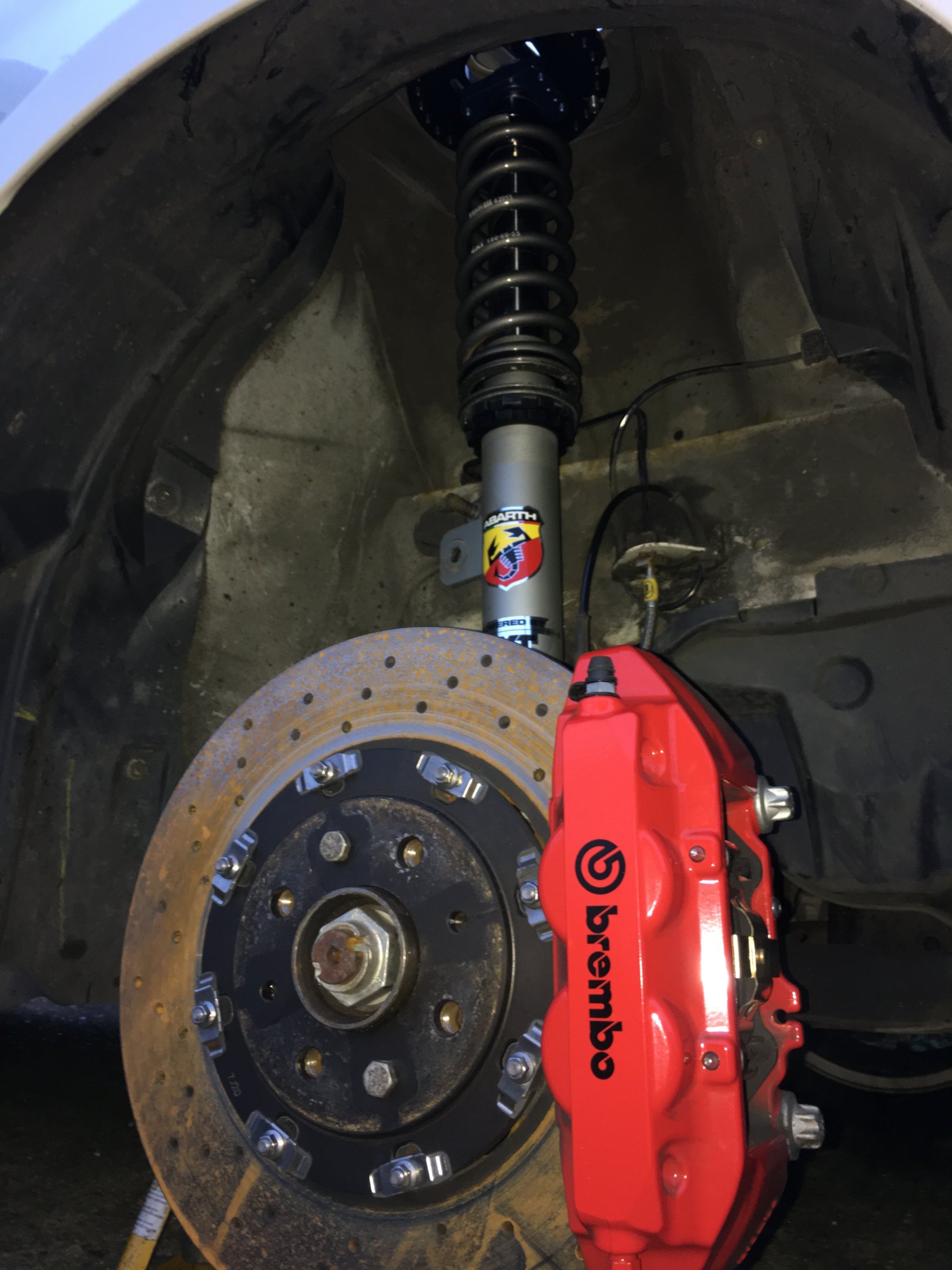

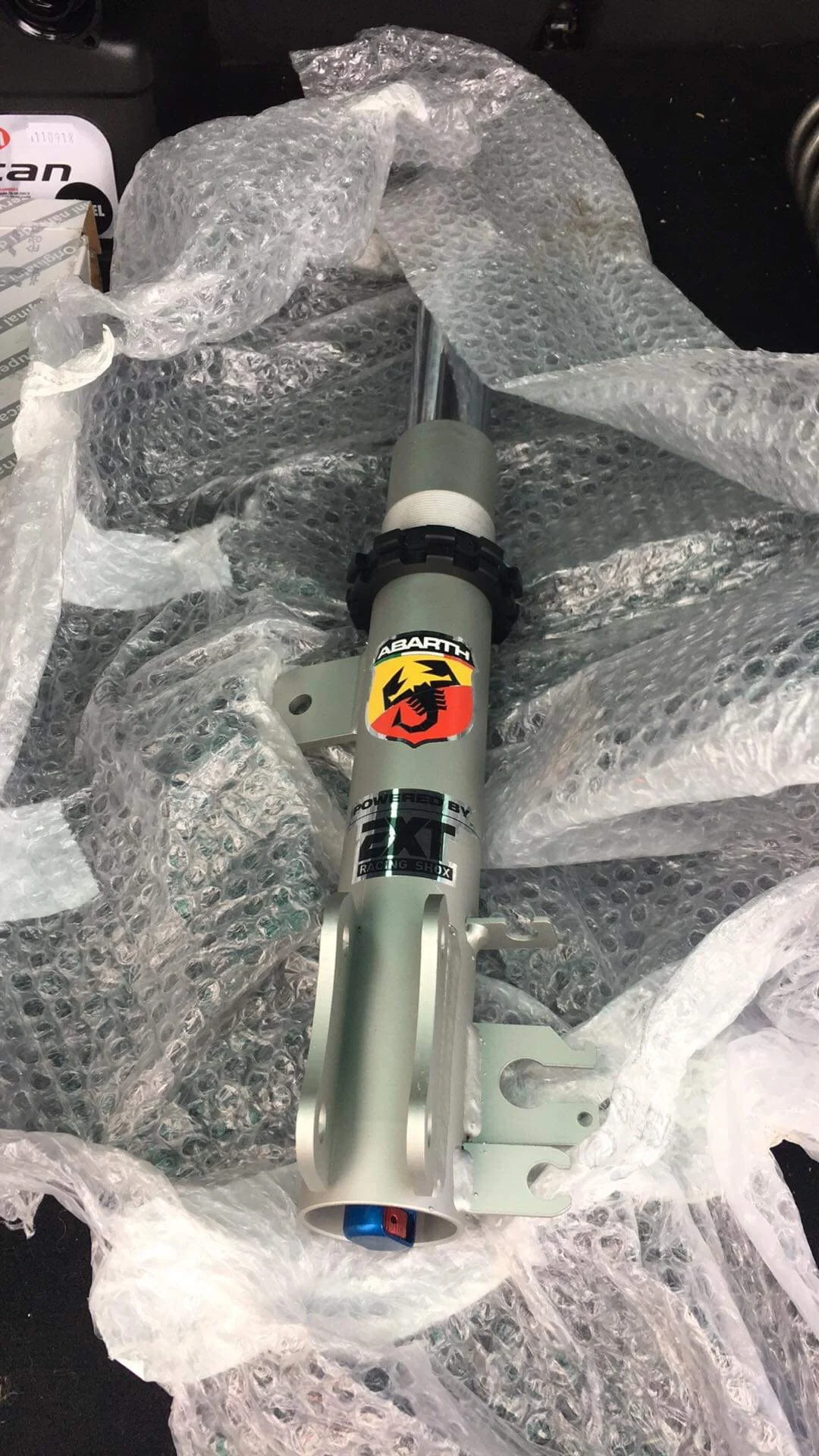

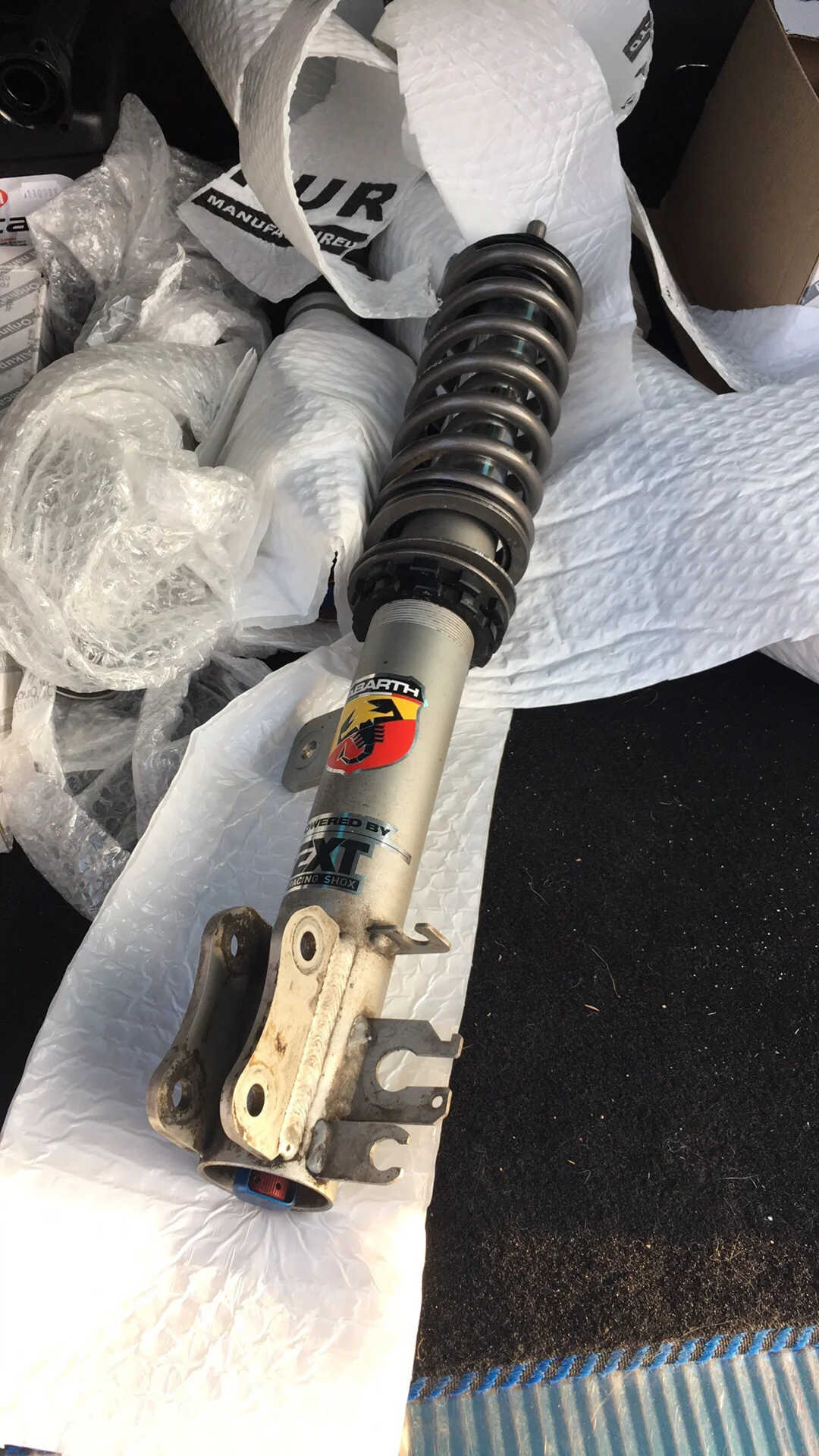

Somehow I managed to bag these Abarth Biposto dampers for the front and rear. Think the RRP is about £2500 or something daft. Ended up driving 9 1/2 hour round trip to the dark depths of Bristol today.
2 dampers on 3,000 miles and two brand new along with rears and all springs. Just got to sort out solid top mounts and they'll be going on!

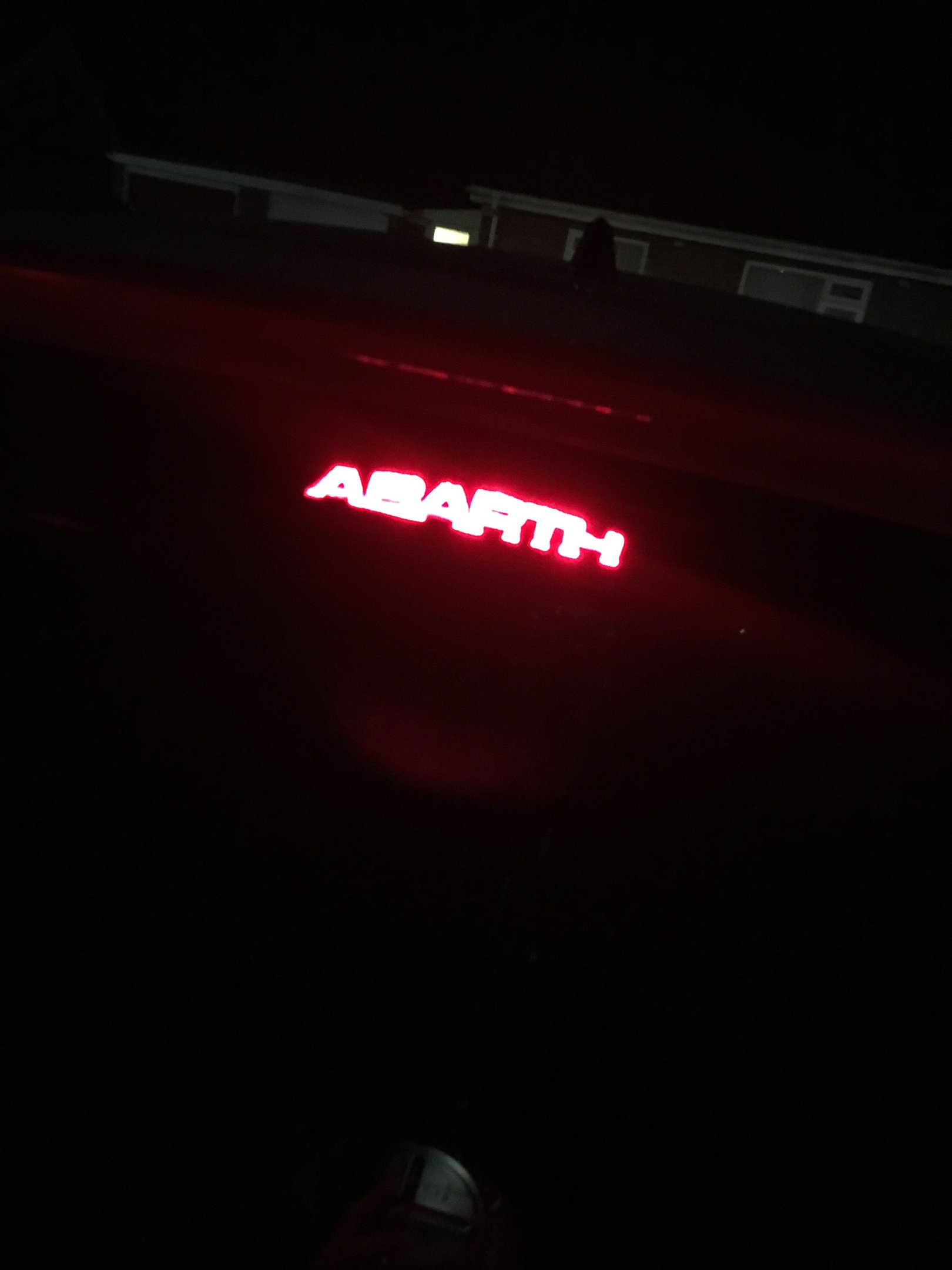

I removed the Sun strip, side strips and put on the Esseesse rear badge.
Can't wait to get the coilovers on with the powerflex bushes everywhere.
Some fresh plates made up and a colour coded sunstrip

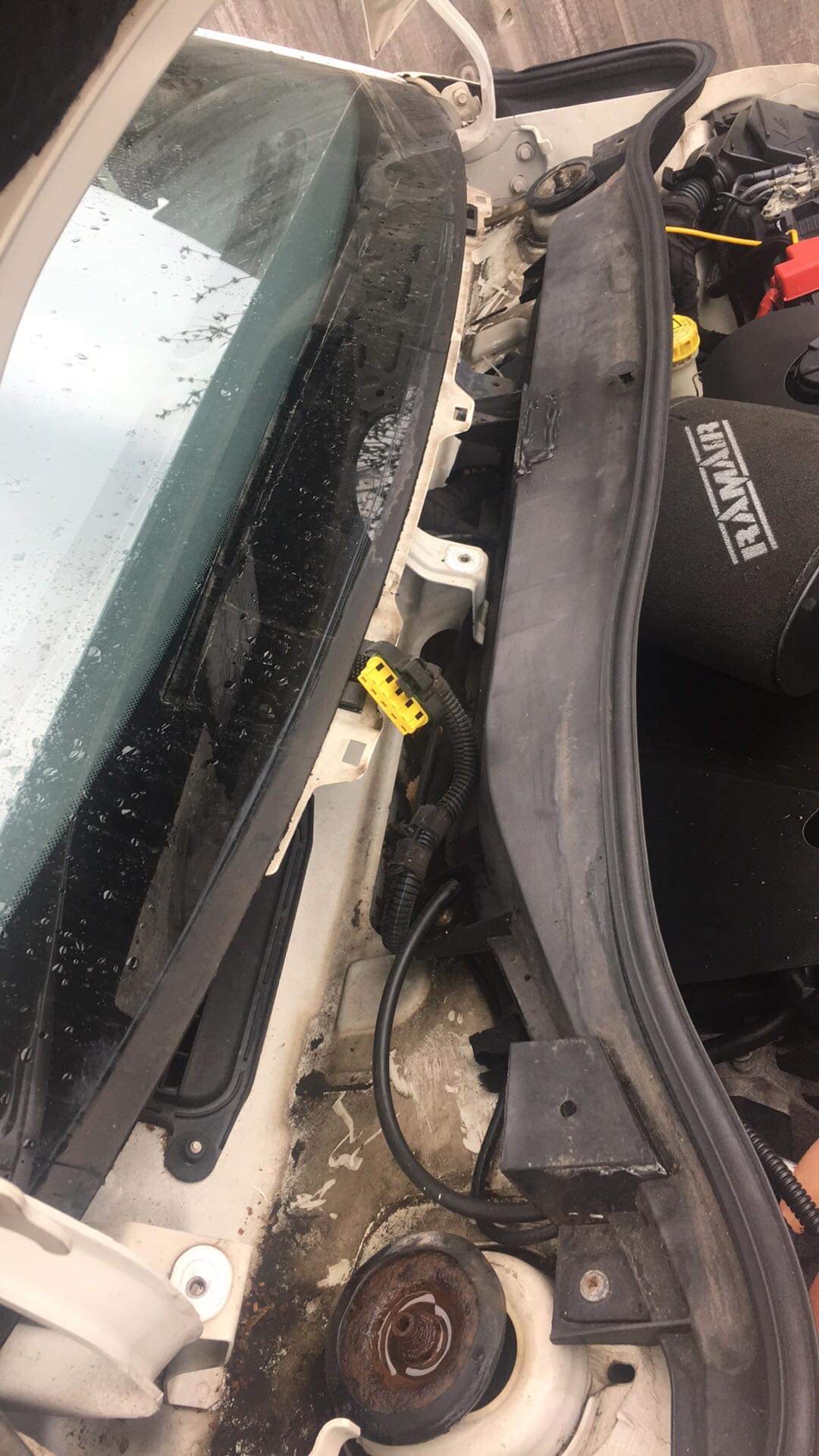

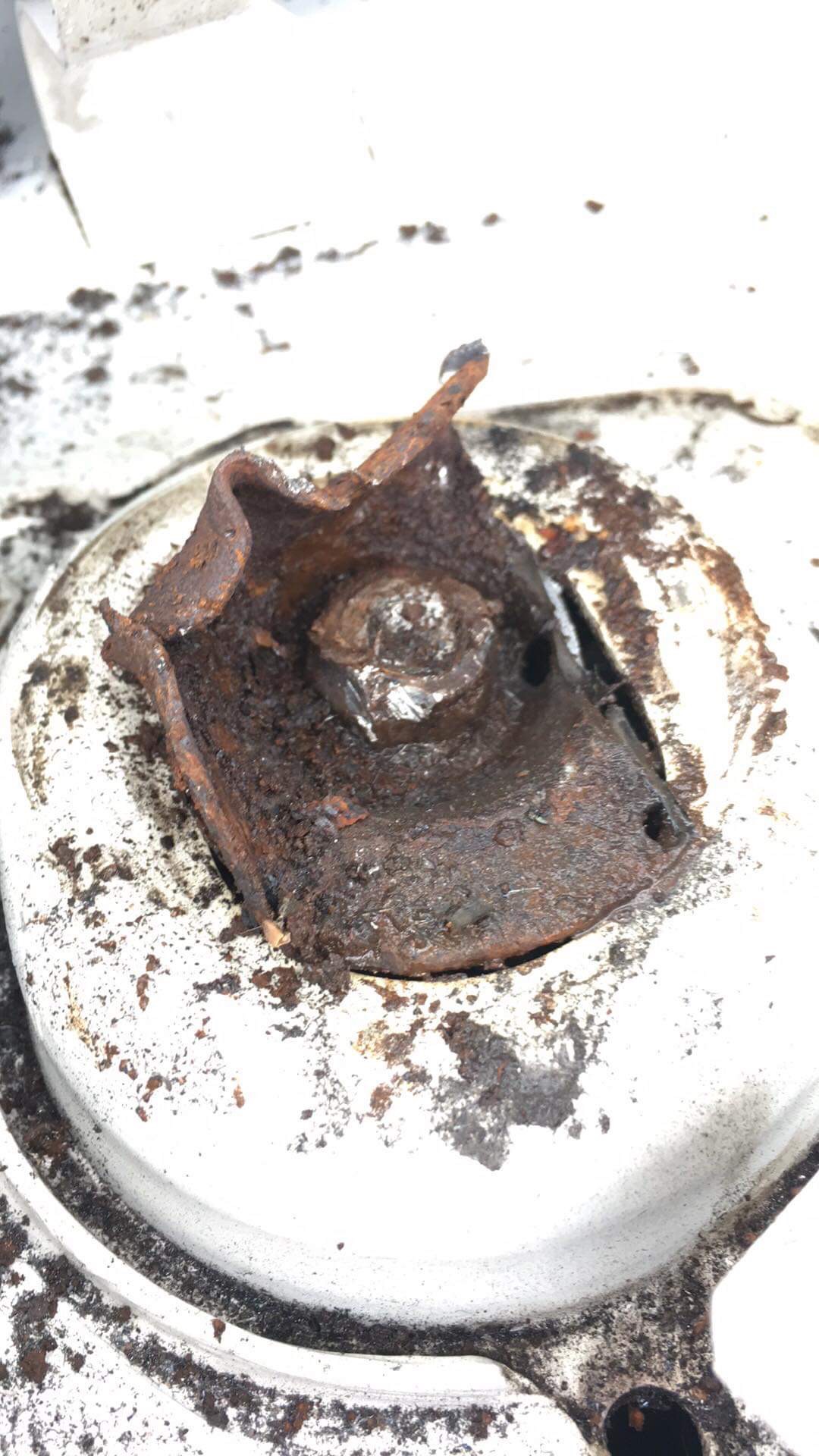

Fitting the front top mounts I was welcolmed by this mess..
1408642
These top mounts were originals and sheered into pieces so the angle grinder came out.
1408643
The new top mounts don't fit correctly so I've sent them back and awaiting revisions to be made.

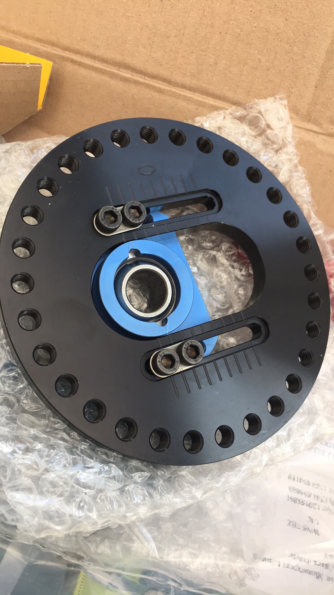

New camber adjustable top mounts have arrived, good quality. Pretty cheap and will allow the adjustment that I want and need.

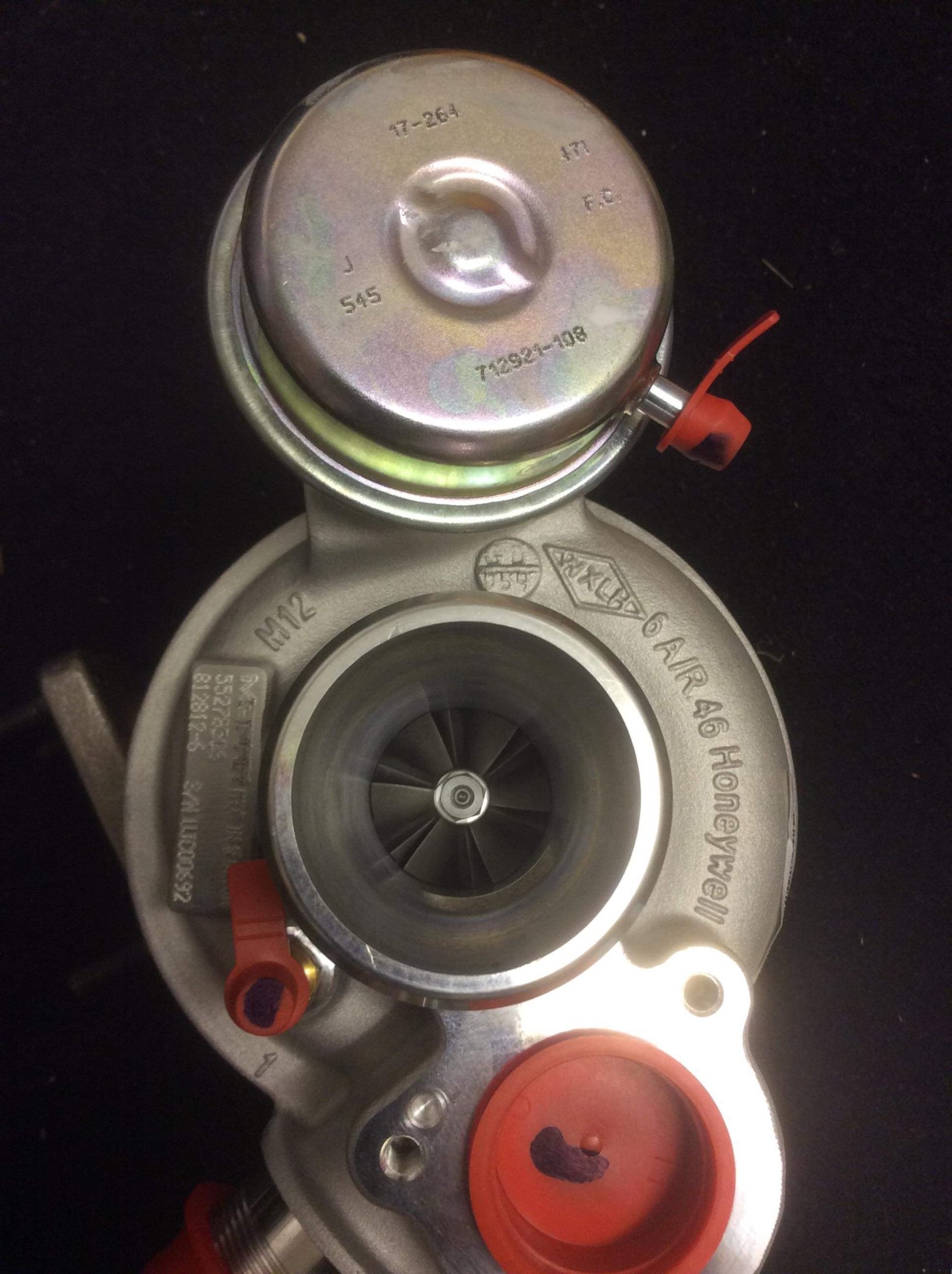

May have also bought a brand new bigger turbo, sensors, oil feed and manifold.. with a FMIC and injectors from a 599GTO I SHOULD get about 230/240hp and cap the ft lbs to 280/290.

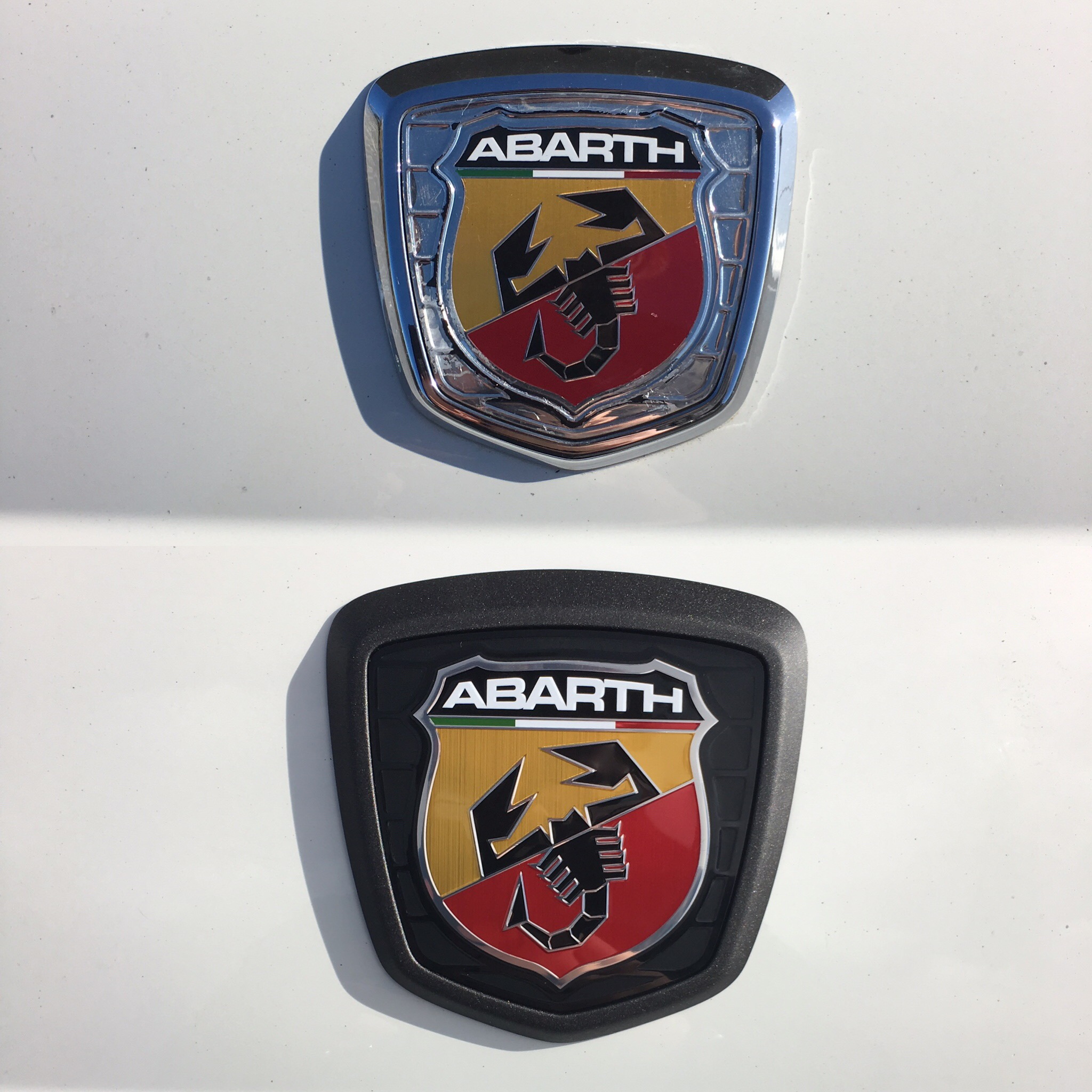

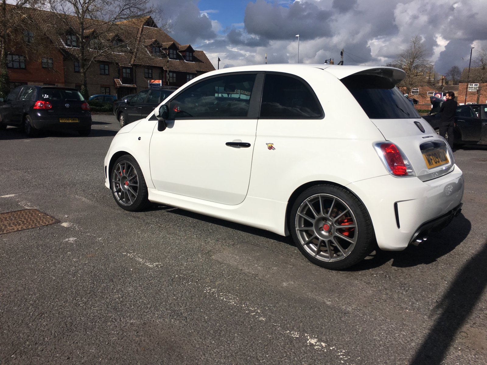

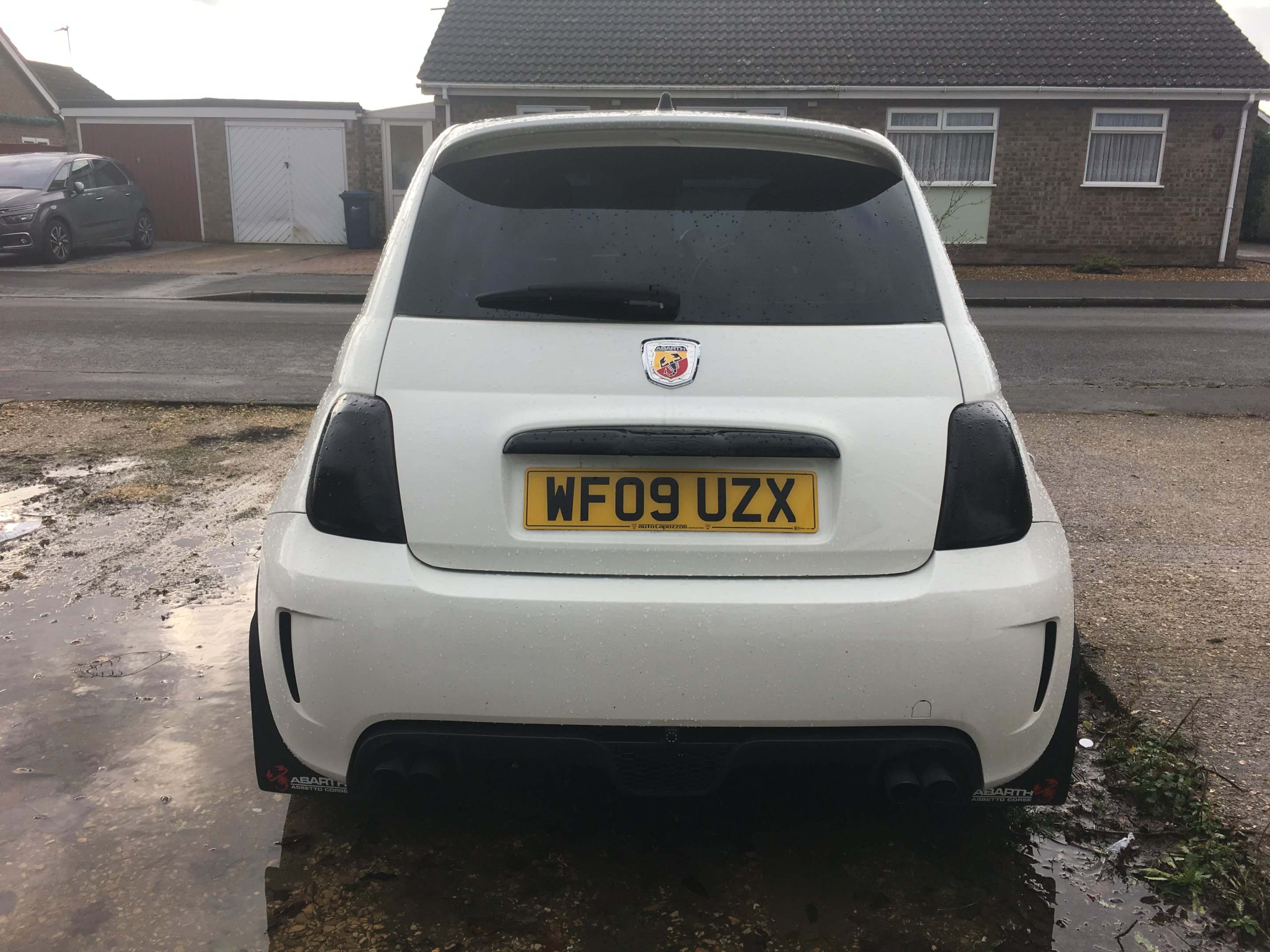

Changed the rear badge. Looks a lot better.

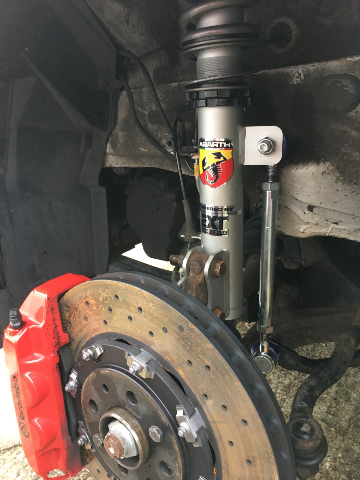

I managed to fit the drivers side coilover and top mount today, the top mount is from a Ford Fiesta and was £310 cheaper than the Abarth equivalent.. it has a draw back.
The top of the damper sits about an inch lower than standard top mounts and I need shorter drop links as the front anti roll bar is on constant load with the standard one fitted. So I'll be searching around tomorrow to try and find something suitable!
Managed to find these adjustable anti roll bar drop links and they're fantastic quality.
Wheels back on, brand new dampers and springs so need time to settle a little
I must have put about -3 camber on the front, it's pretty mental. Need to get the entire subframe off soon to replace bushes and powdercoat the subframe as it's a mess. Then I'll get a good alignment/corner weighting.

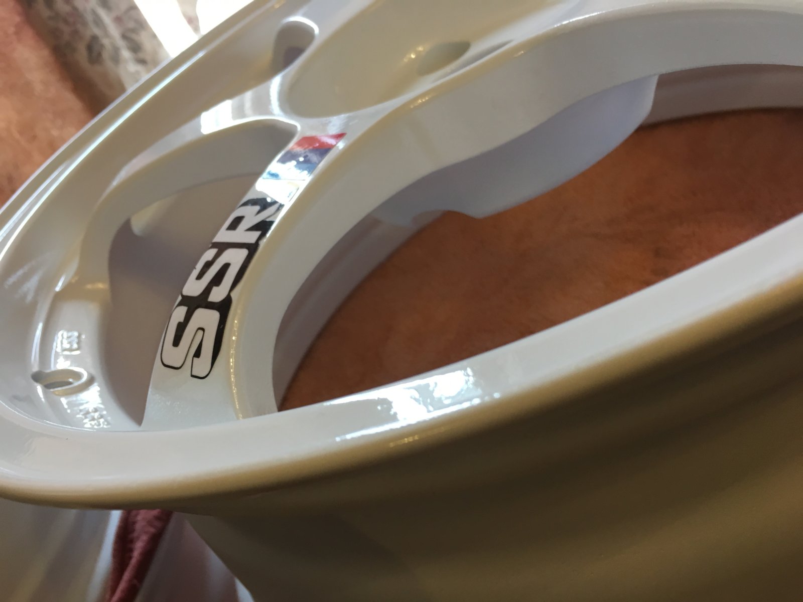

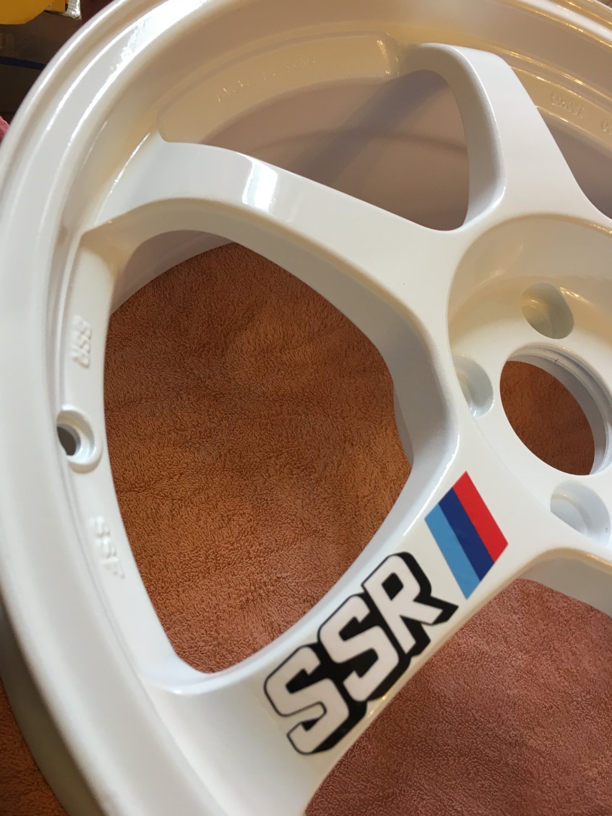

New wheels came in the post from Hungary!
5.8kg weight, freshly painted white. Awaiting SSR valves from Japan before I can get my Dunlop Direzza DZ03G on them. Should look phenomenal!
