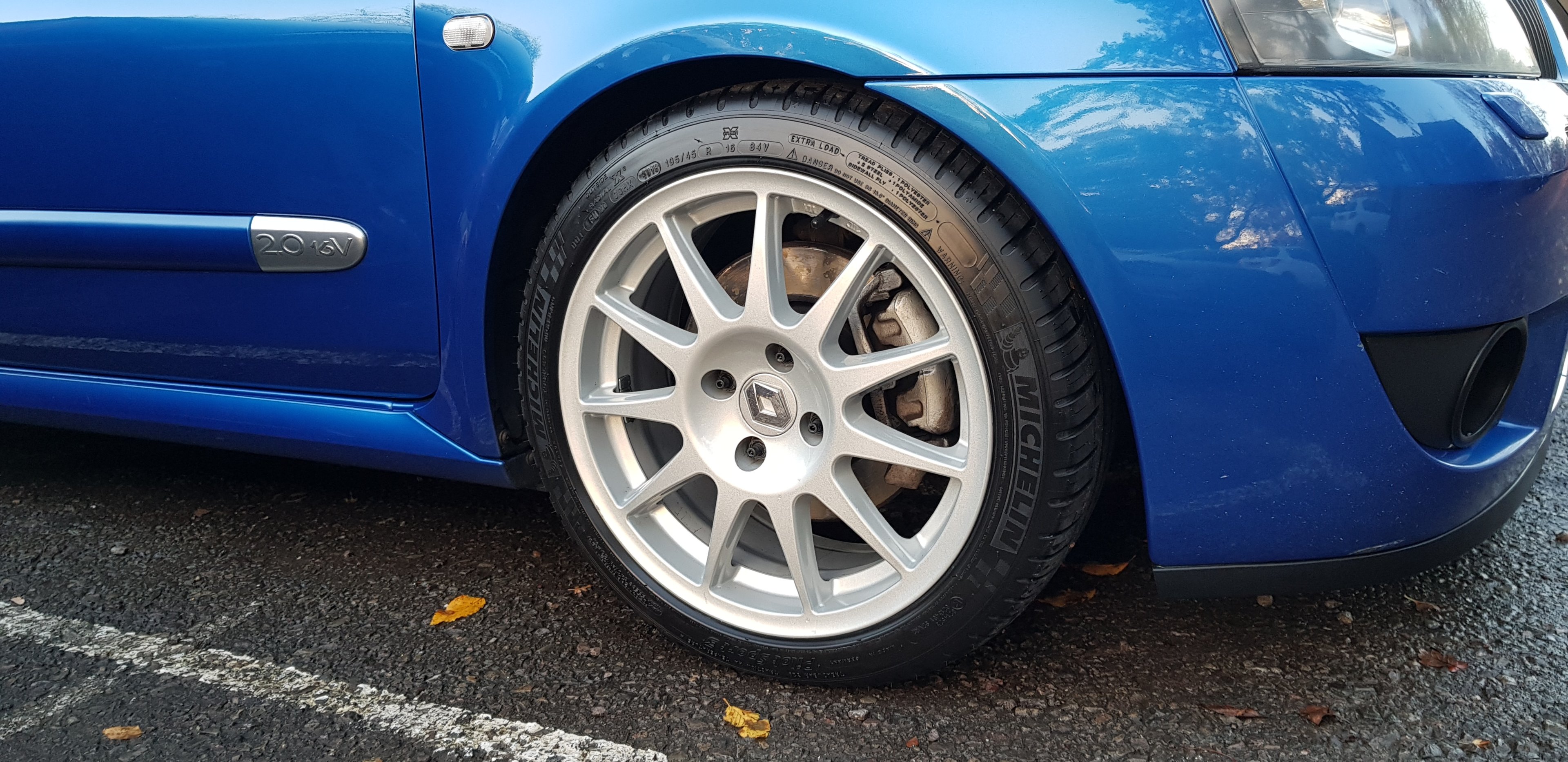

  Megane275R / 172 mk2
Toyo T1R’s are utterly shat I do not know why so many people use them. May as well have your wheels wrapped in bread rolls.
You should get Michelin Pilots or similar. I had Toyos on my Saxo years ago after Yokohama’s and it killed the feel of the car. Good tyres should not be underestimated. I’ve tried tried all kinds of performance tyres over the years and recently had several sets of Cup 2’s (on Megane trophy R not Clio) they make an incredible difference. Even coming from super sports on my last trophy which were soft and reduced the directness of the steering. Honestly I’d get shot of those T1R’s and get some pilot sport 3 or 4’s on before spanking money anywhere else. The tyre is what translates the whole thing to the road so if they’re too soft you just loose directness in the steering. Give it a shot and see what you think. Good luck.

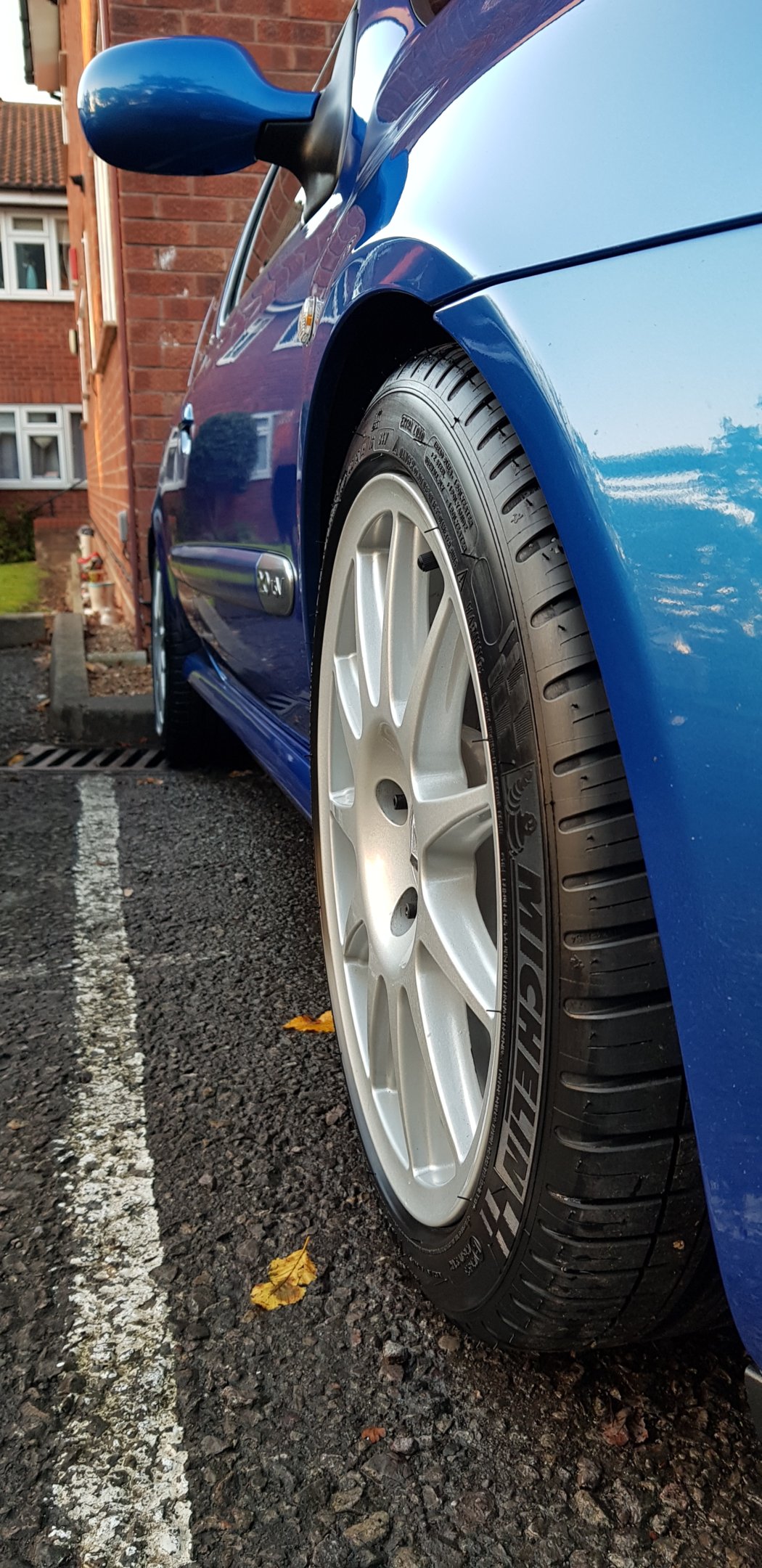

This looks lovely! I have some fairly hooptey tyres on my 172 Cup at the moment too but will be upgrading them when I sell my Lotus. Michelin’s look so much better too and fit the wheels perfectly. It’s what the car wasn’t fitted with as standard so I’m sure sure Renaultsport gave this a lot of consideration. Let me know how you get when out change tyres i’d be interested to hear if it solves your problem.
