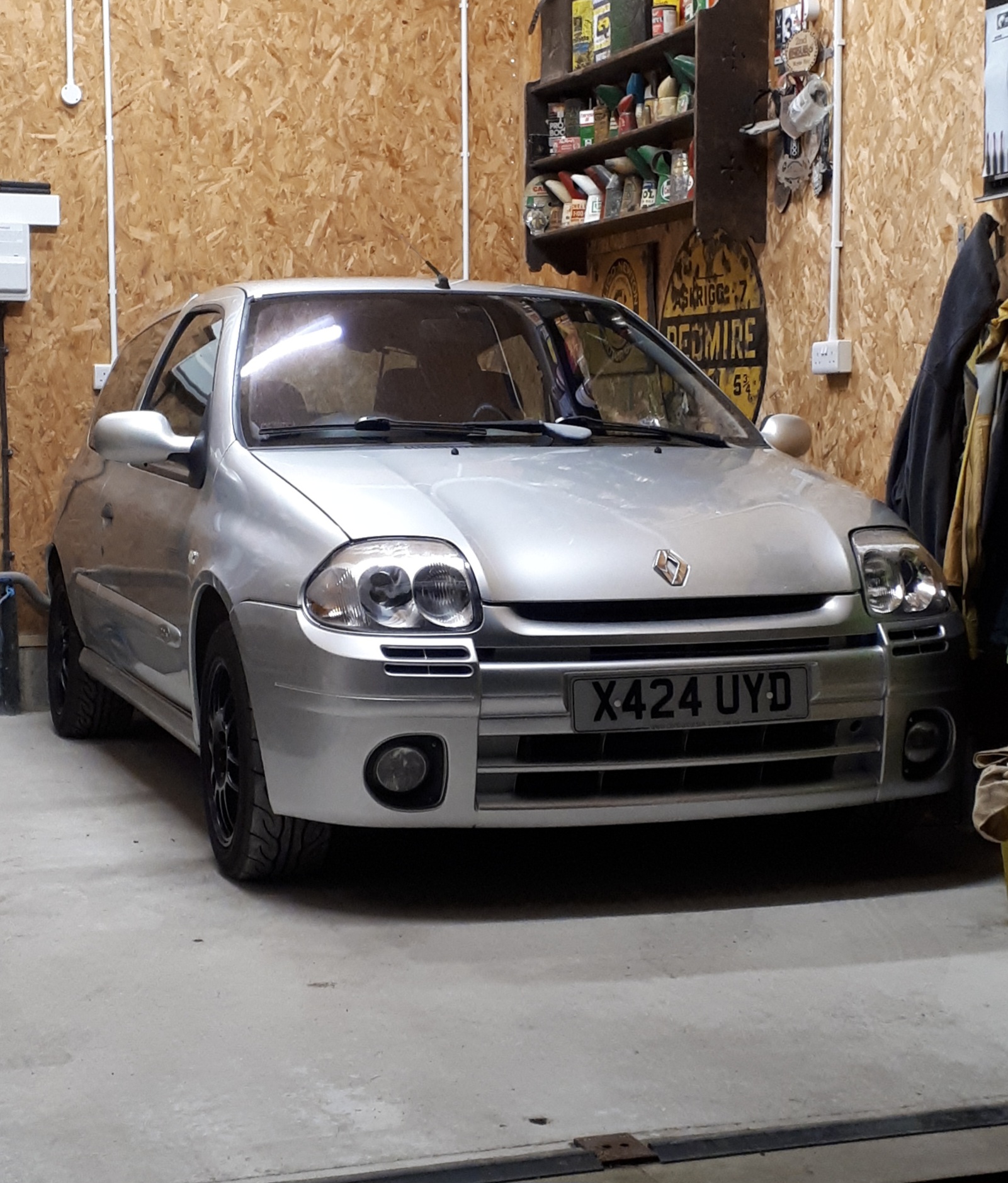

Hi everyone,
After 12 boring years without clio ownership, I have once again returned to the fold....
After kicking myself for parting ways with my last inferno 182 cup, this time I've took the plunge with a 172 phase 1. I always preffered the front end of a ph1 over the ph2 cars i've had in the past, and after a lengthy period of 'badgering', a mate of mine eventually agreed to part with it (he had two PH1's) so this one came back with me from only 5 mins down the road!
I knew it would need some work. My mate had resurrected it from an incomplete car to an MOT passable machine but didnt want to go much further. I'm a bit OCD minded anyway and like things to be right, so I'd already succumbed to the fact i'd be spending to get it to the next level. I'm ultimately hoping for a fast road set up, most importantly with everything done right, the car will get what it needs!
Bear in mind im a 37yr old Yorkshire builder with 2 young kids and not much spare time, I'm doing what I can when i can! The combination of minimal mechanical experience, insufficient tools and lack of patients doesnt always result in progress, but I'll get there! Thankfully i've chewed my mates Andy's ear (he's a Porsche mechanic & engine builder) to the point he's finally given in, and is helping me on some evenings with the important stuff!

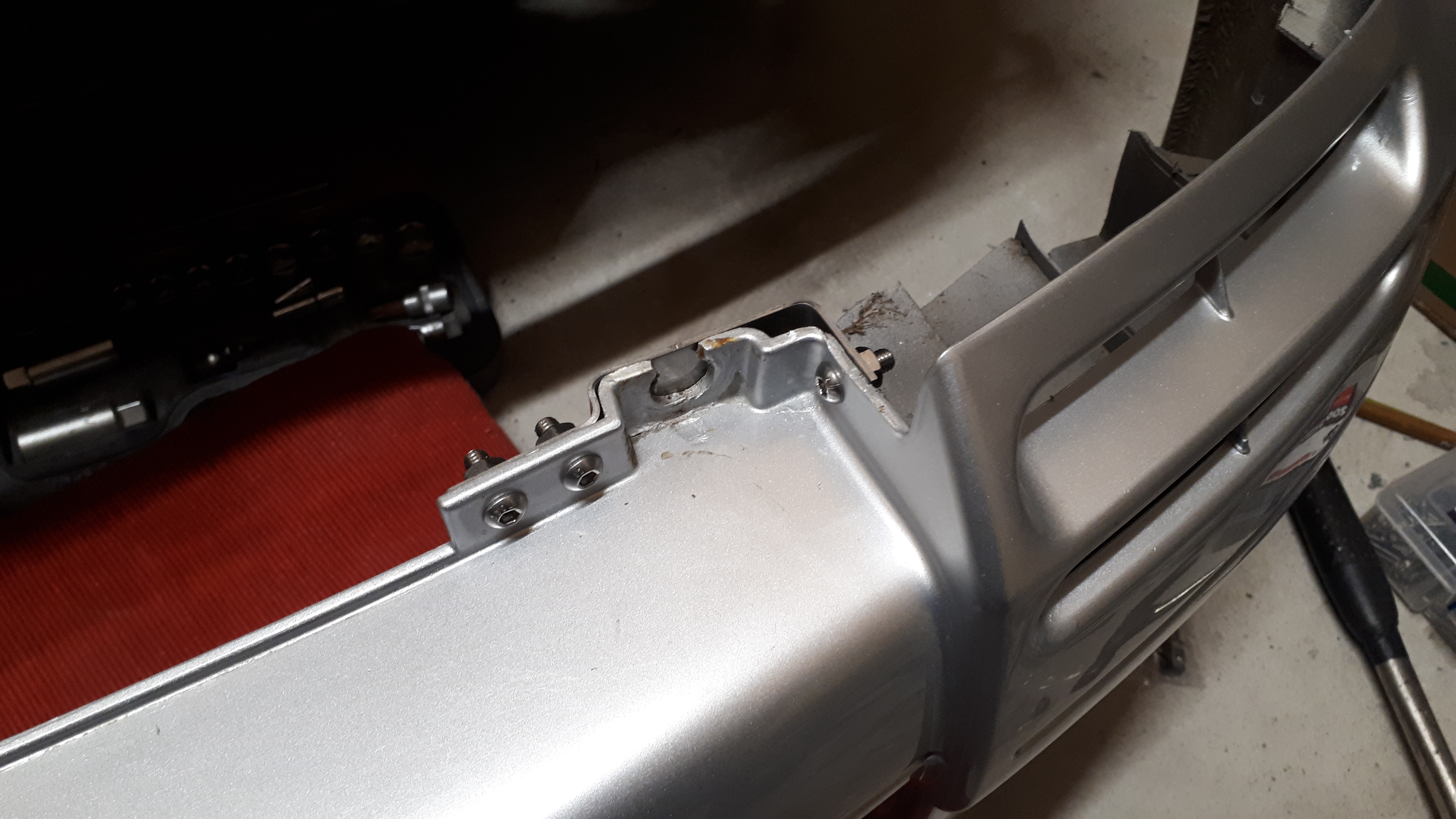

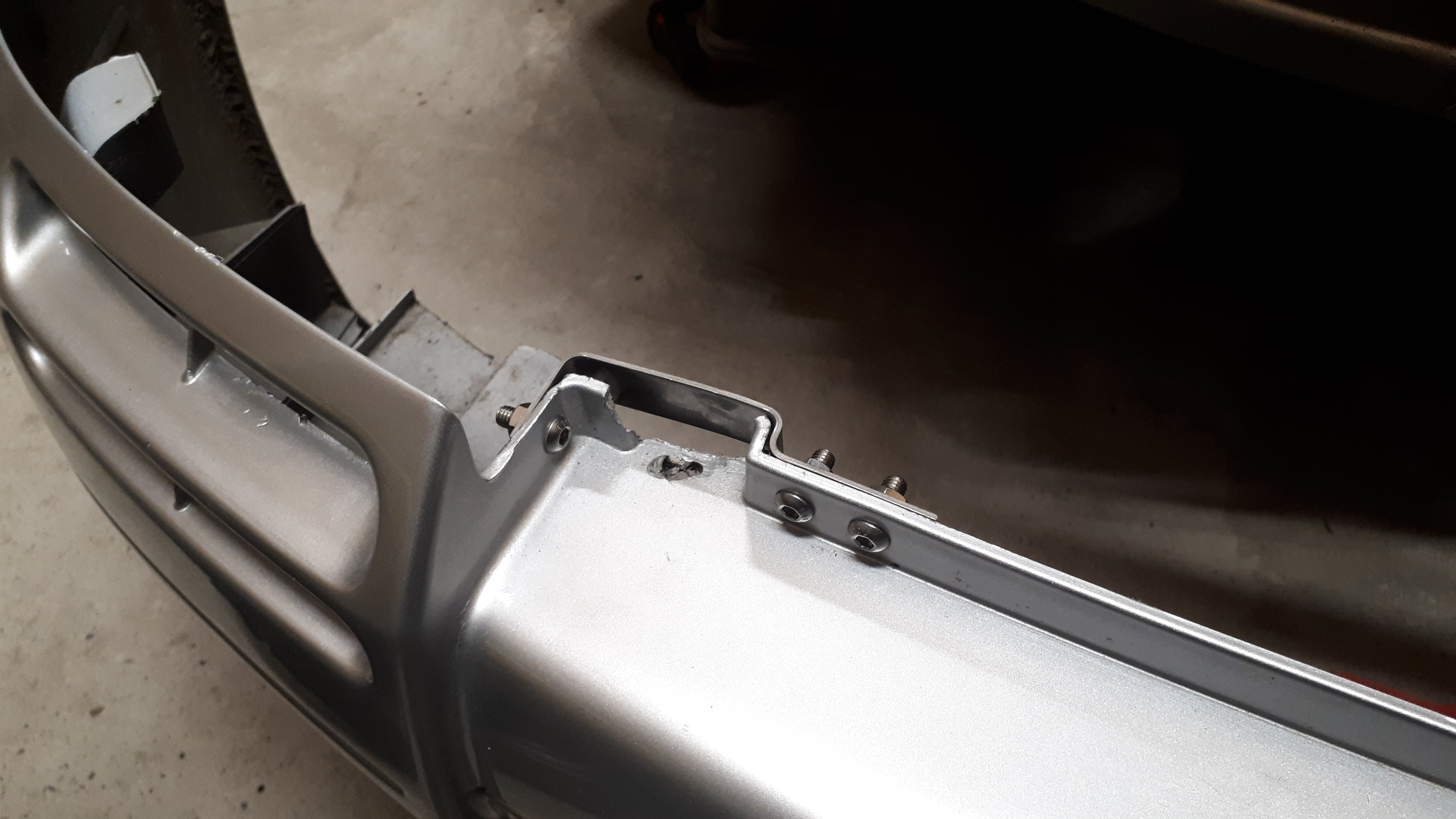

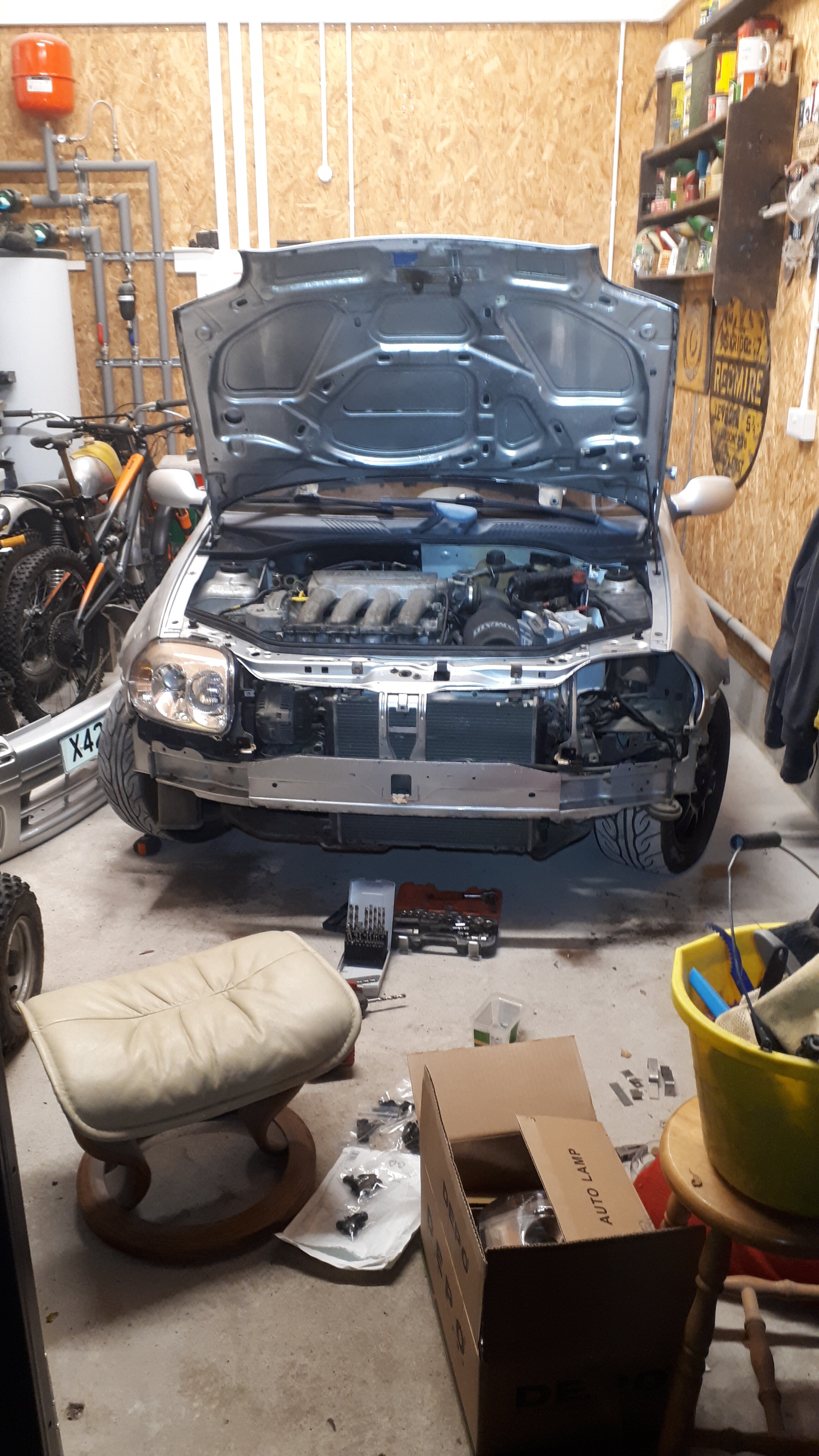

Turns out the front bumper was self tapped on, so a few bits of home fabrication along the way....

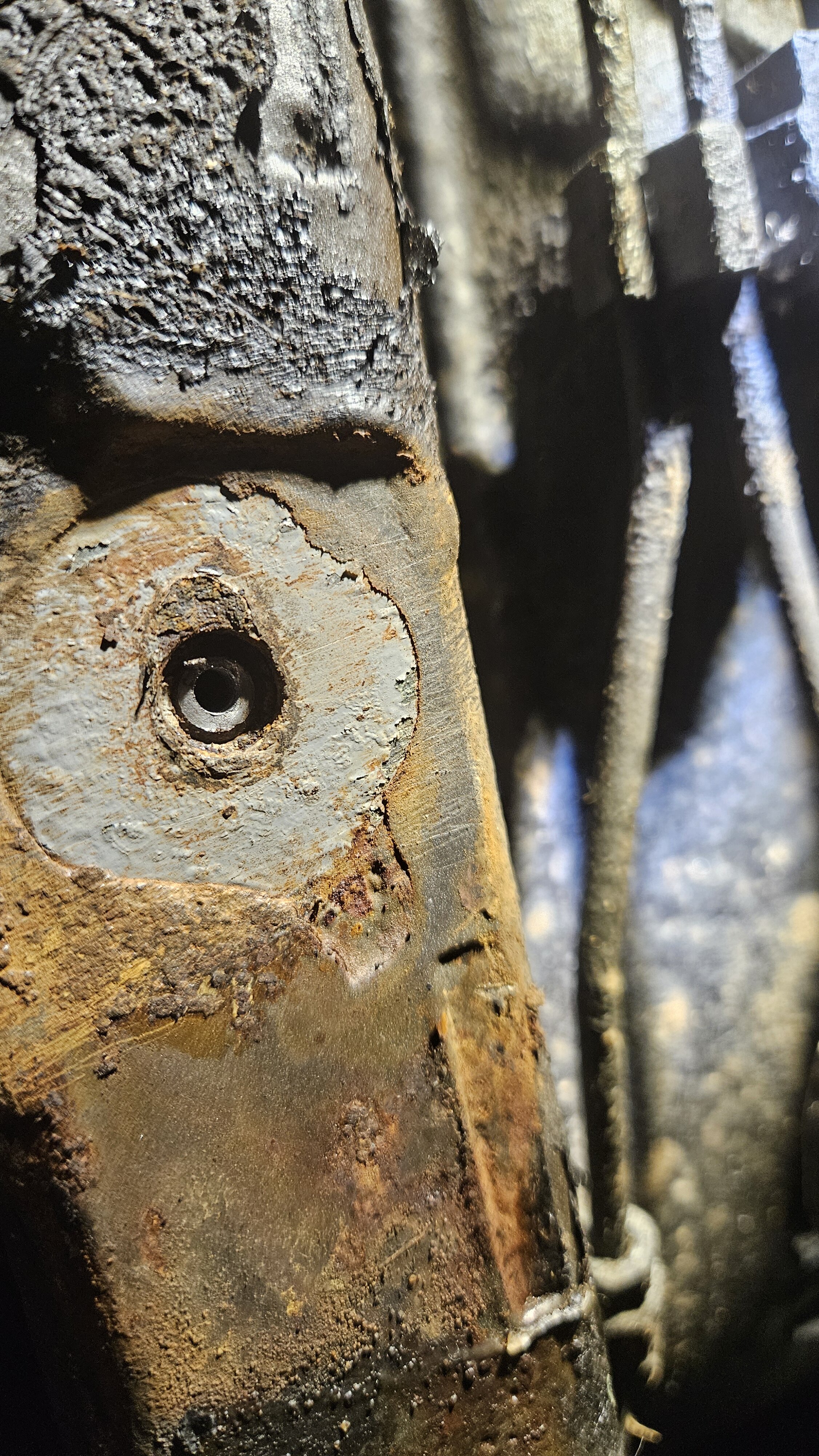

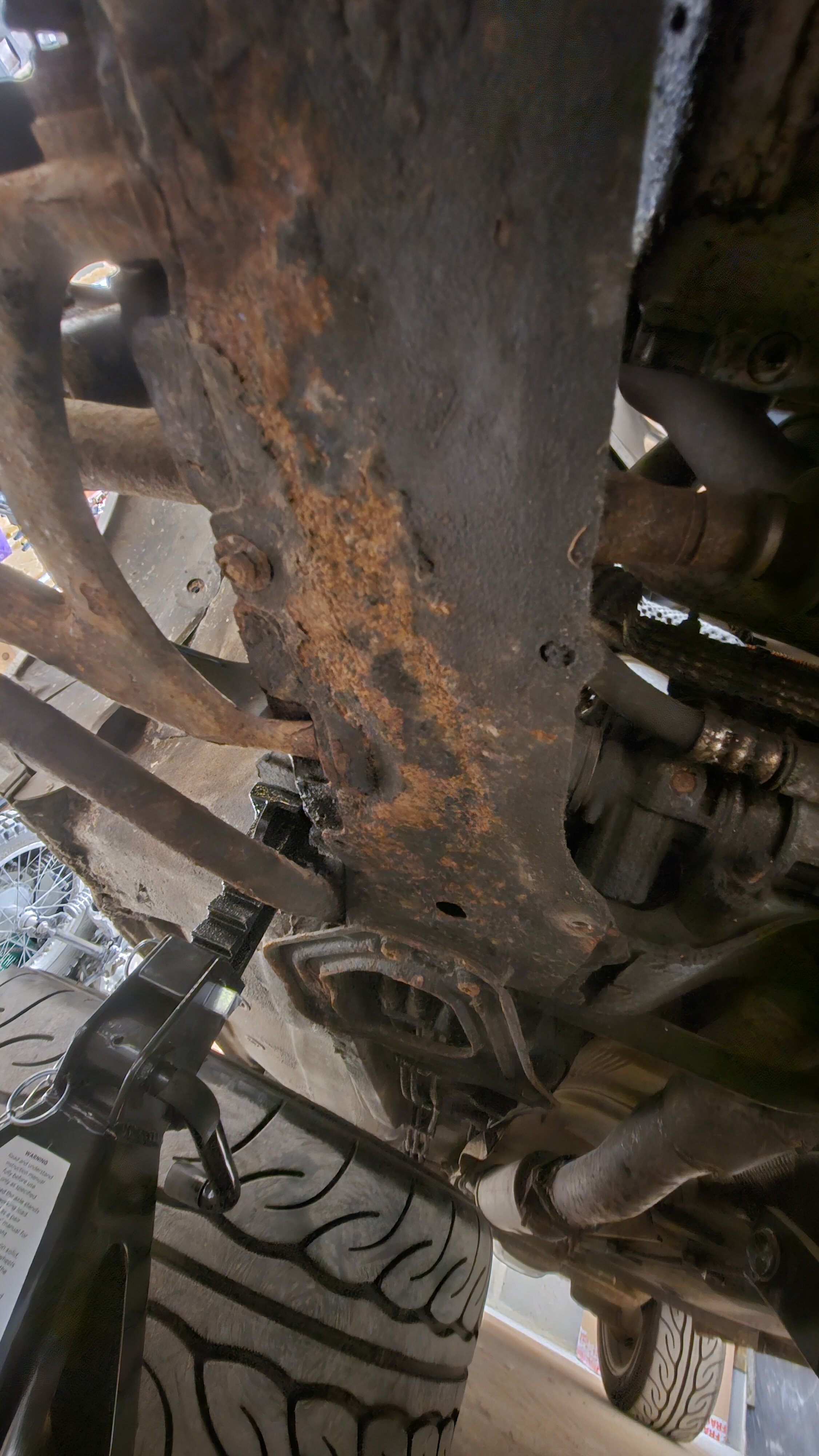

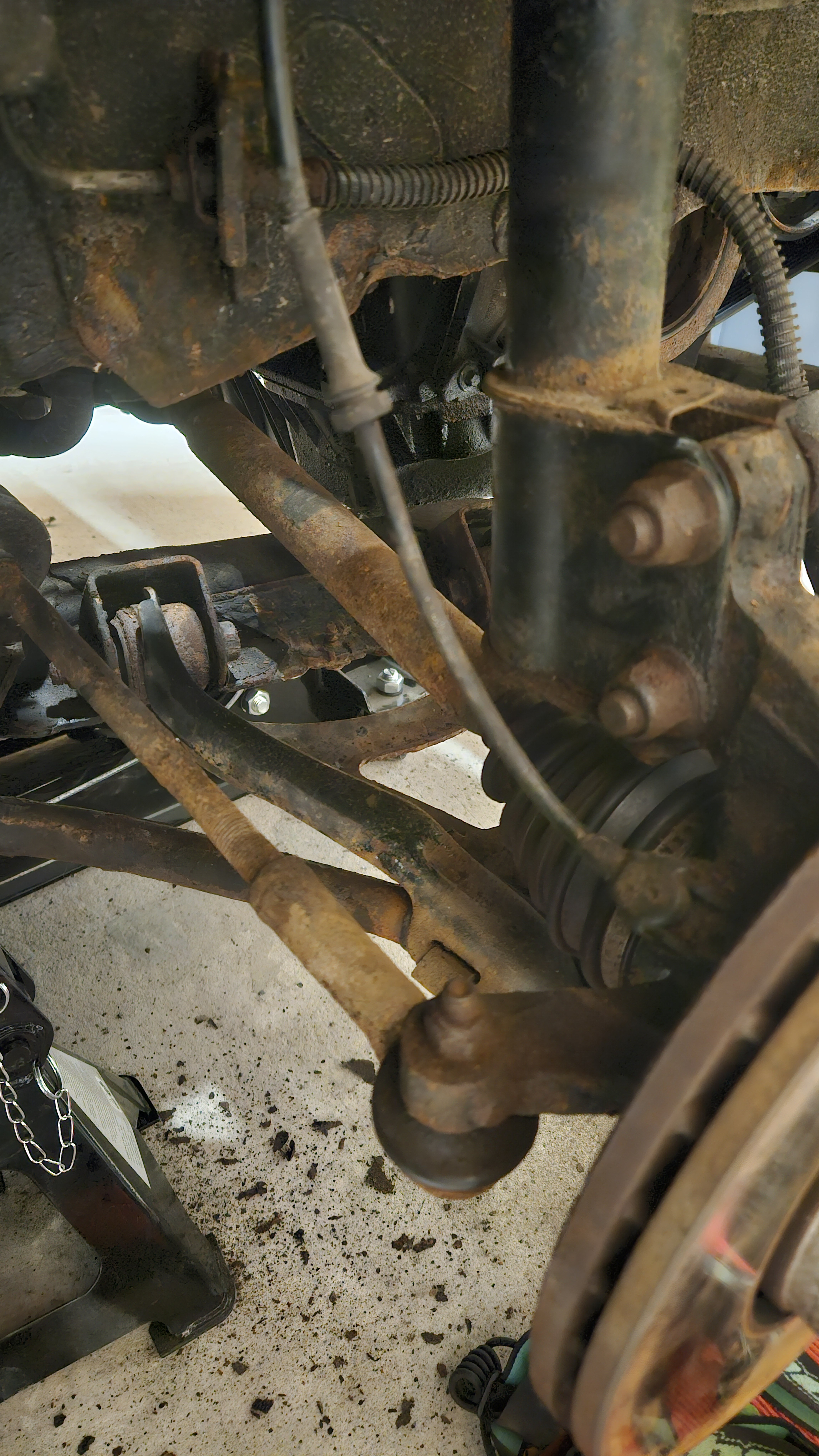

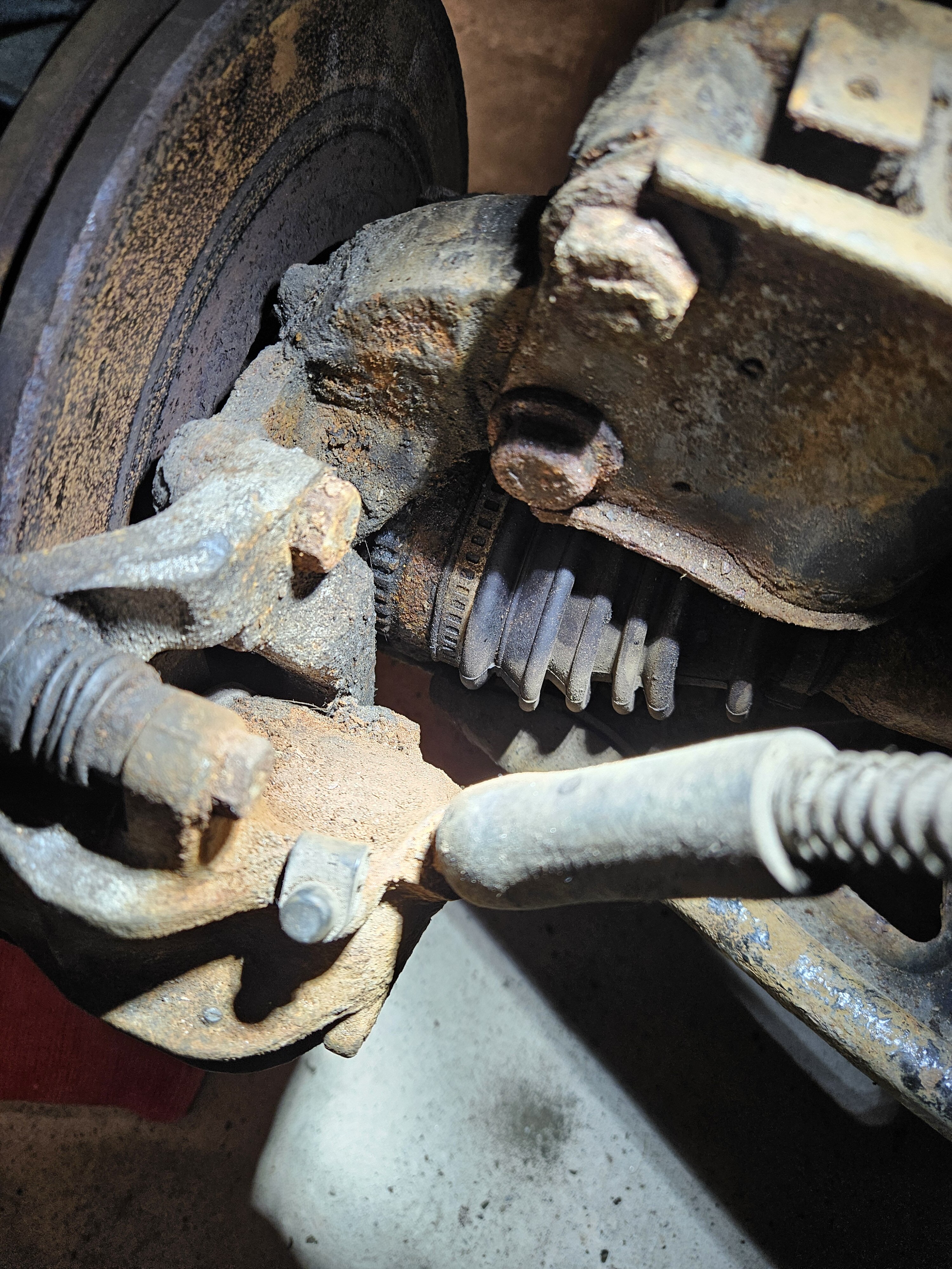

I quickly found that the car must have been sat over a puddle for some time, everything underneath is a bit tired, orange and pitted! Thankfully it seems to be localised to the subframe and front corners, the rest of the floor pan and chassis rails etc are all good.
One thing led to another and as i just want it spot on, i decided to treat her to pretty much new everything in the front corners. So far I've got new;

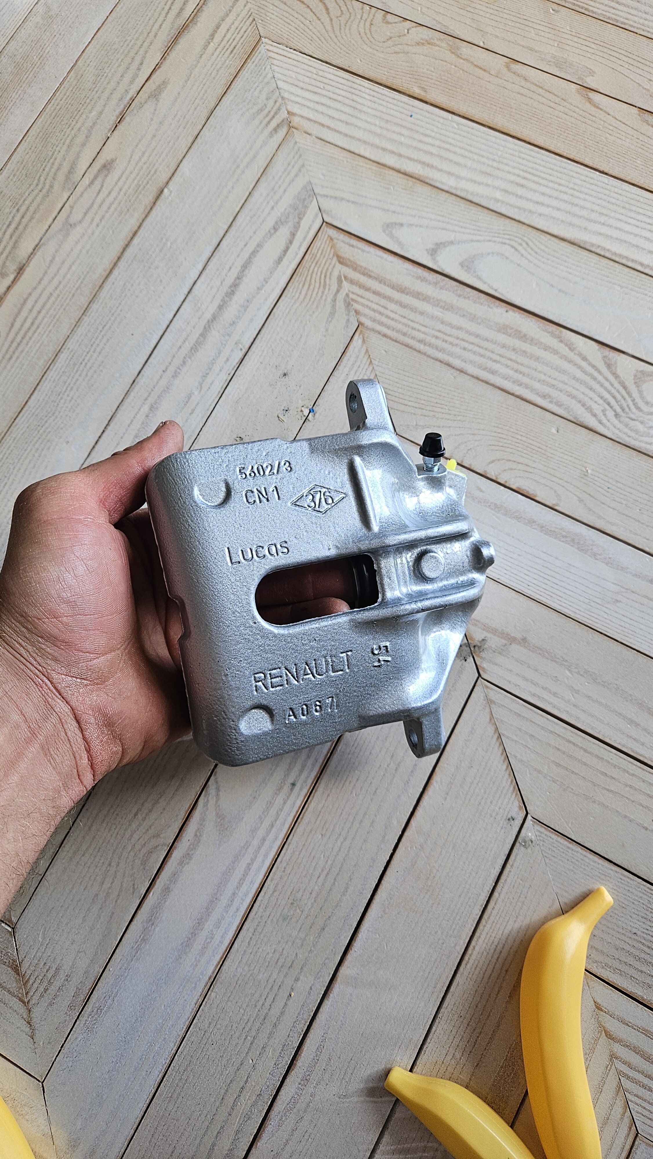

Ive had the subframe/brace plates/ARB/Hubs etc away for powdercoating, the OE calipers have been away for rebuilding/repainting, and Ive sent the inlet manifold / breather plate and upper engine mount casting away for aqua blasting. Cam cover got a couple of hours of love too! happy enough with all of it...

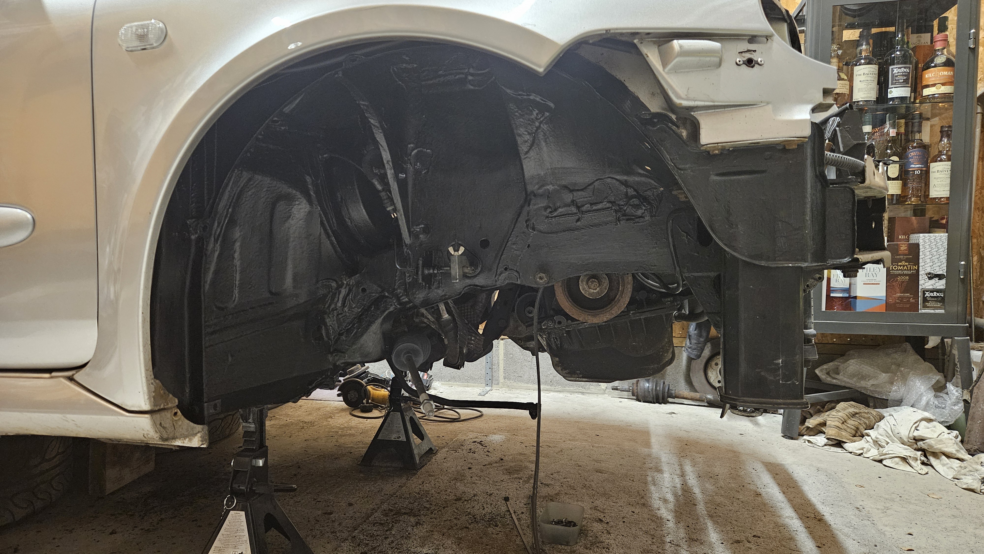

Whilst everything has been stripped from the front corners i've had the arch liners out, scraped back all the old underseal back to the factory stuff and coated everything with Bilt Hamber products, finishing it off with black epoxy resin and their Dynax C, not the best of jobs and more time consuming than imagined, but well worth it for the result...
Then I took the plunge and decided to do the sump gasket while the subframe was off. Had a bit of a fight with some of the Etorx bolts that are made of cheese, but after losing a knuckle, a new sump bolt kit and plenty of cursing, I got there eventually and the saga is long forgotten! That was the last offender...

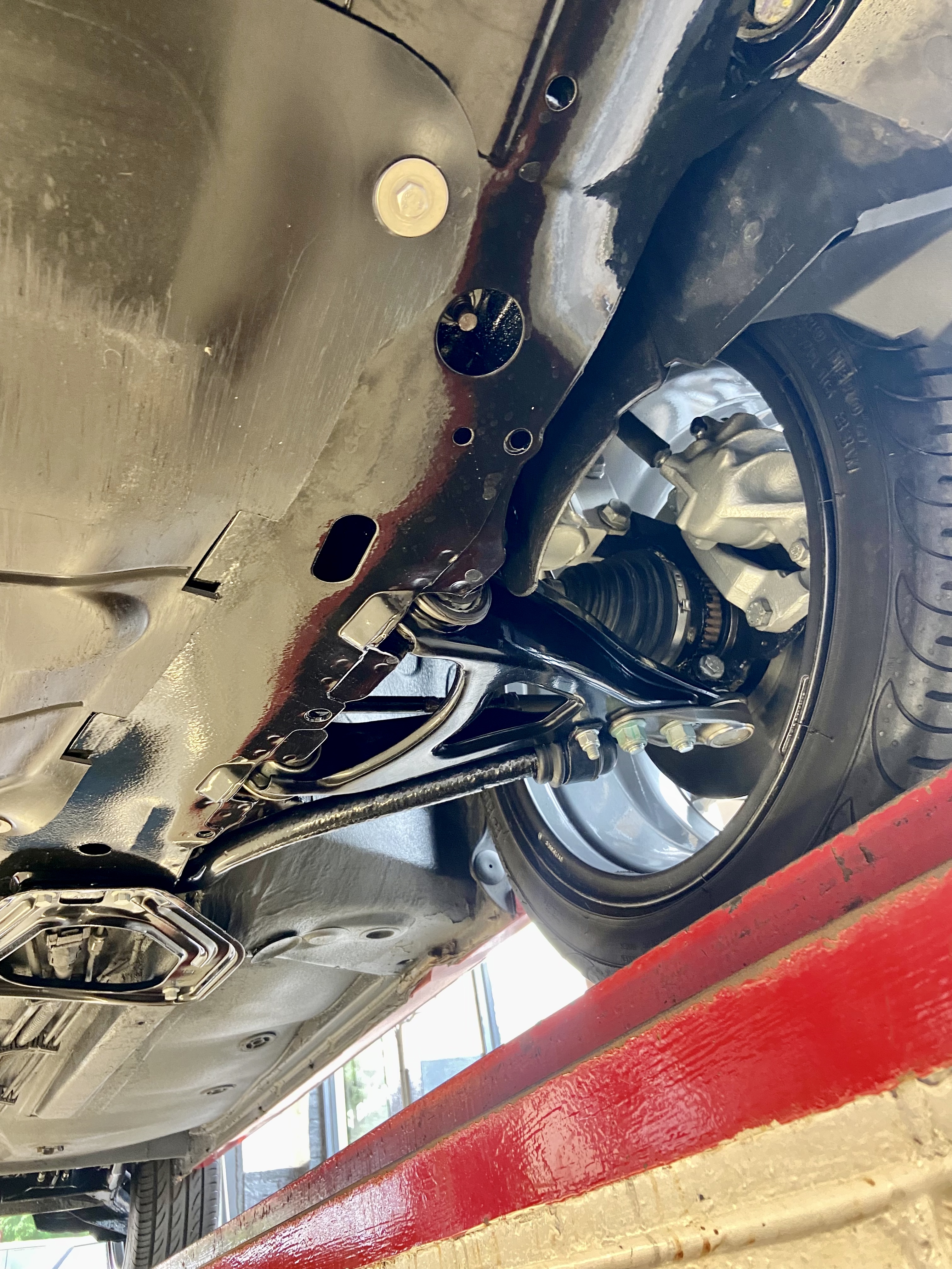

My mate Andy came around the other night and we got the sump on, subframe back on, steering rack bolted up, new wishbones mounted, ARB and bracketry on and gear linkage connected back up. Good progress for 3 hours id say! Sump got a good polish over too!
And thats where i am at present! Hoping to keep things ticking over in the garage over the next few weeks to try to get the front end completed and back up & running. Then i'm planning to turn it round and strip the back.

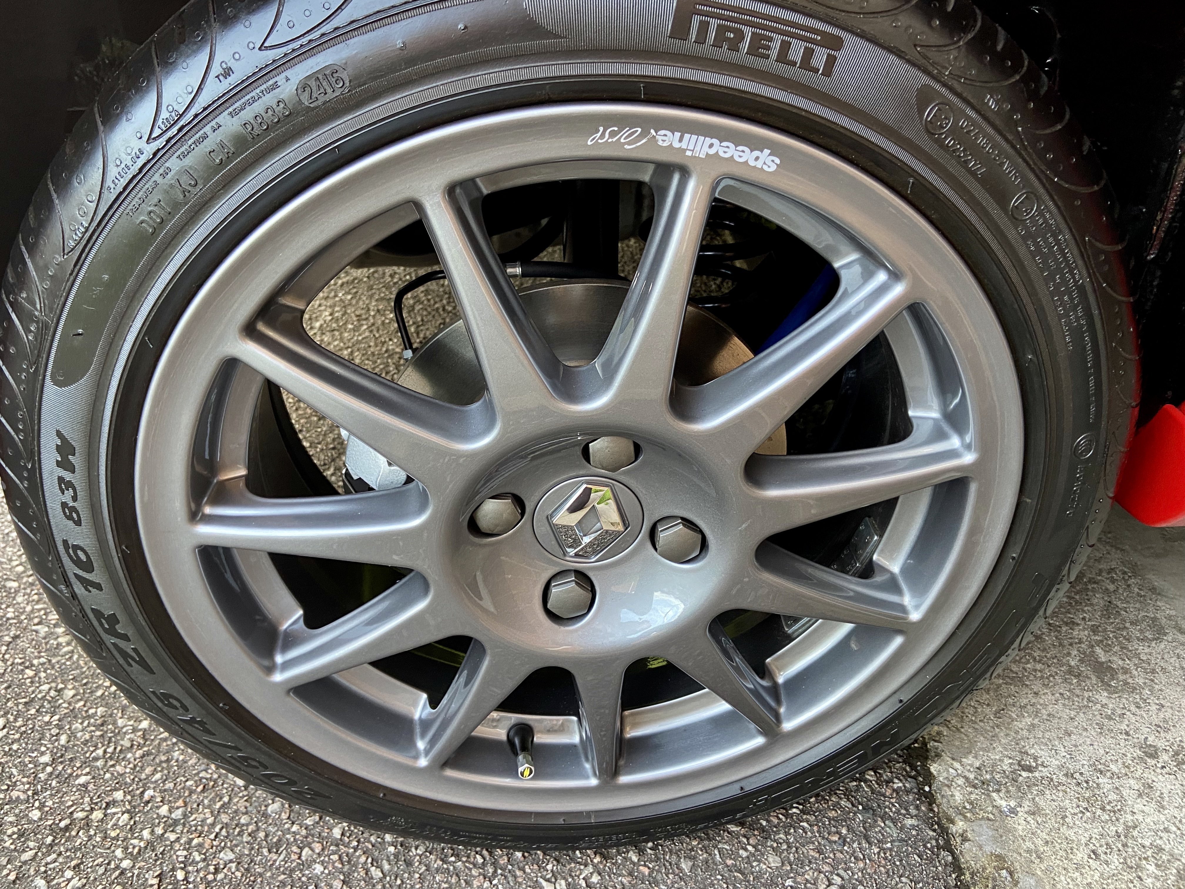

Lovely job youve made there chief 👌 can i ask.....did you put any coatings over the new parts before you started driving it again regularly? I'm just debating coating ARB, wishbones, tie bars, shock lowers, driveshafts etc with clear Dynax so they stay looking new slightly longer than they would. I mean im only going to drive it during summer months anyway, but might keep it looking a bit tidier for longer?? Anyone had a bash with that sort of thing? Cheers
Nick doesn’t drive his cars. Just polishes them and puts them in showrooms. 😂
Daniel right above 🤣🤣 I’m sorry to say I can’t comment due to not using the car since I finished restoring it in 2022 - I’ve only taken it out occasionally on dry days so it still looks the same.

Last time my car came out last year for a spin around the block.
I do love seeing treads like yours on here however it’s not easy to do now due to the unobtainable parts and costly labour charges.
View attachment 1775342View attachment 1775343View attachment 1775344View attachment 1775345
Bloody hell, if i can achieve half as tidy as that i wouldn't want to use it either😂 looks like theres some time and brass gone in to her pal, lovely motor. 👌

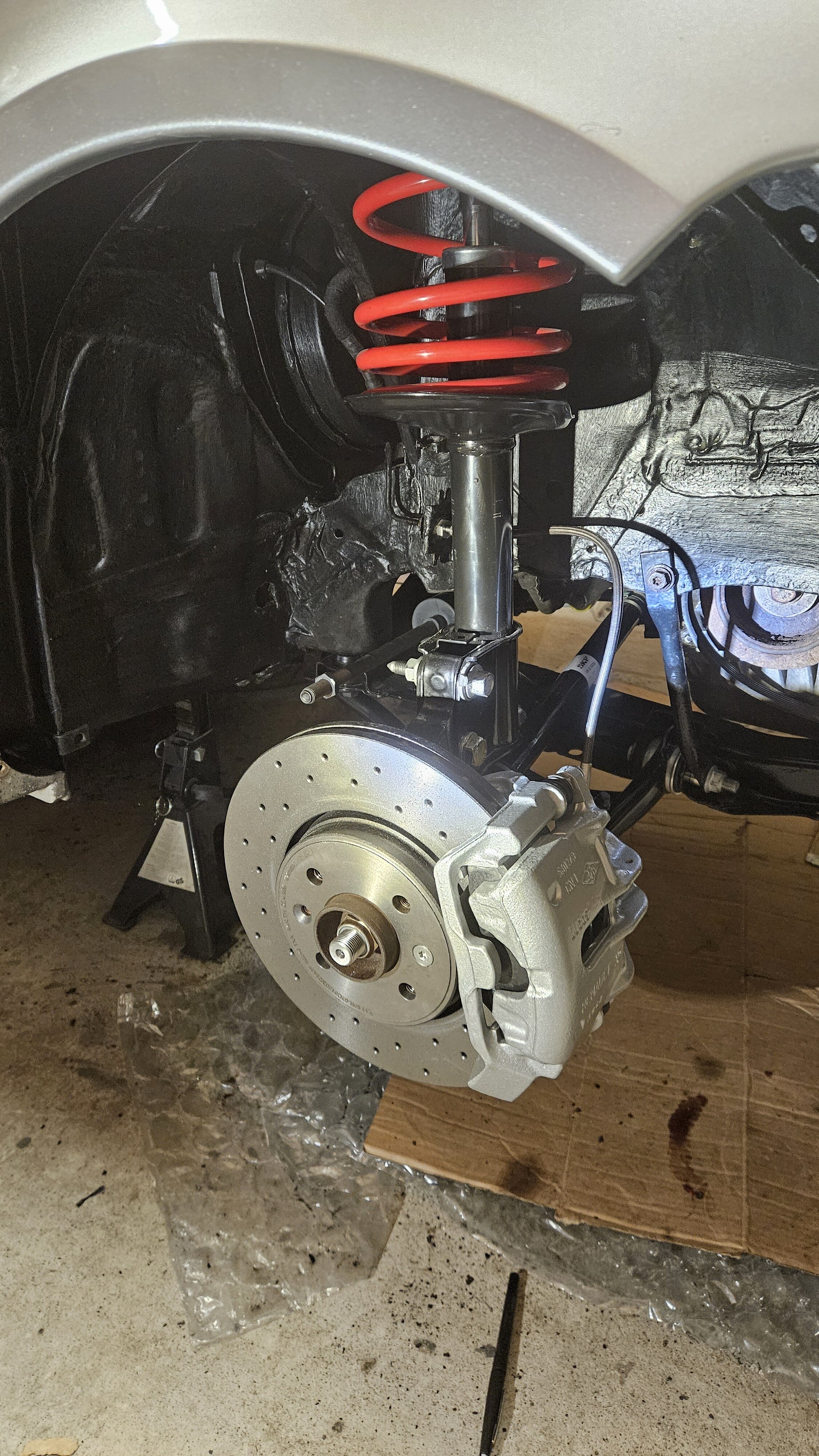

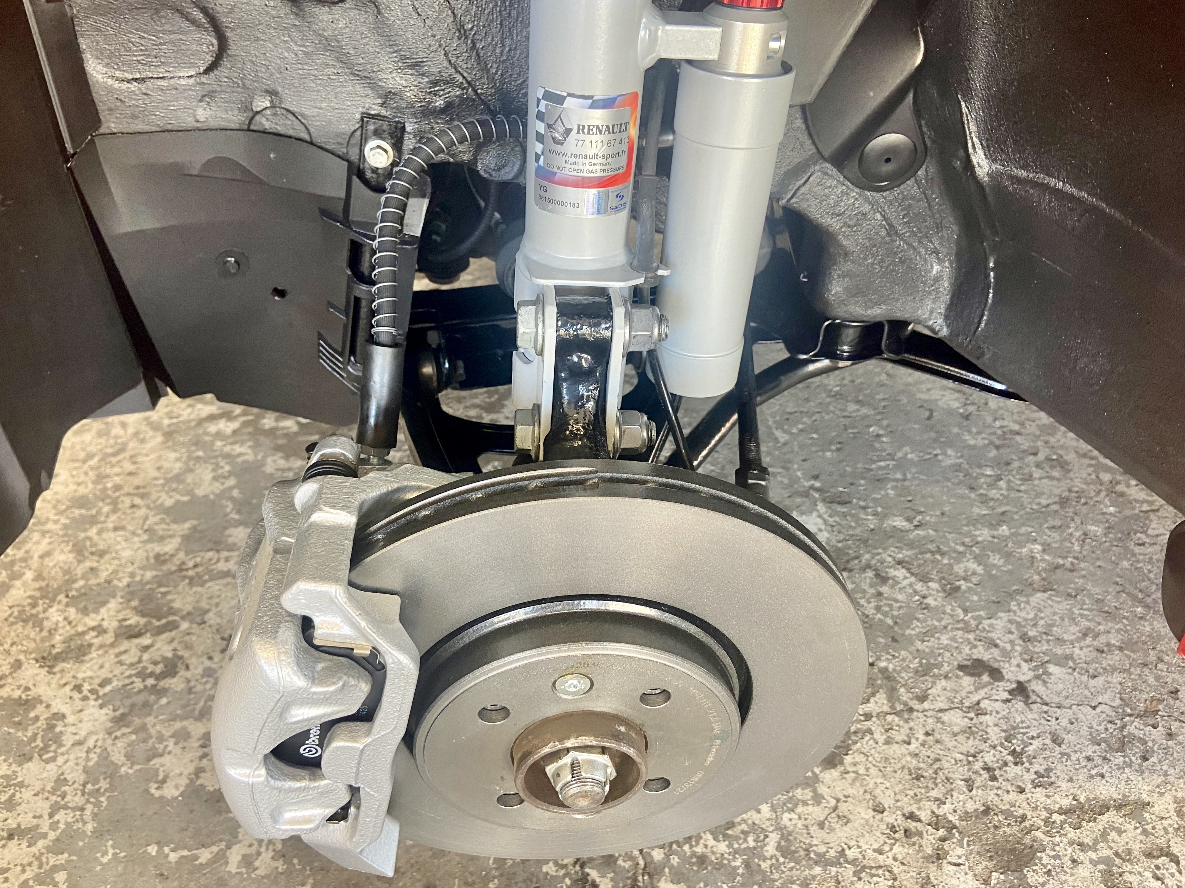

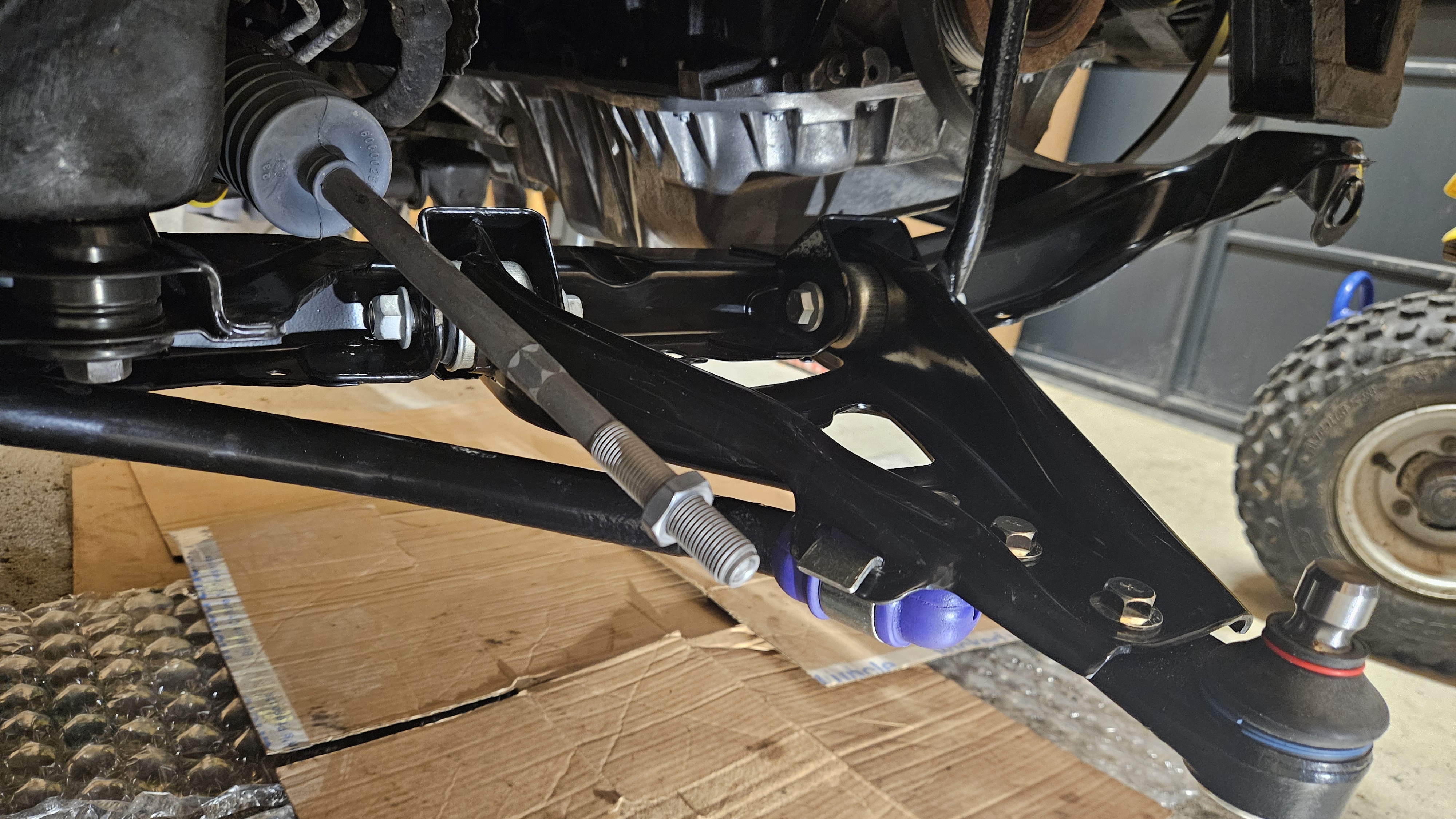

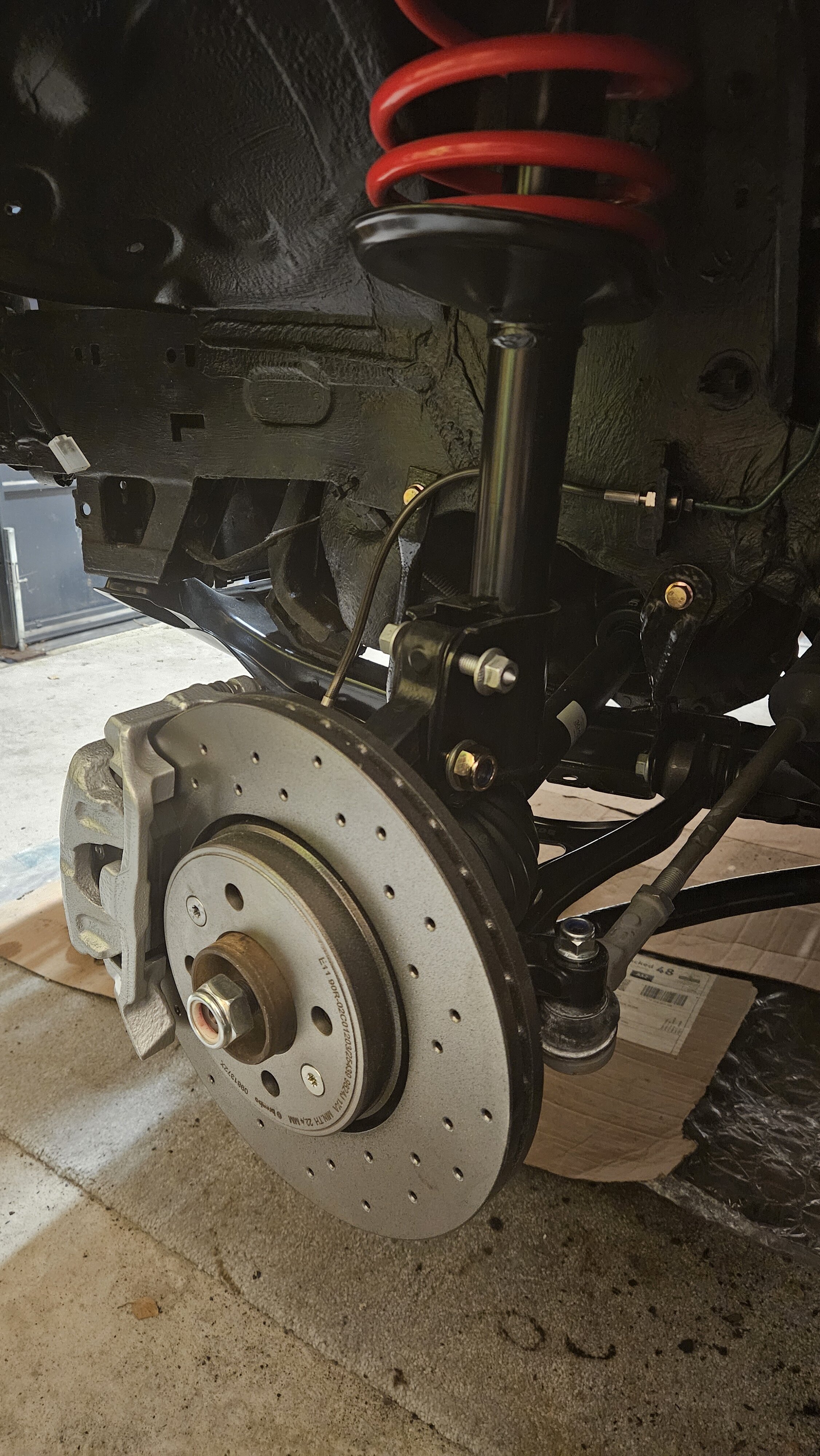

Update of last night's progress....

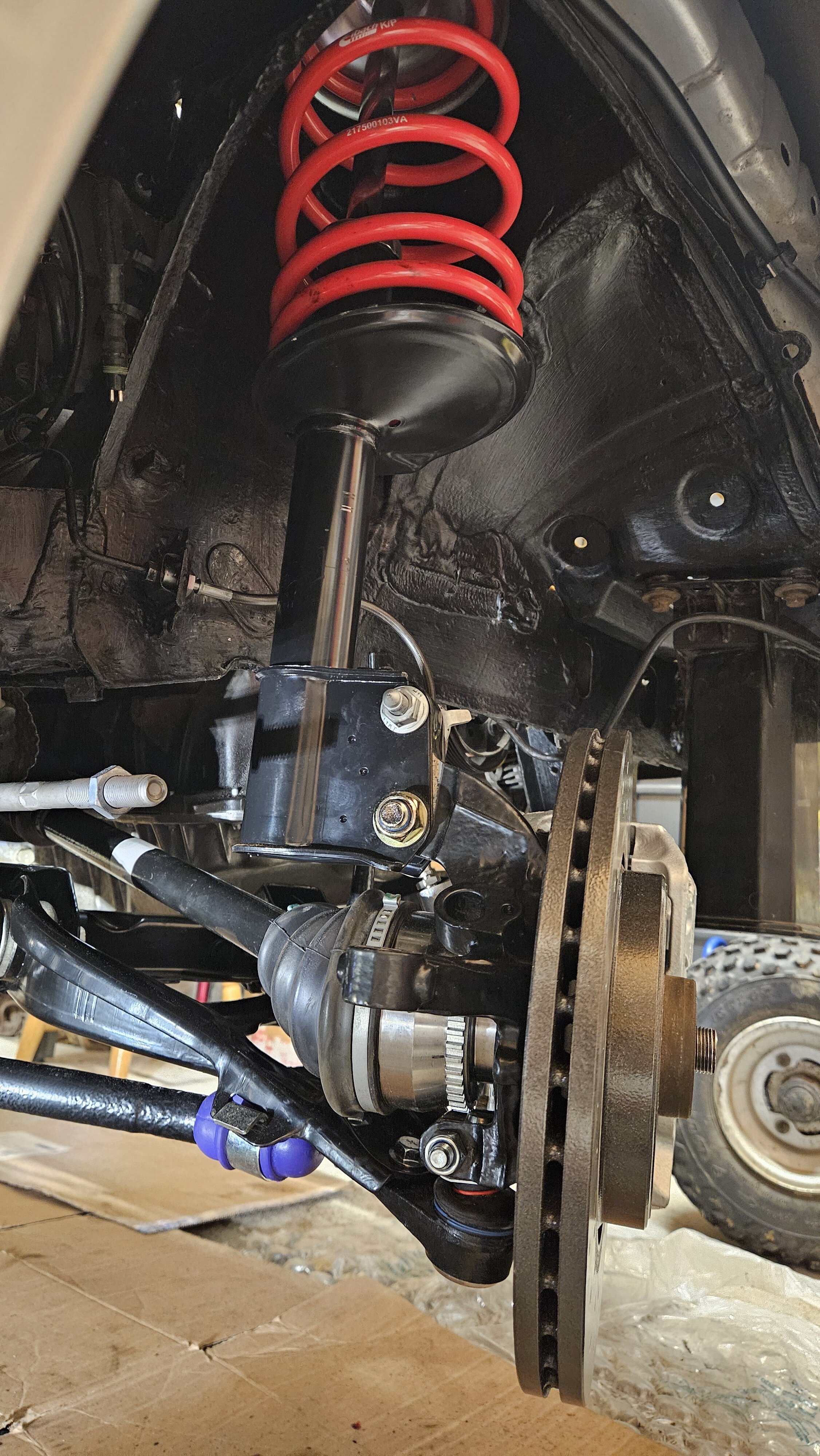

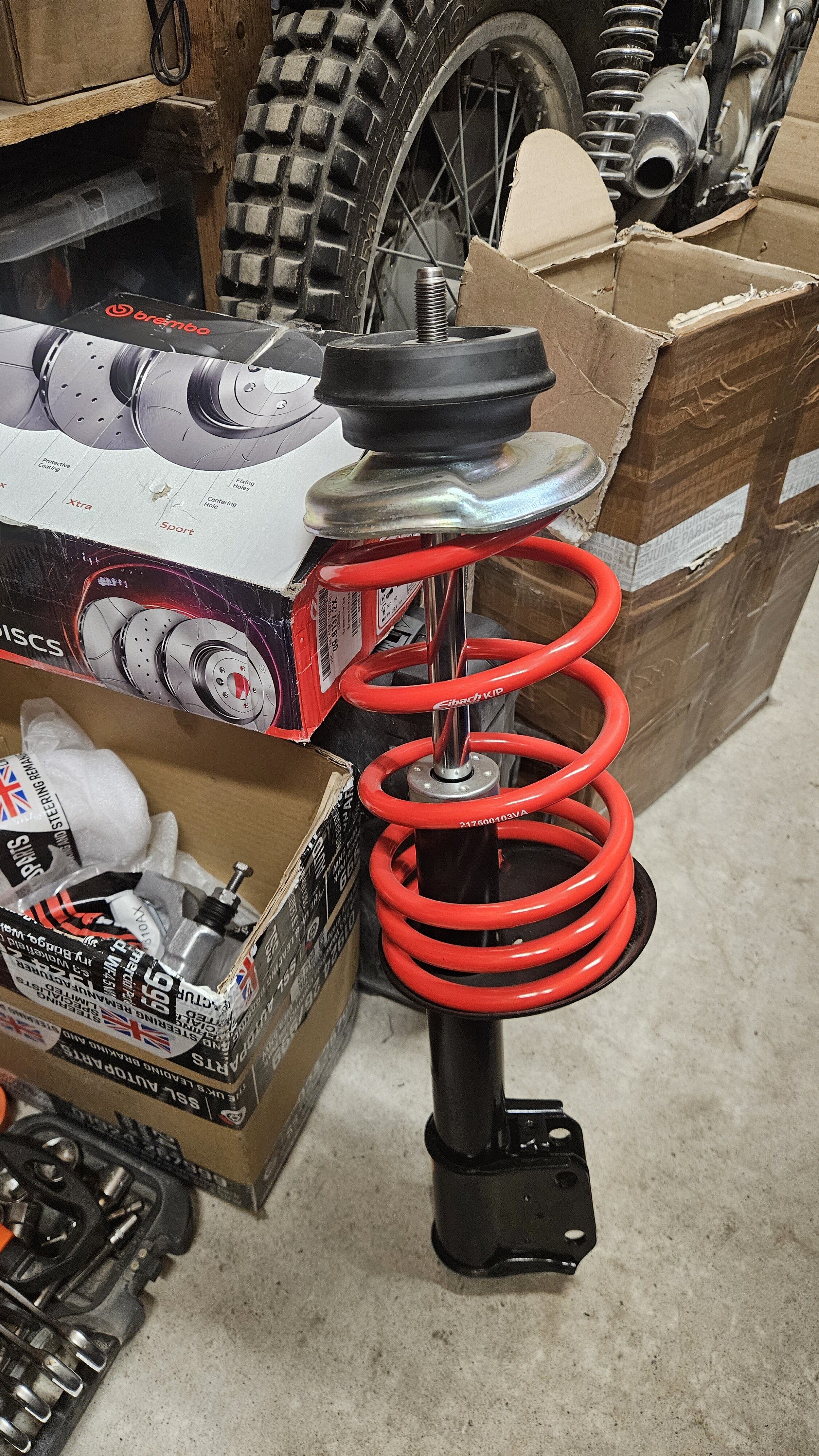

Built shocks up with sportlines, new spring retainers and powerflex top mounts 👌
Started on drivers side front corner.... New shock and top mount bolted in.
New SKF driveshaft in, Hub back on, Brembo disc on, Pad Carrier and caliper mounted, HEL braided brake line fitted, jobs a gooden, looks well.

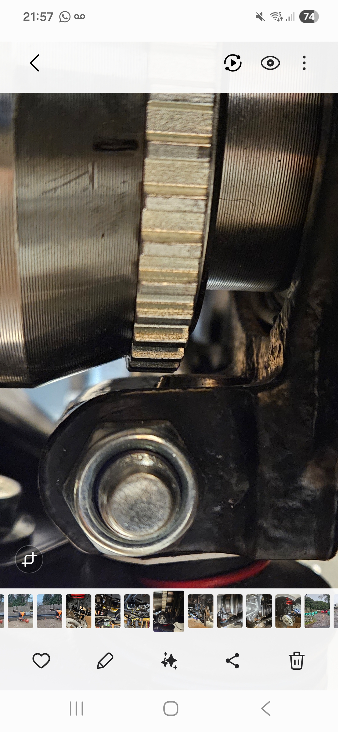

Problems requiring advice.....
1. ABS ring on driveshaft is ducks arse tight to the top of the ball joint pin. Its all fitted right and pinch bolt fits nicely, just looks like aftermarket ball joint is slightly longer than it should be. Anyone had similar issue? Might have to take ball joint off and grind 1-2mm off the top of pin. Guessing the tolerance it tight, as it runs close to hub anyway, just dont want to interfere with abs or chew a load of teeth. Anyway, much tighter than stonework tolerances i know that 😂
2. Powerflex camber bolts, looks simple but cant for the life of me figure it out, cant seem to turn the washer thing once its fitted, might wait until geometry set up for that anyway.
3. Forgot all about the ABS sensor, should have faced the powder coating off while the hub was off, no chance that b*****d is going in, need a die grinder or a round file to clean out the hub socket 😂
Anyway, good couple of hrs on the old girl 👌 onwards and moderately upwards

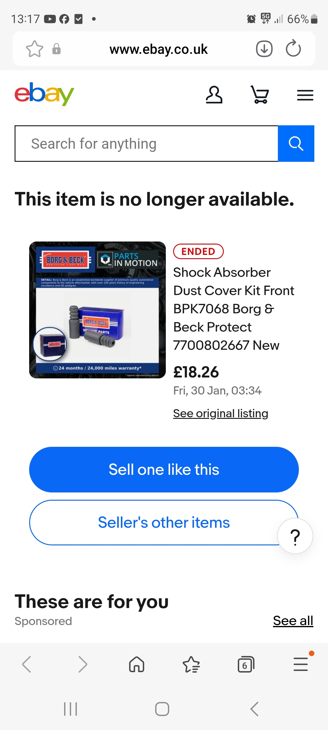

One quick thing, don't these need bump stops mate?
Cheers for having a look mate, I was exactly the same..... weirdly I've kept looking at the project threads now and again since I sold my last 182 nearly 13 years ago 😂😂
Bump stops, go on tell me more, I just put these together the same as the ones that came off, what am I missing? Cheers pal,
Sam
@Samholmes88
Honestly it's one of the only forum's I bother with, I still pay membership and still come back and it's been probably 7/8 years since my 182 and a lot more than that since my 172.
The shaft (silver part) of the shock, should have bump stops. They're rubber boots but also have a cushion within to help when the suspension is under compression.
They will also protect dirt from getting in to the shock seals as a secondary benefit, but as I said, the most important bit is them stopping you from bottoming out.
How do I know / why did I notice, I hear you ask;
I made the same mistake years ago with my 172 cup and completely forgot them, then when driving it I found it kept rubbing in certain corners or even over some bumps.
They'll only be a few quid but the annoying bit is that the springs need to come off again.
These are the ones, although I imagine they may be cheaper from Renault / pattern parts will no doubt suffice for these.

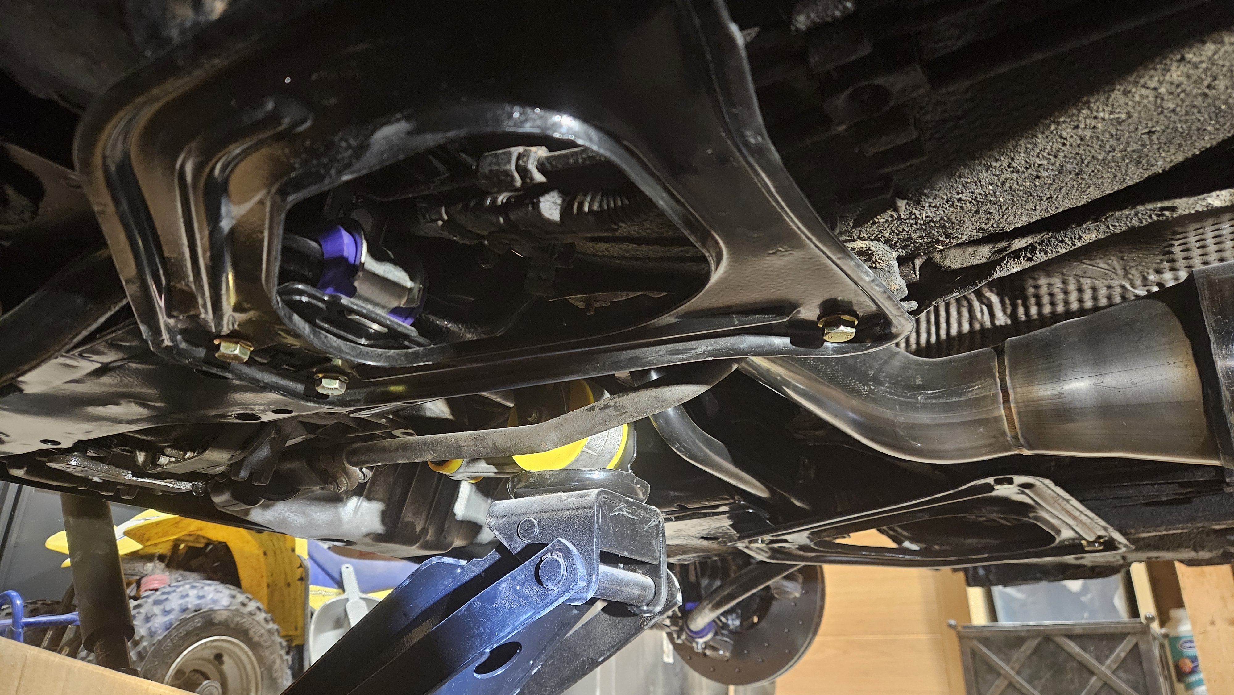

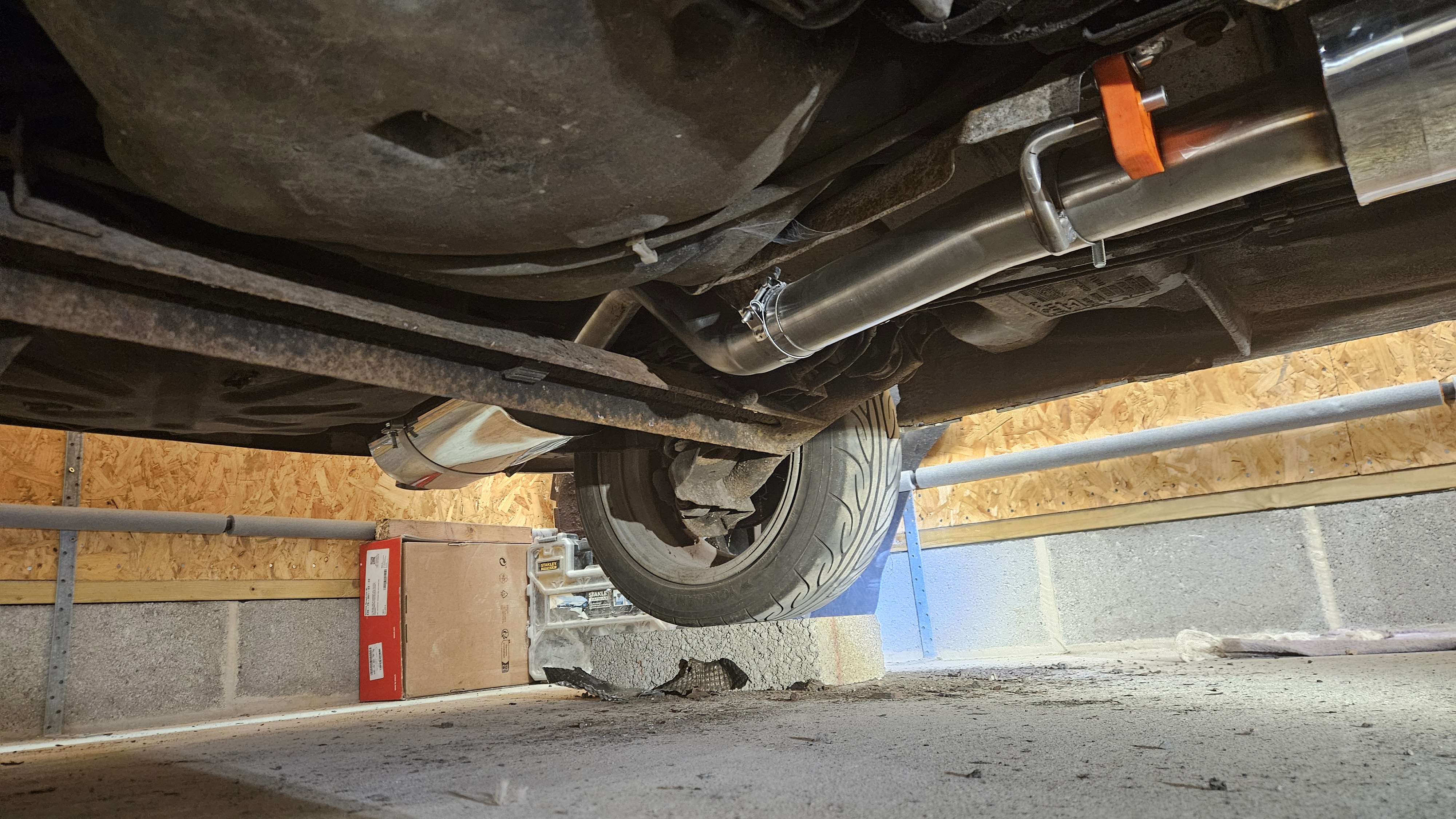

Some more decent progress on the ph1 last night......
Passenger front corner built up

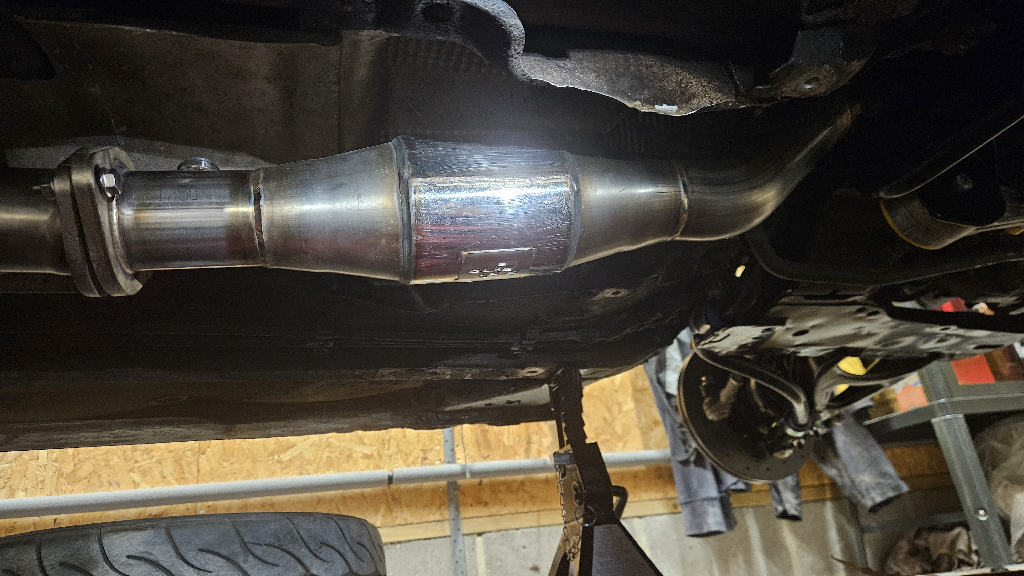

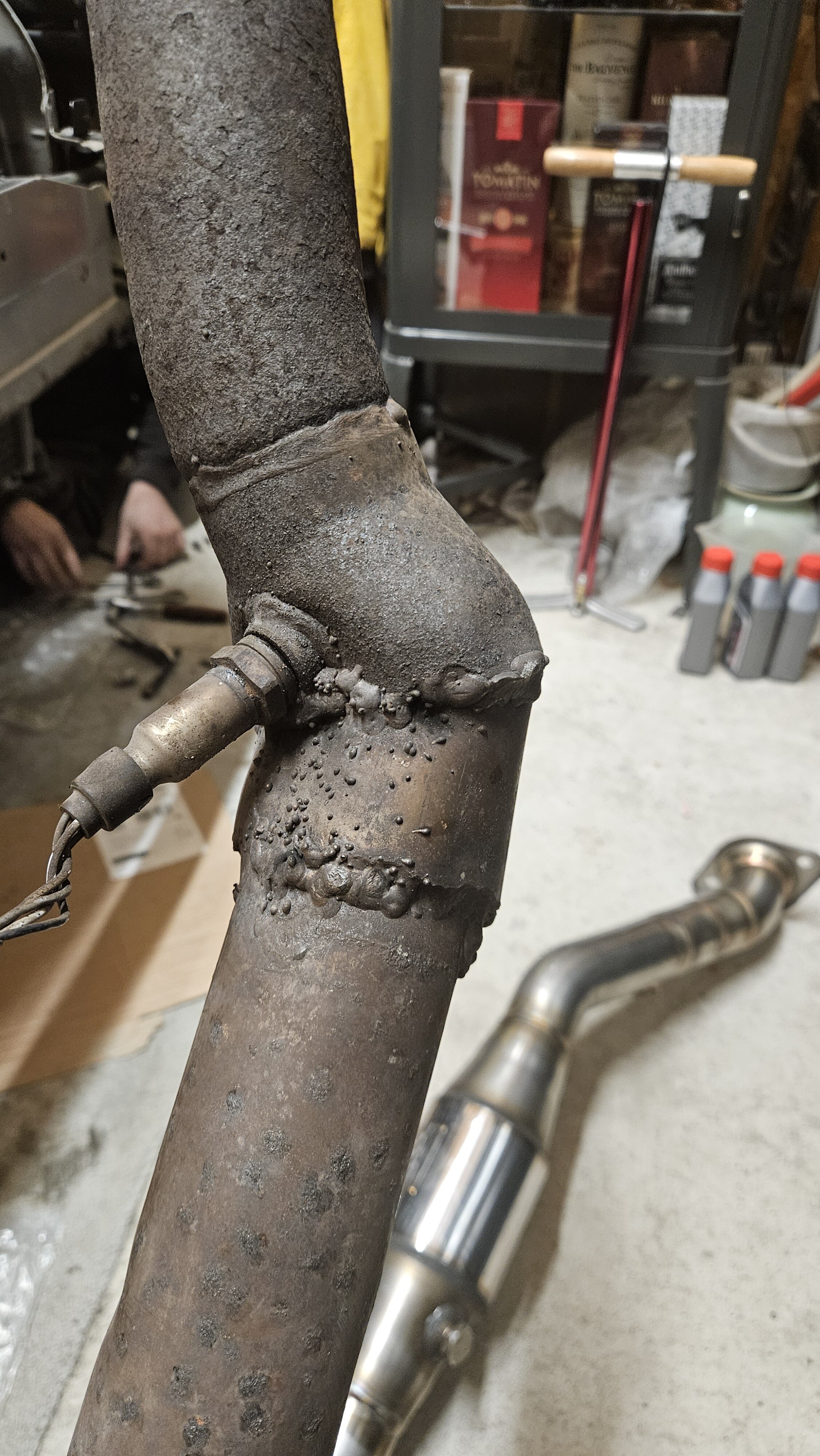

New BTT motorsport poly hangers on and KTR stainless system / sports cat offered up.....
Look at the butchery department decat pipe i took off !!! Somebody in the past must have tried to keep the pre-cat lambda in place and crow shitted some scaffold tube along to the middle section 😂
Next up im hoping to get the TB and filters back on, air con delete kit fitted then get it back running.

🙏 Many thanks mharvey - bump stops/dust covers for front shocks ordered from KAM 👌👌
That's all folks 👍
Sorry , too late for you , but these faftermarkey dust covers fit perfectly , I've got them on my Cup ..

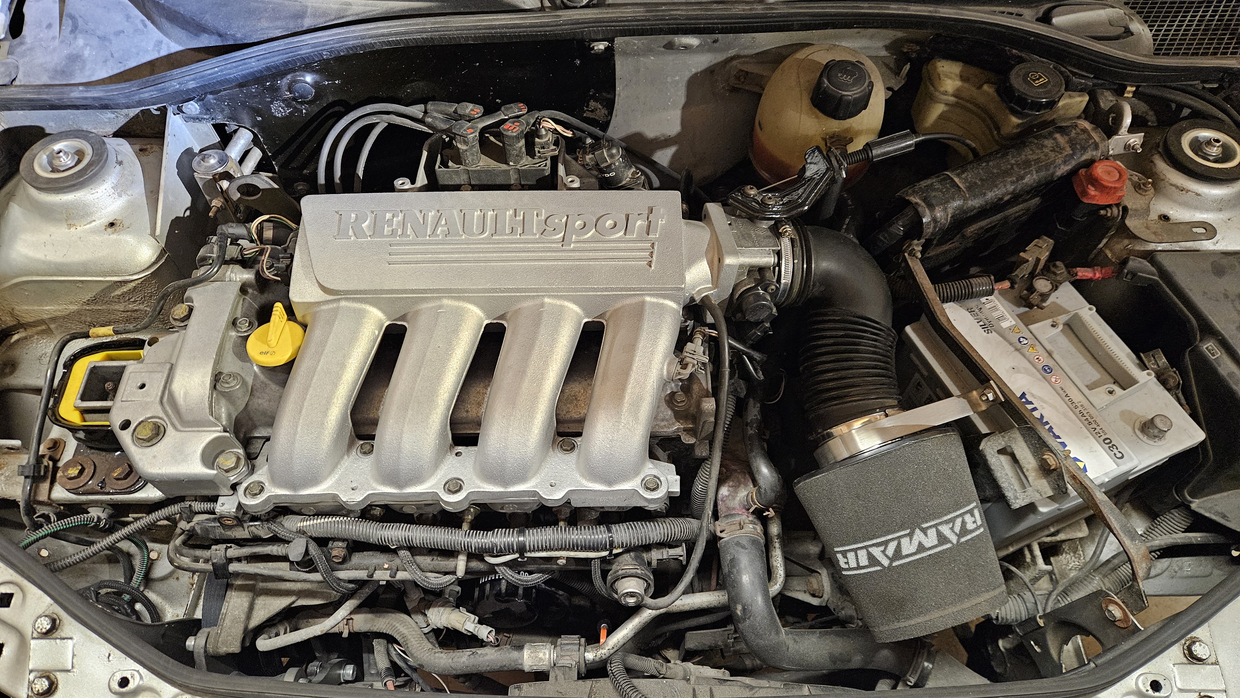

Its been a quiet couple of weeks on the clio, partly to do with it taking me about 2 weeks to get over a stag weekend in Hamburg 😂, but I was back in the garage last night pushing it on a bit.....
Got the shocks back off, stripped down and OE bump stop / covers on, TR ends nipped up and had to file the powder coating out of the hub sockets to get the new ABS sensors to fit. So the front corners are now pretty much complete 🙏👌 just have the arch liners etc to put back in and mudflaps to sort.
Also got the Throttle body cleaned up and polished, painted the cable bracket and new gasket, so got that back on along with ramair filter and ductwork. So its nearly there up top now too.

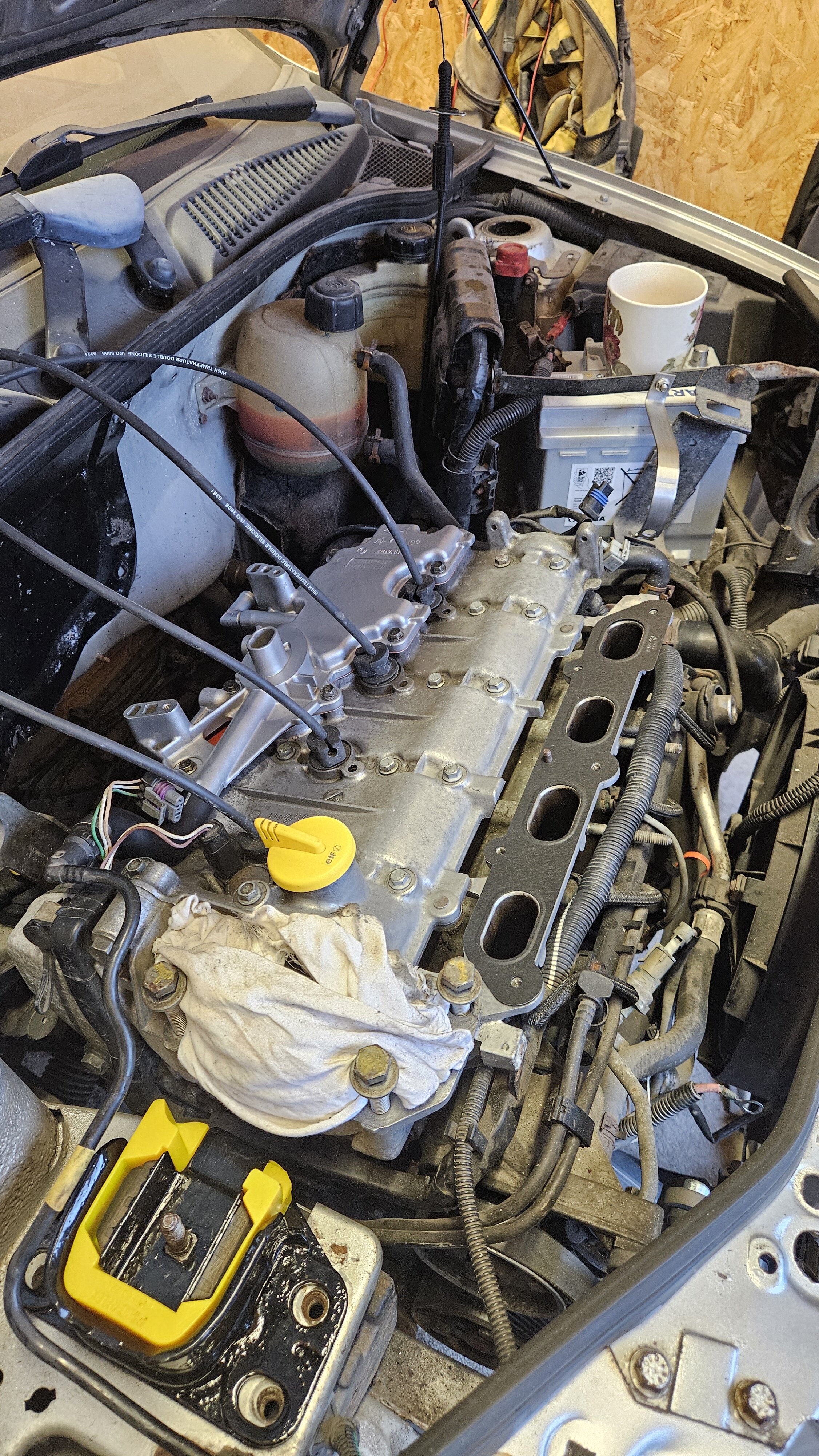

Then thought id give the stud removal a go underneath. I was a bit heavy handed with the crack bar taking the subframe braces off (which seems like a life time ago) and 3 of the 8mm bolts snapped off flush with the chassis rails. Couldn't quite believe it, got myself some decent cobalt tipped HSS bits and all three drilled out perfectly, bang on centre and 8mm tap got the last bit. Happy as Larry with that little win. Apart from it taking me half hour to get the swarf out my hair 😂 Few new shiny bolts and subframe braces are back on and looking well 👌

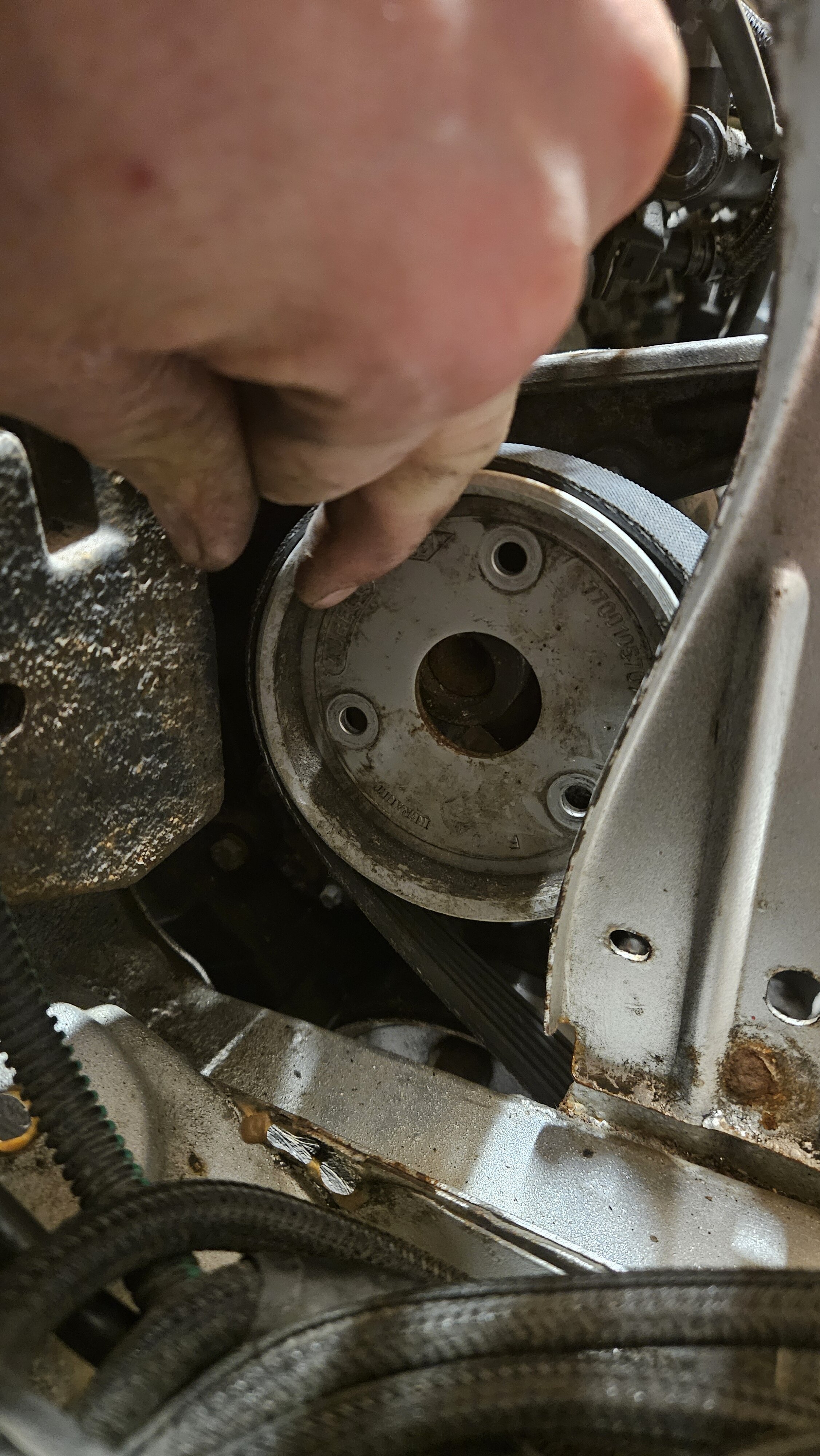

Ran into a slight problem trying to finish the PMS air con delete kit..... I got the bracketry mounted and alternator back on a while ago, but left it just needing to be belted up and tensioned before nipping it all up. Followed the instructions and got the belt back around the pulleys, but can't seem to get the Power steering pulley back on the axle as the belt seems way too tight. Anyone had this issue before? My man Andy says its far too tight and even if we could get it back on, the belt will whine like a b*****d. Spoke with Nick at PMS and he says the gates 6PK1305 belts are seemingly coming up short at the moment so he's sending a 1310..... top service 👌 hopefully that will work but any tips from anyone else?
That's me pulling the PS pulley as tight as I can..... nowhere near getting back over the shaft.
