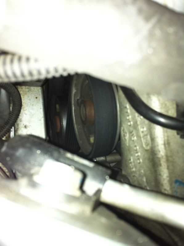

Maybe it might help if you can get some pics of the belt, pulleys and tensioner in situ so we can see if their are any obvious problems.
No, it done it before, that was why i replaced it. The belt is tight but as you say.. there's something off somewhere. Yeh I'll get some photo's when i take it to bits again because i need to sort it before sunday haha! The Altenator pulley has a litte chip off the outer edge but the belt isn't even coming close to that so i assume it could only be the PAS or the crankshaft pulley at the bottom (i really hope it isn't)

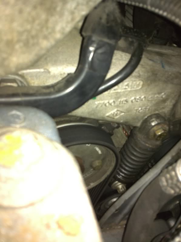

(in this picture, the pulley is new, but the damper on the pulley is the old one)
So you didn't replace the spring?.
It might just be the way the pic looks but in the first photo it looks like the PAS pulley isn't inline with the water pump pulley. Which would mean the belt isn't running straight.
Yeh i replaced it but it was far too tight The spring was bent right over and had no movement what so ever, it was about an inch and a half longer than the original. so waiting for new one coming from renault.
I'll have a good look in the light in the morning.
Thats probably the problem then mate. Your springs probably had it. The new ones are stupid tight.
